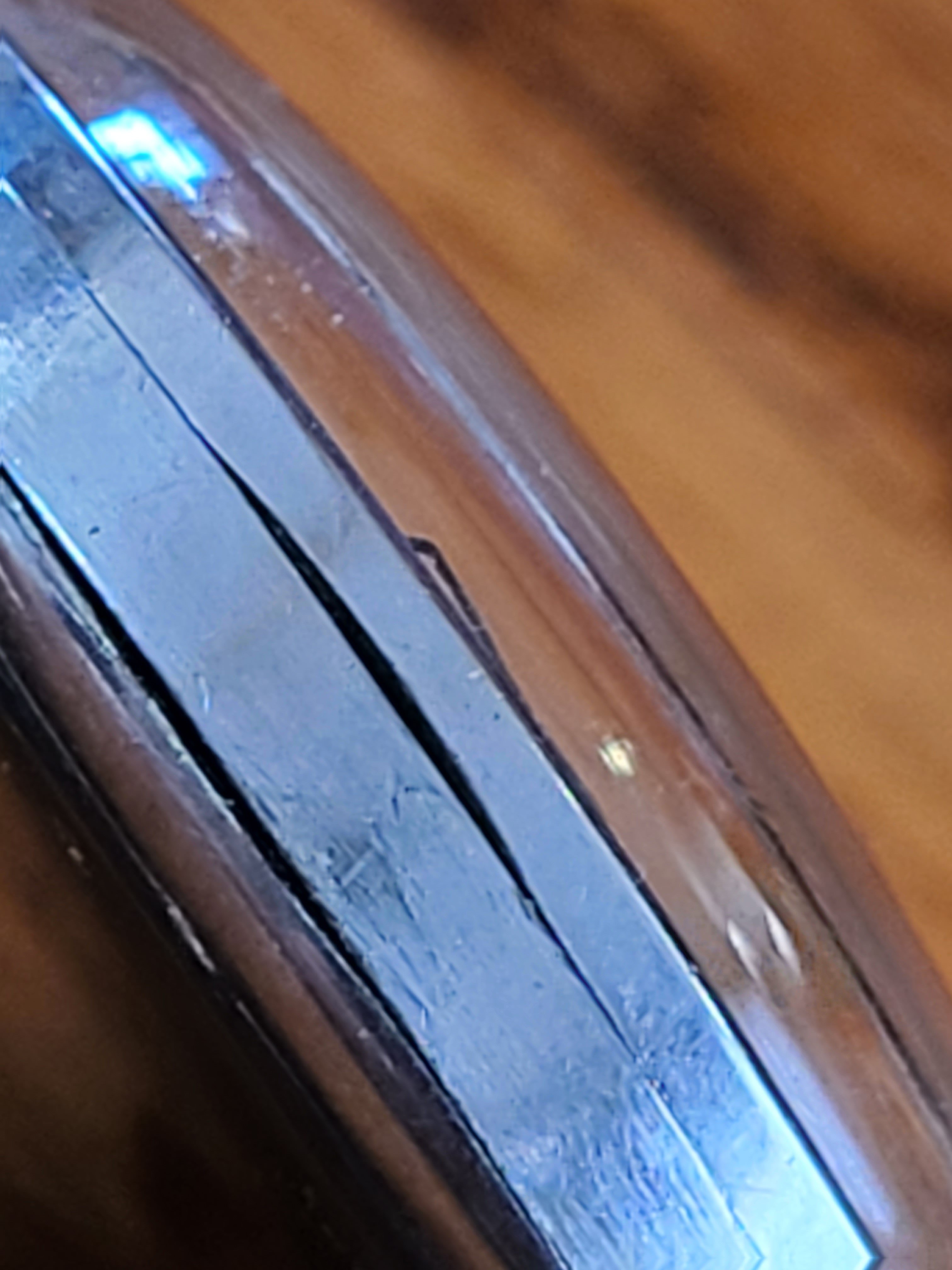

Ooooh oooh. Not sure if this is a three piece case. How would I know? I don't think that there is a bezel so It may be not. You see any bezel? Thanks.

Is this a three piece case? If so maybe you have to remove the bezel/glas assembly and take the movement out from the front side.
I believe I see a bezel. Took a shot but since I have a new phone , have to download something(bummer this technology). Thanks.

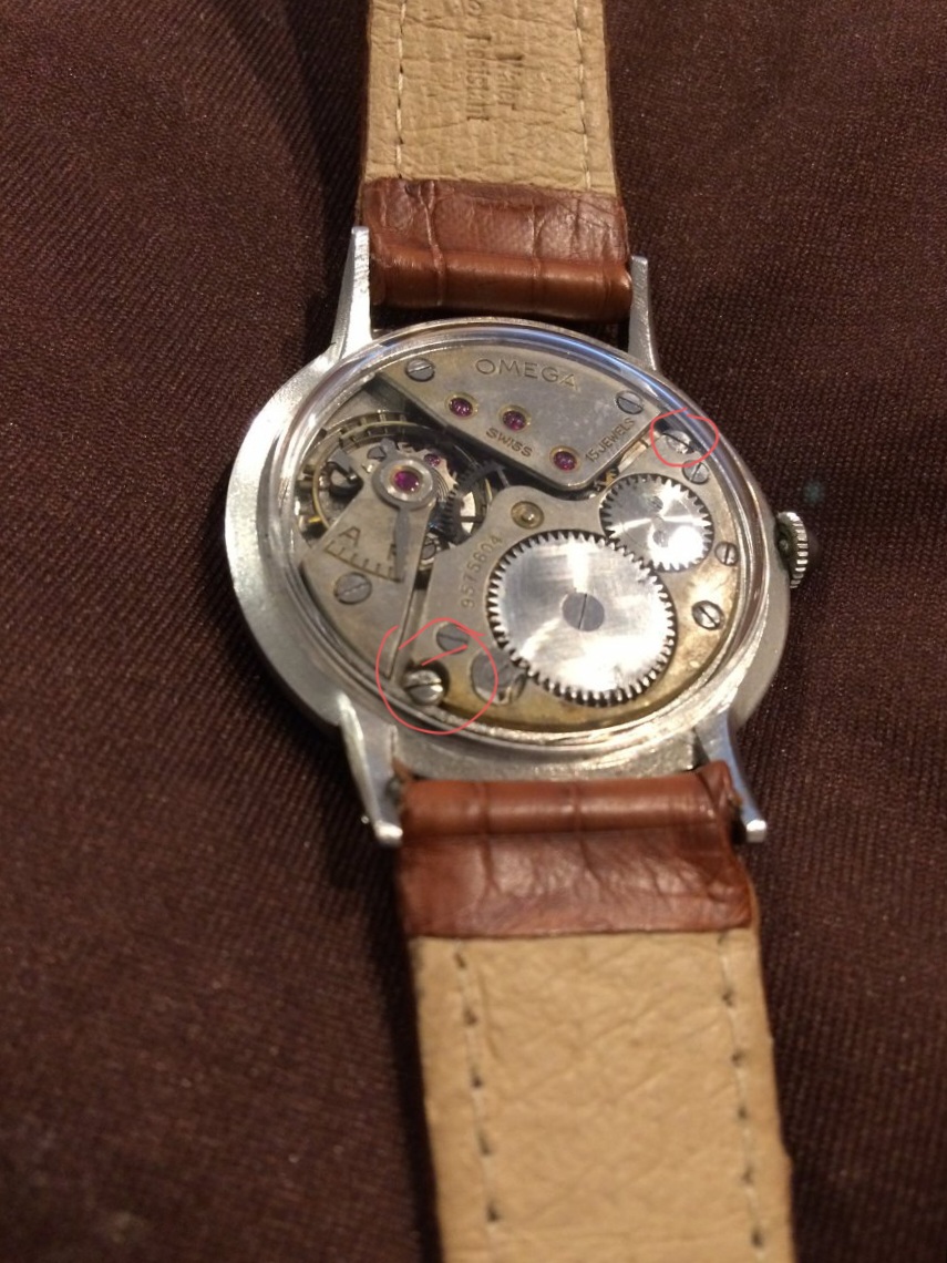

And those two movement screws.
Can you show me the movement screws location? Thanks and I sent you a PM too.

The crystal is attached to the bezel and be removed as a whole unit. Be extremely careful with your knife or it goes too far and hit the dial.

So:
1.Crown Stem assembly out
2.Movement screws out
3. Pry the bezel crystal assembly out very carefully
4. Entire movement with dial and hands out from the top.

Mission Accomplished. Movement out and soon caseback ship for repair. Thanks everyone. Special mention to Hoi Polloi!!
