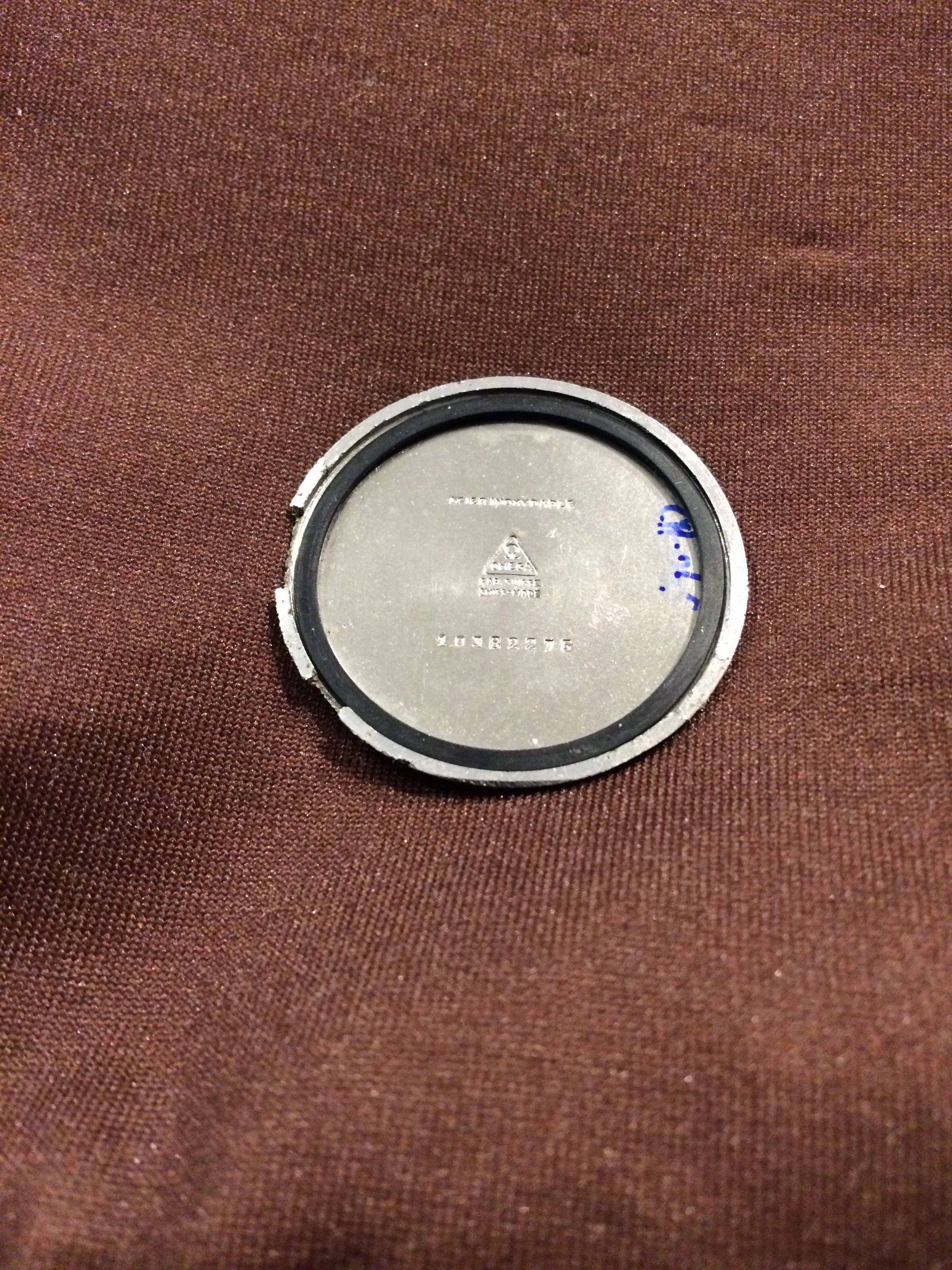

I found a shop that can repair the case back of my watch but I need to send the entire case as well. Can't figure out how to take out the crown stem to take out the movement. I don't see any holes/pins like some watches where you need to do is push while pulling out the crown. Guidance please? Thanks.
317
251
The shop is in Asia and to be on safe side the guy just want the case/case back. Thanks

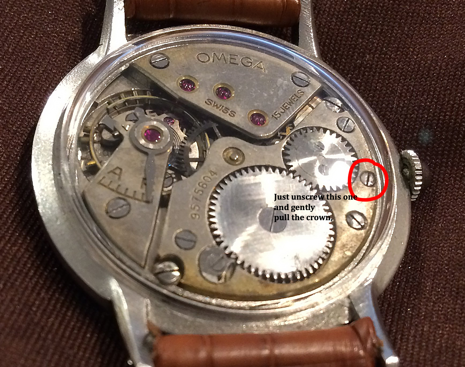

You need to loosen the stem release screw, but just enough to remove the stem. Not too much. If you mess it up, you're going to be unhappy.

That is so true. Didn't think of that that way. The shop(Asia) uses a courier here in Oregon (don't ask me why) then from Oregon to him. Maybe he doesn't trust this courier with a complete watch(lol)? Which one is the stem screw? I can do it. It is just that I am so used with Seiko. Thanks Dan

It's important that you only unscrew it enough to remove the stem. Don't go crazy unscrewing it multiple turns. Be gentle and slow.

Try to pull the crown out every screw turn?

Less than one turn. You might start with one turn, or one and a half. But if that doesn't release it, I would go half a turn from there.
