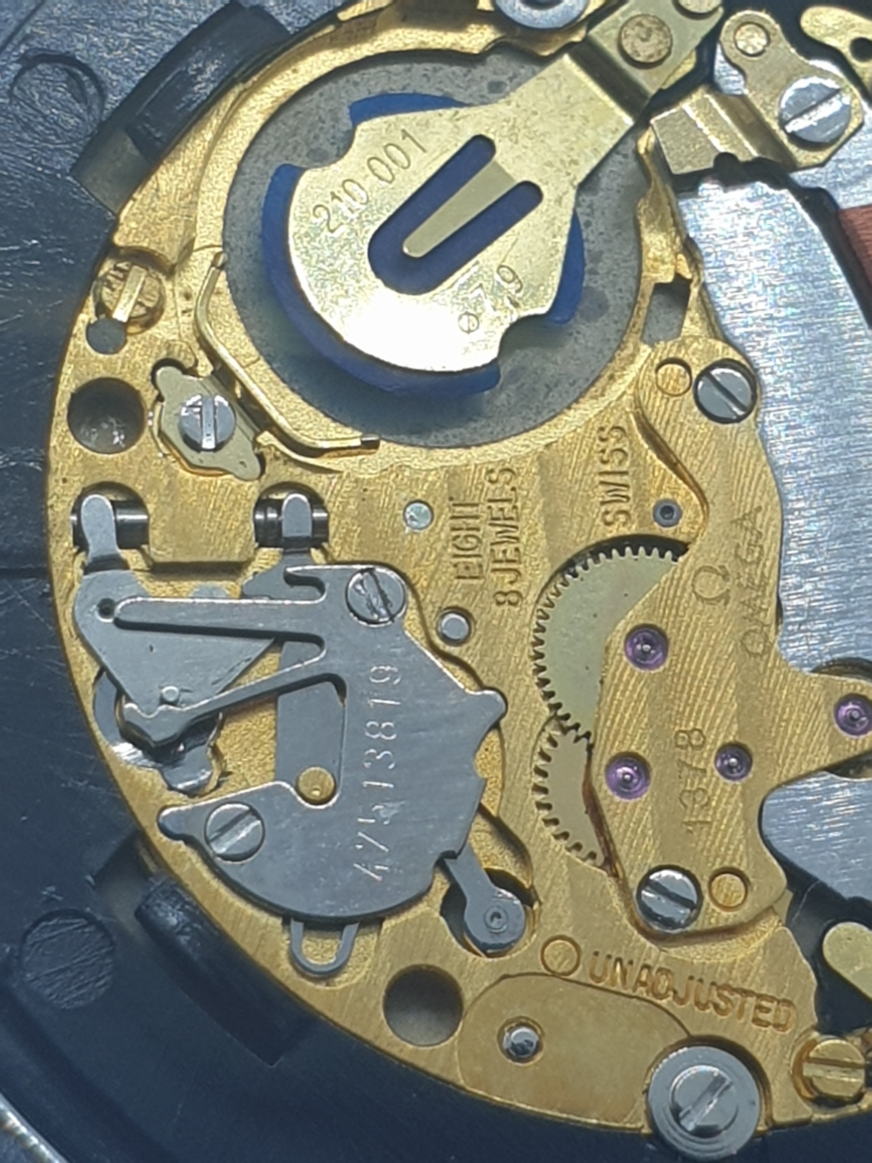

Good afternoon can anyone please help me, i need to remove my Omega De Ville Quartz Cal. 1378 watch movement but i can't find anywhere how to proceed with stem removal...

The layout is unusual with all the setting parts installed on the top plate, rather than on the dial side of the movement. I suppose for this reason there was no real stem release provided, at last that I can see. Fortunately, you can remove the necessary setting parts easily to get the stem out.

Thank you very much for your help i will try to remove the top to see if it does release the stem
