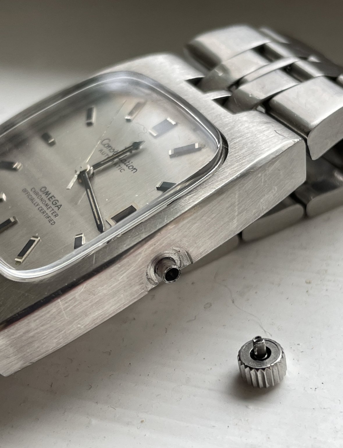

My new-to-me vintage 60’s Omega winder needed the time set and I gingerly slide the crown outward to do so…and it popped right off. It had been service in 2021. And here I was thinking that this Christmas gift was ready to go in the box. Geez. I’m sure I’m not the only one that this has happed to, but dang I thought I was done.

I’m assuming it will have to be sent off to have repaired. Now I might be in a race to get it done by Christmas. Heart-sinking feeling for sure…

I gently tried to screw it back on but was afraid to try to hard. Didn’t work. I’ll put it under a scope and examine to see if it is indeed a break.

I wouldn't try to screw it back in, anyway. Even if it is just unscrewed, you'll still want to remove the stem and install it correctly in the crown with a tiny bit of thread locker. If you're not familiar with these steps, it would be a job for a watchmaker anyway.

These use a two part stem, should snap back in place.
16,001
48,139
Put the crown back on the case tube, press it inwards and turn it slowly until you feel a “click”, then press the crown inward, firmly. It should re-attach to the inner part of the two piece stem.

Thank you. Will give it the old college try. Appreciated.

That . Sometimes you can aid the " snap back in " female part with the crown with a very fine pointed arts brush and a miniscule amount of lubricant, brushed into/onto the slit. With common sense wisdom you can not damage anything by pressing it in. Just make sure, you feel that the crown part of the stem " catches " the counterpart inside. You will feel a slight movement towards the case, if both parts are aligned. If you are unsure, take a pen and mark the crown and the case at that position. Then do it a second time and see, if that location corresponds. Good luck !

That worked. Much obliged, Sir!

You’re welcome! Remember this procedure because there is about a 90% chance it will happen again!

That being said, it would probably be a good idea to check for worn parts, the male stem (the part sticking out of the movement) and the female part attached to the crown.
