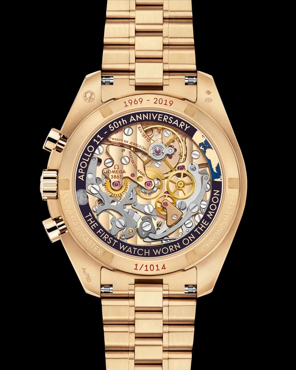

Not at Omega marketing it seems as on their site the A11 is pictured with steel springbars but irl they use gold
30,196
77,952
Omega still uses gold springbars on the A11 Moonshine
When I look up say a ref. 31060425010001 on the Omega Extranet, it uses regular 2207 steel spring bars.
Same thing with ref. 31060425099002.
And ref. 31060425002001.
6,439
31,631
How about 310.60.42.50.99.001?
7,324
23,739
Looks from pictures on the website that they’re steel.
Different part number:
068STZ013119
COLOUR : 3N
MATERIAL TYPE : 1.4435
MATERIAL : STEEL
Looks like they are plated.
6,439
31,631
068STZ013119
COLOUR : 3N
MATERIAL : STEEL
