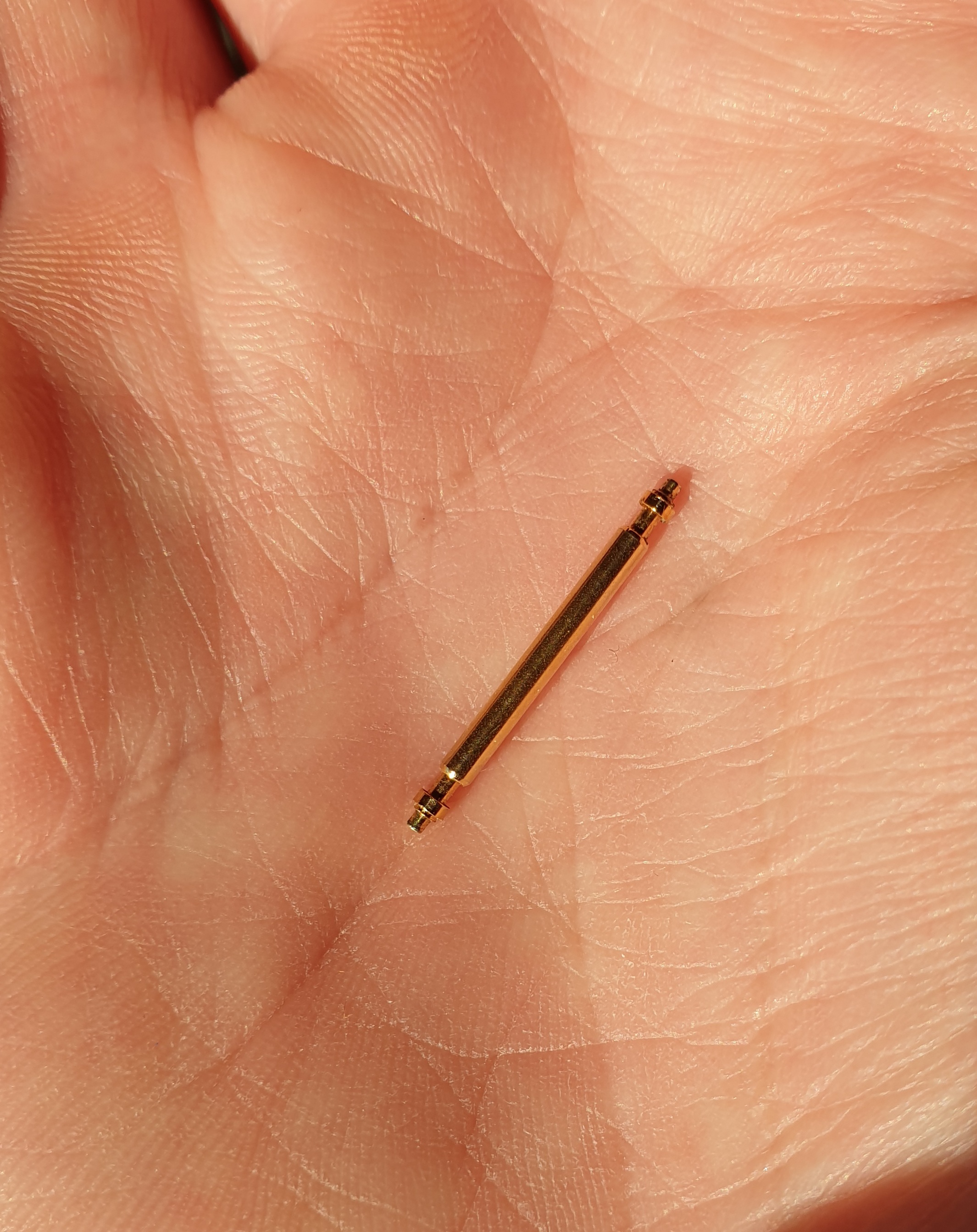

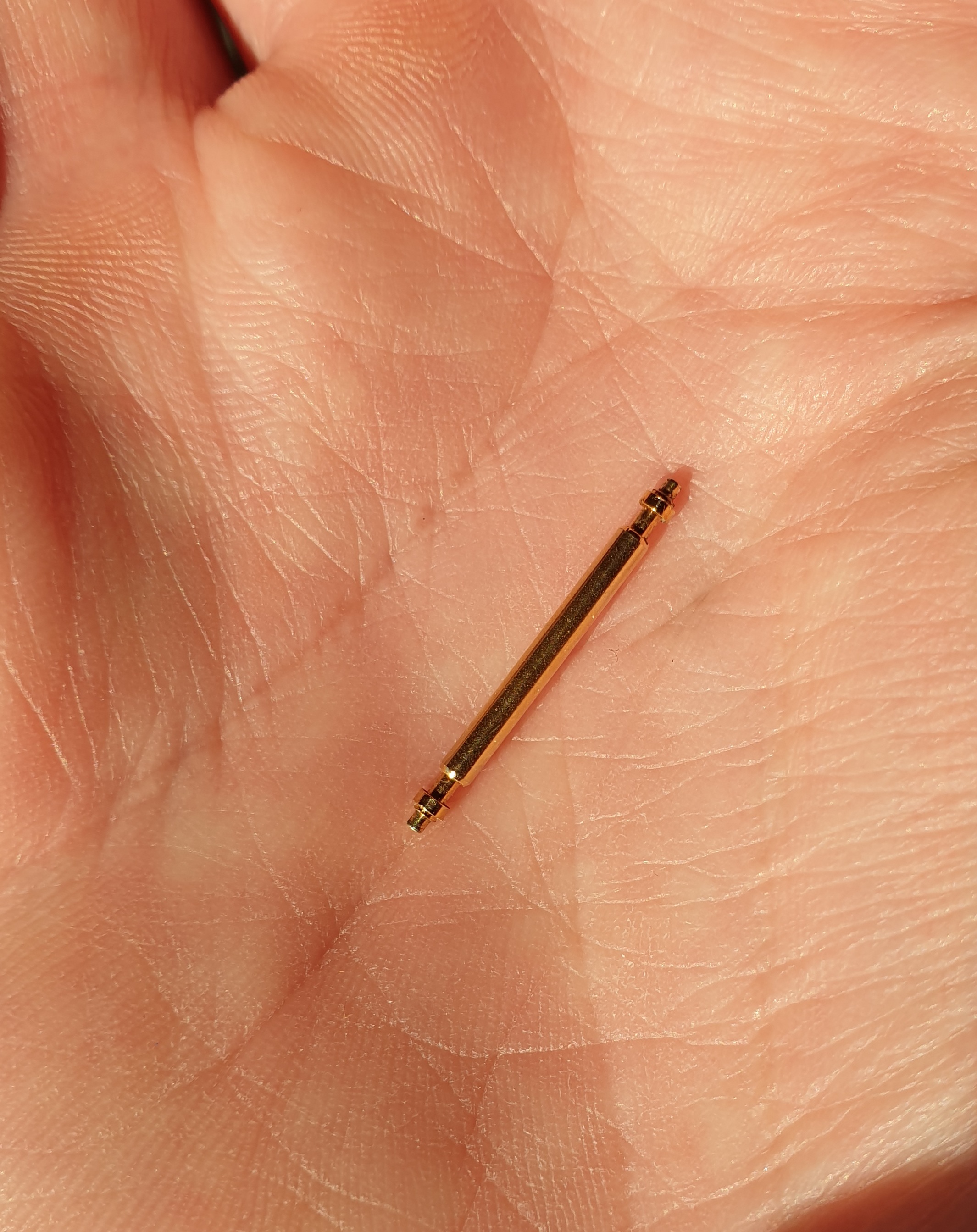

Here is one of the gold spring bars that were on my 18k Certina DS-2 which came on an original Certina strap:
Immensely well built.

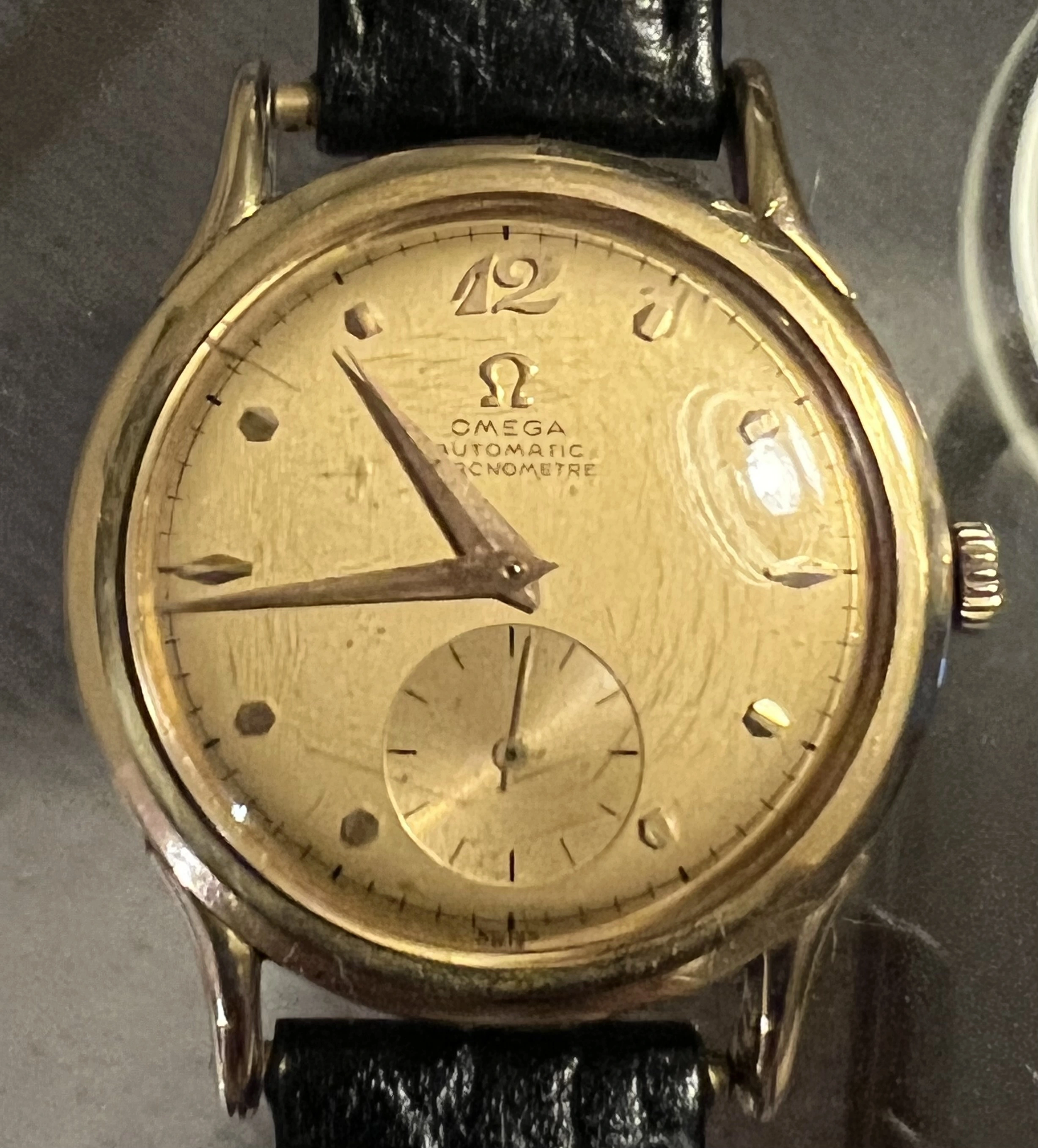

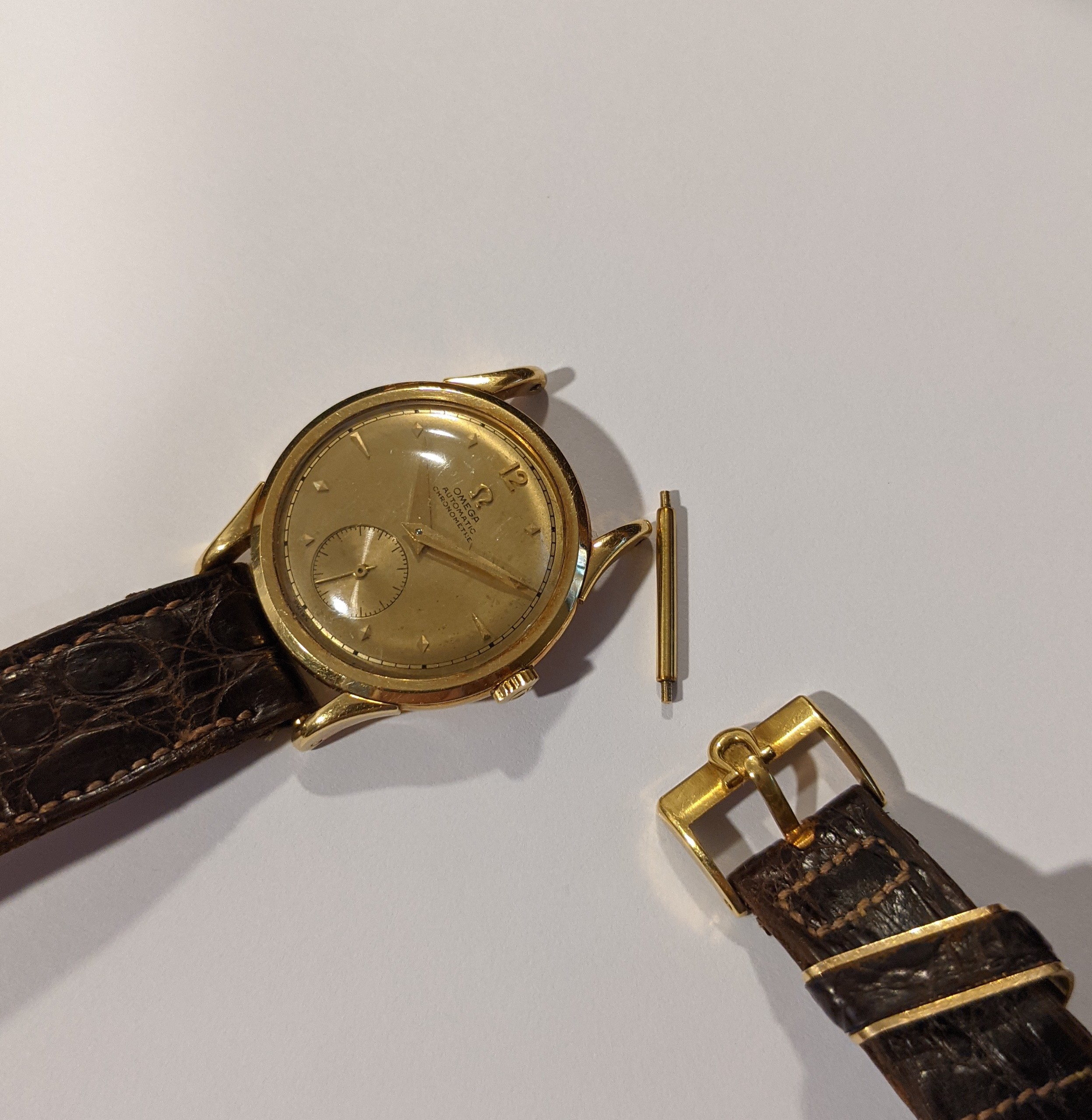

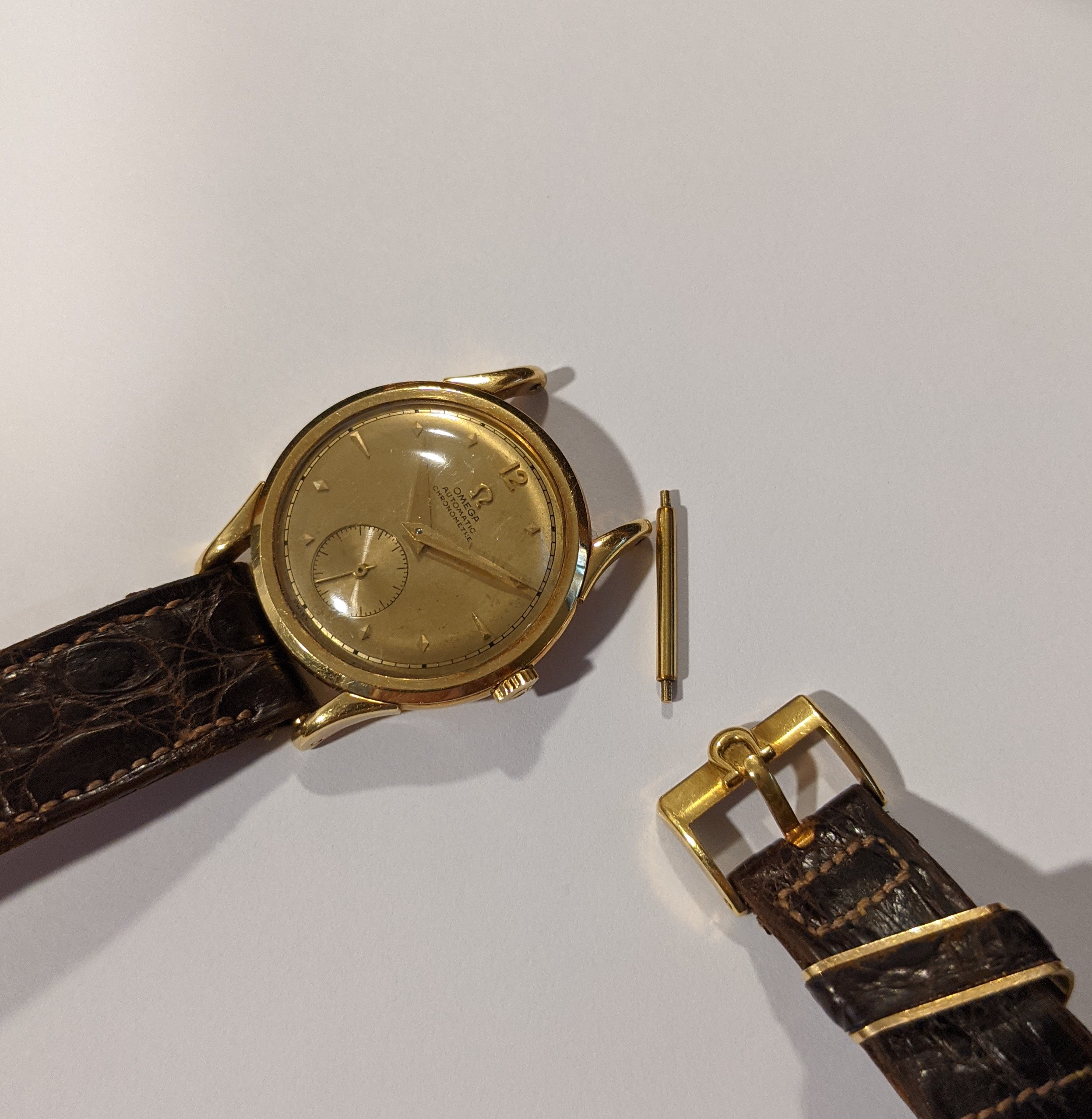

I have a lightly worn OT2499 Centenary that appears to have gold springbars. The buckle also has a gold springbar. All 18k, presumably.
*The strap is a vintage Longines piece. I believe the keeper is plated.
2,541
19,779
Every time I see a Centenary for sale, I look for gold springbars. They crop up occasionally, but more often not than with.
My 2499 . . .
. . . came with steel springbars.

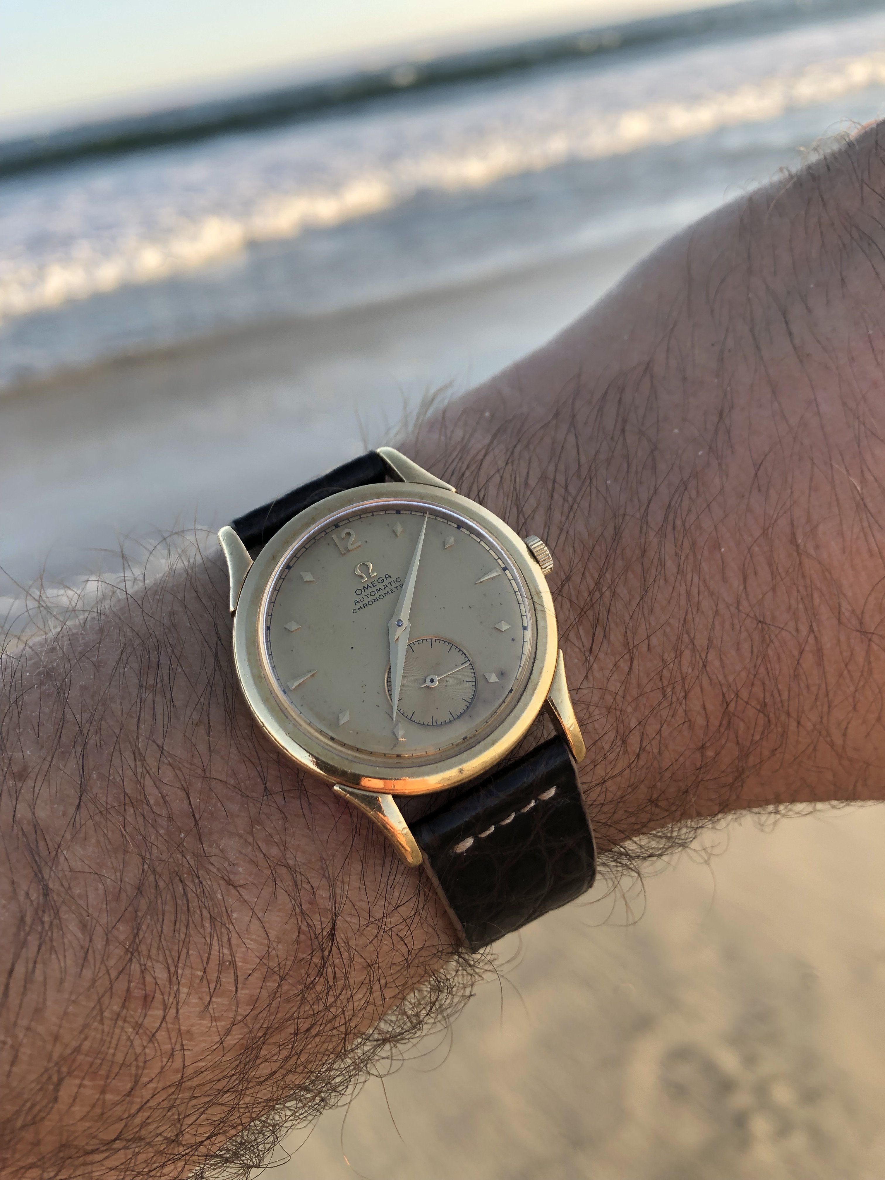

The only Omegas where I ever heard of gold springbars being used are the Centenaries. That’s probably because they were intended to be limited special edition watches made for one year to celebrate Omega’s 100th anniversary.
They sold so well that they were held over for several years after 1948.
My Ref. 2499 came with gold colored springbars on a non-original strap. I saved them and installed fresh steel ones, but never had them tested for gold content. You can see them peeking out in this photo.
