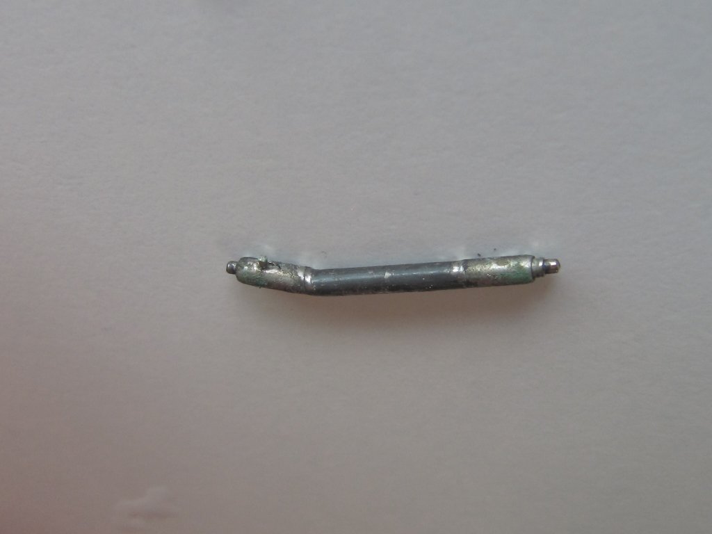

Hi all,

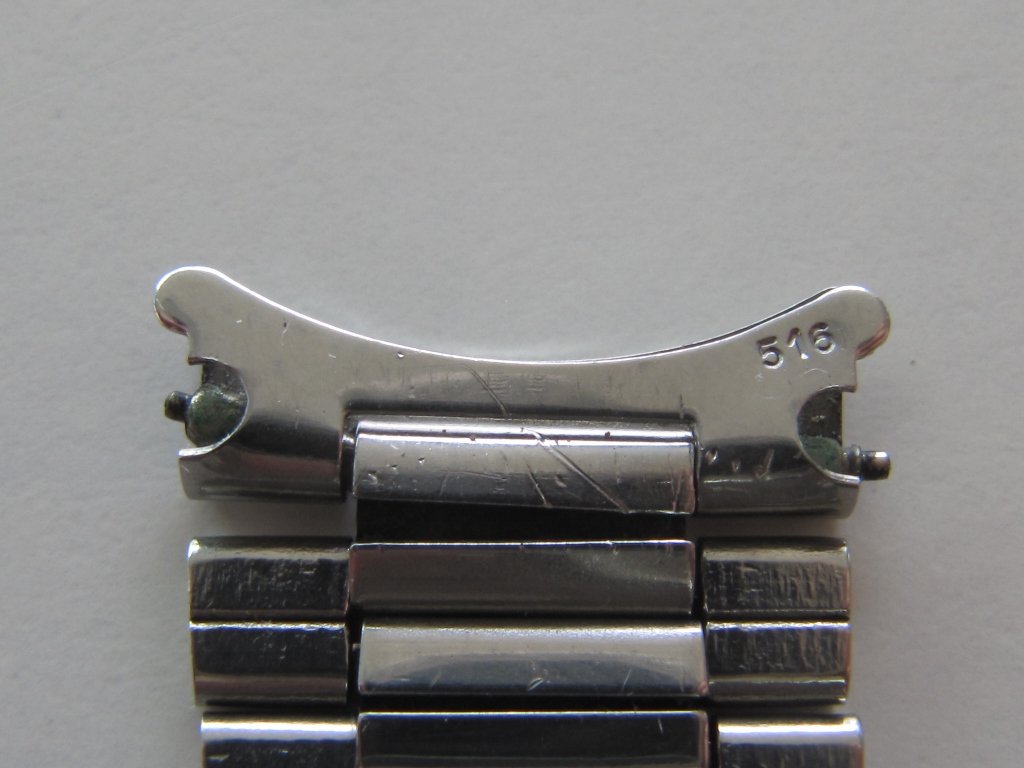

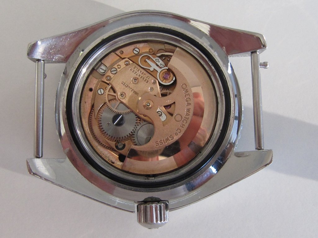

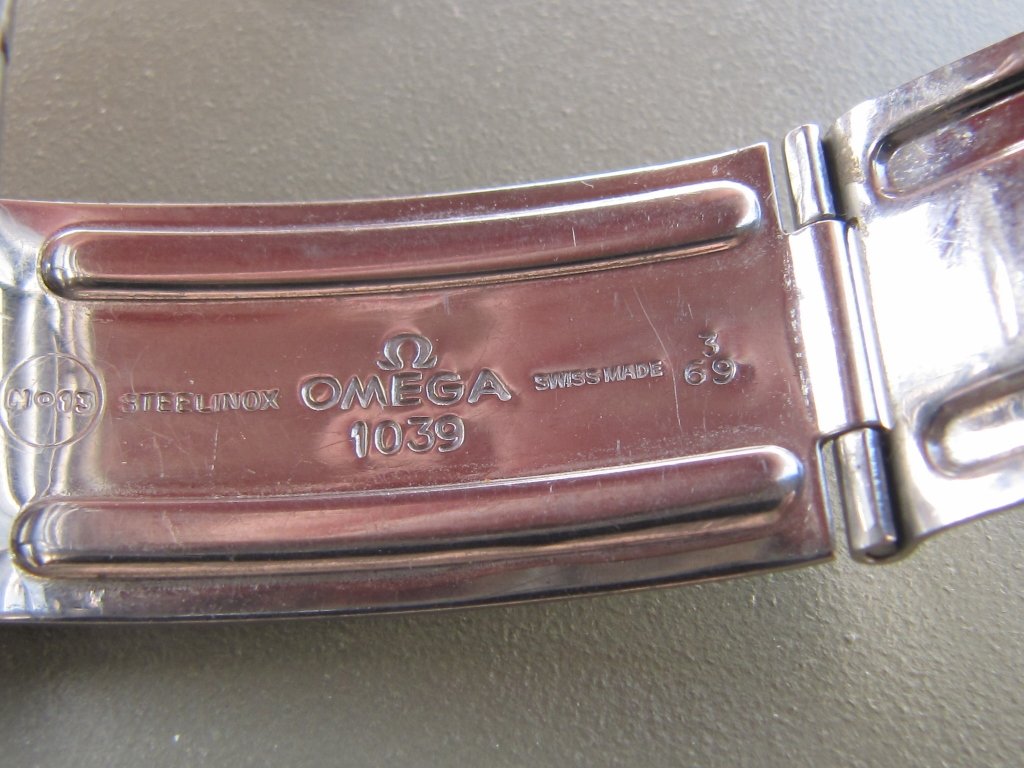

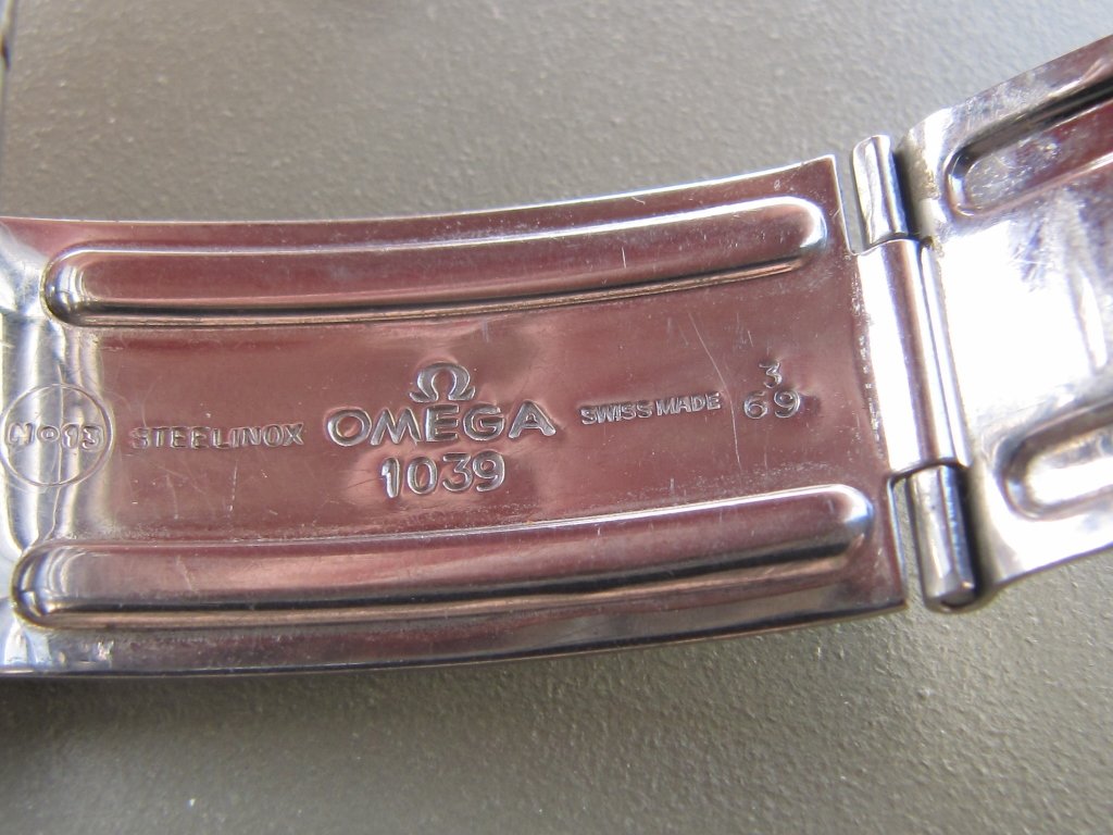

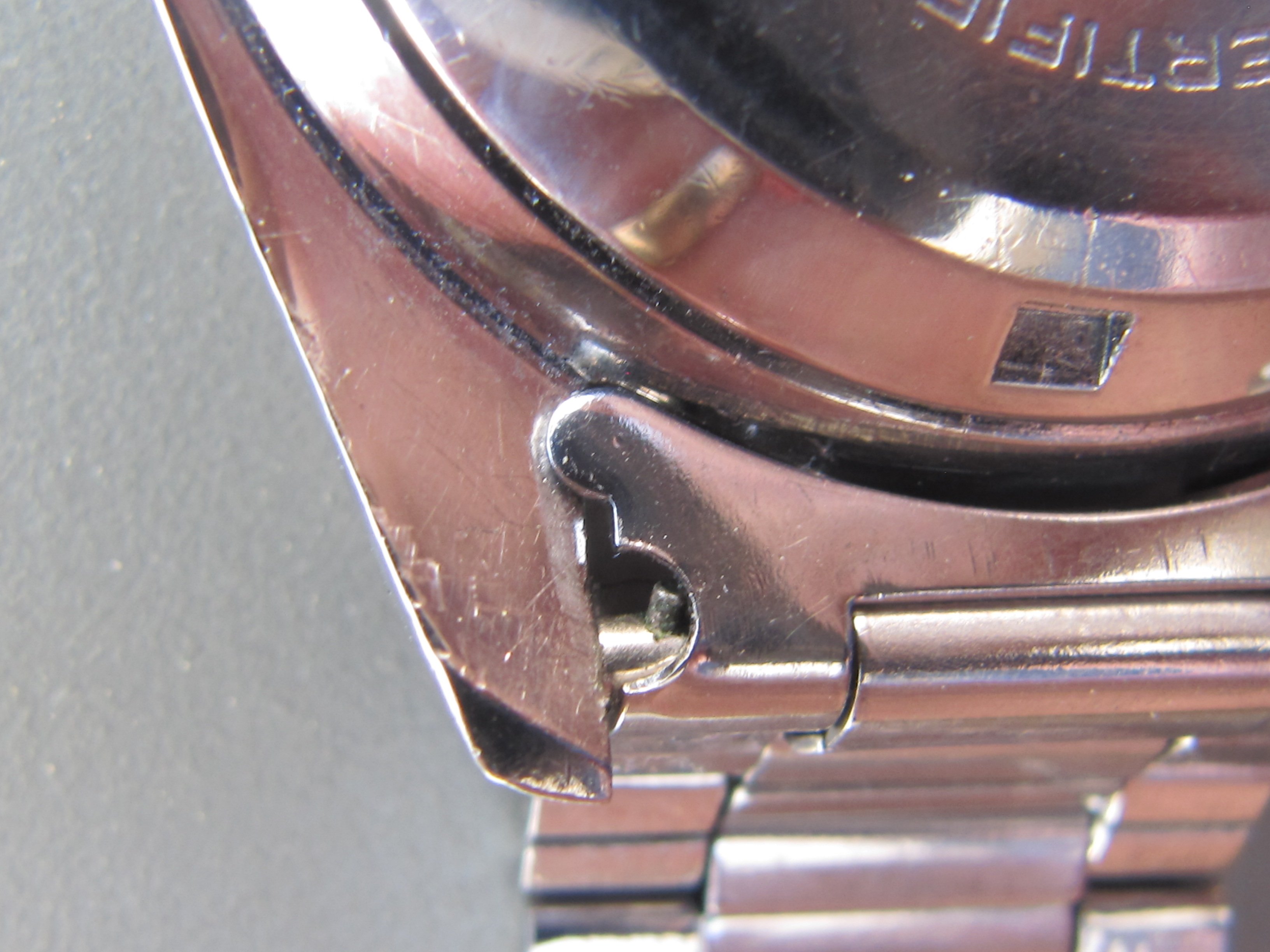

I would like to address this to all 1039 / flat link experts. together with my SM 300 came a 1039 bracelet that was correct in the date range and had lots of DNS on it, so I figure it could be the one the watch was first sold.

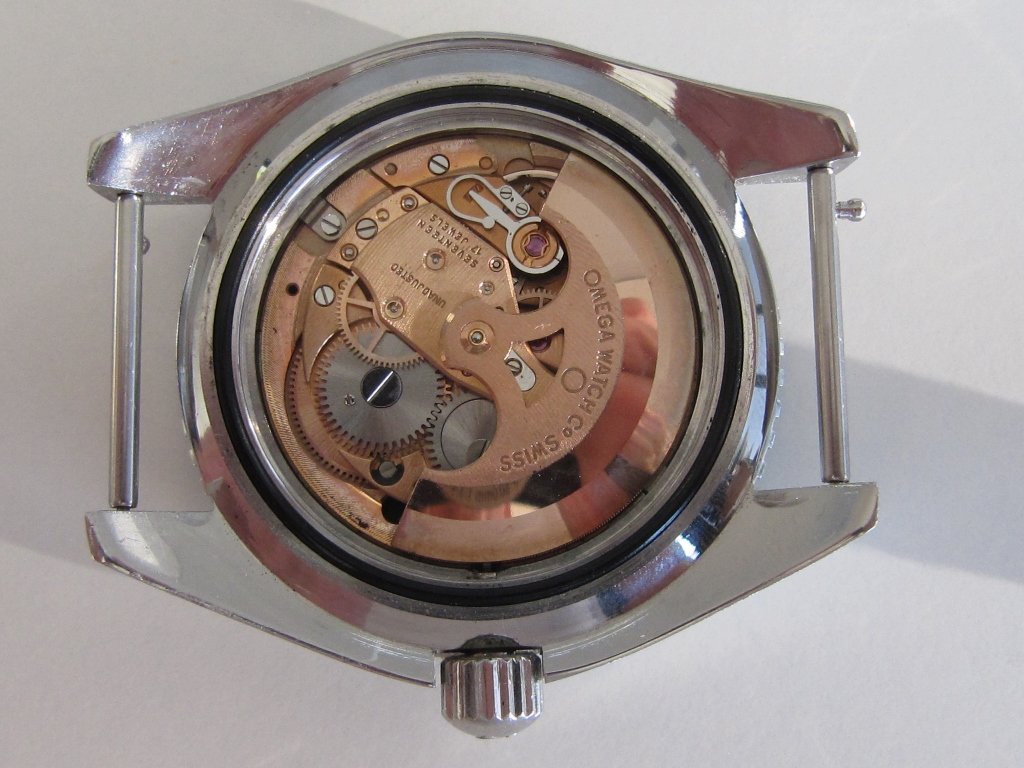

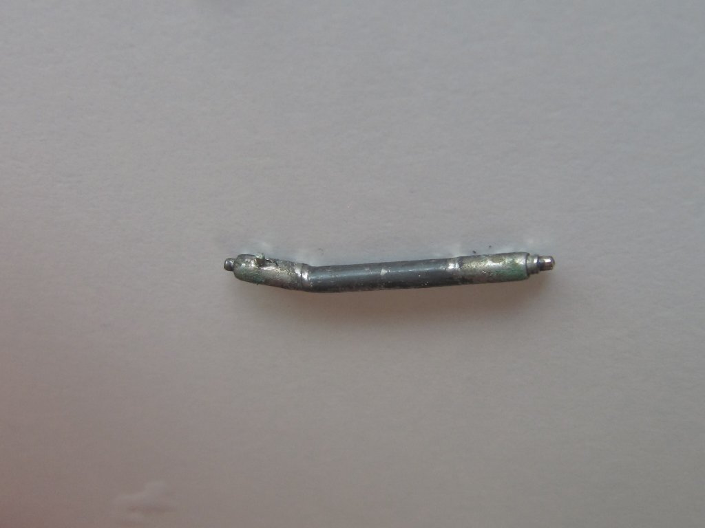

This question appears to be of minor interest and going too much into detail, but for originality sake I would like to know which kind of springbars were mounted in the first place and if somebody knows wether this kind of springbars are on the spare part list of Omega. This is how I got the watch:
I mounted these new ones, they do fit under the endlinks:

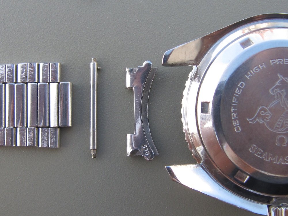

1,996
9,508
The ones you are trying to use are quick release style which don’t work with endlinks. You need “normal” ones that are double sided with shoulders. For bracelets 19mm often works better than 20mm.
13,571
23,557
I think the ones you’ve shown could well be original but I wouldn’t try to use those ‘quick release’ type on that bracelet. I’d use standard 1.8-2.0mm shouldered spring bars. Whatever you do, don’t fit shoulderless ones as they’re a massive pain in the arse to remove on lugs without lugs holes.
232
342
Ok, that sounds reasonable, 19 mm with shoulders on both sides probably are the easiest to mount/dismount.
232
342
I wonder wether Omega has quick release springbars in their sortiment. I only found these: 068ST2206, not quick release. It is not that I necessary want to mount original Omega springbars, but I have to admit the standard springbars with shoulders on both sides are not easy to mount /dismantle as well.
And: you are right, my quick release are shoulderless, I did not realize the outcome of that when I want to get them out again. Good point!

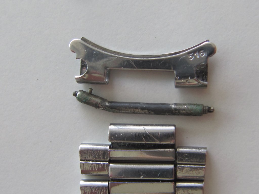

2,318
5,713
The ones shown in your pictures with the 'quick release' are in fact the original spring bars that came on the watch.
If the correct tool is used, they are actually much easier to remove than the modern ones wit the 'shoulder'.
I use a thin OEM Omega spring bar tool, just get inside the end link notch and press the pin back.

To be clear, I didn’t mean “don’t fit shoulderless bars that have a ‘quick release’ notch”. No issue using those as the notch is easy to move. I meant standard shoulderless bars while you’re trying different options. There was a thread a while ago where someone had used shoulderless bars on a watch without lugs holes and they’re a nightmare to relive without damaging the lugs or bracelet.
Thanks for the input. So my guessing was right then. I have to check and try to mount these with endlinks now....

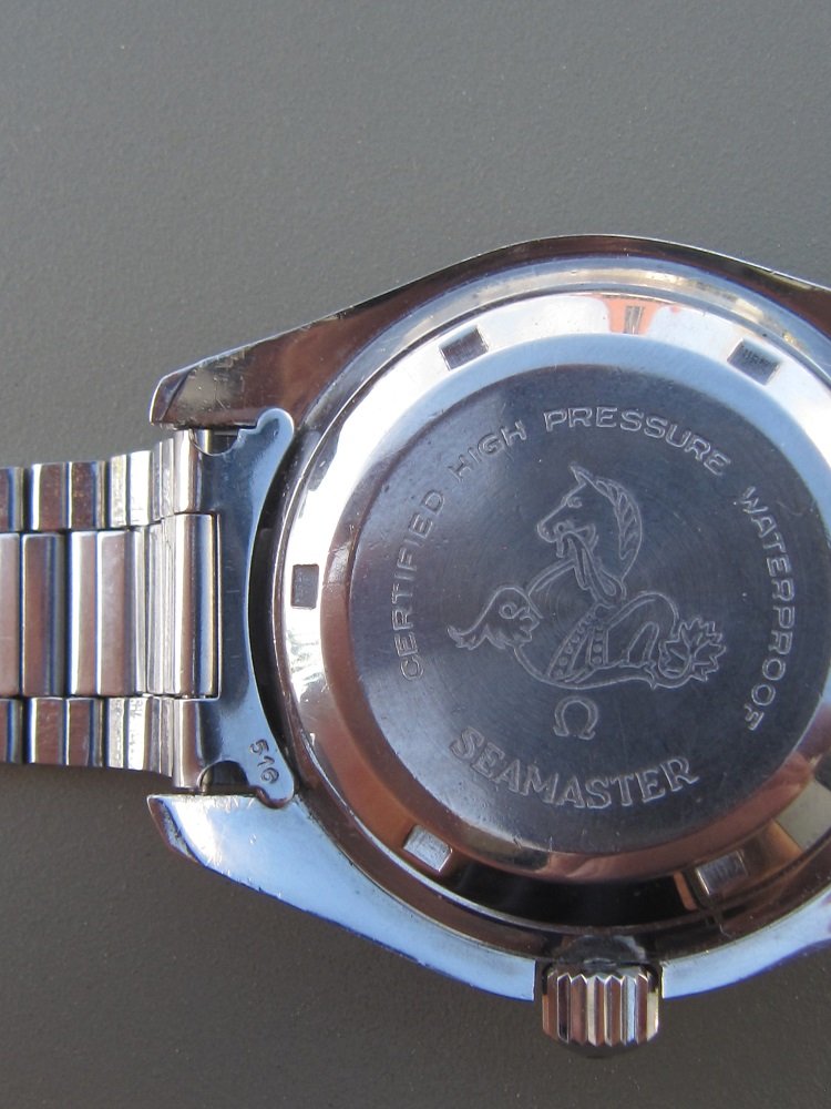

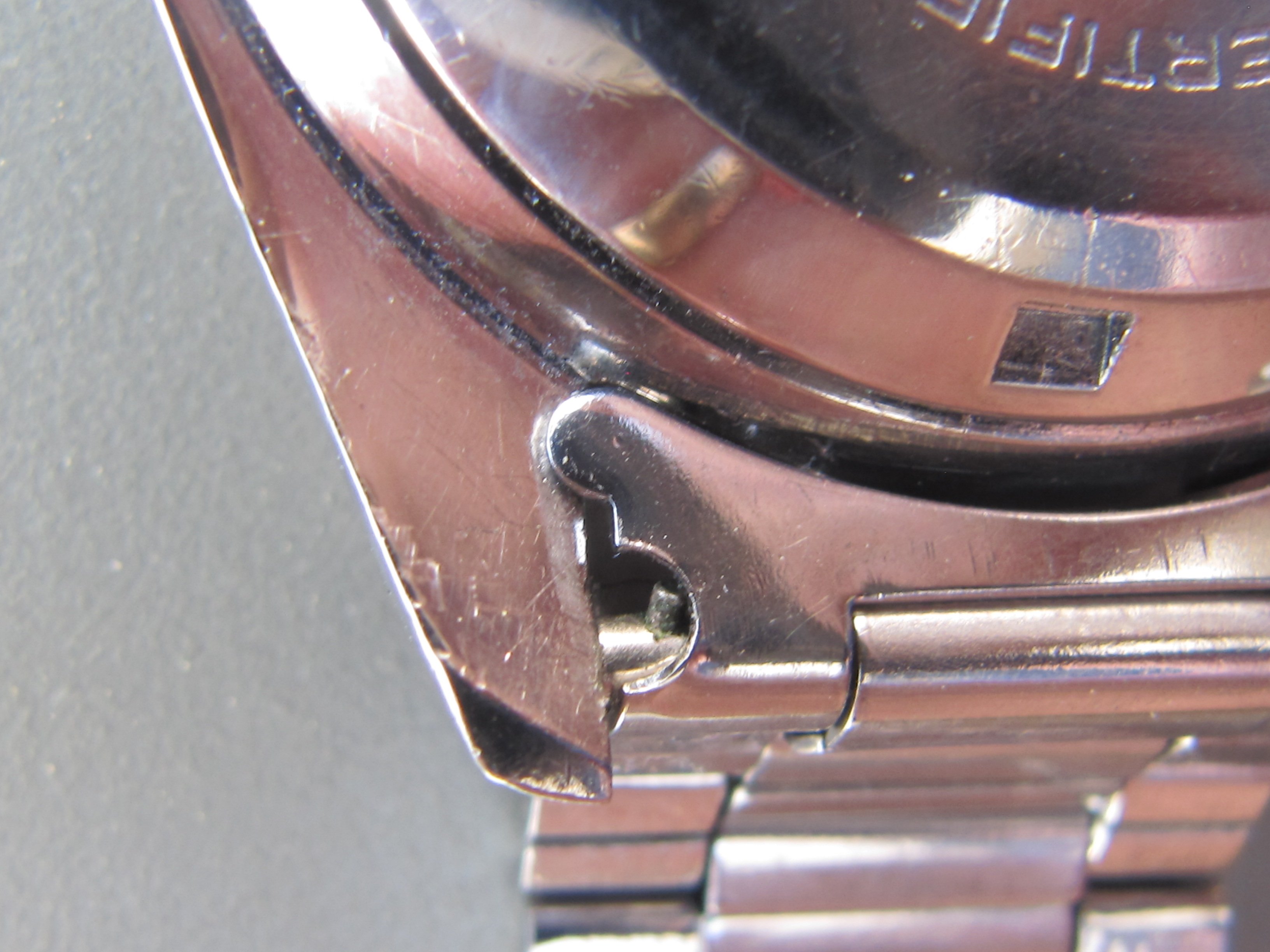

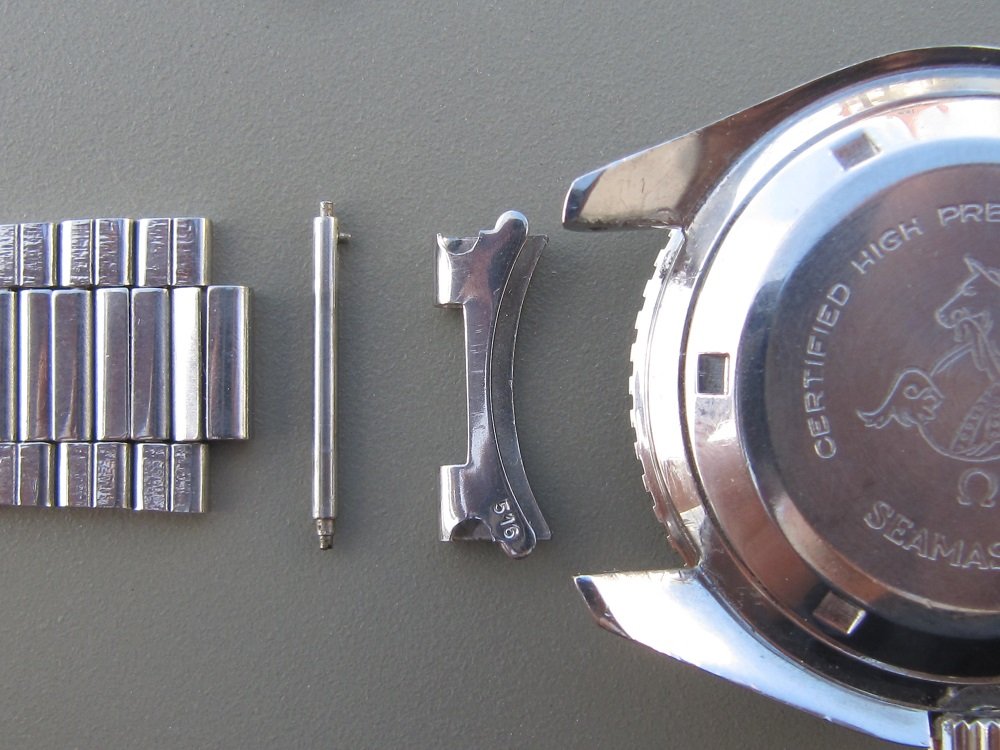

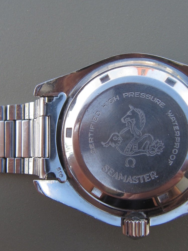

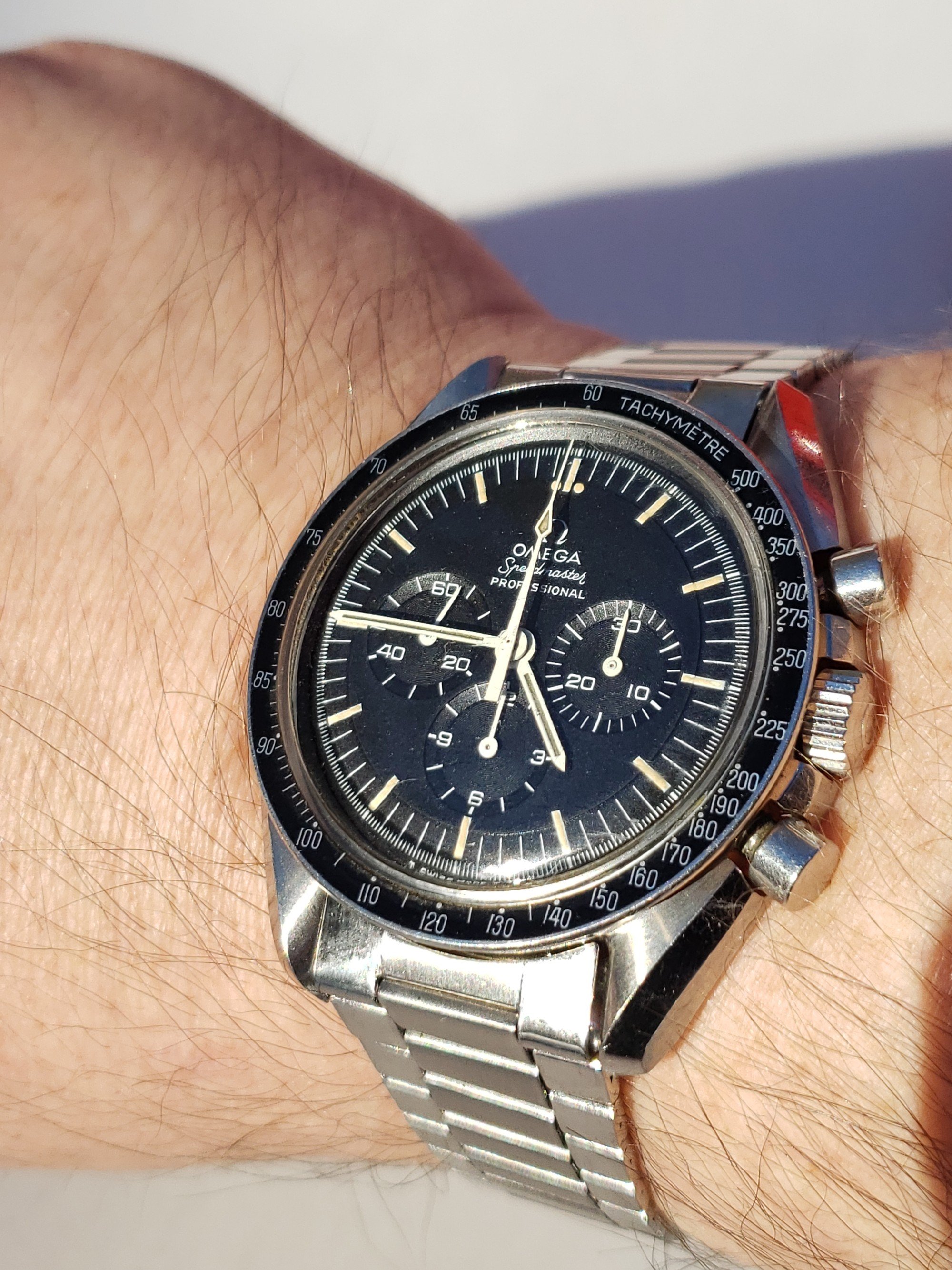

... which leads me to my next question: what is the correct shape, or should I say: curve of the endlinks when looking at them from the side? I tried to figure that out on some of the older threads, but I have to admit: it is not easy see how they are bent to get them `tight` towards the case. When I try to give it a curve, the endlink comes very loose and ends up upside down / below the bevel of the case. The only way to get it tighter towards the case in my hands is when I give it a very flat scalope. But then it looks as beeing too flat...
Is there someone with an unmolested endlink, preferably a side view? Maybe mounted on a Speed- / Seamaster?

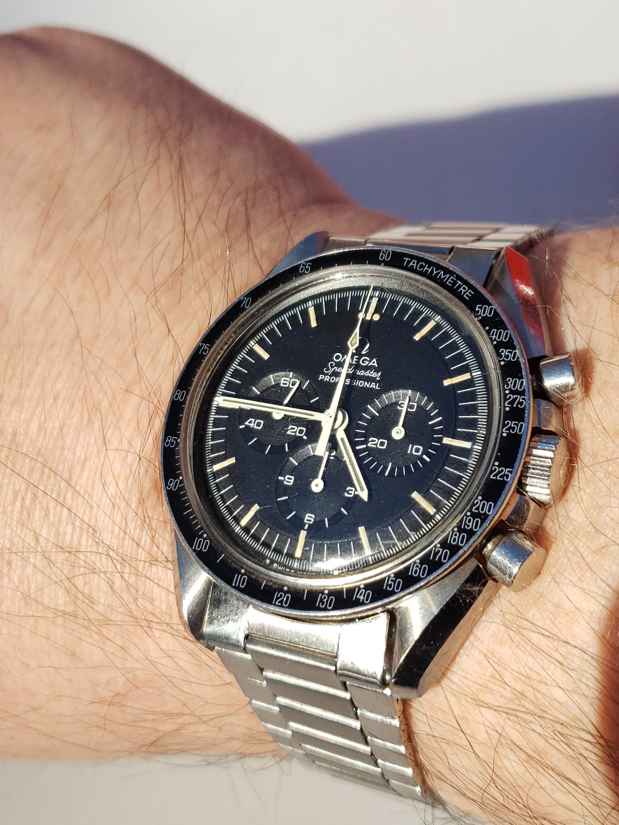

1,593
3,154
As @Dan S says below, I use standard Omega 20mm spring bars. I would never use 19mm bars on this watch or the Seamaster. I wouldn't use QR bars on any watch, let alone this watch or the Seamaster. I wouldn't use curved or bent bars on this watch or the Seamaster.
24,849
55,289
That watch should take 20mm spring-bars, not 19mm. 19mm spring-bars will not be secure. And straight, not curved. If you bend straight spring-bars (especially 19mm spring-bars), they will definitely not be secure in a 20mm wide space. And I really do not recommend trying to use quick-release spring-bars with your bracelet.
All in all, you are really asking for trouble. Just use some good quality straight 20mm spring-bars, with shoulders.
2,351
1,479
Use double flange spring bars and as Dan said. 20 mm if the spacing is 20 mm. Don't use undersized spring bars
232
342
Sorry for the confusion: of course I would use straight spring bars not bent ones, and 20 mm not 19 mm.
What I meant was: what should be the form / shape of the 516 endlinks when looking at them from the side. It seems to me that no matter what shape you give them, they are not held in place by the springbar but by the second link that follows the endlink?
232
342
Nice pic, gives an idea how the endlinks should sit in place... thanks!

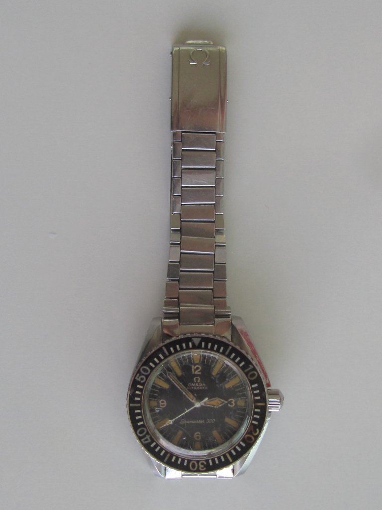

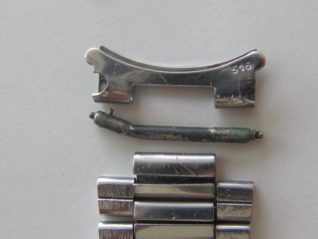

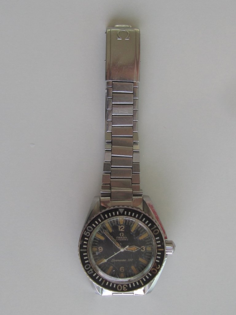

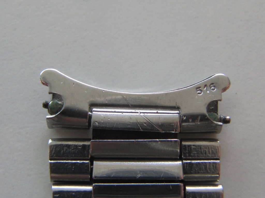

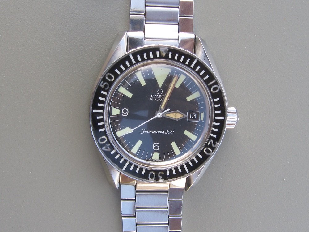

this watch just came in from a kind member here on the forum: I In this condition, with little wear on the back and sharp lines, it seems the bracelet probably never was switched as well. I checked the endlinks: it was no surprise to find another QR springbar under the endlink, still soft and workable. So it seems very probable that these bracelets of that time were delivered as this:
24,849
55,289
So you think that Omega supplied these bracelets with quick-release springbars in the 1960s? I would be very surprised. Perhaps @Archer and other watchmakers might have some insights.
232
342
This is what I recently observed, but it is just an unproved theory. I certainly would love to hear what the experienced members and watchmakers say.
All my original watches that came with flat-link bracelets had these bars. They can roll under the end-link, and can be very difficult to fish out without bending the link. I save them, but change them out.
