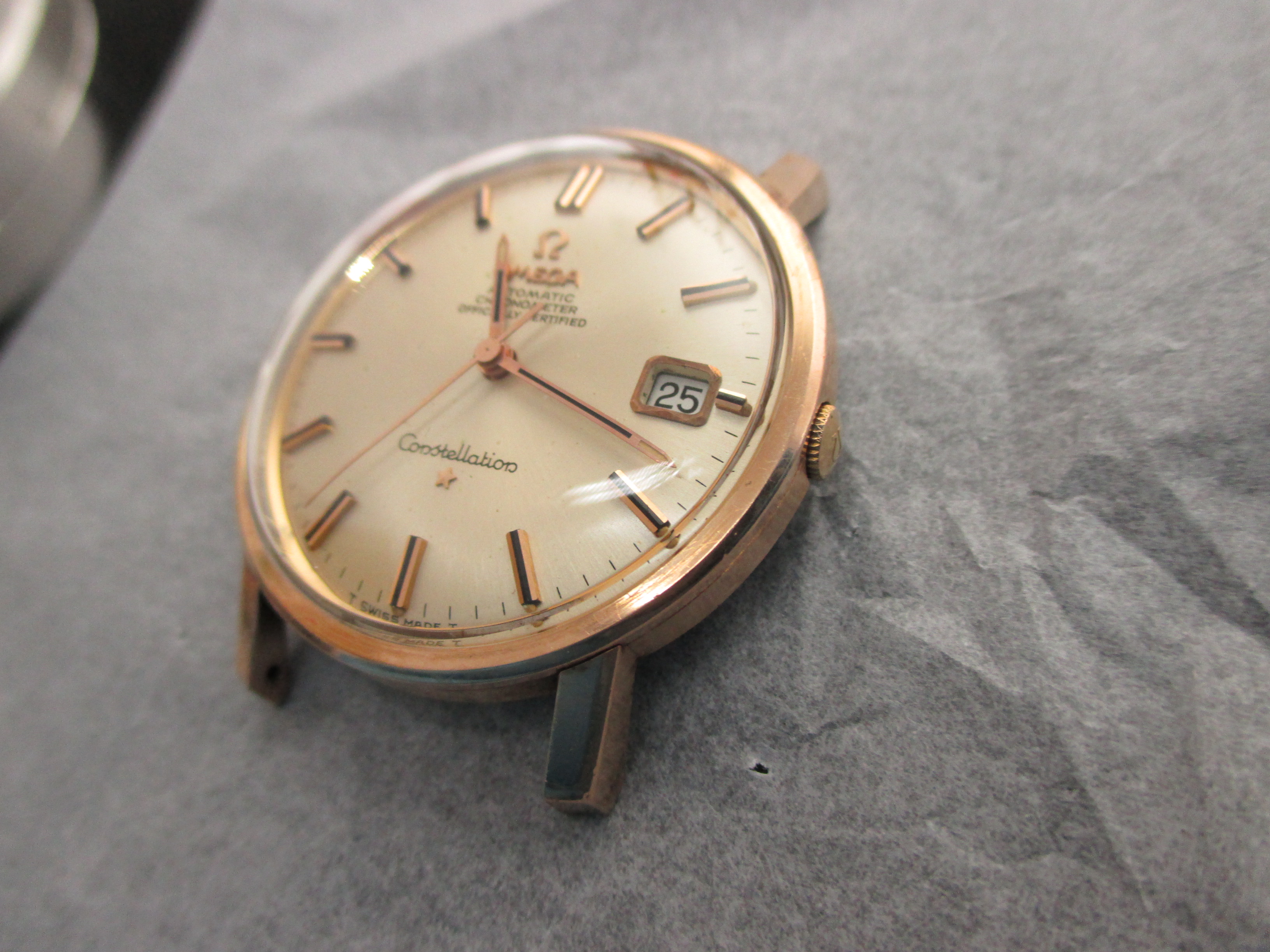

As you noticed the dial has had a failed cleaning attempt that has removed some printing. That coupled with the case which has been unsympathetically buffed makes this one a resounding, ``No``

Yea, that was probably an ok looking watch prior to someone's efforts to improve it

For reference - fonts look correct
But have to agree - case heavily polished - should have nice edge around bezel and near square lugs
Shame - nice ' hidden crown' 18k Connie once upon a time

So the consensus is that it is probably real, just been comprehensively ruined.
Has anyone tried to unpolish a watch? 18K is quite soft, very fine abrasive paper / brass wool might take the shine off.

hmmm -unpolishing a watch might be a bit tricky...😕
it's not that the watch is shiny -it's the fact that it is not all there anymore....😉
18k watches become frequently over-polished -because as you point out they are relatively soft metal
mine isn't solid -only gold cap -but if you look at the edges and lugs, the gold one would have looked something similar originally
hope that helps

OPs watch👎 and buckle is a fake.
What the whole thing Hijak?
I could only blow the dial up so far on my phone but the script looked okay
- you live and learn .... thanks for pointing that out

No whole thing not fake...I was just giving watch a thumbs down and pointing out fake buckle.

Oh good - I misread the emoticon punctuation -glad I'm not too much of a numpty! 😀

I was thinking along the line of gently abrading the tops of the lugs. It would reduce the overall depth a tiny bit but restore an edge. Cheat in other words.
Anyway, here is another. Strange crown but better dial and an original signed crystal. Maybe? And it has the 1 over the calibre so must be first quality as well!
http://www.ebay.co.uk/itm/mens-omeg...50-solid-gold-pie-pan-dial-watch/221916333852
I am after an solid 18k pie pan - hence the interest.

I think we would all like an 18K Connie!
I'm on the hunt for one myself....
The market price at auction -for a decent one - runs at around 1500-2000 Euro
From a collector a bit more
from a retail shop -double
The one you posted appears to have a decent dial
you correctly identified that the crown is wrong -the 168.010 should be 'hidden'
case is polished but not as bad as the other one
there does appear to a problem with the movement though
there are multiple colours to the different parts -this could be just the photo -or it could be that a number of parts have been replaced (not a good sign)
However, if you look at the rotor you will see a 'rubbed line' on the high point
this is replicated as a circular line on the case back -the rotor shouldn't come into contact with the case back
-not sure how bad this is but it would need attention -which can add significantly to your service cost
FYI -Gold based Connies are a 'speciality' in themselves due to the fact that (because of import tax on gold -and possibly other precious metals) gold cases were produced in a number of the countries of sale rather than just Switzerland
Including: UK, US, South America, France
Movements and dials were shipped and installed in the locally produced cases -which varied in quality
Fastidious collectors want one that left the Omega works as a complete watch
-so you have to know what you are looking for -often identifying them by the hall marks inside the case back

Indeed it is a bit of a mess. Also, I do not know if it is deliberate, but the actual movement number is obscured / unreadable. A bitsa?
Even paying mega money is no guarantee.
http://www.sonningvintagewatches.co...ga-constellation-pie-pan-gents-vintage-watch/
£3700 and the pivot bridge (?) is unoriginal and without the constellation script!
