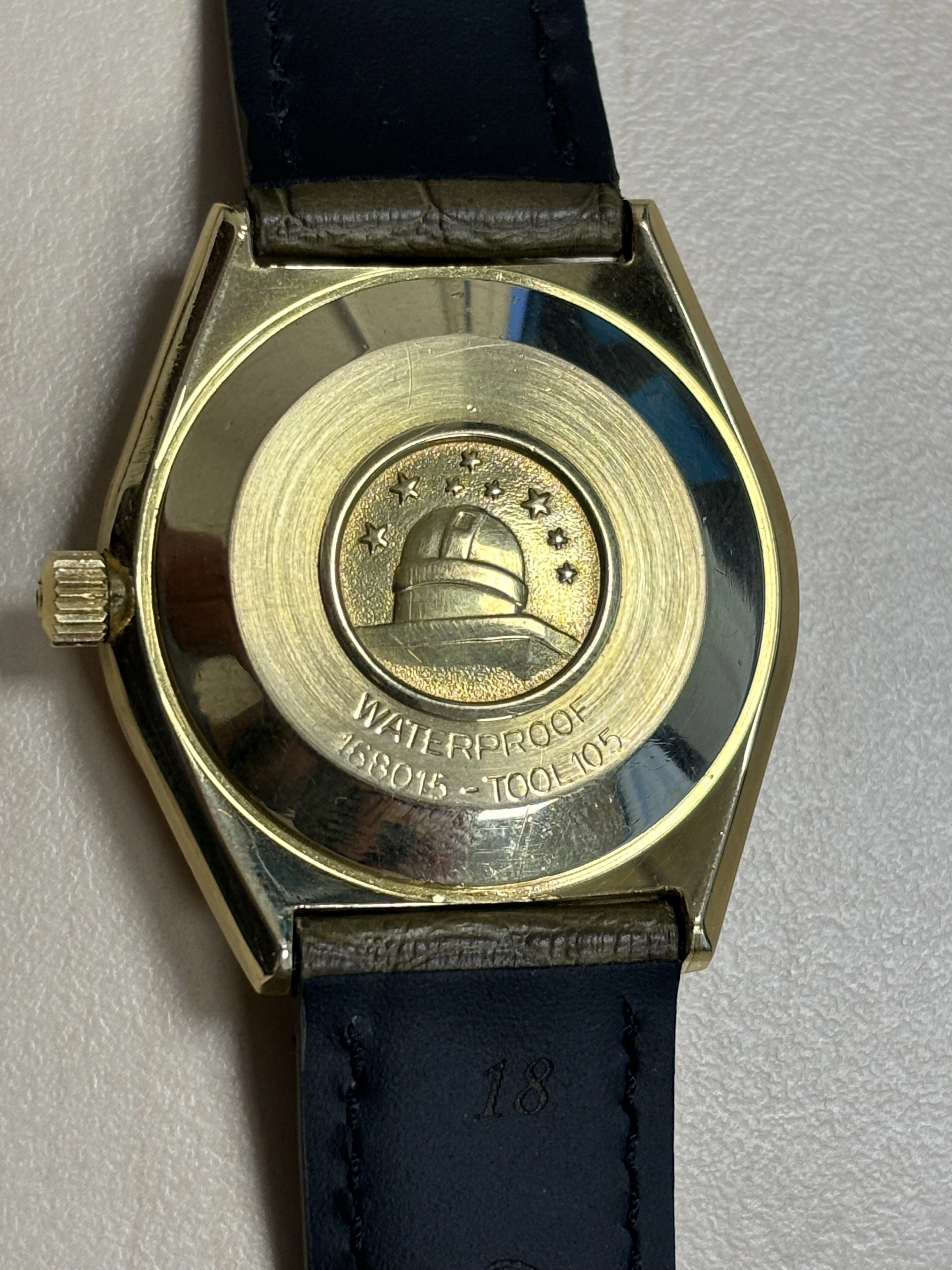

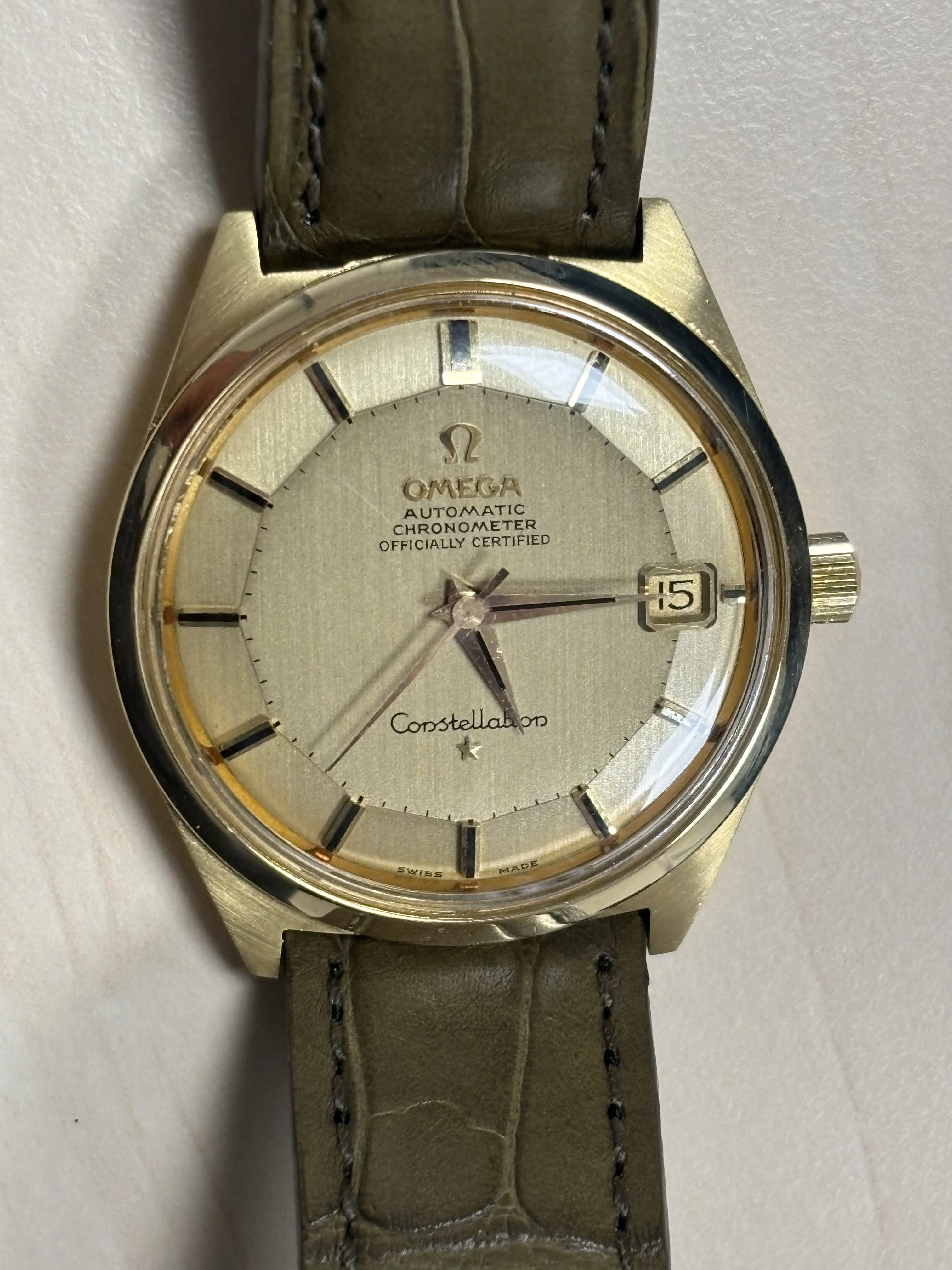

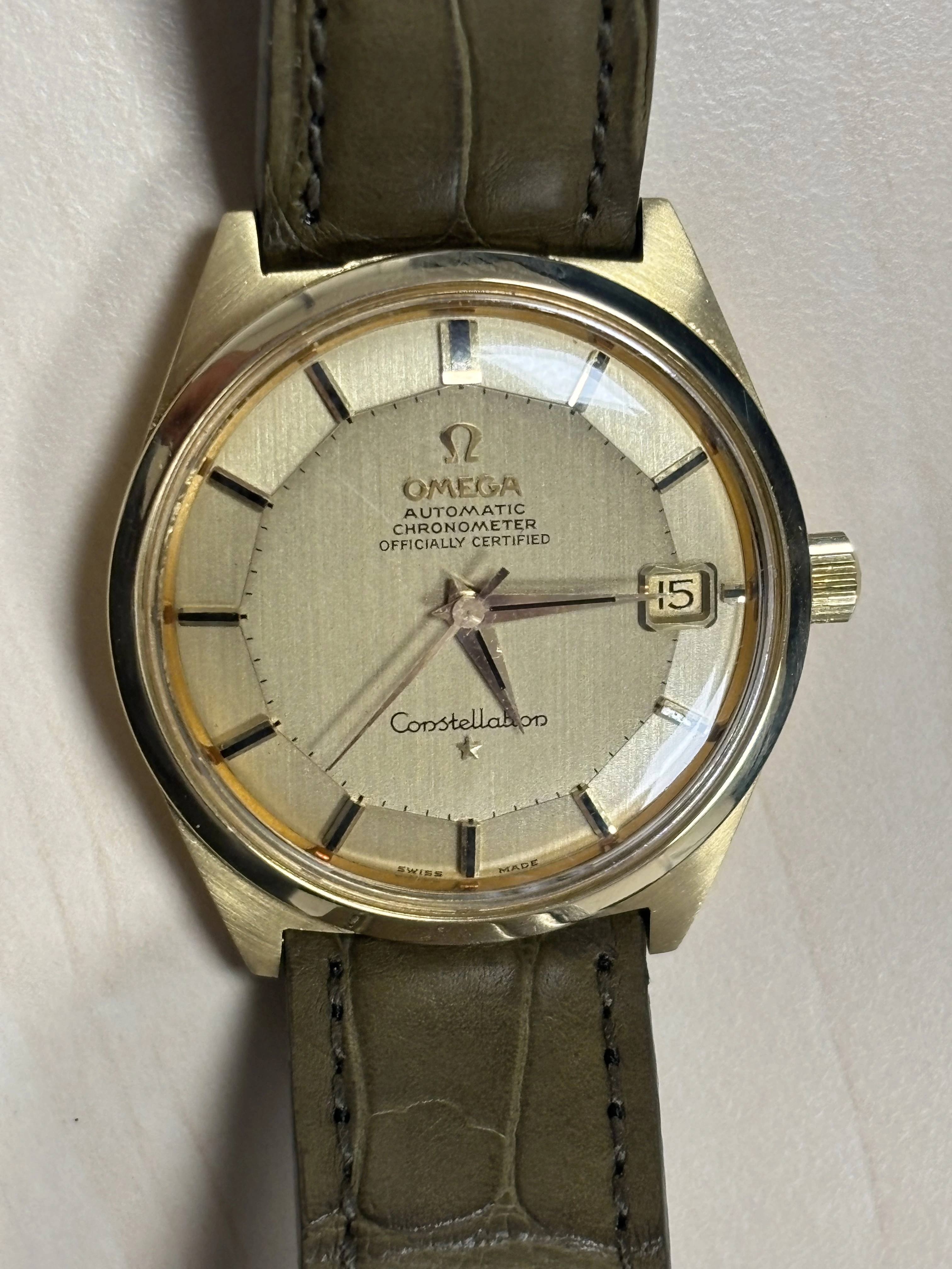

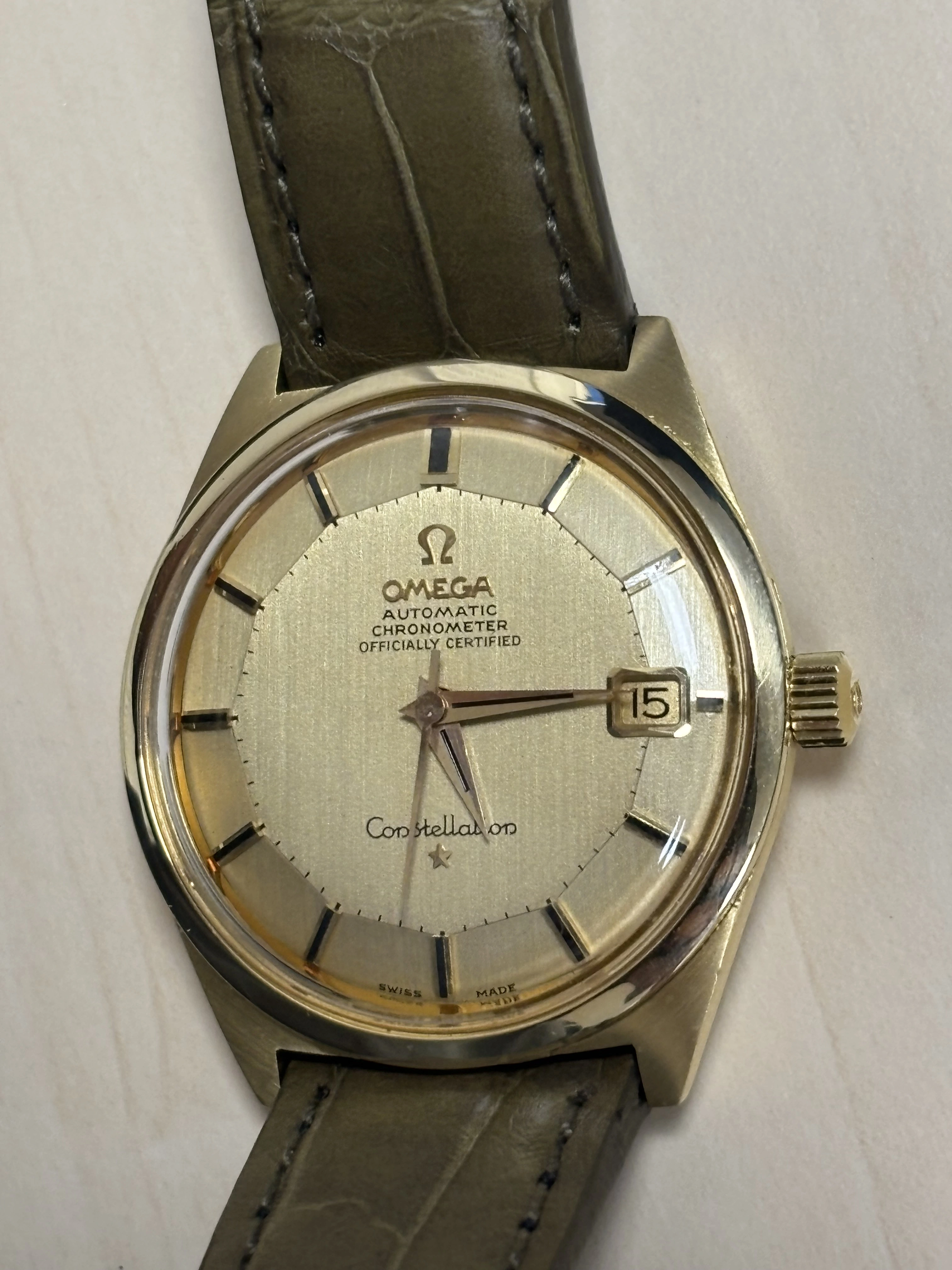

Hello everyone,
I would like to ask for your opinion regarding the legitimacy and originality of an Omega Constellation ref. 168.015 I recently acquired.
This configuration could be a transitional one.

Additional information: based on the serial numbers, the watch dates to 1968.

Looks good.
Thank you Dan for your response. I’m asking because I can’t find any reference to a 168.015 with a pie-pan dial. The year of manufacture 1968 may suggest a transitional model.

Well, the other option is that it is a transplanted dial from a 168.025. Have you actually seen the inside of the case? Or are you trusting the seller's word for it?

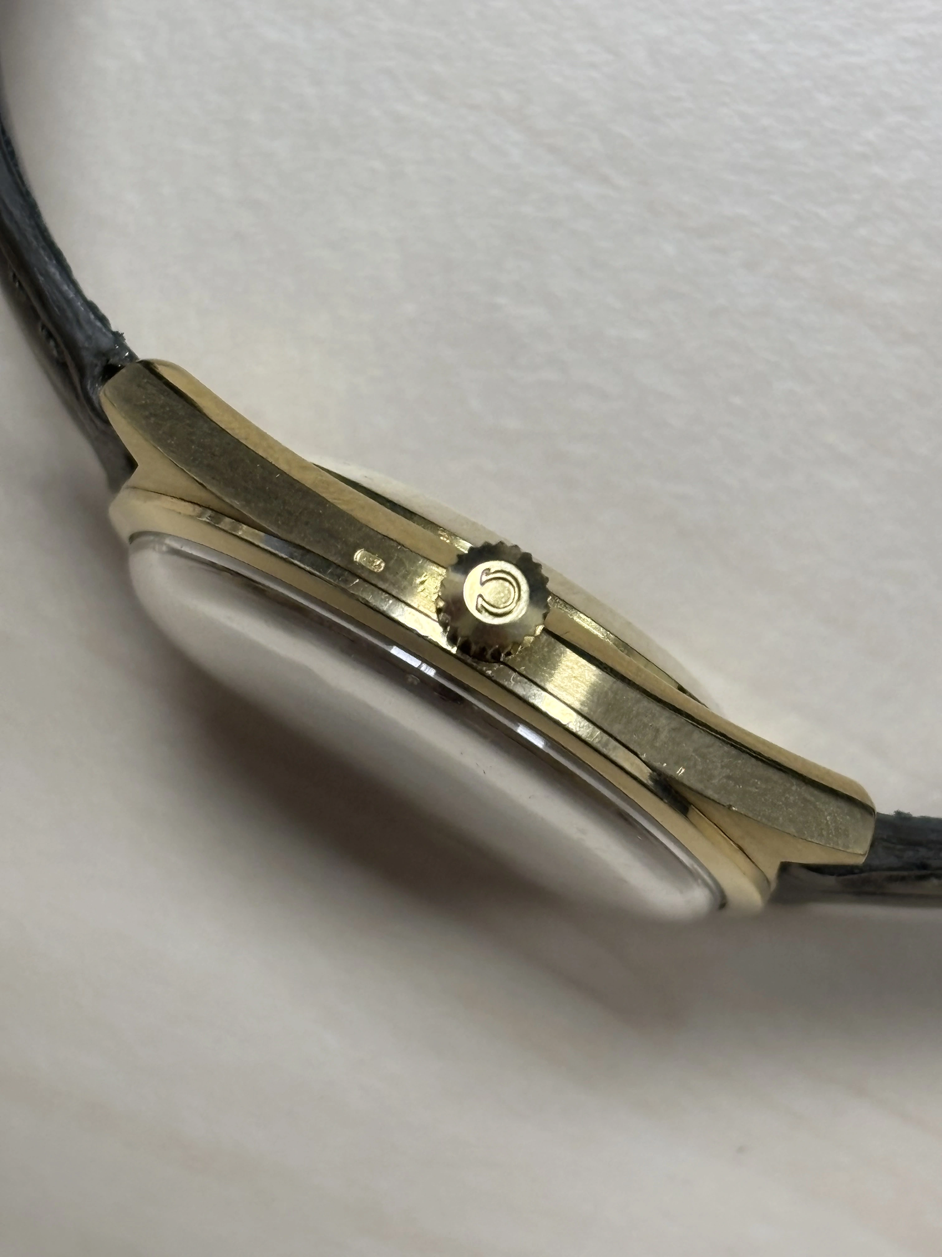

Hello @benoit13_34
I'm sure you (or the seller) meant 168.025 ? (the pie pan version rather than dome dial version)
I'm more concerned by the lack of bevels on the case. (I thought that was what you were referring to when you mentioned 'transitional')
Although I don't know how you remove enough gold to create the sharp case edges while retaining the hallmark.

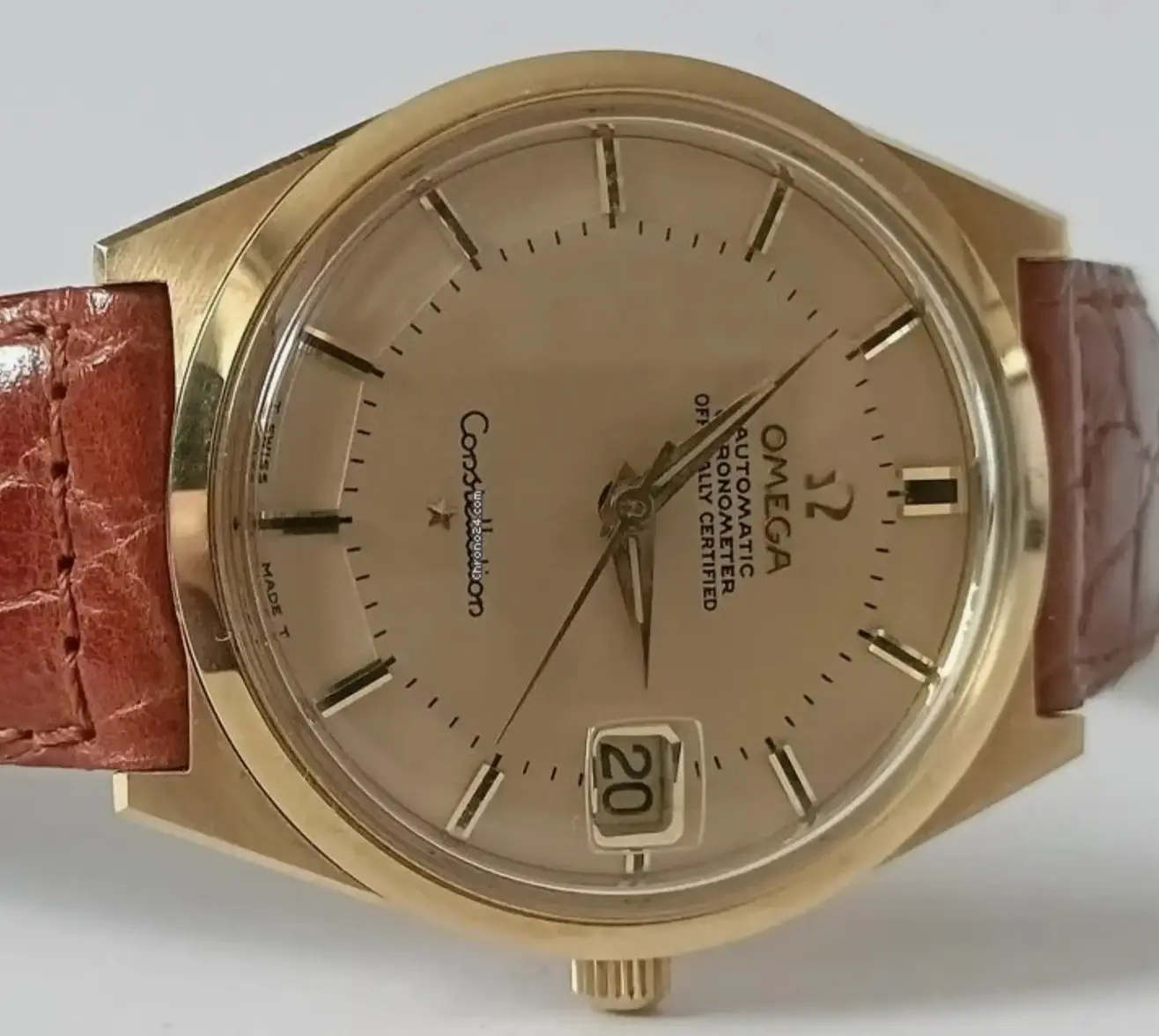

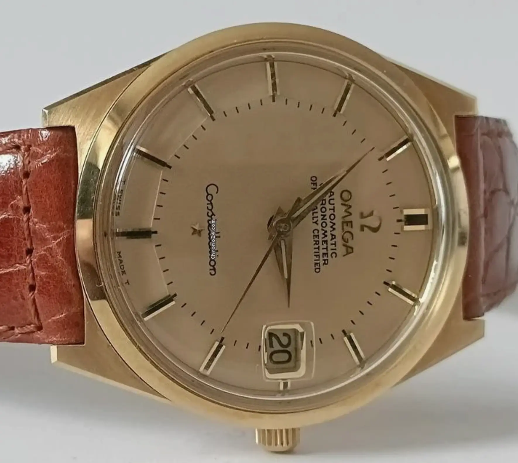

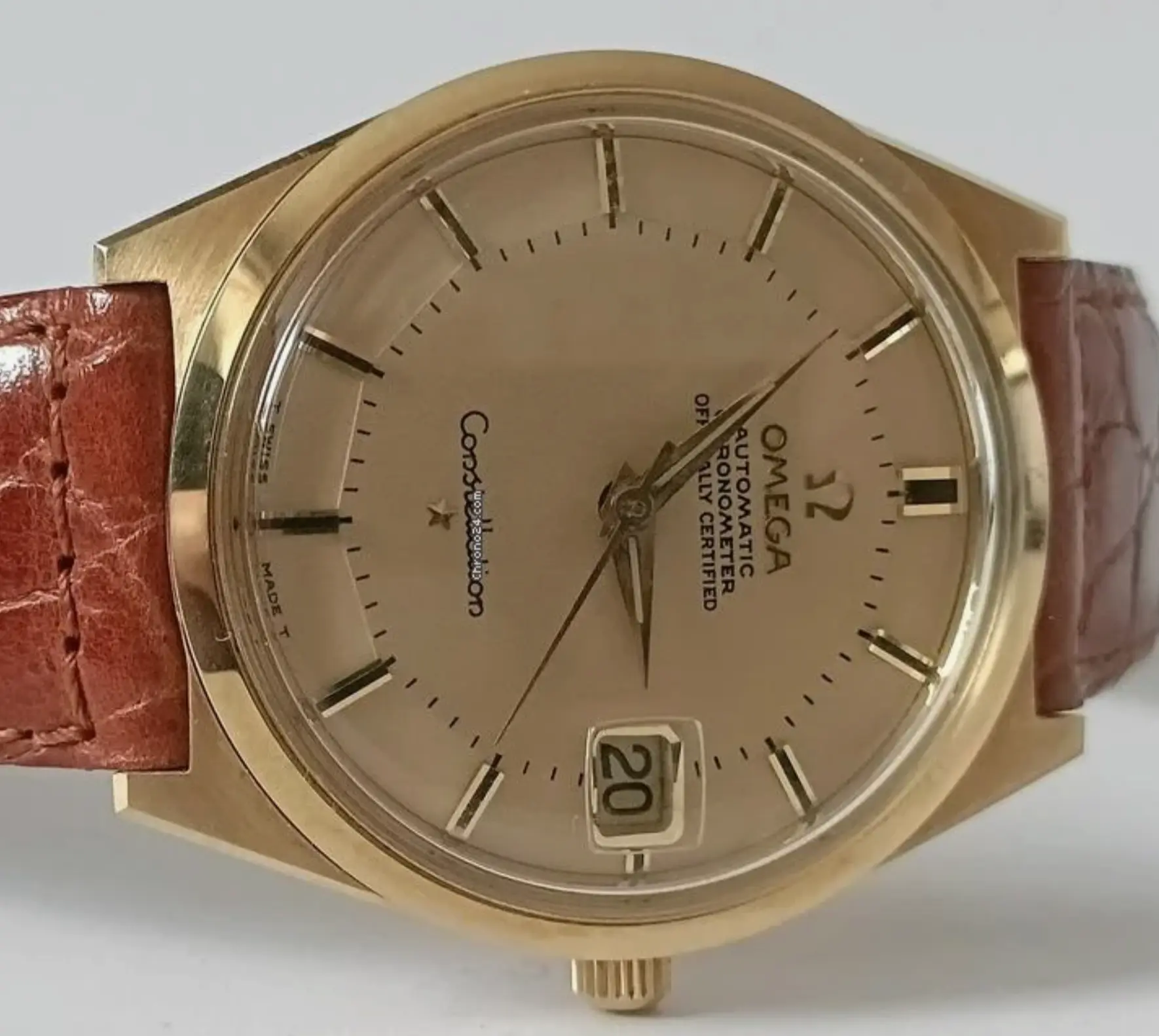

Here is a near identical 168.025 (rom C24) and you can see the sharp bevels on the case edges, that hey are know to have.

The case says 168.015 on the back, which is where I'm sure he's getting it from. And it is a front-loader (tool 105), and appears to be a monocoque case, so it is very clearly a 168.015 (at least as far as I can tell... that is VERY clearly a 1 in that picture, yes?).

you're absolutely correct. 👍
I was so busy looking at the case that I didn't read what was right in front of me. 🤦
The comment about the edge facets still stands. - and IMHO the dial has been transplanted from a 168.025 because the pie-pan is a more desirable / valuable watch.
If I was @benoit13_34 I would consider returning the watch, depending on how it was described by the seller of course.

Thank you for your replies. I confirm that the watch is engraved 168.015 and is a monocoque model, which is why I cannot open it myself. I relied on the seller, who is known to be reliable, but he maintains that everything is fine inside and that it would need to be sent to Omega to Check.

Any watchmaker with the Omega tool can pull the movement out. Heck, you can get said tool on Ebay (I even have one, and I'm far from a watchmaker! 😁).
If @Peemacgee says the .015 was never available as a pie-pan, he's correct. So the dial at least is incorrect for this watch. Not sure you can trust the seller if they can overlook something that serious.

Yes, I agree with you. But before going back to the seller, I would like to make sure that, given the year (1968), this is not a factory transition between a 168.015 and a 168.025.
Otherwise, how can one determine that it is an assembled (put-together) watch?
I trust my dealer, and in any case he will support me throughout the process.

See this article: https://stories.omegaforums.net/constellation-monocoque-piepan/
My read of that article:
The 168.015 was date-dome-dial verison.
167.015 was the no-date dome-dial-version.
168.025 was the pie-pan.
167.025 was the no-date pie-pan version.
I don't see any evidence that any 'transitional' models existed based on the research done in that article (nor from @Peemacgee) So it is an assembled-watch, since it is a .015 with a pie-pan dial.
However, the movement would be otherwise identical between the 015 and 025 of the versions, so I suspect you can say that the movement at least is 'correct'.
So either yours is a never-seen-before-authentic combination, or someone replaced the dial at one point in its history. If I were a betting man, I'd take the former every time 😀

Thank you all for your replies. I think I’ve convinced myself. 😂
I’m going to go back to the shop.

The question about an uncommon or transitional variant is always interesting for collectors. Sometimes, with the accumulation of research over time, it is true that the conventional wisdom gradually changes. I've seen many examples of this, where watches thought to be incorrect were later accepted as correct. Unfortunately, even in cases like this, the conventional wisdom can be slow to change, often because people continue to use the standard reference websites that aren't updated to reflect new knowledge. I have a bit of a pet peeve where people take information on websites too literally, e.g. serial number ranges.
However, at the moment, this watch is believed to be incorrect, and at best would be a "watch with a story," so it would certainly impact the value.

This is an excerpt from the table on Desmond's site.
It shows the ref 168.015 being first released in 1966 but unusually it has a duplicate entry for 1967 specifying a flat dial, alongside the 168.025 specifying a pie pan dial.
However, with these tables, the 'first release' date is often in advance of actually being available.
There are many Constellation cases with dual references (e.g for deluxe versions) however, until this reference Omega didn't differentiate between dial types with different reference numbers (only complication types.
Unless there is concrete evidence that (for some unknown reason) Omega fitted flat dials and pie pans dials in the original 168.015 case reference before releasing a separate case reference for pie pan dials then we have to assume it is a 'frankenwatch',
Only an extract might answer that question. (which isn't currently available)
However, we have seen time and time again that Omega did peculiar things- especially around this time frame.

ask him about the case facets as well - unless he says the case is also transitional.

Franken or not, I think it is a lovely watch that I'd enjoy having in my collection. However, barring pretty-darn positive evidence that it truly IS a transitional model (and not one that someone swapped dials into later), I'd expect to pay significantly less than a pie-pan goes for, and probably less than a .015 (though... given its pie-pan-ness, perhaps a touch over?).
That said, I don't think we know for SURE it isn't original, but without documentation to that effect, I'd say we have to treat it as a franken.
