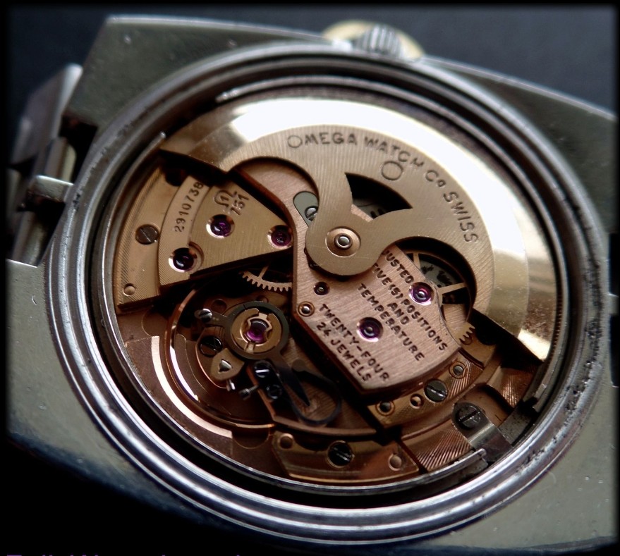

That's what I was told by a long term dealer - "I was told it was the height of the hands above the dial. 1 signifies the height of the crystal required."
Then again it was the same chap who ripped me off big time a couple of weeks later!
Attached image of 751 also with 1 above it .
