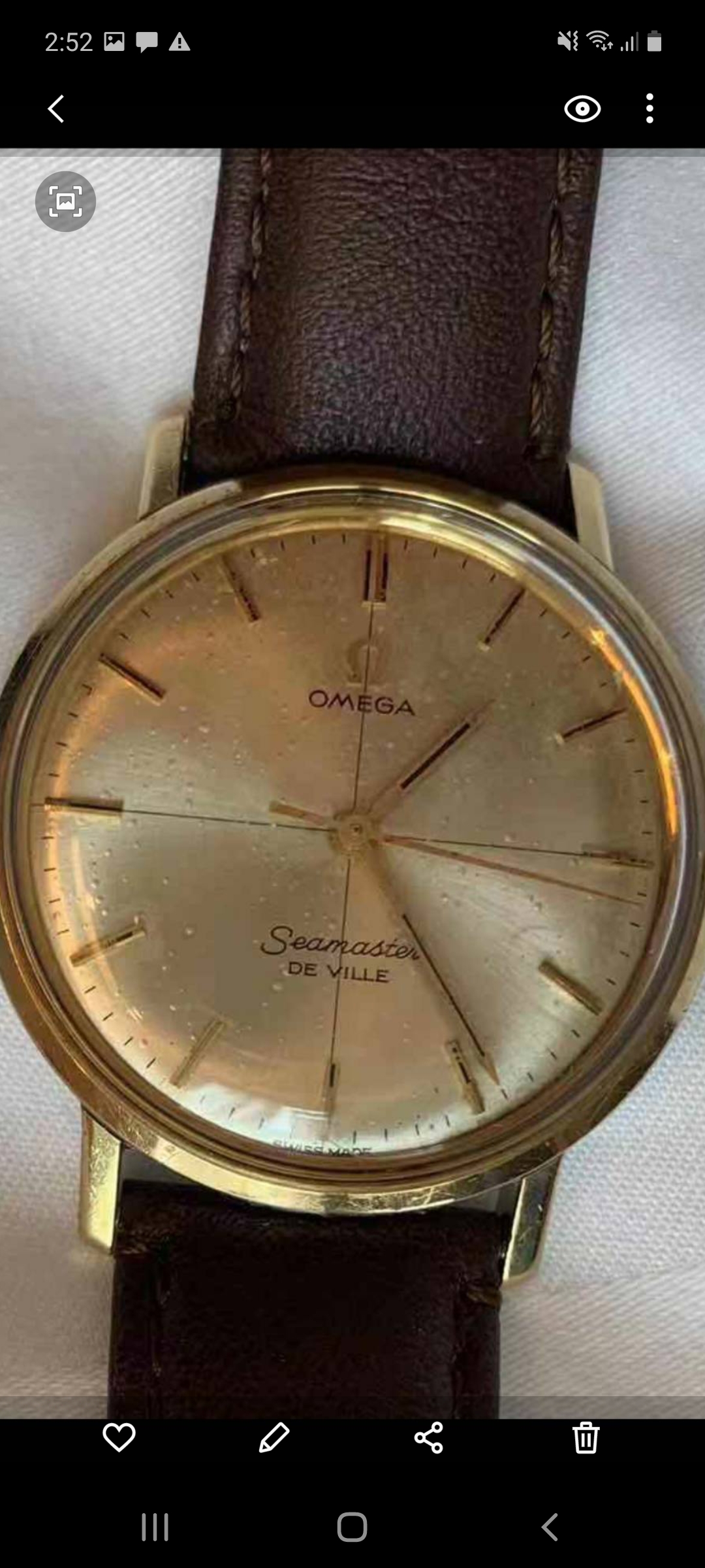

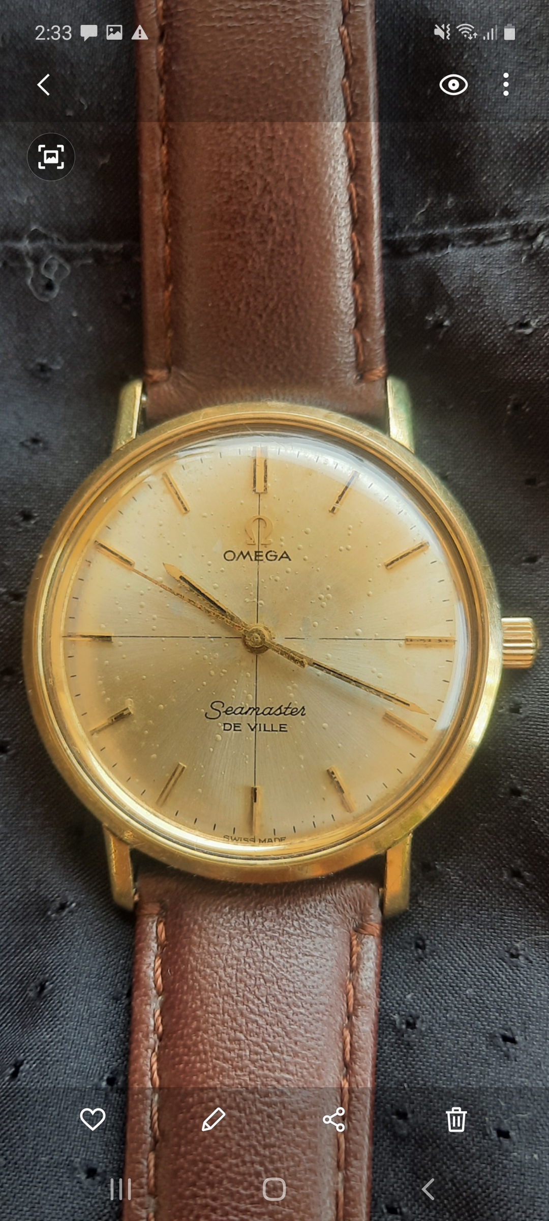

I have a gold plated Deville, which i believe to be a 135.020. It belonged to a friend of my fathers in Hong Kong. The watch hadnt worked in decades. For a cheaper priced repair, I took it to Bangkok. I have included an image of the service and repair description, mostly in Thai. Due to the travel restrictions, I am still here and the watch has been sitting in a drawer. I got it out a few days ago. Admittedly i didnt pay much attention to it, when picking up from repair. Now, after giving it a wind etc. I have a few questions. I hope forum members might be able to help with.
The watch winding feels very tight. Tighter than the few other seamasters ive wound. And only allows for 14 winds max. Is this anything to worry about or unsual?
How long should this watch run for after full wind?
I understand this movement to be manual. But when the watch is fully stopped. When give it a mild shake, it starts ticking. Whats going on?

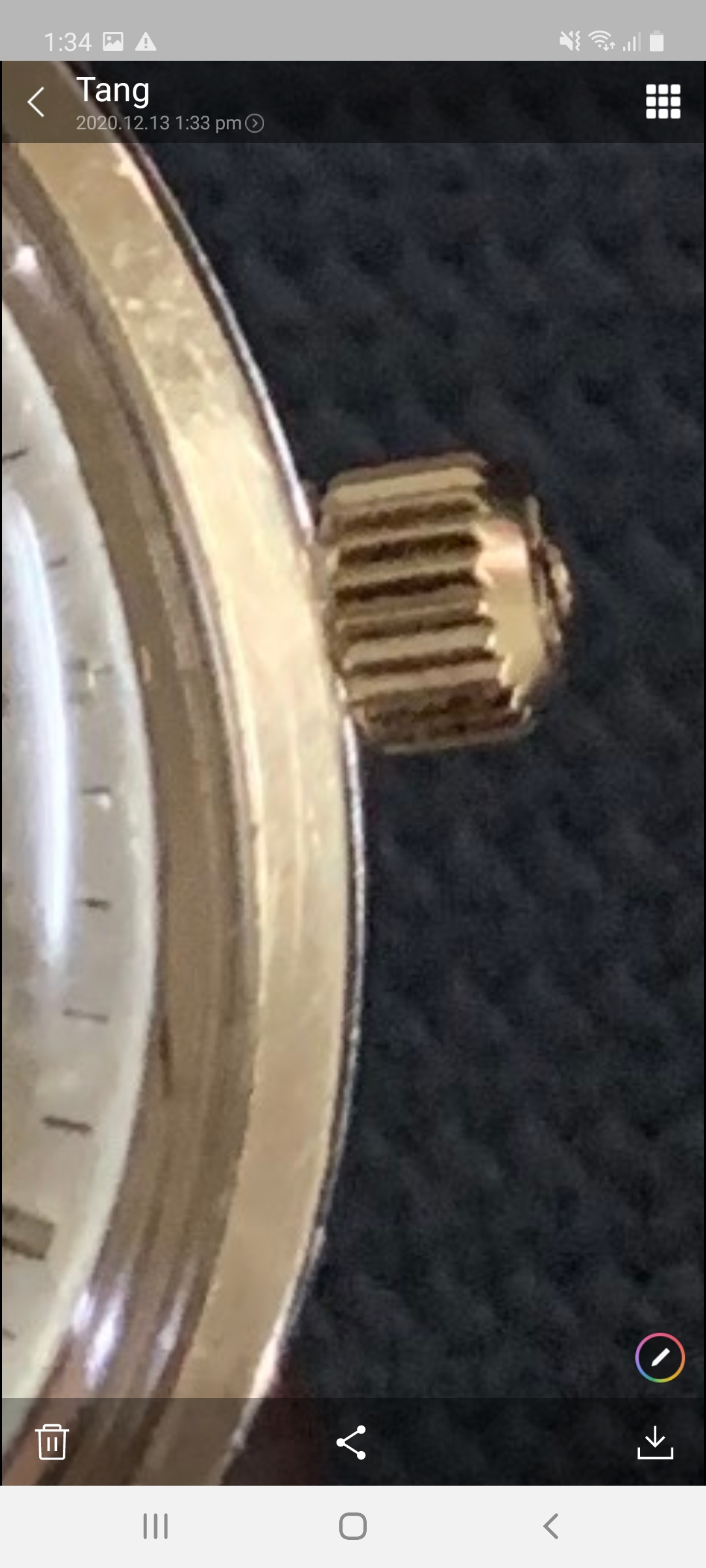

Also any comments or 20 cents on anything you may notice re the crown etc. Even narky comments hahaha Thanks to anyone who helps. Ps I gave myself an uppercut for not getting a decent inside caseback image
