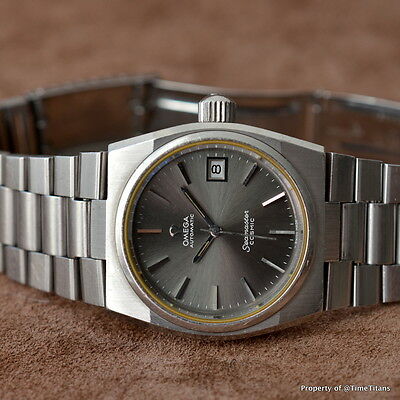

There are other watches with no lugs such as Omega Dynamic where bracelet is part of the case surround. Not sure if your example is similar design or not

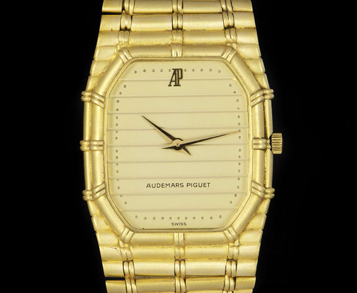

Used to be relatively common on high end brands like PP, AP and Breguet (gold watches). Not so common today.

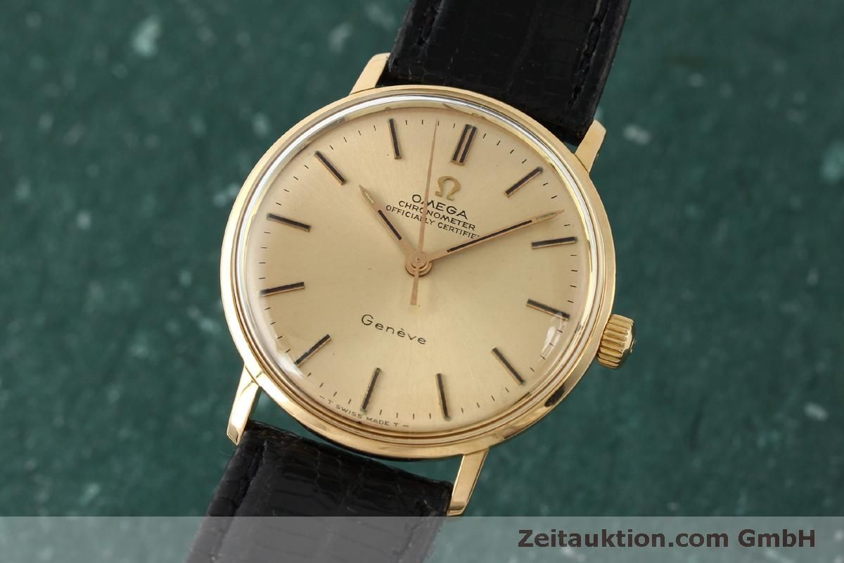

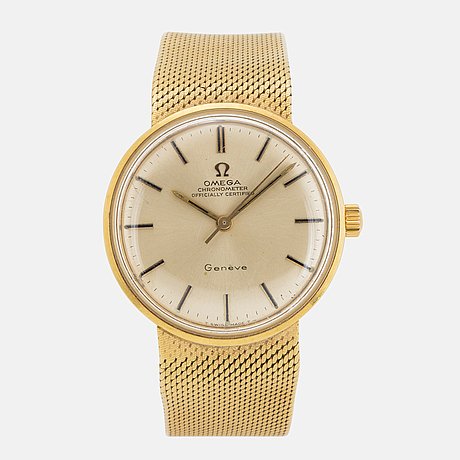

But it seems like there is a clasp to disconnect the braclet from the case. I think this didn't possible with the Geneve above
1,561
3,672
It was a quick example only. There are many others

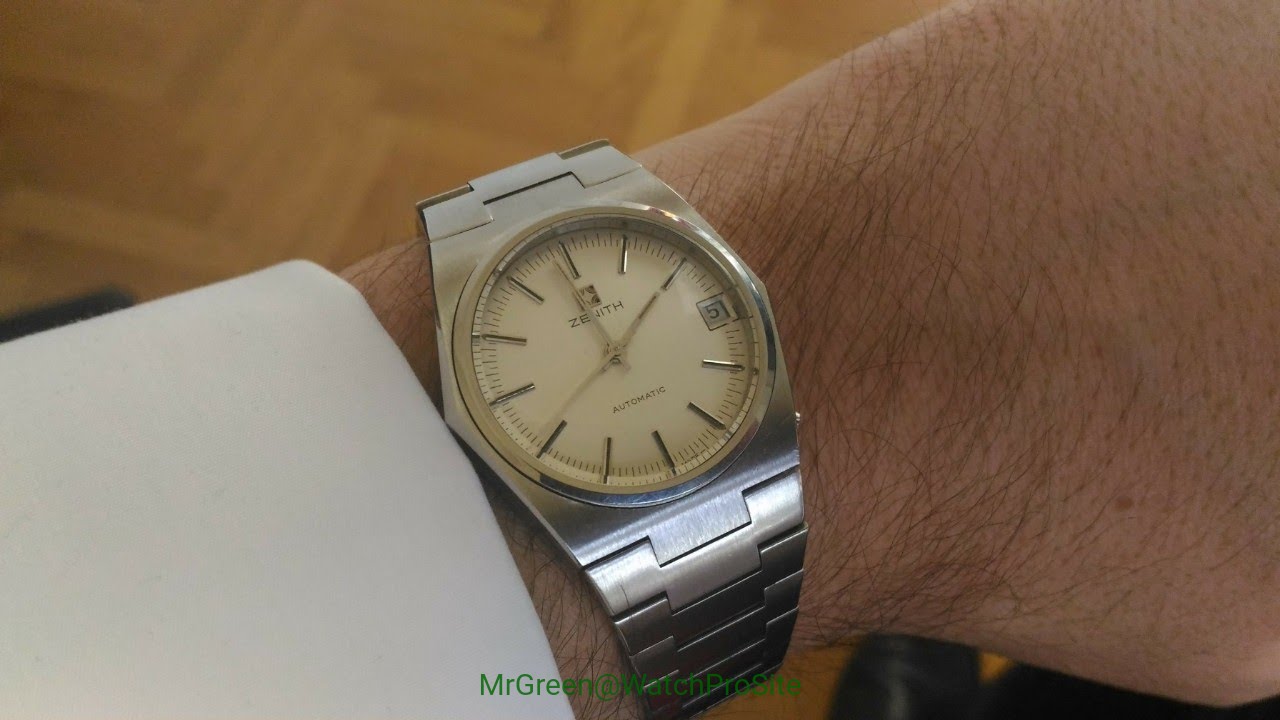

I have a Rolex in a similar style with an integrated bracelet like that. It was a common style for dress watches in the 70s and 80s. As lindo mentioned, any alterations to the bracelet are permanent.

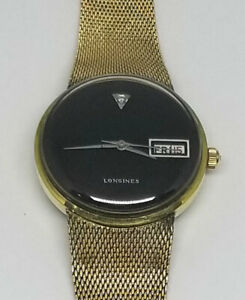

OPs watch is pretty uncommon (IIRC 4000 made) being a caliber 602 hand wind chronometer, so finding one cataloged exactly like it is probably not going to happen. Here are some similar examples with fully integrated bracelets.
