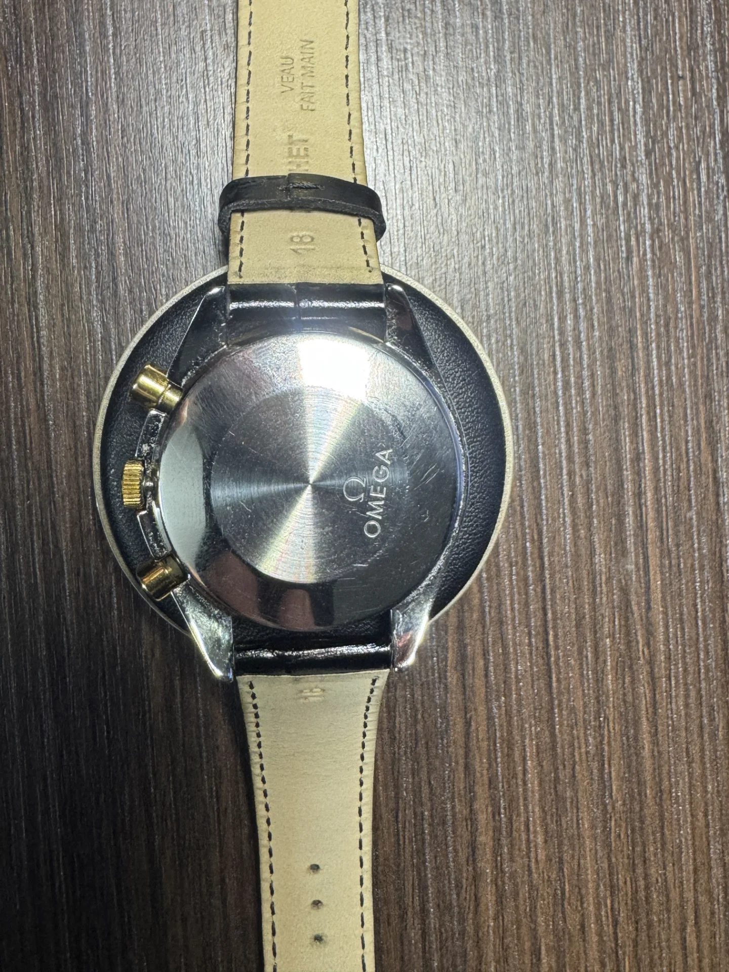

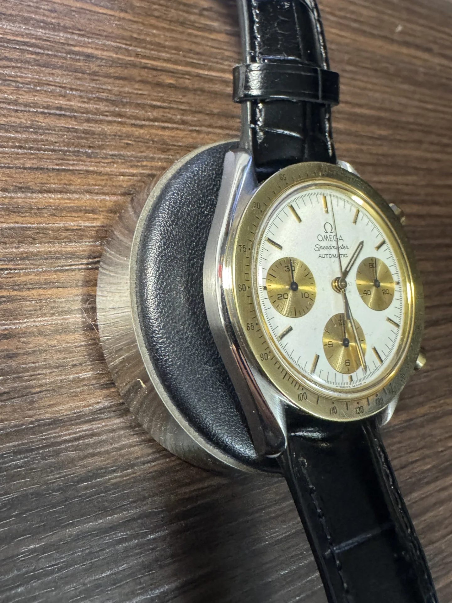

I recently purchased an Omega Speed Master Reduced steel/gold in Japan reference DA 175 0032.
Caliber 1140.
I know that the first series from 1989... reference 175.0032 has a flat steel caseback with the writing omega, OK.
My doubt is about the strap with which this watch was born: leather or steel?
In any case I will have to change the strap and the buckle to make it "original", so I ask for help on which is the factory strap or bracelet.

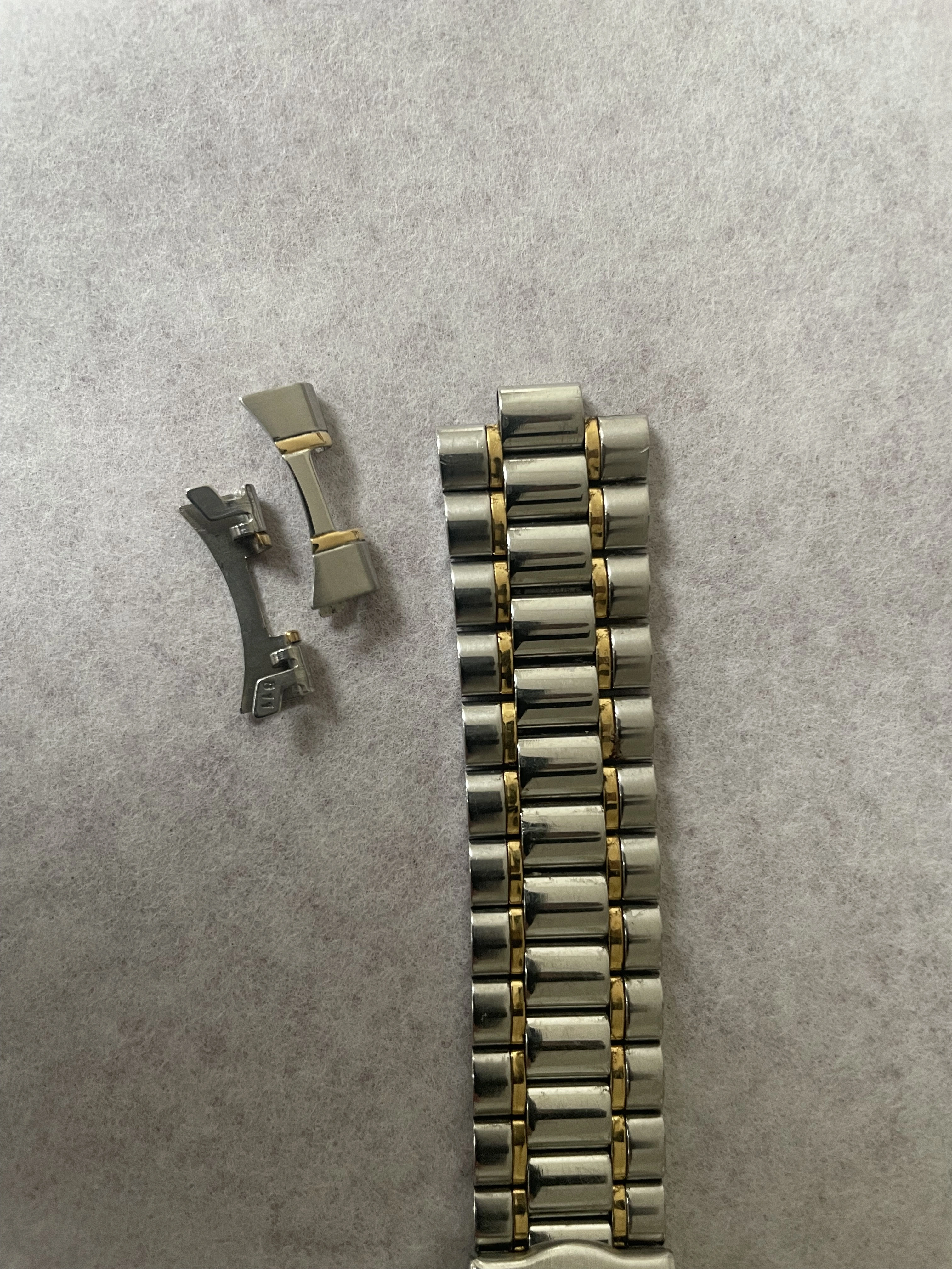

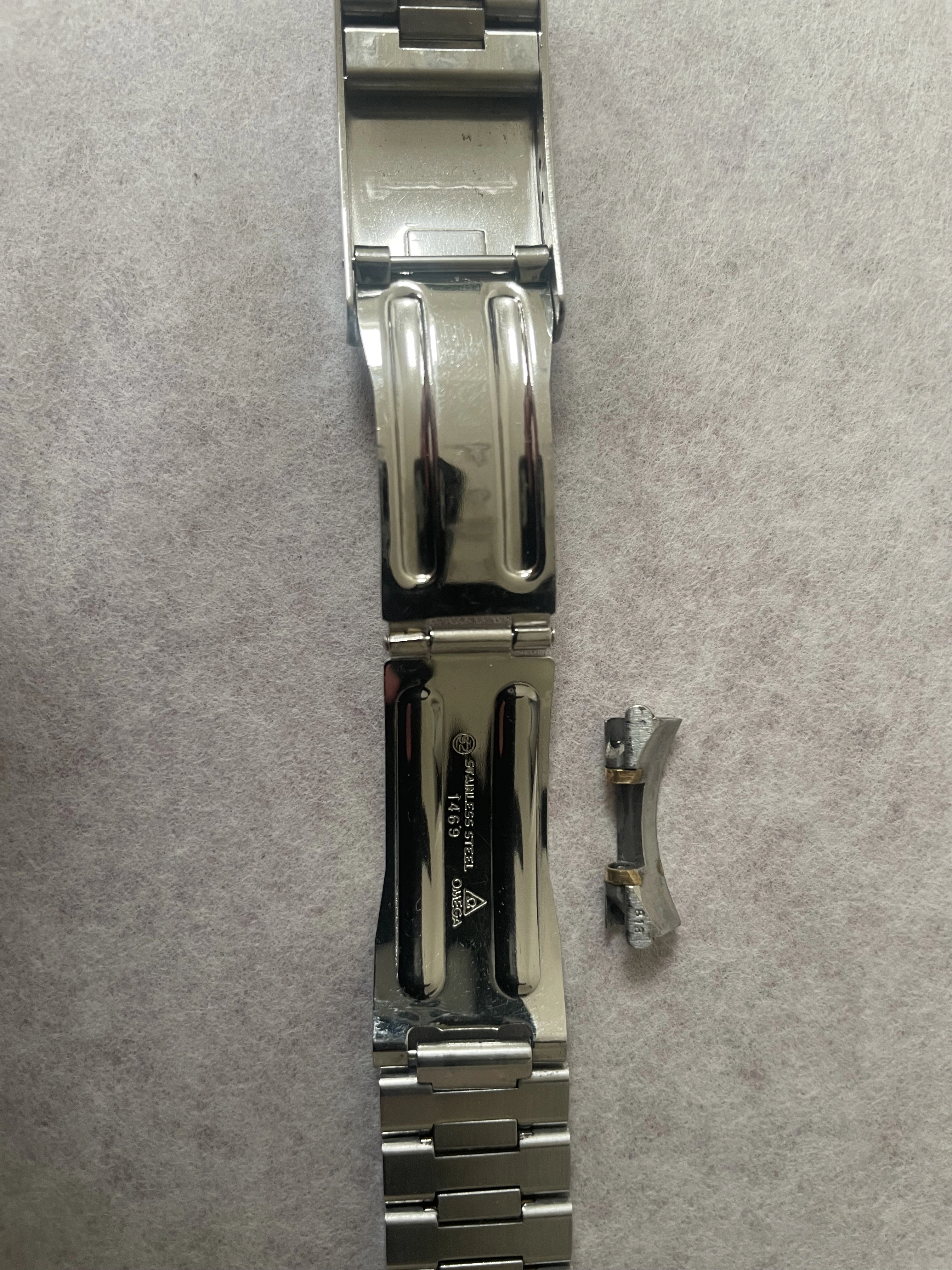

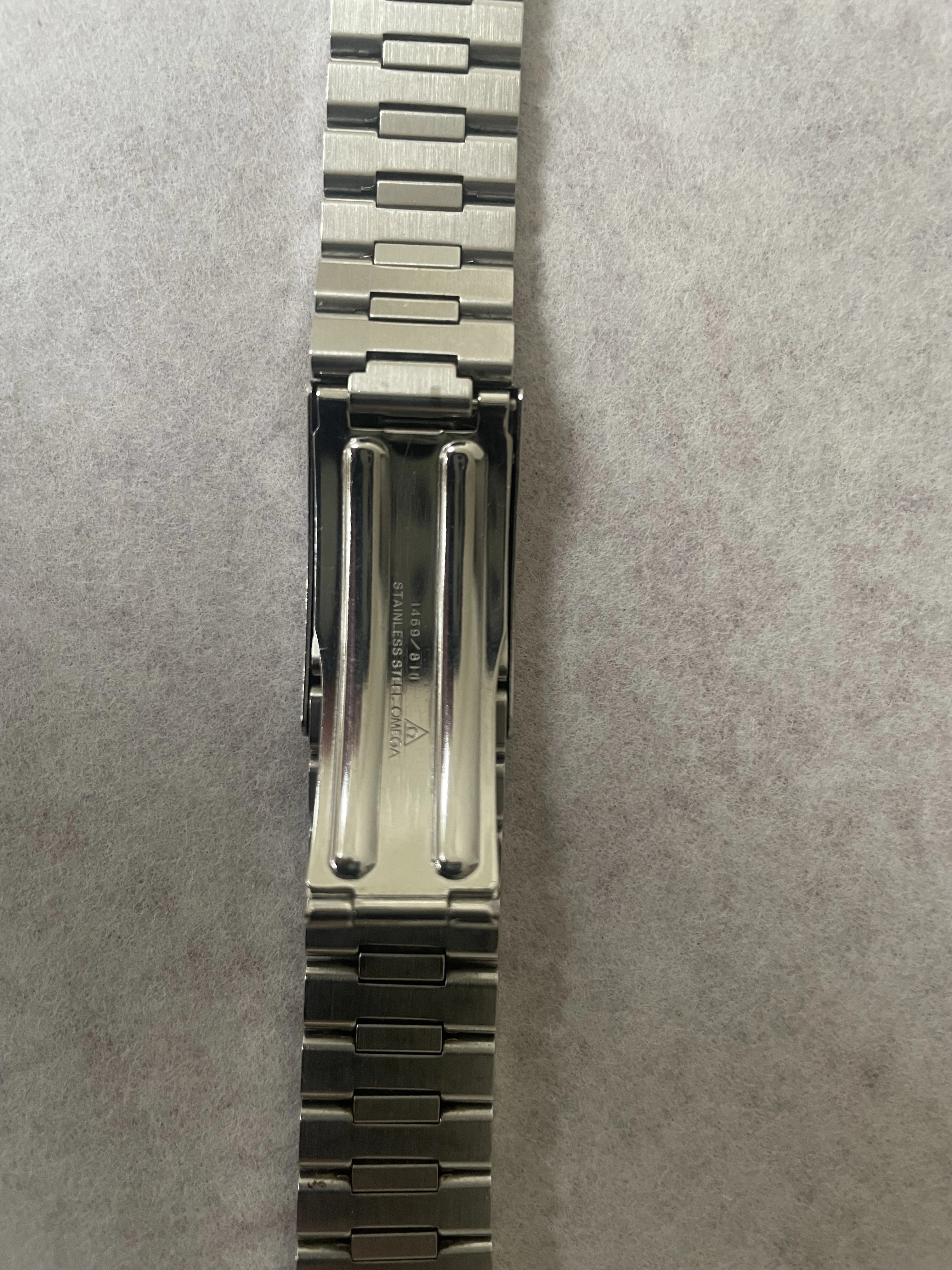

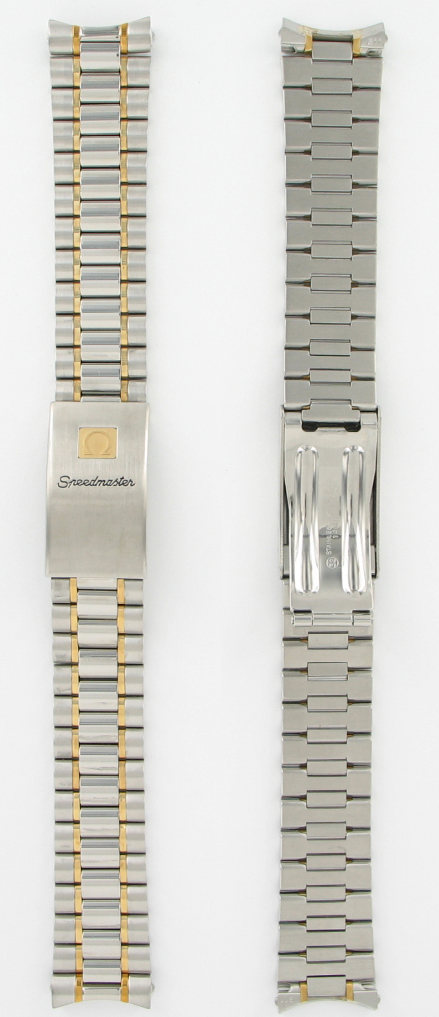

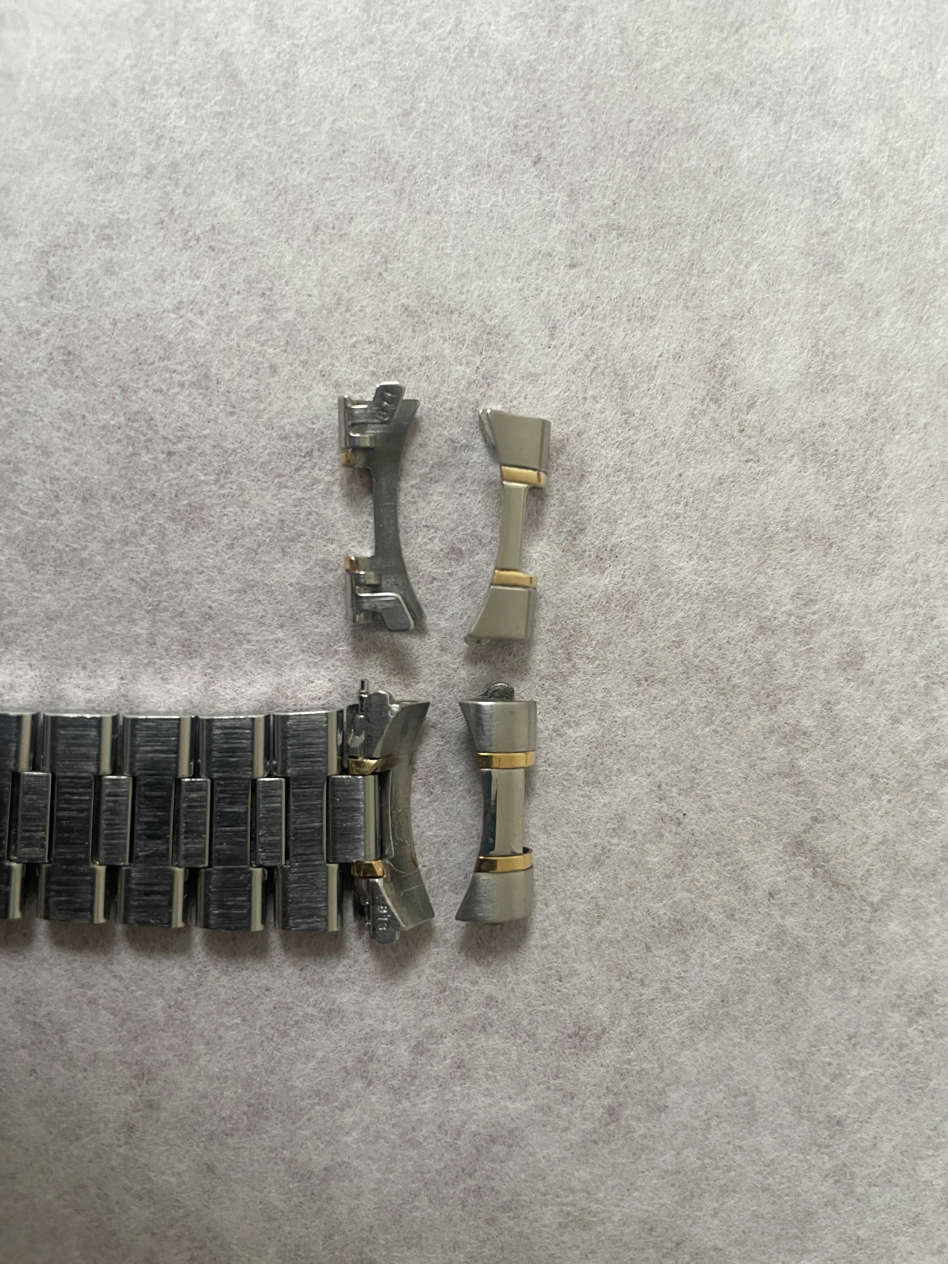

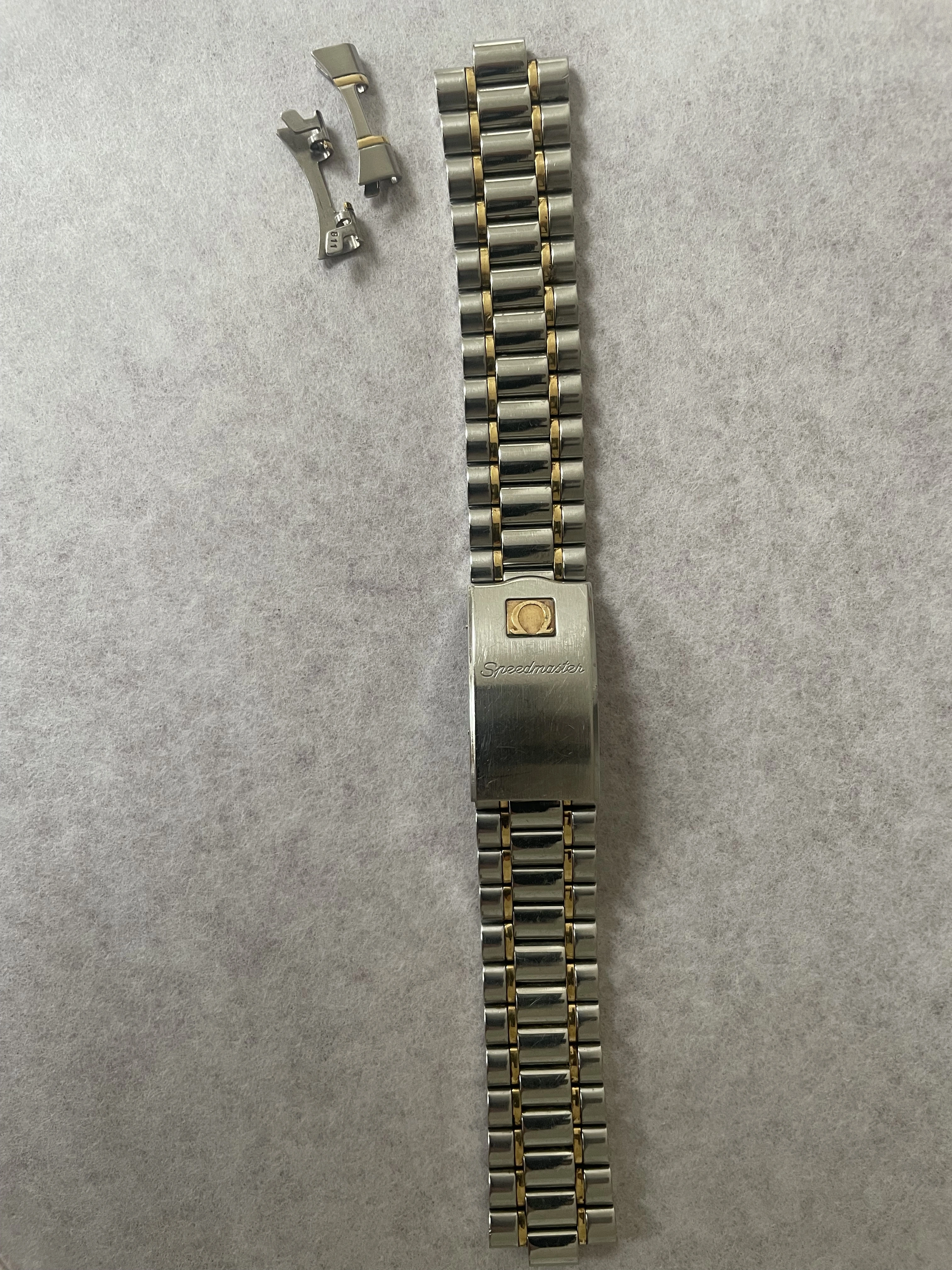

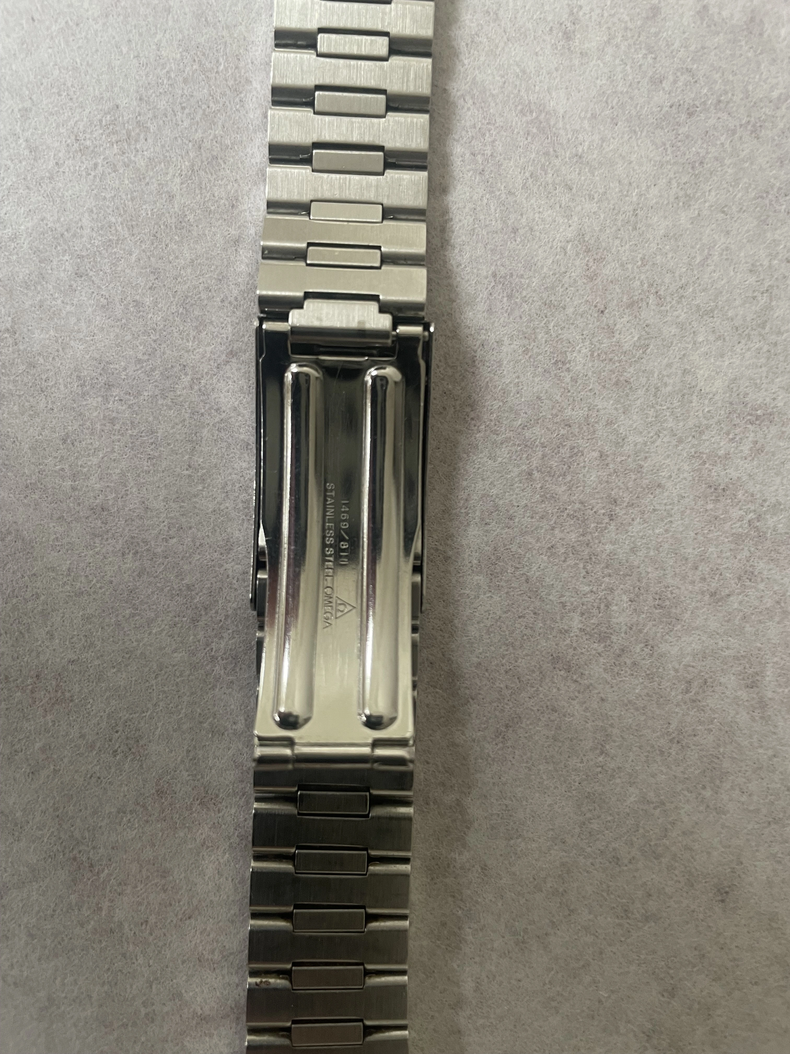

Hi, welcome to the forum. I believe this is a 175.0033 as opposed to a 175.0032 (the inside of the caseback most likely references both watch case numbness). I expect that this watch may have had a leather strap option but most would have come with a 1469/811 bicolour bracelet/ endlink combination. A newer 1469 bracelet with 813 endlinks would also fit the watch. I’ll post pictures of both options.
911
1,725

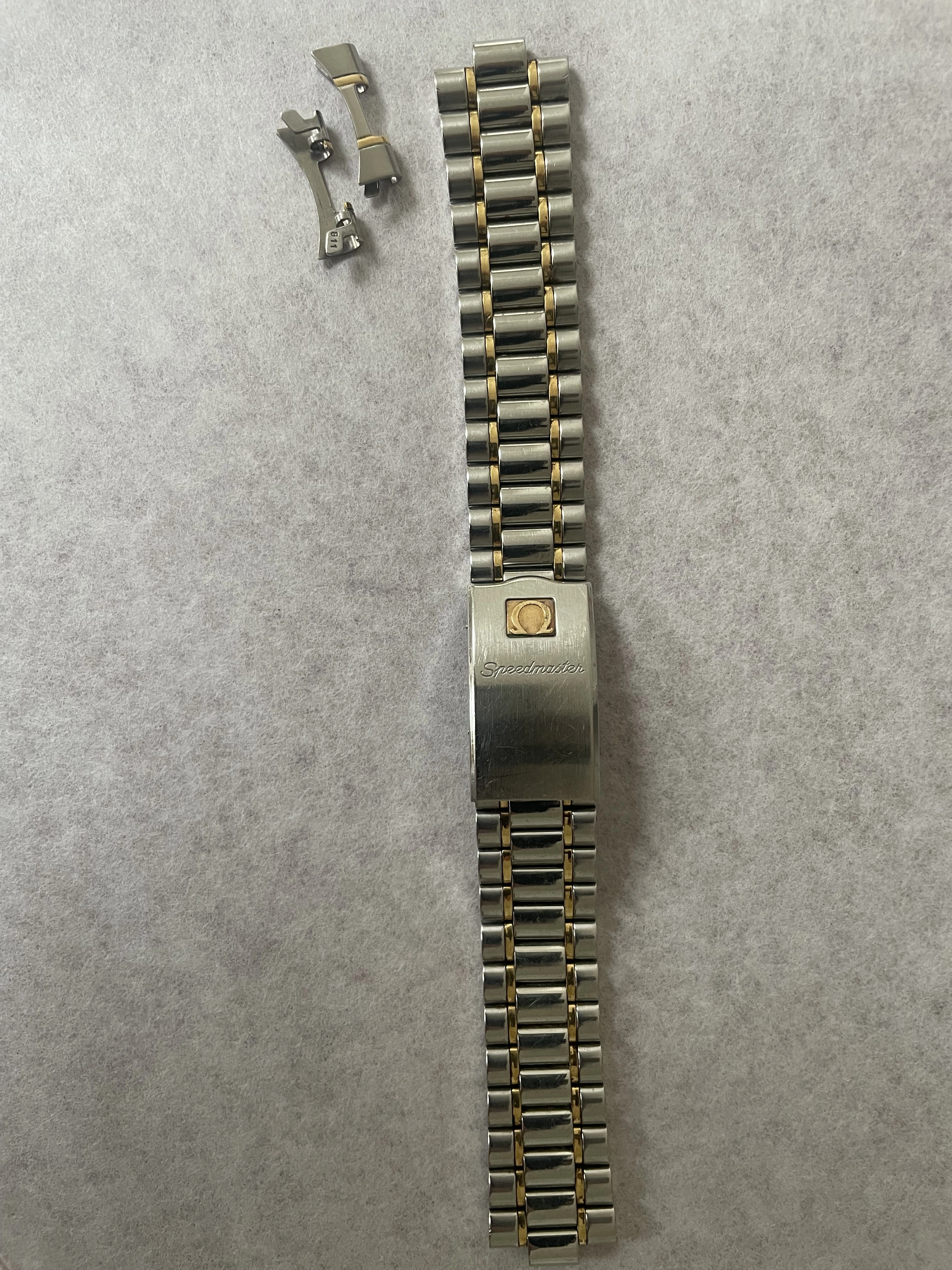

Pictures of both the 1469/811 and 1469/813 combinations. The final picture shows the different endlink profiles but these are interchangeable.

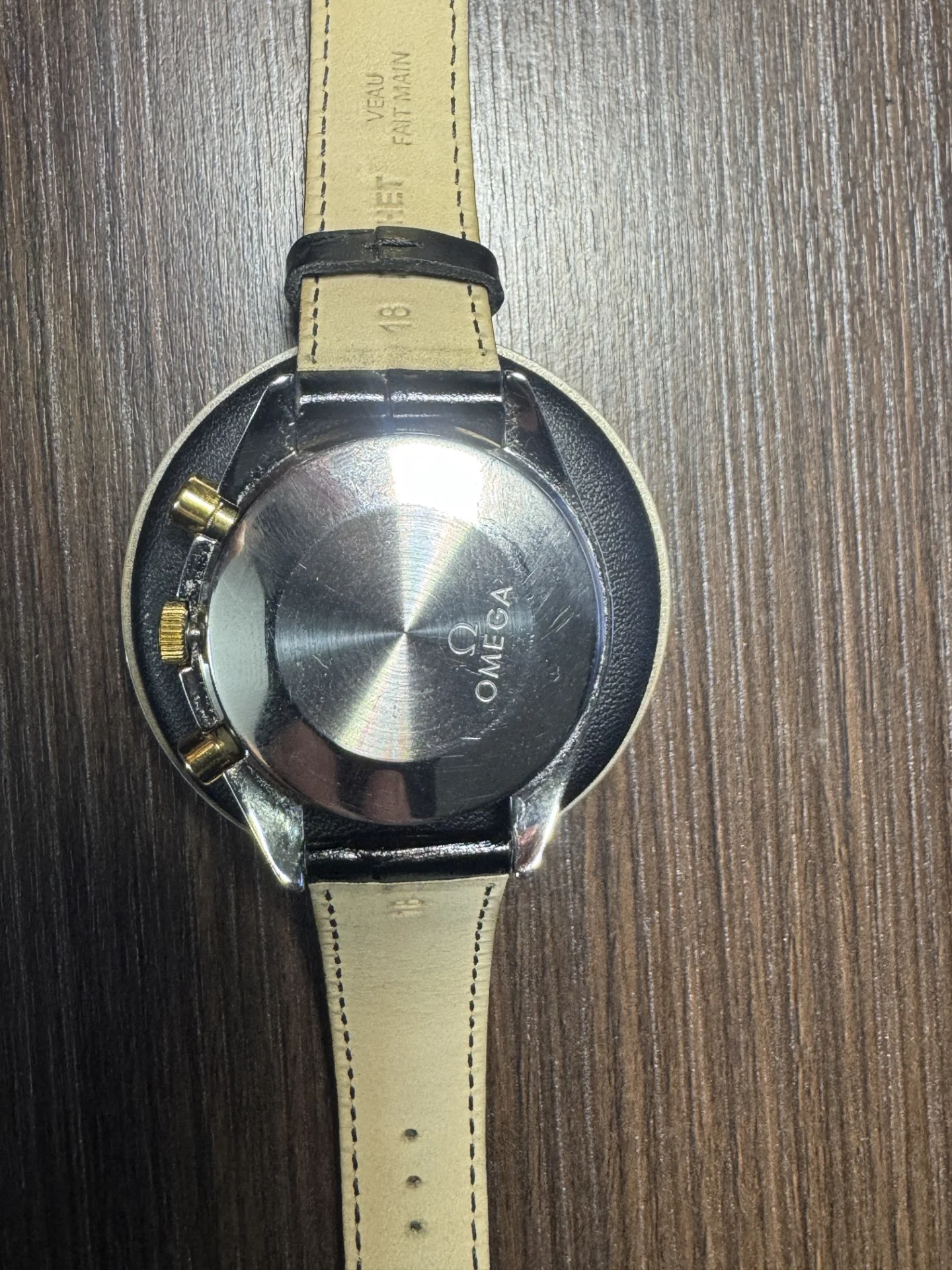

The case back says DA 175 0032.
Why might it be a 175.0033 instead?
I know that the first steel/gold models had a smooth case back with only the Omega writing without the classic seahorse.
Where can I buy this bracelet?

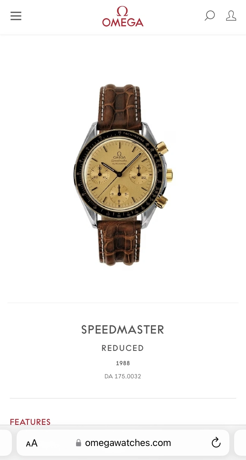

Below is a picture of the DA 175 0032 from the Omega website. If you search online you’ll fine a couple of different variants of the 175 0033, one of which appears to be your watch. These are simply case references; really you need to find the model reference number - i.e. specific to your watch. I’m sure if you spend the time online you’ll find the number - eight digits commencing with a 3. Once you have this information you’ll be equipped to do more specific research on your watch. I hope this helps.
