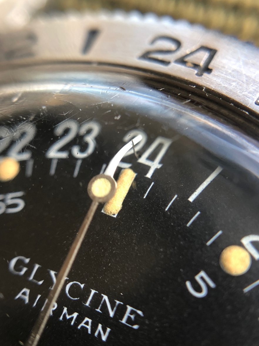

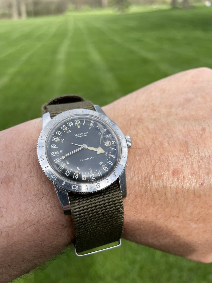

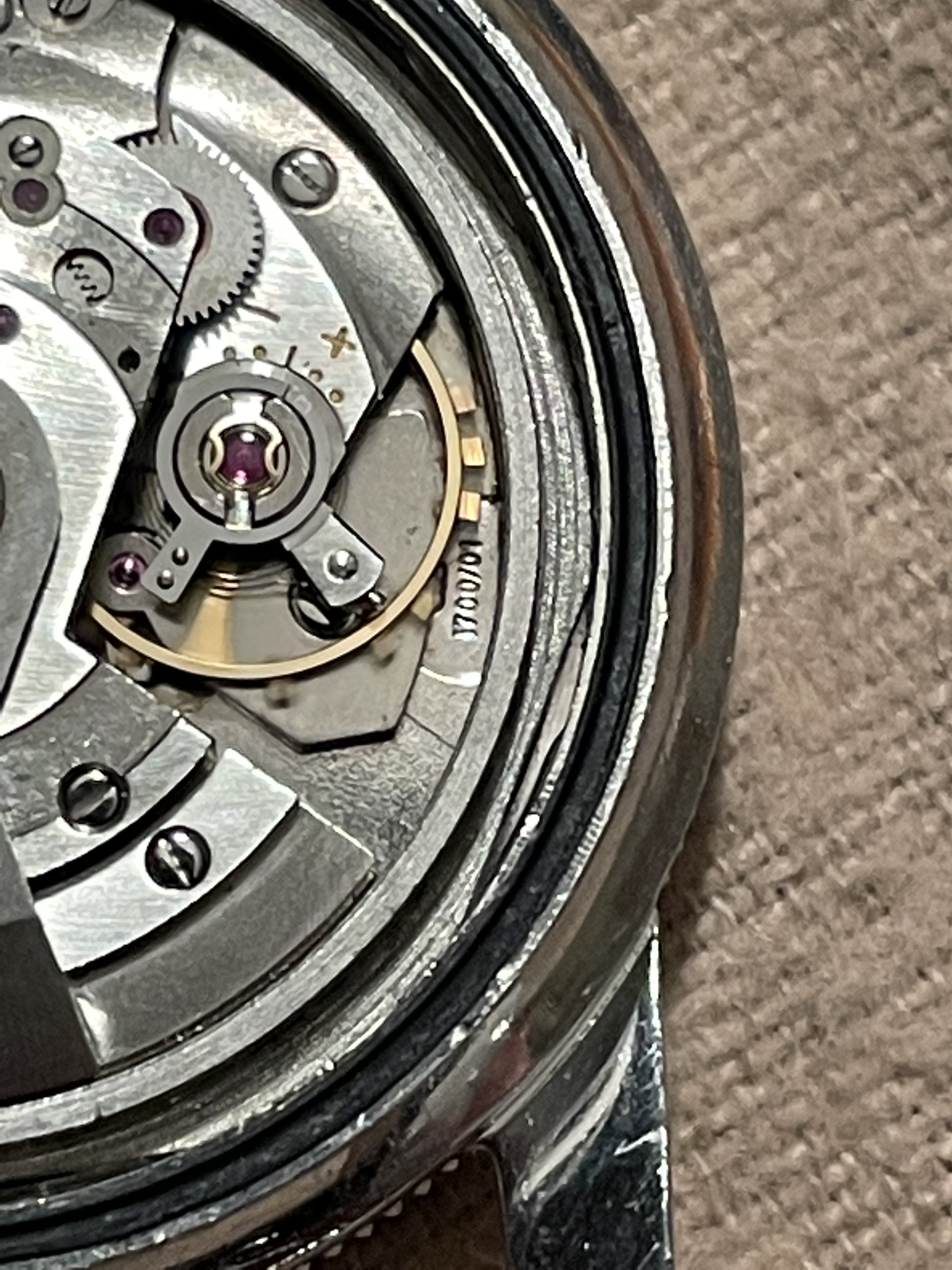

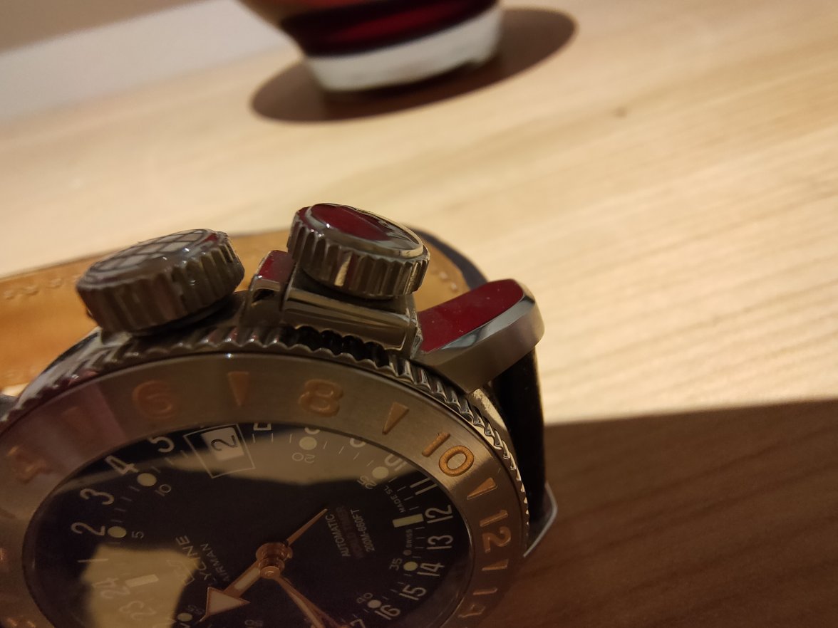

I recently took this macro of the hacking pin on my Airman for a game that we are playing over on WuS (Emre's game, actually). I thought people might be interested in seeing it. I guess I need to break out the Polywatch as well. 😬

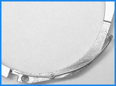

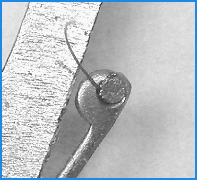

Here are "under the dial" photographs of the Glycine Airman hacking mechanism. The device is not part of the watch movement. the operating lever is attached to the movement ring. The end of the lever opposite the wire fits a notch in the winding stem. Pulling the stem into the setting position pushes the wire up to catch the second hand.
This photograph shows the entire lever with wire at the mid-right.
This is a close-up of the wire.

Interesting idea. This system would allow a relatively cheap conversion of most non hacking movement watches to hacking of a sort. mainly its a mechanically assisted back hack, but with very little stress on the movement itself.
Its also not dependent on how tight the arbor fit is, so long as its just loose enough not to cause damage to the pin or the second hand.

It's more effective for synchronizing watches in a group of people. As a hacking mechanism per se, it's not so convenient, since the watch continues to run until the seconds hand hits wire.
Not as quick as even back hacking which you can do from any position on the dial but effective just the same.
By the reference to "arbor fit" I assume you mean the cannon pinion. My thought is that if the cannon pinion is so tight that there is a possibility of damaging the second hand, then there is a definite danger in my opinion, of tearing teeth out of the minute wheel and causing unnecessary wear to other components in the setting mechanism.
It seems to me unwise to tighten a cannon pinion to the point that the watch can be stopped by turning the hands backward. Just last week I completed an expensive repair on a vintage Glycine Airman where a previous repairer had over tightened the cannon pinion to the point that the minute wheel post was sheared off while the owner was setting the hands.
It is true that this Glycine Airman hacking mechanism is adaptable to a variety of watches, but not cheap. The watch must have a metal movement ring of sufficient size and strength to carry the lever. The ring would need to be machined to provide clearance for the lever to move in and out and drilled for the pivot pin. The main plate of the movement has to have an opening milled in the side of the plate at the top of the dial for access to the dial for the wire, and the dial has to be drilled. Also, the sweep second hand has to be longer than the minute hand so the wire catches the second hand and not the minute hand, and the winding stem has to be modified to operate the lever. So while the design is adaptable, it could require considerable effort and expense to accomplish. From a production standpoint, all this can be accommodated in the initial design. As a one-off modification, probably it would not make economic sense.

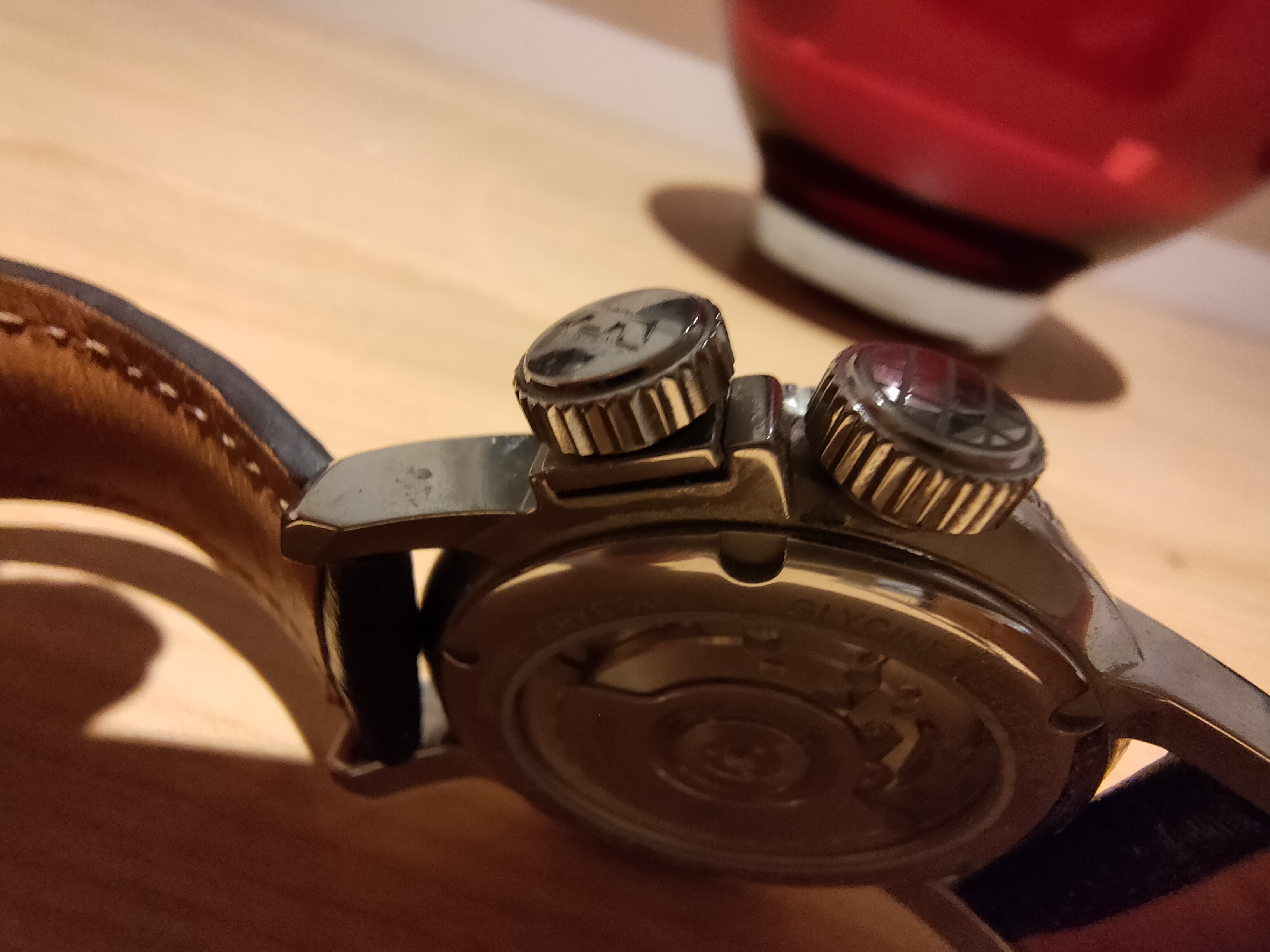

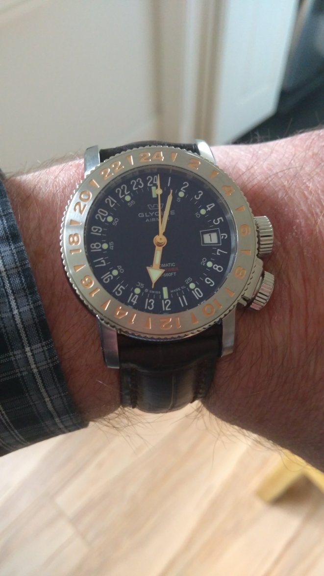

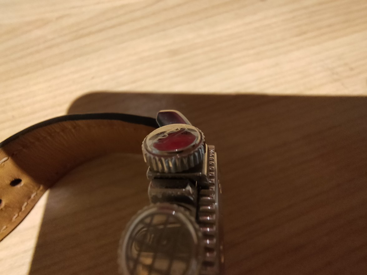

I own what might be considered the spiritual successor to these vintage Airmen - the Airman 18. The mechanism is different, there is no hacking wire and the size is 39mm, but it's a great watch 😀
Below are some photos to show how the bezel lock mechanism differs from the vintage examples. Rather than a block that locks the bezel by simple pressure, as far as I can see, the modern version is more of an inverted "L" shape with teeth that lock onto the bezel edge. It also seems to be attached to extra metal on the side of the case. Not sure if the macro shots show this clearly or not, but I tried 😁

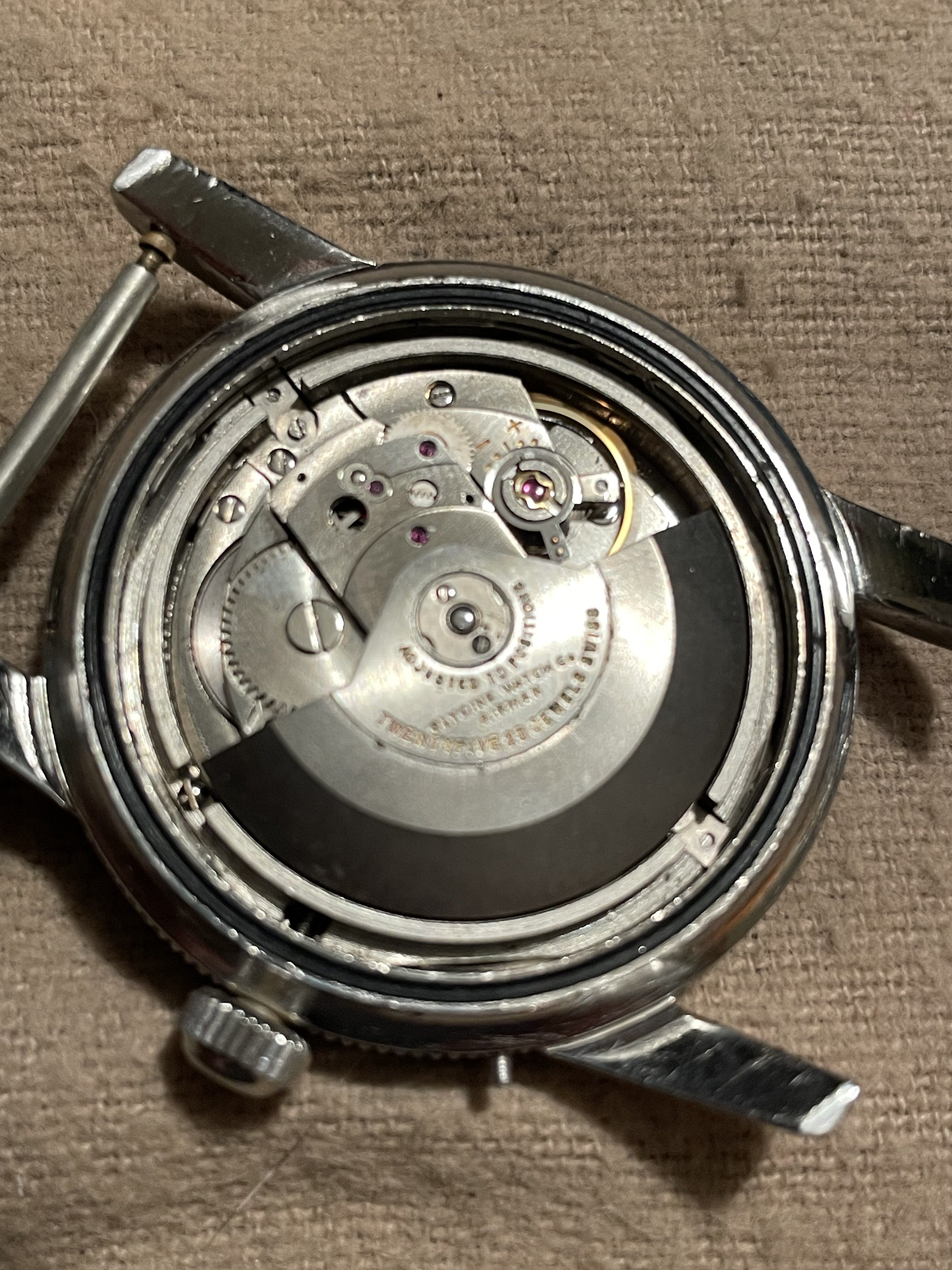

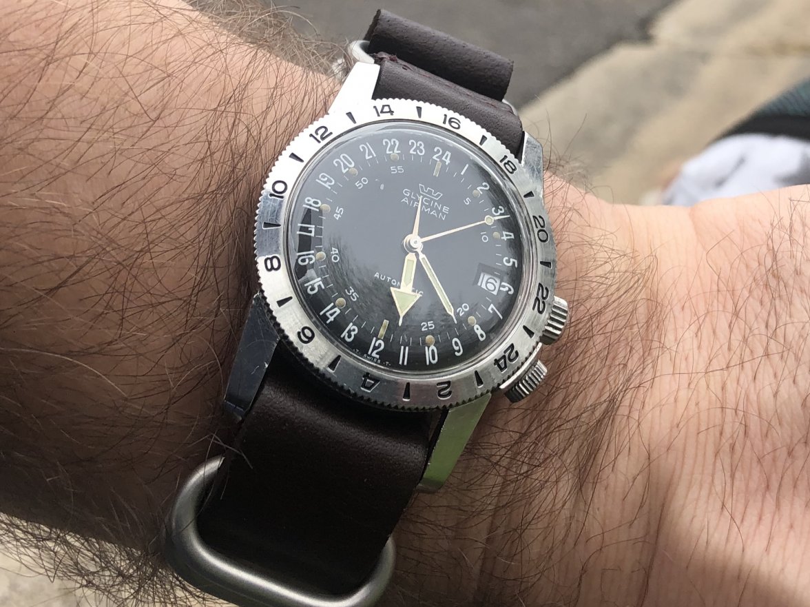

Excellent thread. I had briefly considered getting an old Airman over the years but never got too serious. Today, I just stumbled upon one locally, and as much as I hate the "I got a 2915 at a yard sale for 35 cents and a piece of pocket lint," I can honestly say I got a pretty good deal. Not a pocket lint kinda deal...but not bad. It is a handsome watch on the wrist, and I like it with a green or khaki nato. Now I have to fix the same locking crown problem the original poster had.
6,497
22,087
That's a nice one. Consider contacting James (above) if you'd like to get a new crystal and he can paint the bezel numerals, not to mention a full service.

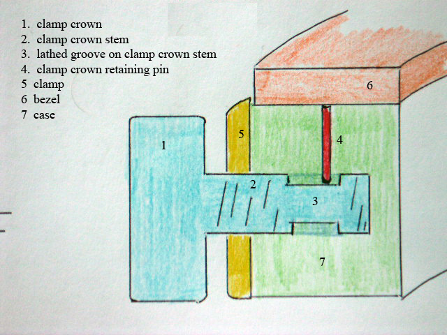

Did anyone say the secondary crown was to do with the movement or hacking? More than 3 components on the old Glycine Bezel clamp. Can't see the clamp post on the OPs watch that stops the clamp from rotating.
The clamp crown retaining pin usually corrodes and the rest is lost.
Try the new parts. I would be interested to know if they fit.
(I nicked that drawing from https://andres55.home.xs4all.nl/frames/airmangeoff.htm)
Having seen dozens of vintage Glycine Airman watches over the past several years, I have never seen one with the bezel clamp design depicted in the drawing posted by Tubber. In all the vintage Airman watches I have seen, there is, under the rotating bezel, quite a large hole drilled into the opening that comes from the side of the case where the thumbscrew that fastens the bezel clamp plate threads into. Rather than a pin (red #4 in the drawing) as in the drawing to prevent the thumbscrew from coming out, the end of the screw is cross-drilled and a pin is driven into the cross-drilled hole. The pin is sufficiently long to protrude from both sides of the screw and prevents the screw from being completely withdrawn from the case. In order to remove the screw completely, one can access the pin through the hole under the bezel and drive out the pin.
In the posted drawing, there does not appear to be any simple way to disassemble the clamp. I have to conclude the drawing is a figment of some person's imagination.
