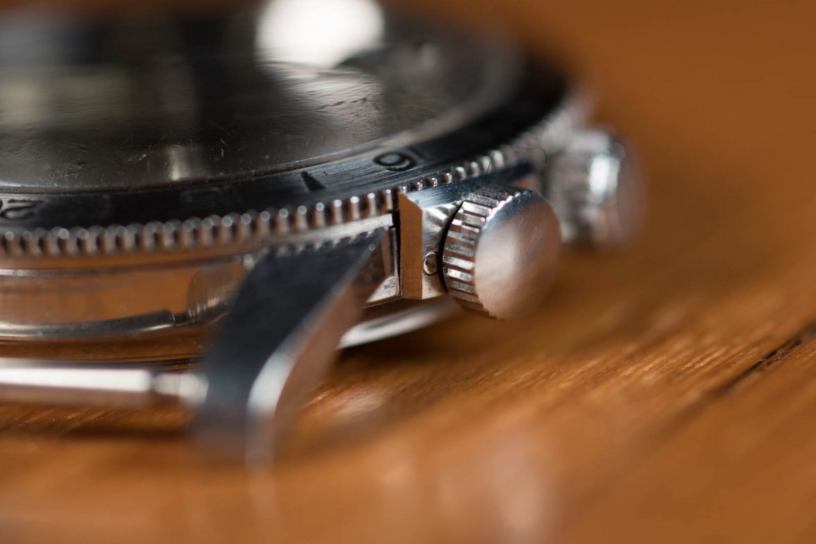

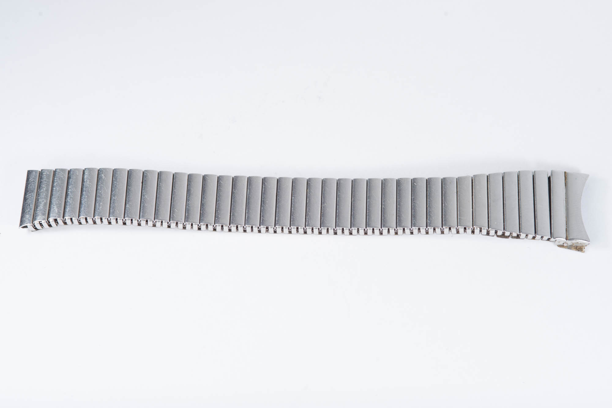

First, thanks everyone for all of the usual invaluable help. I emailed Nevada Watch Repair this morning and am waiting to hear back. I didn't realize at first that the hacking mechanism is in working order. I hadn't seen one before where you have to wait for the second hand to return to zero.

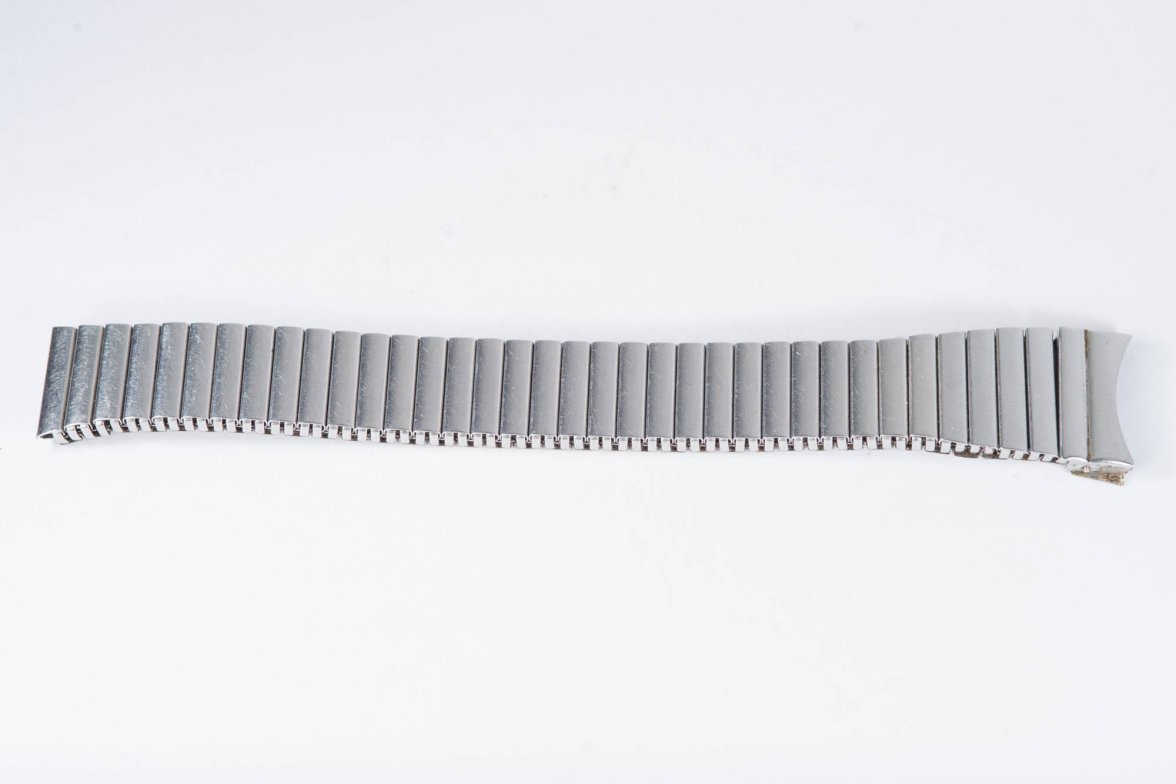

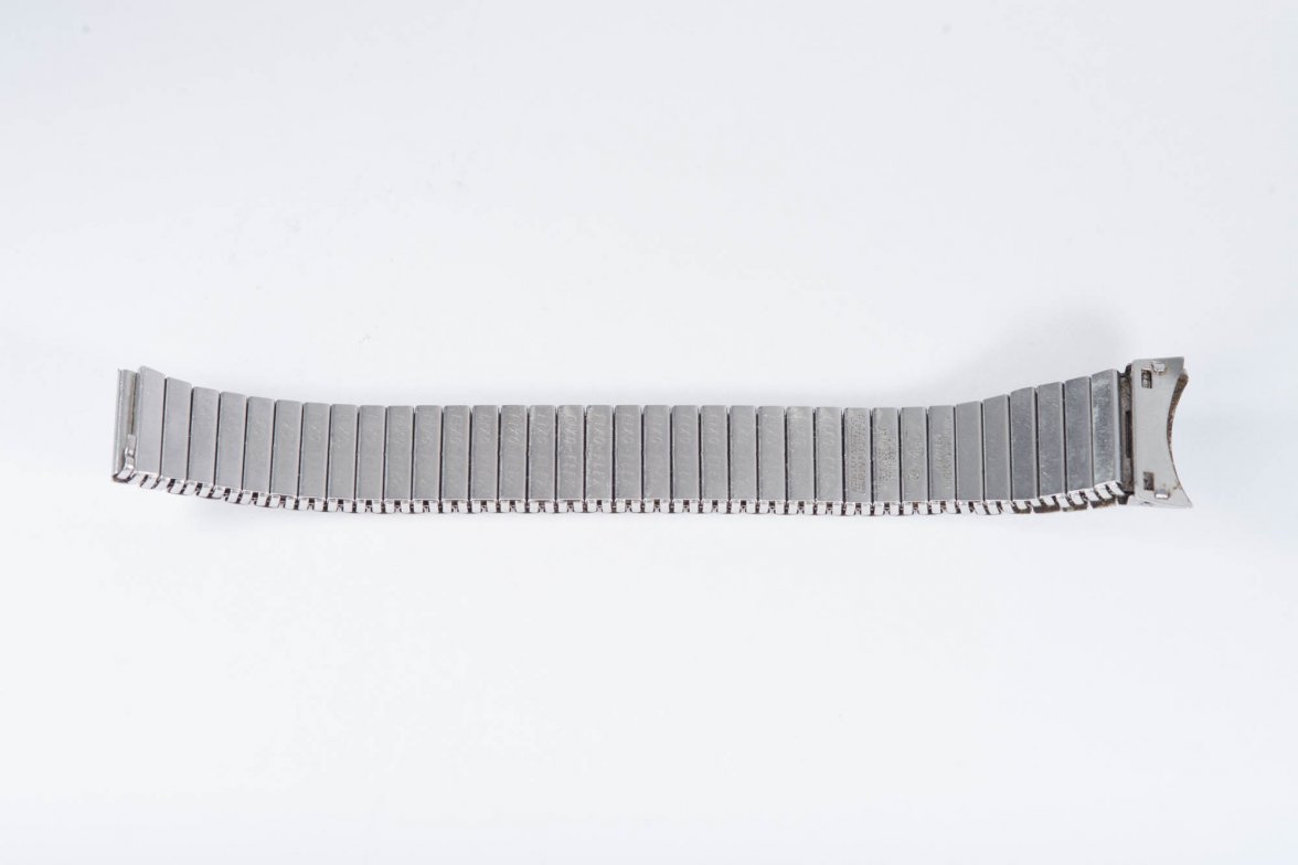

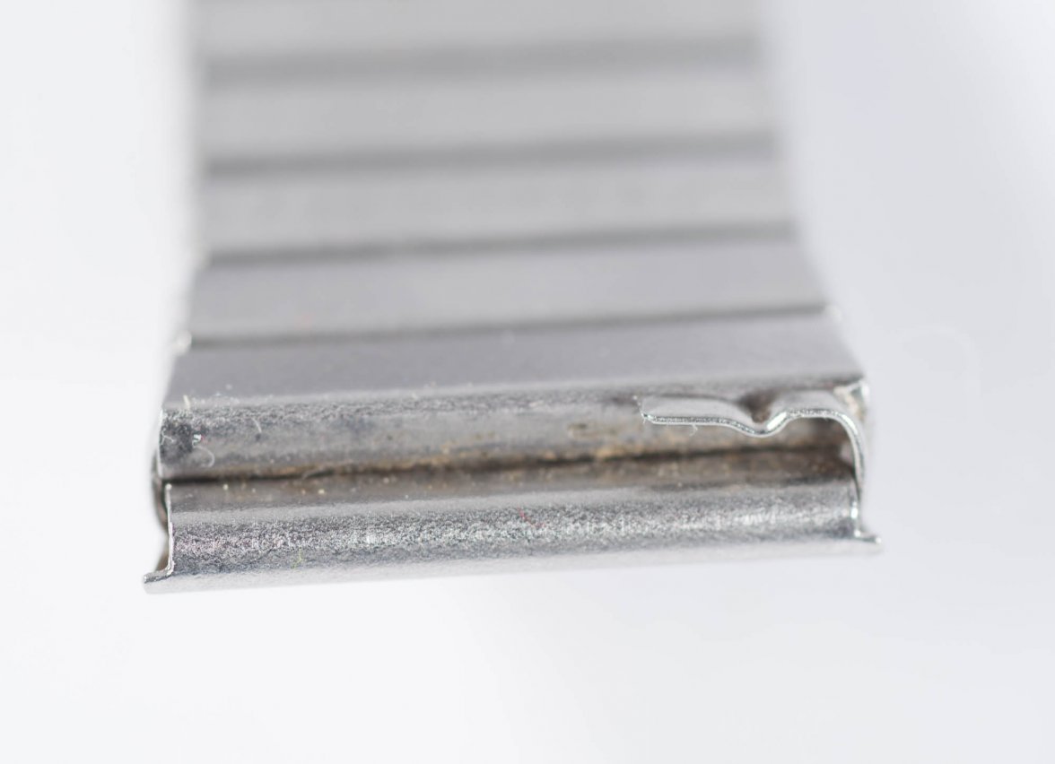

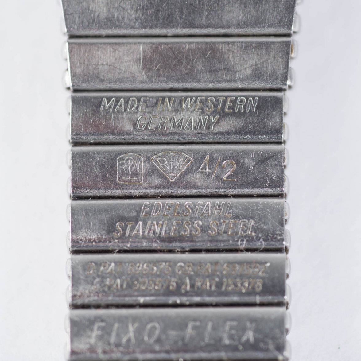

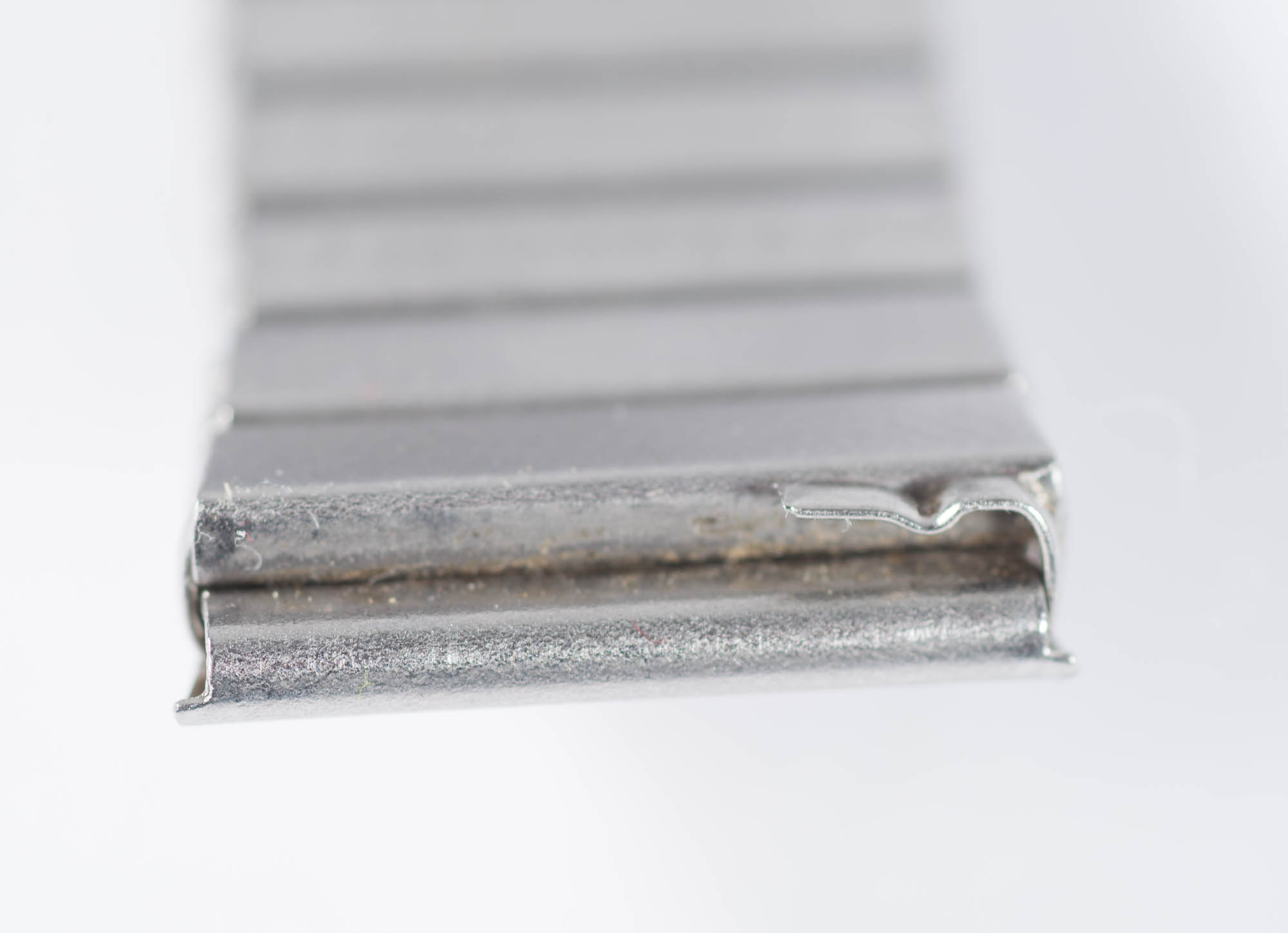

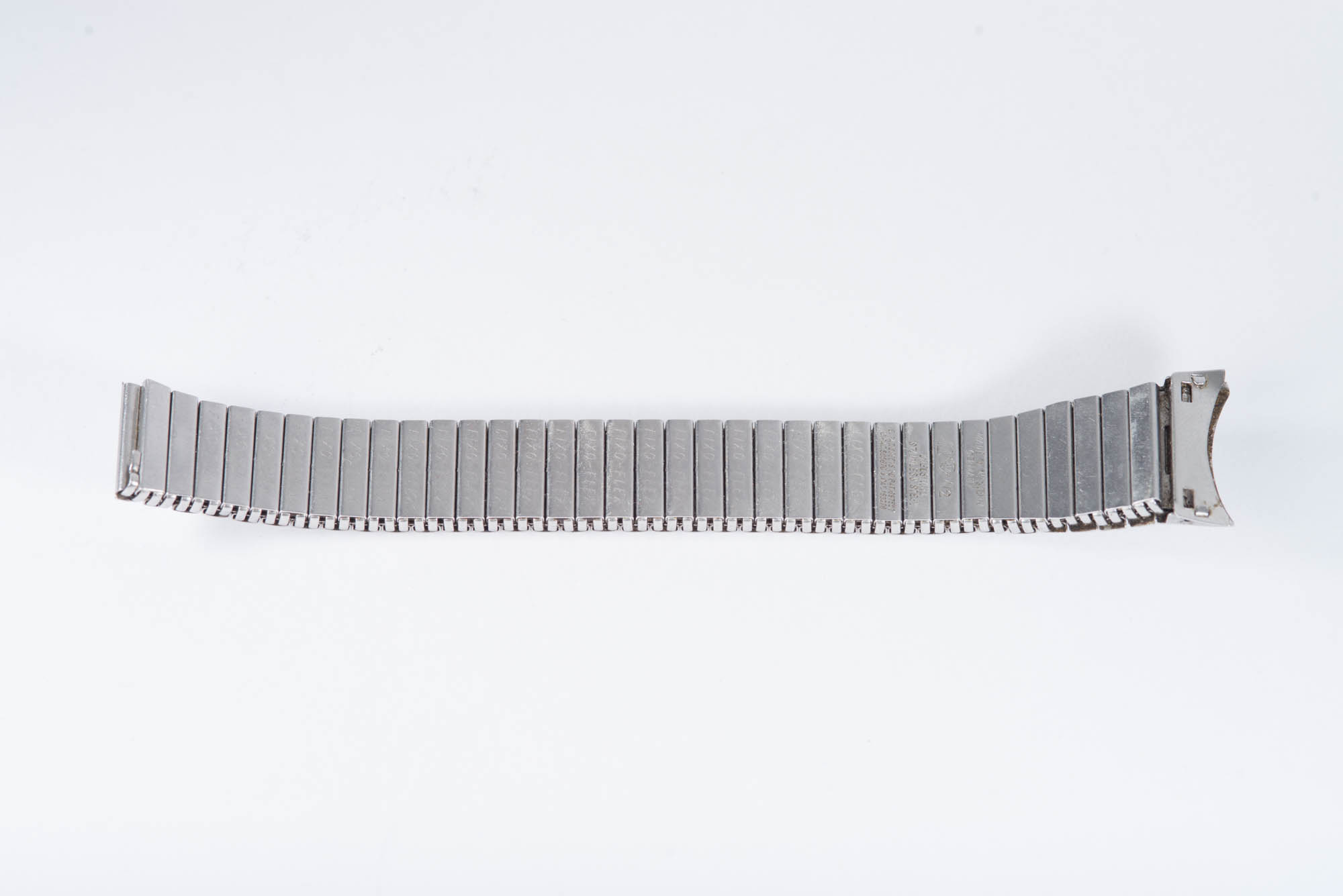

Another concern I have with this watch is the bracelet. I have most, but not all, of the original fixo-flex bracelet. See photos below. Any advice is welcome, but I'm guessing that if there's a solution it resides in the WTB forum. I'll be sure to post pics when the watch is ready for action again. Thanks again!
Nothing wrong with that bracelet, but I'm curious why you think it's original to the watch? Those are pretty generic.

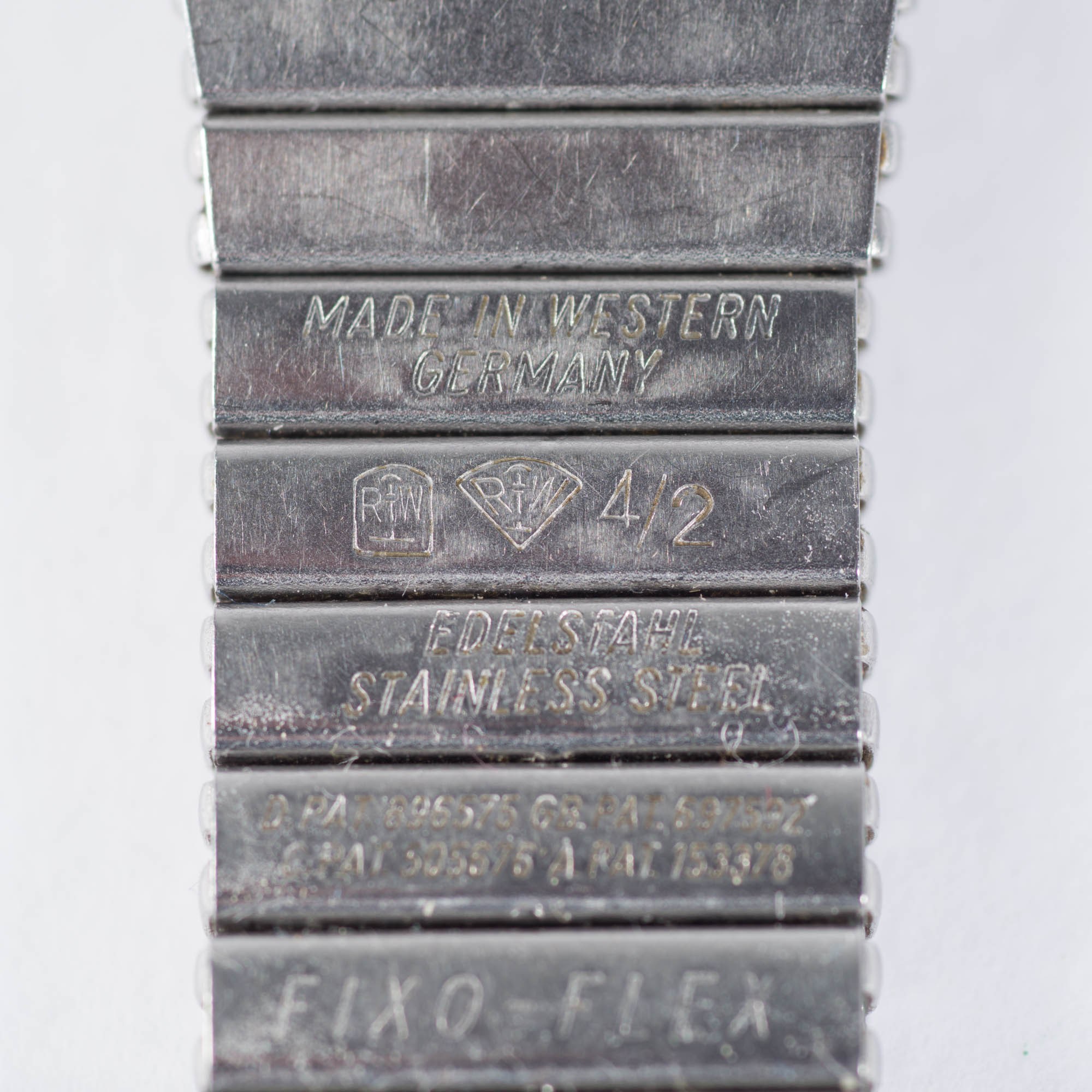

I guess it's not easy to tell from the photo, but the bracelet tapers out to the endlink. The side that's missing an endlink is also missing four pieces of the bracelet. I can't guarantee that the bracelet is original, but the fixo-flex was sold as an option with the watch as seen below.

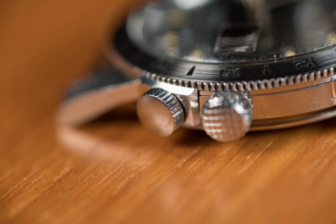

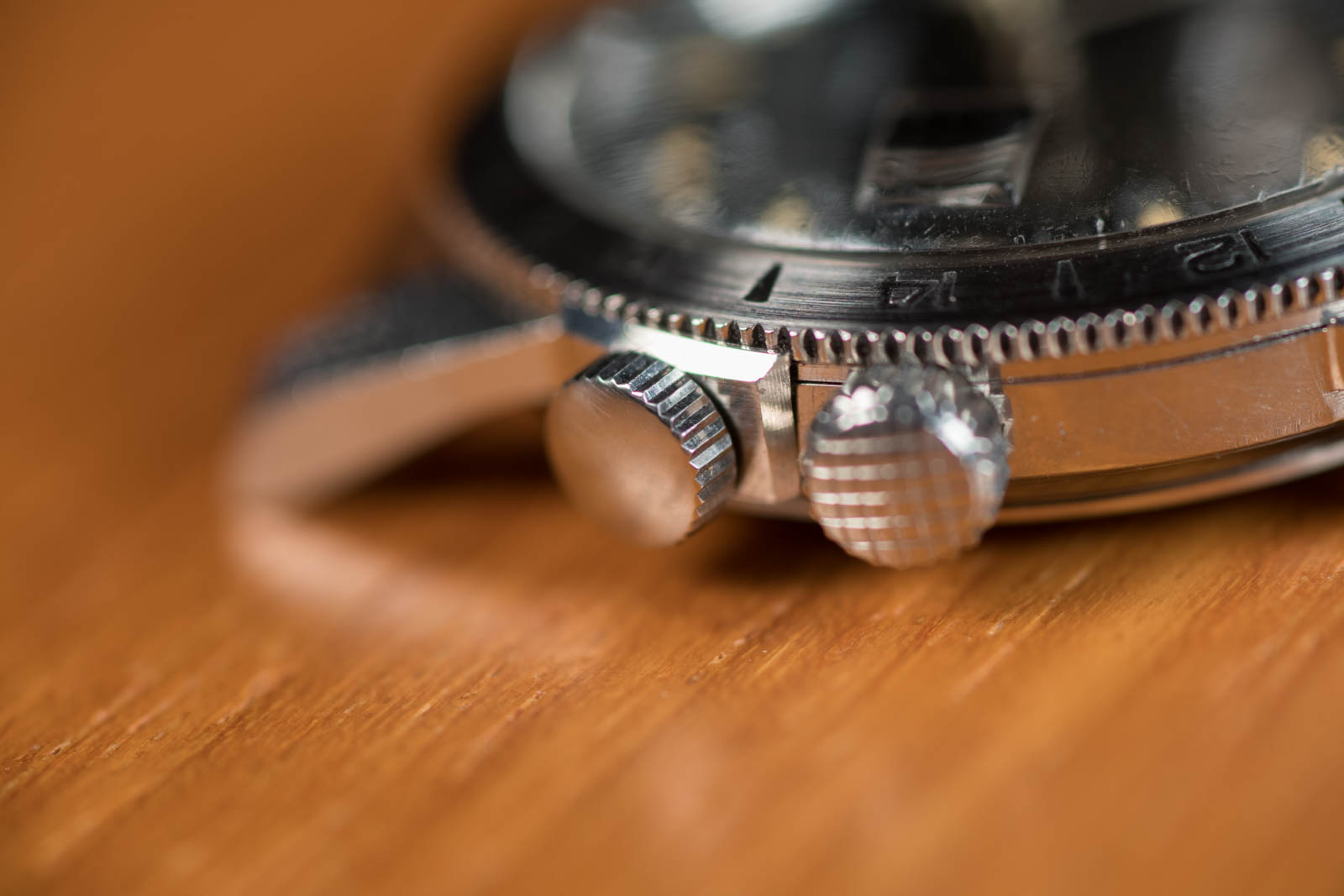

Thank you to all for your kindness in mentioning my name. The Glycine Airman, some versions, did come with the German made Fixo-Flex bracelet.

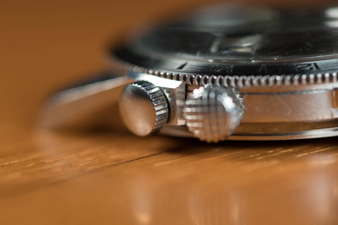

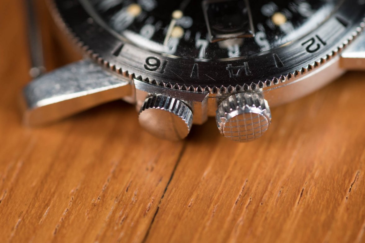

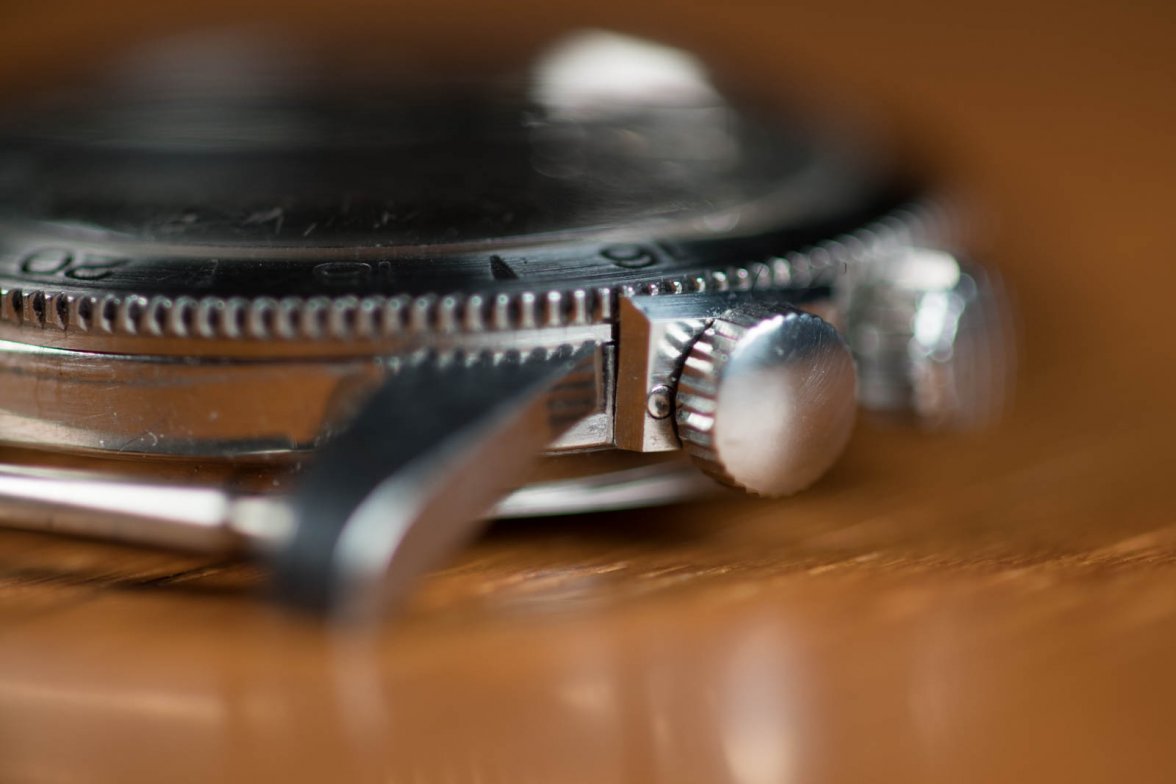

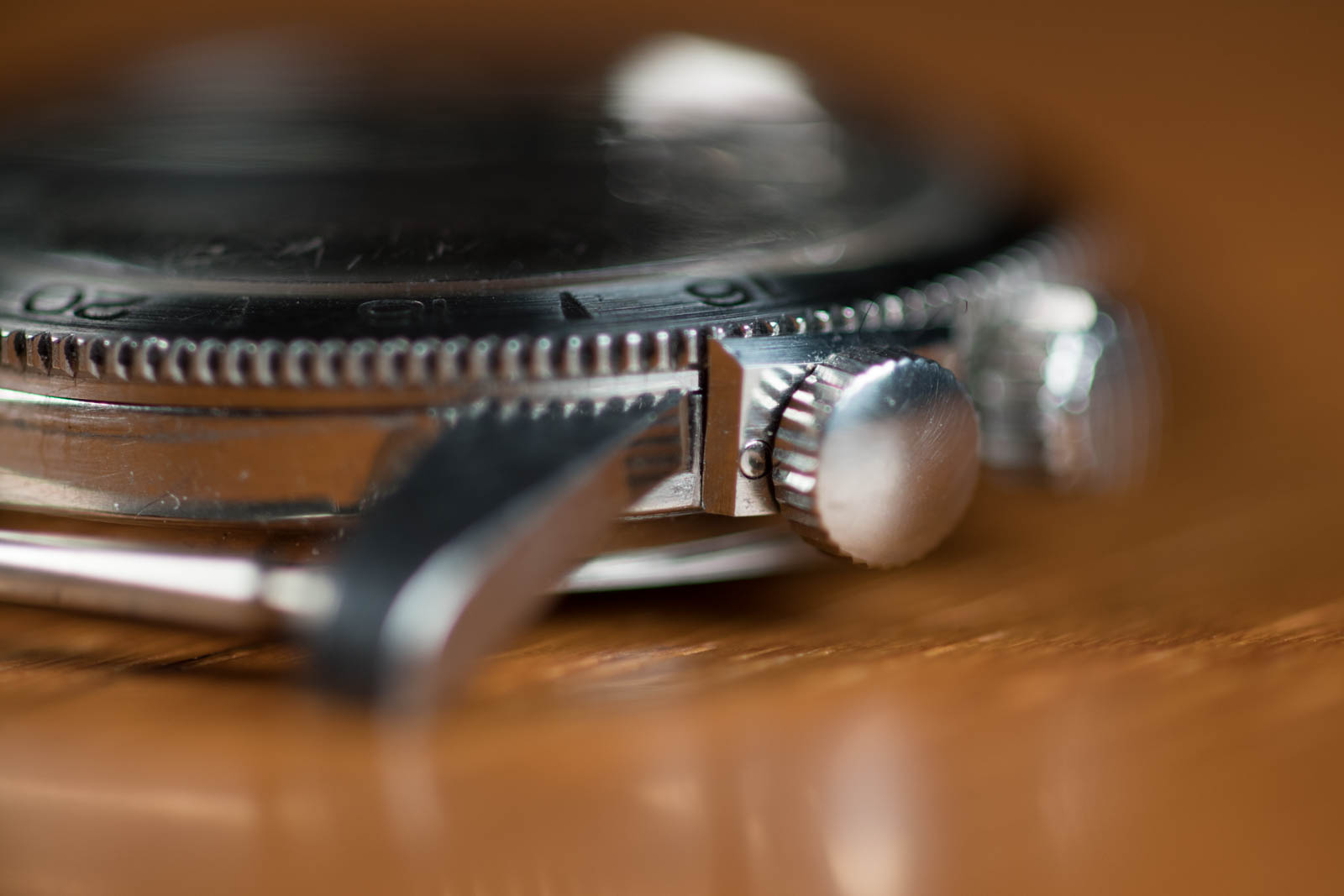

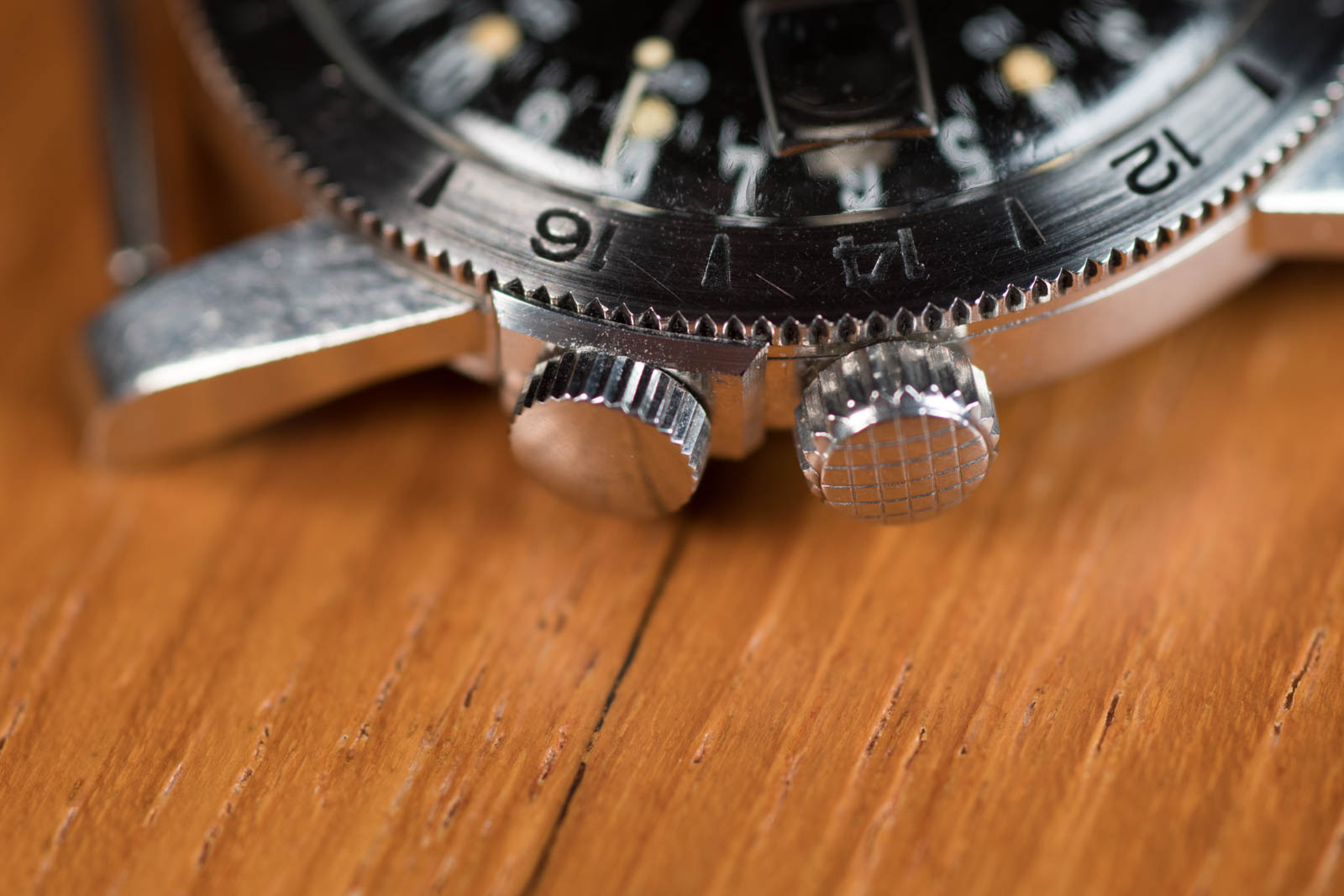

Regarding the posted cross-section image of the bezel clamp, while that configuration may exist, I've never seen it. All that I have seen, and that would be many, have a larger hole under the bezel, about the size of the hole in the side of the case for the clamp screw.
In order to retain the clamp screw, the outer end of the screw is cross drilled. After the clamp screw is screwed into the case, the drilled end of the screw can be accessed through the hole under the bezel; a tapered pin is driven into the hole in the clamp screw. The pin extends a bit on either side of the screw and prevents the screw from coming completely out of the case as it is unscrewed. In order to remove the clamp screw, the bezel is removed and the pin pulled out of the screw and back out through the hole under the bezel.
There are no factory replacement bezel clamp parts. The parts must be fabricated and fitted to the case. The hole in the case for the plate steady pin varies slightly from case to case, so the clamp plate is a custom fit with the hole for the steady pin being drilled to match the plate.

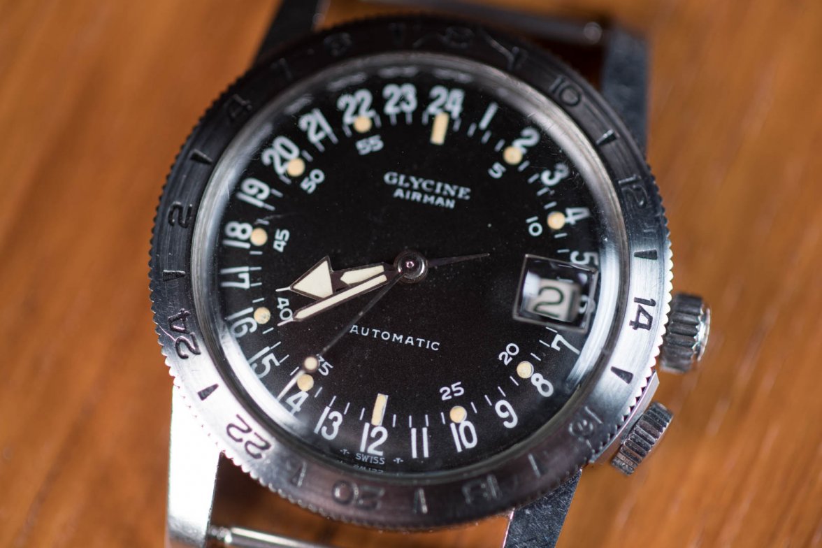

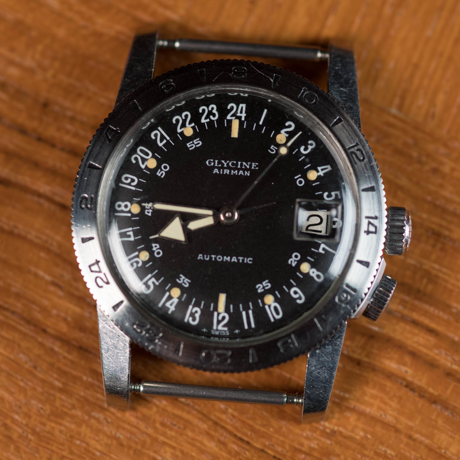

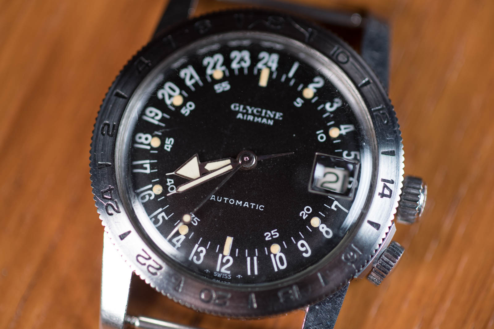

Update:

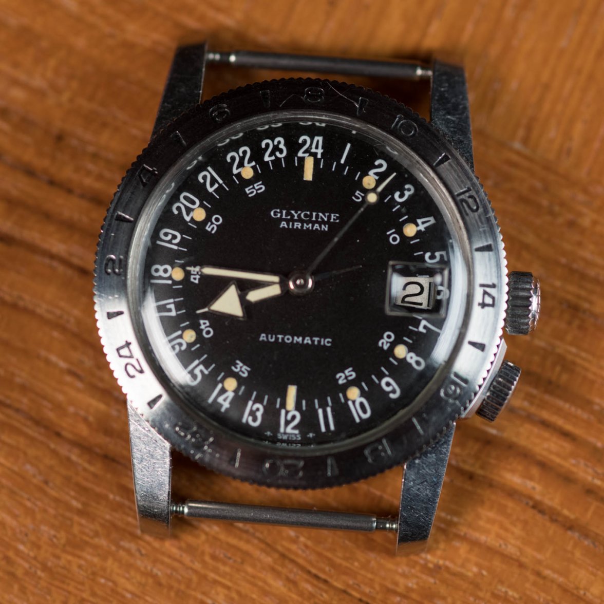

I sent the watch to James and heard back today.
The good news: "Except for the missing bezel clamp, your watch looks very good. The movement appears almost new."
The rest of it: "...more than a minute a day positional error. -40 to +28. Also the dial up and dial down rates should be within a few seconds of being the same. In this instance I am seeing a 40 seconds a day variation. These variations are an indication that the watch needs to be serviced."
It'll be well worth it, but I may need to delay the next acquisition.

Update:
Repair and service are complete. Jim has been a pleasure to deal with. The main part of the elapsed time has been due to a backlog of work at the machinist's shop. I just sent payment and am hoping to have the watch back this week. Will post pics then. 😀
807
2,111

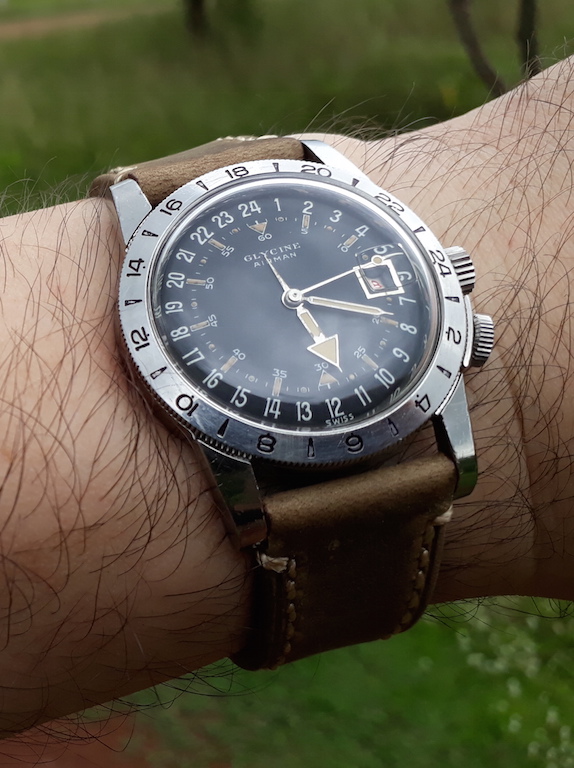

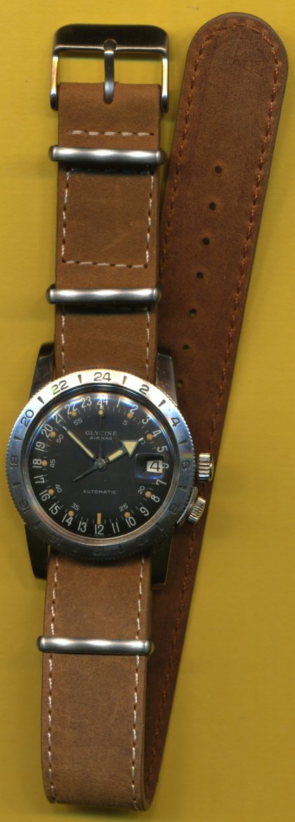

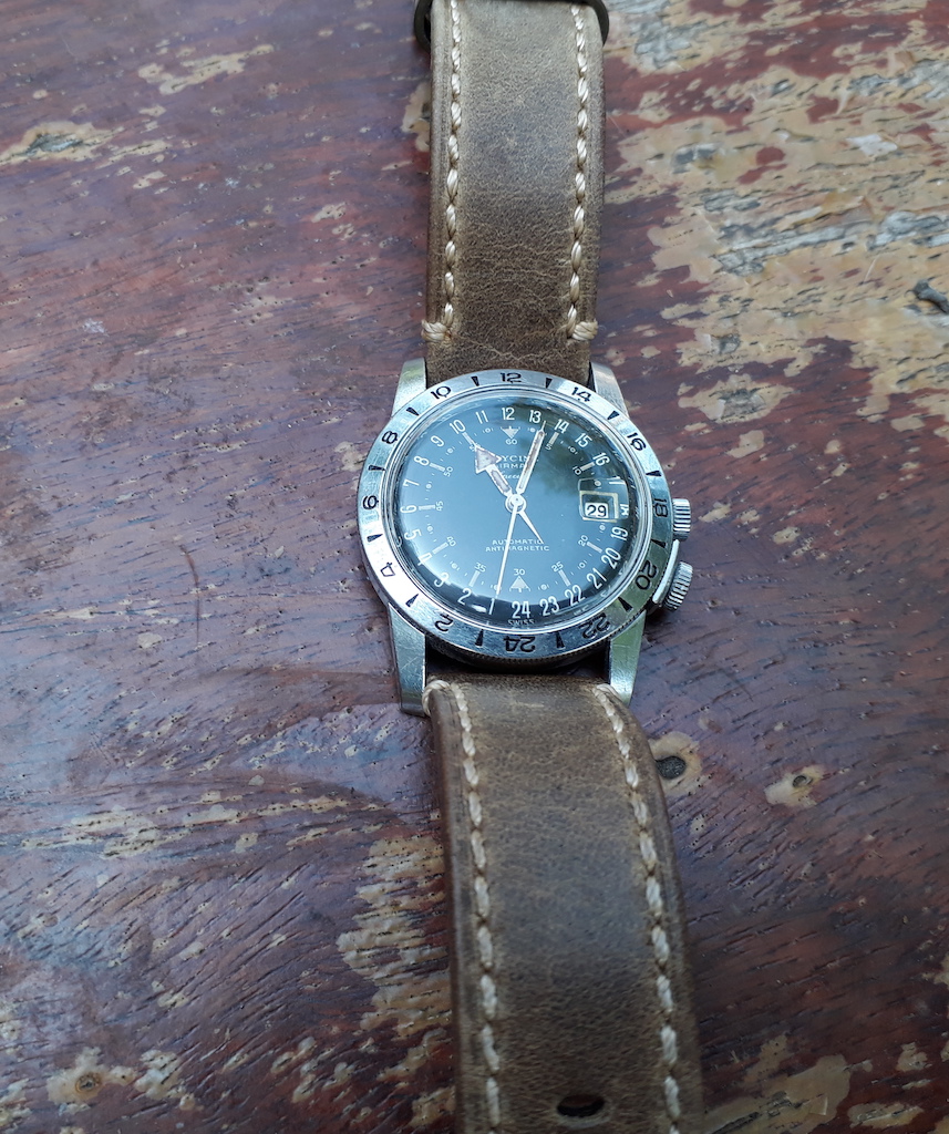

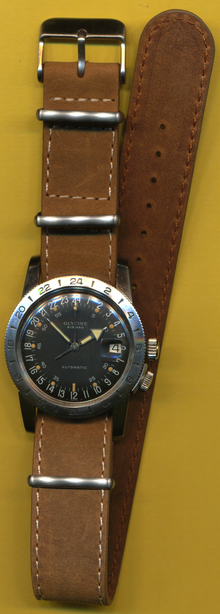

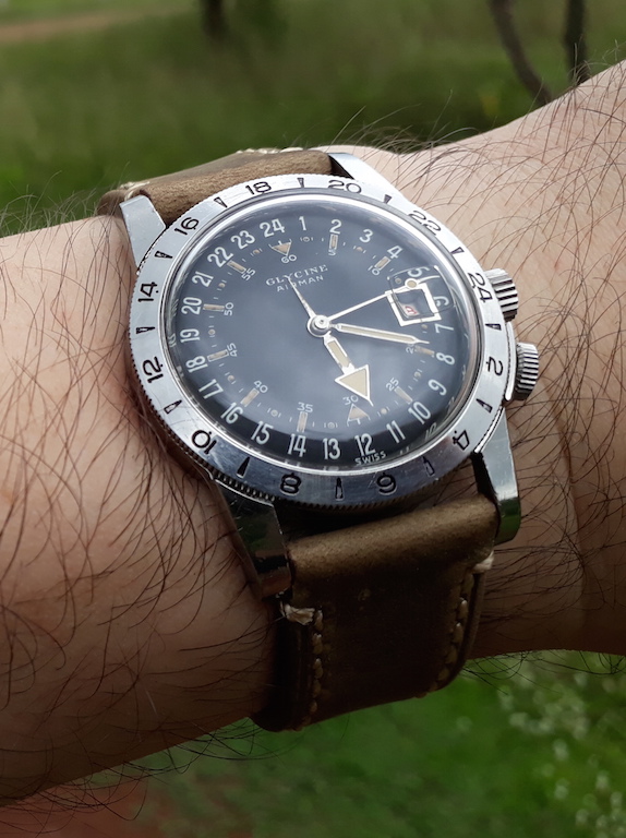

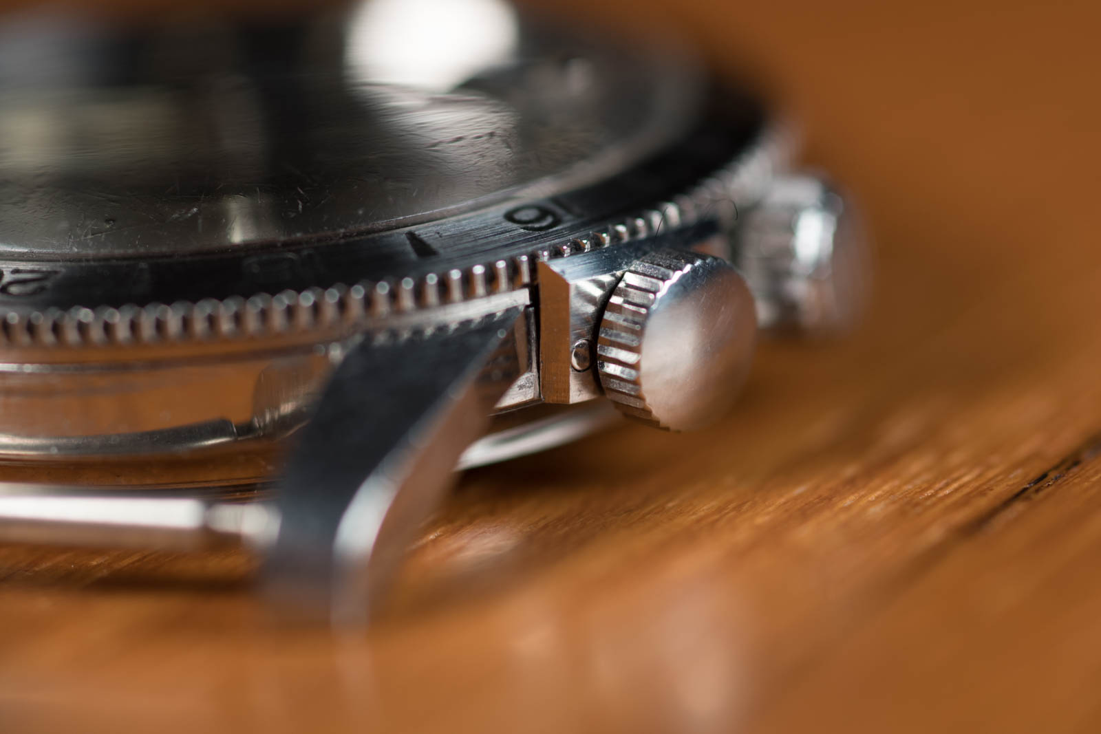

Not exactly watch porn quality images, but I wanted to share the outcome. I have limited experience, but it's easy to see why Jim is so highly recommended. It's nice to have the watch back home. Now I just need to get it on my wrist. If anyone has strap recommendations, I'm all ears.

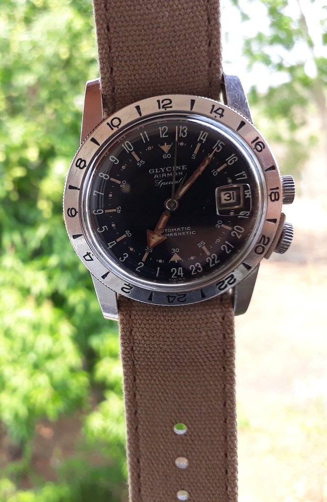

Spectacular watch and on my wish list one day- if it hasn’t been said- dibs!

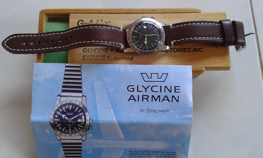

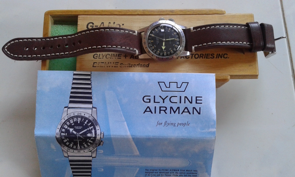

As far as I have seen they came on a thin textured leather strap. The ones Bulang is marketing for the Speedy right now would period correct in my opinion if it’s a 19 or 20 lugs, though it may be an 18- I haven’t handled one in the flesh so don’t know.
https://bulangandsons.com/collectio...ts/taurillon-black-speedy-leather-watch-strap
2,013
7,177

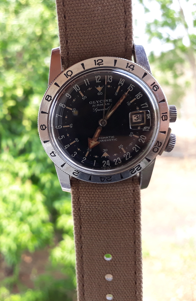

On an older looking leather strap.

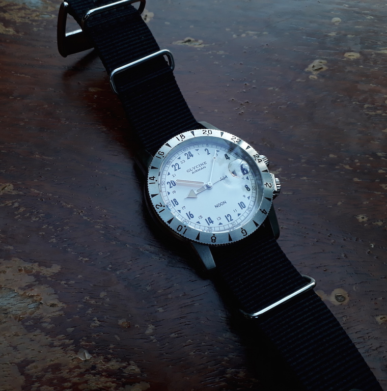

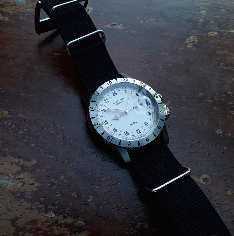

The re-issue came on a NATO strap.
Canvas NATO.
Leather NATO.
807
2,111

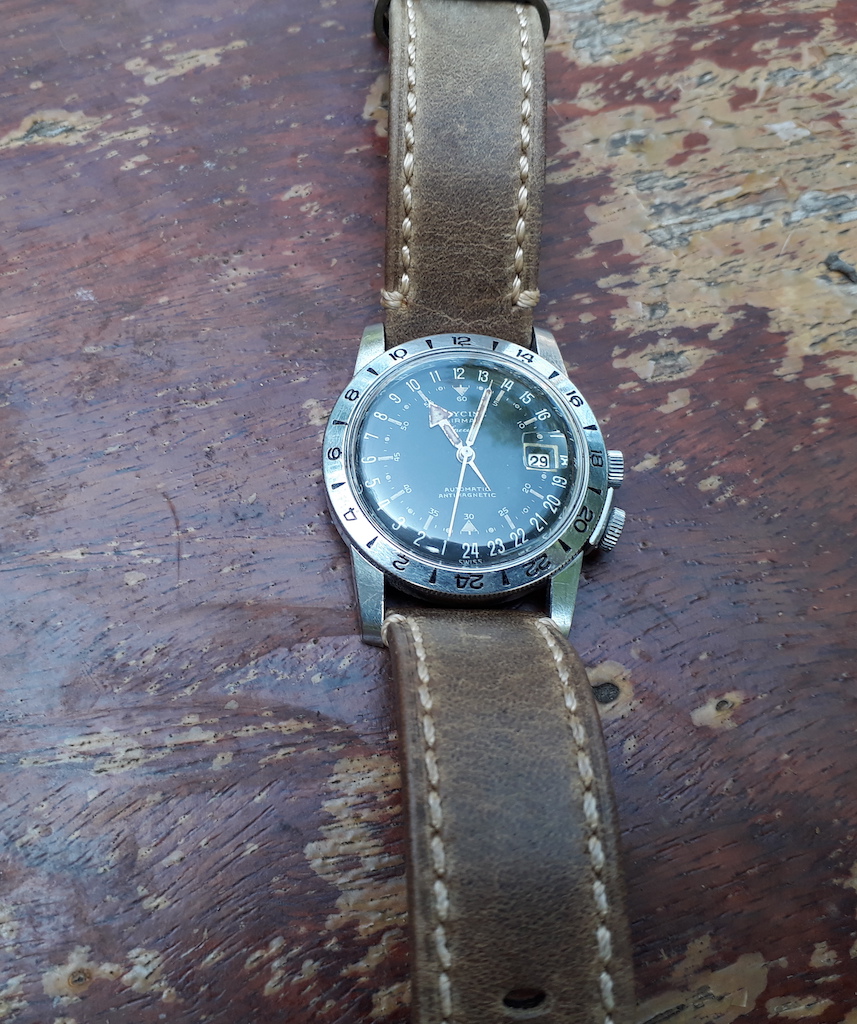

Thanks for the recs. I'm definitely leaning toward brown leather.

Thank you to Krogerfoot for his kind words. Regarding straps, the distance between the case lugs on the vintage Glycine Airman watches is 20mm.
