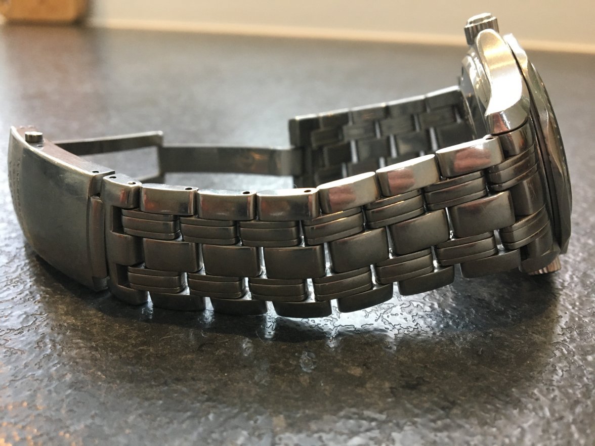

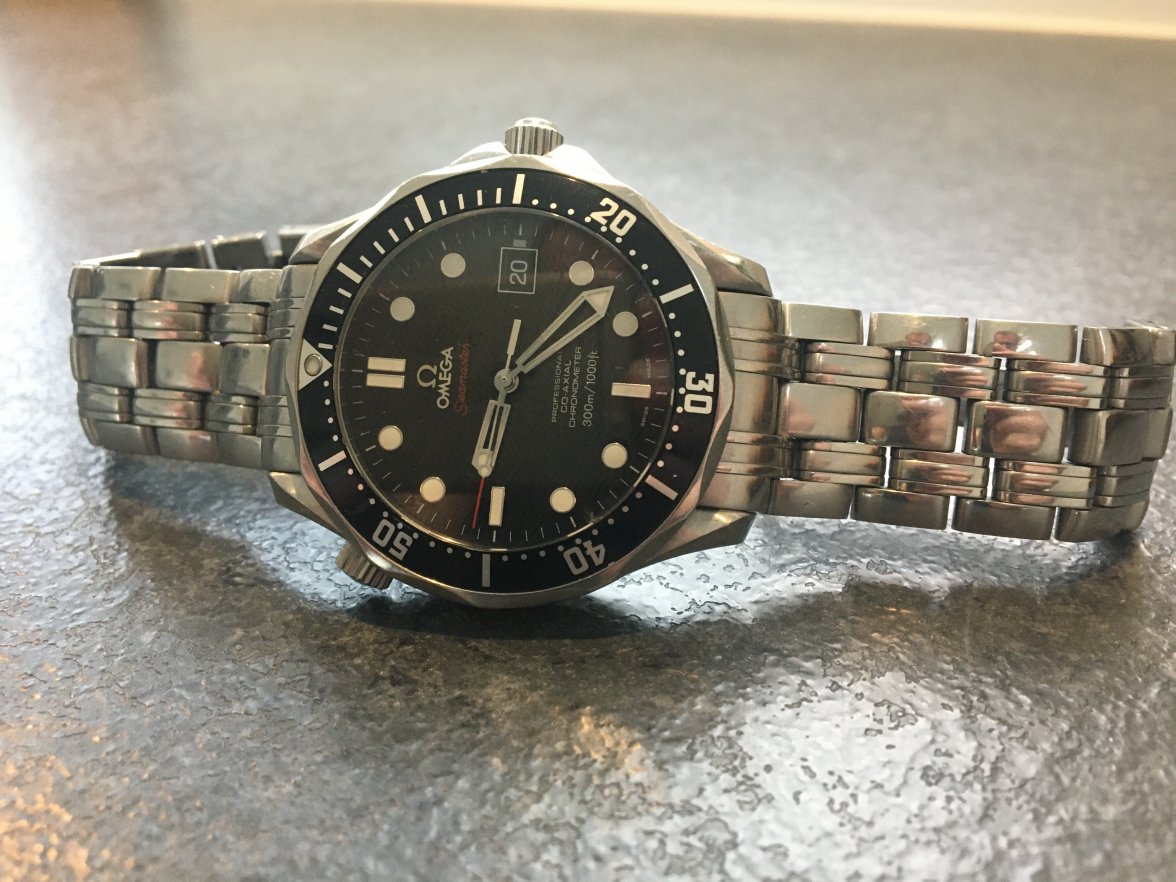

Hi gents,
I’m UK based, I’m arranging work on a friend’s cal 2500 Seamaster he’s had since new.
It’s never been serviced, bracelet is shot, usual wear to the case from 10+ years of wear.
My plan is to send the bracelet to Michael Young in HK for a full revamp and retighten.
After discussion, he wants the case polished as well and thinks he may as well get it serviced at the same time, get it back to “good as new”
I’m thinking if getting all the work done in HK at the moment.
So my question us how easy or difficult is the cal 2500 movement to service and does anyone know anything about Michael Young’s movement servicing work?

Because they won’t repair the bracelet, replacement is £1k+, and will polish the case heavily, MY will laser weld then polish, keeping the profile.

Well you’ll need to take your opinion up with Omega, they are the ones who have told him the bracelet is beyond repair and needs replacing at £1k+

I don't believe a Cal 2500 is too difficult to service - it's just an ETA 2892 with a special escapement. I have a derivative of the 2500 in the watch in my profile photo. Omegas with the Co-Axial are so commonplace now that I bet most watchmakers have worked on them at one point.

I believe it's not just like servicing a good old 2824. @Archer explained in the past how delicate it is to apply a microscopic amount of oil on the escapement wheel (correct me if I am wrong Al). The watchmaker needs specific Omega training in co-axial movement.

In order to properly service a co-axial escapement requires specialized tooling and a full understanding of the process. I'm quite sure there are many watchmakers who have "worked on" these movements, and some have contacted me in a panic because they don't know what to do once they get to a certain point, or they find worn parts inside that they can't get.
Before I went to Omega for the training, I used to get requests from people to service their co-axial watches, and I turned them all down. It's not ethical for me to "wing it" on something I have no idea how to service properly. I'm very glad I waited, because the tech guides don't tell you everything you need to know, and the issue with servicing a co-axial is that even if you don't do the job right, it will run great on a timing machine. But it will be chewing itself up inside, and down the road will require new escapement parts when damage like this happens - worn teeth on the co-axial wheel:
I personally would not recommend sending a co-axial escapement watch to someone who hasn't had training right from Omega, and doesn't have access to the proper tools and replacement parts - in other words someone with an Omega parts account.
