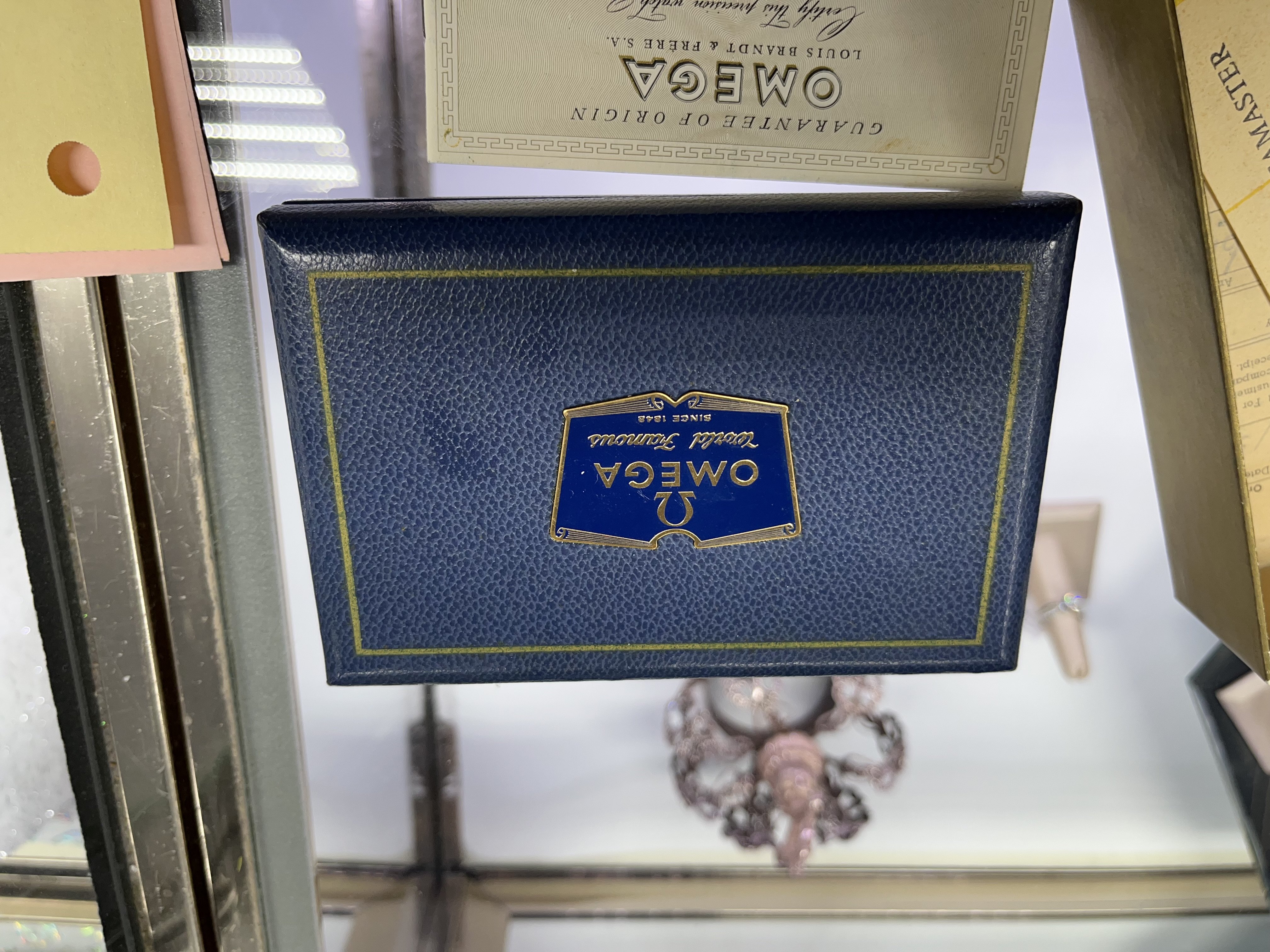

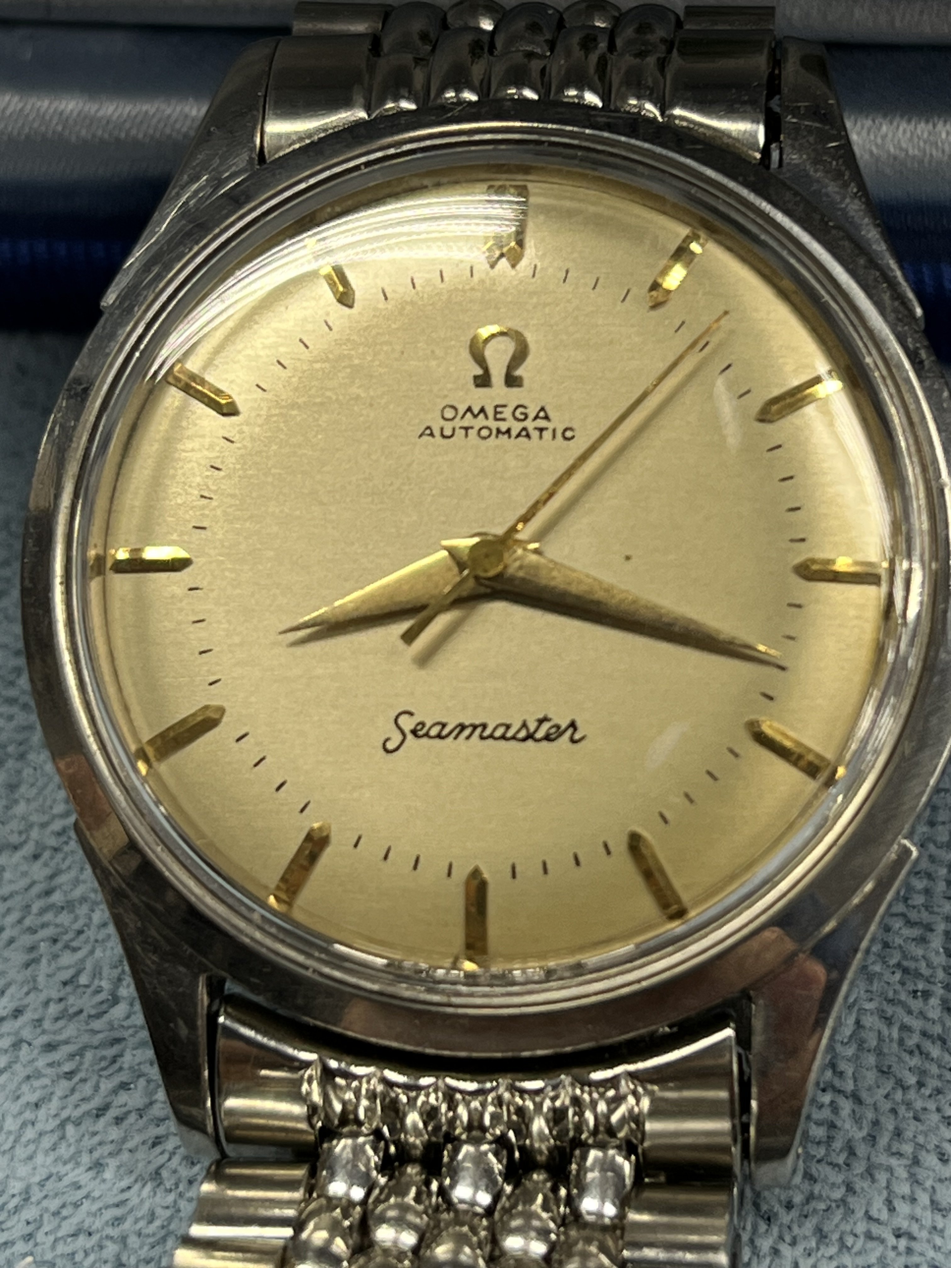

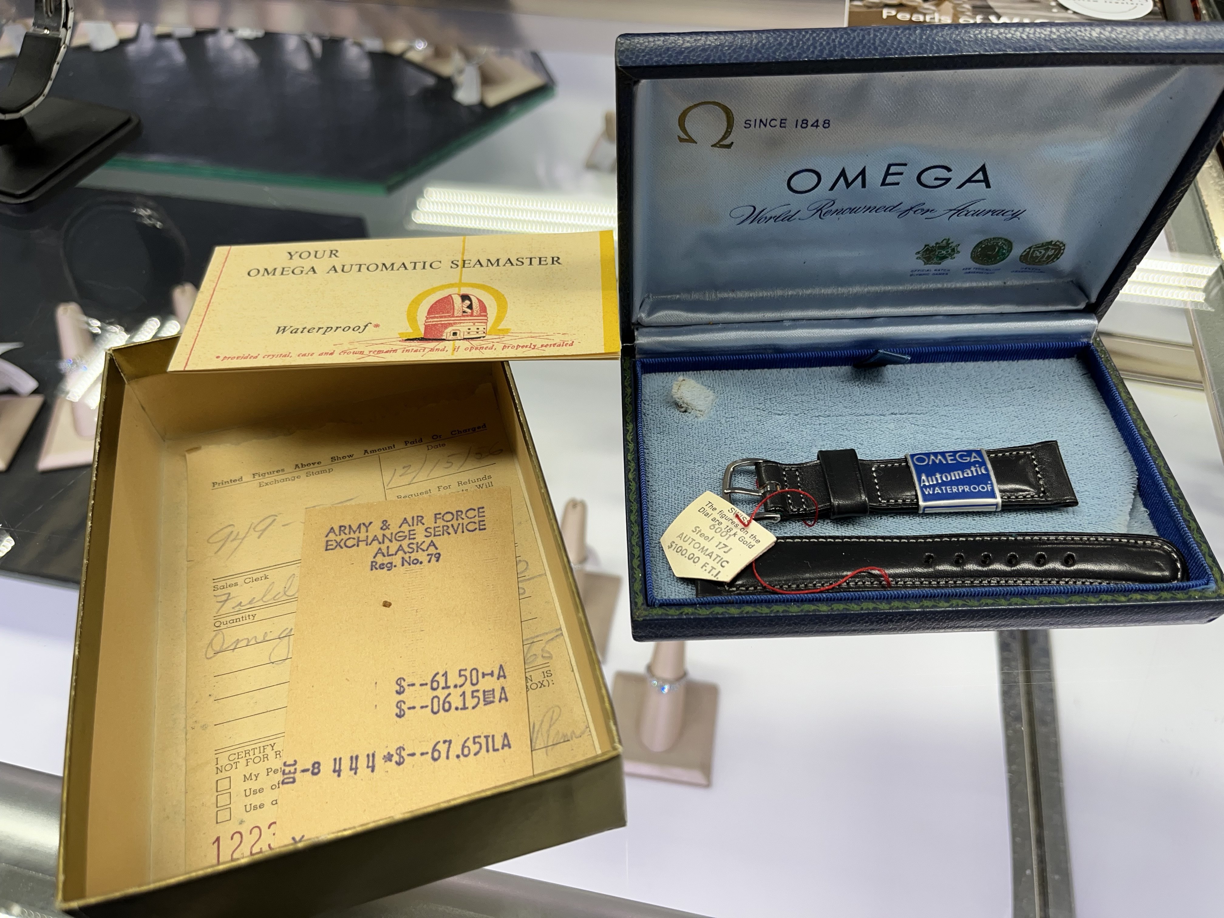

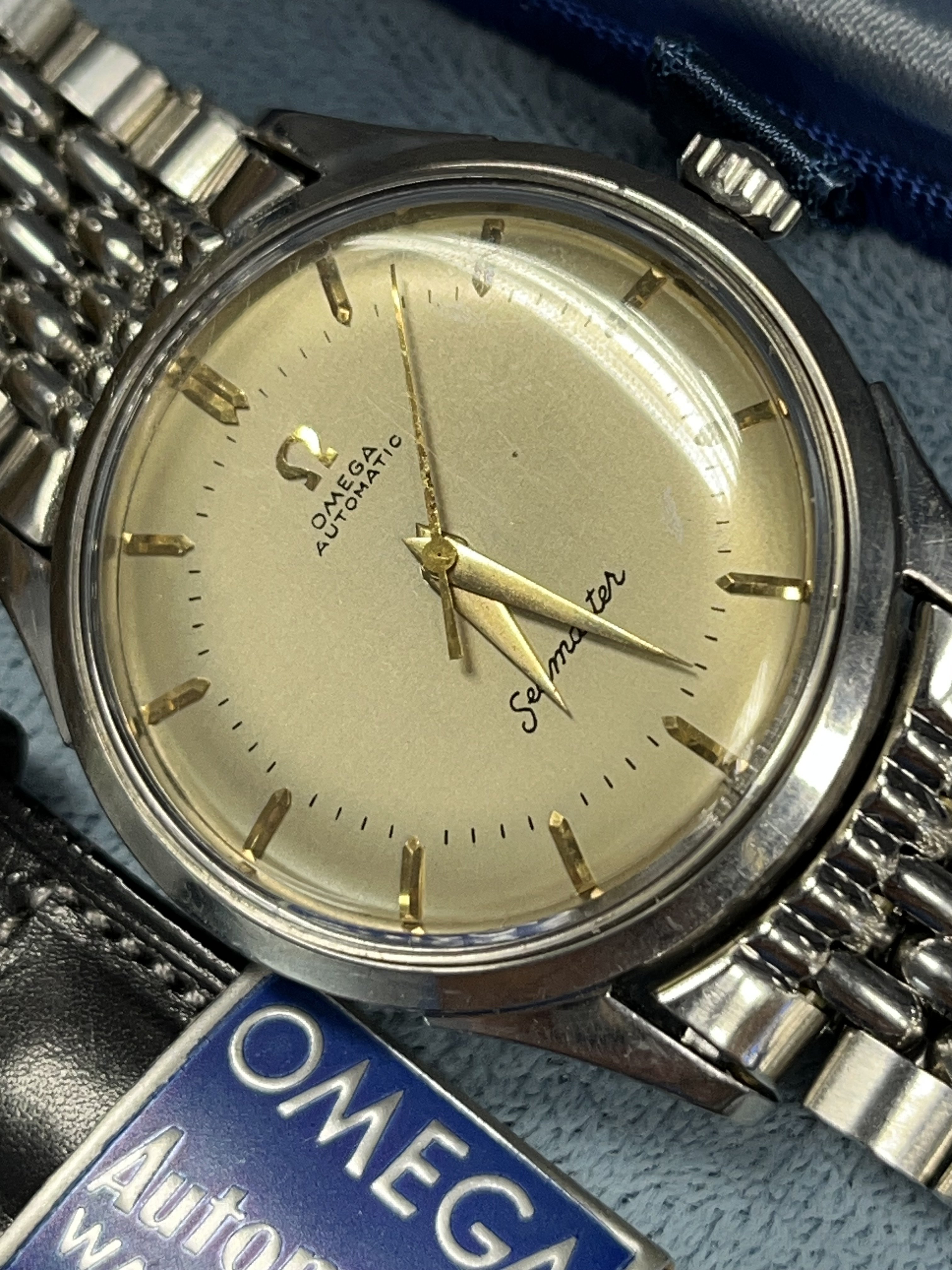

Hello my local jeweler has a customer whose family member purchased this watch in 1956 when stationed in AK. He kept all of the items you can see in the photo, including the outer box and even the receipt from the register.

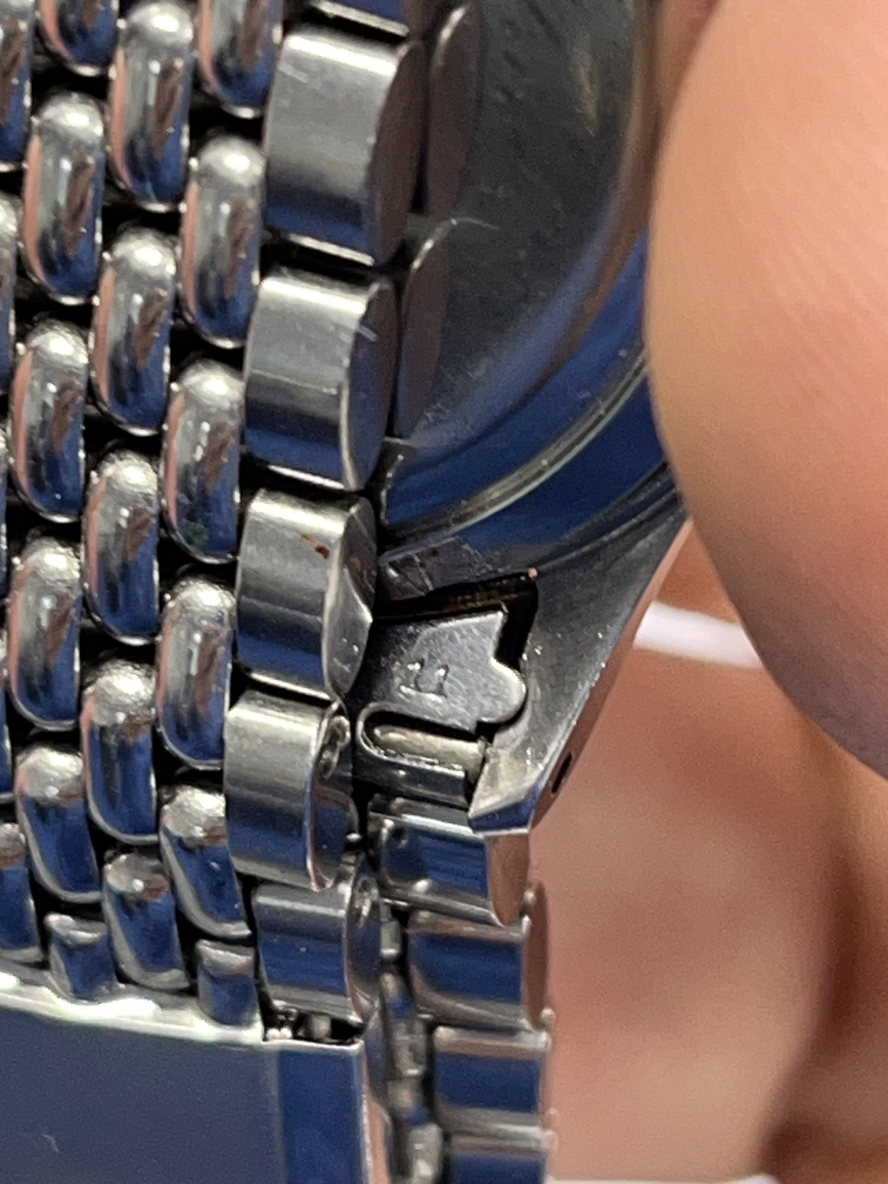

It comes on a BOR bracelet with that odd sliding clasp, and they also have an extra BOR bracelet with the large Omega symbol clasp (I think the latter would be the original one?). I informed him the dial might be redone, he was adamant that it’s original.
What do you guys think?
13,493
31,814

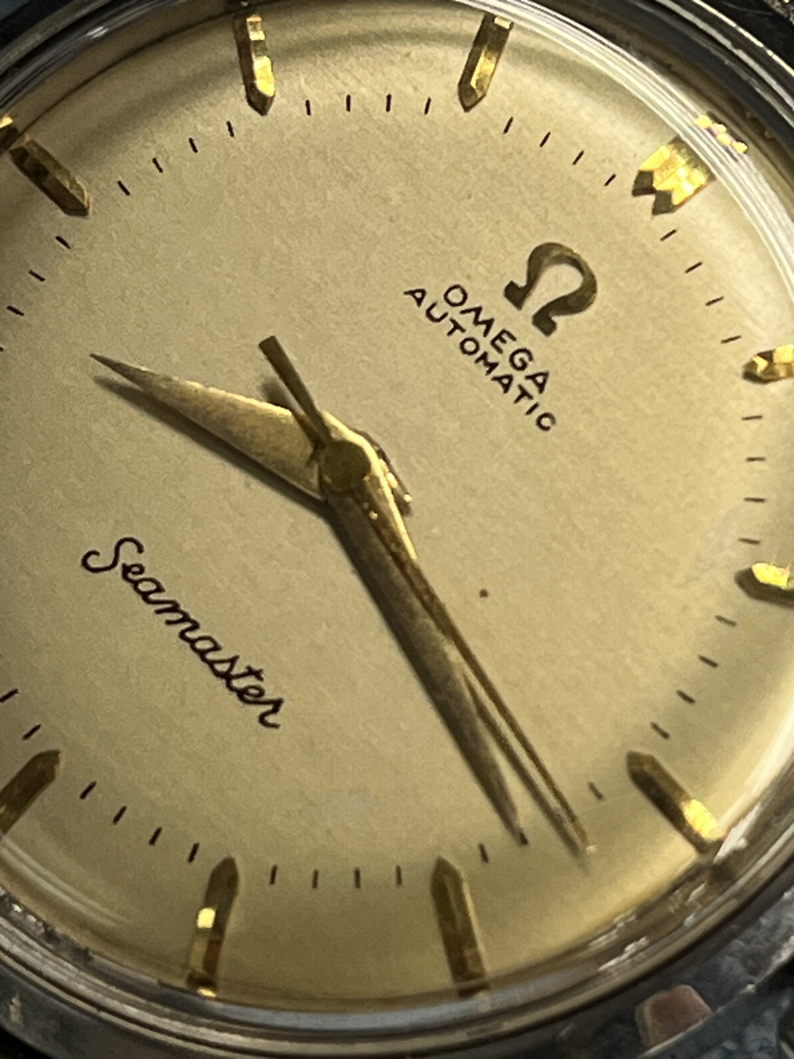

He can be as adamant as he likes, it's still refinished.

I’ll have to find out after I confirm to him the dial was redone.
As an aside- were (most/all?) Omega dials from this era signed “Swiss” (or similar) at 6 o’clock?
907
1,742
Other items to point out to the family:
Font is too small
Lack of serif on printing
Spacing between letter is inconsistent
The right leg of the "A"'s in automatic
The "G" in omega
The script e's in seamaster are wrong
The t is crossed too high
The S looks wrong
There's likely more.
