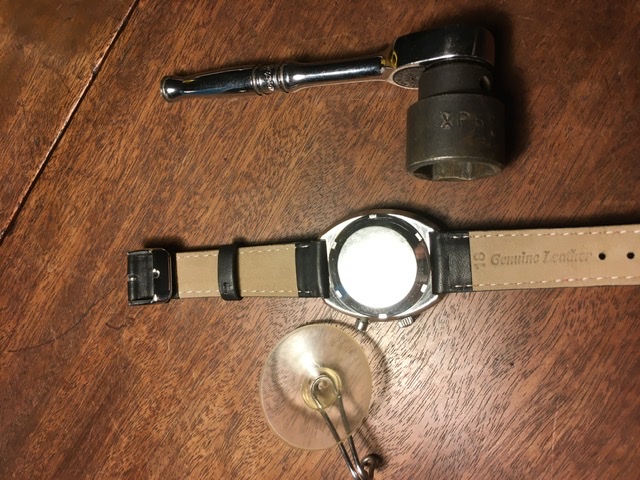

This set up worked for me one day in a pinch. Find a suction cup that is slightly larger than the case back. Remove the wire hook, and use a short ratchet, shallow socket, and great care.
I would suggest taking it to a watchmaker if this, or Con’s superglue/socket method doesn’t work. Good luck and be cautious!!

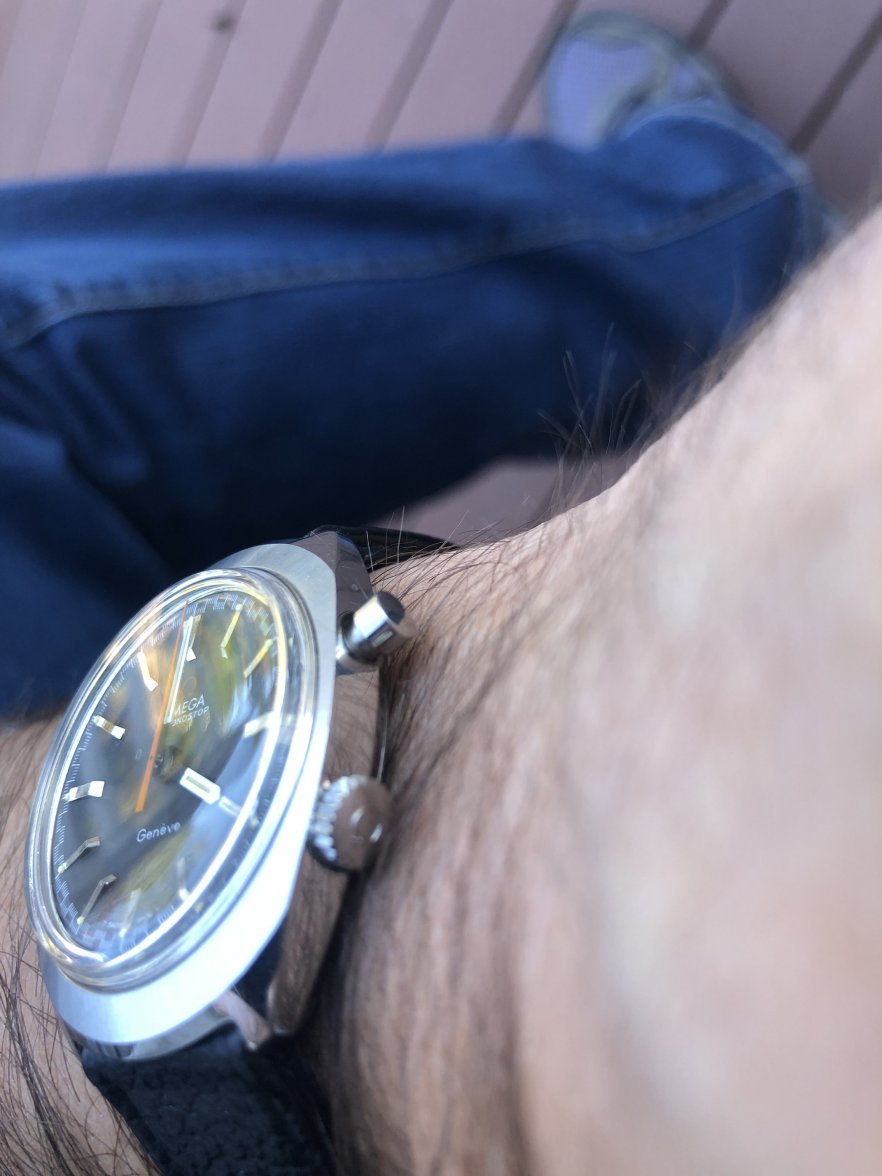

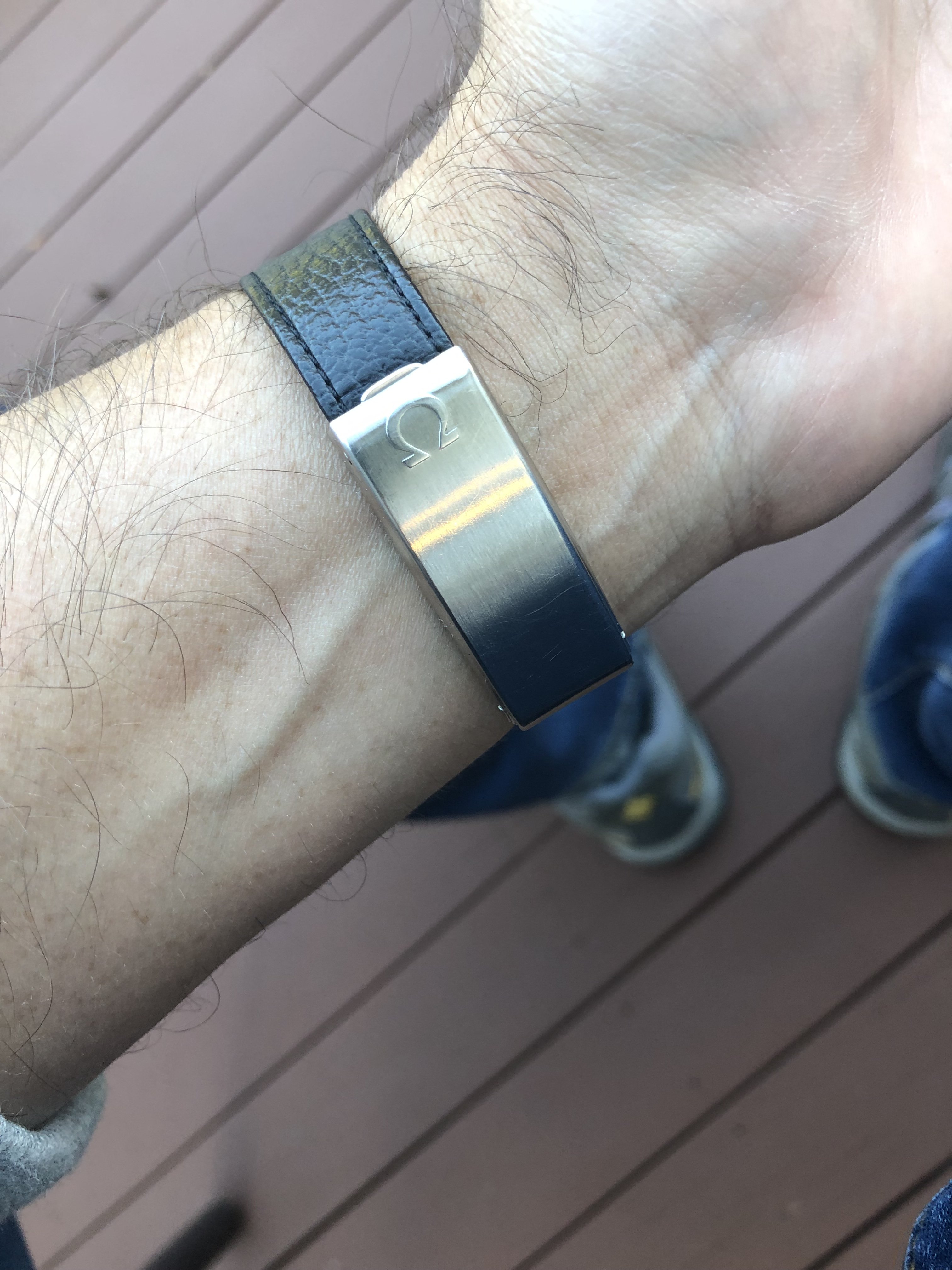

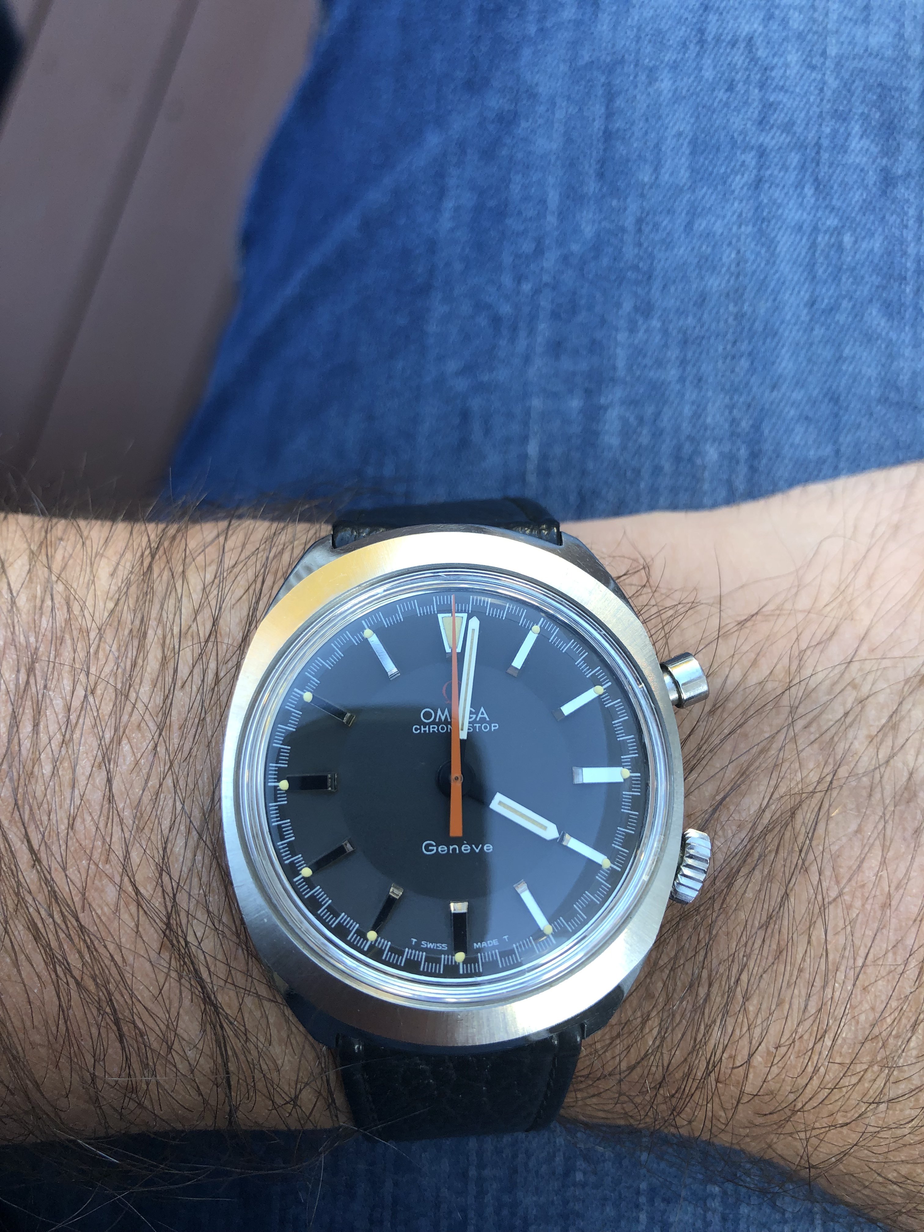

Here she is, everything appears correct. The brushing looks factory, no polishing (only the polywatch I applied), the crystal is signed and the strap appears to be original.
