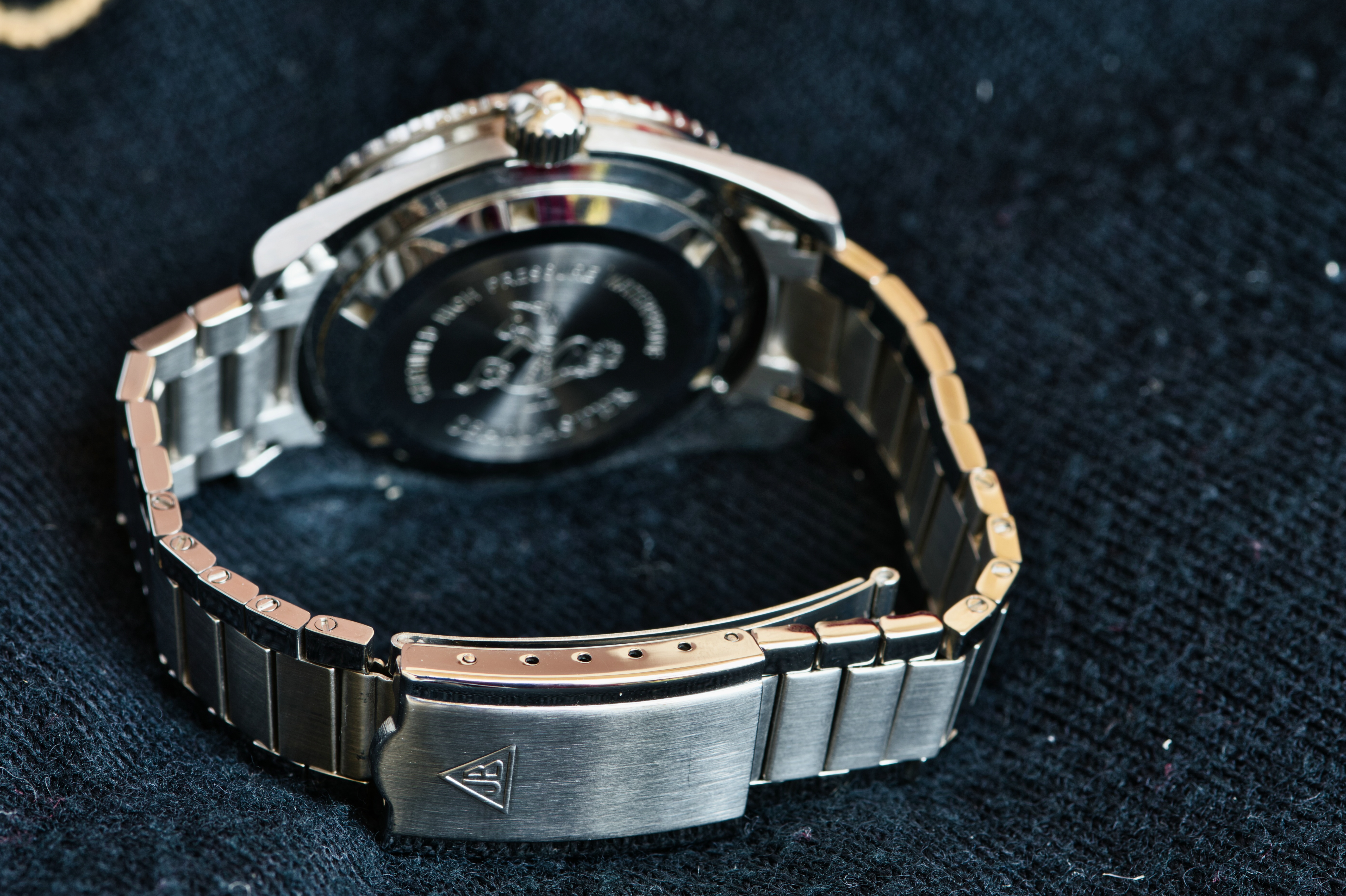

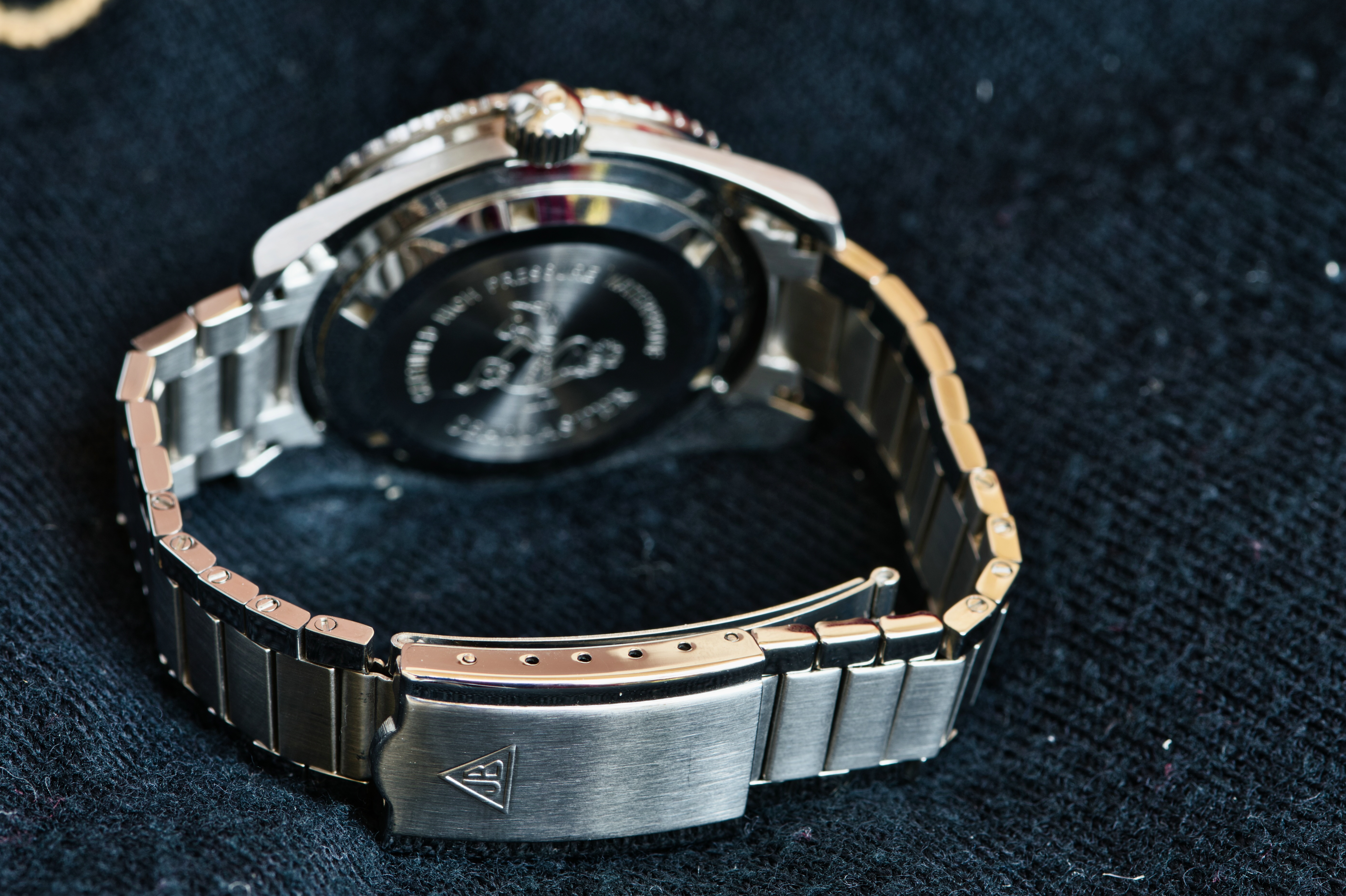

Insufficient space between the case and the lug holes, so the end link tips up. WatchCo Seamaster 300.
A friend of mine has the same issue on his 300 with the US, he simply shaved down the curved part against the case and it fit perfectly. Trimming hollow endlinks was a common practice back in the day

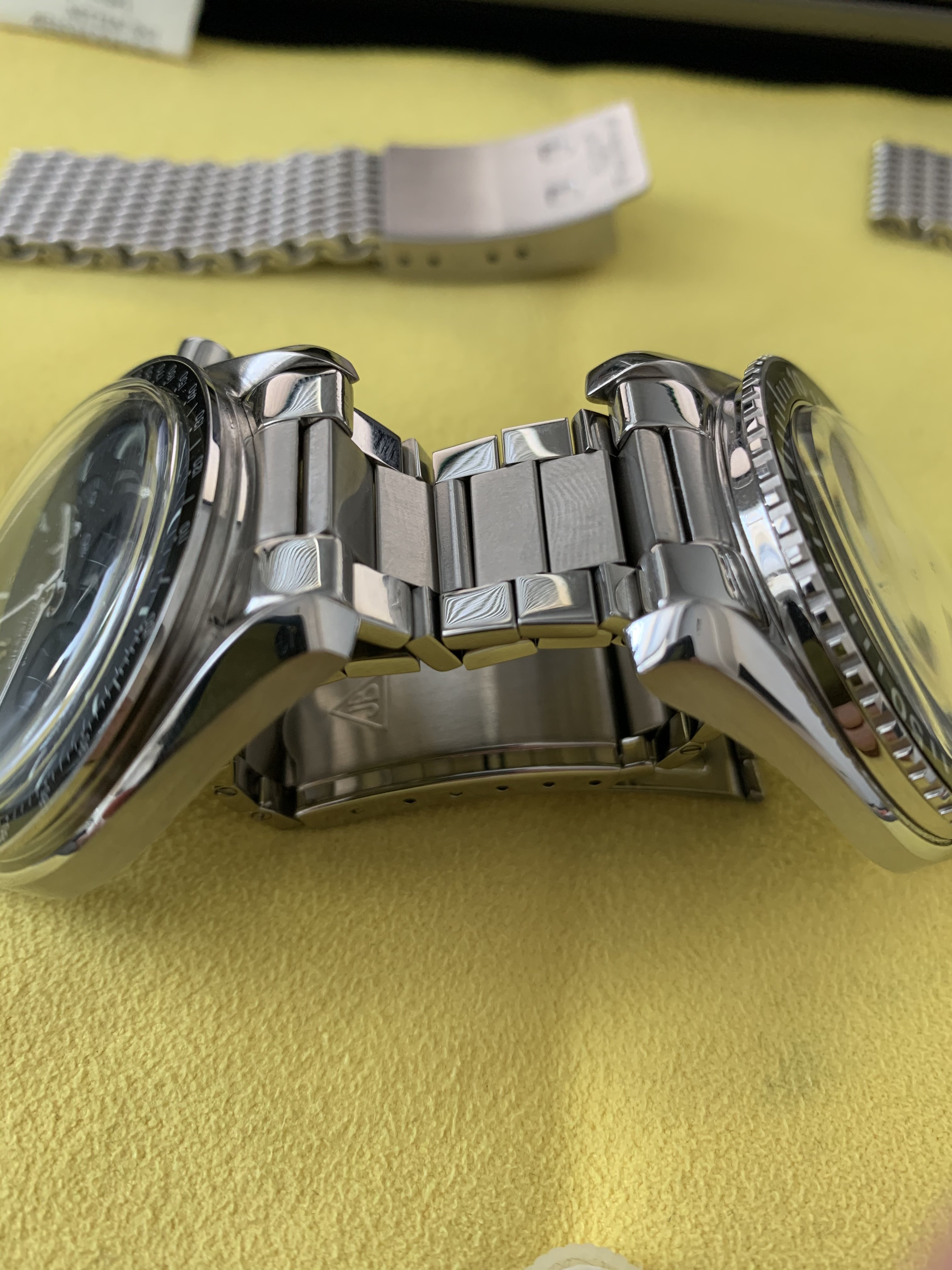

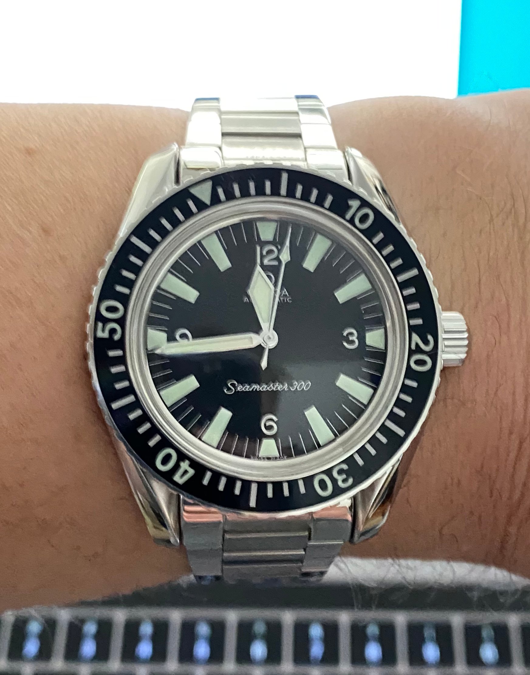

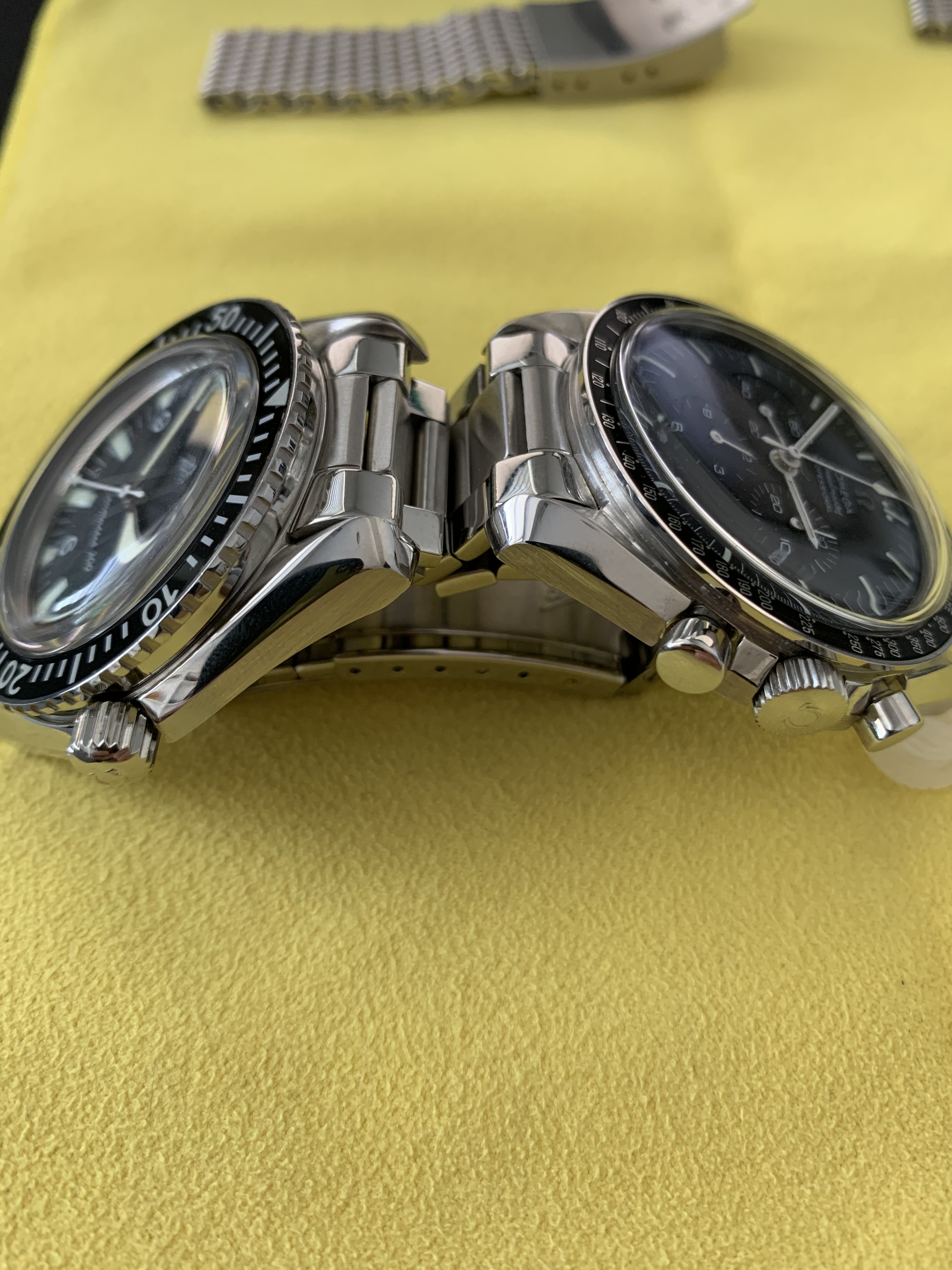

Can you take a picture from the side and a little elevated?
Thanks

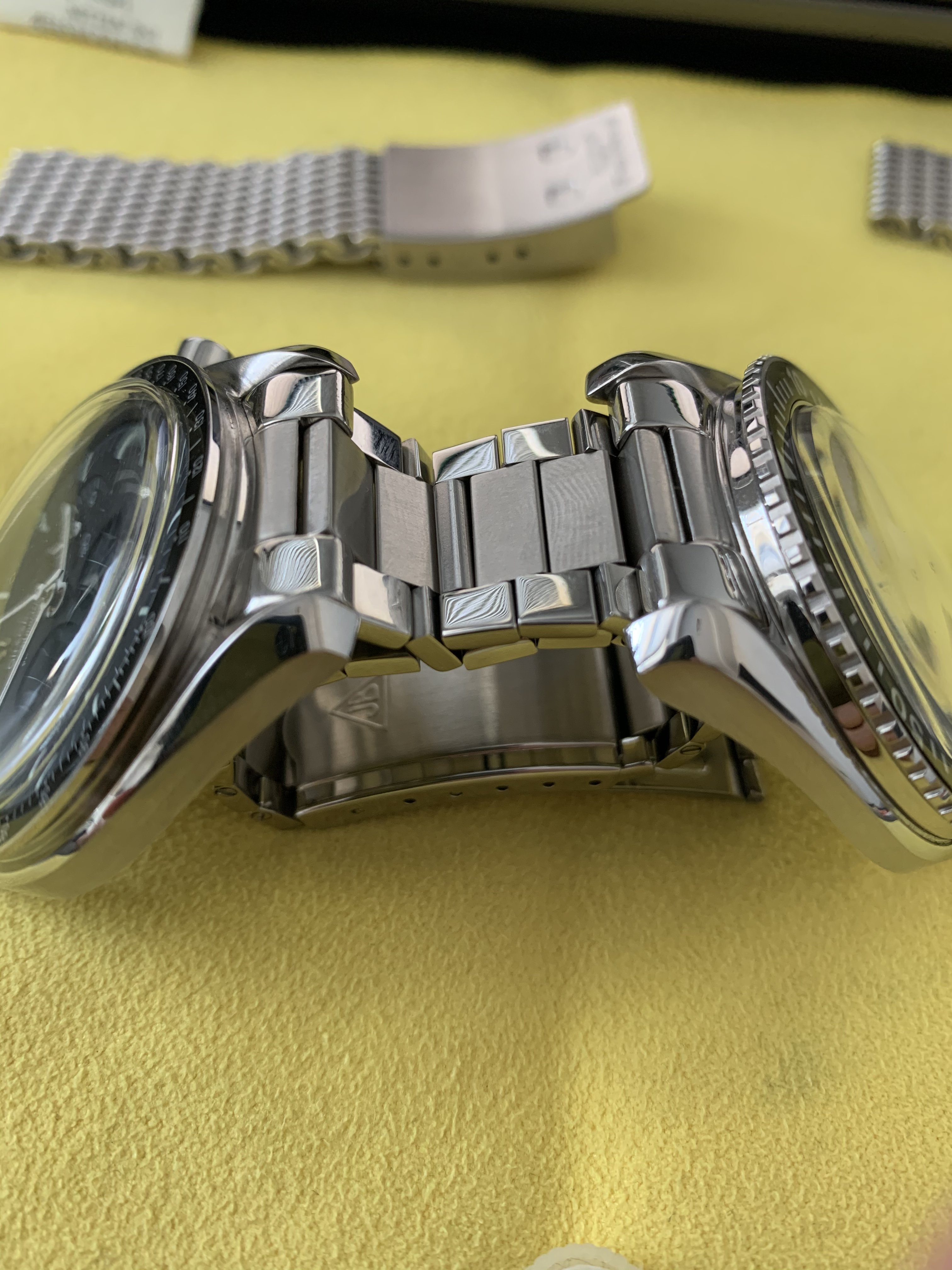

Thanks

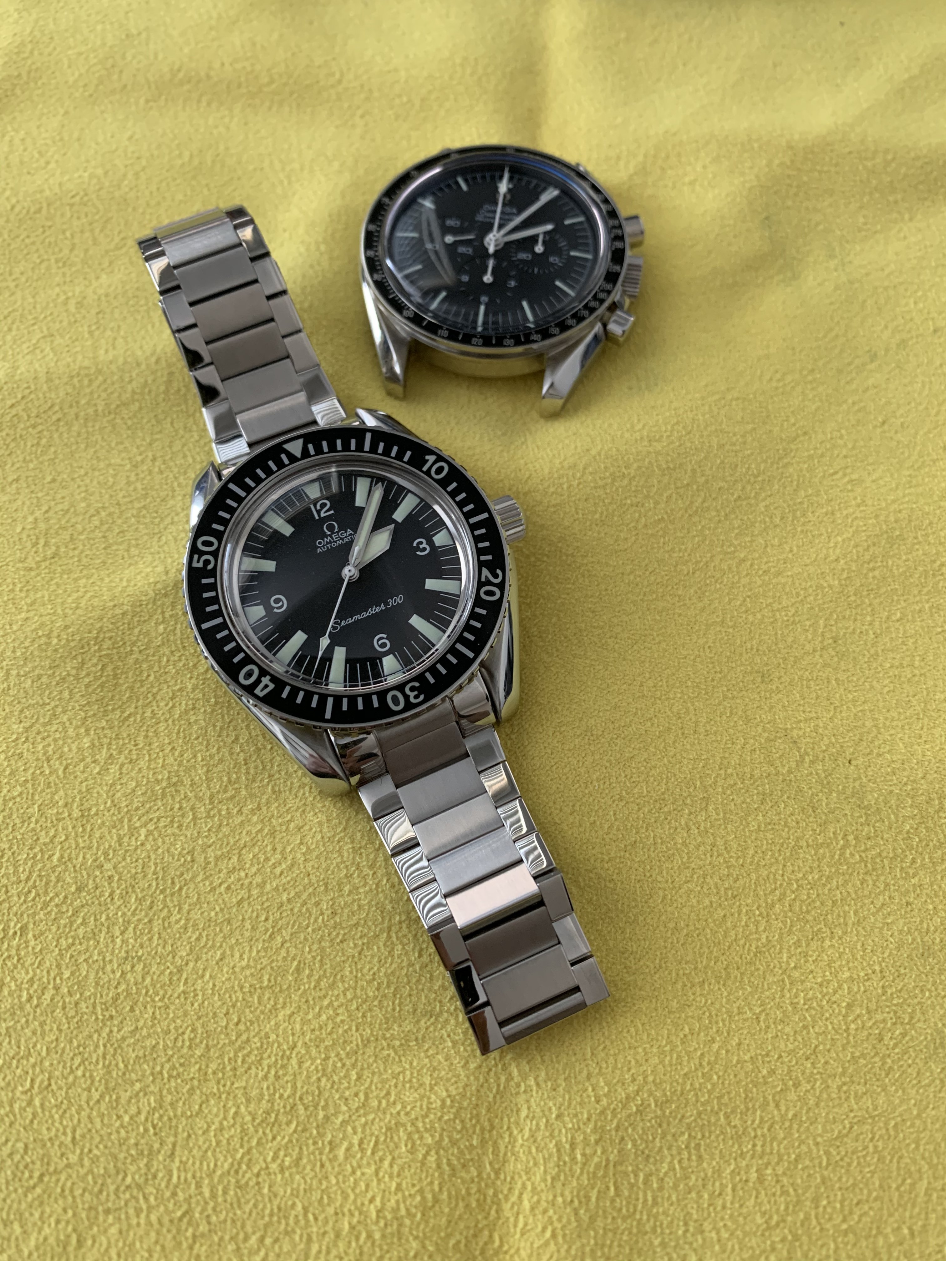

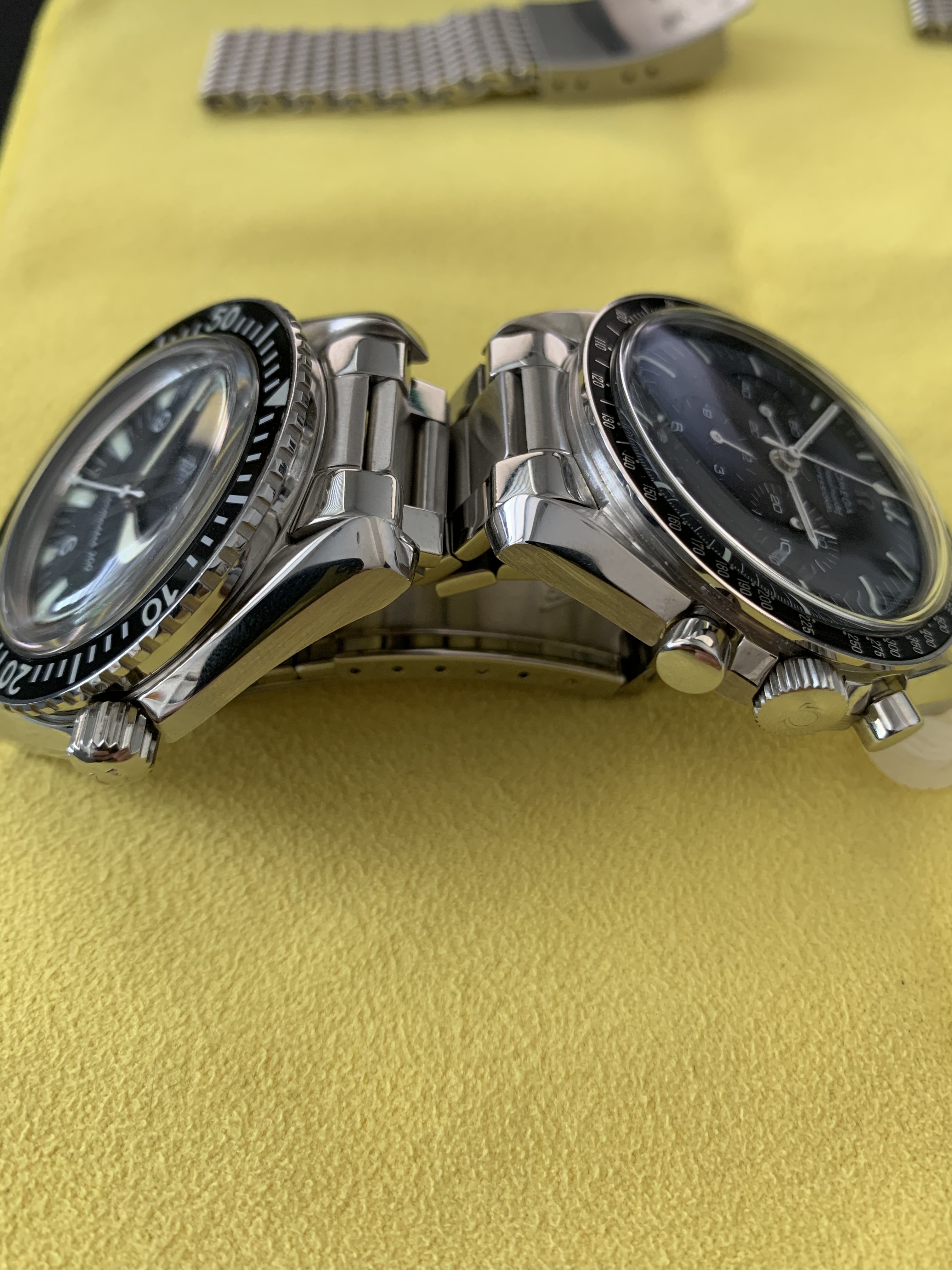

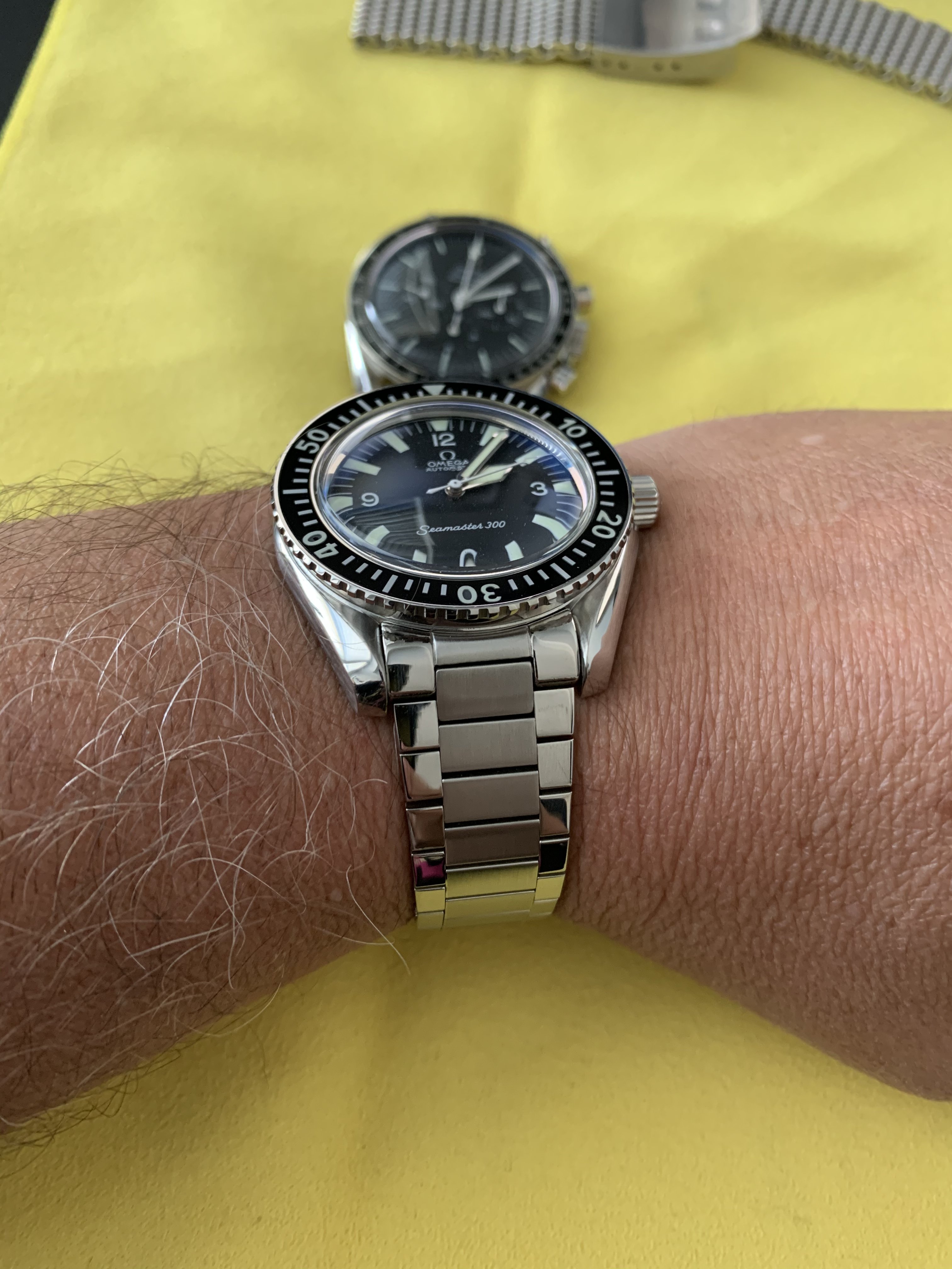

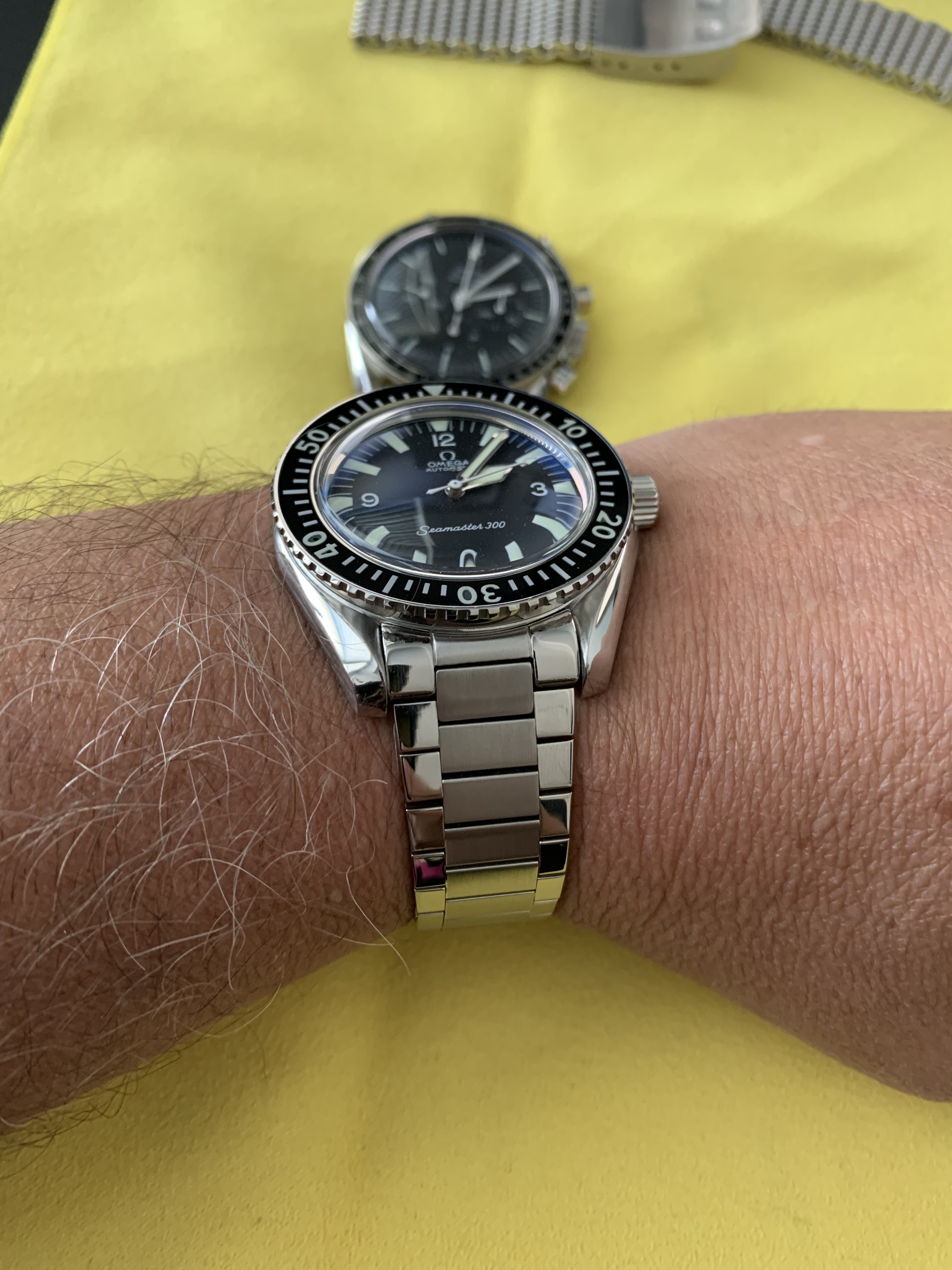

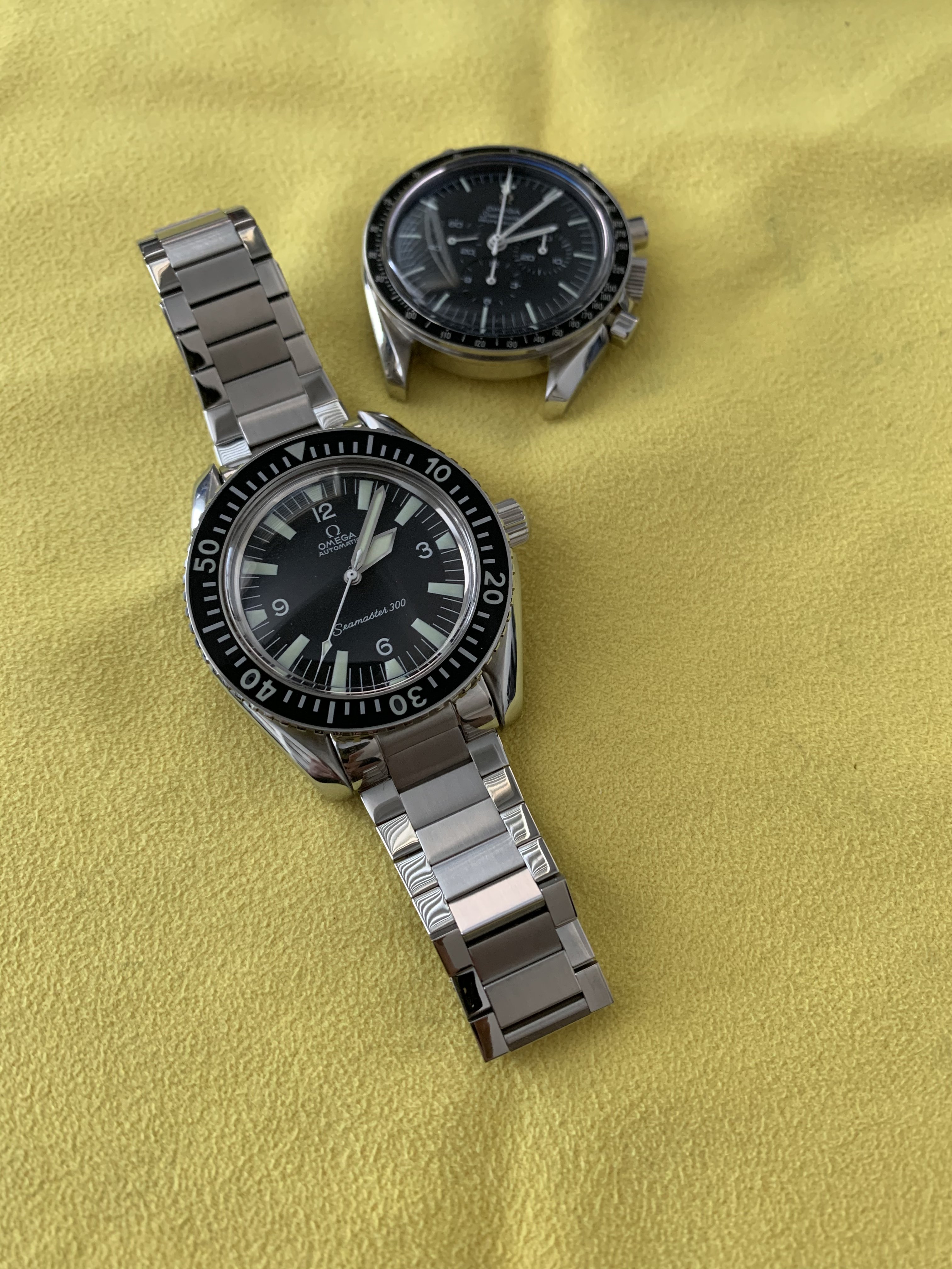

Sure. I attached one side to a Speedmaster (145.0012 case), the other to the 300.
I am not seeing any rocking or end links above the lugs.
5,631
5,815
Interesting, because the fit is not the same on the Seamaster 300 between the two pictures. It did move a bit.
What size spring bars? 1.8mm diameter?

I used the spring bars that were supplied with the bracelet. I didn’t measure them.
If you are referring to maybe .25 mm of movement as rocking, then you are correct and this isn't the fit that you want for the 300. (No movement on the Speedmaster) I can live with it and could possibly correct it with different bars if it bothered me.

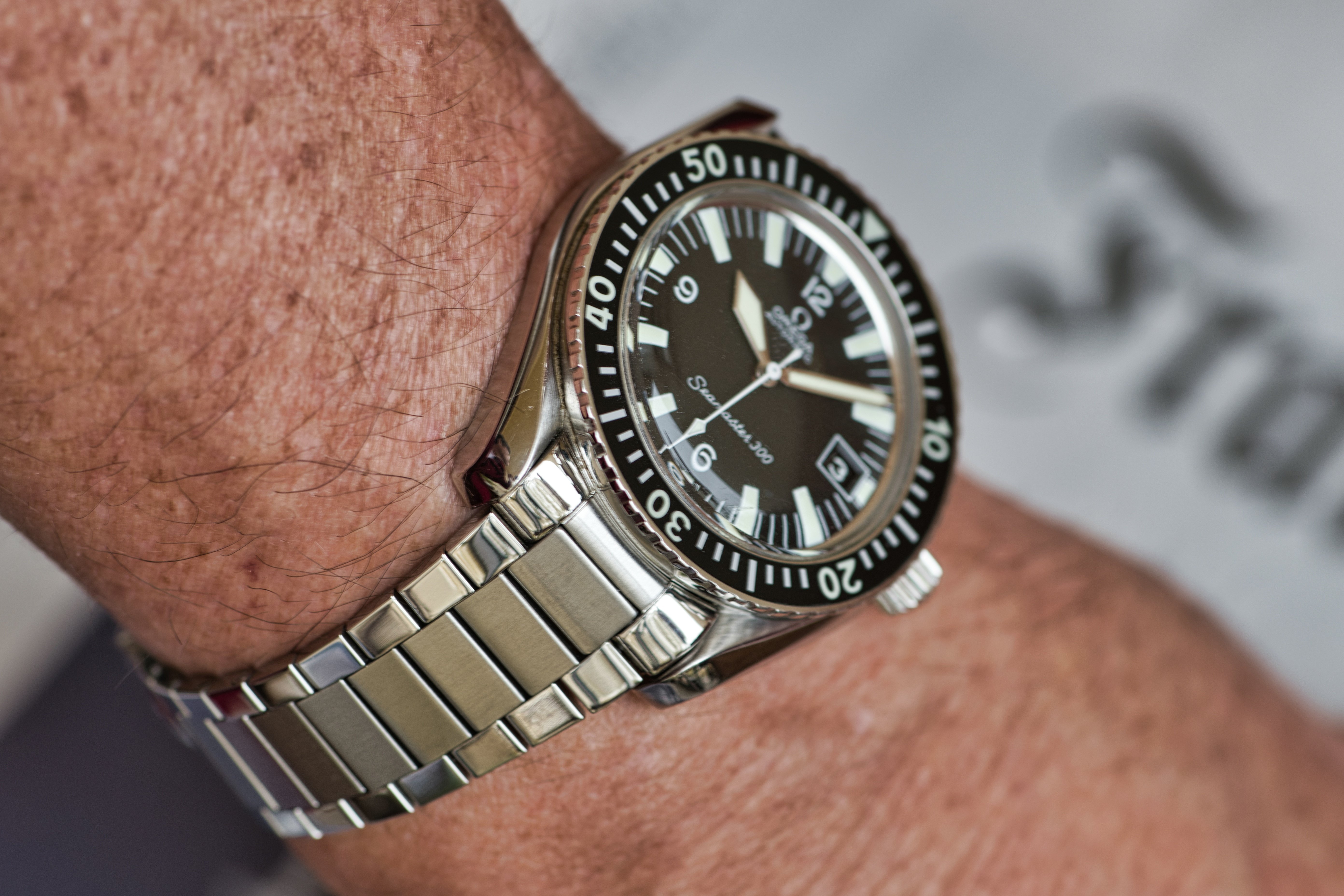

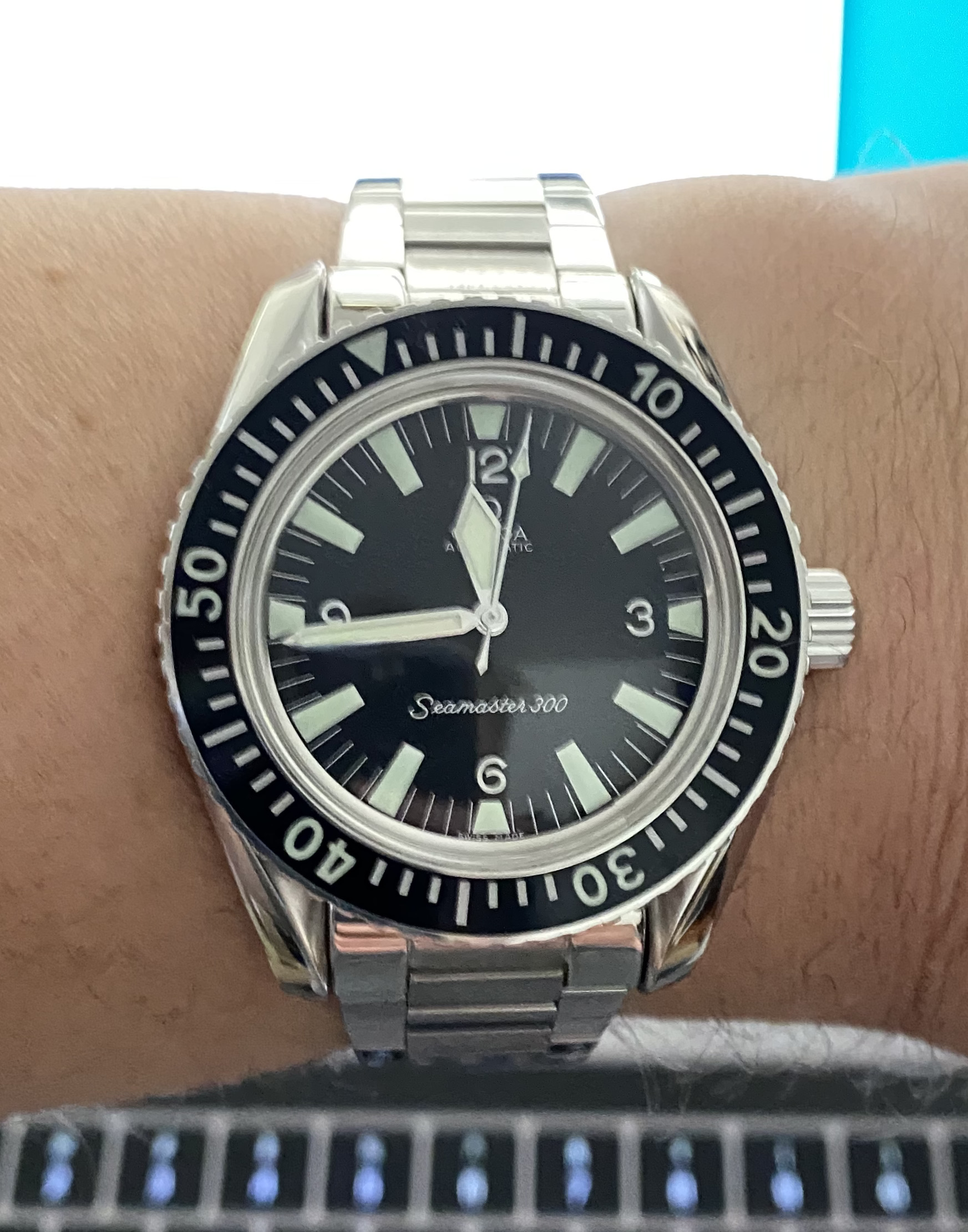

My new bracelet arrived today and I'll be darned... it fits well.
The test end links I was sent are not the same as the production end links. I also found that the mechanism to keep the clasp closed is not the same as Omega, so you can't just change the clasp cover... you have to change the entire clasp. Luckily it is interchangeable with the clasp for the 1171! If you want to do that, the order number is 117ST1171.
By the way, I found out the hard way that the clasp pin comes out one way and not the other. So if it you can't push it out from the one side, try pushing it out from the other.
My watchmaker will adjust the bracelet for me otherwise because I don't want to bugger up the screws.
Very excited!
5,631
5,815
Met my watchmaker at the park down the street and he took three links out for me. Loving it!
