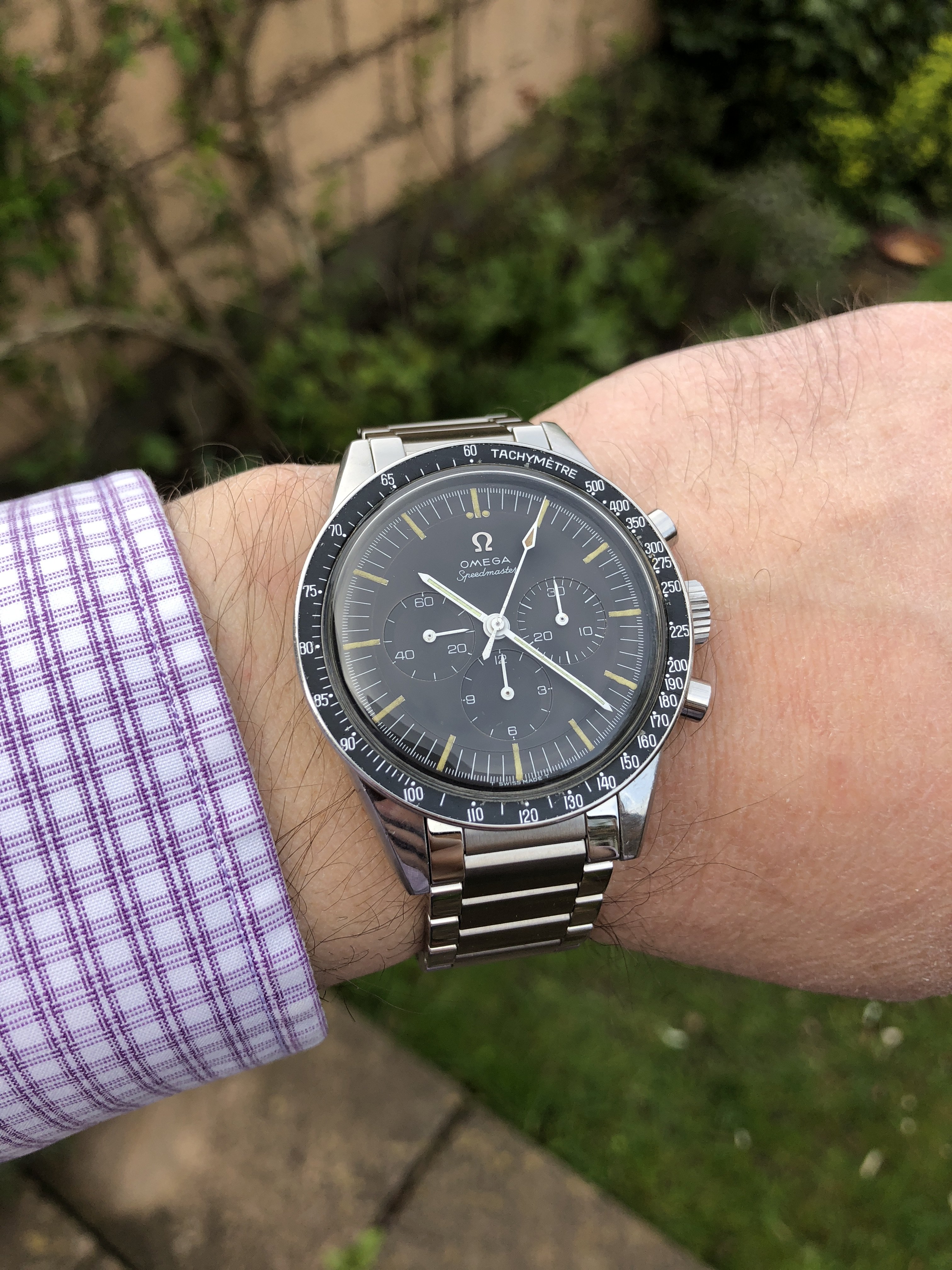

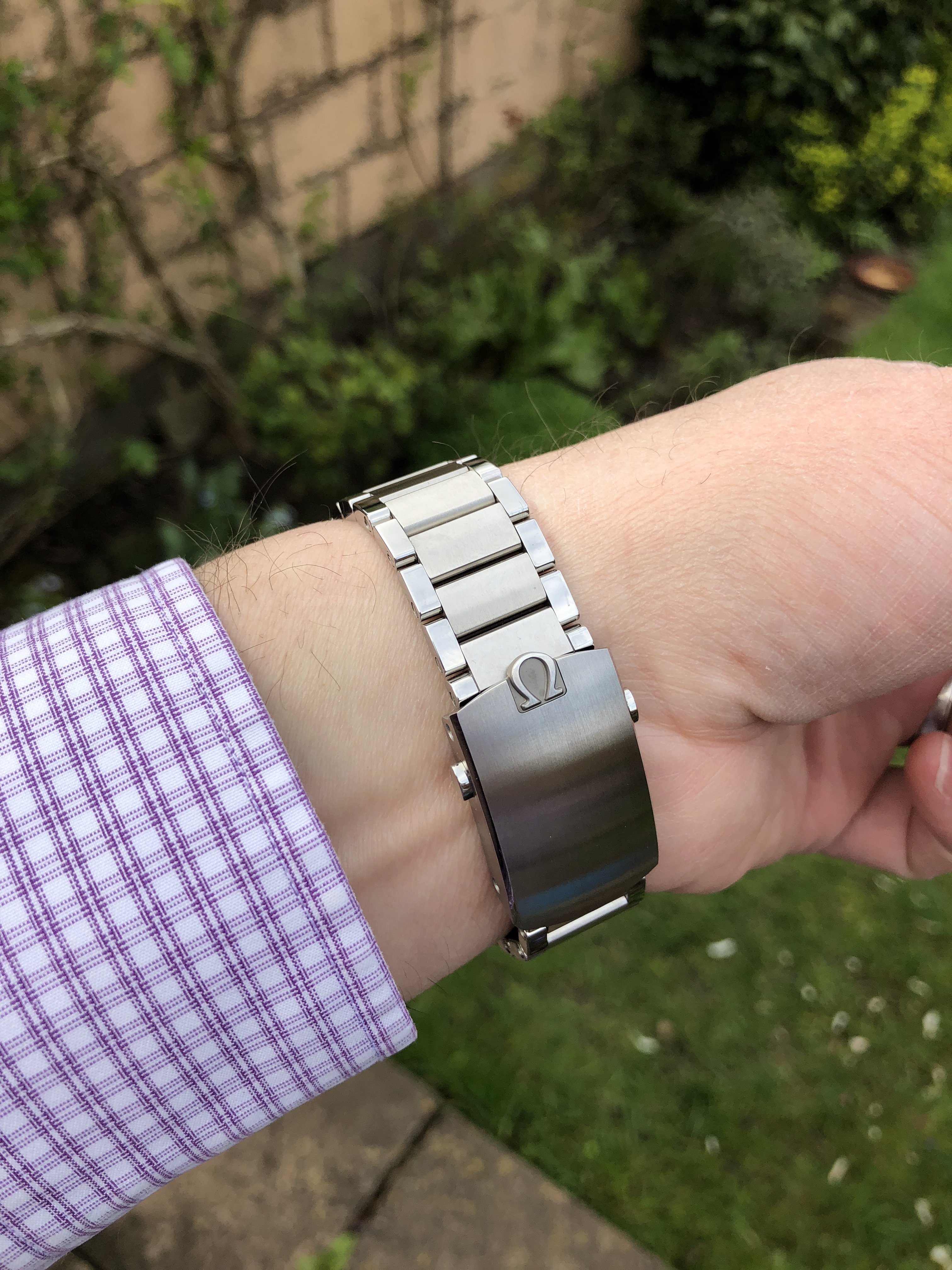

No it doesn鈥檛, many have tried and it doesn鈥檛 seem to fit, but conversely the trilogy bracelet (Seamaster in fact in this case) can be made to fit the the Ed White. This suggests the various straight lug models do vary in spring bar hole position if only slightly. If there is some leeway in the end link then there is still a chance of universal fitment I guess. See I鈥檓 an ideal guinea pig lol.
Here鈥檚 my EW with the trilogy SM bracelet fitted:

Interesting! Looks like I may need to make several different 19mm end piece options.

The trilogy bracelet end links are very tight on their respective watches. If your design is more in keeping with the originals ie has a little more slack/tolerance then maybe a single 19mm end piece may fit the various straight lug designs and the Trilogy watches too. I do believe the 1998 bracelet works on the latest Pro watches and indeed on all Pro cases (and Broad Arrows too). I think the anomaly is the FOIS. The hole spacing on that one does seem different to the earlier (and Trilogy) straight lug watches. It wasn't designed for a bracelet after all and isn't necessarily a faithful copy of any original straight lug. The FOIS bevels for instance are not seen on the 2998 or EW.
