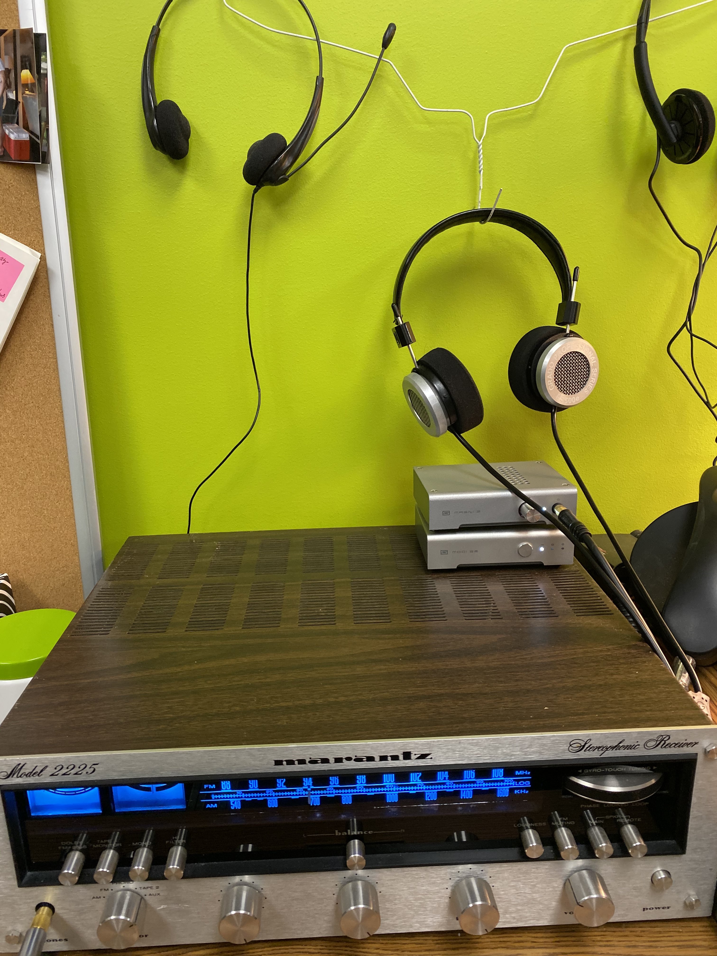

Man, now I miss the Marantz 2225 sitting on my office desk more than ever.
Love the coathanger!
Thank you! My custom transversely mounted powder-coated steel rod headphone suspension apparatus has served me well since I moved into that office in 1996.
Wow, I didn't realize it was a 25 yo VINTAGE coathanger as well. Well done.
Same here. Hardly any patina on that coat hanger.
Keep your eyes open for the LE 25 year celebration special coat hanger that’s coming out soon.
