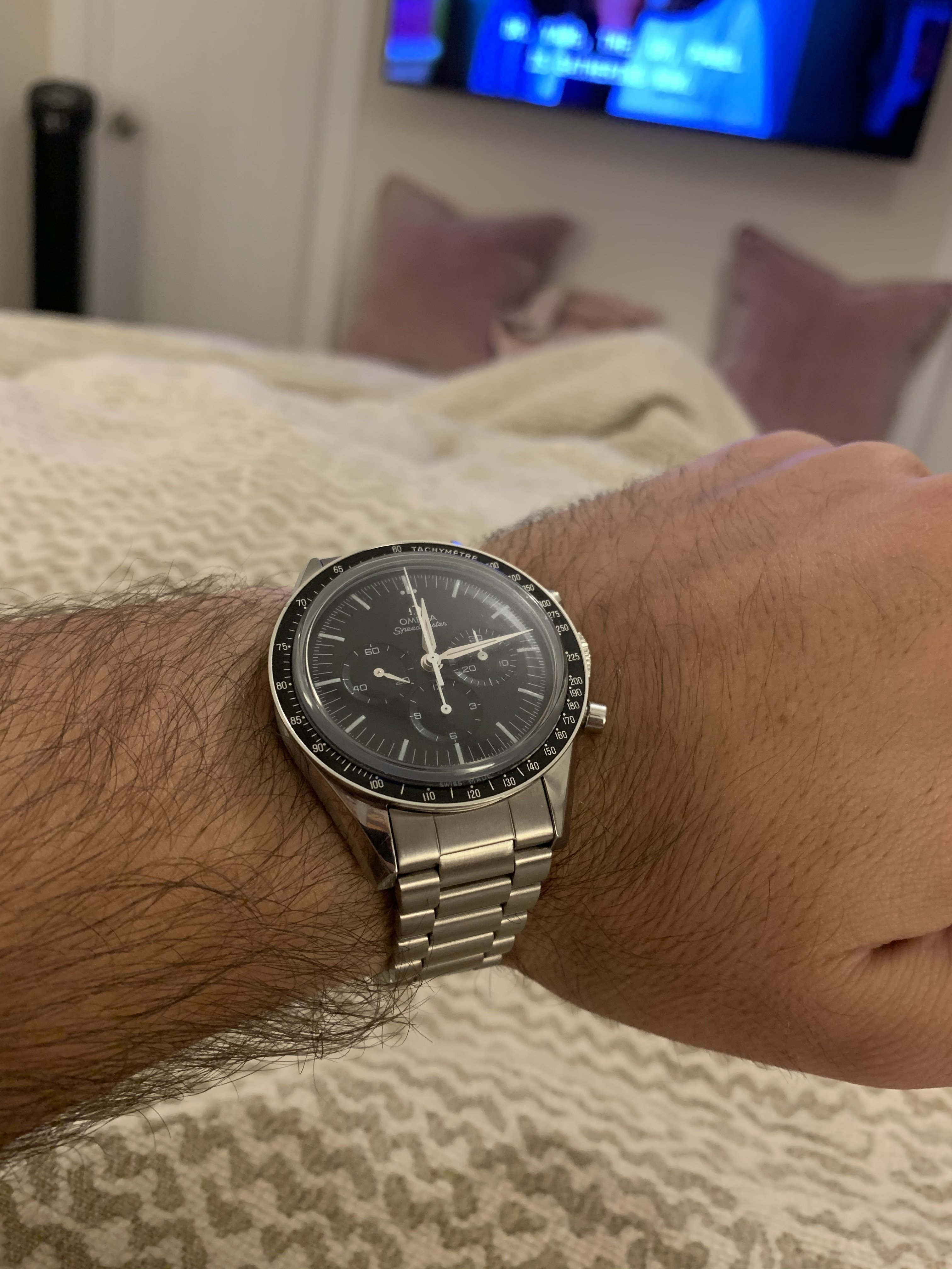

Just got my Uncle Seiko 1171 bracelet in. I already have a few watches on nato/leather but loved the FOIS (size, hands, applied logo), so I rationalized I could put it on a bracelet. Little did I know the headache that would be involved on getting that right via the OB, so decided to try one of Uncle Seiko instead.
I have an Uncle Seiko tropic on my vintage Seiko 6105 and its my favorite strap, so I inherently trusted it. Arrived in the mail, took 30 minutes to size it and get it on the watch head.
Pros: the fit is excellent, the micro adjustment works very well (maybe because I usually wear a Grand Seiko in bracelet without micro adjustment, but this is awesome). It looks like a real 1171, heavy enough to not feel cheap but lighter than modern bracelets. AND NO RATTLE!
Cons: folded end link. Did I mention folded end link? It was kind of a b**** to get on, but now that the hollow end link is on it looks great - and most vintage bracelets were hollow end link anyway, so it didn’t bother me once it was on.

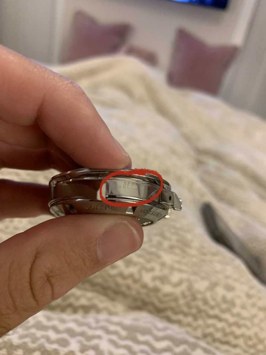

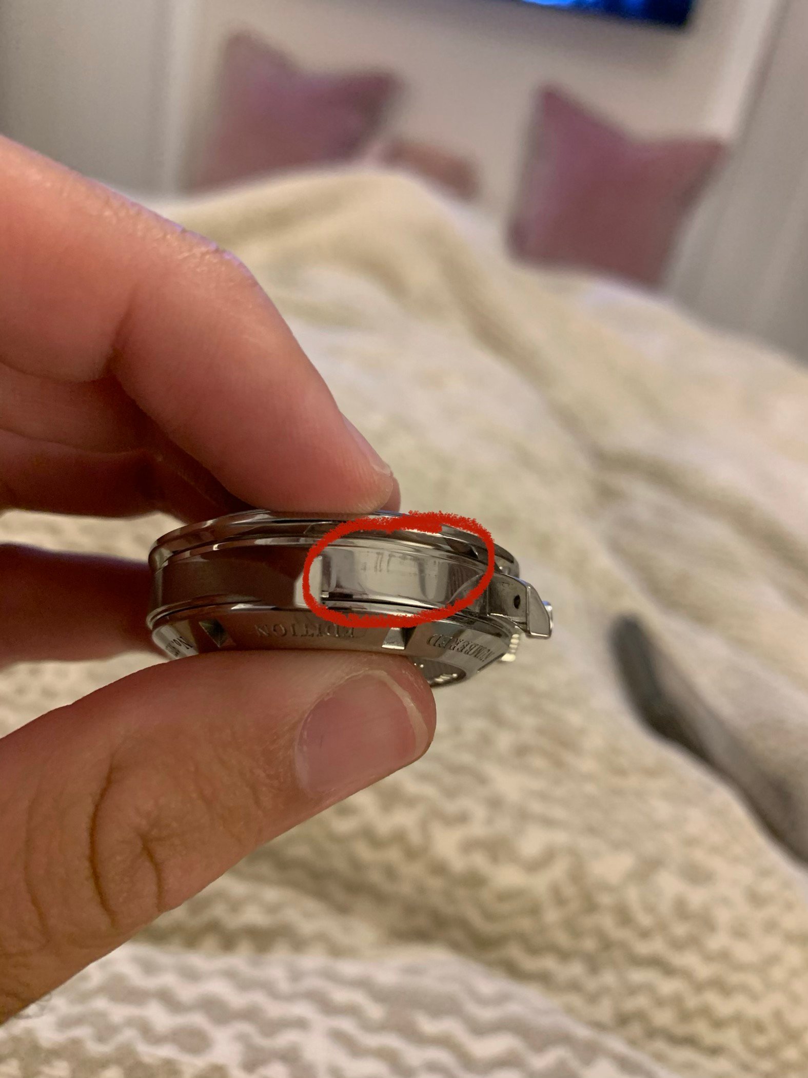

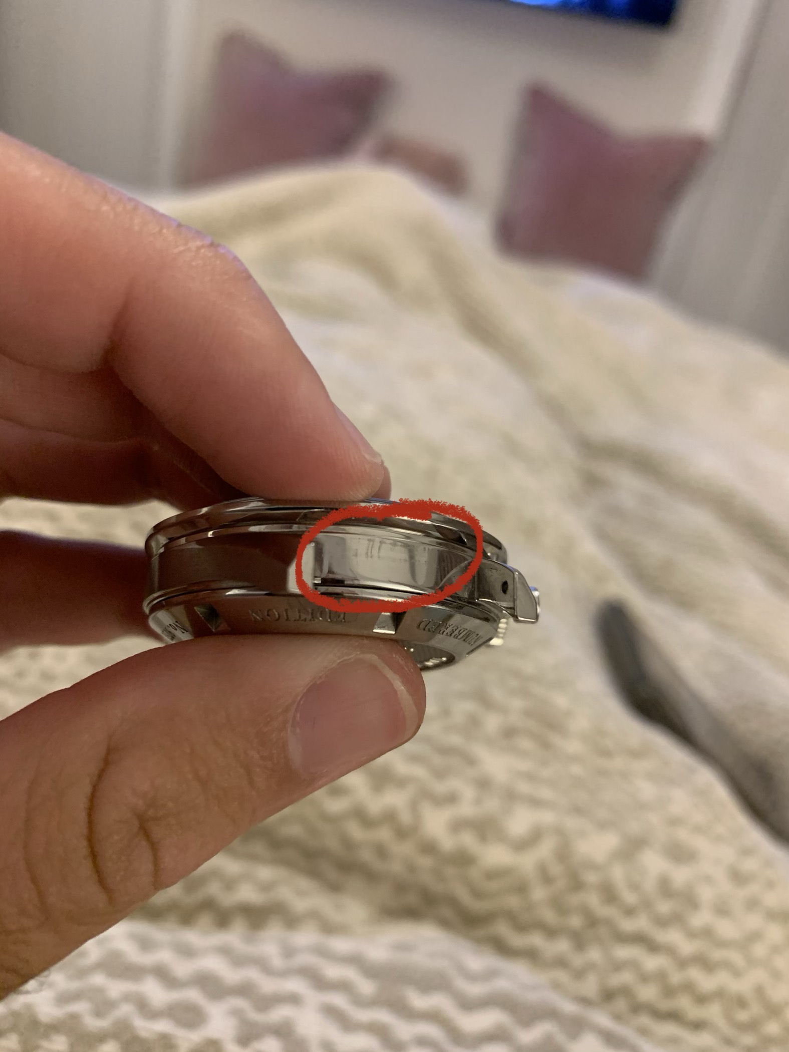

What has bothered me, though, is the absolutely absurd amount of scratches to the watch body between the lugs. You can’t see it with the bracelet on, but if I were to ever switch back to a nato or leather it would bug the ever living hell out of me. The scratches are so deep that my finger nail catches on every single scratch. I actually emailed Larry at US with the same pictures, and he said he hadn’t heard of this before but assumed it was normal.
So if it was your FOIS: would you keep the US 1171 and just ignore the scratches, or would you find a vintage 1171 and deal with trying out the right end links?

Im not exactly sure. On most watches, if the end links are not perfect, the small movements when wearing a watch cause the end link to rub the watch body and cause the scratches. My Grand Seiko SBGA211 actually does this with its solid end link titanium bracelet, but not nearly as deep or bad.
If I had to hazard a guess, it would actually just be the end link being folded hollow and not being 100% perfect. I don’t think it’s from the installation (it’s possible) as the scratches are vertical, and there wasn’t any vertical motion when putting the links on.

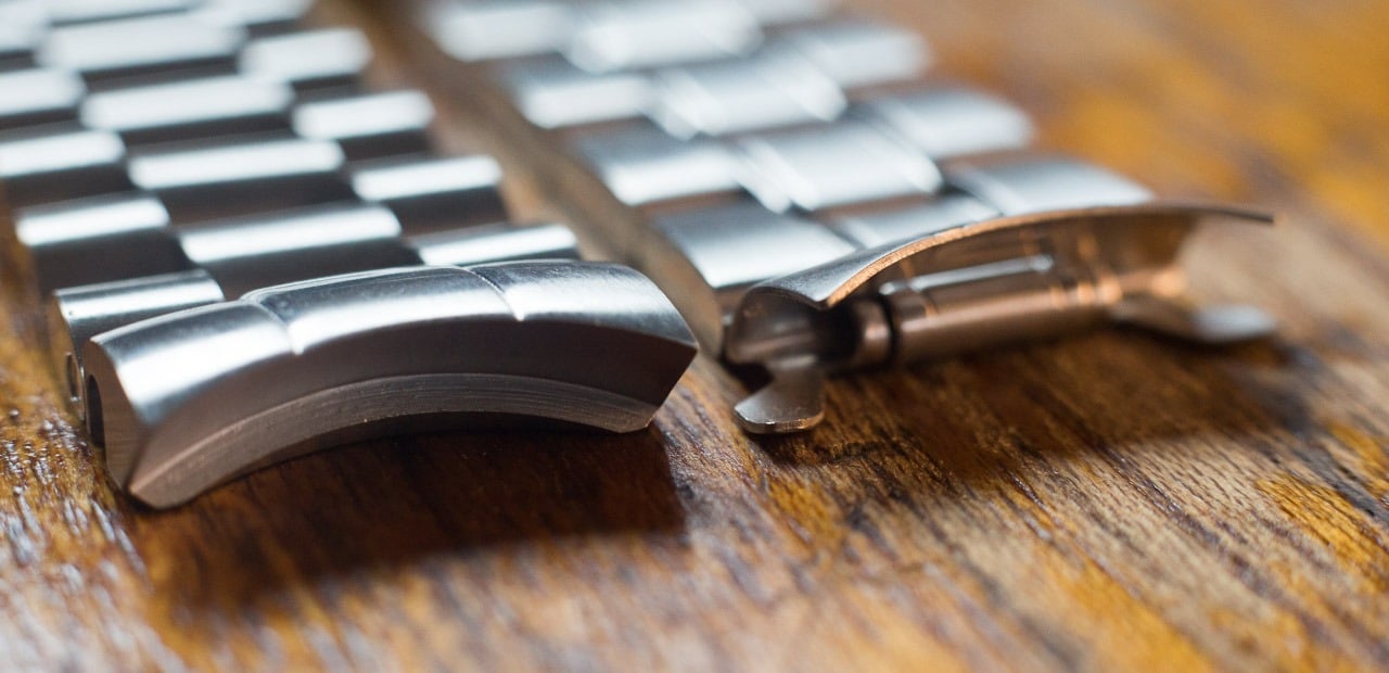

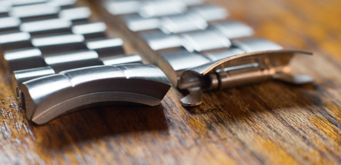

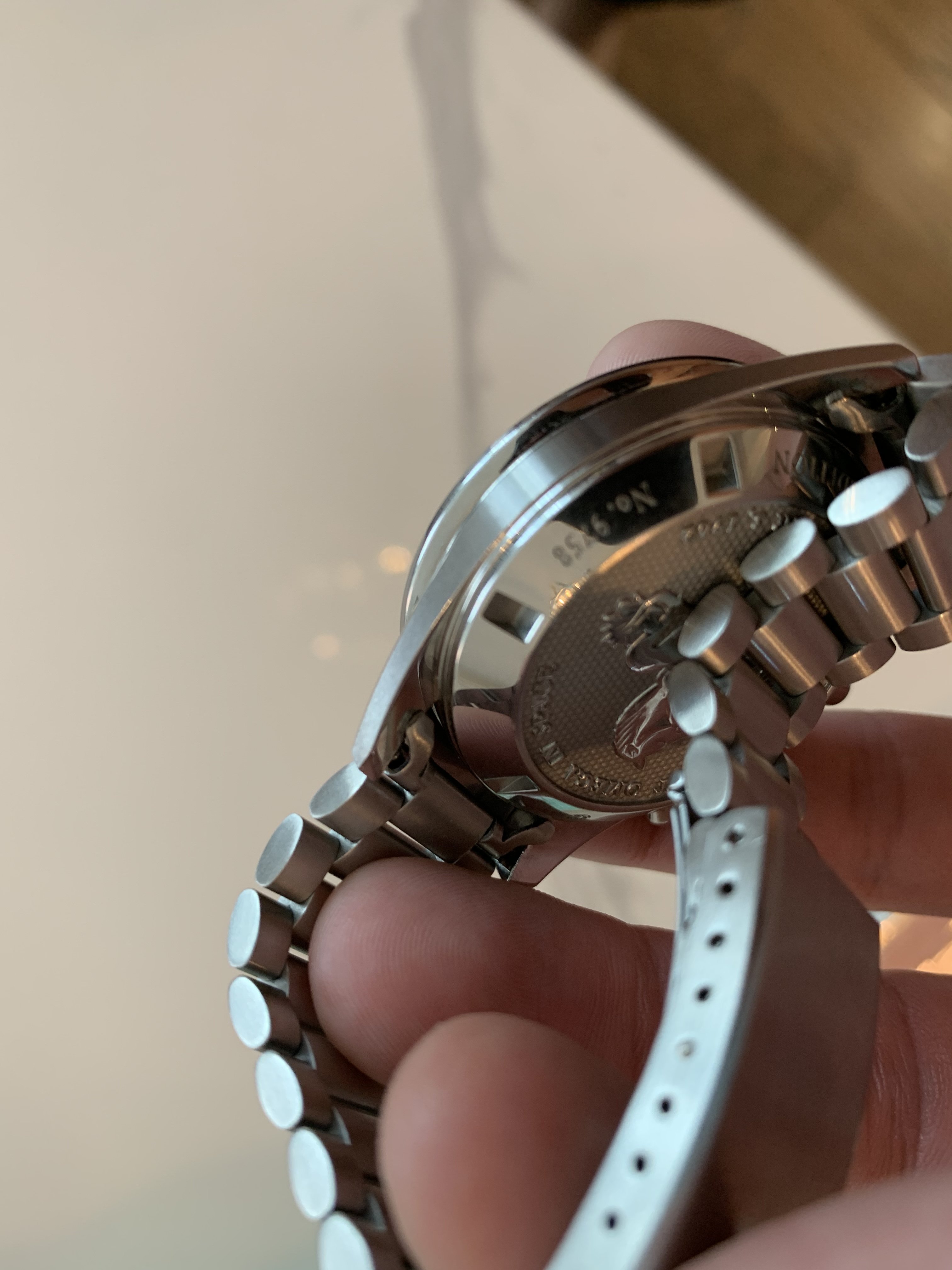

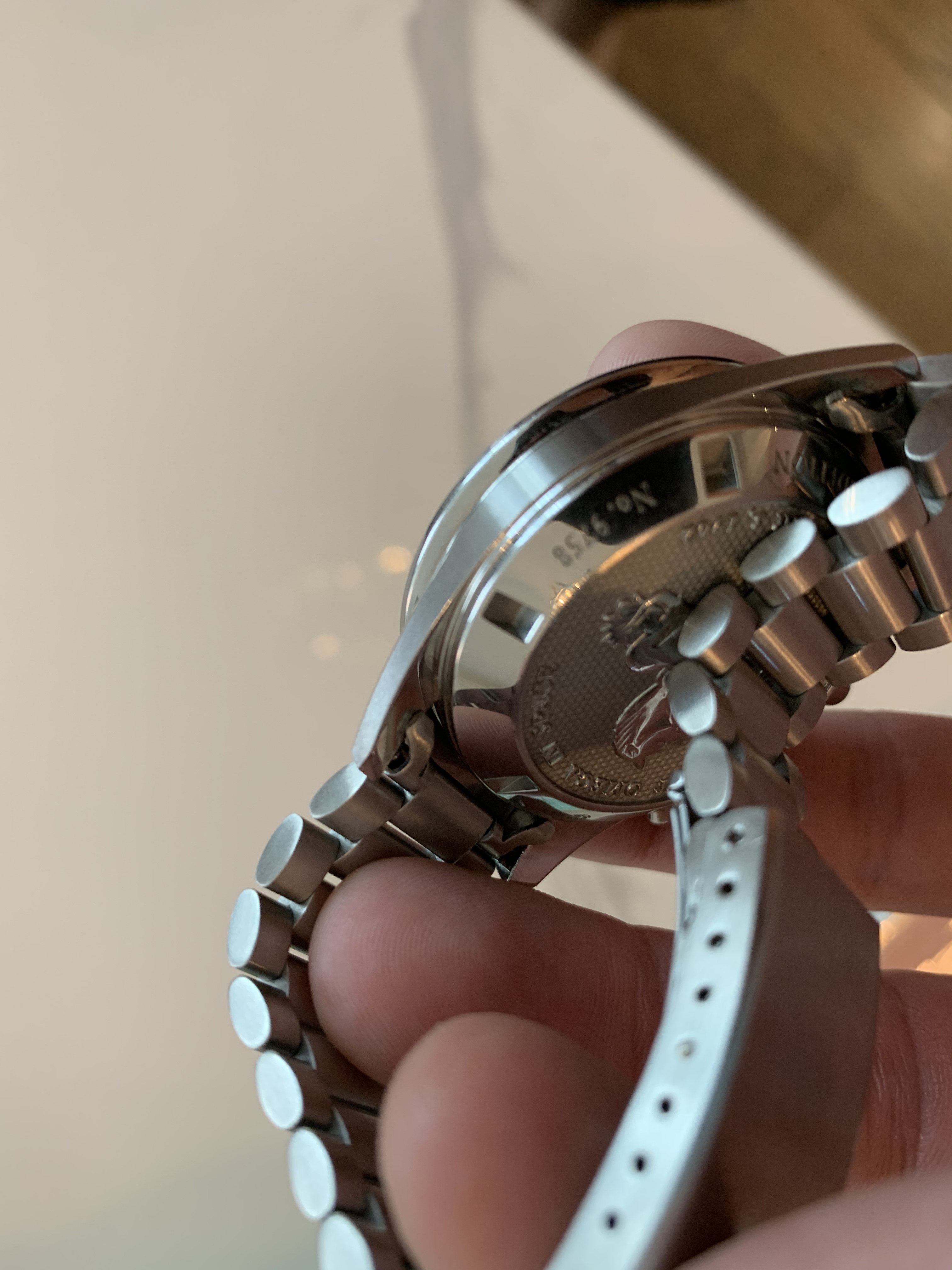

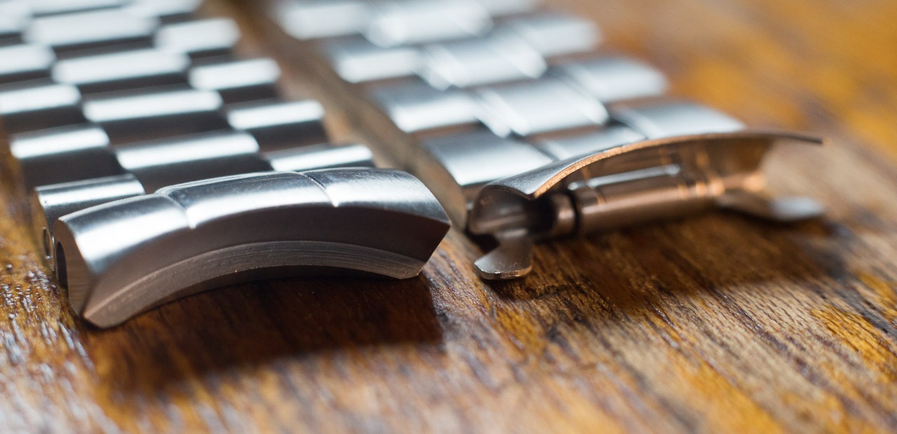

Folded is just a type of hollow end link. It’s basically a very thin piece of sheet metal that is preformed and bent; Rolex used folded hollow end links on their vintage watches, but now either uses a solid end link or a much thicker cast hollow link.
Attached is a photo of the back of the US 1171, as well as a comparison pic of a solid vs folded hollow end link.

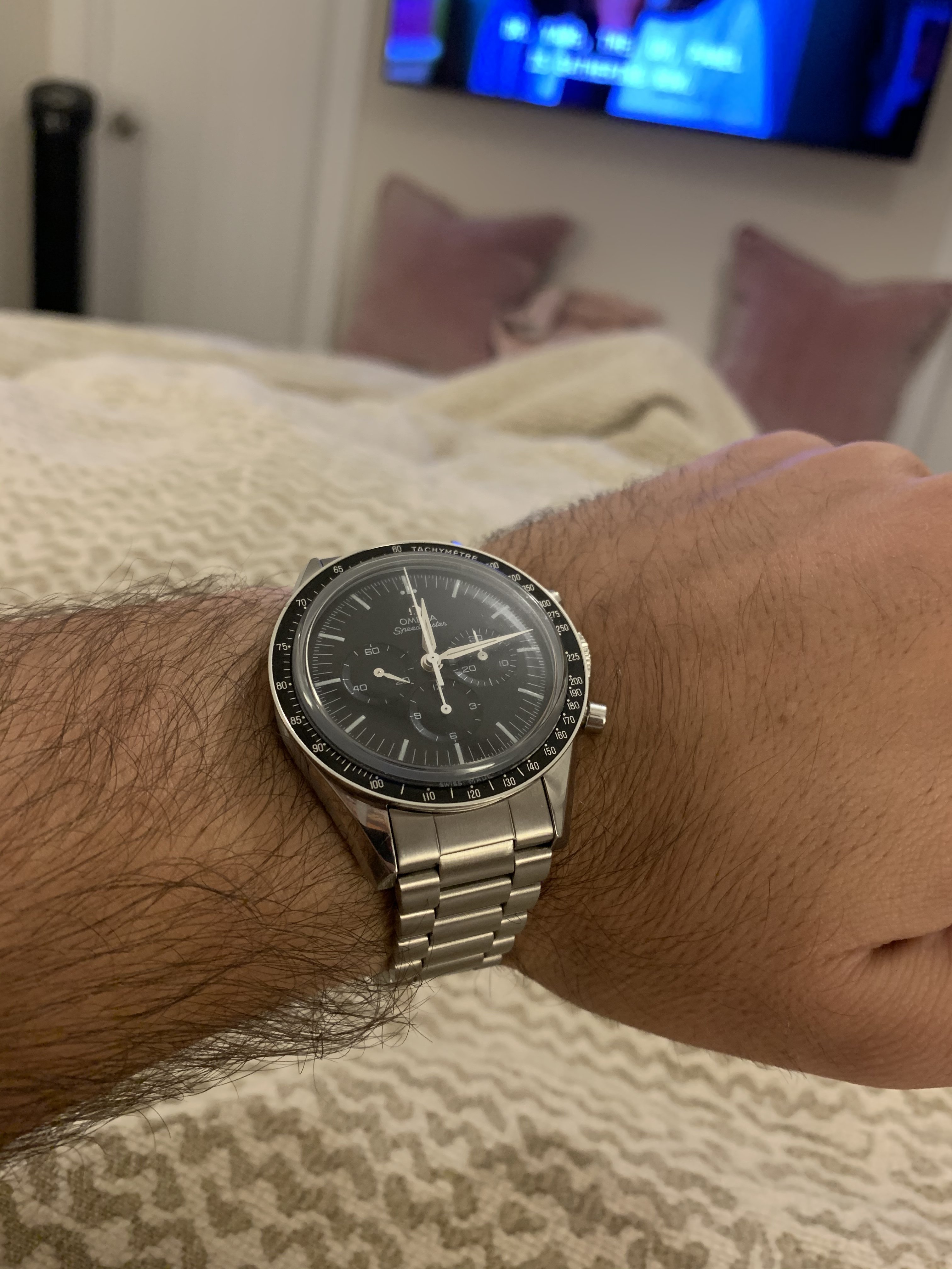

From the looks of it, that bracelet is very tight on your wrist.
Also, you wear your watch below the bone and that doesn't help. With every movement you do with your hand, the end link is biting into the watch body.
Just my 2 cents.

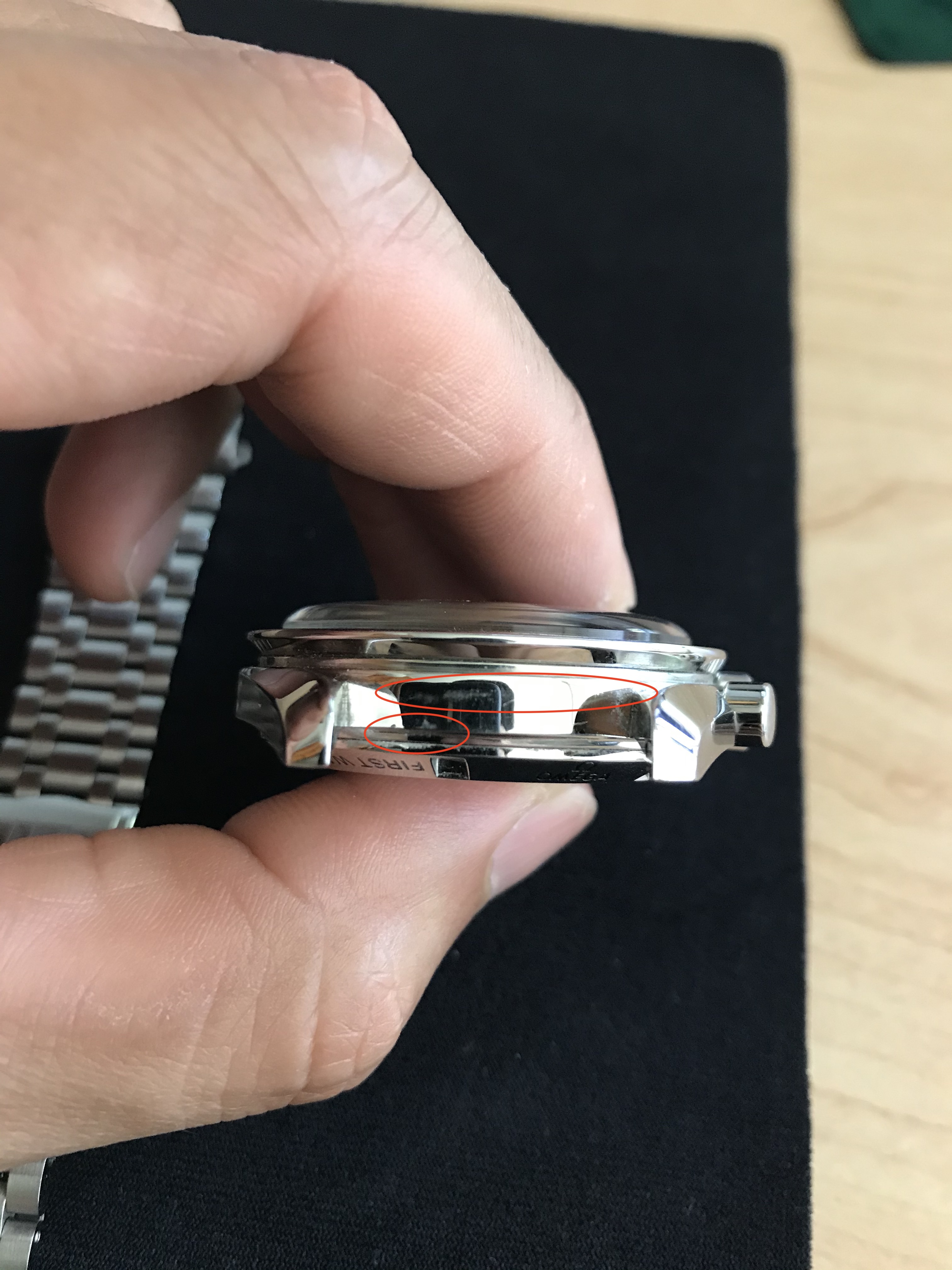

I have a ‘69 speedy with this type of wear.[1] I tend to prefer bracelets so its not too much of a day to day issue for me.
I’d be interested in hearing others thoughts on whether this is common, or is limited to certain vintage end links and/or loose fit.
[1] - in other words I’ve seen wear like this from vintage bracelets.

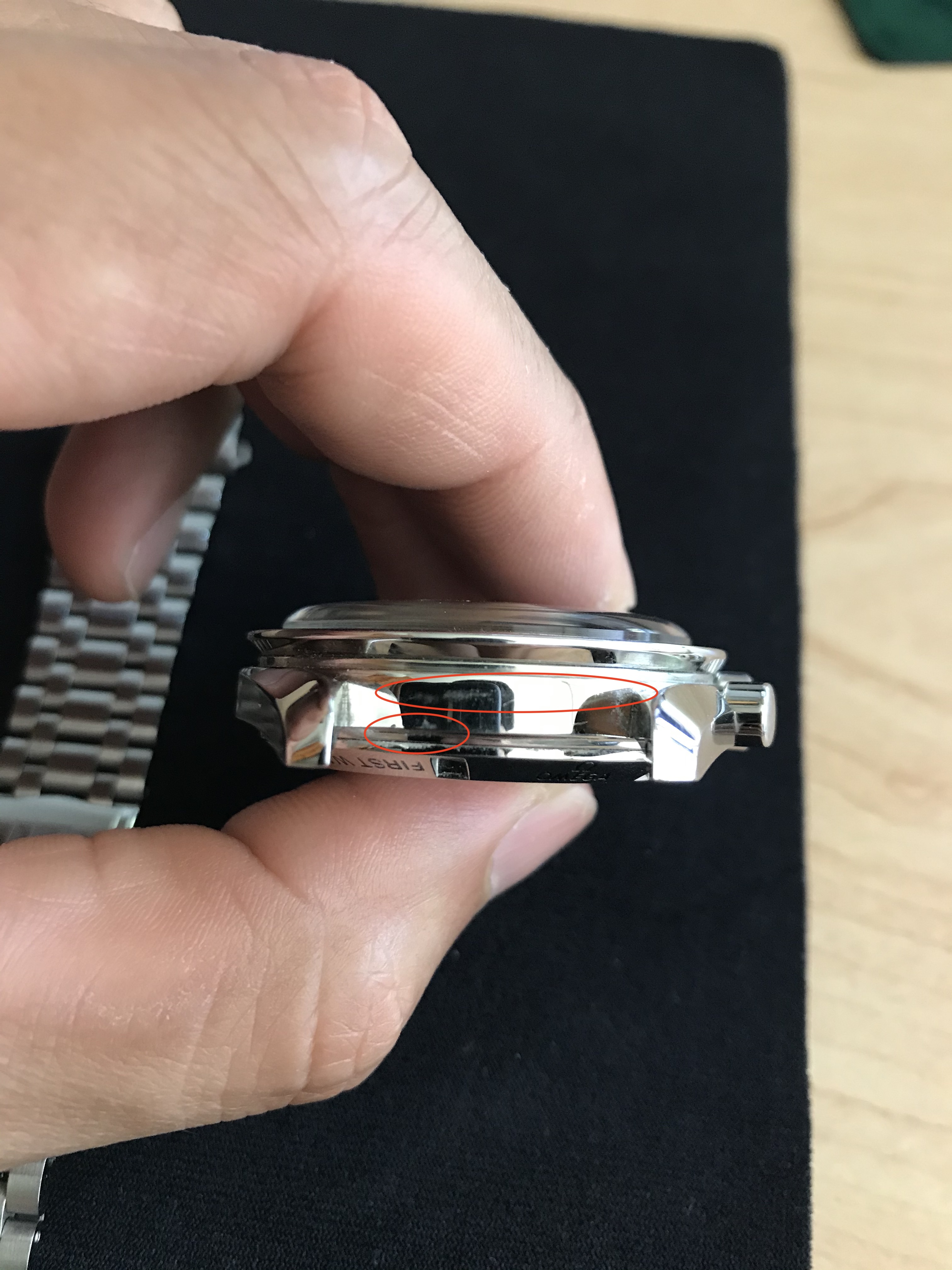

I looked at the Uncle Seiko Holzer on my FOIS and there are minor scratches on the case and this is due to the end links being such a tight and close fit to the case, however I couldnt say if this occurred during fitting or during wearing.
It probably just requires the end link to be shaped / smoothed slightly to fit better or less close against the case. Maybe this is why Omega end links like the 633 dont fit perfectly on the case?
I likely wouldnt have noticed these marks on the case unless reading this thread but it wouldnt stop me from putting the bracelet on the case, it may just need a little adjustment for a less close fit.
