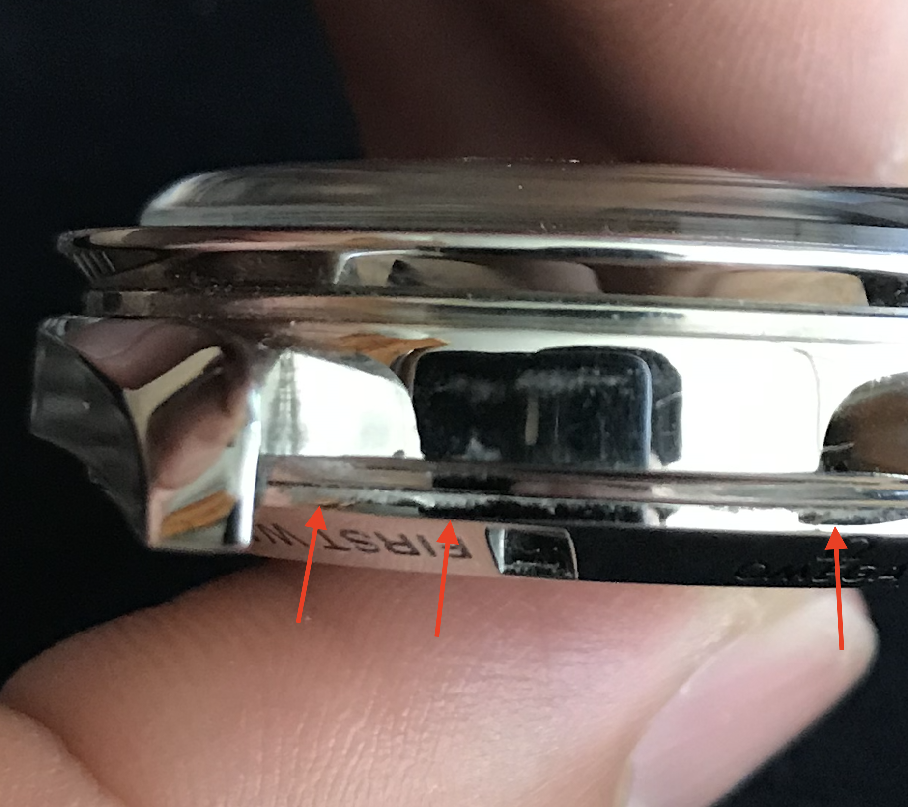

Yeah, I get that end links generally cause superficial scratches to the watch cases and that doesn't bother me. The scratches that I've highlighted above and again below are much more significant. I don't baby my watches, but I do try to avoid needlessly damaging them.

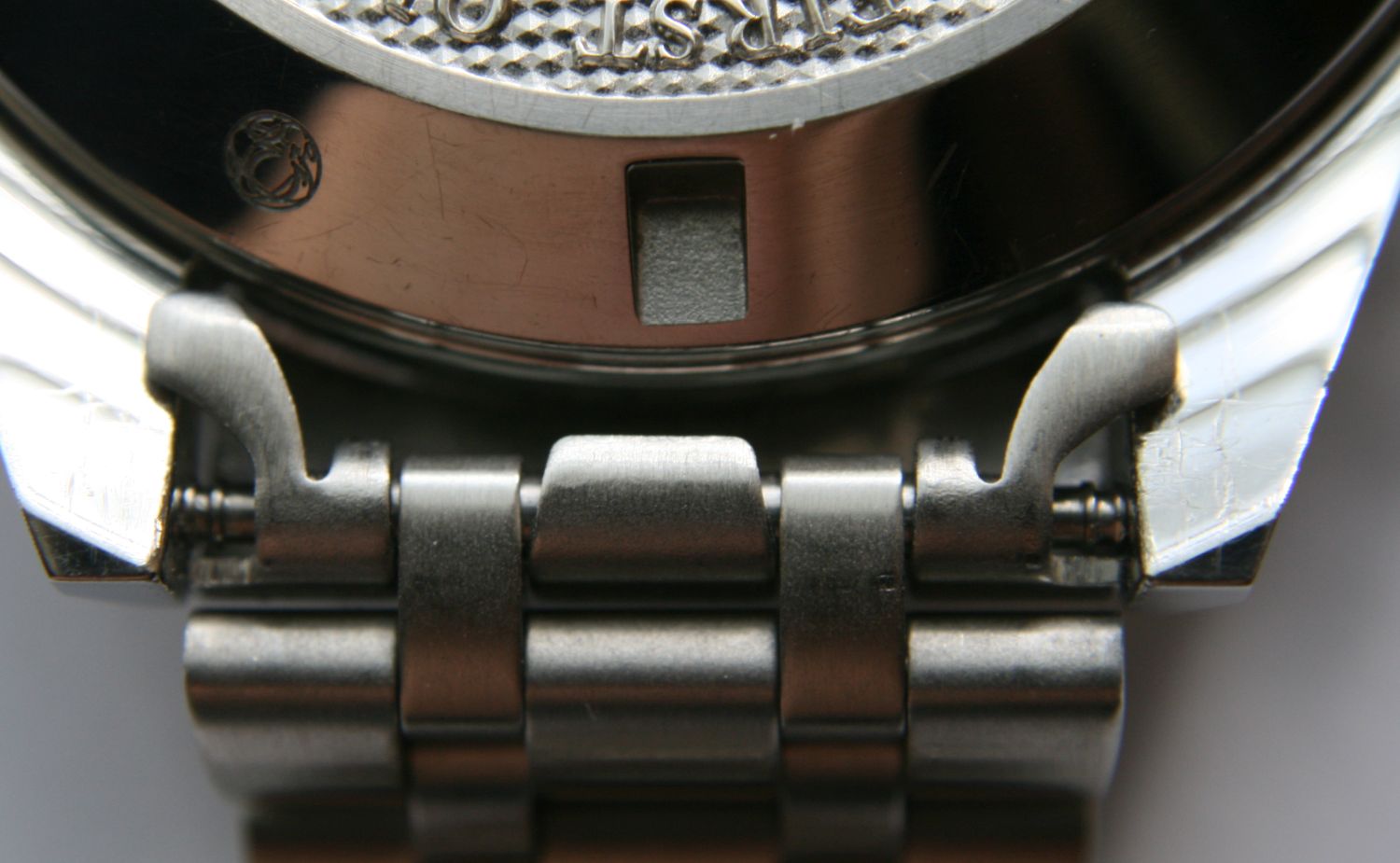

I'm not sure how you got scratches on the edge of the case back when the bracelet and end links dont come close to that area? Although my photo is of the FOIS and you watch is 20mm lug width

Yeah, it definitely is due to the end links from US not being 100% 'perfect'; one edge of the US endlink is snugger against the watch body than the other. I believe in wabi and generally not polishing watches, but these were *deep* scratches that really got into the body. I think adding a bit of scotch tape, or just filing down the endlink a bit with some 600-1000 grit sandpaper would probably solve it. I wouldn't care so much if I didn't frequently change my watch band; it is completely invisible once mounted.
Regardless, 90% of the scratches came out with some TLC from a qtip and Cape Cod polishing liquid in ~5 minutes.
