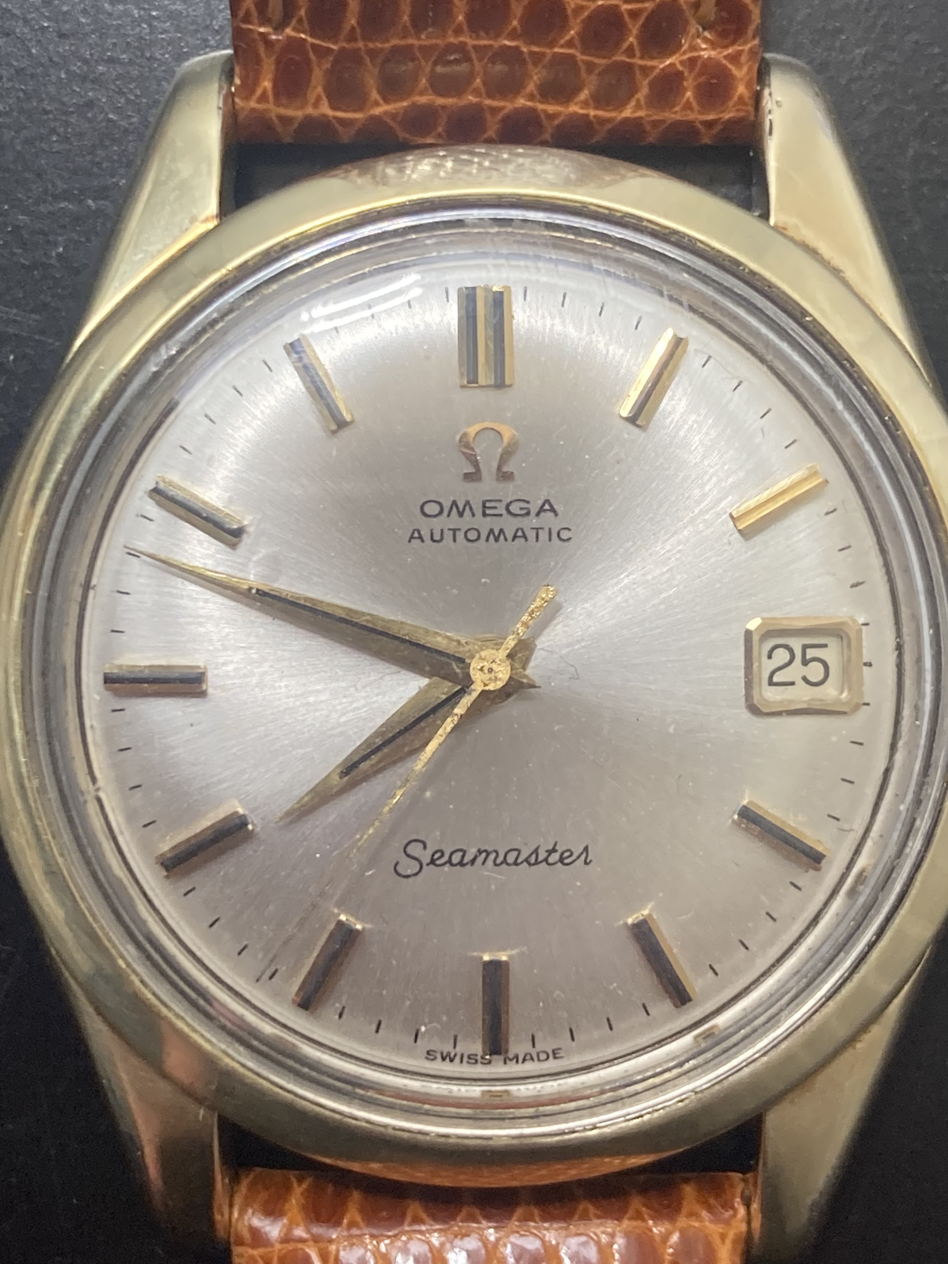

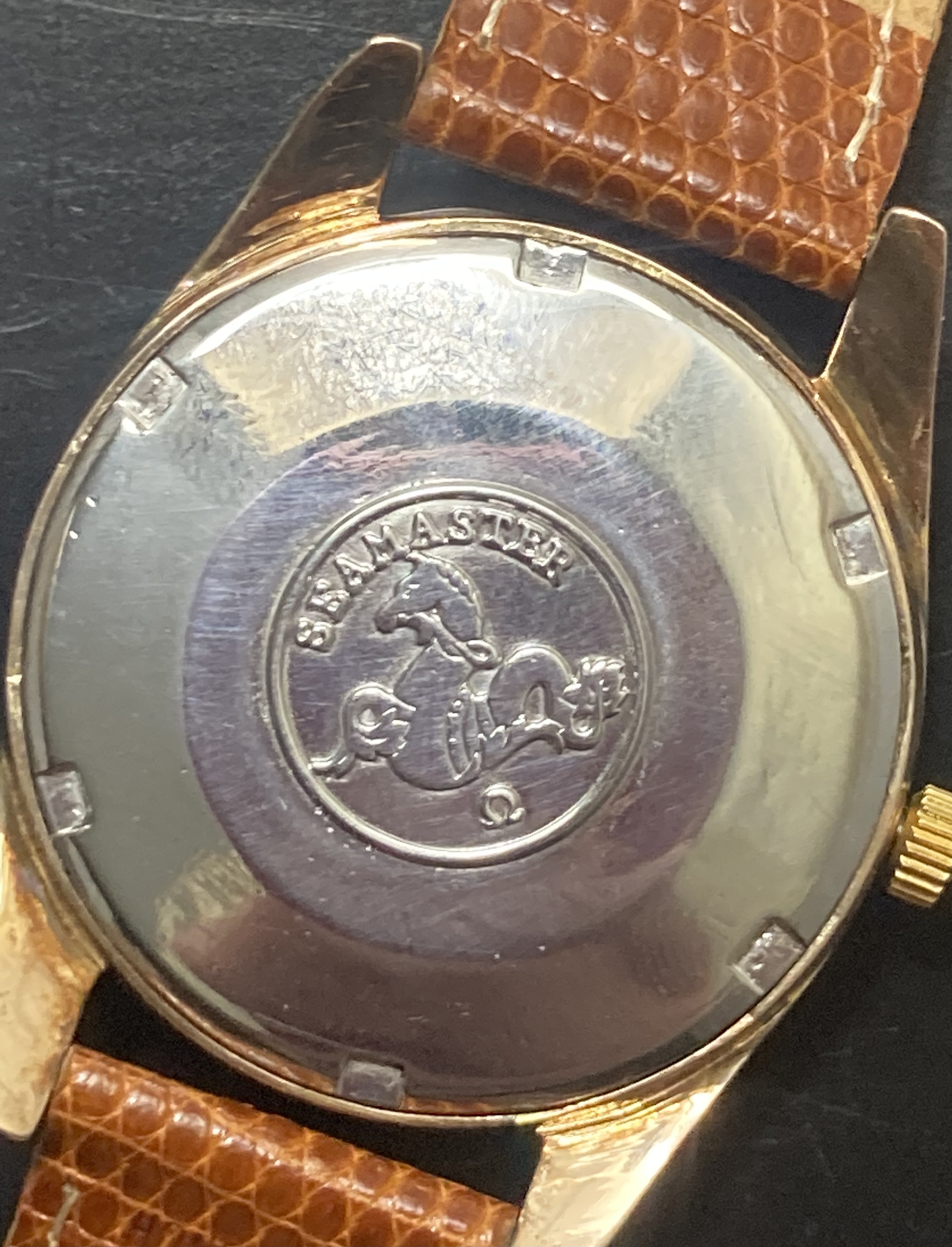

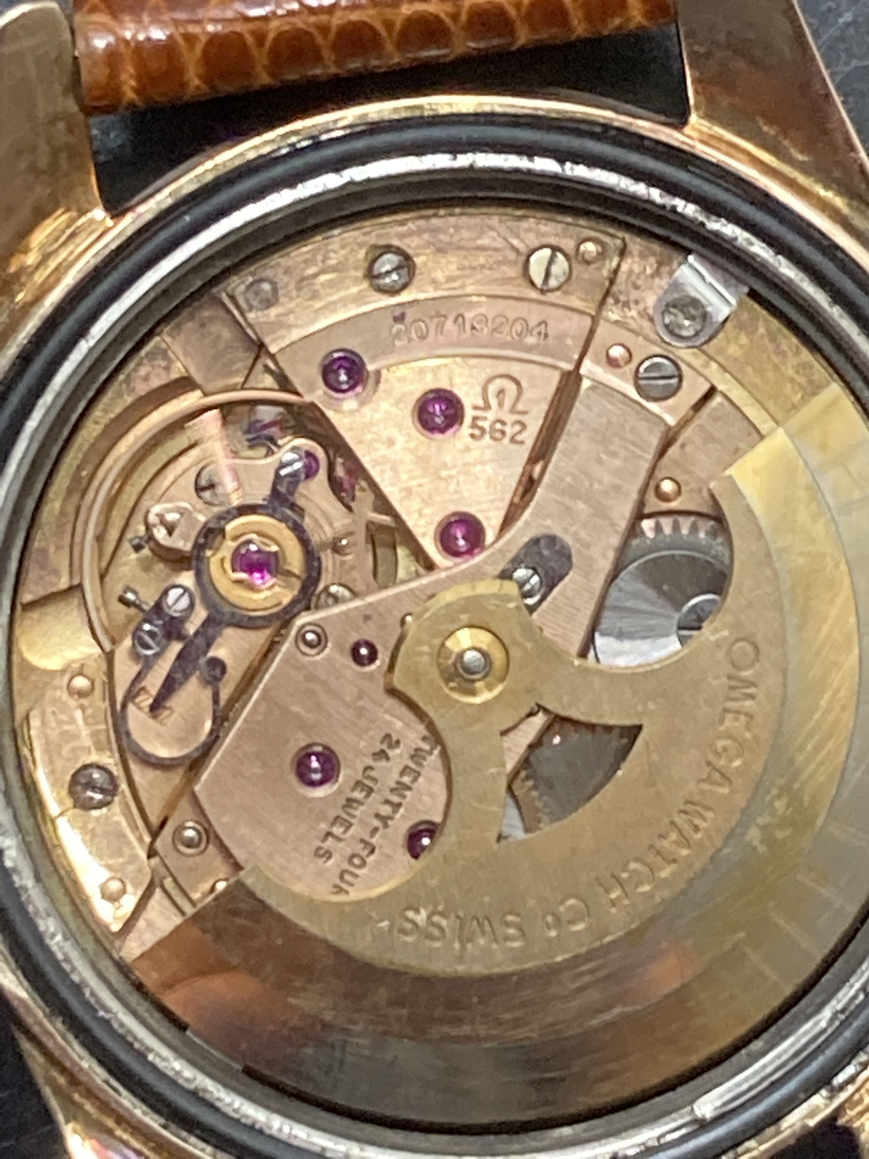

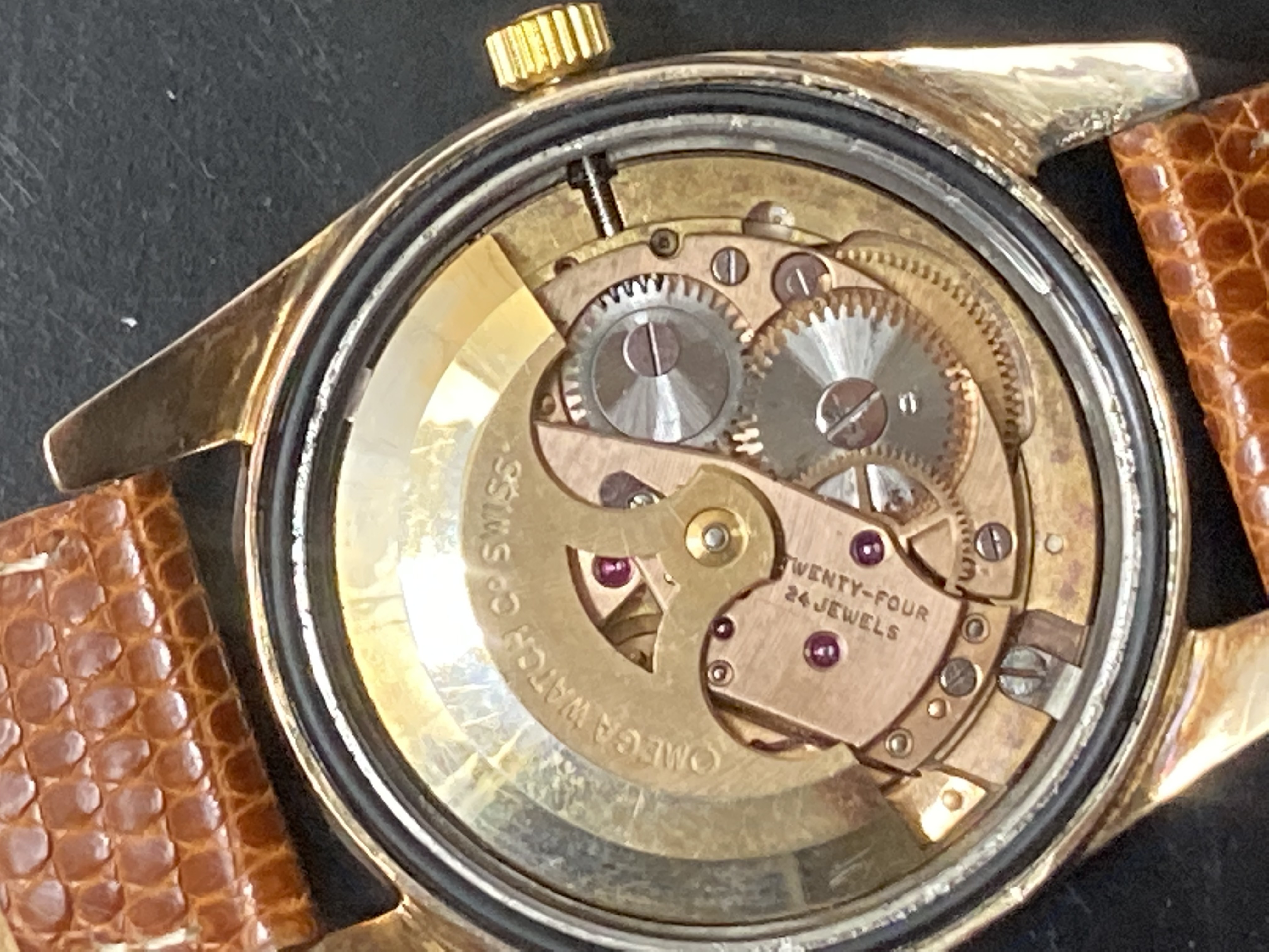

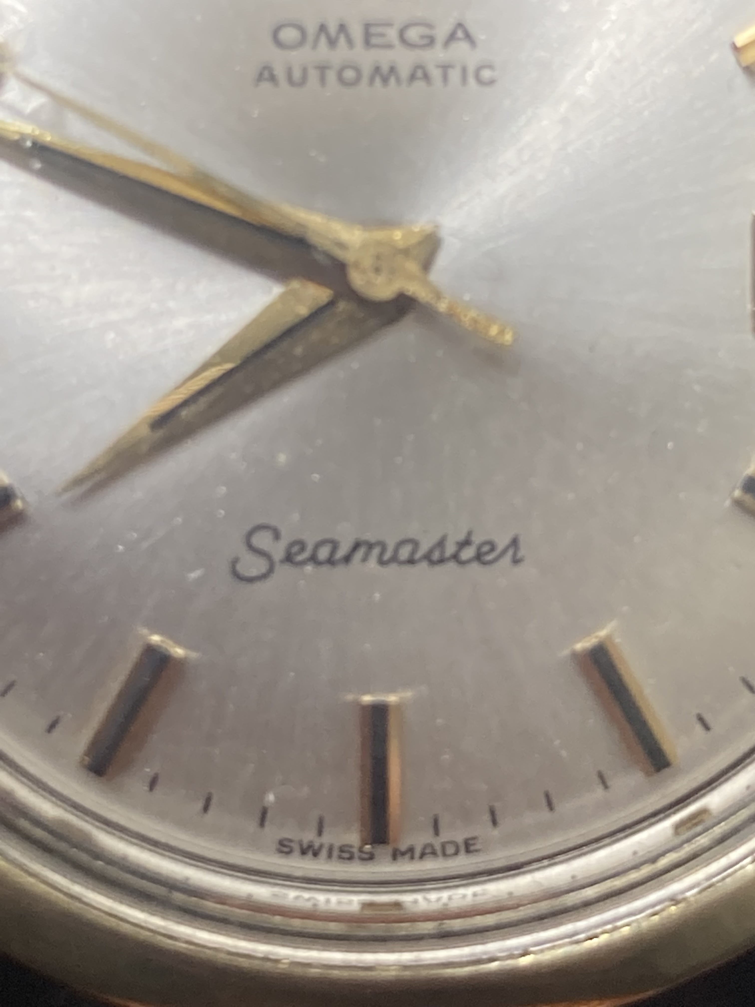

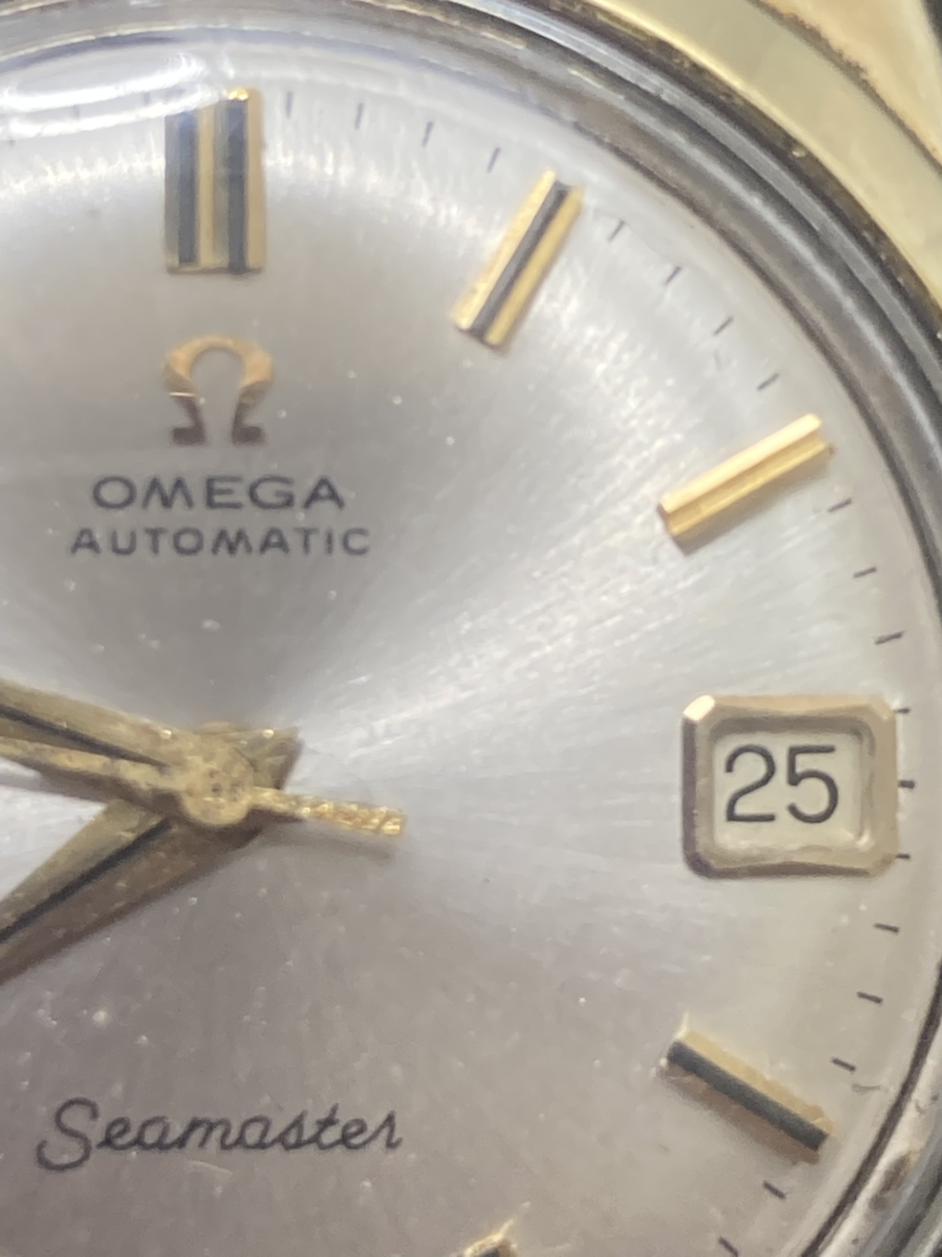

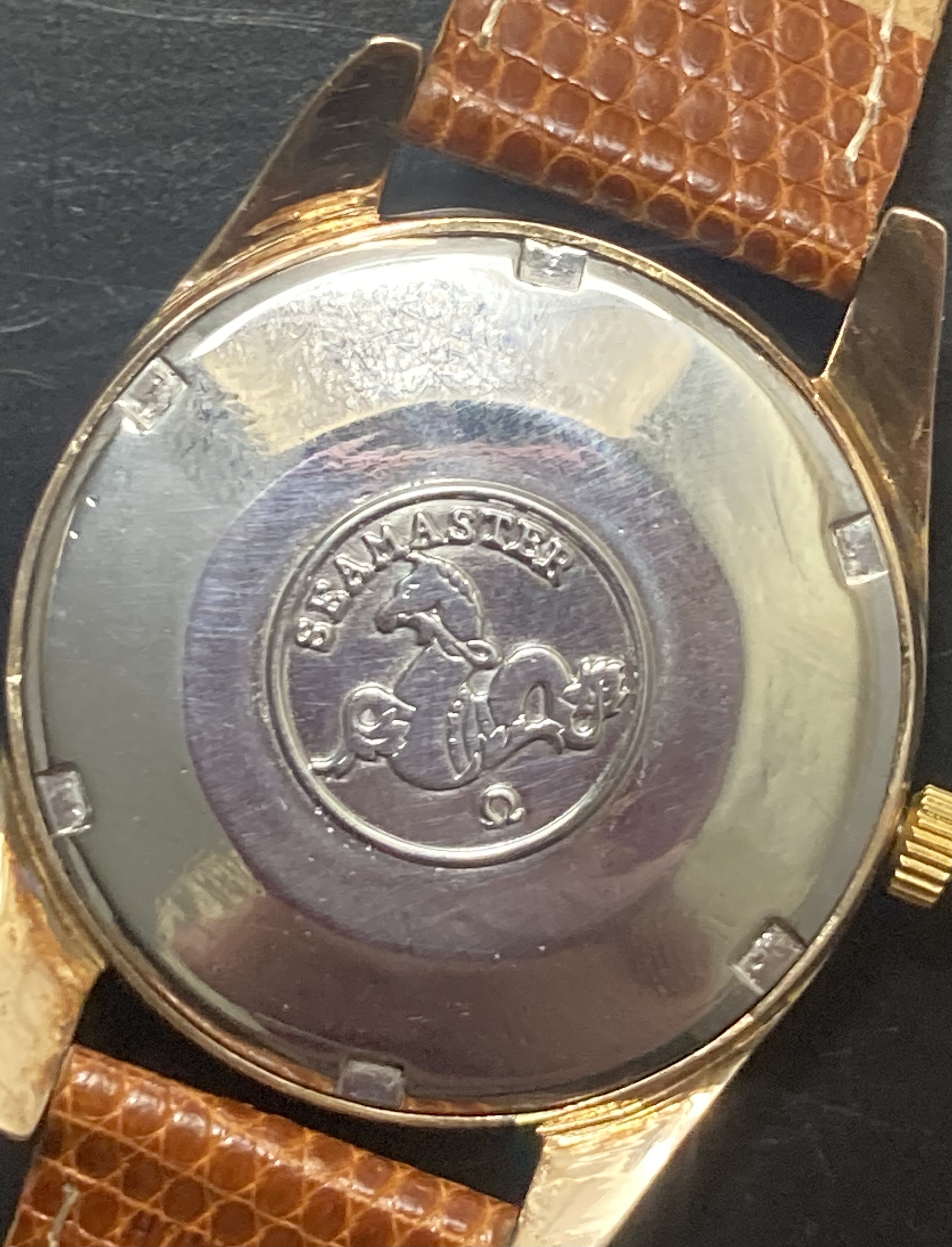

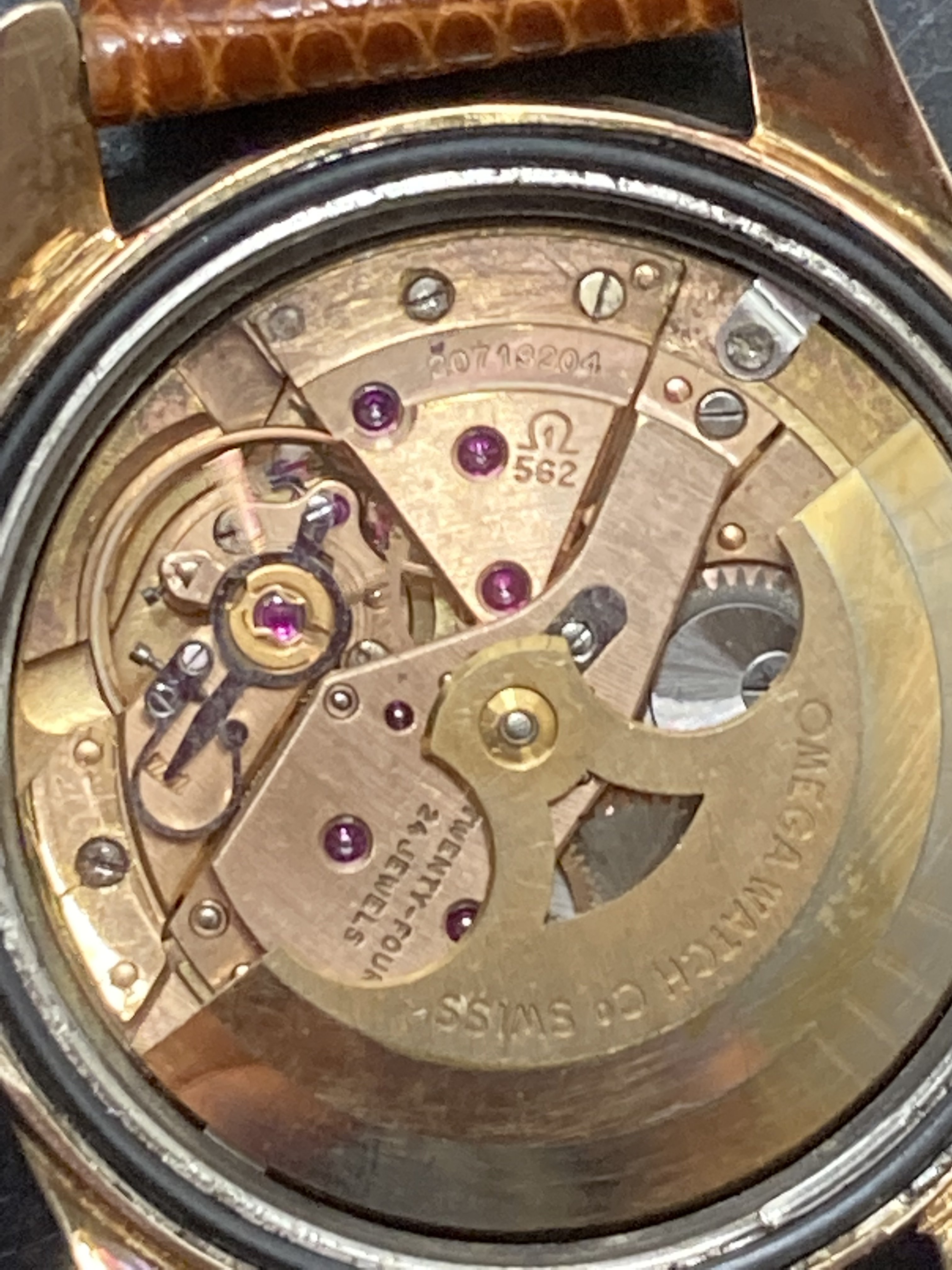

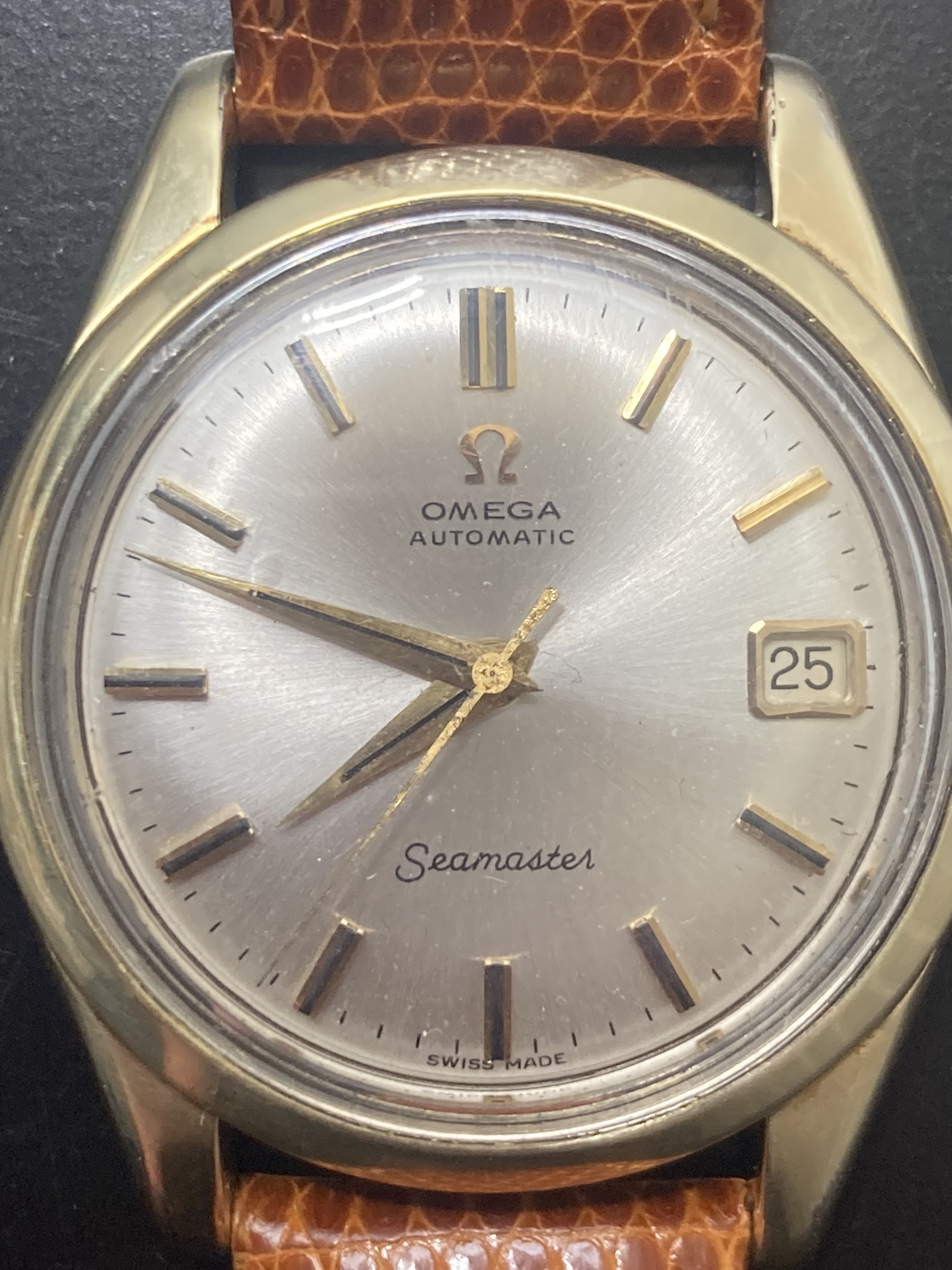

Hello everyone, over the last month or so I have started researching and reading about vintage watches, specifically Omega. I found this forum a few weeks ago and have been enjoying reading.
I made my first purchase last week and it came in today. I was hoping to get some help. I believe it to have an authentic dial, crown, hands, and the movement works, but I’m a beginner to say the least.

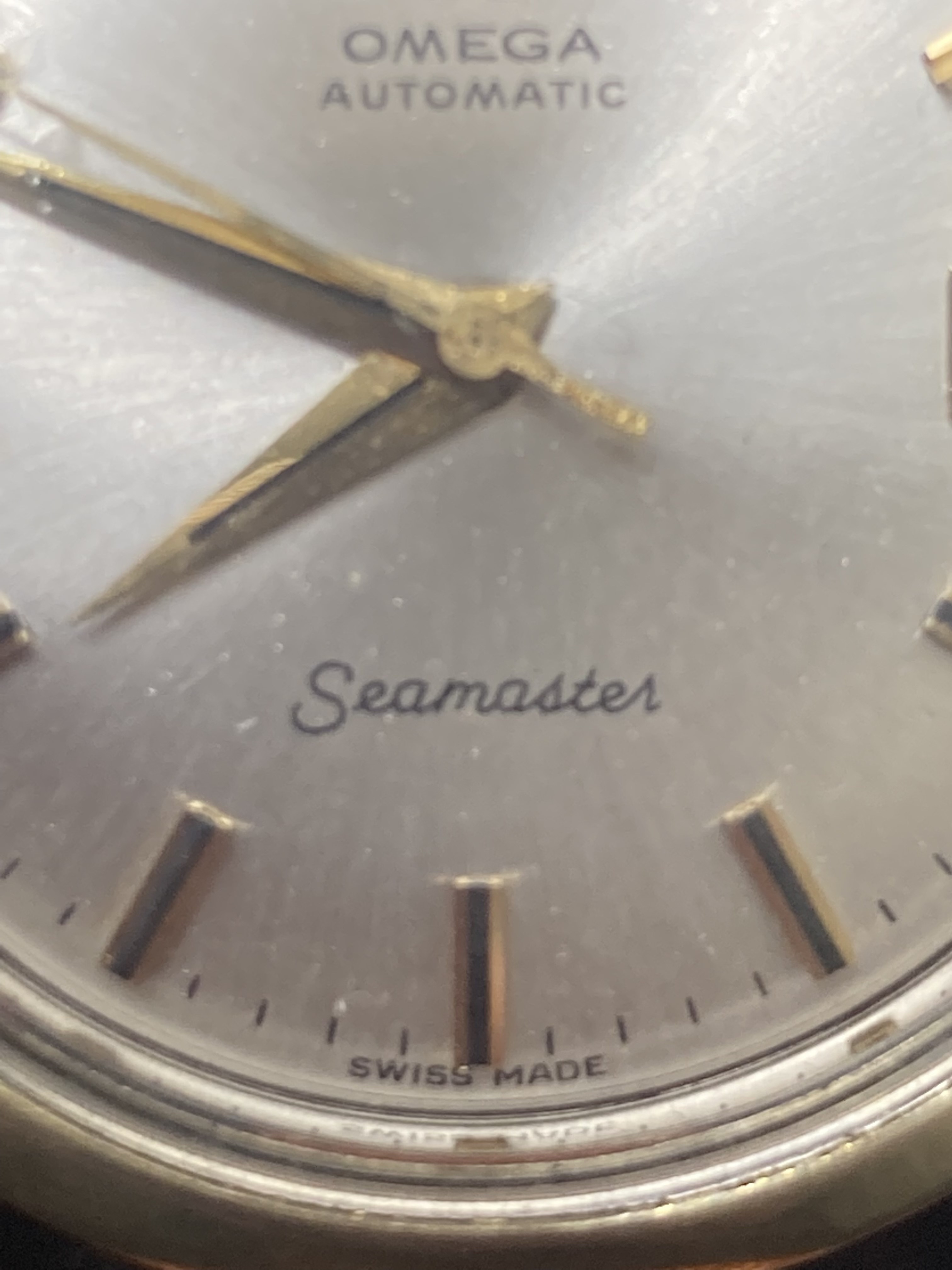

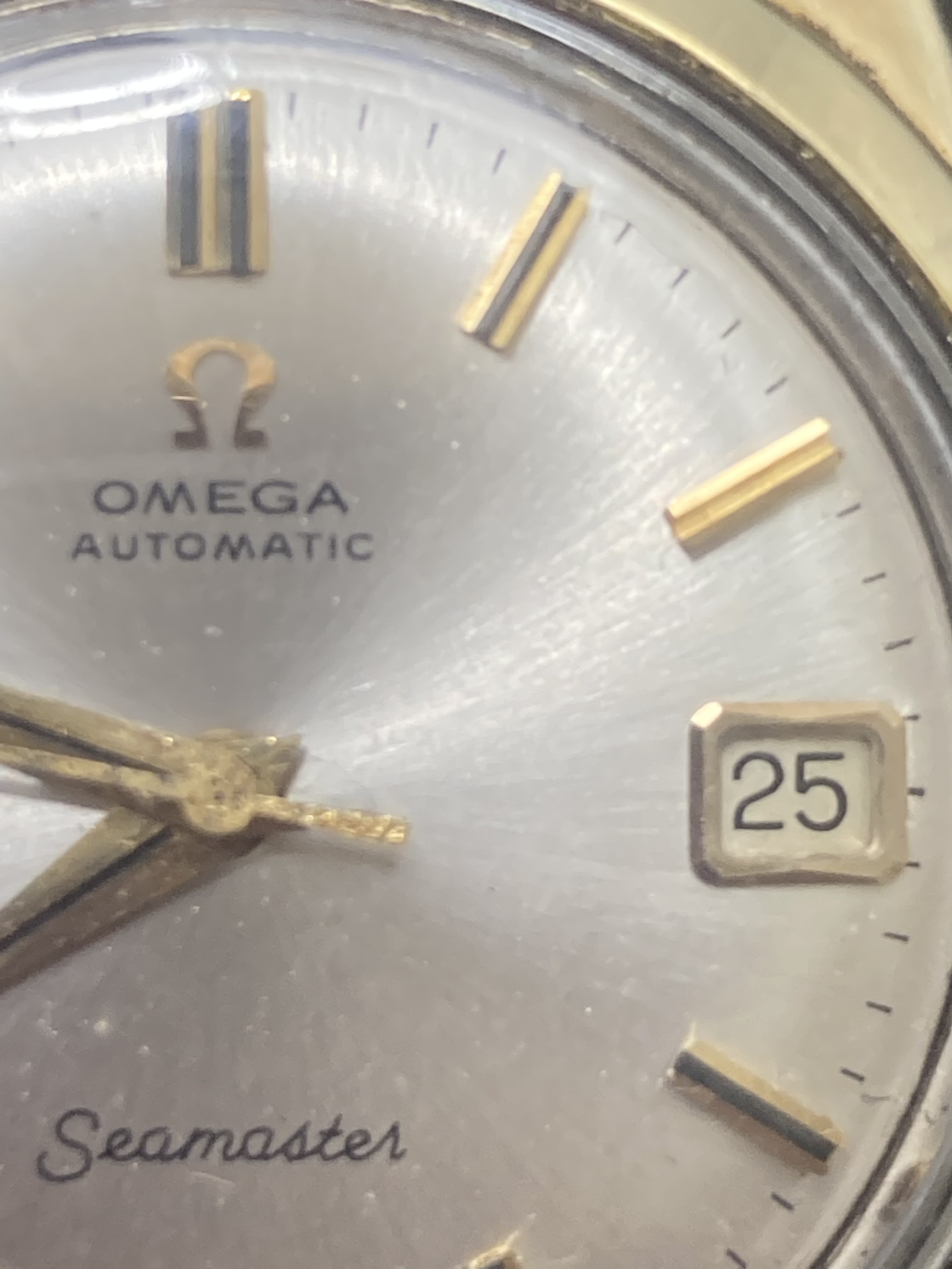

The little black line on the marker for 2 o’clock is missing and I think the crystal has been replaced. Am I missing anything? Am I just plain missing it and the dial has been refinished?
Any opinions on if this watch would be appreciated.

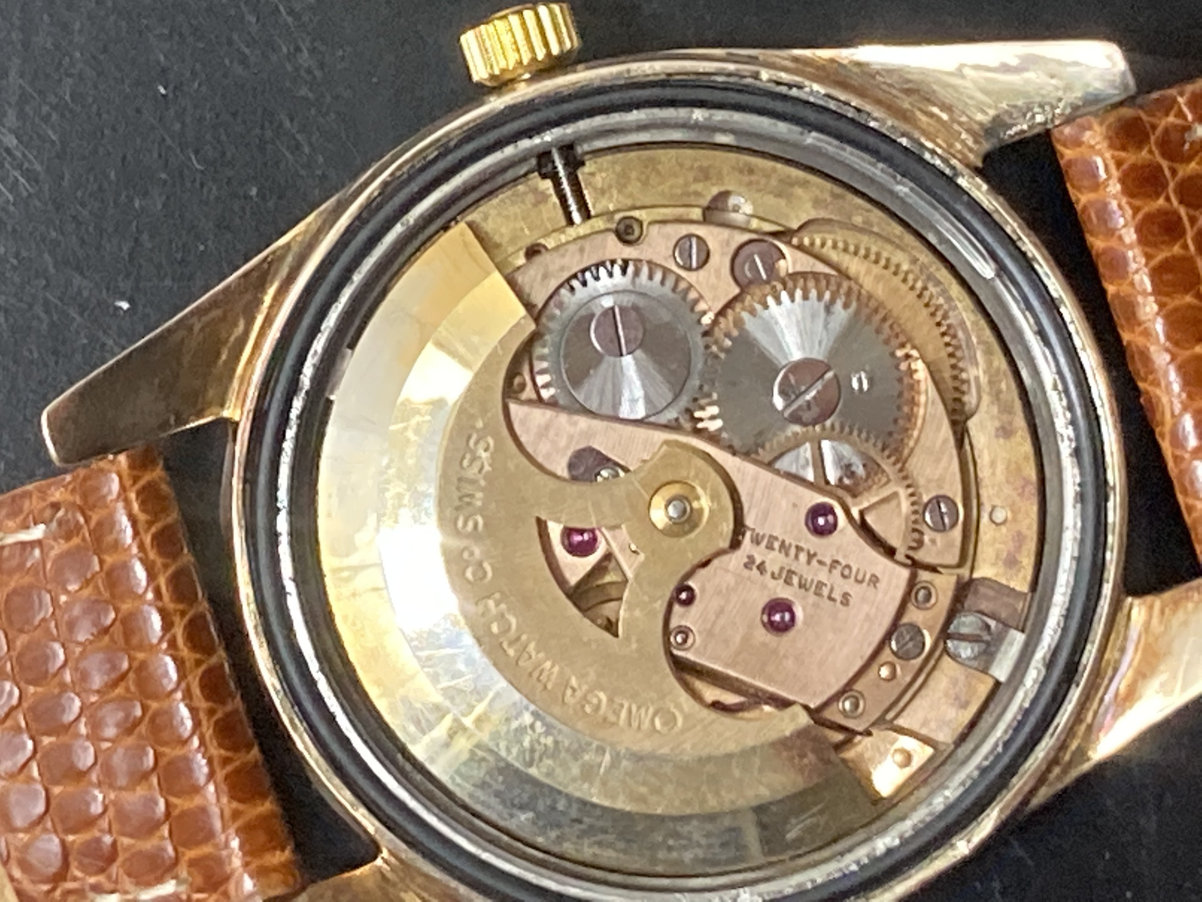

Hi, welcome. I think it is a redial, fonts look off and the sunburst looks odd. Also the case is soft. Movement looks tired.

Thanks for response. When you say case is “soft” what does that mean?

He means that the case is worn and or polished. I also think that the dial is suspect. Movement is definitely tired as well. And welcome to OF 👍

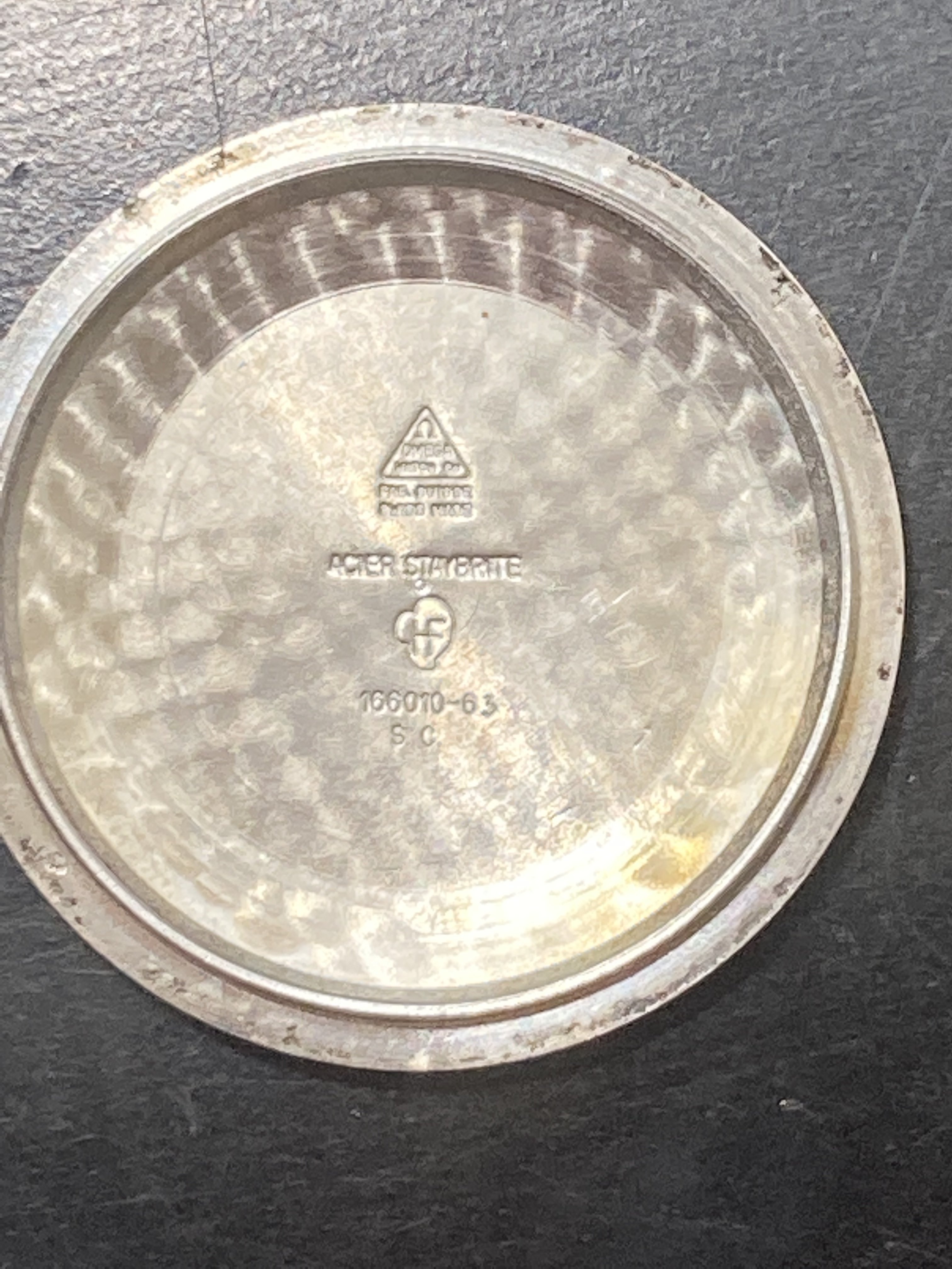

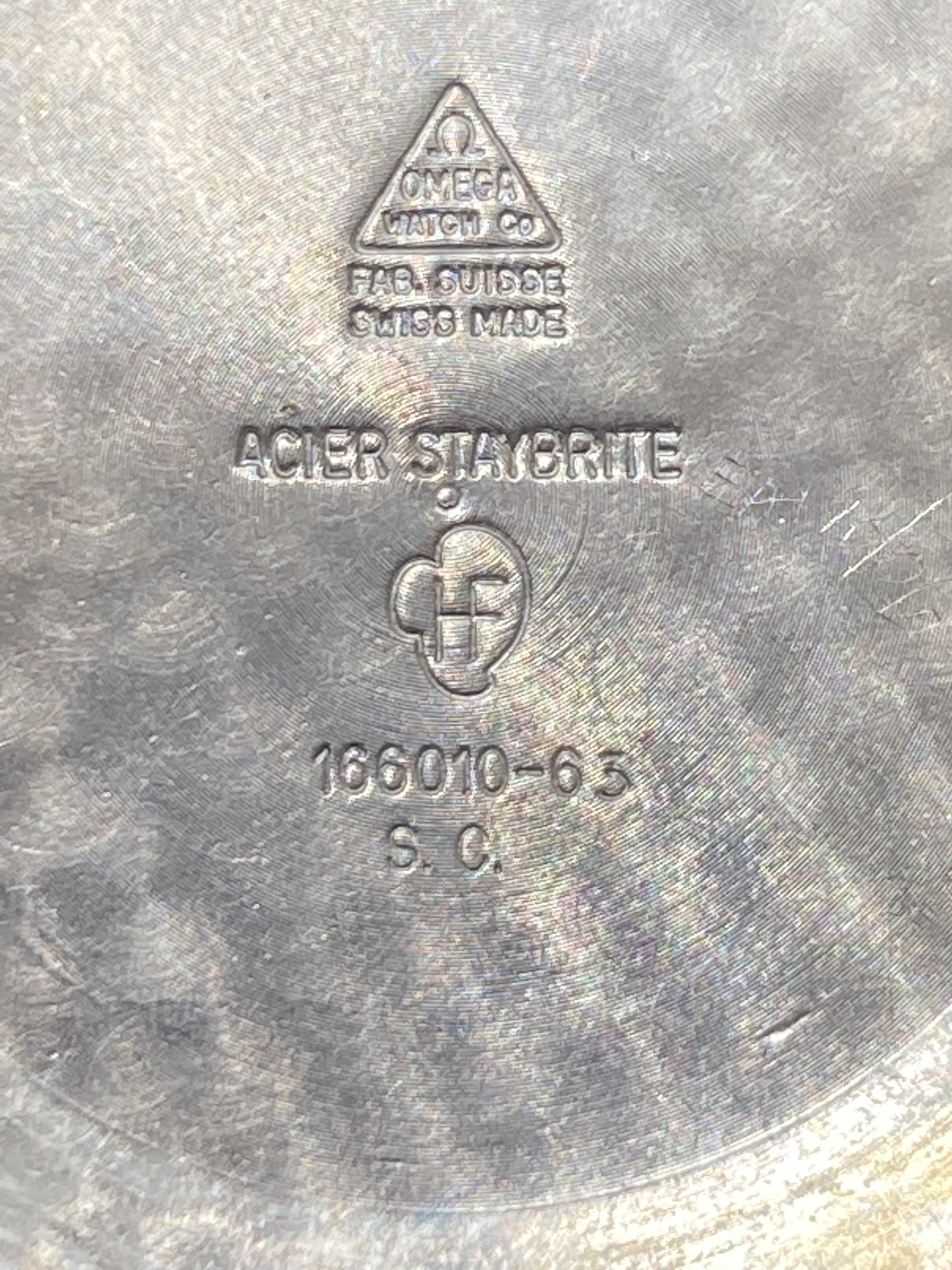

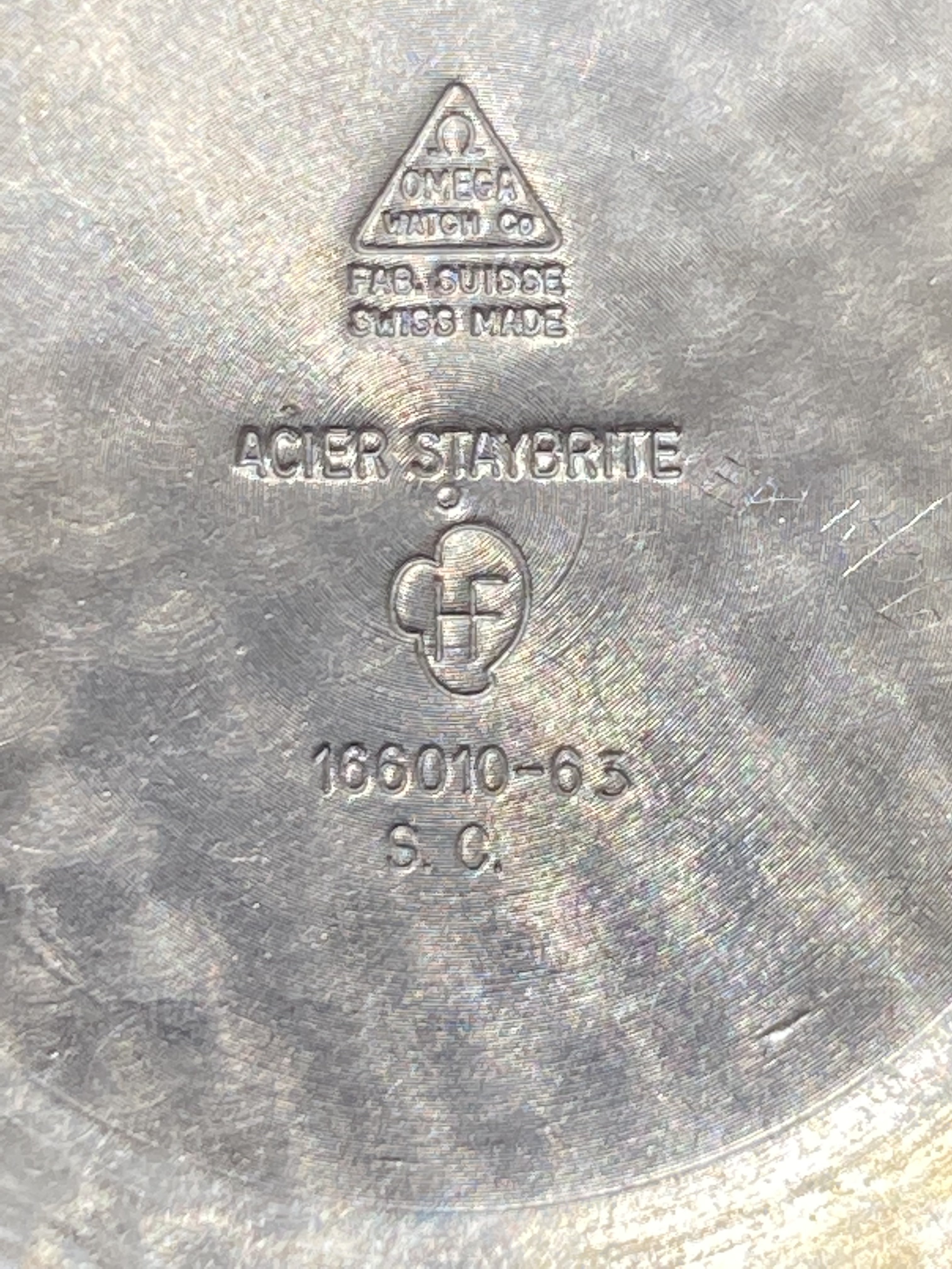

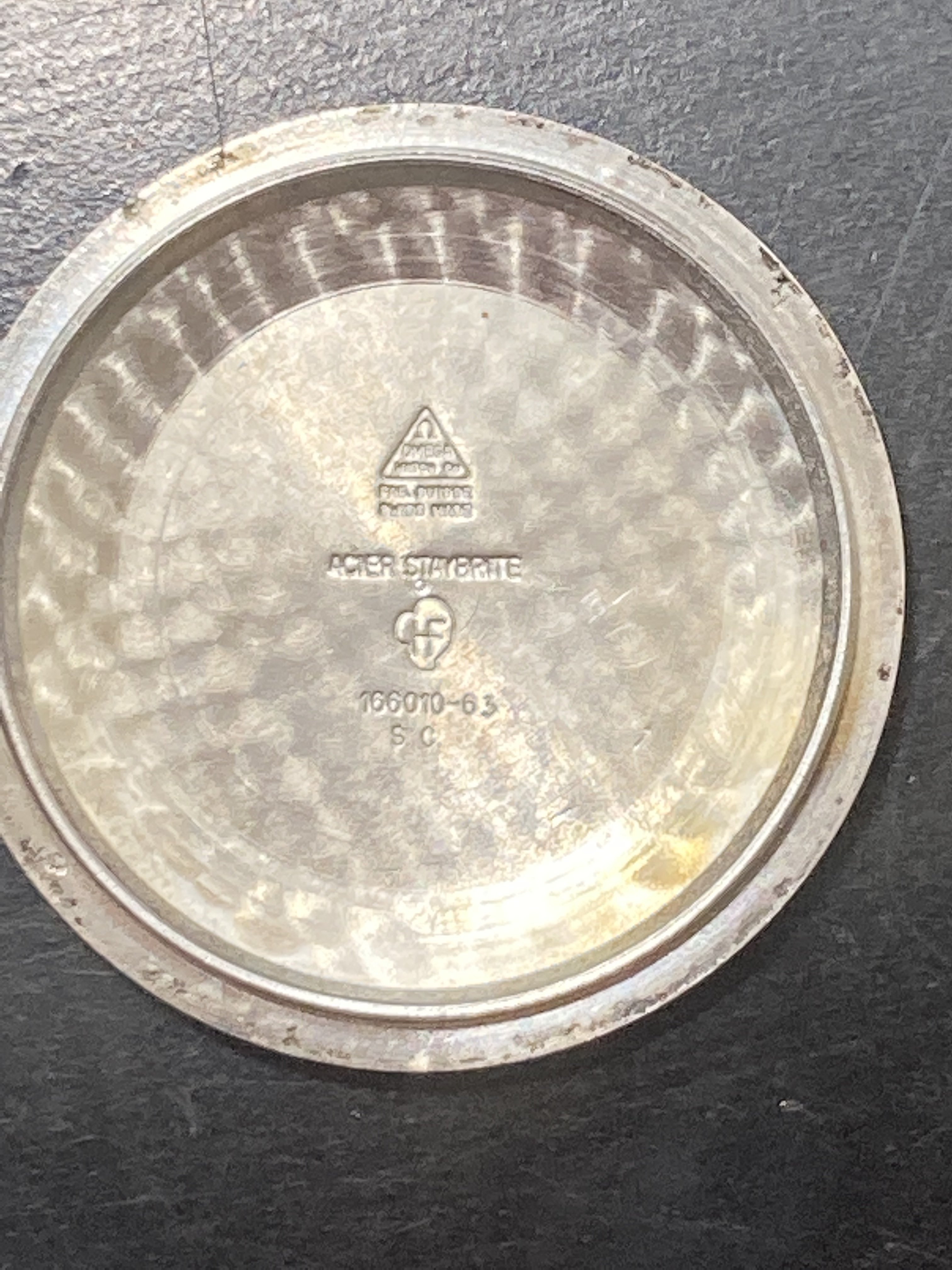

I believe the case back is wrong, it should have « Fond acier inoxydable ». That one probably comes from a steel model.
