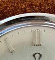

Going back to the OP.
what is that????
What are we looking at?
2,298
3,157
The "12" hour marker isn't centric or the minute markers aren't...
And the black dot above the "12" shouldn't be there either IMO
6,832
10,502
it could be just the angle of the photo - the marks beside 10&11 look off too
not sure about the black dot but there is one below the 11 index too.
Possibly just detritus on the dial?
