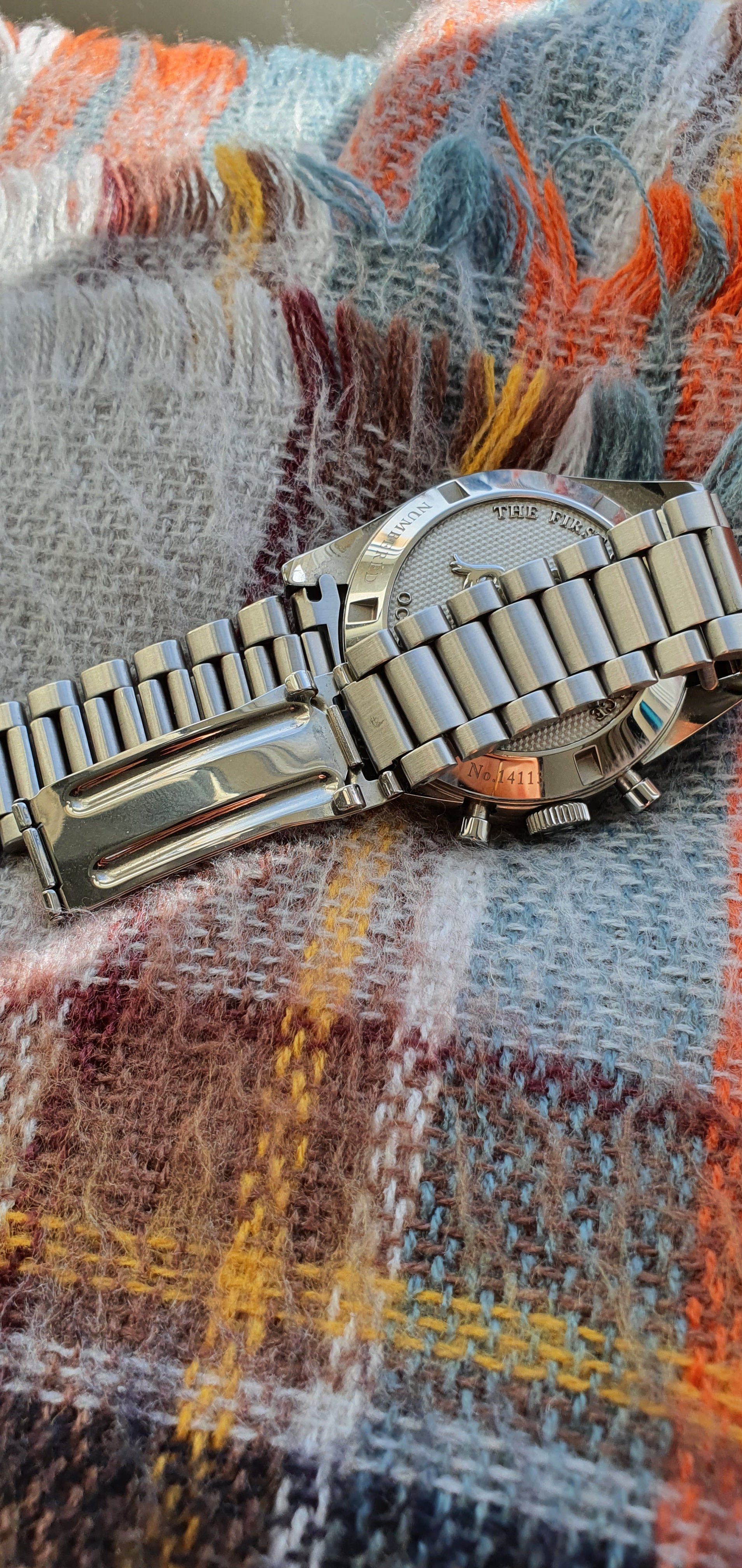

YES! This is one thing that I was pretty worried about. I have a Submariner 14060M and a permanent link needed to be removed to make the watch even wearable for my 5.5 inch wrist. The clasp has tons of microadjustment holes and there are several pins and links that can be removed on each side of the bracelet:
As you can see, I even have one more microadjustment on the clasp to work with. This is one thing Omega consistently does right - their watches are designed to fit tiny and huge wrists!

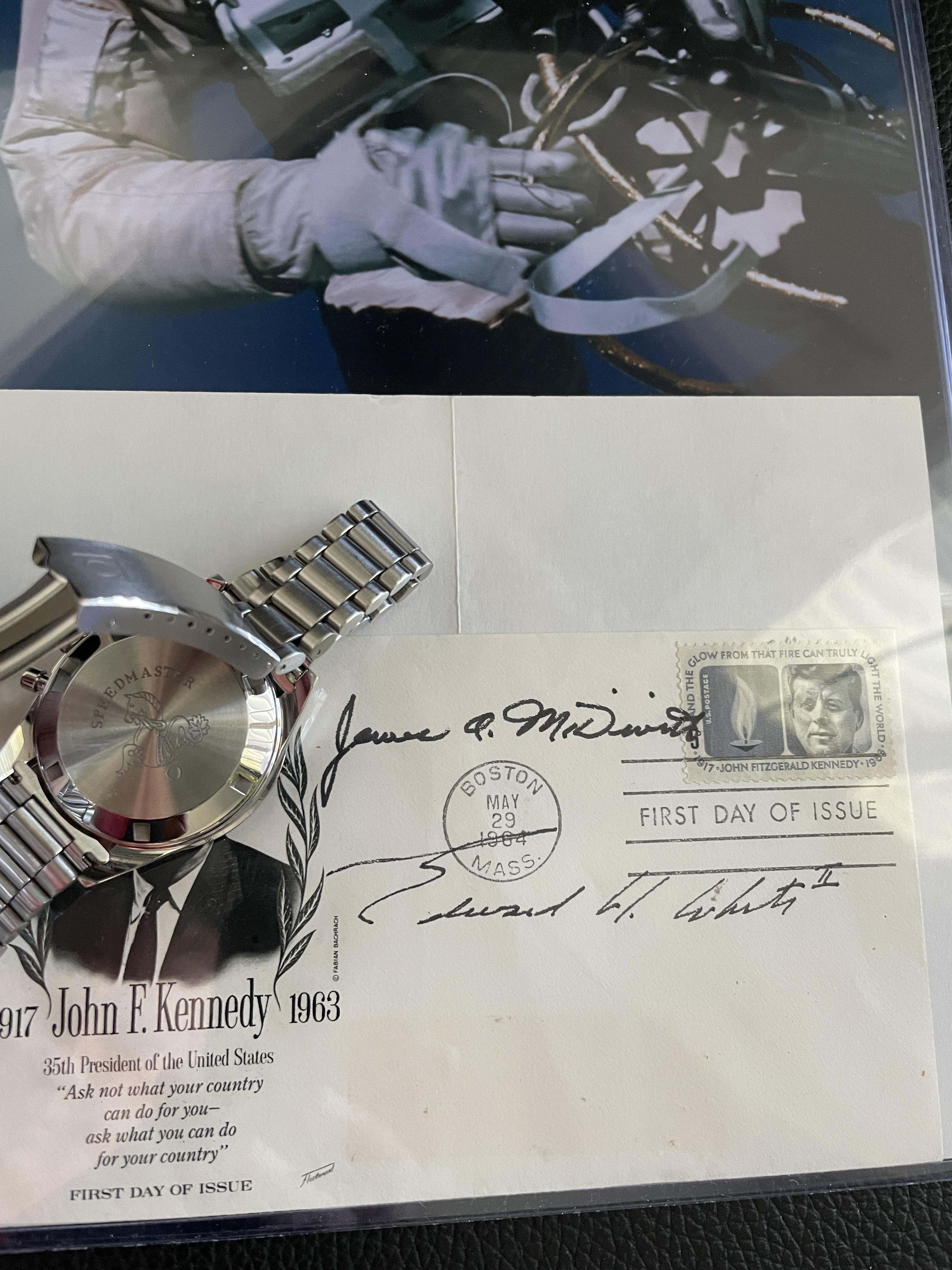

Bracelet review

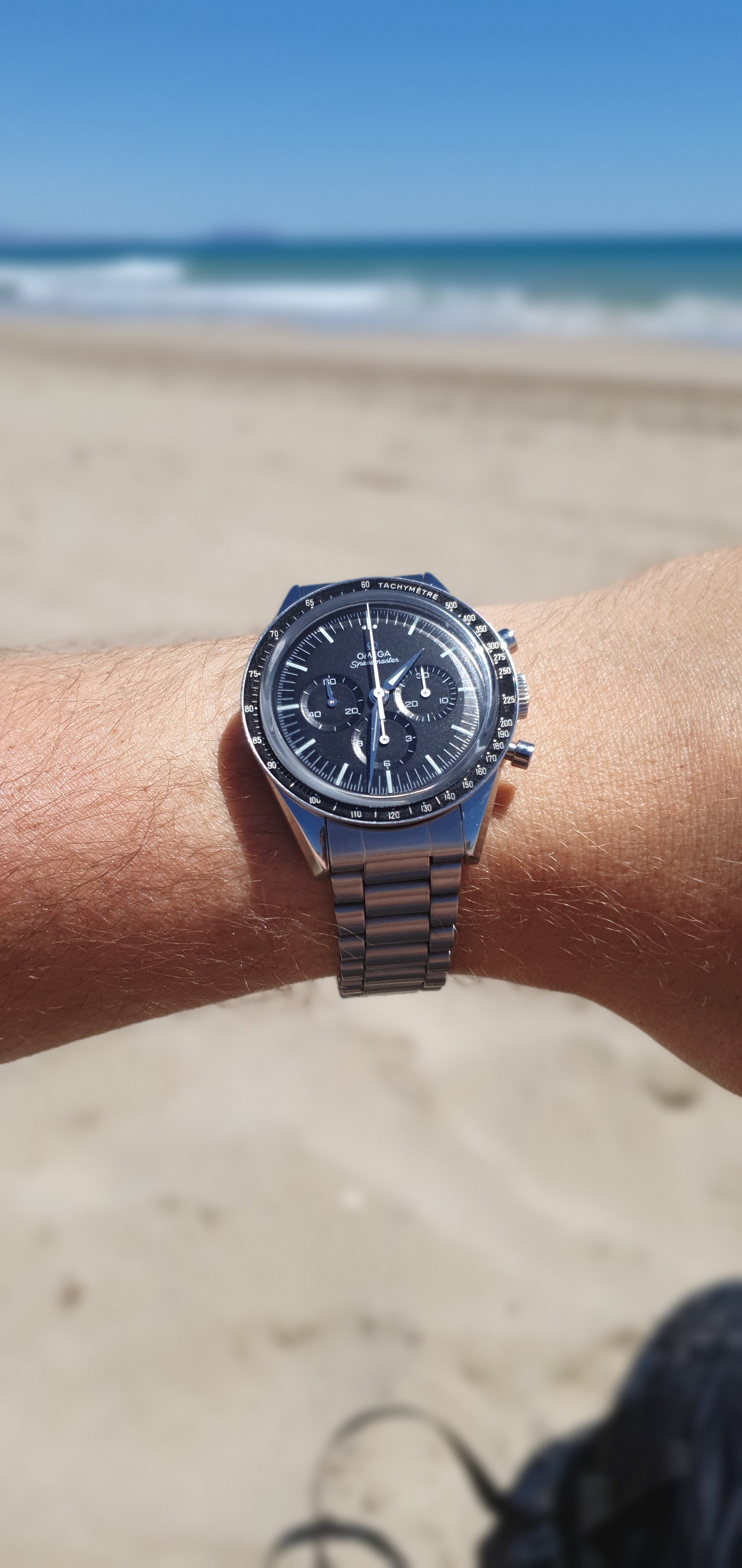

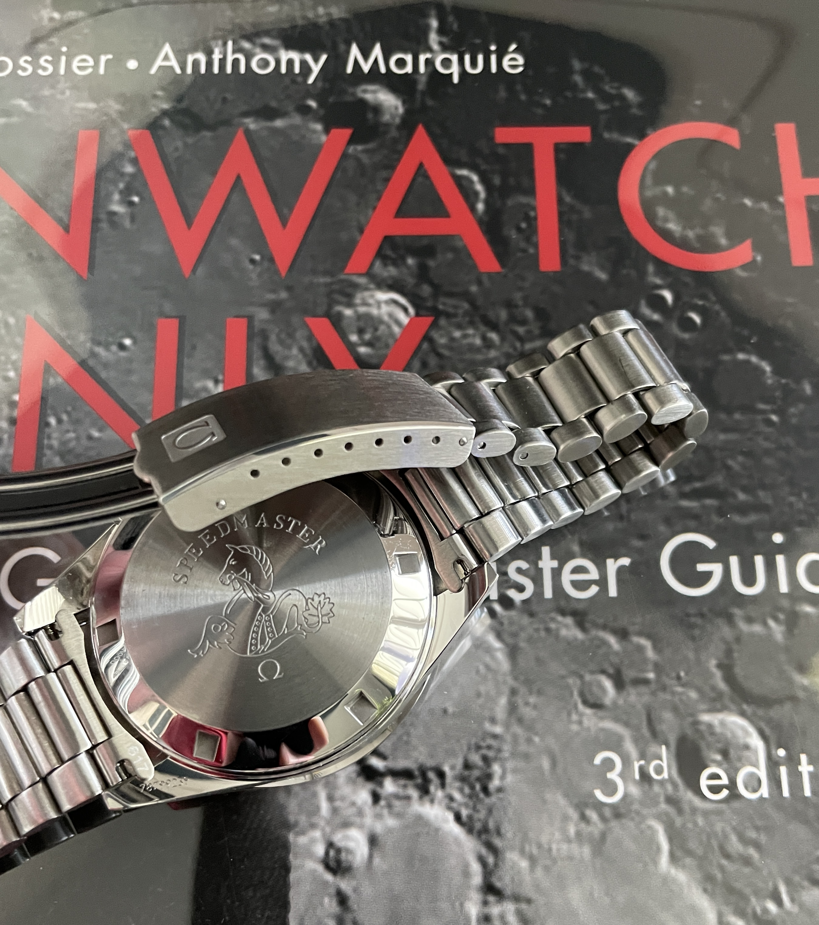

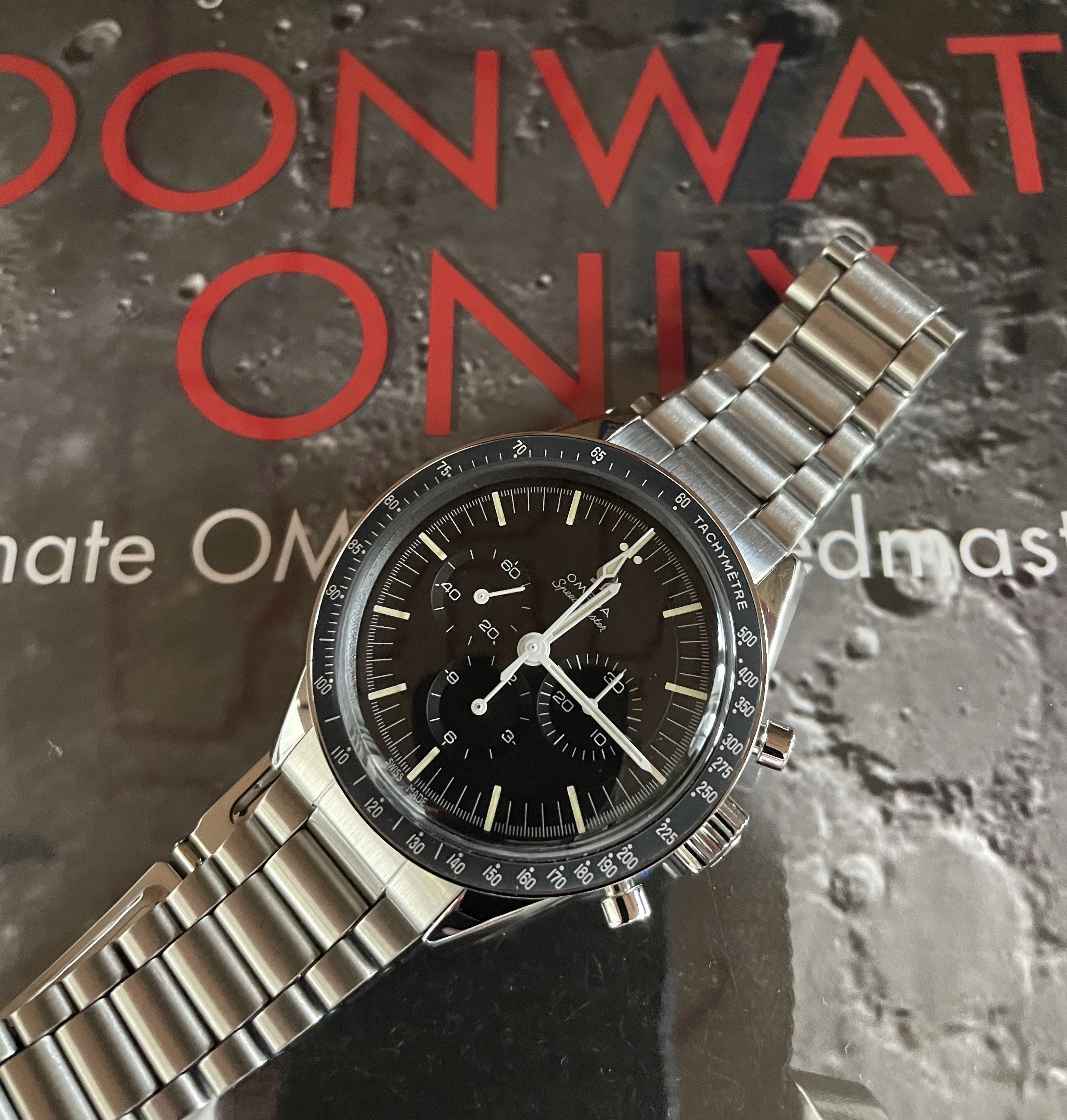

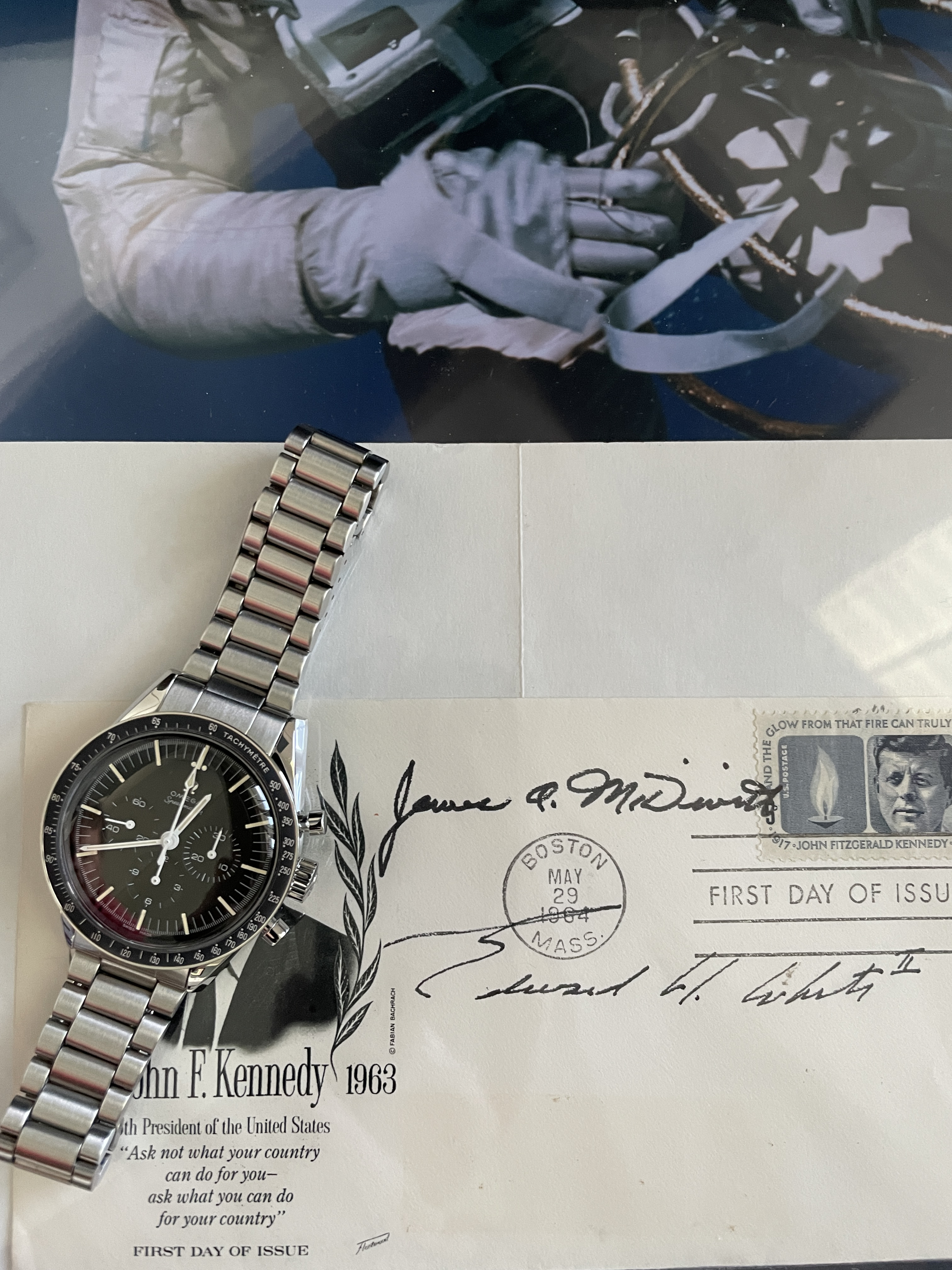

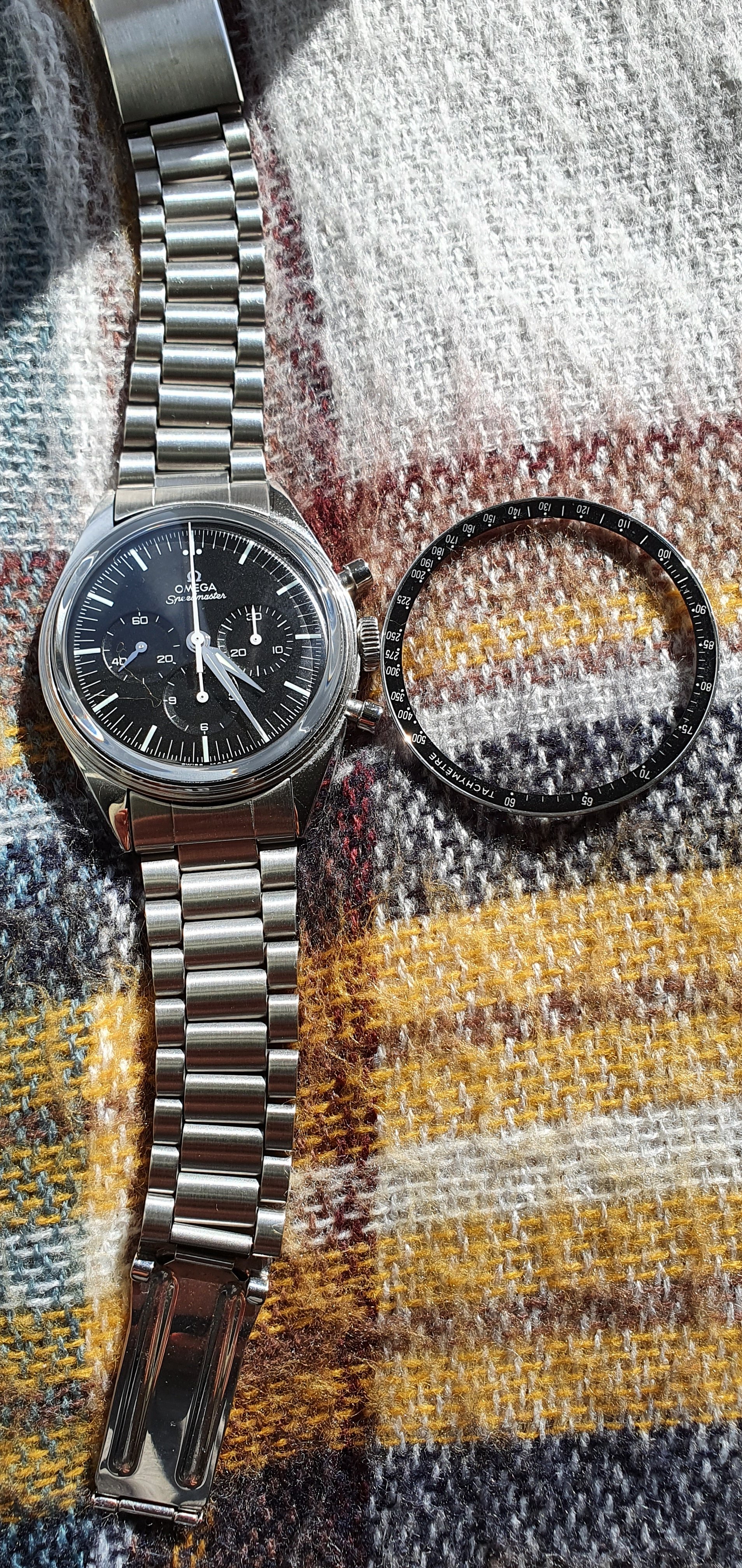

I really love the look and feel of this bracelet. It makes a similar amount of noise as a 1990s oyster bracelet - not too much, but more than a modern bracelet for sure. The 617 endlinks in my opinion are a must, they just look to be a better fit than the 560s and the springbar deal is a non-issue. The clasp is very reliable so far and has not come undone. It requires a lot of force to open and is a little tricky to close sometimes but I find that charming. I have read that the bracelet can pull hairs but have yet to have this happen.
I have also read that someone with the 1125 on his FOIS had the clasp fail and the watch fall when the owner was getting up off the ground with his hands. He was moving his wrist dorsally toward the top of his wrist, putting pressure on the clasp which caused a part of it to fail. With the way I have the bracelet sized I do not see this being an issue but I will be more cautious of this and thought it worth mentioning. If you choose to wear the bracelet loose and have it distal to your ulnar styloid process (that bump), maybe be weary. In this story the Omega boutique did cover the cost of a new bracelet, even though the 1125 does not officially belong on the FOIS, a nice gesture for sure.
I love the big omega logo on the clasp and the sheen of the metal. The bracelet has a nice "droop" to it that adds to its vintage charm. It is comfortable and I can now give it gentle bird baths after a long day at the hospital. I am completely satisfied with this addition and found it to be well worth the cost and effort. Enjoy some pictures!
