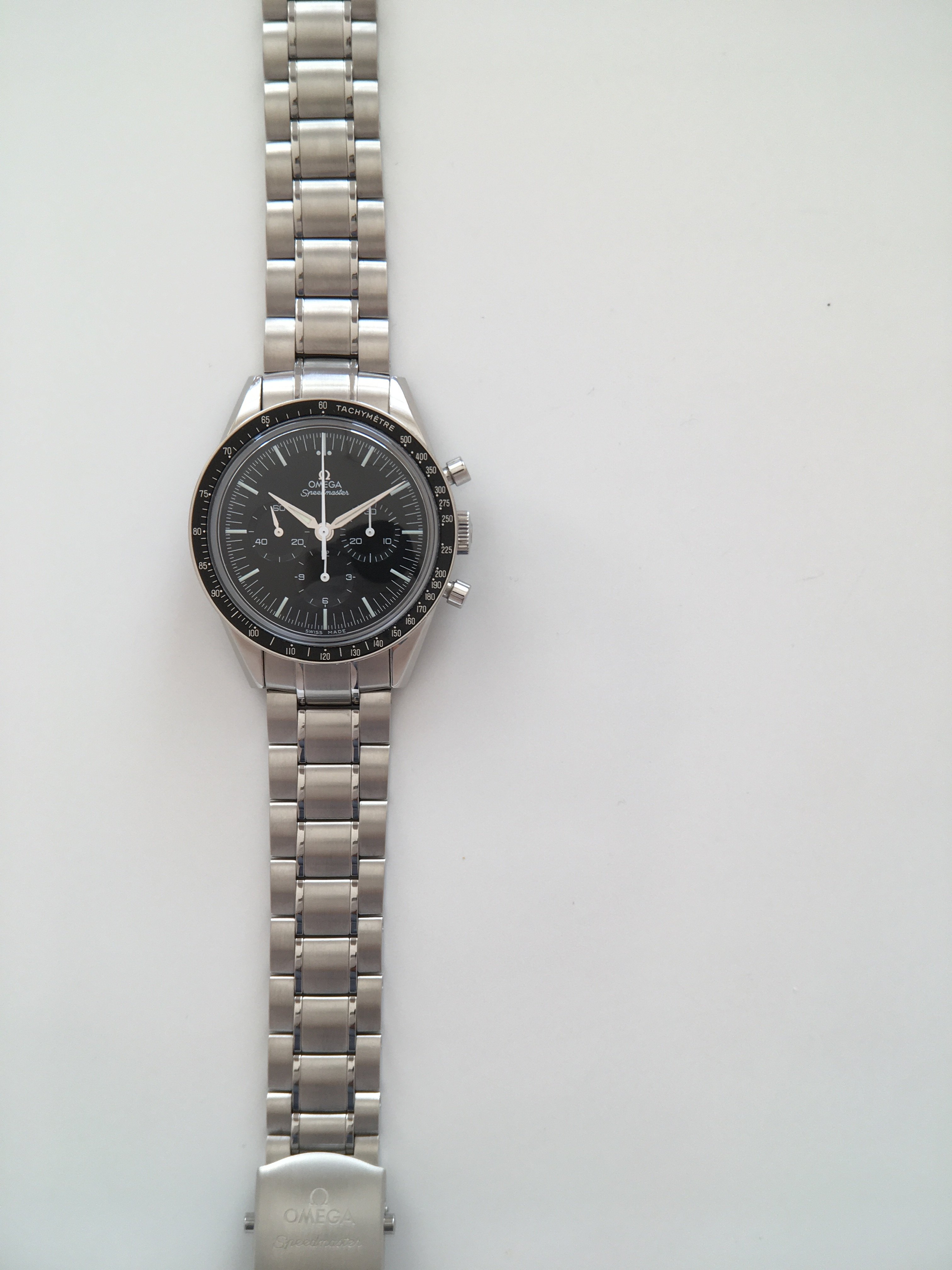

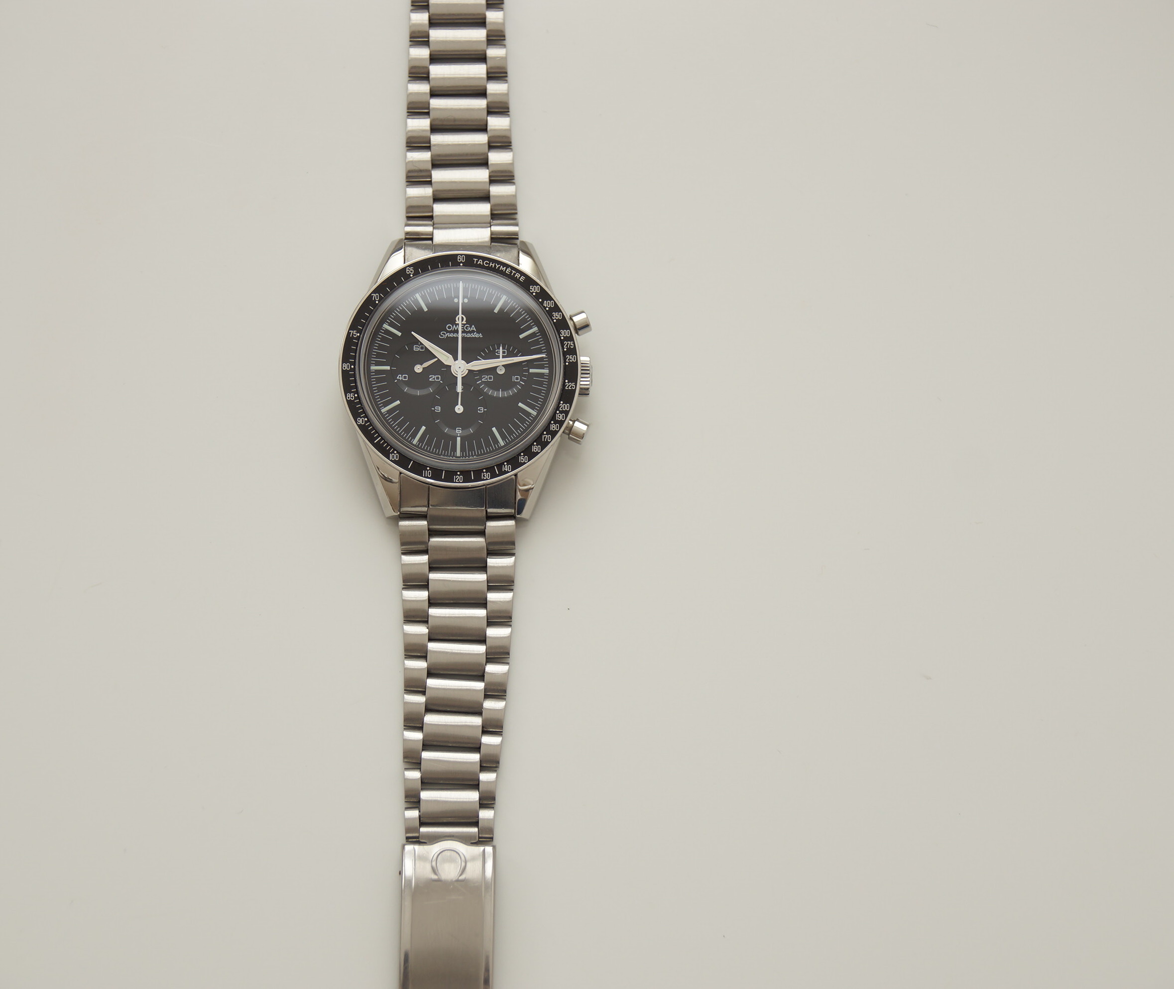

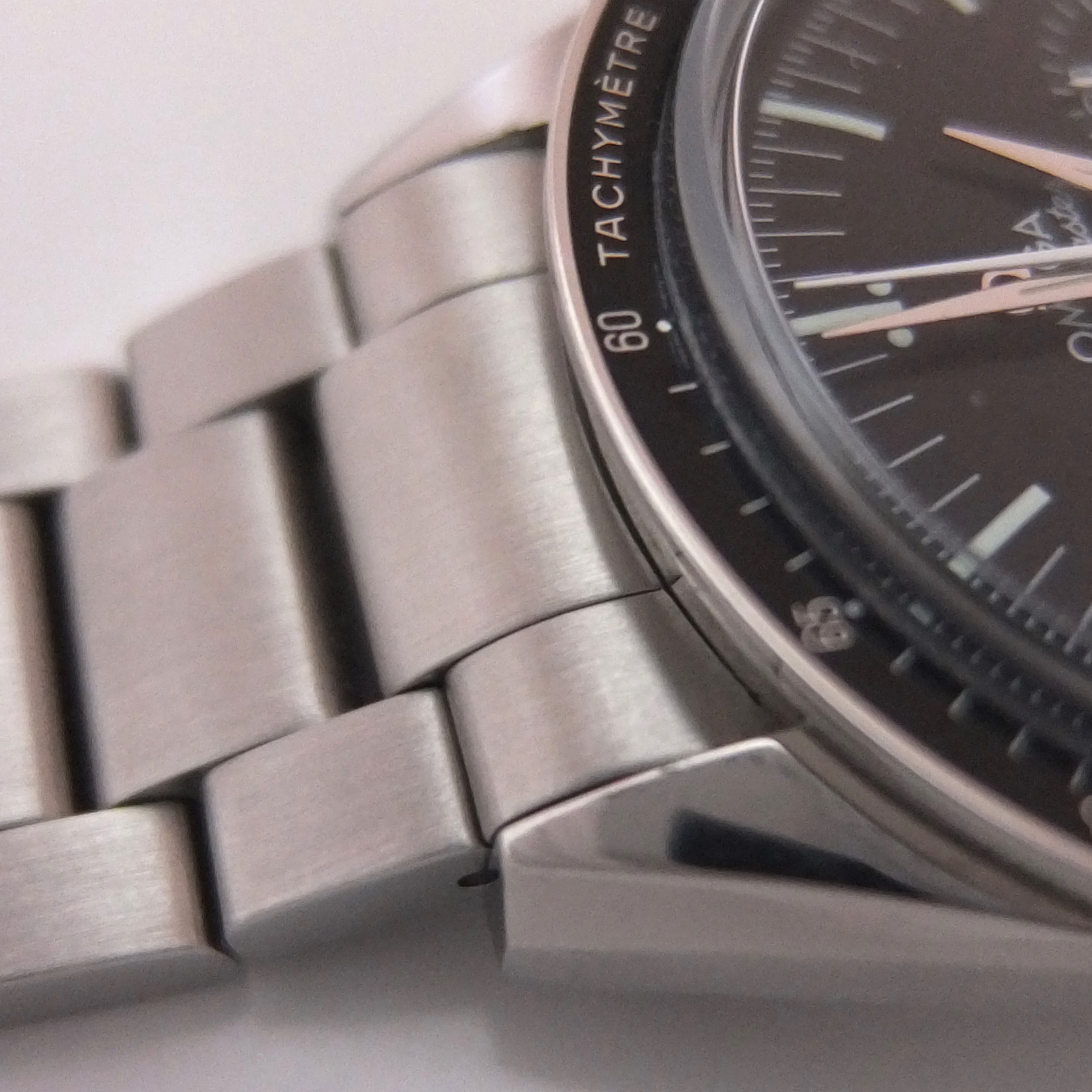

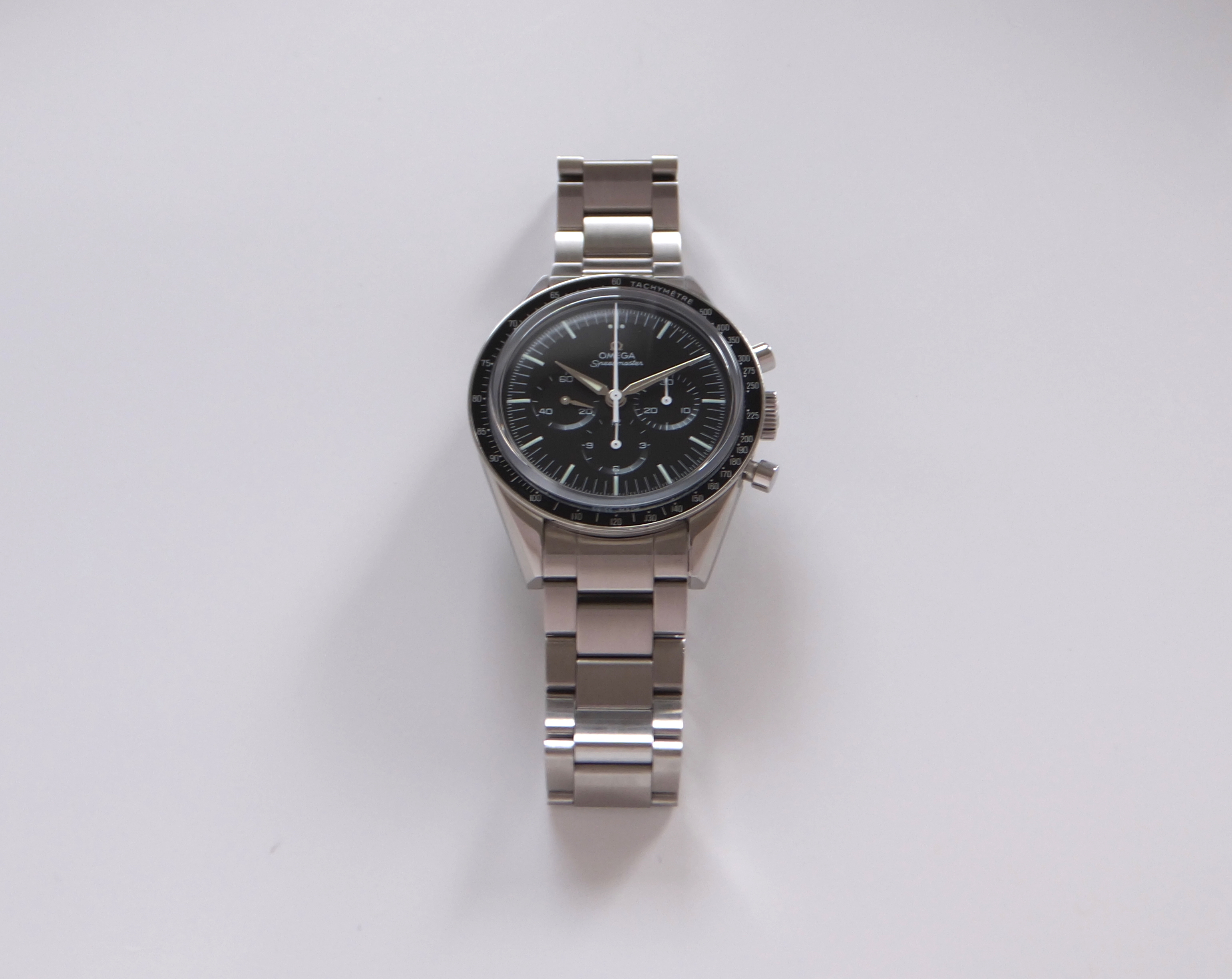

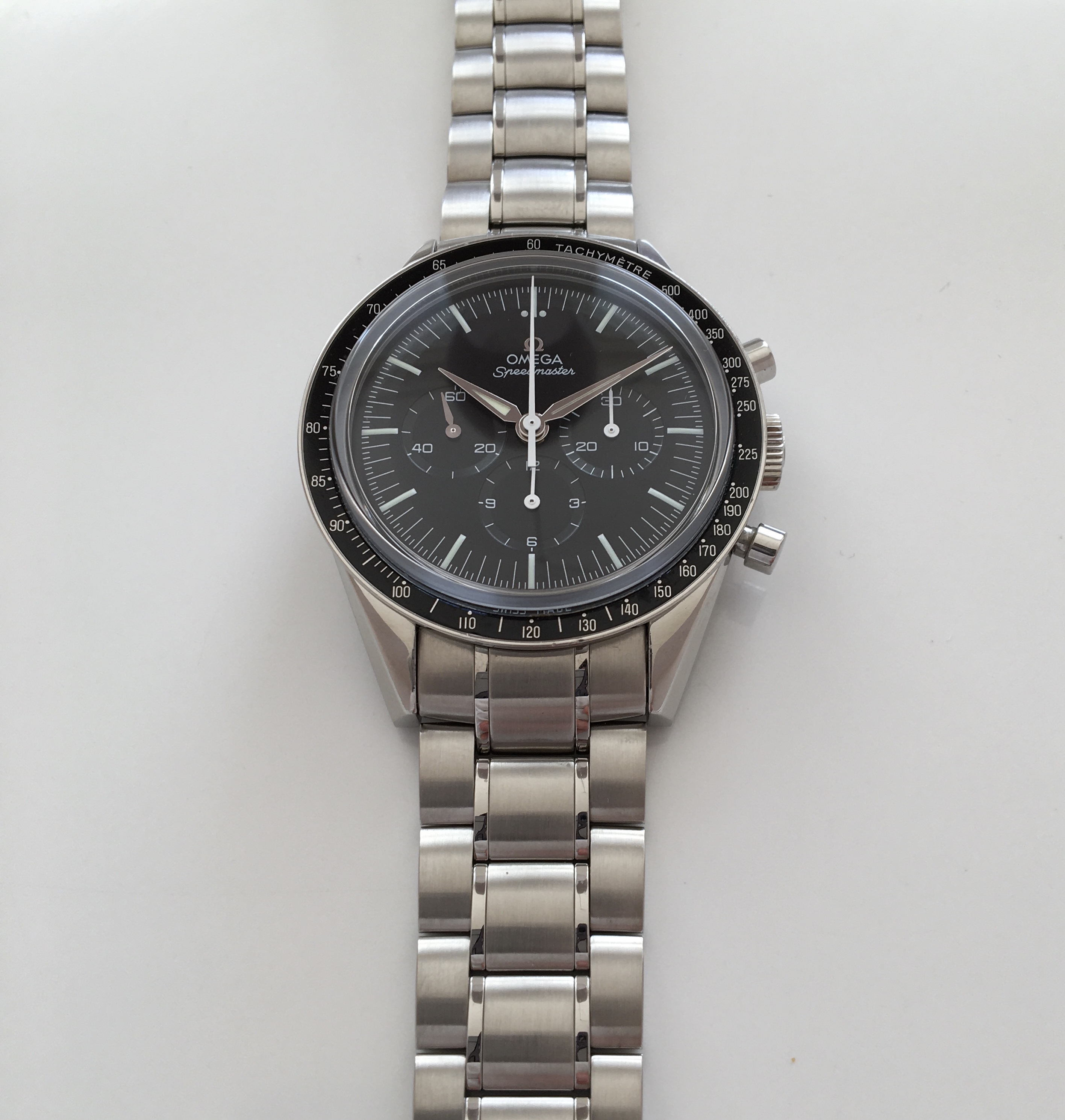

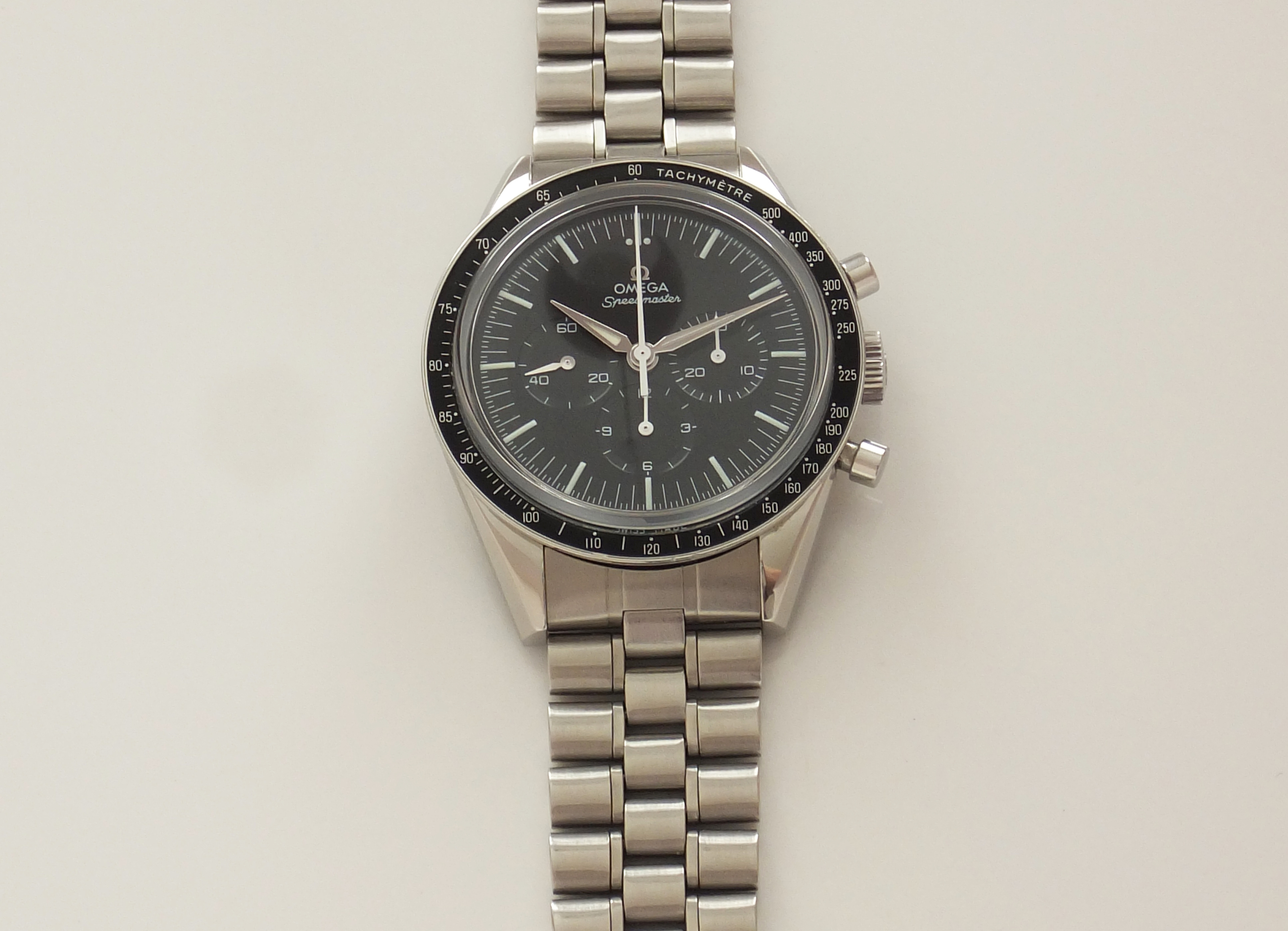

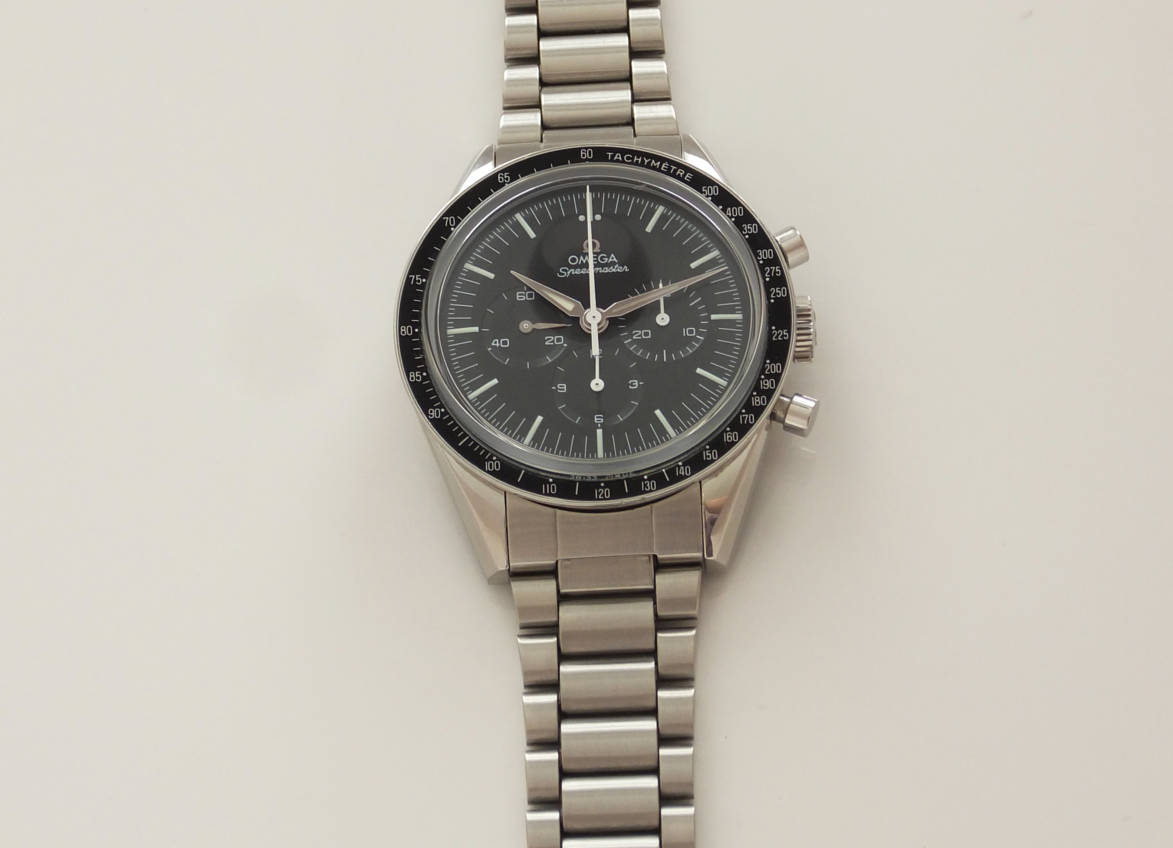

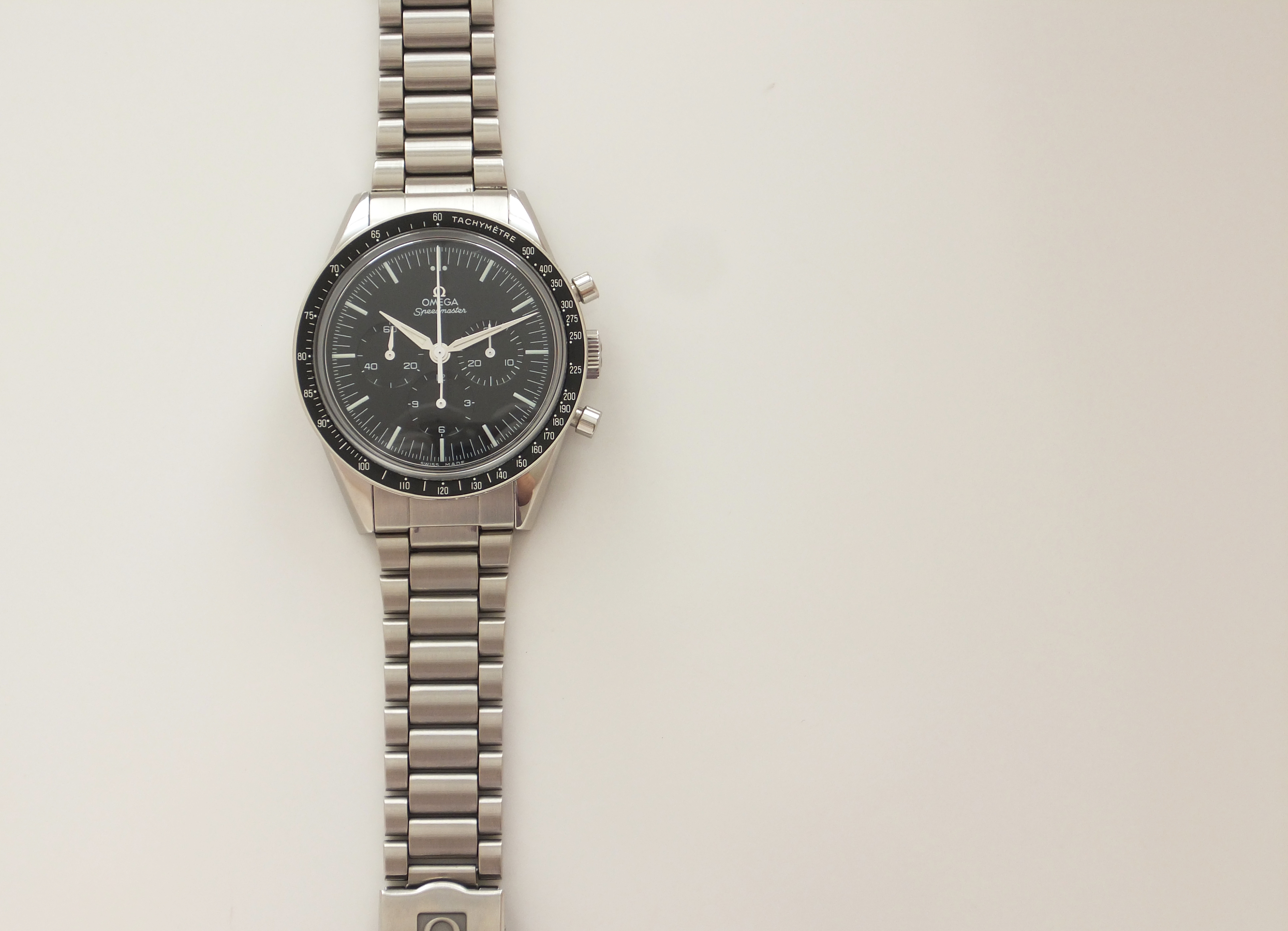

    FOIS on 1125 / 617 bracelet
    This is the one vintage looking bracelet for the FOIS that you can still get at the OB.
    The only tricky part was to find out that the spring bars (19 mm, 1,8 mm diameter) come in two different lengths. One short version reference 2206 for bracelets and one slightly longer reference 2207 for straps. The latter ones are coming with the FOIS and making it almost impossible to fit a bracelet to the watch. Take the short version and it will work.
    Bracelet reference 1125 (new from OB)
    Endlinks reference 617 (new from OB)
    Spring bars reference 2206 (Width 19 mm, 1,8 mm diameter, short version for bracelets)

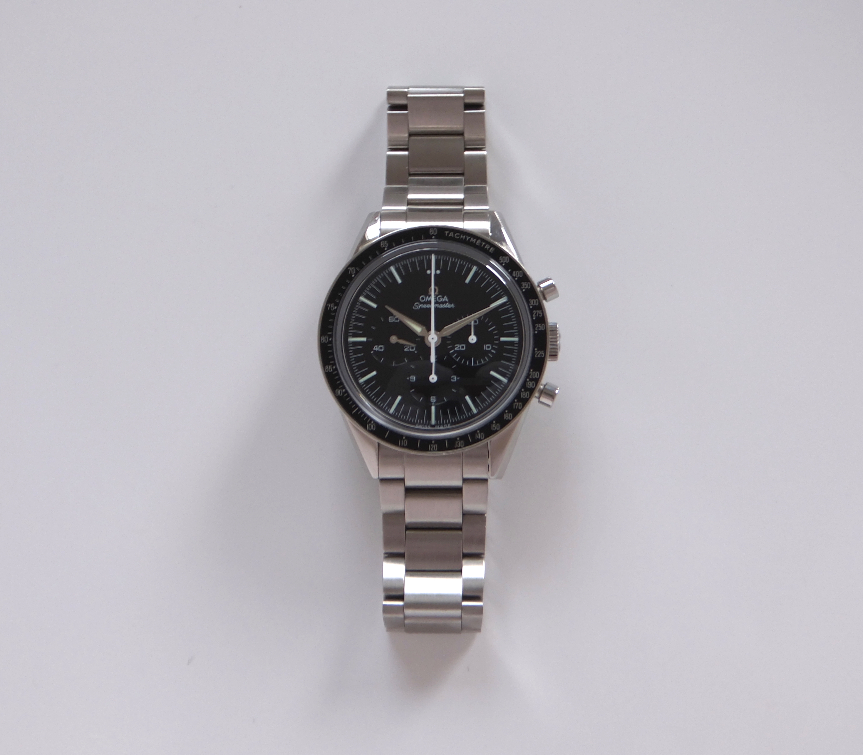

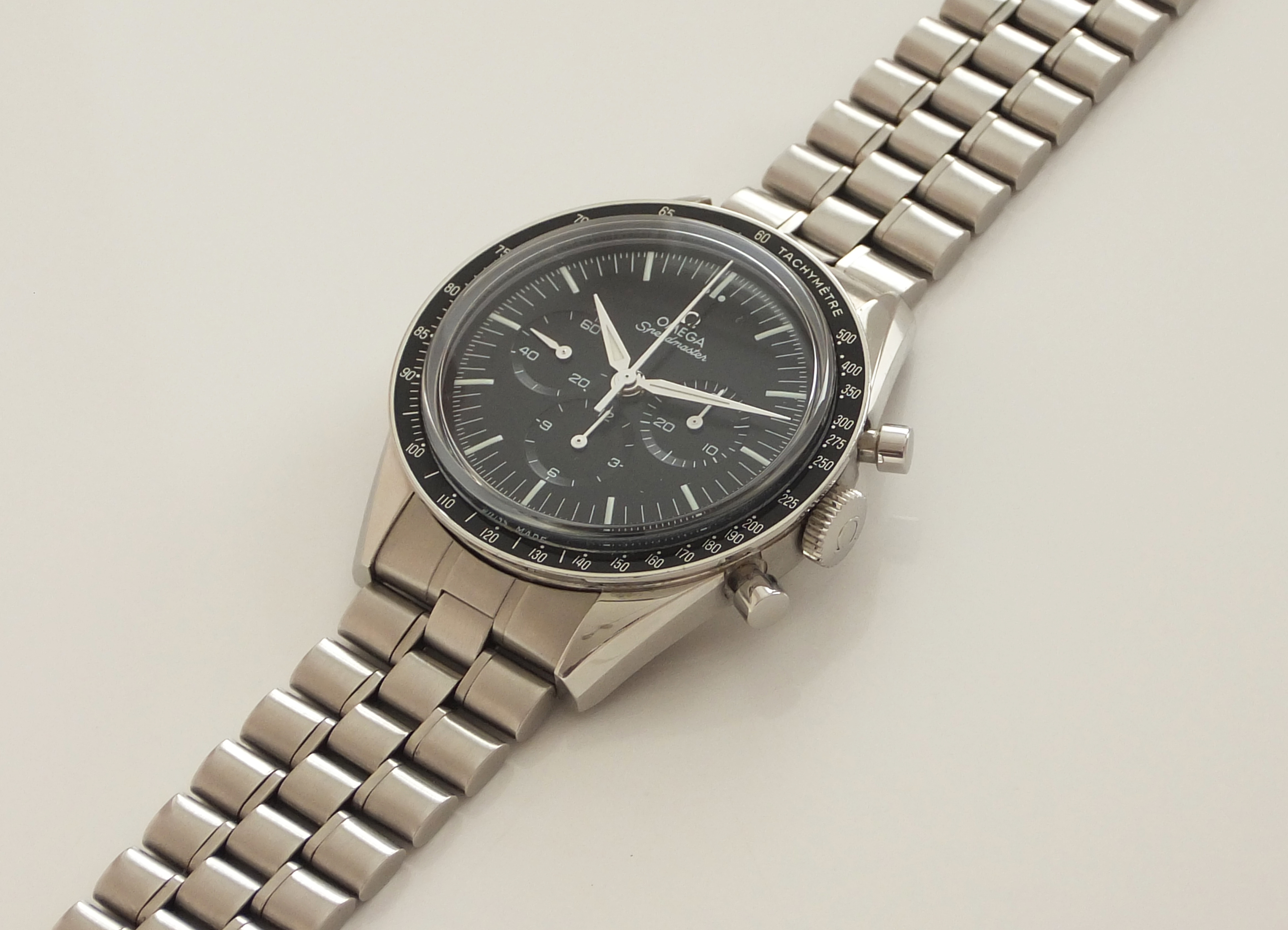

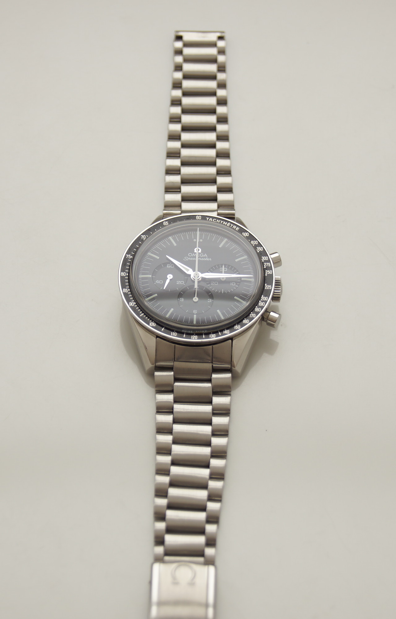

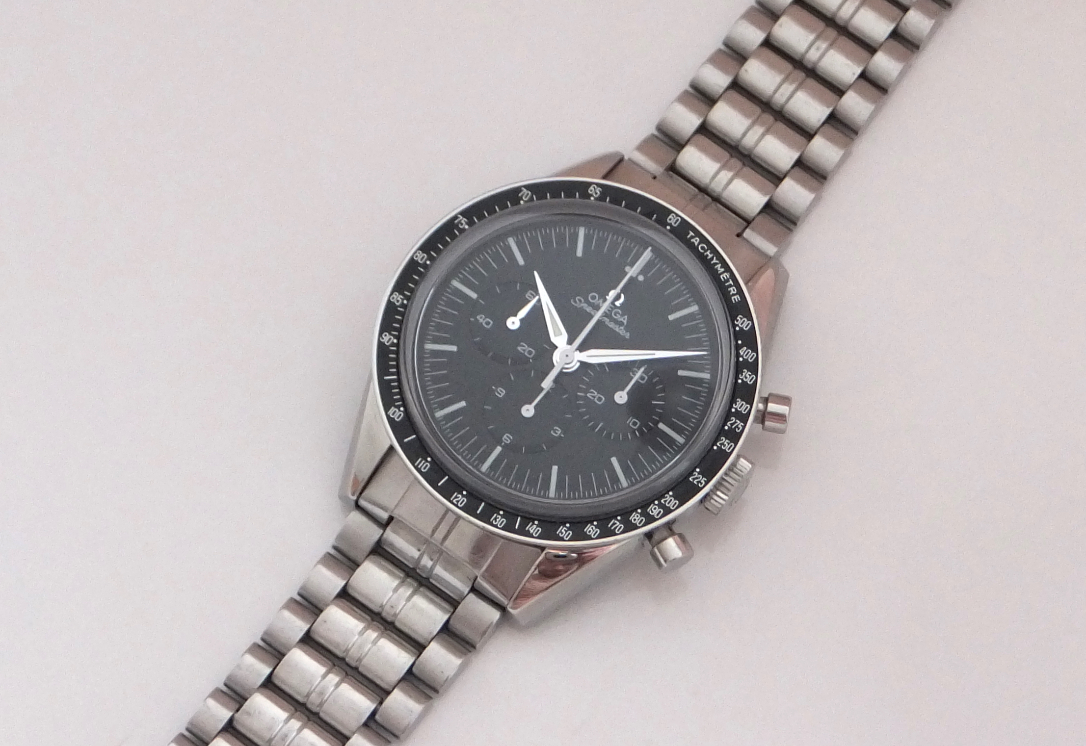

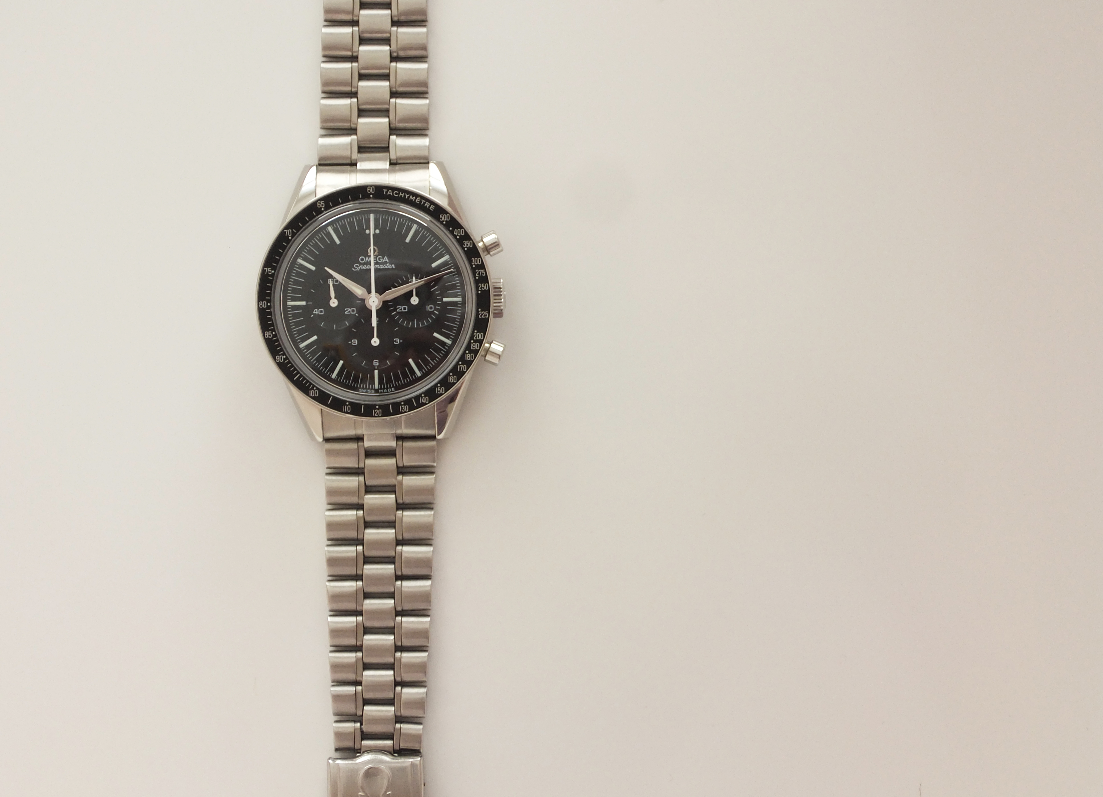

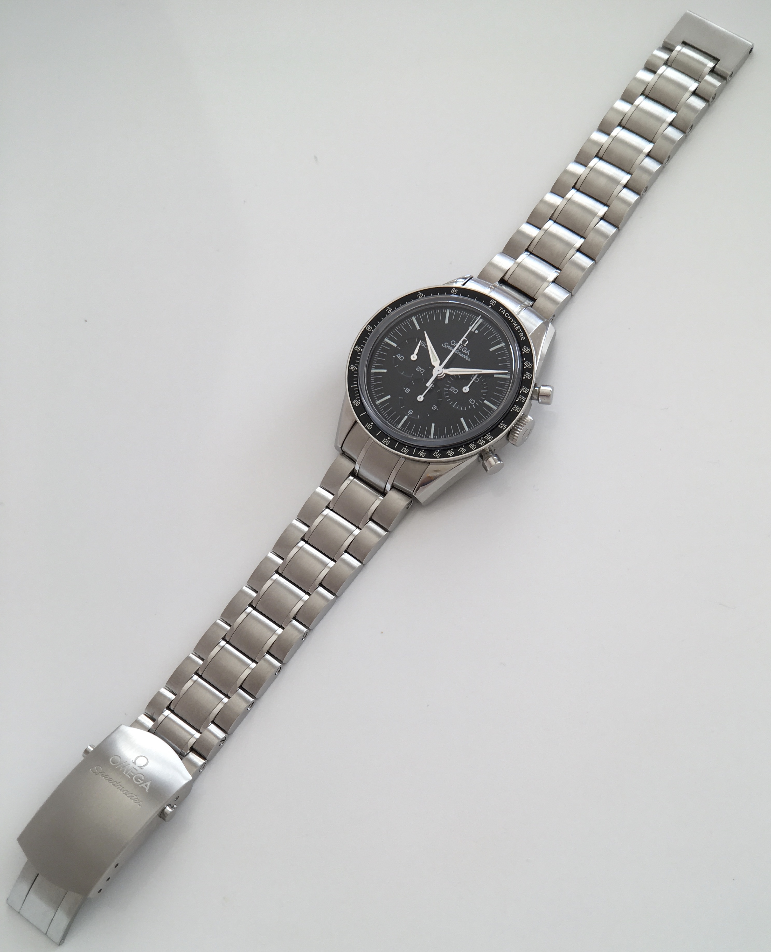

    FOIS on bracelet 1098 / 540
    I really love my Speedy Pro on the 1116 bracelet, so it was nice to see that the small brother 1098 fits the FOIS. And the endlinks 540 are still available at the OB!
    Bracelet reference 1098 (from second hand market)
    Endlinks reference 540 (new from OB)

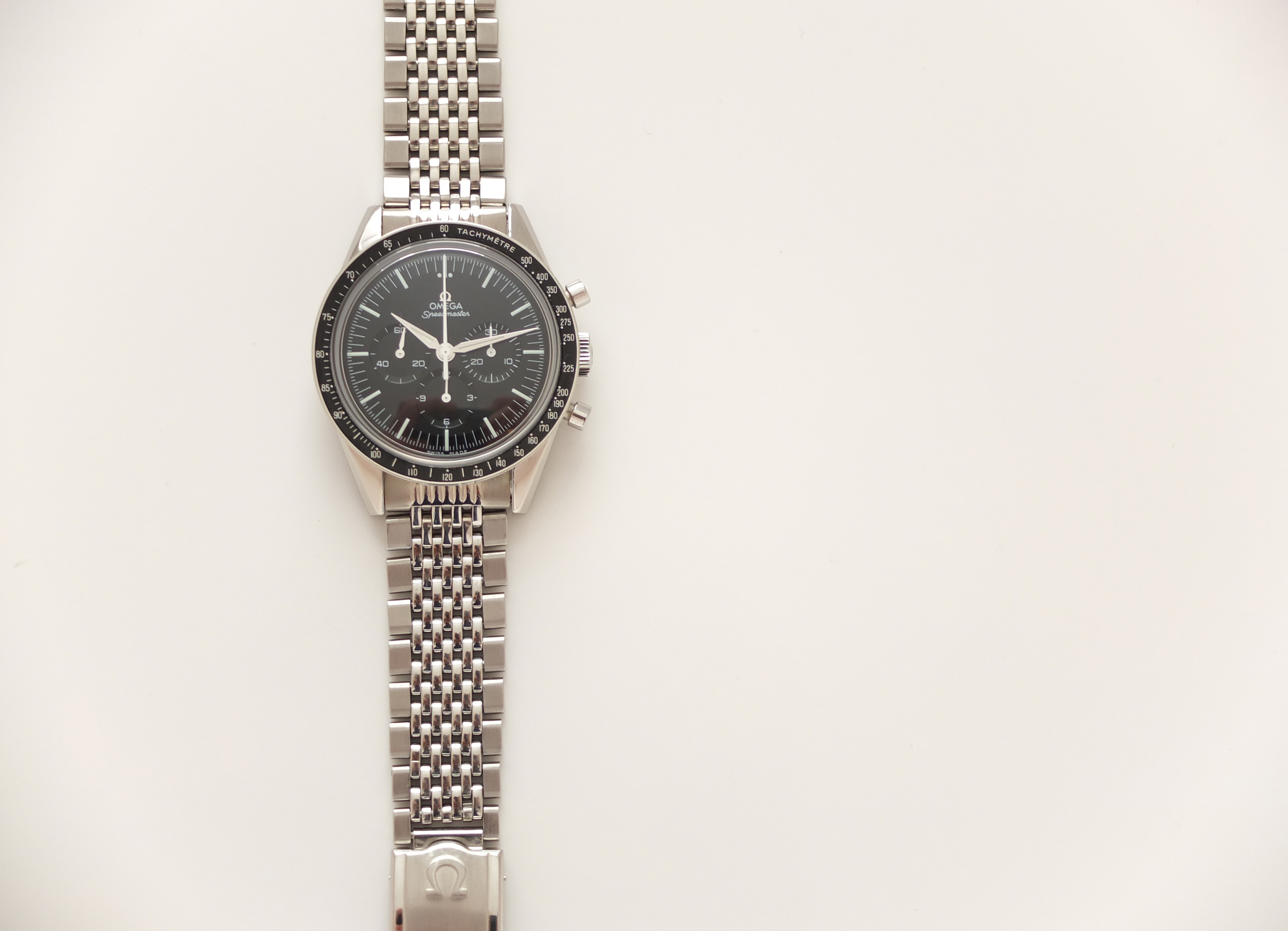

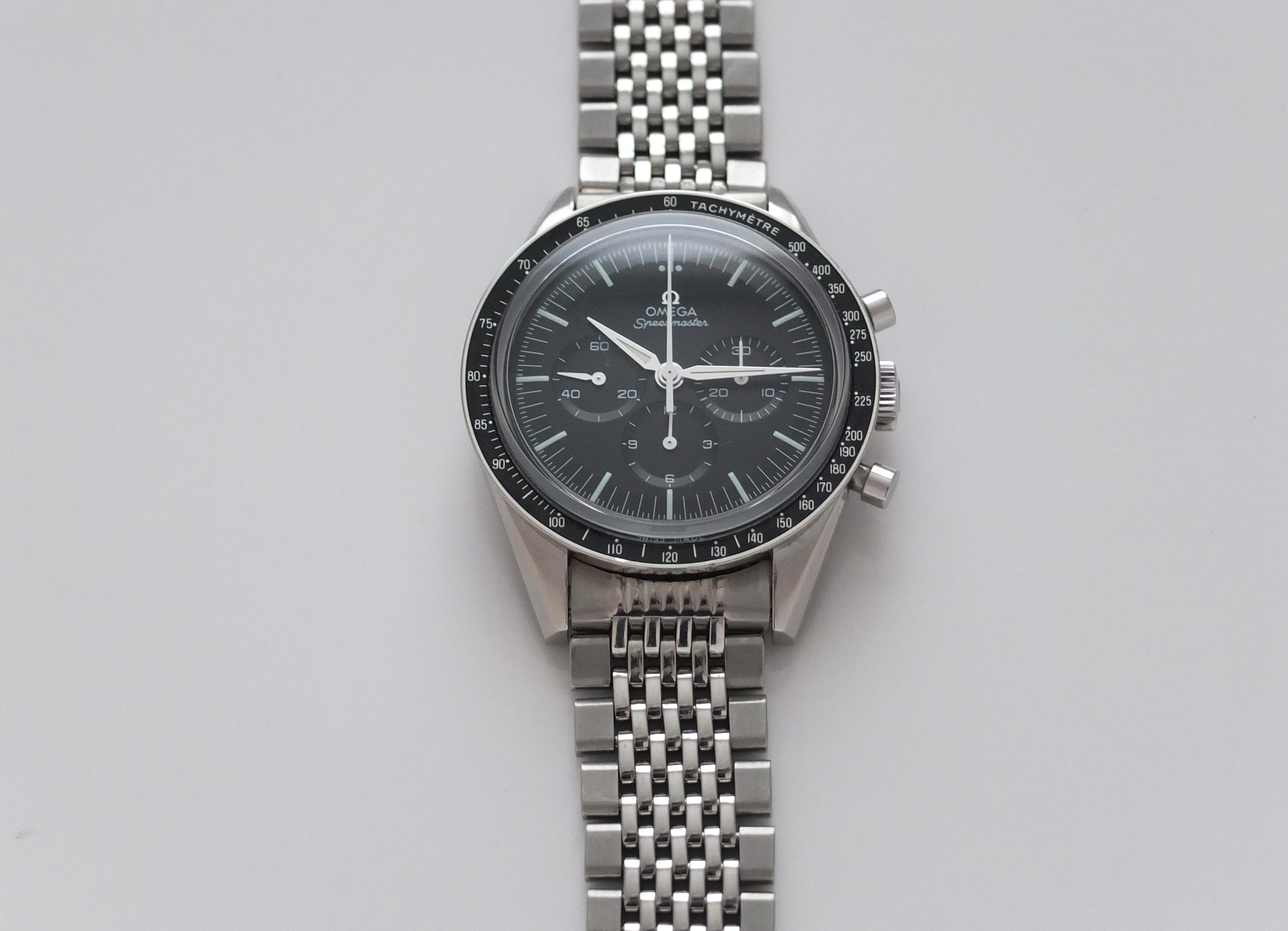

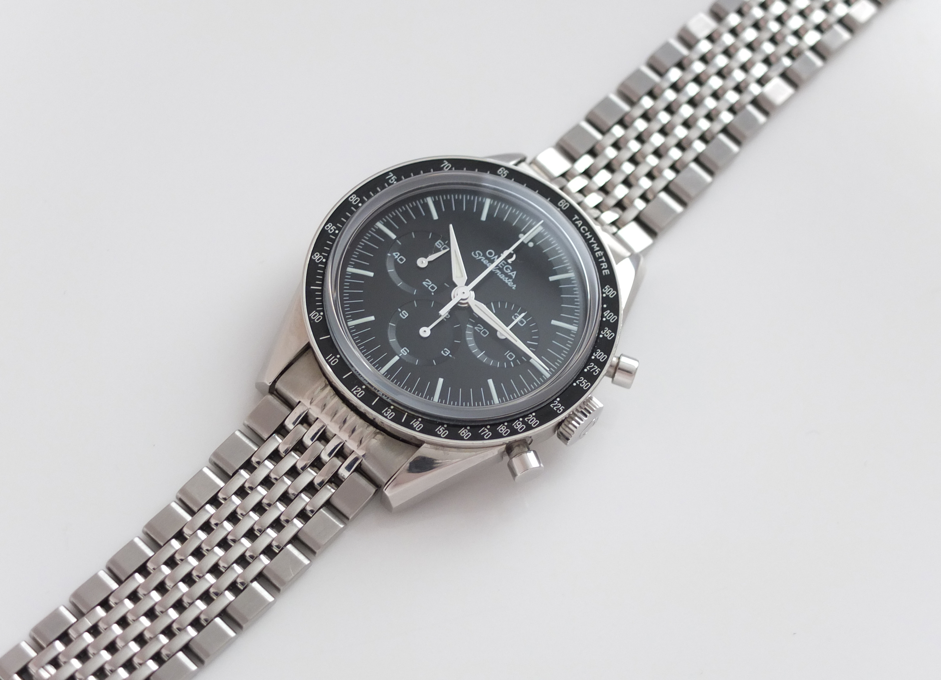

    FOIS on bracelet 1068 / 556
    To give the FOIS a kind of 60ies look I went for a beads of rice bracelet reference 1068. Again, the end links are still available at the OB! (Yes, the fit is not quite as good as the other bracelets, but …)
    Bracelet reference 1068 (used)
    Endlinks reference 556 (new from OB)

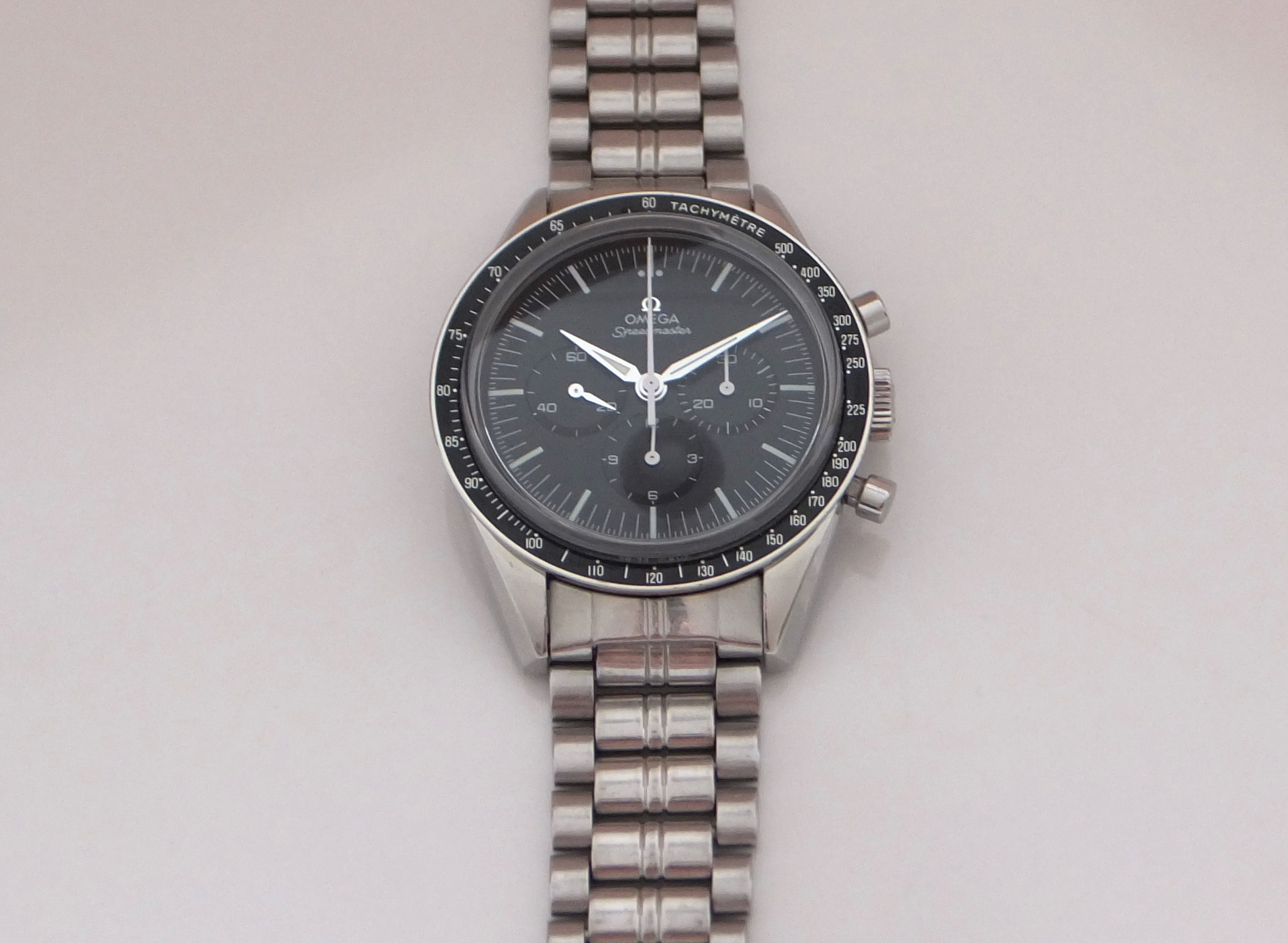

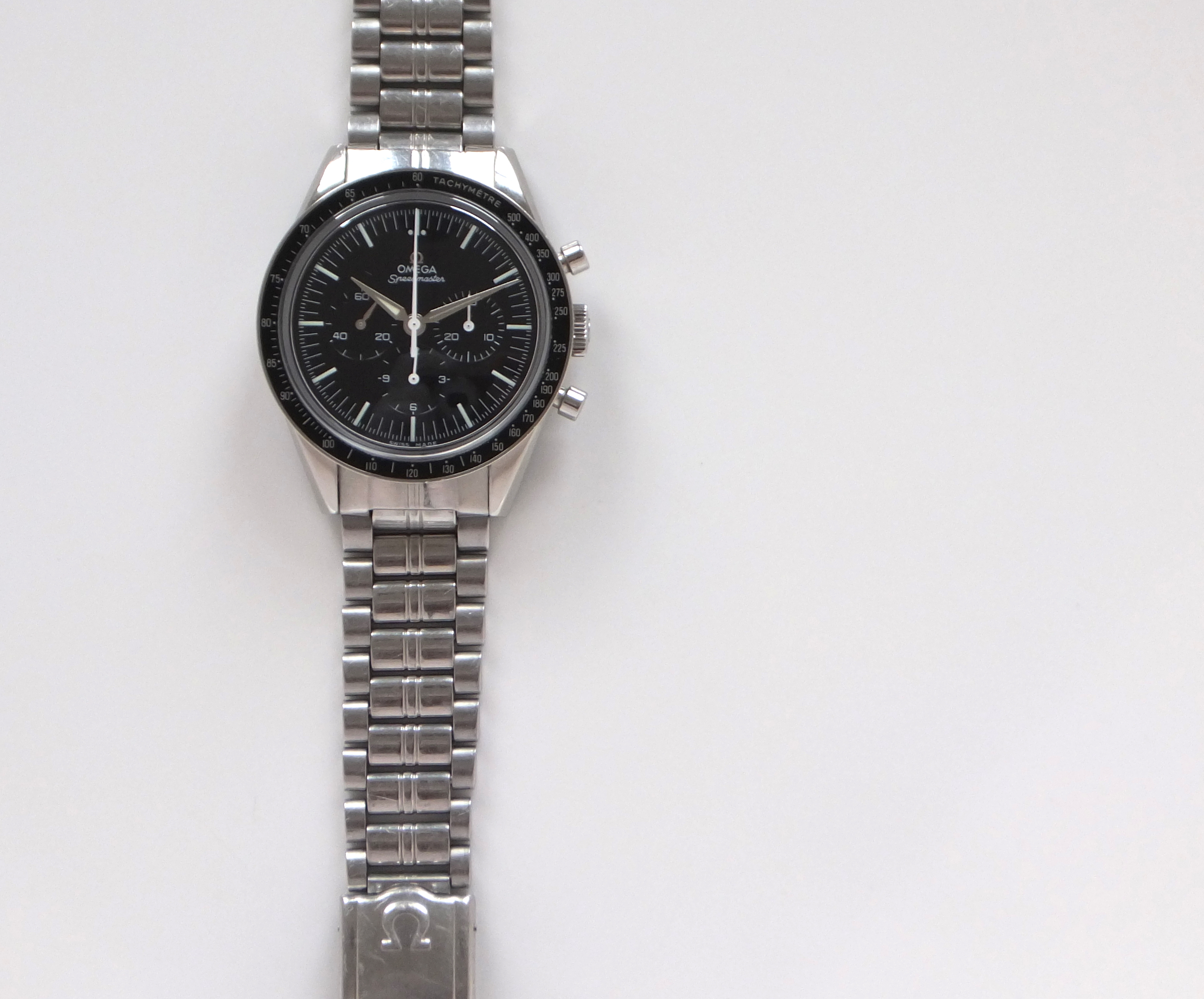

    FOIS on bracelet 1069 / 524
    Here ist the 1069 bracelet with the grooved center links. The fit is quite nice.
    Bracelet reference 1069 (used)
    Endlinks reference 524 (used)

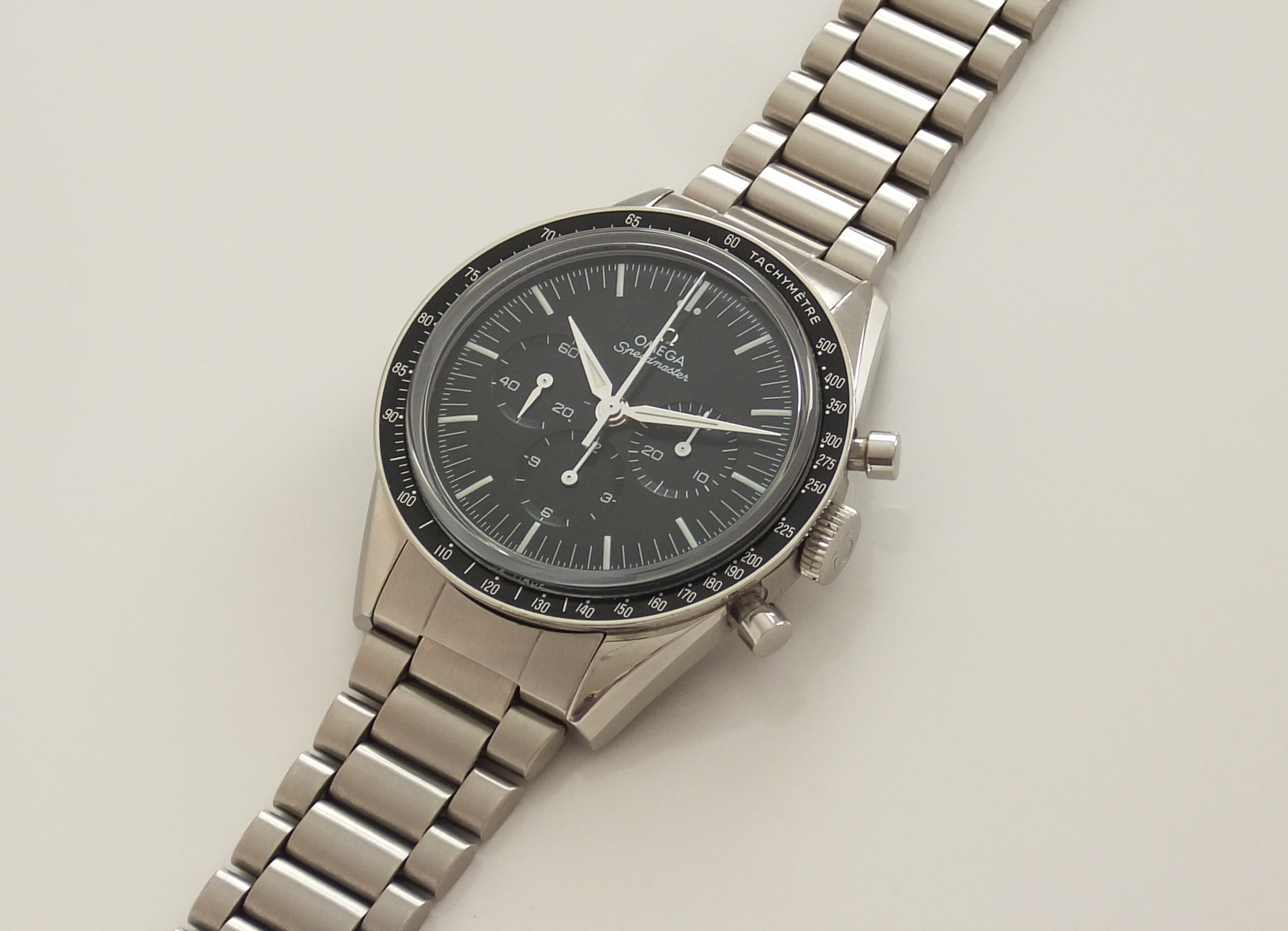

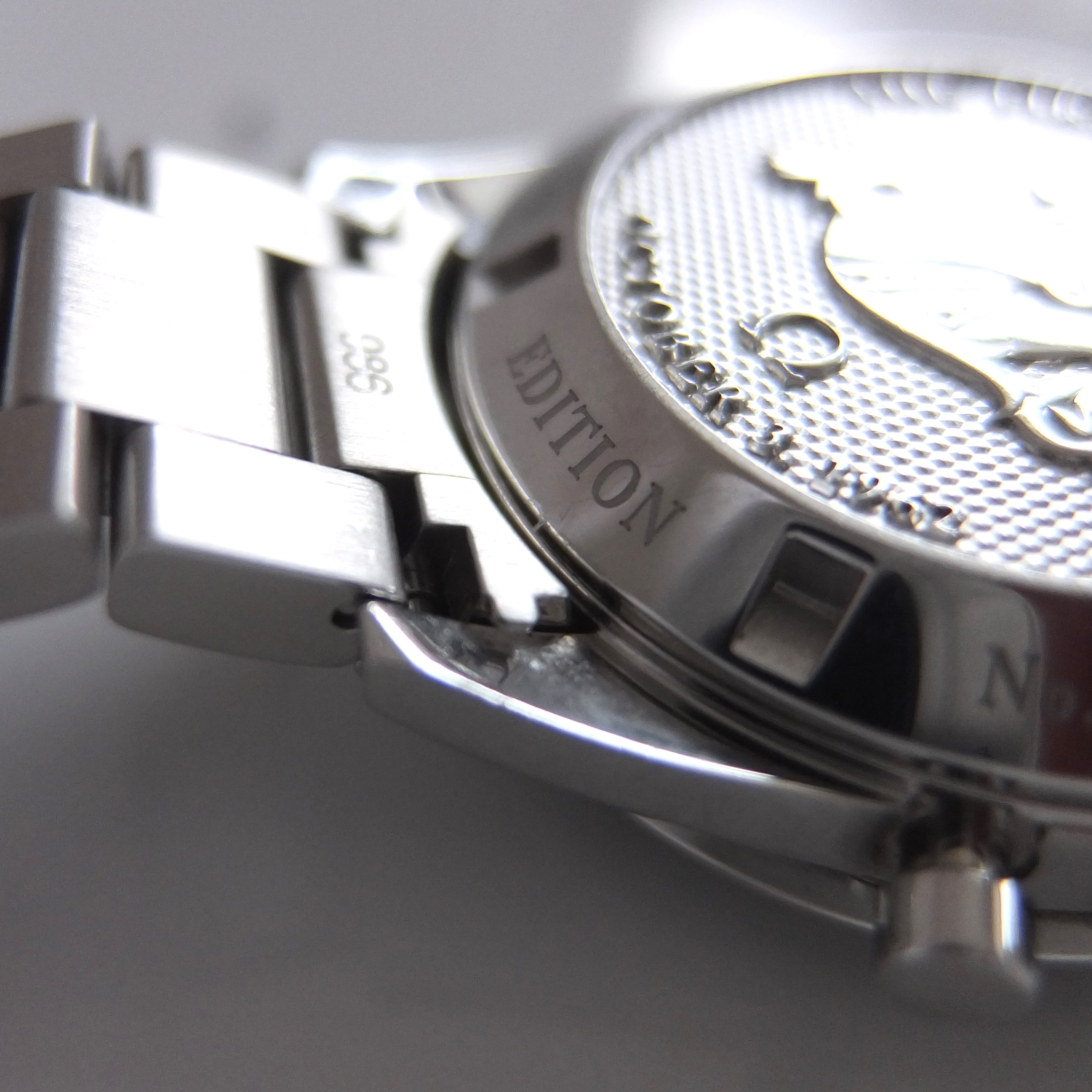

    FOIS on bracelet 1587 / 986
    After seeing several photos of the FOIS with this bracelet, I was curious to try it out. Modern flatlink bracelet on FOIS.

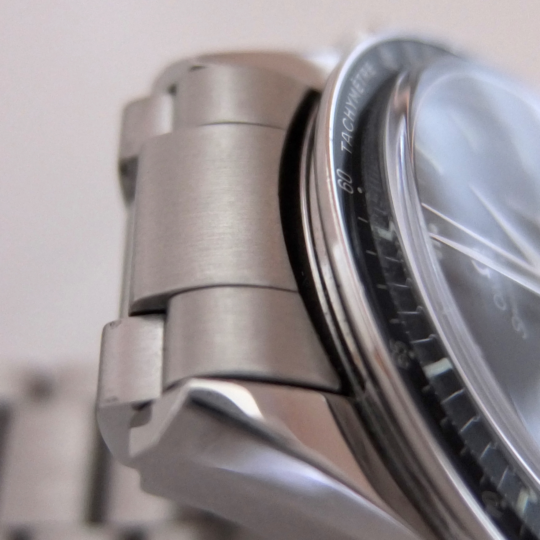

    In general the fit is quite good, but the small tabs of the solid endlinks are somewhat hanging in the air. Therefore the endlinks are rotating a bit around the spring bar and open a gab between watch case and endlink. See detail pictures below. Surely this can be solved somehow.
    Bracelet reference 1587 (new)
    Endlinks reference 986 (new)
    Small tabs hanging in the air.
    Nice fit with endlinks touching watch case.
    Not so nice fit with endlinks rotating and opening gap.

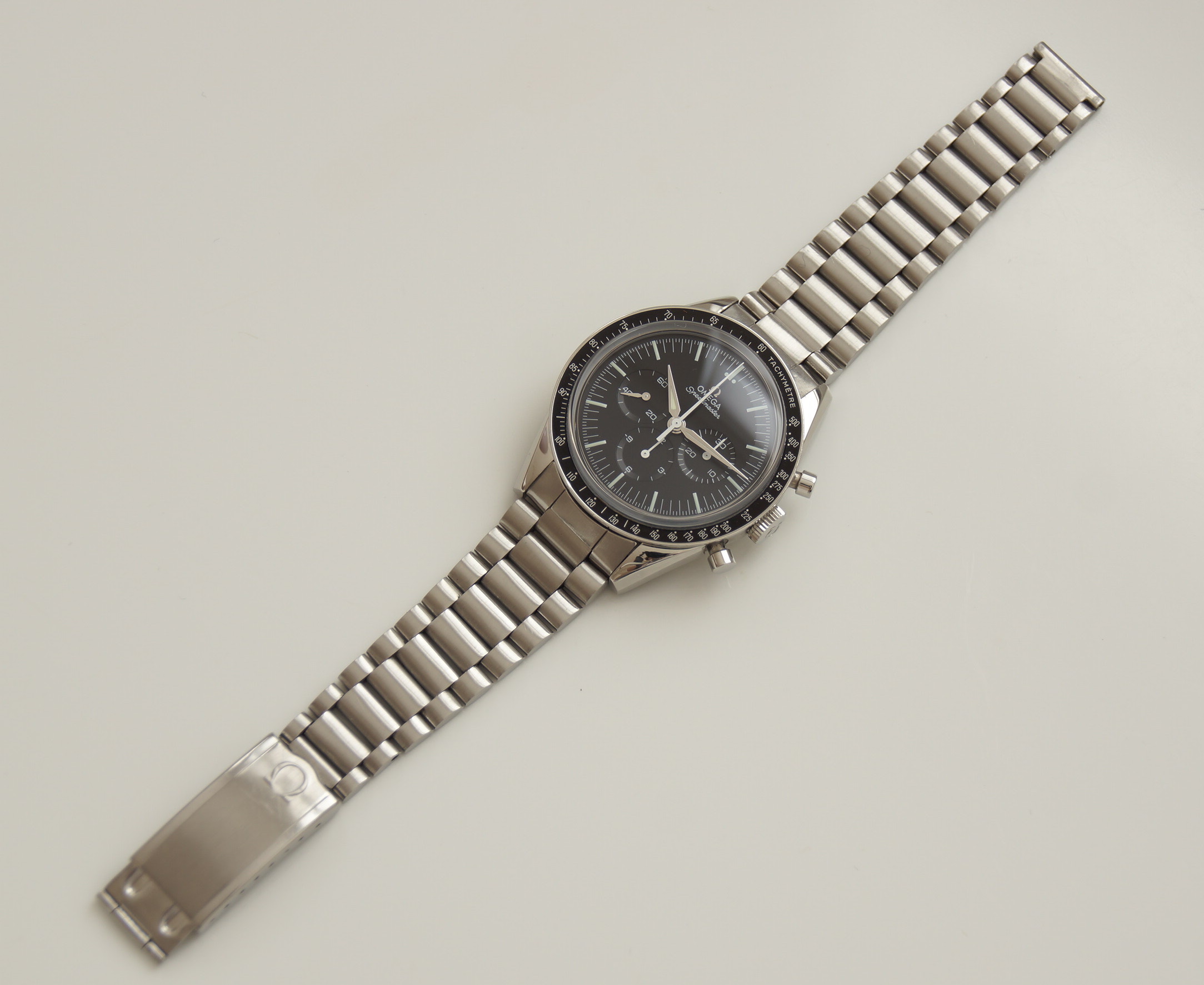

    FOIS on vintage 1125 / 560 bracelet
    I recently had the opportunity to purchase this vintage 1125 bracelet with 560 end links at a good price. So I tried it and it fits the FOIS very well.
    The vintage version of the 1125 bracelet is different from the modern version with more taper and a small clasp cover with embossed logo and grooves. I really like the taper from 19 mm to 15.5 and the old version of the clasp.

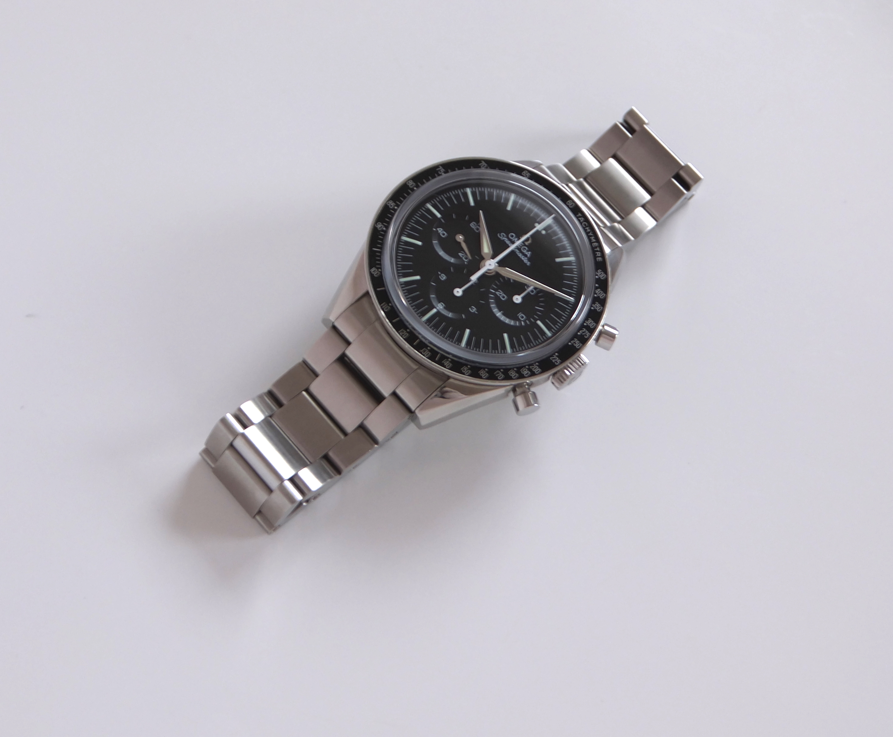

    FOIS on modern 1565 / 976 bracelet
    I had the opportunity to borrow this bracelet to mount it on my FOIS and take some pictures to kind of round off my post.
    The fit of the solid end pieces is very good, especially when you consider that the bracelet was intended for another watch with a different case shape. It is very solid and, together with the two security pushers, offers a robust bracelet for everyday use.
    I assume that the bracelet 1564/975 fits similarly well, because it only differs in the links with pins instead of the screwed links of the 1565/976.
    Note for small wrists: The end pieces shift the axis of rotation of the bracelet outwards, causing it to bend significantly downwards for small wrists. I prefer bracelets where the spring bar is also the axis of rotation for the bracelet.
    Bracelet reference 1565 (new from OB)
    Endlinks reference 976 (new from OB)

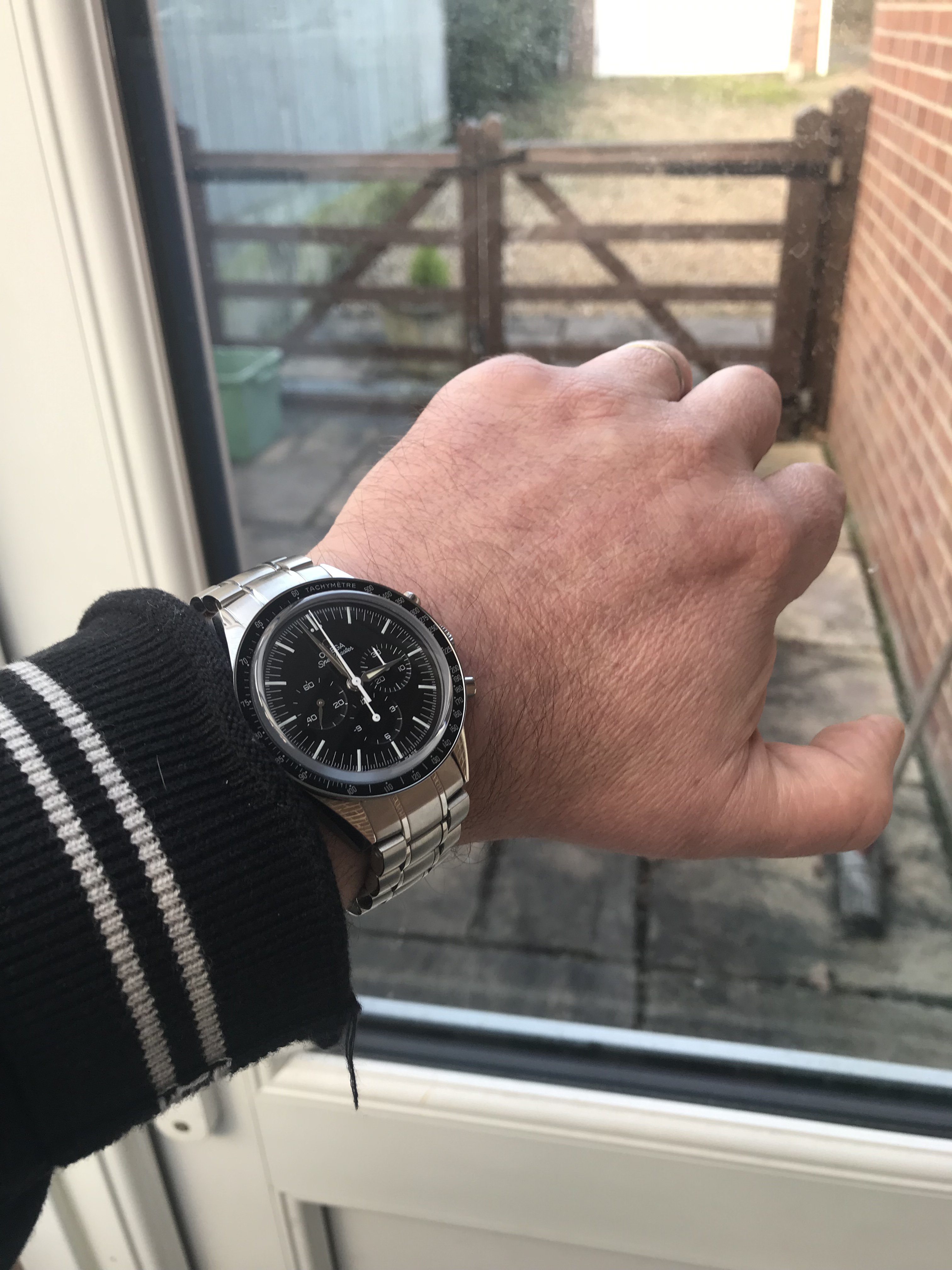

    I have the 1125 with straight endlinks and it does the job though I mostly wearing my FOIS with nato.

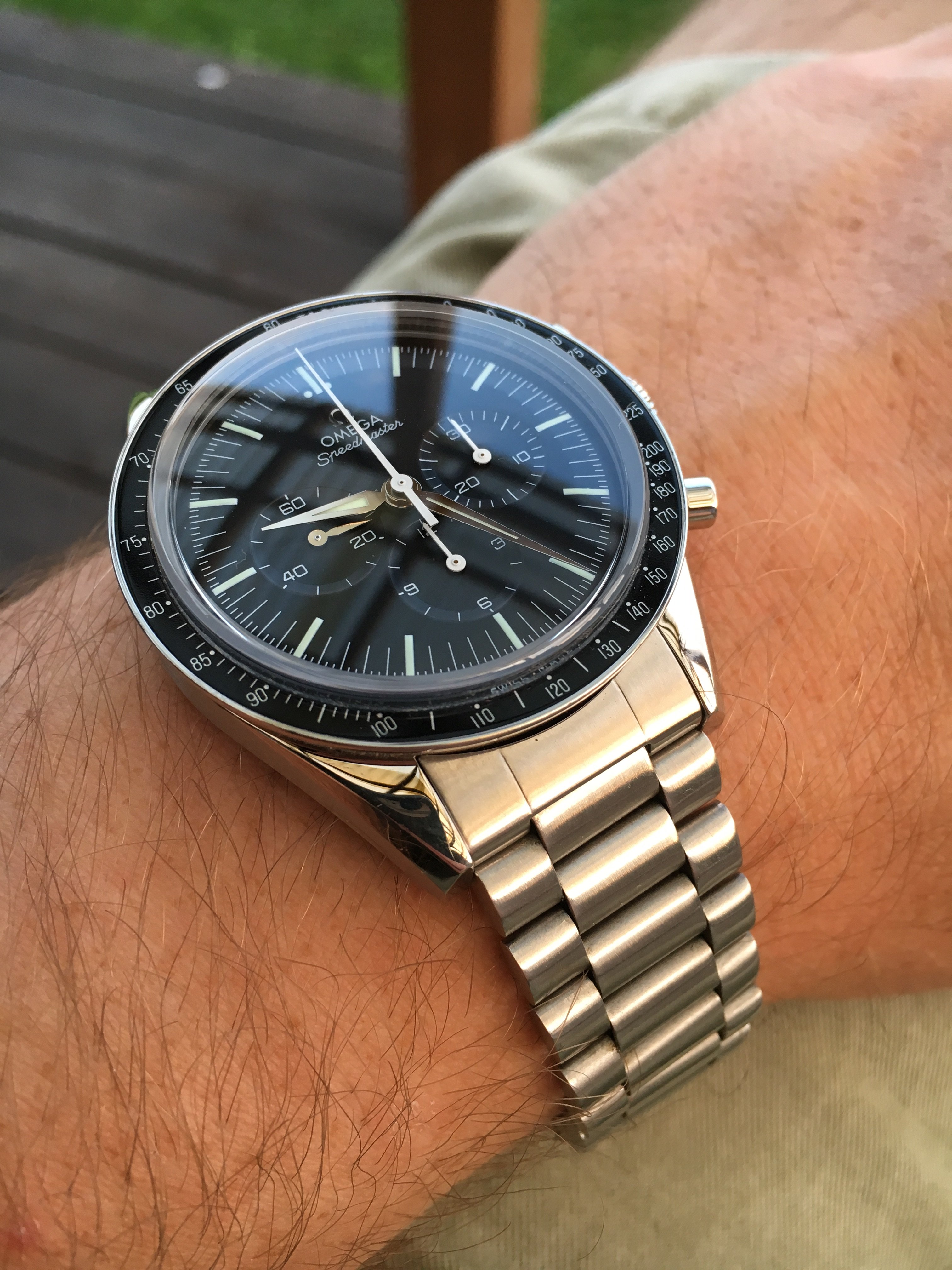

  3. Risto May 30, 2019
    1,492
    4,620
    Excellent article!
    I have 1125/617 myself and I feel it's the best combination.
    I have older 1125 (that you can't buy from OB).
    I'm wearing my FOIS in rotation with 2 TwoStitchStraps leather straps.

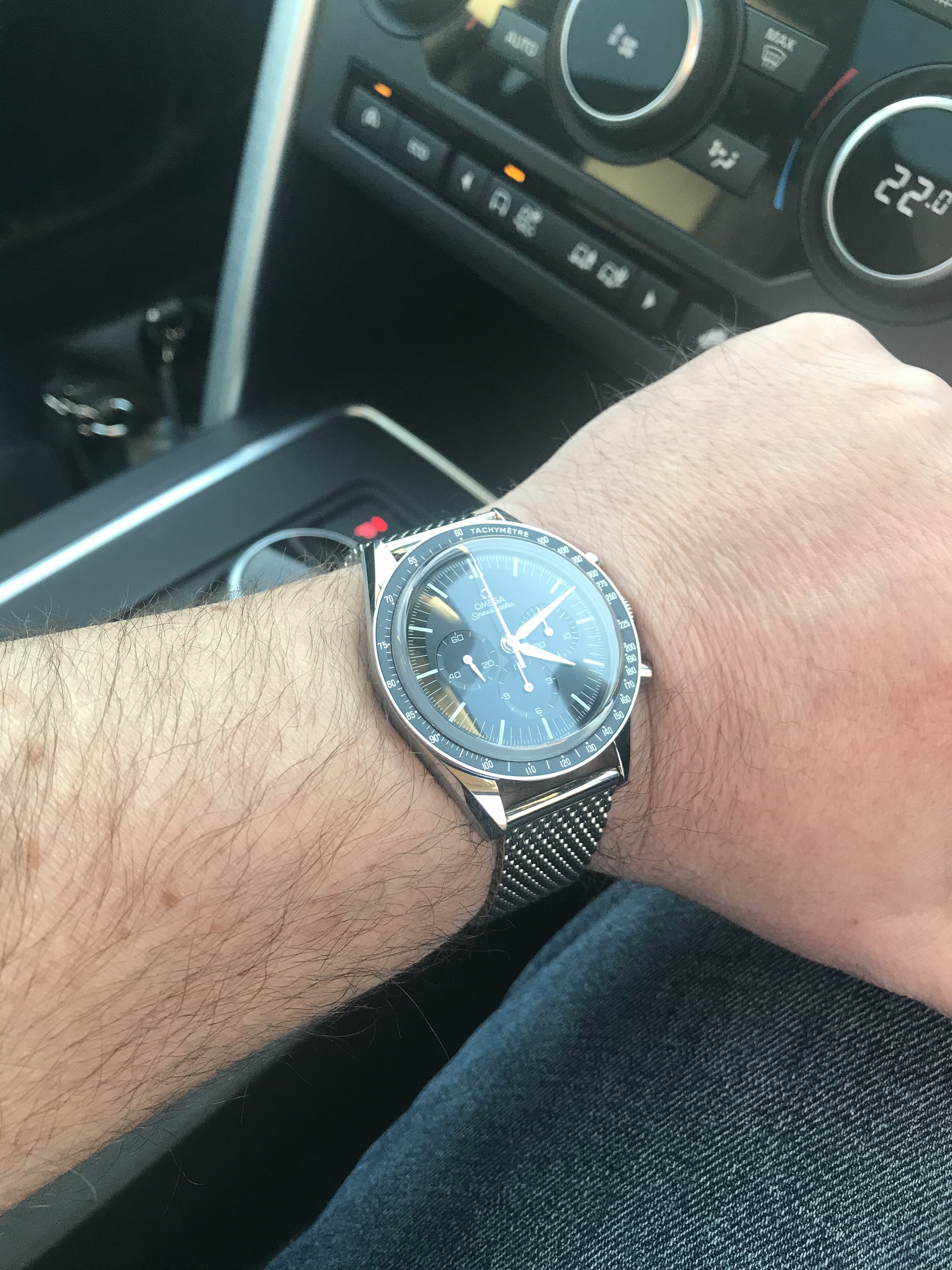

    A pic on speedy racing if anyone is interested

    No - it was about 30 quid from watch gecko. Easy to adjust and a comfortable bracelet.
