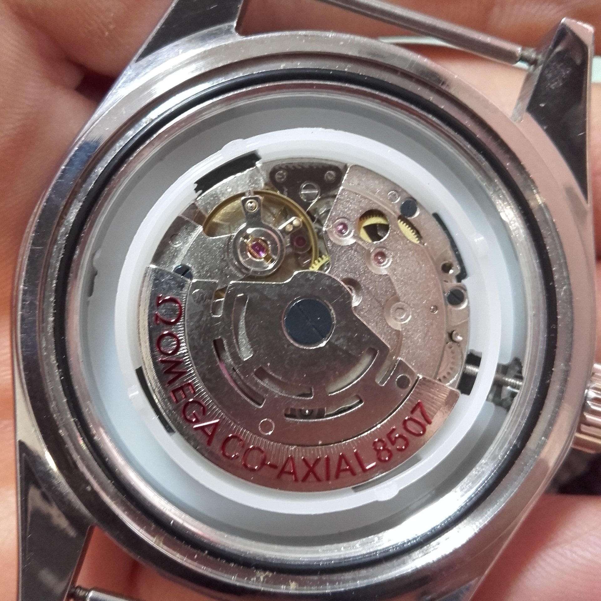

Just look at the balance; they might be able to replicate bridges etc to look nearly genuine, but they cant replicate the free sprung balance - always look at the balance to begin with and you'll know its a copy in a matter of seconds.

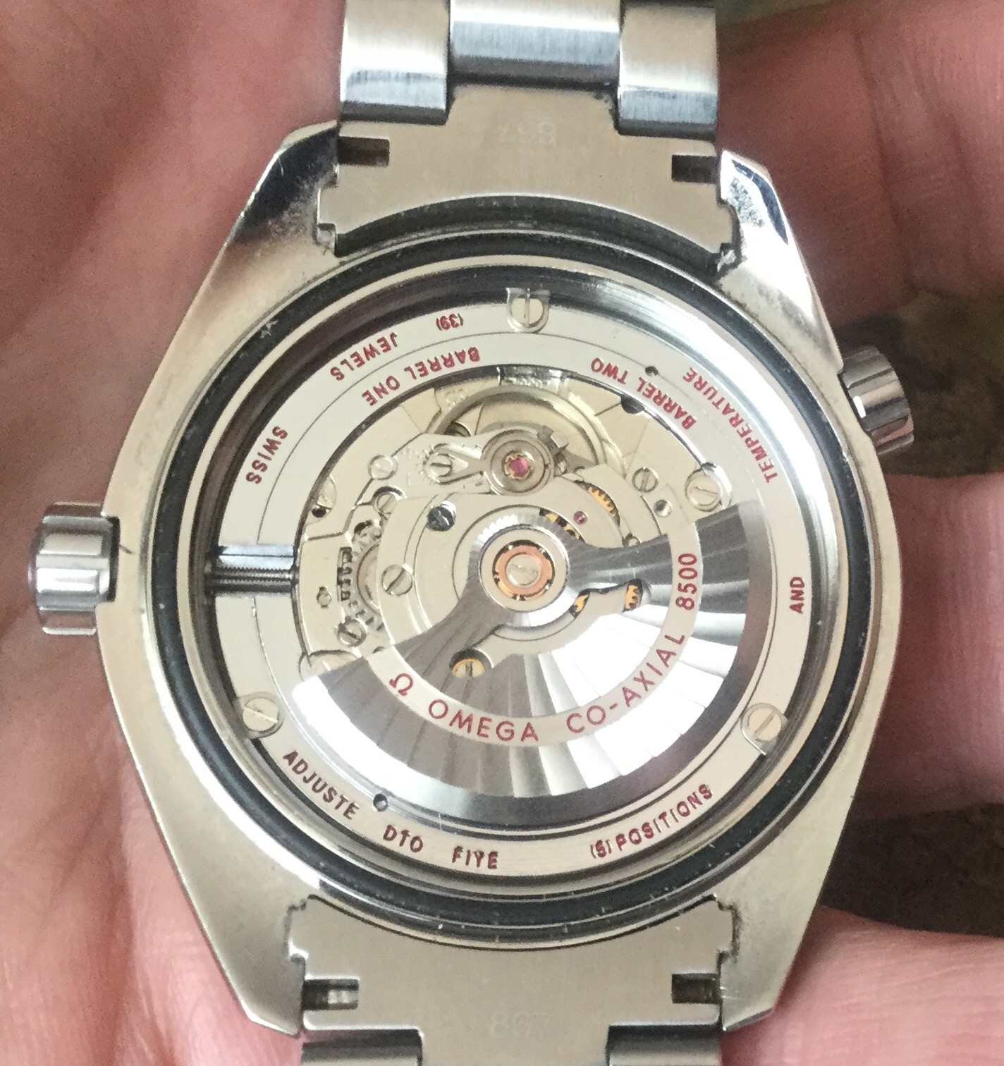

The worst Omega co-axial fake I have ever run into! Notice the printing ADJUSTE (space) D, and FIYE positions! And it in no way resembles an actual co-axial. At least none that I have ever seen.

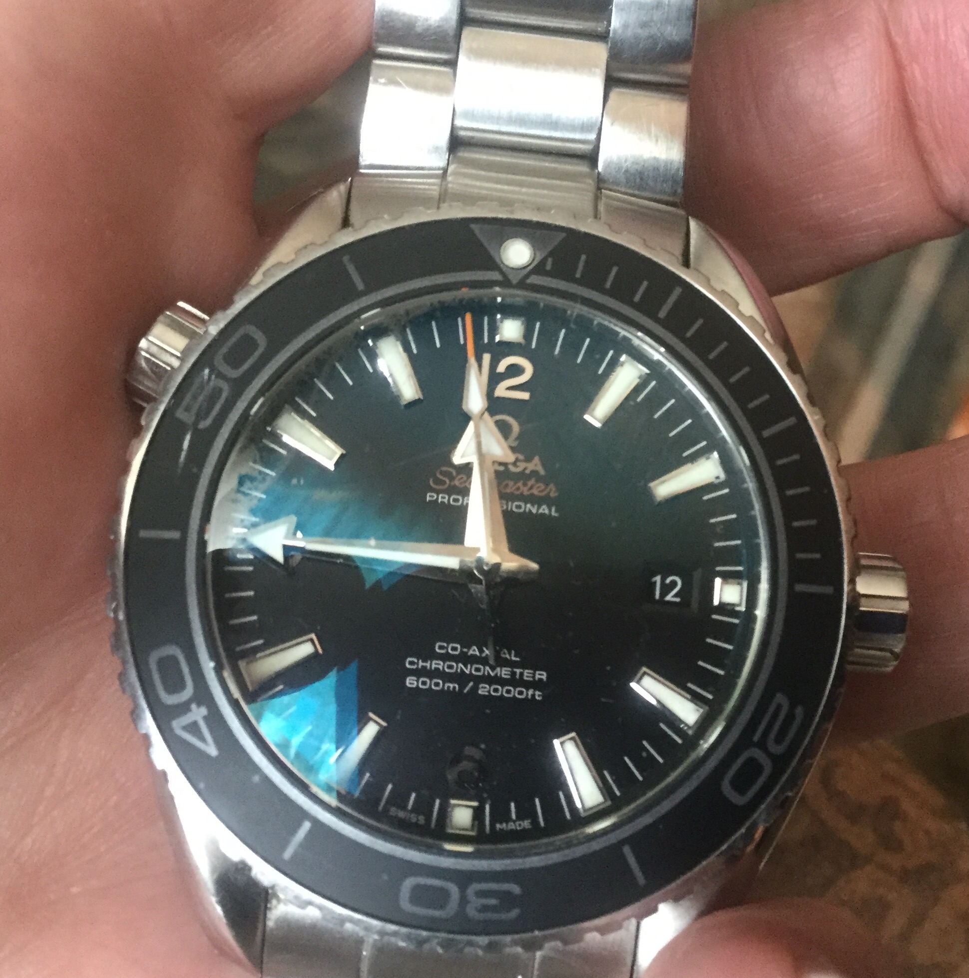

Overall, I think this is quite unbelievable to see this level of quality for a replica, given that the cost is probably around $300-350.
I assumed that replicas could be easily be determined when a crystal face back was installed, ie fake is so bad it can easily be spotted. I am mistaken on that assumption.
It's pretty amazing how much work is going on with the making of these things, and they would easily fool a lot of casual buyers. If you saw it on somebody's wrist when at a party for example, you couldn't tell unless you really examined it closely. With the ease of 3-D printing and such the fake issue is just going to get worse, methinks. Weird, when with all the effort maybe they could make something original? Very perplexing.

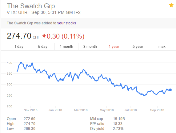

That still leaves ridiculous profit margins.
Can't say I am in the stock for the long haul, but I am in with Speedmasters for the long haul

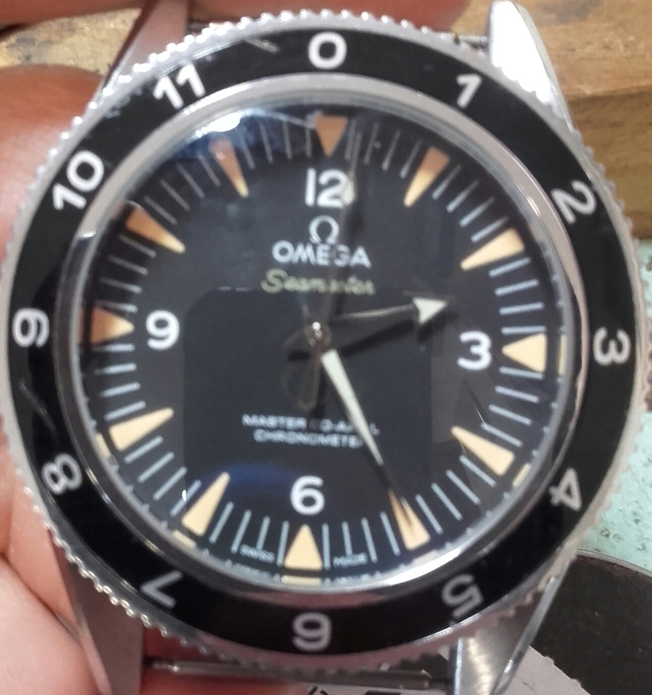

Defo a fake. NATO not an original and best clue was non hacking when setting the hands. Apart from that, from what he showed, it would be difficult to tell without having a closer look at the movement. Balance is a giveaway and as Archer has previously pointed out, no pivots to the jewels.

Had chance to see this yesterday si I took a photo....
