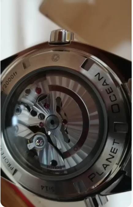

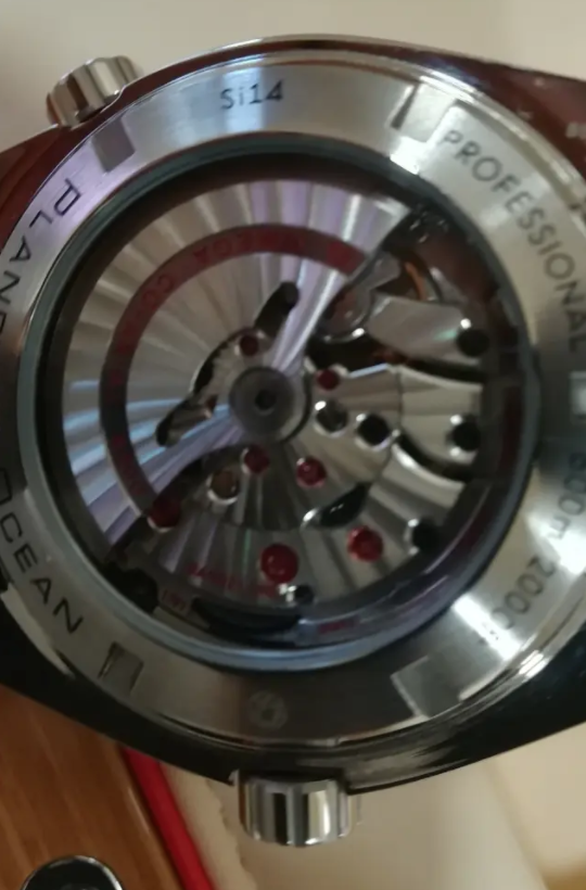

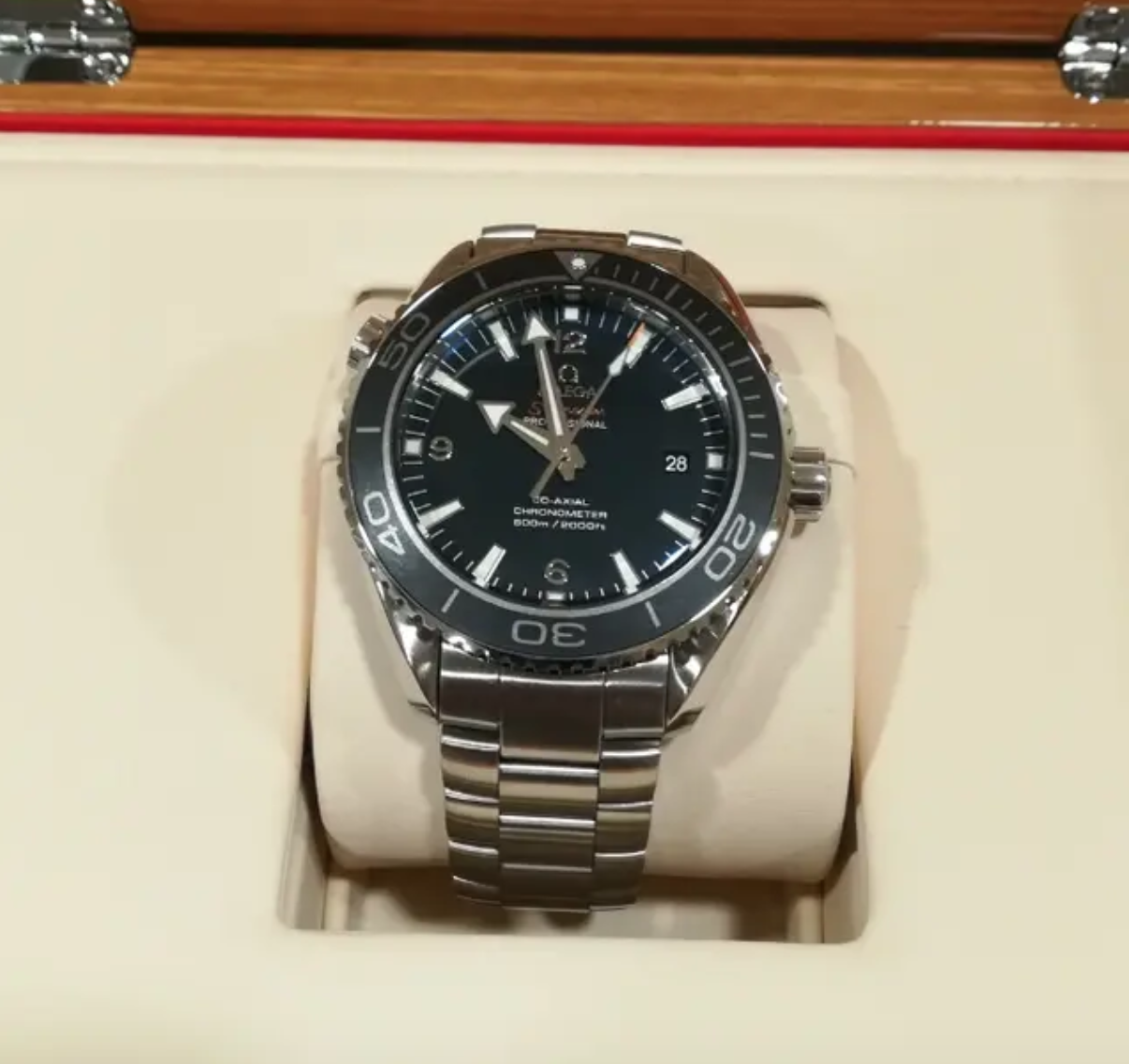

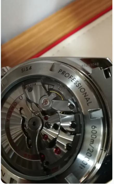

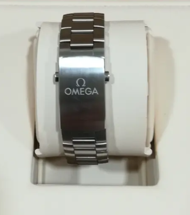

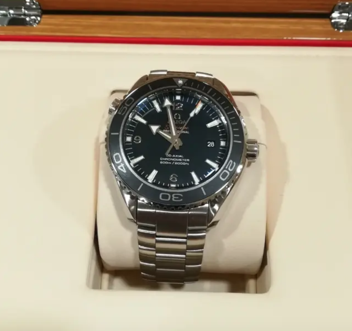

Great forum great advices, I'm new and about to buy my first Omega, a Planet Ocean ref 85243048.
I would really appreciate your help on this one to know if it's gen or not. (seems fake to me)
Here is the beast:
The shinning numbers on the dial and kinda weird 6, the "T-shaped" end link and the clock hands make me think it's fake.
Great week end to all of you,
Q.U.

Yikes! This is getting scary. I guess the old adage rings true "buy the seller".

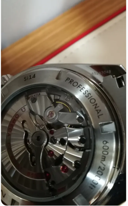

Hi I have planet ocean gmt and my serial is 85243048 my warranty card looks off
Serial number: 85243048
Article ref: 23110422106001
Oops! Did you mean Aqua Terra instead of Planet Ocean? If not, you may have a fake...

Short summary on how to spot a fake Seamaster 300 Master Co-Axial (did my homework):
- the crown on the fake is brushed and not polished as on the gen
- the metal between the case and the bezel is brushed on the fake and not polished as on the gen
- the serial number on the lug is upside down compared to the gen
- the serial number on the case appears not to be consecutively numbered (it's always the same number) - 88510199
- the serial number on the movement appears not to be consecutively numbered (it's always the same number) - 85243048
- serial number on case and movement don't mach (contrary to the gen obviously)
- the link next to the end link (on both sides) is engraved with the ref. number of the bracelet "STZ001145" (for the steel bracelet) on the gen, not so on the fake

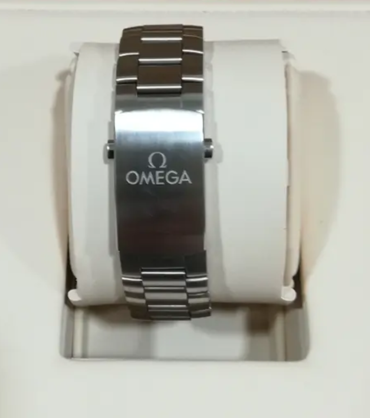

- there is no Omega engraving + again the ref. nr. of the bracelet engraved on the bottom side of the clasp-mechanism (where the little pin is) on the fake as contrary to the gen
- there is no "stainless steal" engraving on the 7 o'clock lug on the fake compared to the gen

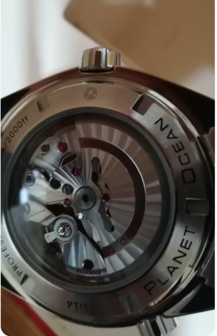

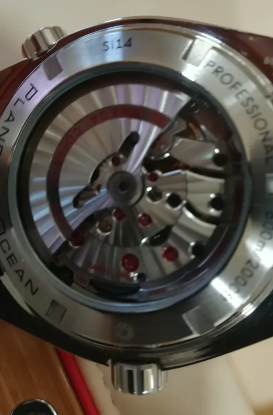

- the movement in the fake is a Myota 8215 which is supposed to look like a 8400 - but of course, it doesn't. The most noticeable differenc; the Myota has its balance wheel on the 7 to 8 o'clock position compared to the balance wheel on the 8400 which is on the 6 o'clock position. The balance wheel on the 8400 is black due to its use of silicon and not "gold" as on the Myota.
- the lume on the fake isn't correct - its all blue, including the bezel pearl. On the original the lume on the minute hand and on the pearl is greenish. (Some say that the fake-factories improved on that point, but I haven't seen a correct fake yet).
- on the fake, the inner metal ring (the ring between the bezel and the crystal) isn't flush with the bezel - it "pops out" a bit so that there is a "gap" between the ring and bezel.

As per above post - Omega has put 85243048 serial number on the Aqua Terra watch, not Seamaster PO GMT watch.
