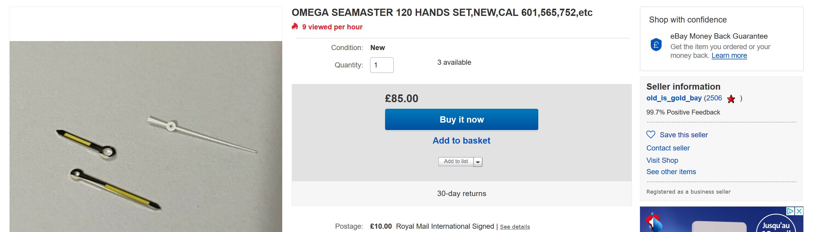

Fake parts from the same UK seller:
old is gold bay
m.zak zakariya
77 duncombe street
milton keynes
Buckinghamshire
MK2 2LX
United Kingdom
Fake hands from a "reputable" seller old_is_gold_bay (2506 iconRedStar_25x25.gif ) based in Milton Keynes, United Kingdom
https://www.ebay.co.uk/itm/OMEGA-SEAMASTER-120-HANDS-SET-NEW-CAL-601-565-752-etc/254567051818

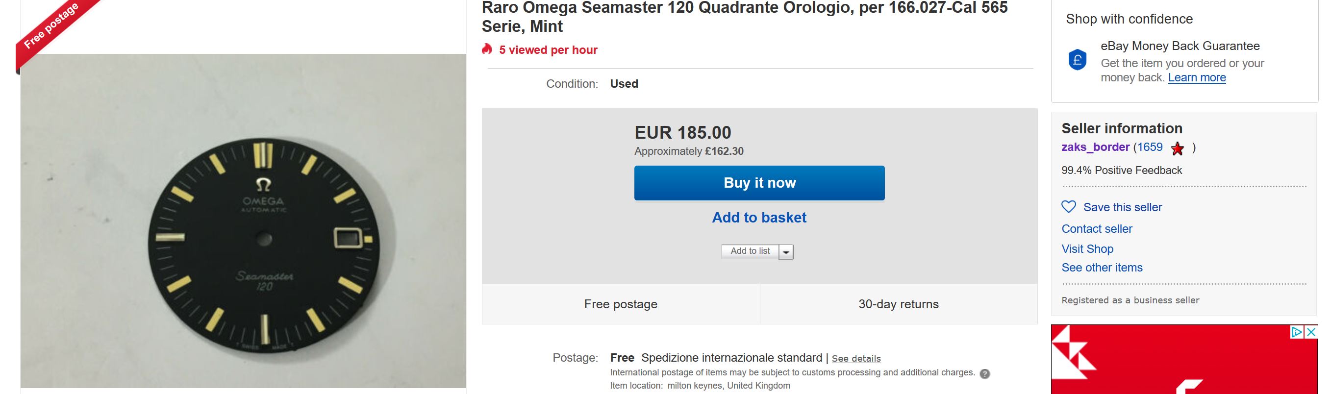

Fake dial from the same "reputable" seller zaks_border (1659 iconRedStar_25x25.gif ) based in Milton Keynes, United Kingdom
https://www.ebay.co.uk/itm/Raro-Ome...o-per-166-027-Cal-565-Serie-Mint/153895273613

Thank you for sharing! They also appeared on the Italian platform “subito” advertised as NOS with an asking price around 1000€ 🙁

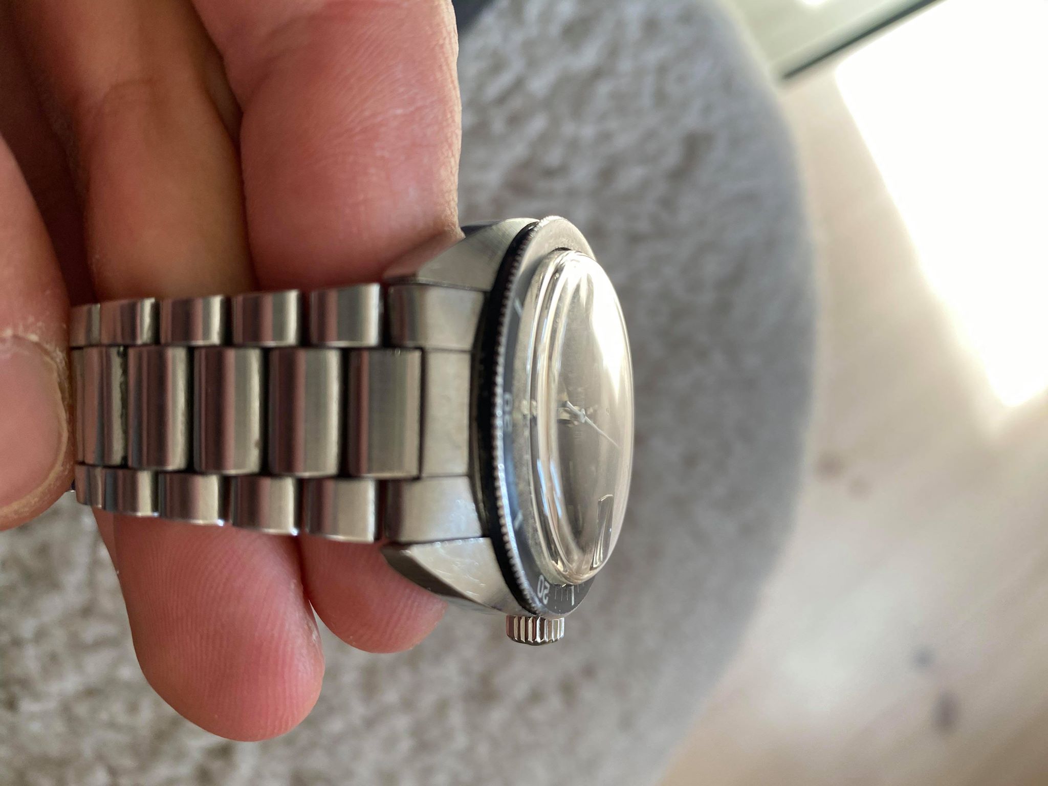

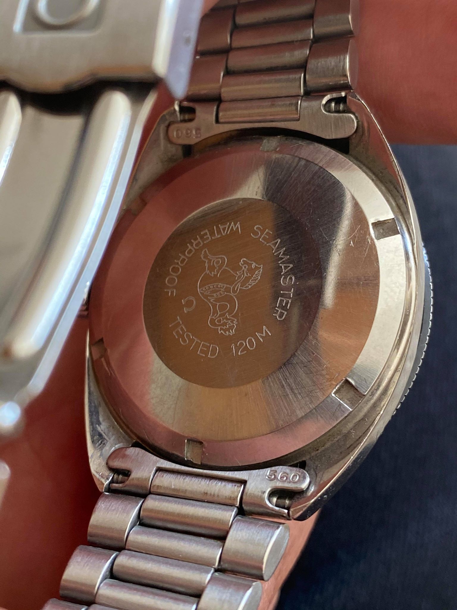

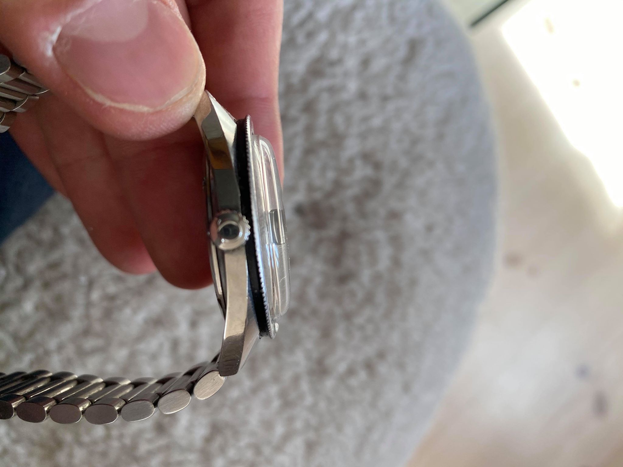

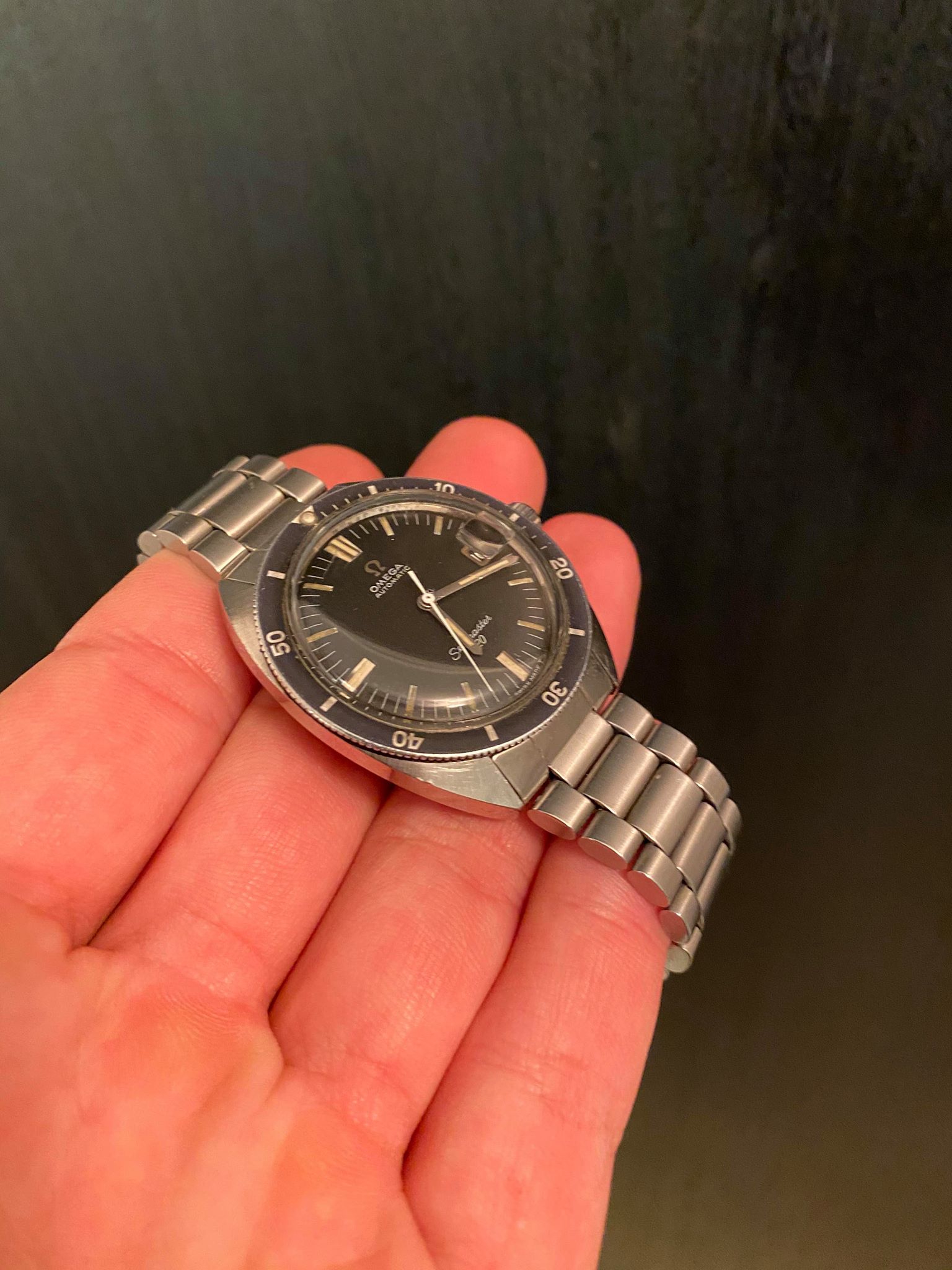

Hi all, completely new member here. First of all, a big thanks to everyone here. This forum is an unparalleled source of knowledge and enthusiasm. This and other Omega Seamaster 120 posts have helped me a lot! Thank you.
Now for the matter at hand. I have been searching for a proper Omega Seamaster 120 for some time now. I was recently offered one (ref 166.027) from a trusted seller, which has some obvious 'tells' qua this and other (very helpful) posts detailing the pitfalls regarding this particular vintage model. Despite this, the seller insists on its authenticity. Since it is a trusted one, I wanted to double check my initial thoughts here. There are also some new facets that I have never seen before, which might be interesting for some of you. Unfortunately, I don't yet have a photo of the movement.
Now, first of all, there are:
1) Backside: Ω-sign in wrong place, pointed A's, different text (120M instead of 120 and 'tested', which I haven't seen before), lacking engraved circle.
2) Date-magnifier. I am told by the seller, this is authentic and original, though I haven't seen it anywhere else. This makes me curious. Do you know, whether this is a known feature? The glass has an omega-sign on the backside .
3) Notch at 3 and 9 look somewhat off.
4) The hands seem new. Unsure about bezel.
5) To me, the dial seems alright.
In addition, I have a general question about the Omega Seamaster 120's date function. I see models with both white and black date backgrounds, but I have been unable to figure out whether both are genuine and what references come with one or the other.
Your thoughts on this are much appreciated.

Dial, hand and bezel ok
Glas with magnifier ok
Polished case
Service caseback
Later 1125/560 bracelet
Not a bad one
