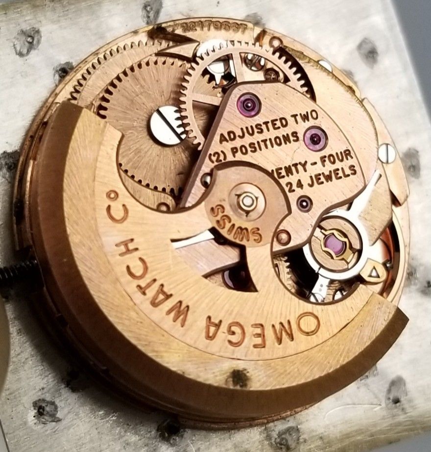

I'm not sure if there is a thread for this as I couldn't find it (but there should be) where pros like you can help us pick a vintage without getting ripped off.

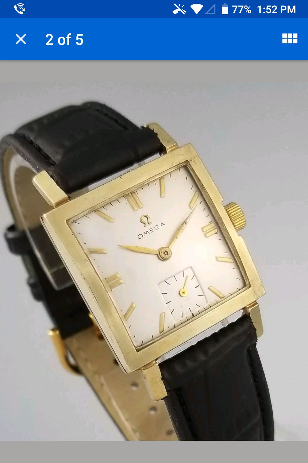

Here's one I found:
Fake or real?
13,479
31,764

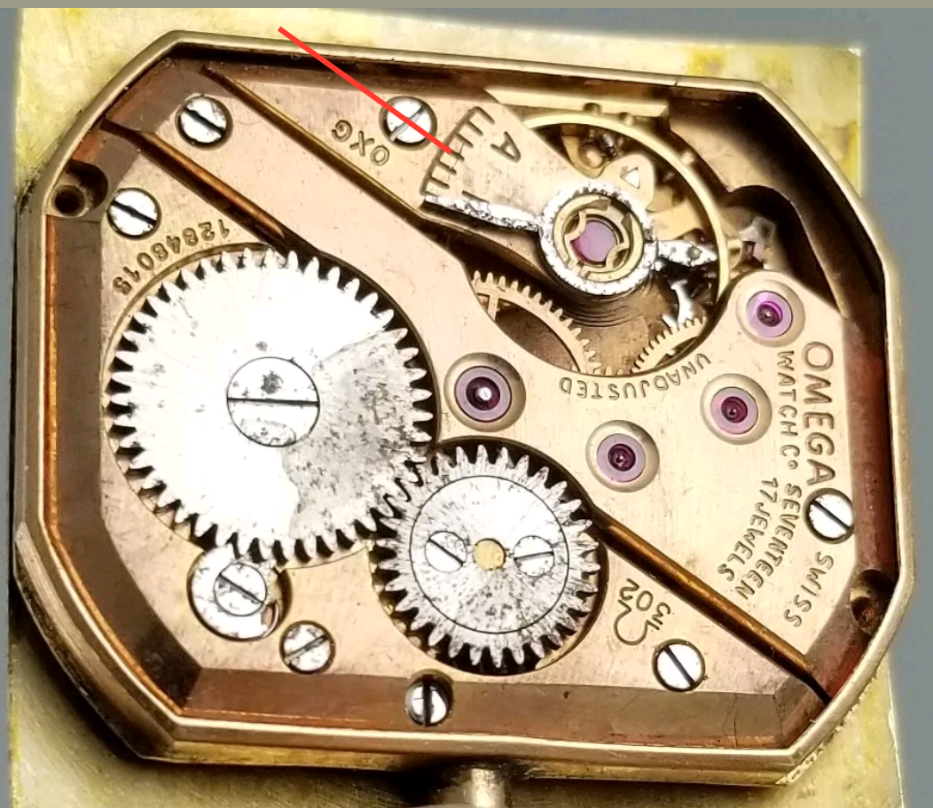

Genuine but the dial has been refinished killing the value and the movement is badly in need of a service.
This would be one to avoid regardless of price.
675
6,798
Thanks x350! How can you tell about the movement?

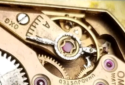

Those stains in the silver colored wheels don’t look good...😉
8,711
14,616
Does it look clean to you?
23,760
52,783
And the regulator has been adjusted to an extreme position.
Thanks! Doing a lot of reading and trying to learn more. Tips like this help me watch out for it more. Also going through the fake thread to to learn a lot. Good stuff
Is that the dial on the the first picture? Upper left dial of that picture?
13,479
31,764
Should be where the red line is.
This thing:
8,711
14,616
lol, there's always one in every forum ^
Yes, one who asks the obvious question.

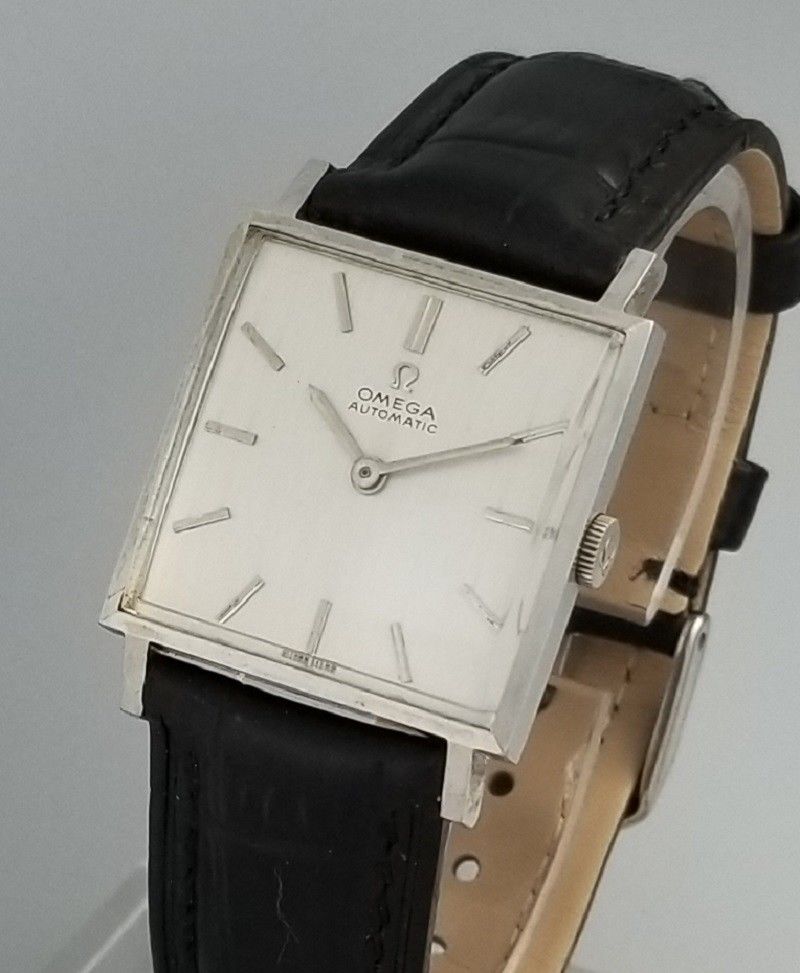

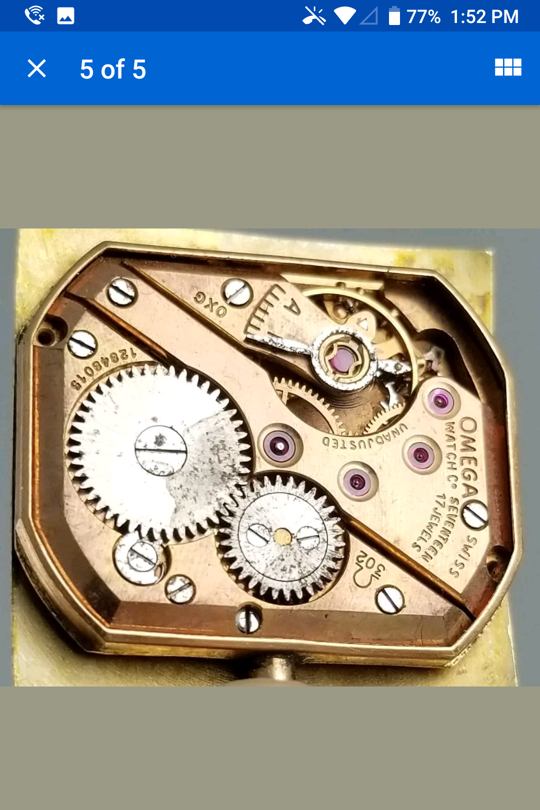

Too bad. I liked that one. Alternatively there's this one, but not sure it's worth the $400
13,479
31,764
Refinished dial too. More concerning is the second hand pinion is missing or broken, this caliber should have a second hand.
Good catch. And how can you tell the dial was refinished?
