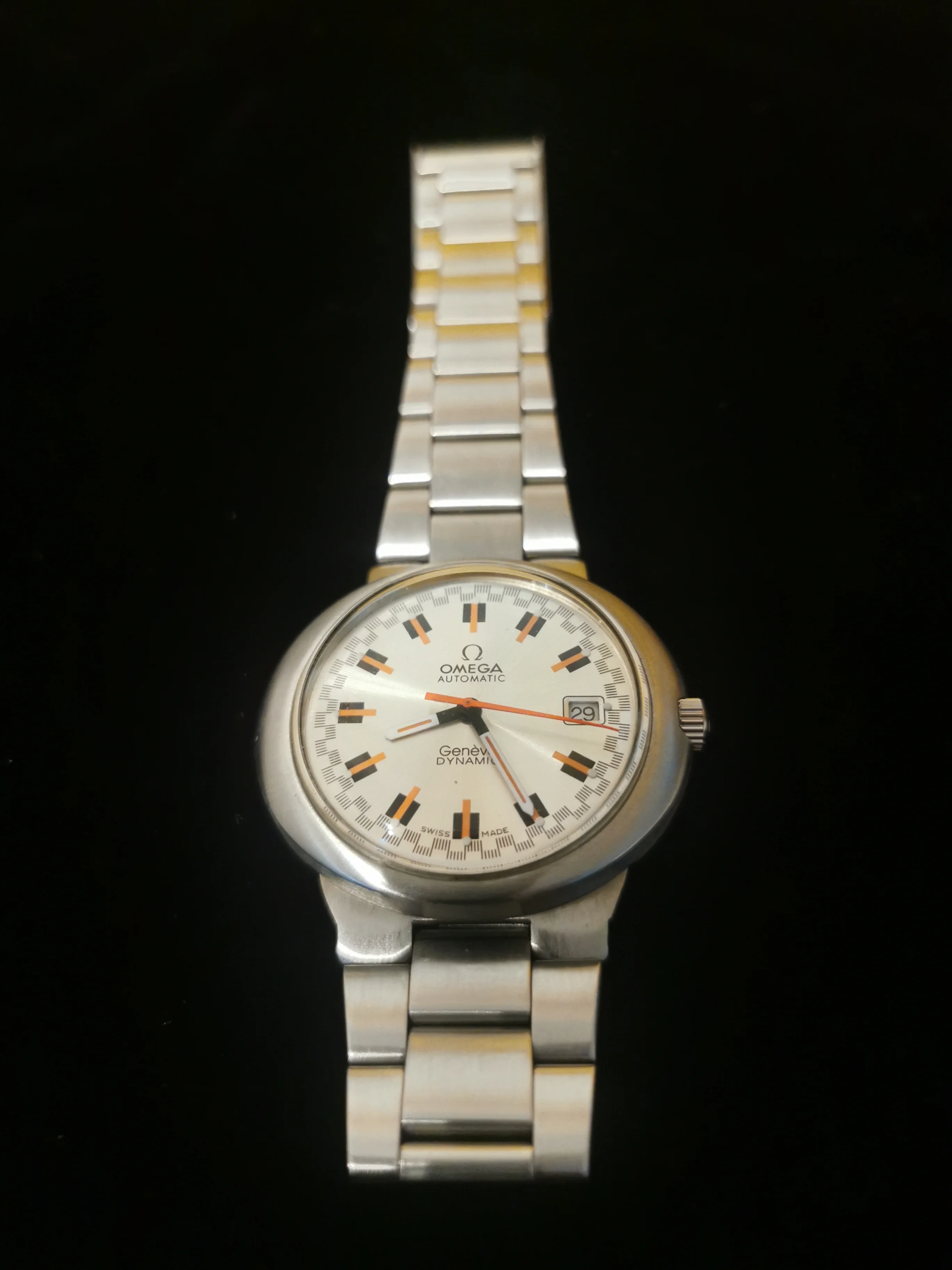

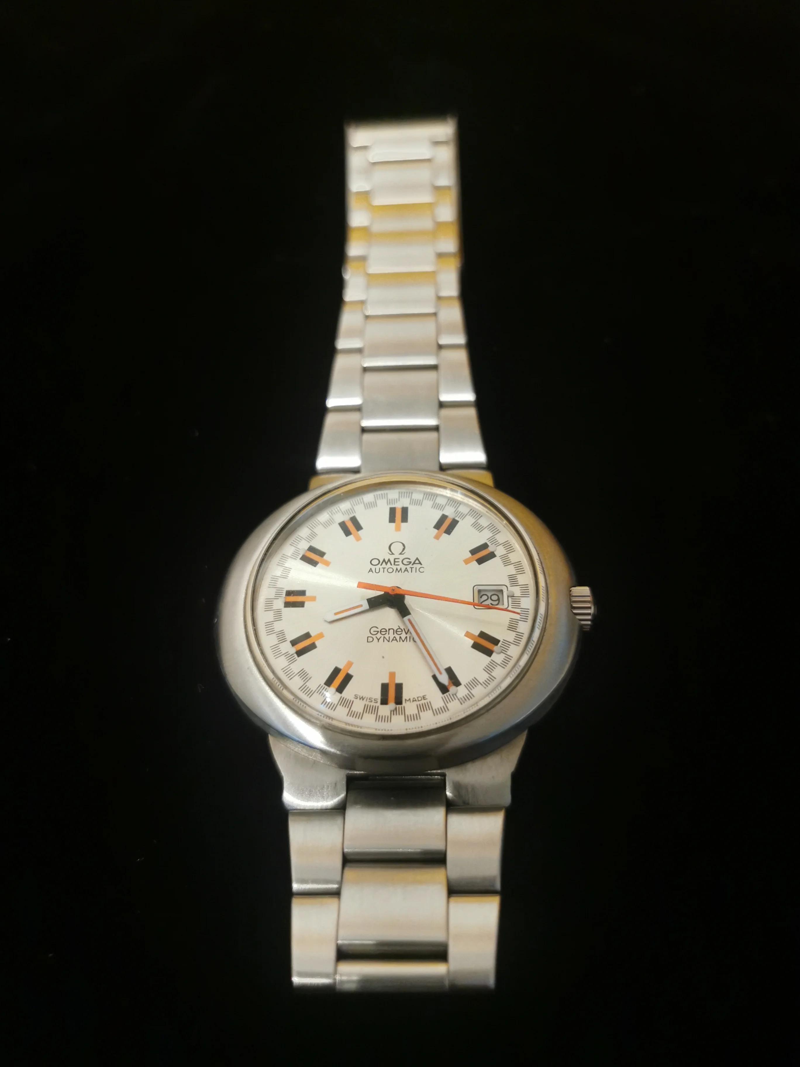

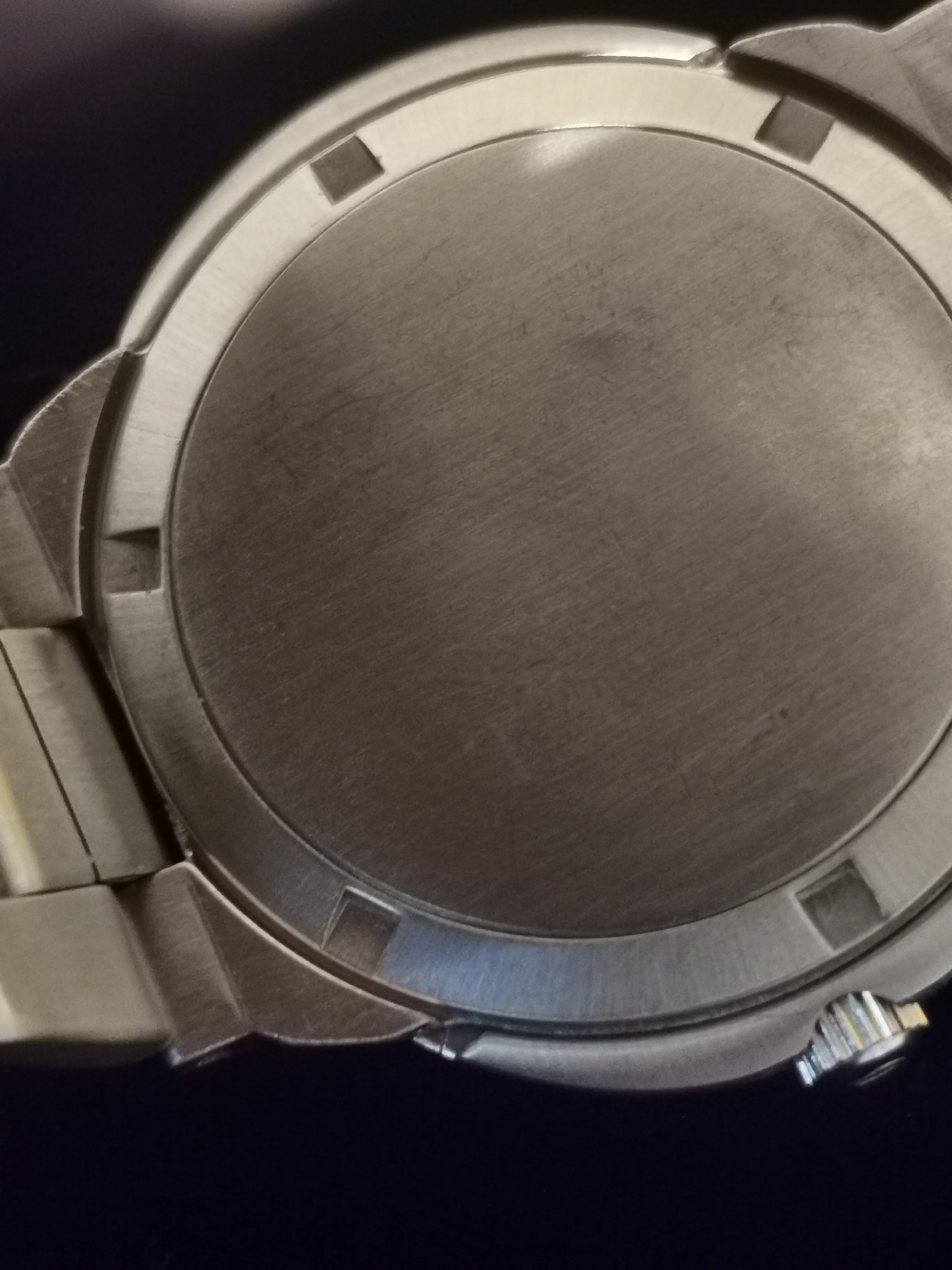

Hi picked this up in a lot , looks too clean to be original, but just want to be sure it's a fake .
Thanks
6,904
10,769
I'd say a real Dynamic
35,776
40,053
Under a grand, not a rare or hugely sought after piece but a good daily wear piece to enjoy
18,851
39,205
I'd say that too.
any idea what they go fo
Depends on what continent you're on.
Google Omega Geneve Dynamic to see what's being asked and what's being realised.
6
I'd say that too.
Thanks
10,824
16,844
Note this seems to the less desirable second generation Dynamic from the early 70s found with the 1481, 1012 and 1022 movements and slightly more rounded case.
6

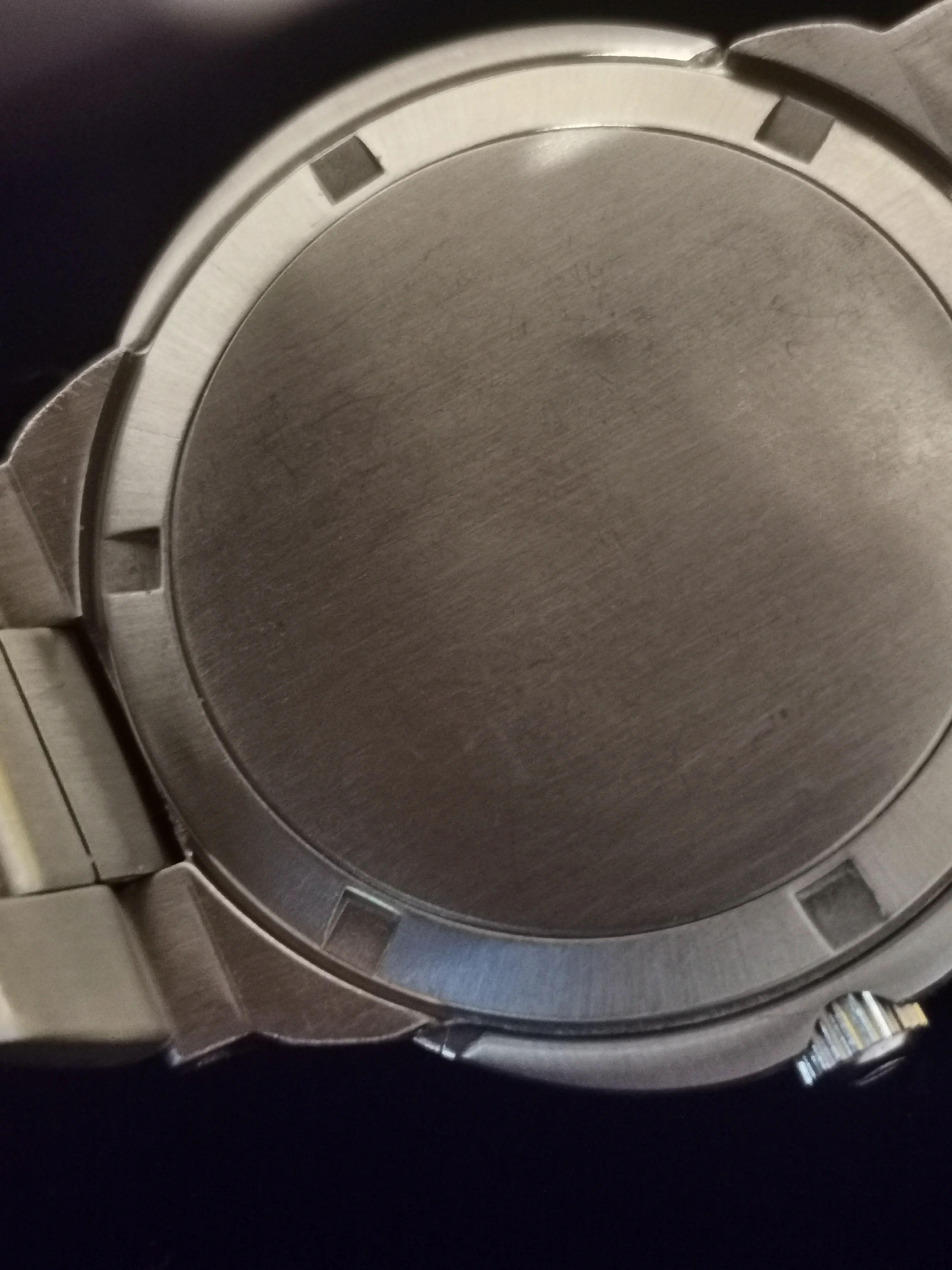

Thanks , to check I'd need to take it to a shop and have the crystal removed ? Or does thaback open?
10,824
16,844
These are front loaders and a pain to open. I think they use a special tool or compressed air to pop the crystal. Not DIY!
18,851
39,205
It's a Unishell case, so it would need a competent watchmaker with the right tools (not a crystal claw) to open the case.
It does not have a caseback you can open.
210
185

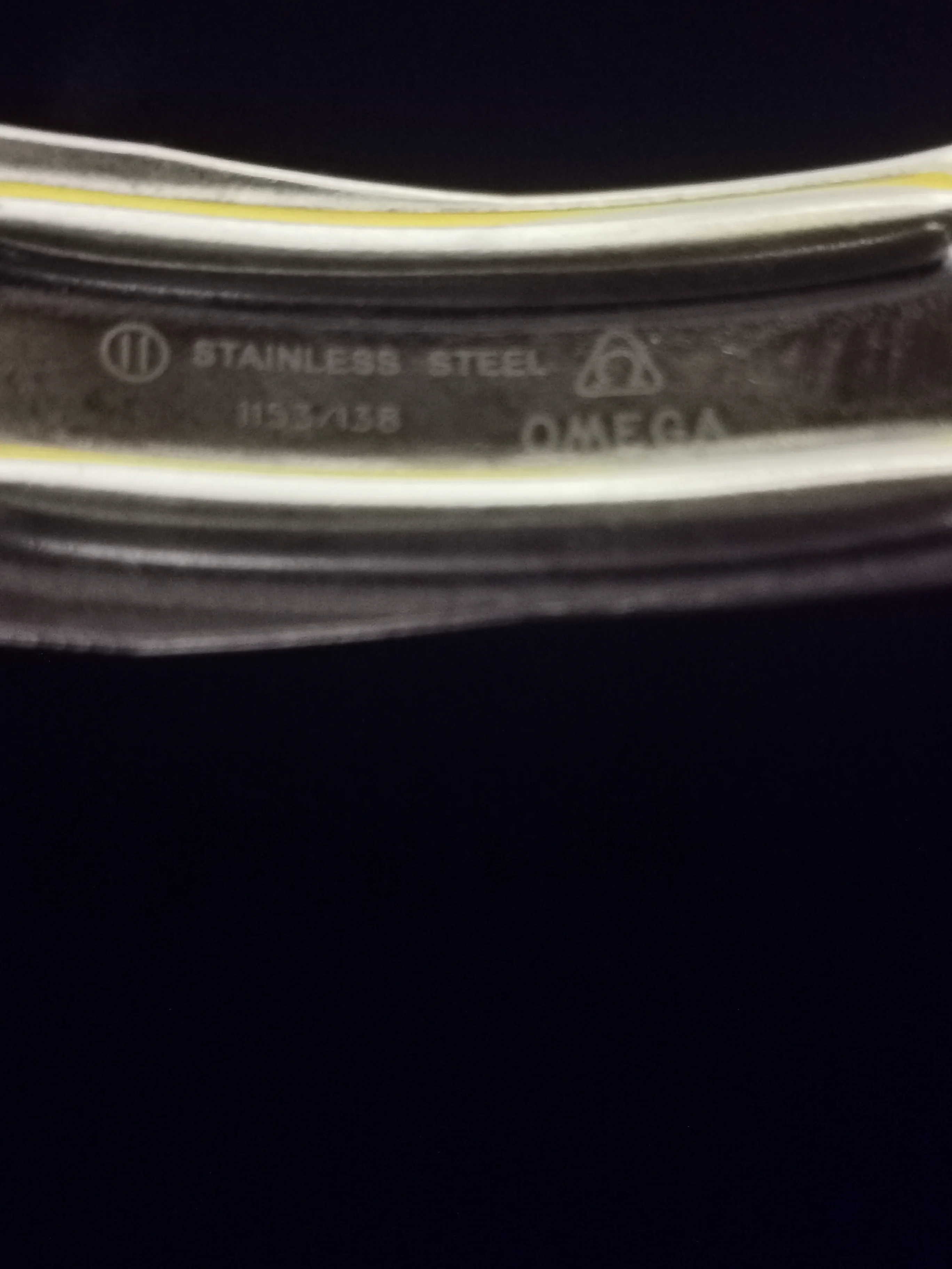

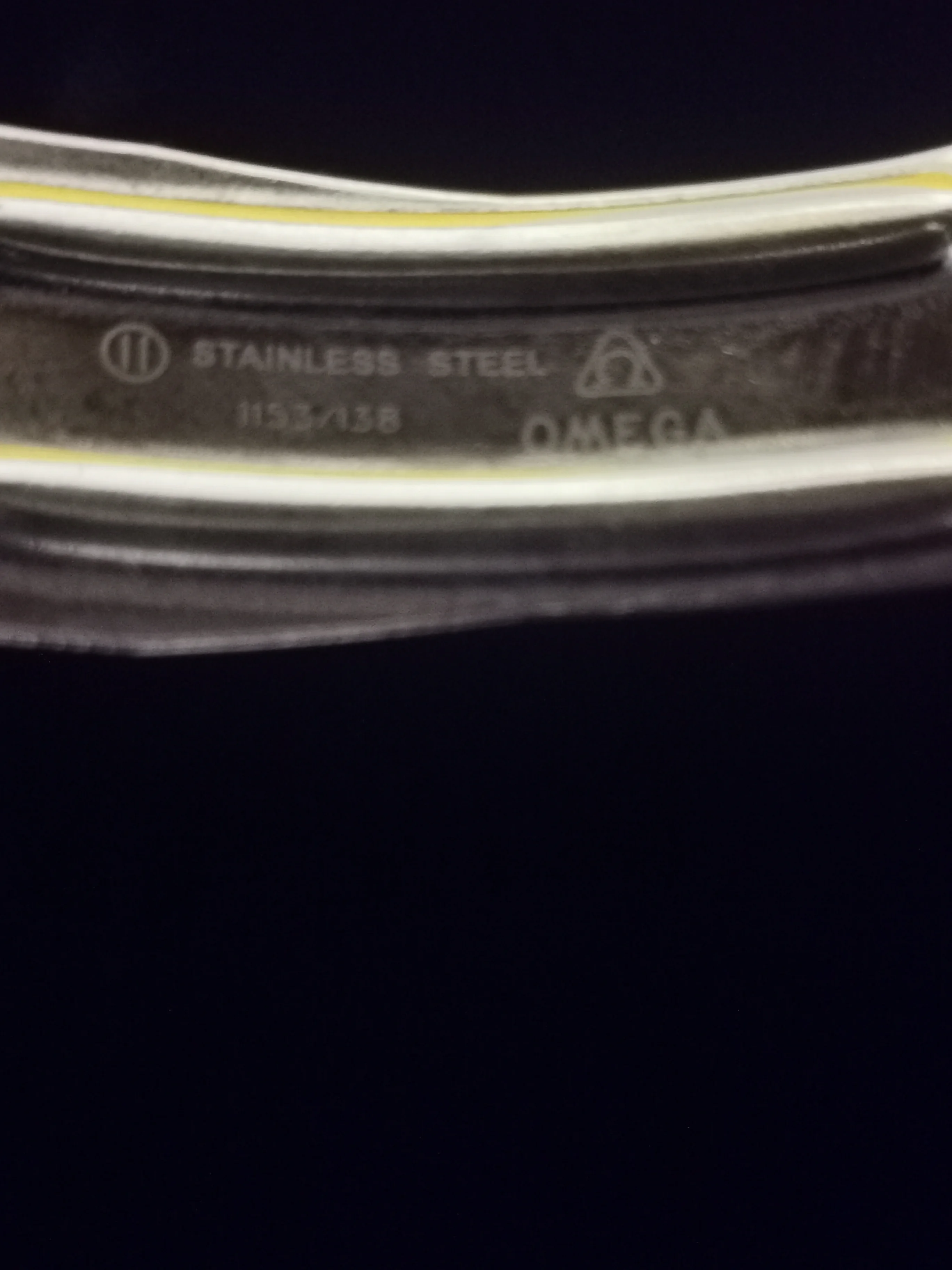

Hi, No markings at all on the outside of the case back.
That'll be because it's worn off, or has been refinished.
All Dynamics of this era have the words "Waterproof" and "Tool 107" (gents) or "Tool 102" (ladies) on the rear of the case.

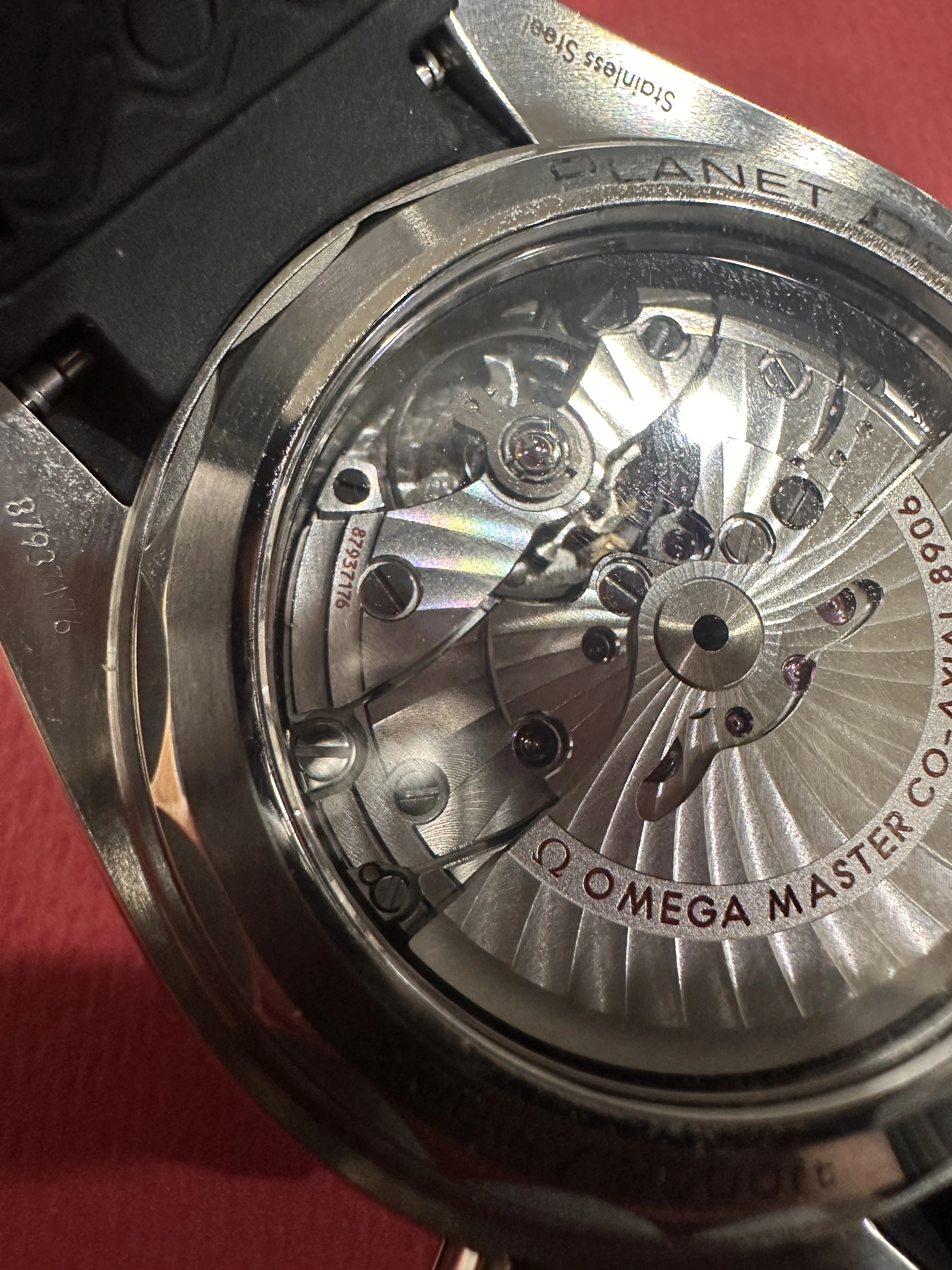

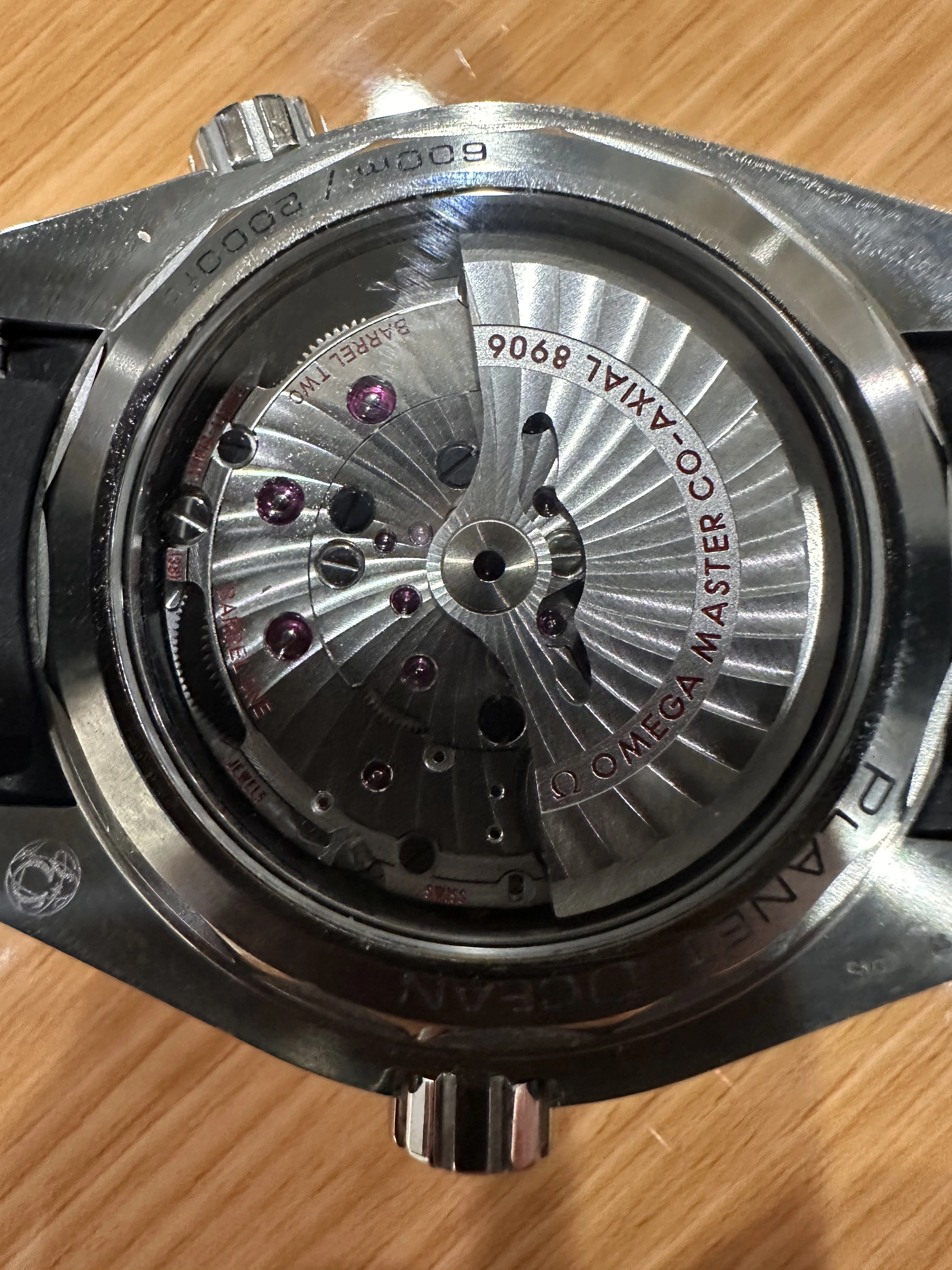

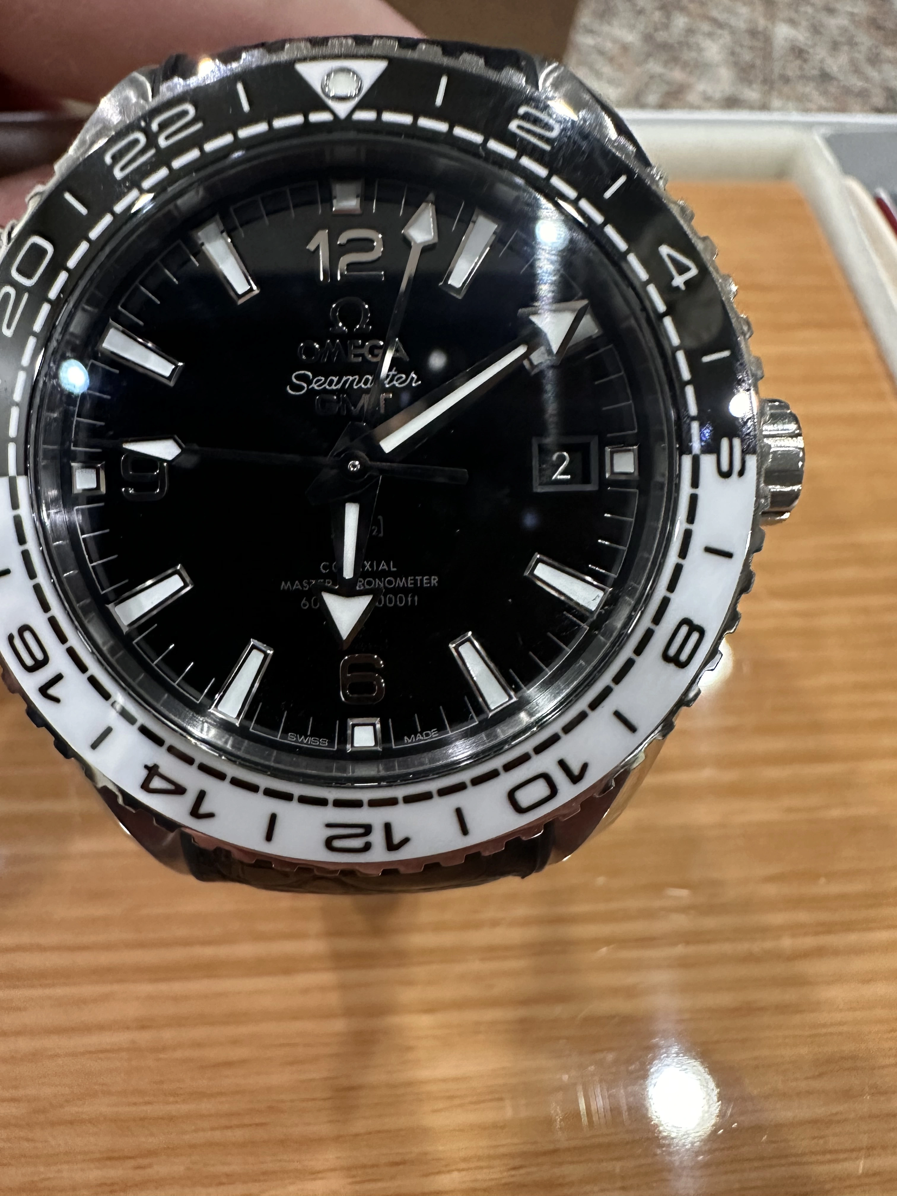

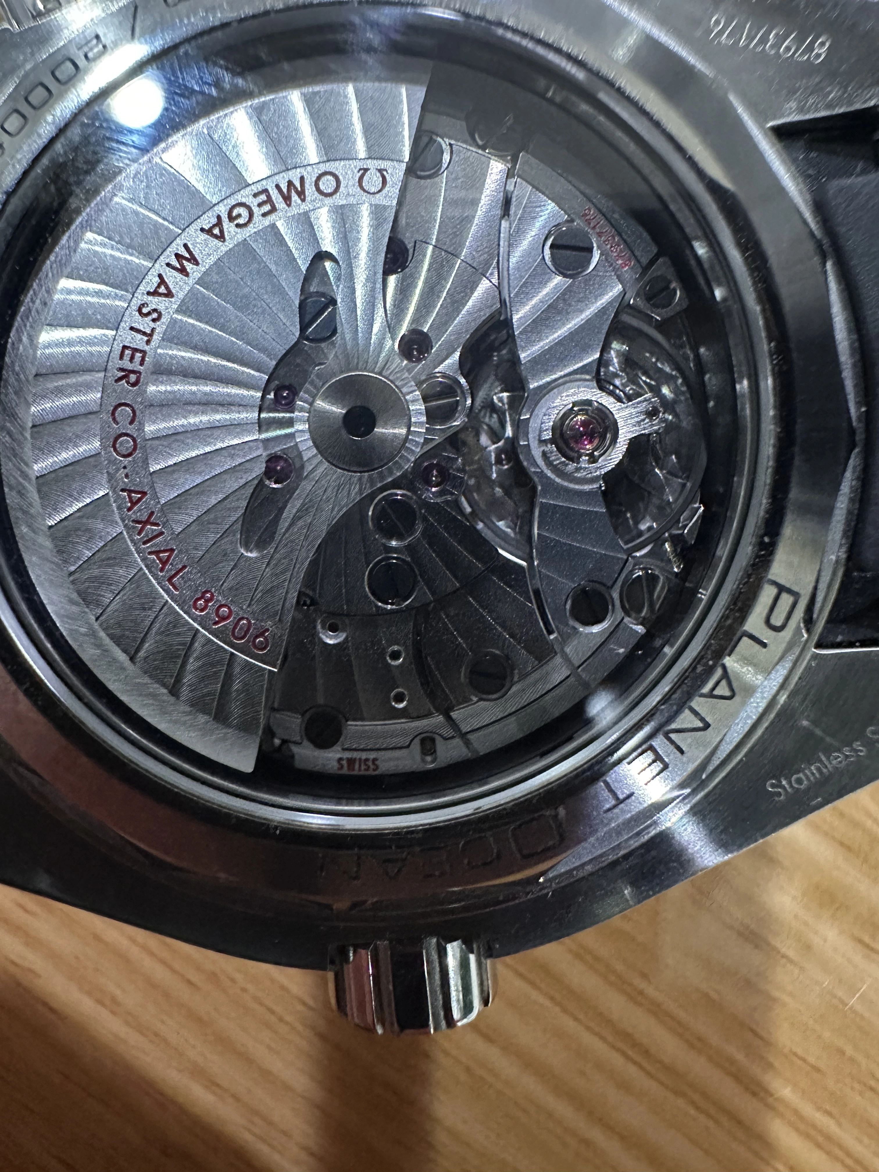

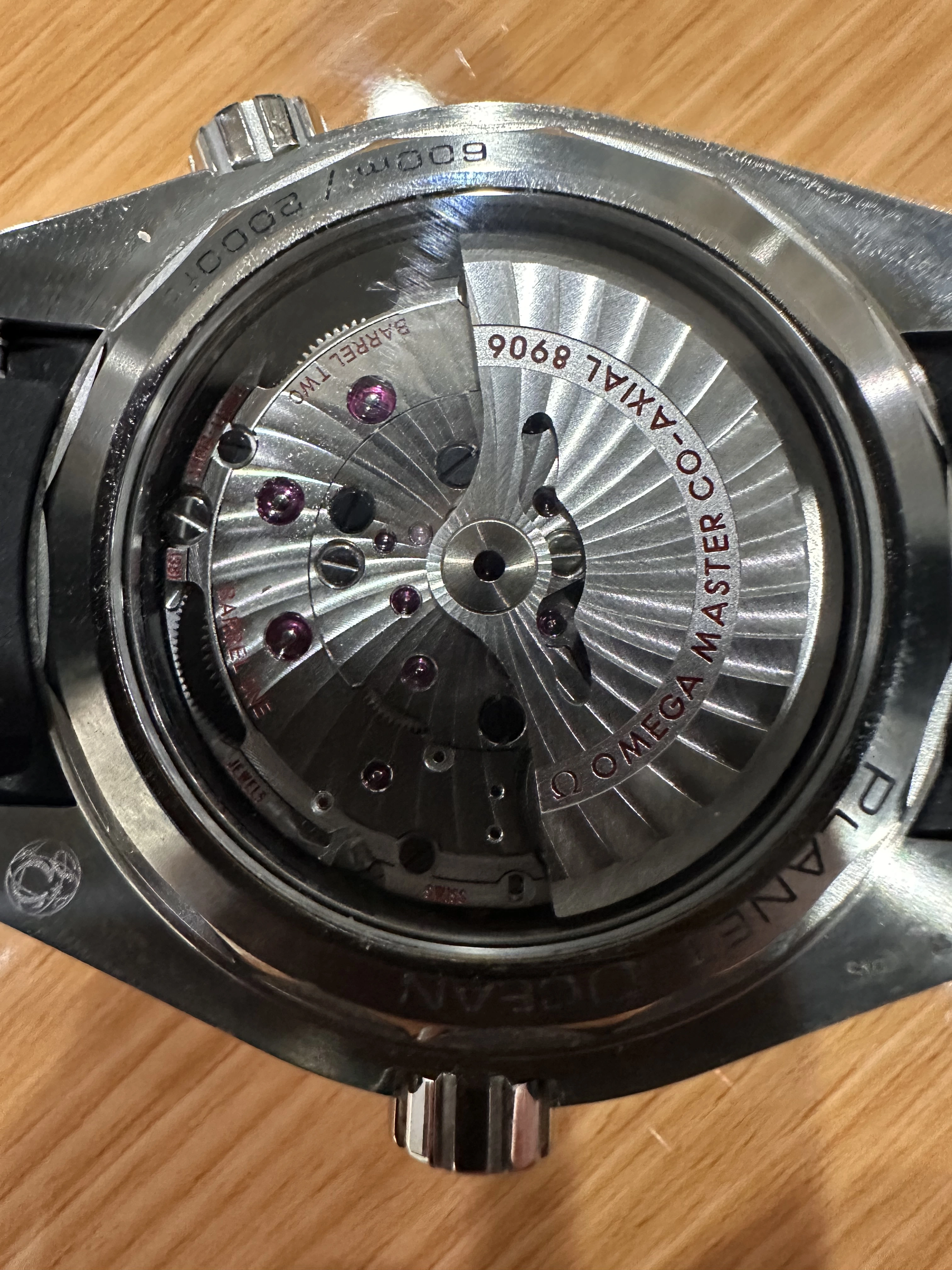

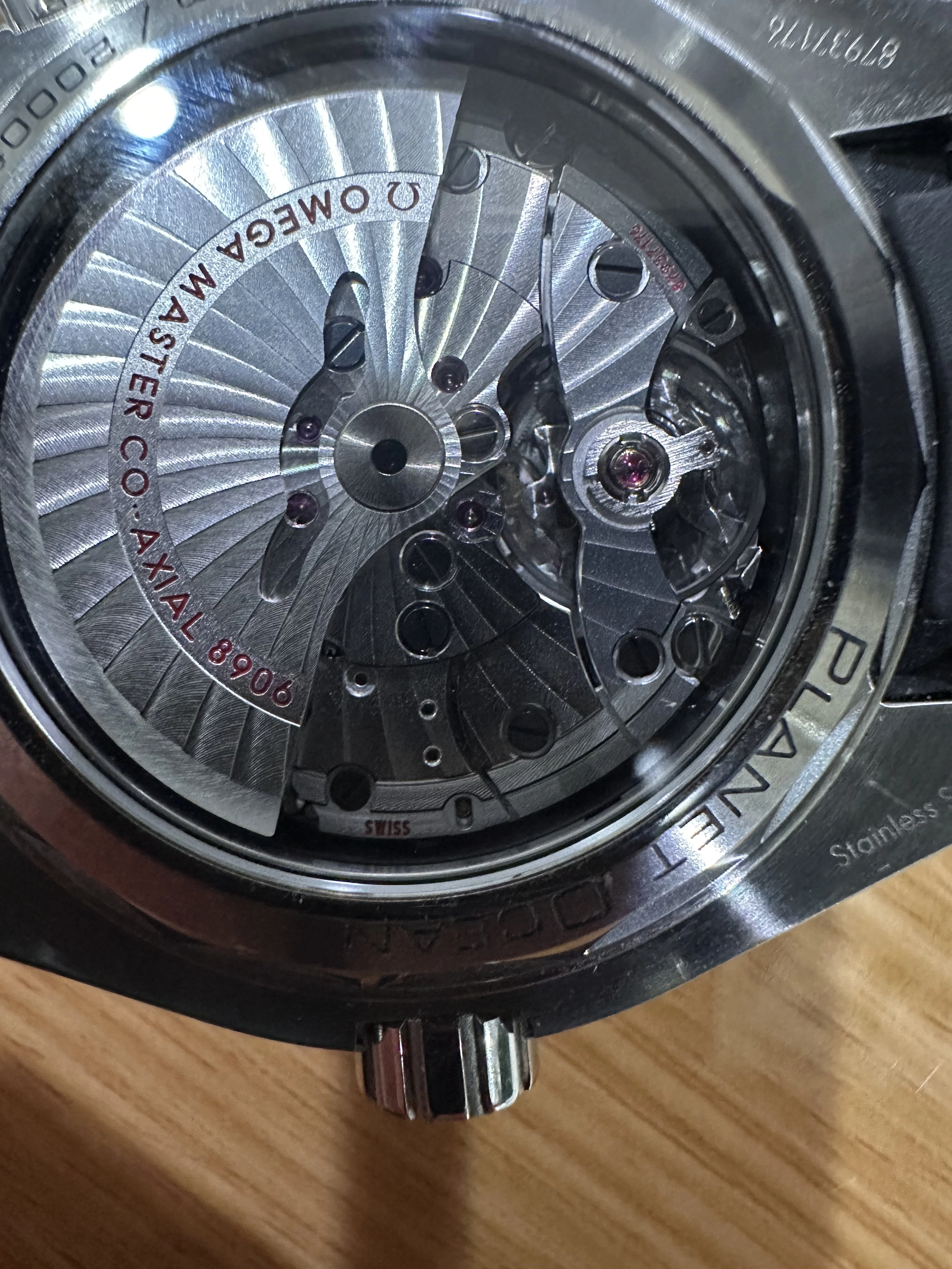

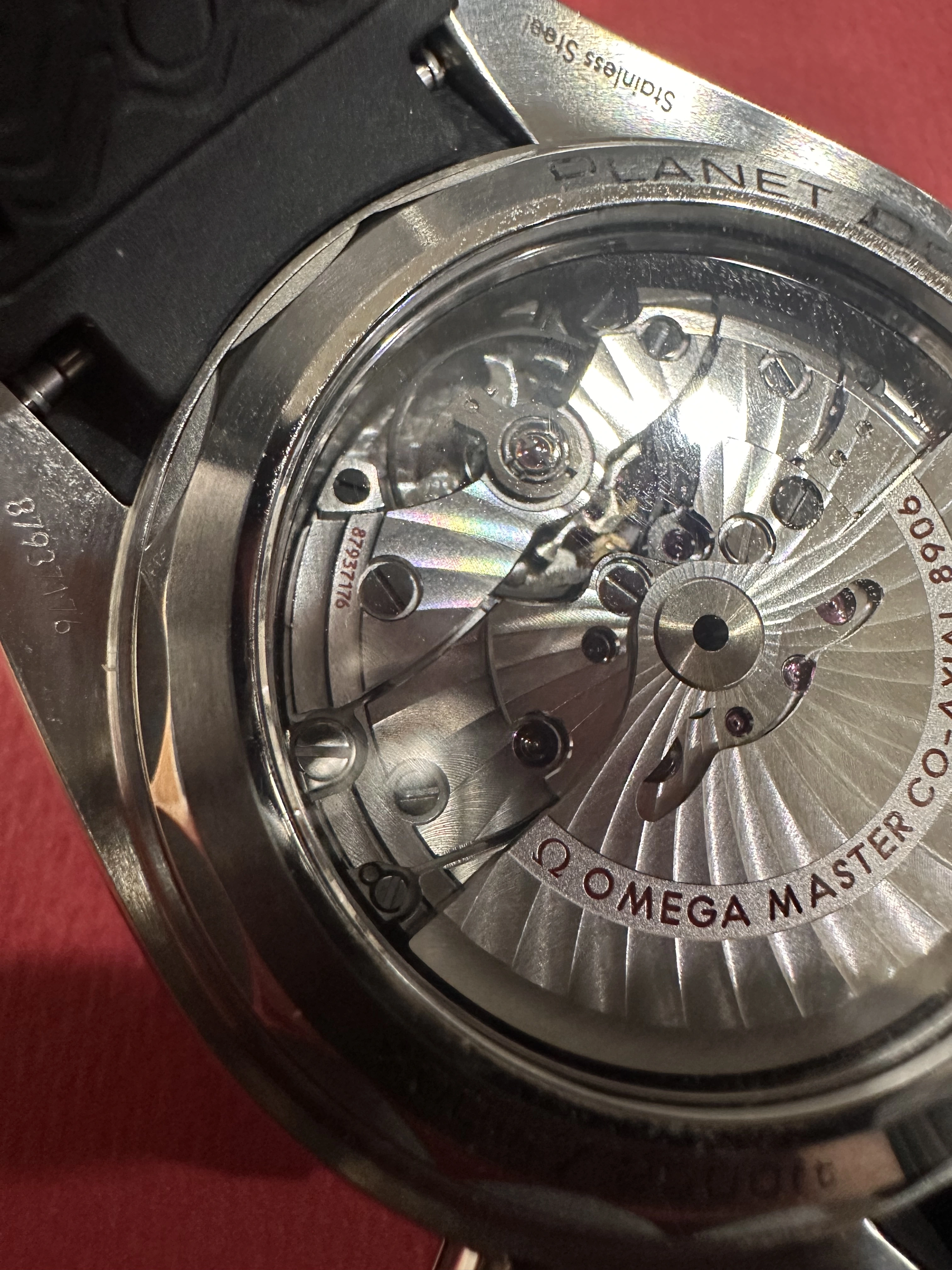

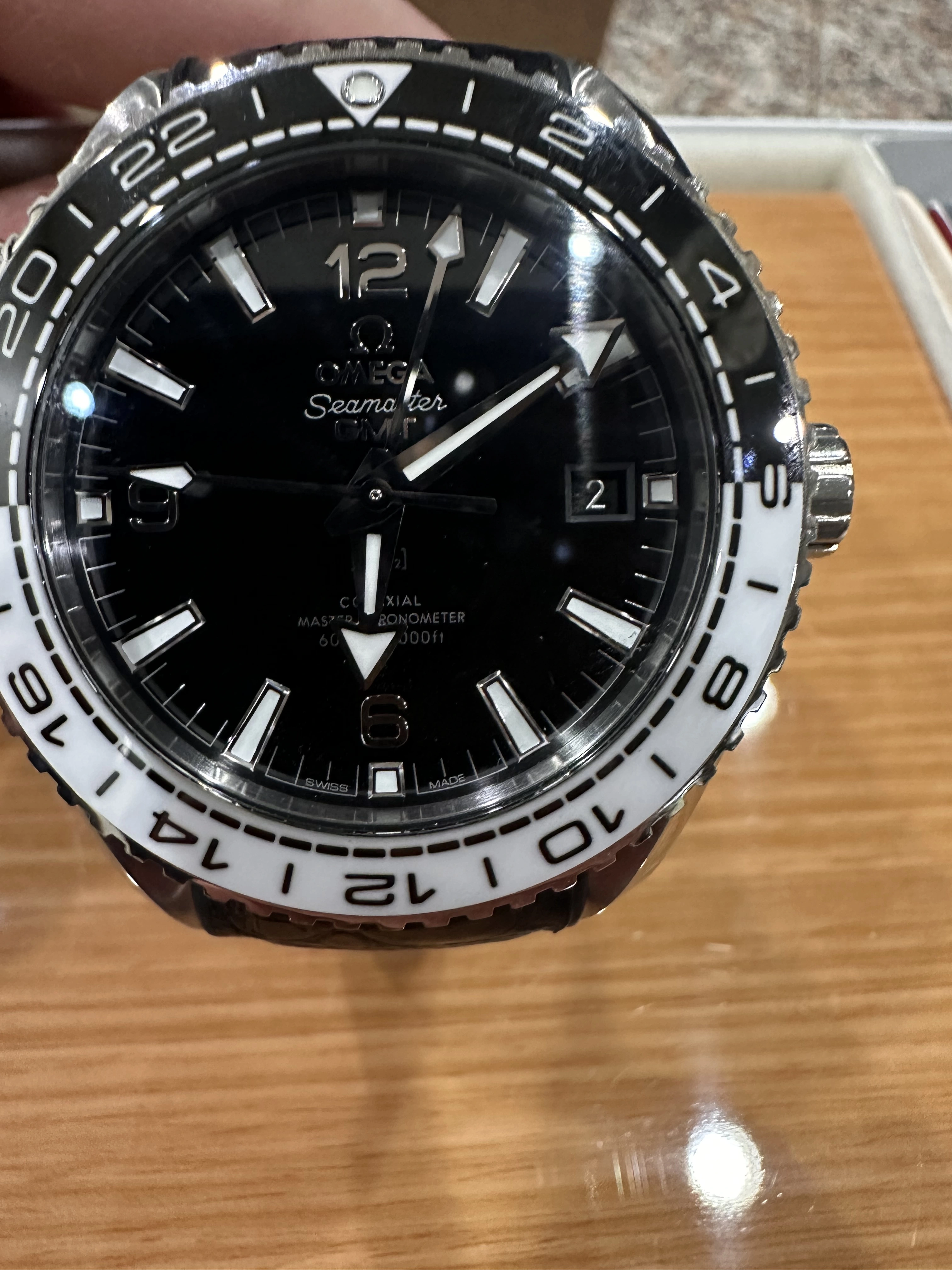

Just picked this up today. Everything look legit to me. All the numbers match on the cards also. Can anyone confirm.
2,684
2,873
That is very much not a real Omega Dynamic.
13
12
Oh dang I’m sorry I posted this in the wrong place. I’m still new in this forum trying to figure it all out.
