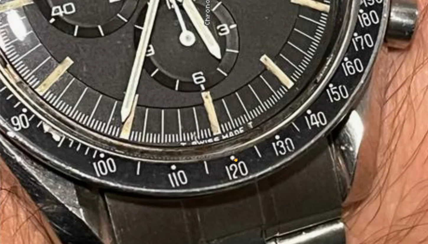

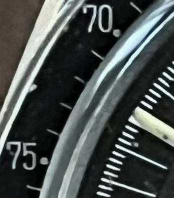

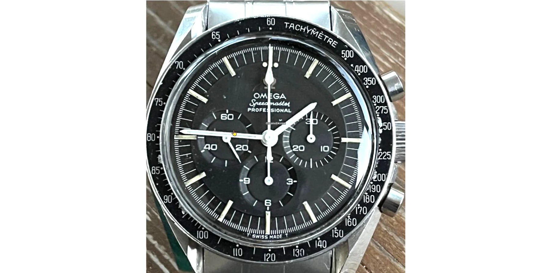

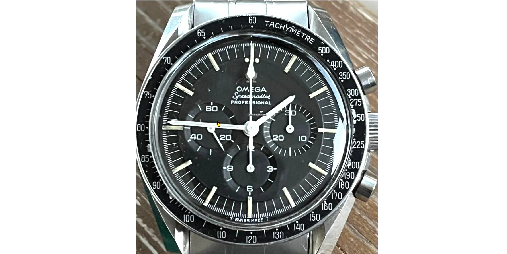

I am looking at this CB case on C24 , and i am sure some of you are too, and the bezel has question marks i think. I am not seeing any serif on the 7 and 1`s. The font is thin and looks fine so maybe i am wrong ?
And it has service hands but otherwise a good looking watch i think.

The serifs are there Ron!
And nice CB facets and the correct pushers!
But the rest....meeeh....

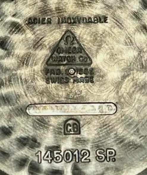

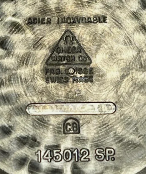

Lume looks weird and prob a relume, servicecrown, and the inside of the caseback - Hmmmmm!!
And the case has seen some polishing, even though describes as not polished.
No good vibes on this one (for me)!

Thanks Hans, the 5 have serifs indeed, but i am still not seeing it on the 1`s and the 130 is not convincing for me either. Probably looks more clear in real life.
The caseback is strange with the 105.012 removed ( by looks i think Omega ) in favor of a 145.012. price was to high for me anyway but always nice that you and others are willing to discuss these watches. 👍
