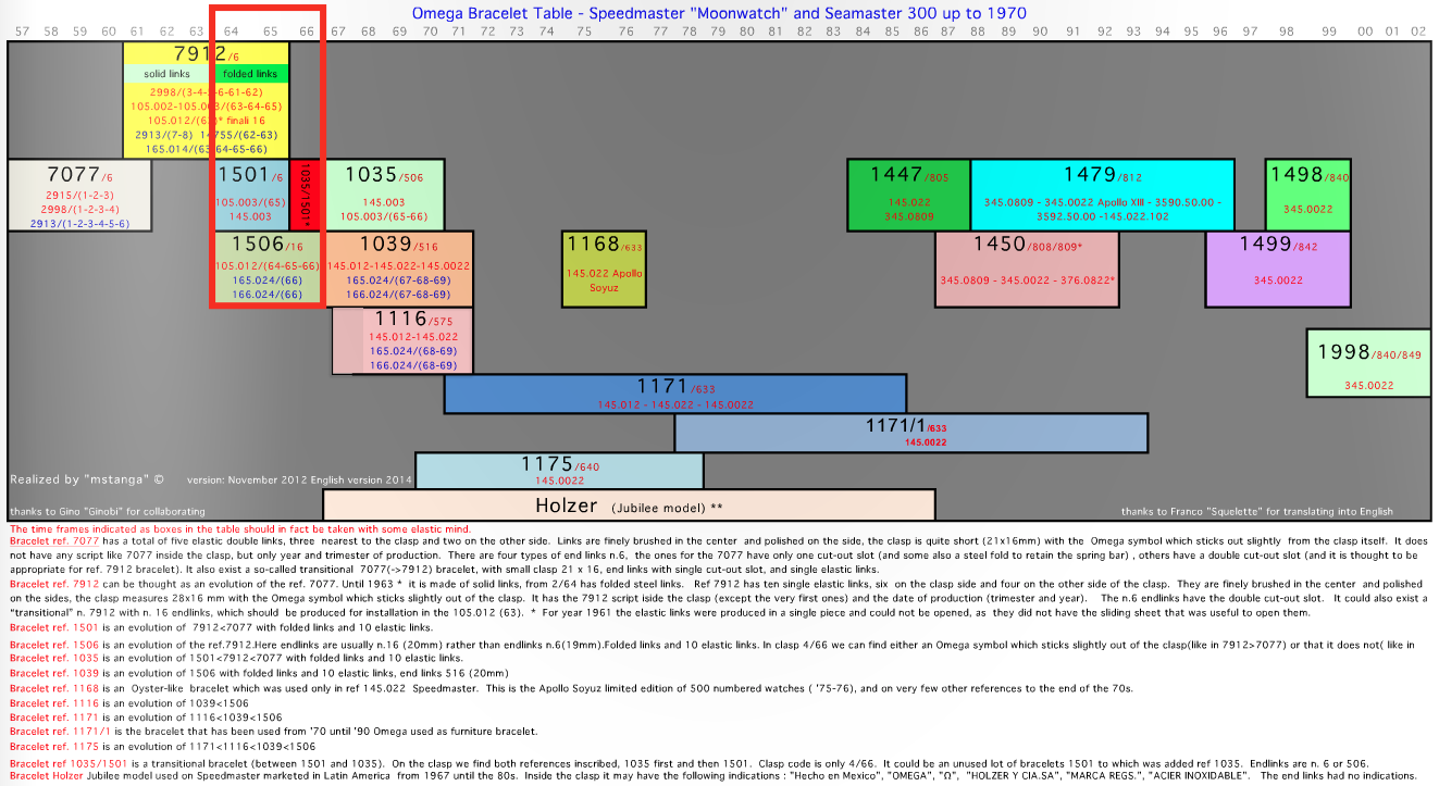

what omega bracelet match a 105.012-66 from march 1967

I am looking for an Omega bracelet that pair with 105.012-66 from march 1967. Is the 1039 1/67?

WOW... i'm beginning in these Omega Universe... I wasn't able to find the 105.012 on the chart 😕, but will keep looking for...😉👍

1039 w/ 516 endlinks would be appropriate.
@Dan S why not a 1035? I’m not saying you are wrong I’m just curious.
IIRC, I think the 1035 is more typically used with 19mm end-links.

for cb66 - 1506 +16 pair period correct which i have but rarely available as a pair.😉

1039/516 is the only correct bracelet for the 105.012 reference I believe

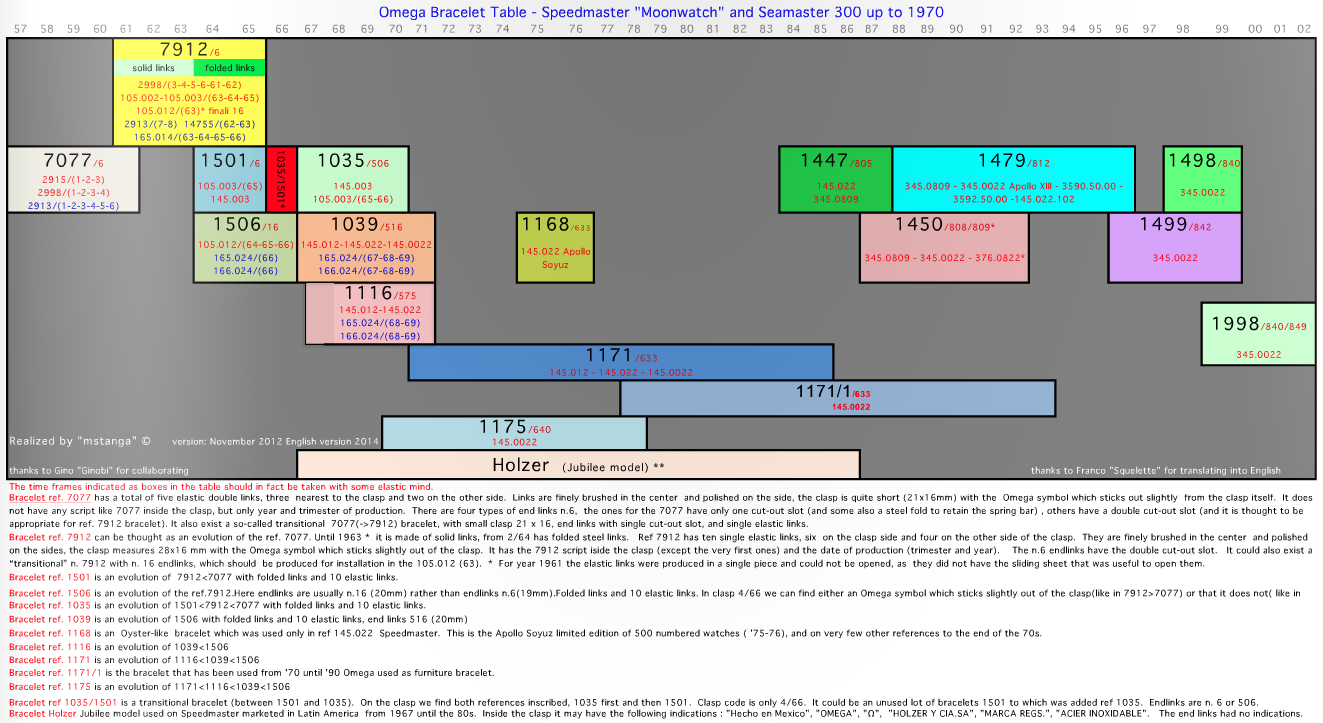

this chart is therefore patently misleading and wrong if 1039/516 is the only correct bracelet for reference 105.012.

MWO says 1039 & 1506 & maybe 1116.
For march 67, quite early for a -66, could match with 1506 and 1039 only IMHO.

Agree. 1506/16 or maybe 1039/516.

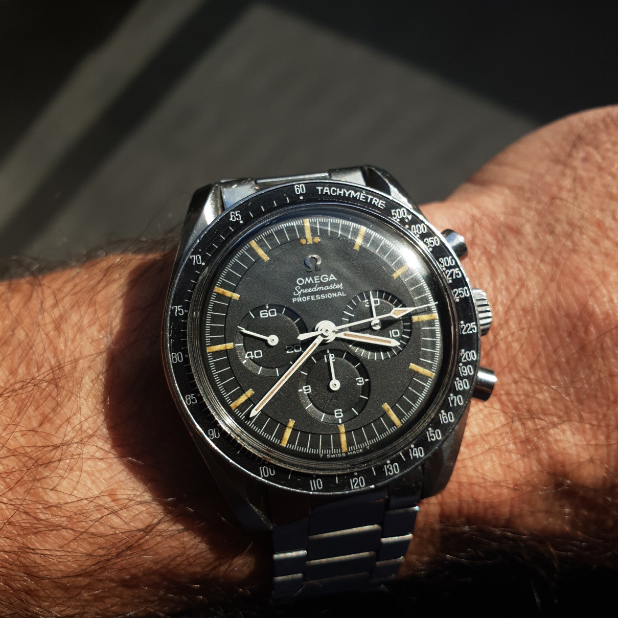

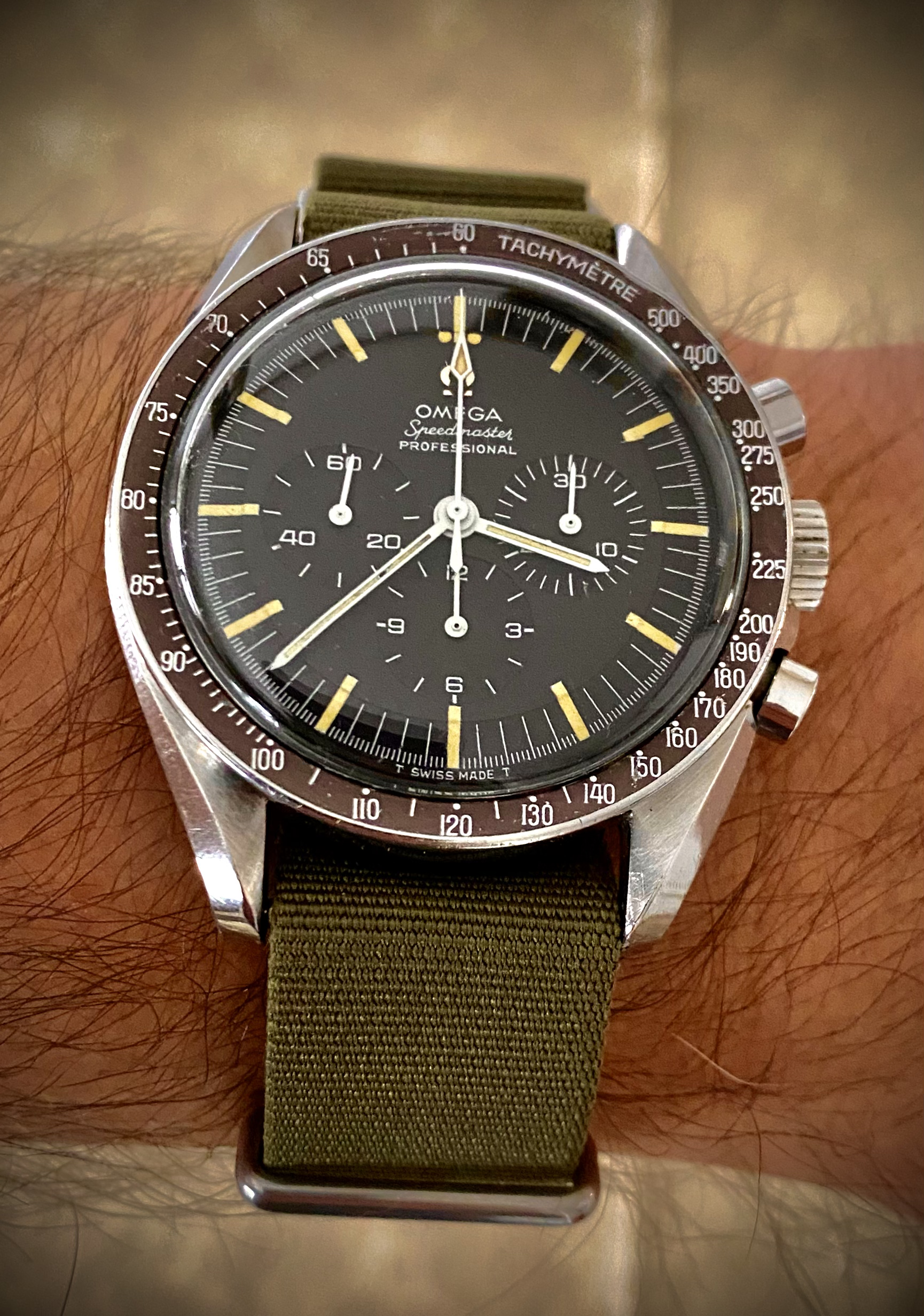

Now we all expect a picture of your wrist...😁
6
8
sure!!! still looking for the right bracelet 😎. It is a 105.012-66 with tropical bezel, unpolished, from the firs owner.👍
