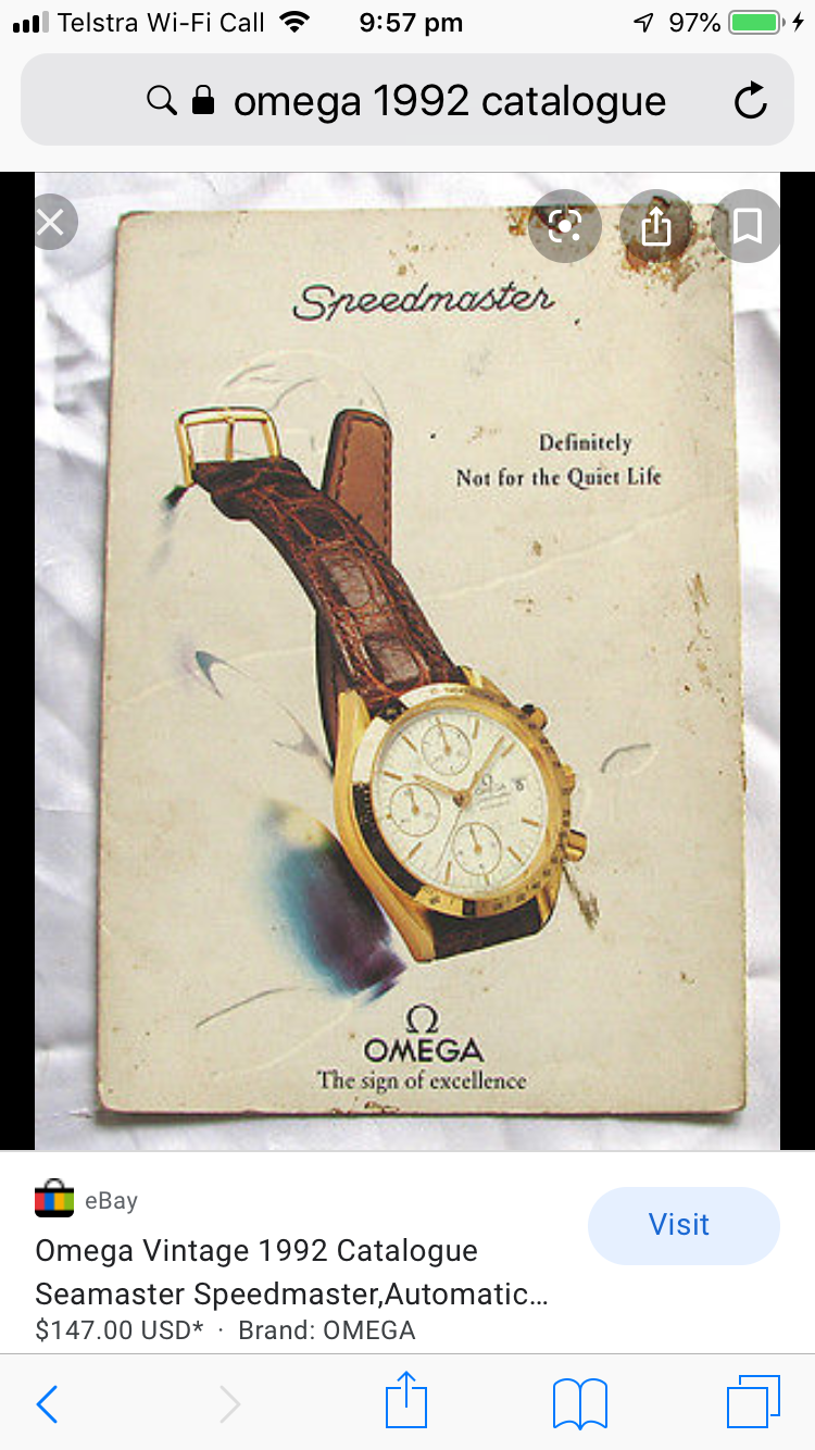

I took this catalogue page said to be 1991 off the net. I emailed the person who built the website but didn’t get a reply.
I used to race and collect old bicycles. There is some great information online but it seems anyone with original Omega catalogues wants to sell them at ridiculous prices.

Archer, 3711.20, what does this number represent in the pictured catalogue and could this be my watch model?
Thanks for your continued assistance.

Which of the references starting with 3711.20 are you referring to?
37112001
37112002
37112003
37112004
37112006
37112007
37112008
37112009
37112010
37112011
37112012
37112016
37112020
37112033
37112050
37112051
37112052
37112053
37112056
37112058
37112060
37112080
37112098
37112099
Please listen carefully...your watch is a 37111060 with the wrong dial on it. I can't make this any clearer than I have multiple times already.

OK Archer, I’ll end the conversation here. Thanks for your input. I’m not a slow learner. I was simply looking at the watch in the catalogue with the black leather strap that mine looks identical too ...
30,280
78,140
Yours looks identical to a 37112001. However Omega has confirmed that your watch is actually a 37111060...with the dial from a 37112001.
