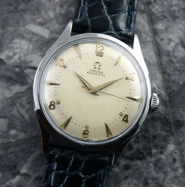

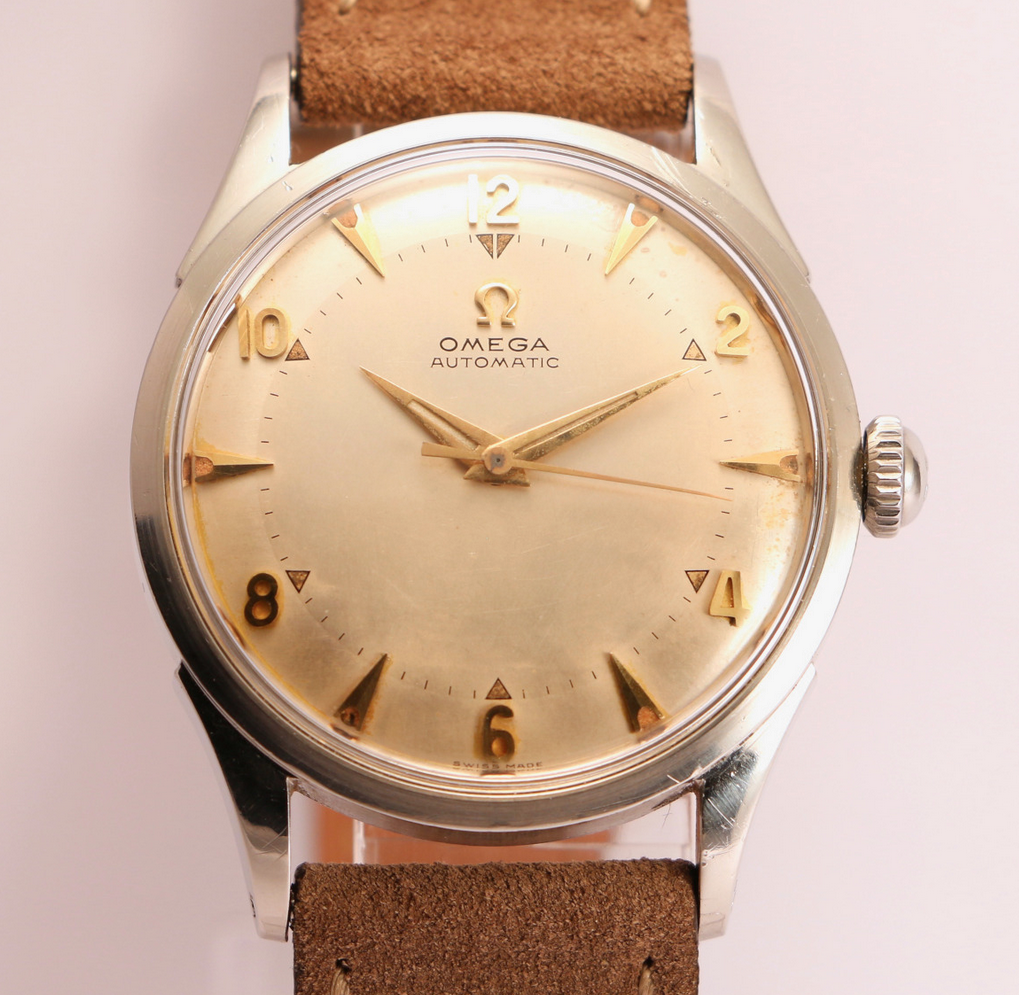

#1 and #4 look good to me.
Not replaced ... repainted. Honestly, it's very common in watches from that era.
For example? What details do you see in the "2635 - Bumper" to realize so easily that it was repainted. I am impressed by your knowledge. My doubt in that watch was always in the crown.
The printing of OMEGA and AUTOMATIC is wrong, SWISS printed in wrong location, misaligned and misplaced minute markers, missing lume dots, etc. After a while, refinished dials just jump out at you.

I'm surprised to learn that #1 is an original dial. That's an interesting one that I've not seen before.
I feel the same, but I am in no way an expert and trust the verdict of more experienced members here.

Two correct 2635s.
Totally..! Now it's obvious to me. Thank you very much for your time and sharing your knowledge.

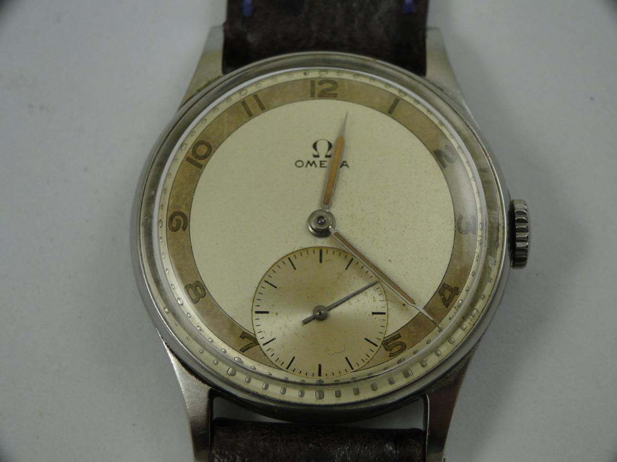

My omega is CK 2637 instead of CK2635. Check this: https://vintagewatchrestoration.com...one-golden-dial-cal-354-bumper-automatic-35mm The difference with my watch is the two-tone dial. Prints are in the same places
