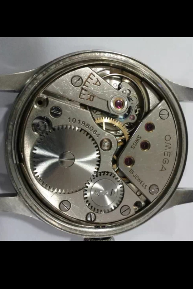

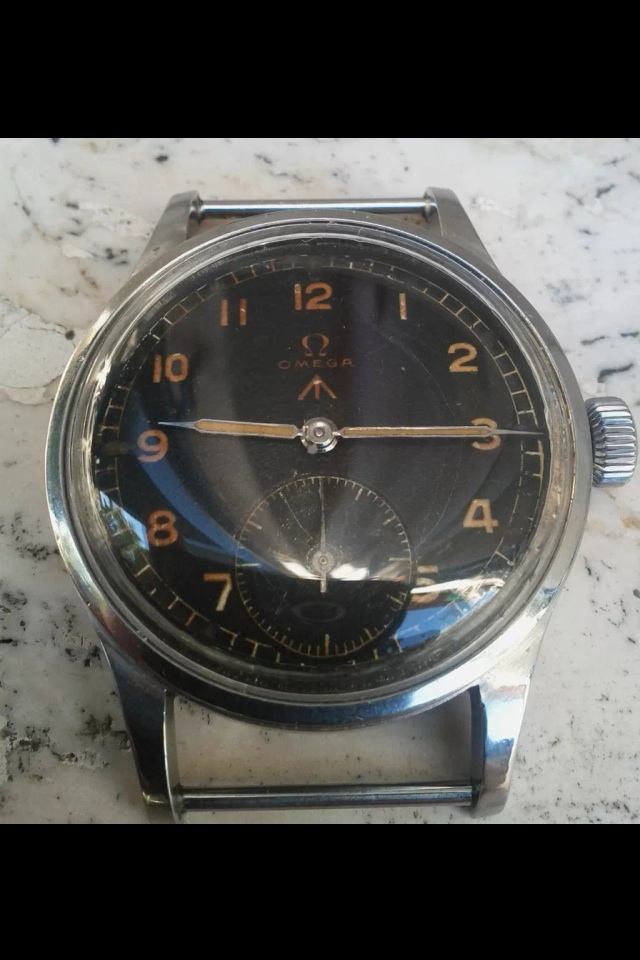

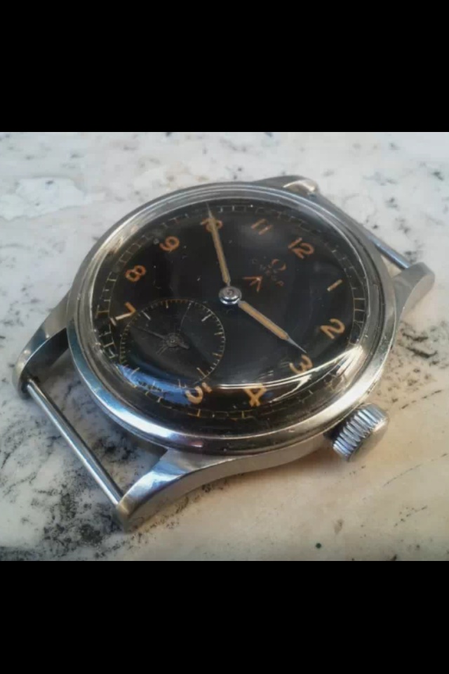

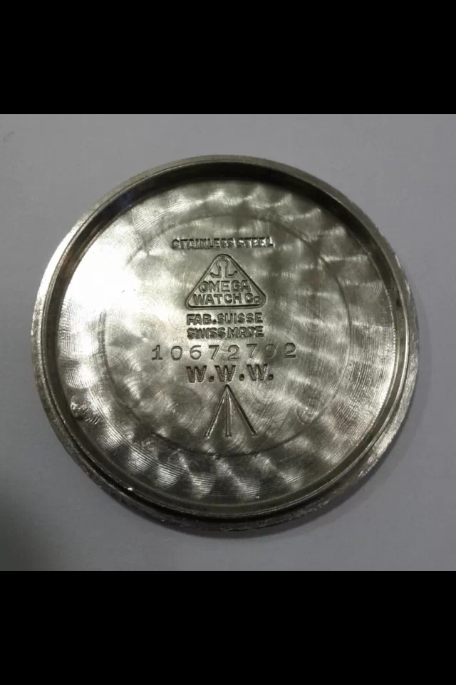

    image.jpg image.jpg image.jpg image.jpg image.jpg Hi all!
    I'm new to the forums but I wouldn't say I'm new to watch collecting. Most of the pieces I've accumulated thus far have been post 1995. I've fallen in love with the timeless military stylings of the WWII era issue pieces. The omegas seem to be more common and given my budgetary restraints this helps keep the cost down.
    It is however, my first vintage piece. I've read countless write ups on fakes / bits and piecers and what to look for and what to avoid but I would like some help with the following assumptions I've made:
    1) From what I gather, this watch is a 1945(?) RAF Military Omega.
    2) the dial appears to be original
    3) the crown appears to have been replaced
    4) from other pieces I've found the hands appear different? Are they replacement or were they originally issued like this?
    5) the numbers and markings correspond with British issue pieces from that period
    Any help would be greatly appreciated. I know patina isn't for everyone but I absolutely love the appearance of this watch and want to get a better understanding of what to look for before I take the plunge.
    Rob

  3. marturx Jan 25, 2015
    2,266
    4,214
    Hi and welcome to the forum!
    To keep it short, not a collectible specimen. Personally I would move on, to seek a better example

  7. agee Jan 25, 2015
    739
    698
    Hands look like MOD replacements-not Omega
    Look like Vertex WWW hands
    Omegas ,and Record, are common- 25000 produced, but highly sought after and command high prices

  9. Joe K. Curious about this text thingy below his avatar Jan 25, 2015
    1,647
    2,099
    Not an RAF watch. MoD...
