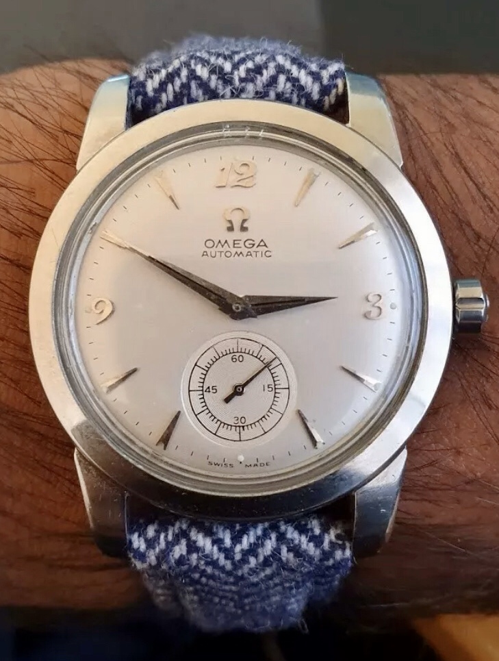

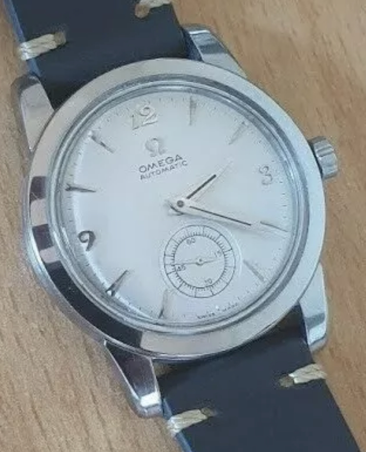

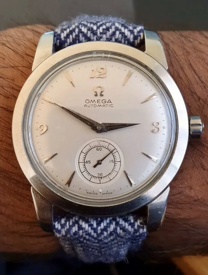

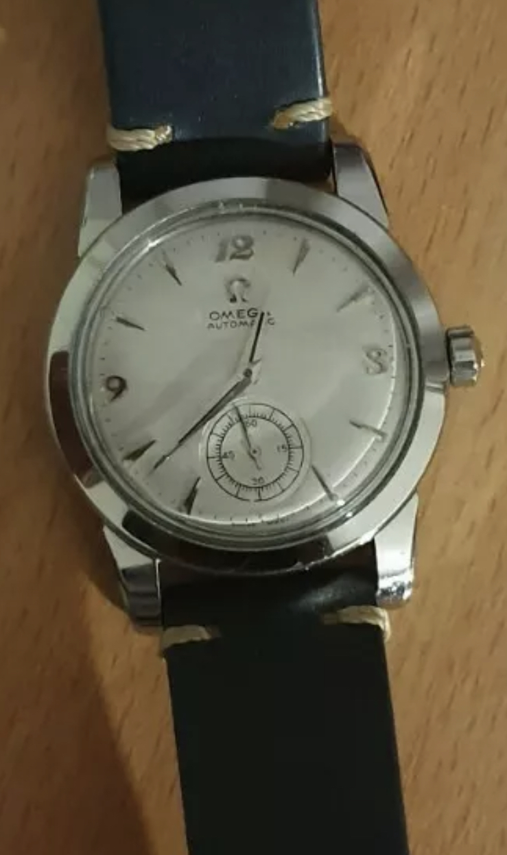

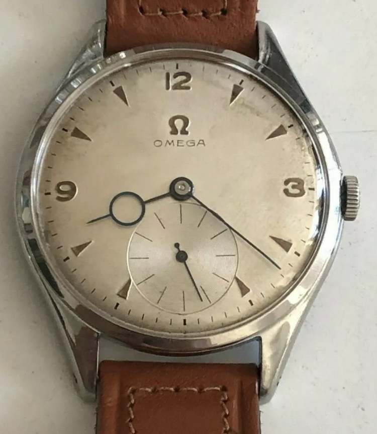

Could you guys help me out with your expert eyes? I’m wondering if this dial hand combination is legit for a cal 30 t2. I’m not sure there was a pontife hand version with this dial. Appreciate your help.

Well the omega looks like it was written with a pencil
7,690
22,055
Aside from what’s already been said -The hands and dial are completely different styles and time periods. Dial is 1950s. Hands 1930s.

Thanks for all the input. I really appreciate this community and its member’s good intent and support!

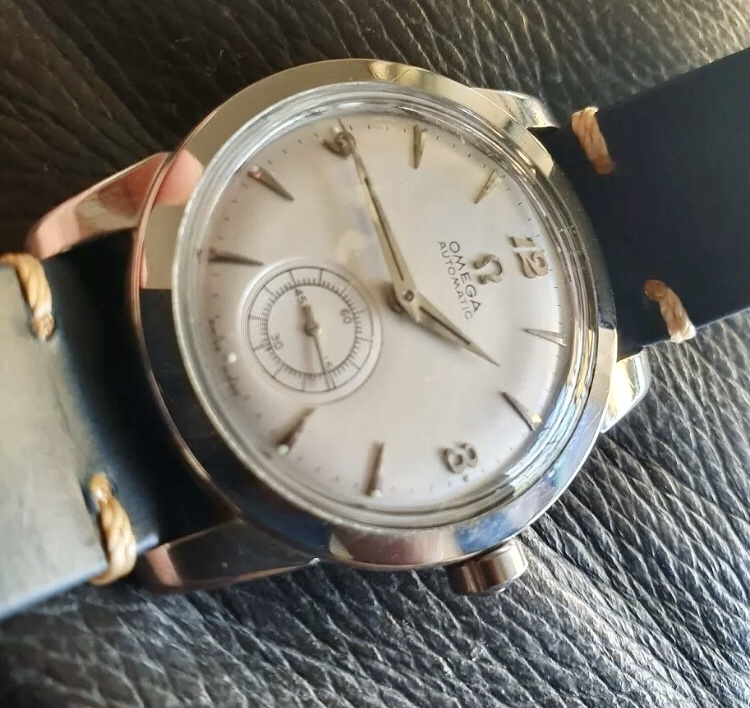

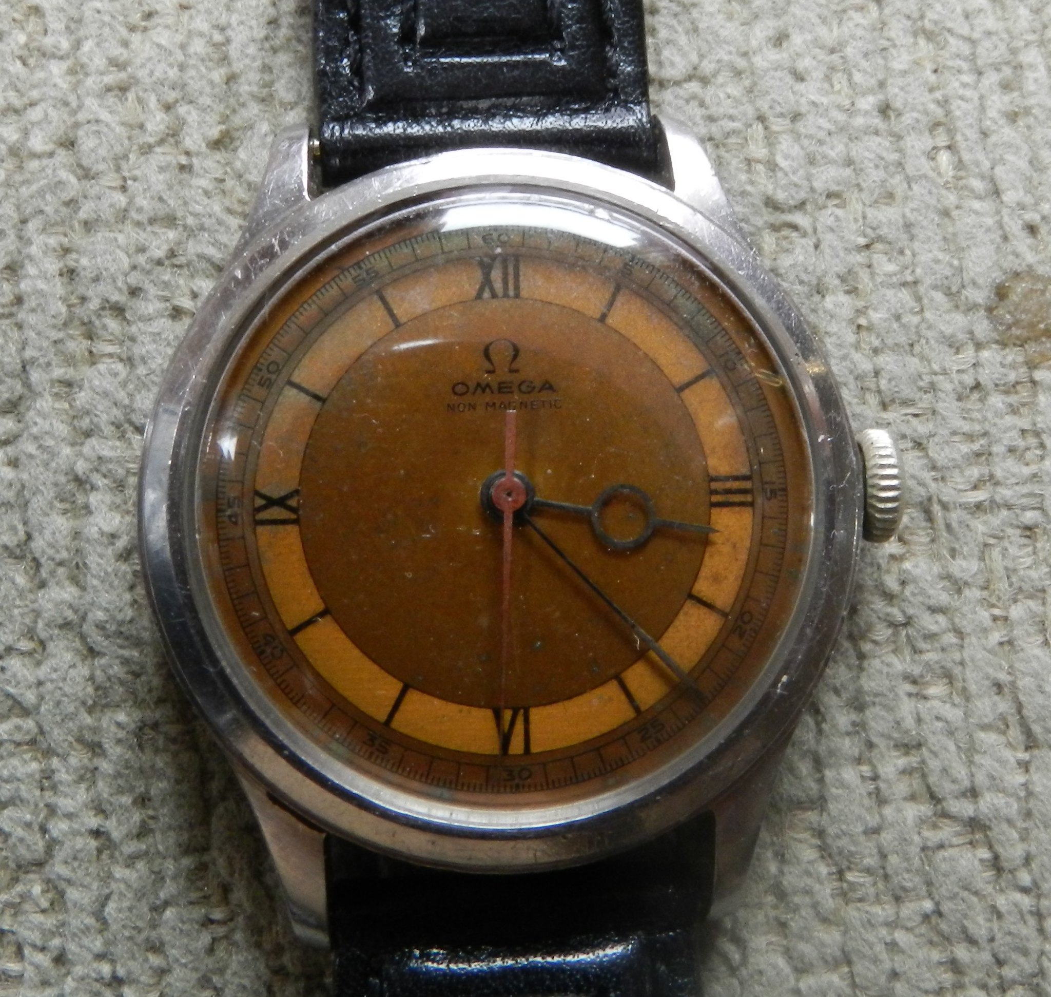

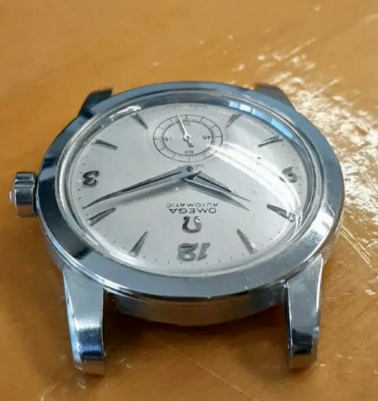

Maybe I can trouble you guys with another? This seems to be quite genuine to me and I love the Breguet numerals. It is said to be a cal 344 frim 1952?

I believe they intentionally did not take a good, clear photo of that dial...
24,836
55,255
I don't want to jump to conclusions, but that sub-dial looks strange to me at first glance.
295
148
you really can't figure by yourself out, that how the "omega" is written looks more than suspicious...??!

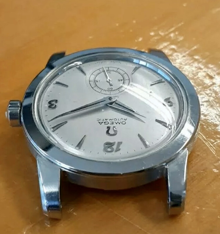

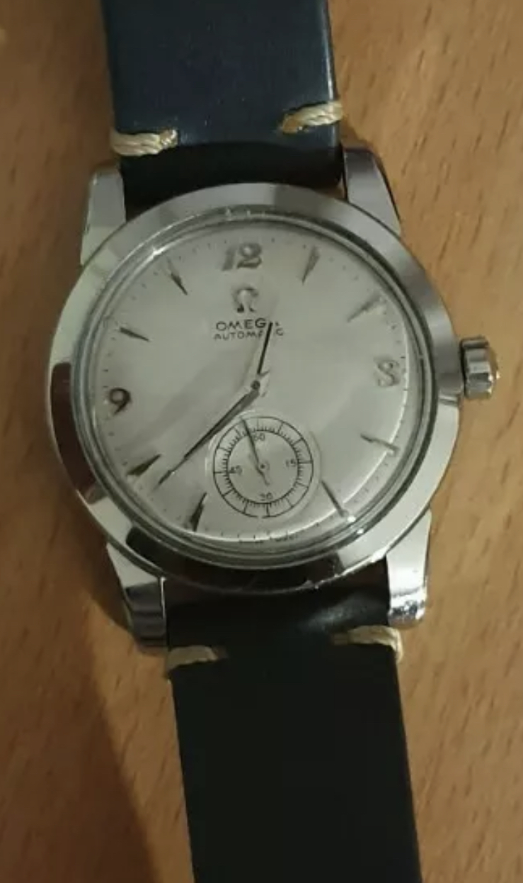

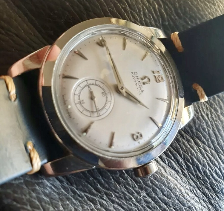

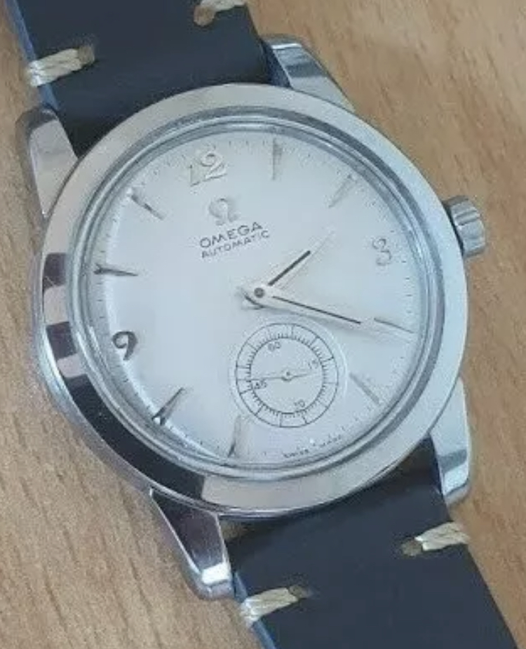

I asked the seller for a better photo. He sent these, what do you think?

Still looks like a redial/ relume to me. "Swiss made" lettering and spacing, some minute track spacing, some of the hashmarks in the seconds subdial
24,836
55,255
Yeah, there are some alignment issues and obviously lume-dot problems, but I'm still hung up on the sub-dial. I just can't remember seeing one like that. But there are some real experts that have seen everything, and hopefully they will give feedback soon.

2,326
1,887
I'm not as expert as some but I've been looking at Omega watches for decades and I've not seen that type of subdial either.
Tom
5,026
18,608
Tom
Me neither. That's not original.
