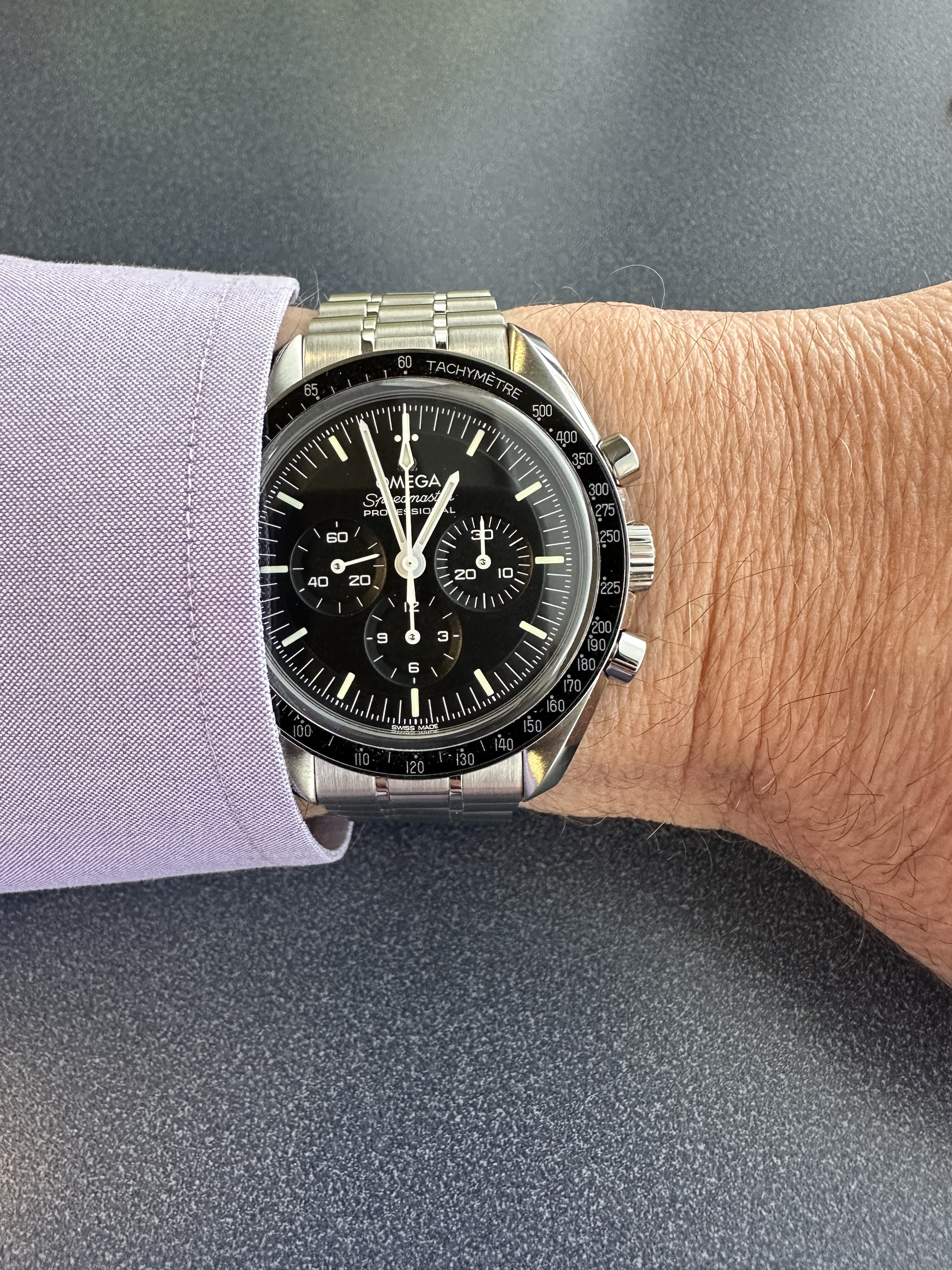

Have been on quite the watch journey the past 2 years. I like to think of it as a journey and not a buy a new watch and sell the old one at a loss description!!!
I am very much a one watch person and have found it with my new from an AD 3861 Sapphire on a bracelet. Turns out I like shiny things and am in love with it. This is my forever watch and can’t be any happier.

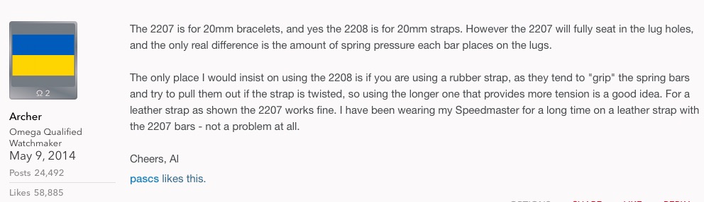

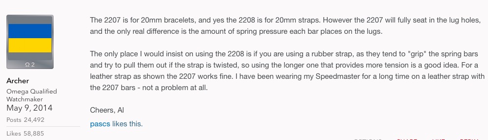

How many did you get and is shipping cost in the amount, personally I would get a spare set of 2207's and 2 sets of the 2208 so I have back-up?
Not really a risk but Omega recommends the 2208 for straps, here's professional advise;

This all comes from my knowledge of the 1861. The 2207 bars are slightly shorter and easier to get on and off with the bracelet. The 2208 is a bit longer and meant for straps and natos. I don't think wearing the strap with a 2207 would have any risk.
You can buy springbars direct from Omega (just email [email protected]). I am in the US and have done it a few times. They were $4 with $10 shipping if you order 1 or 100. I ordered 10 to have a supply on hand.

You would be ok for most situations using the shorter bracelet bars with NATO or Velcro straps, but Omega specs out the slightly longer bars for straps. The prior 1861 Speedmaster had NATO straps included as freebies and Omega included longer spring bars in the box, so they obviously believe longer bars are better with straps.
068ST2207 is 22.428 mm long for bracelets
068ST2208 is 23.317 mm long for straps
NEVER use the longer 2208 bars with a bracelet, you will have a devil of a time removing them in the future. Much cursing will ensue, along with tool marks on the back of the lugs in the effort to remove the longer bars. Don't cross the streams.
