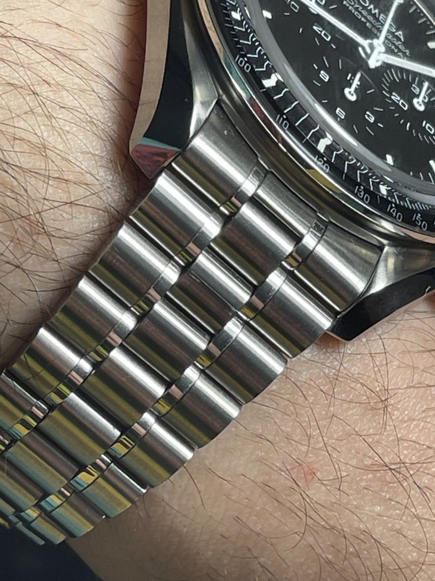

This is a new sapphire 3861 from AD. After purchase I noticed a rattle that was coming from the end links tapping against the case when my wrist rolled.
https://imgur.com/a/54YmKwI (make sure to toggle sound on the video)
I didn’t expect this on a new watch and actually paid full price as they weren’t able to work a discount. No problem I was in love and made the purchase.
I can’t imagine this is normal and if it was just a visual thing I could (maybe) get past it. But it makes a clinky clanky sound when I roll my wrist
At first I thought it was a spring bar issue but the AD thinks end links so they are ordering a set. Part of me wants to pray this fixes it. First “luxury” watch purchase.
Both the 6 and the 12 side exhibit the same issue.
Is this normal? anyone want to take a guess at the issue?

Sure doesn’t seem normal to me. Since the issue seems to be consistent on both sides, I wonder if the AD swapped out the bracelet at some point (like during sizing) and used spring bars of the incorrect thickness to reaffirm it.

Yeah i did bring up the spring bar possibility, and also looked at the same model they had in store. They seemed the same to my eye but I could be wrong. Either way they pretty much dismissed the spring bar as a possibility and there really isn’t any play in the spring bar area but rather the edges of the end link that meet the case.

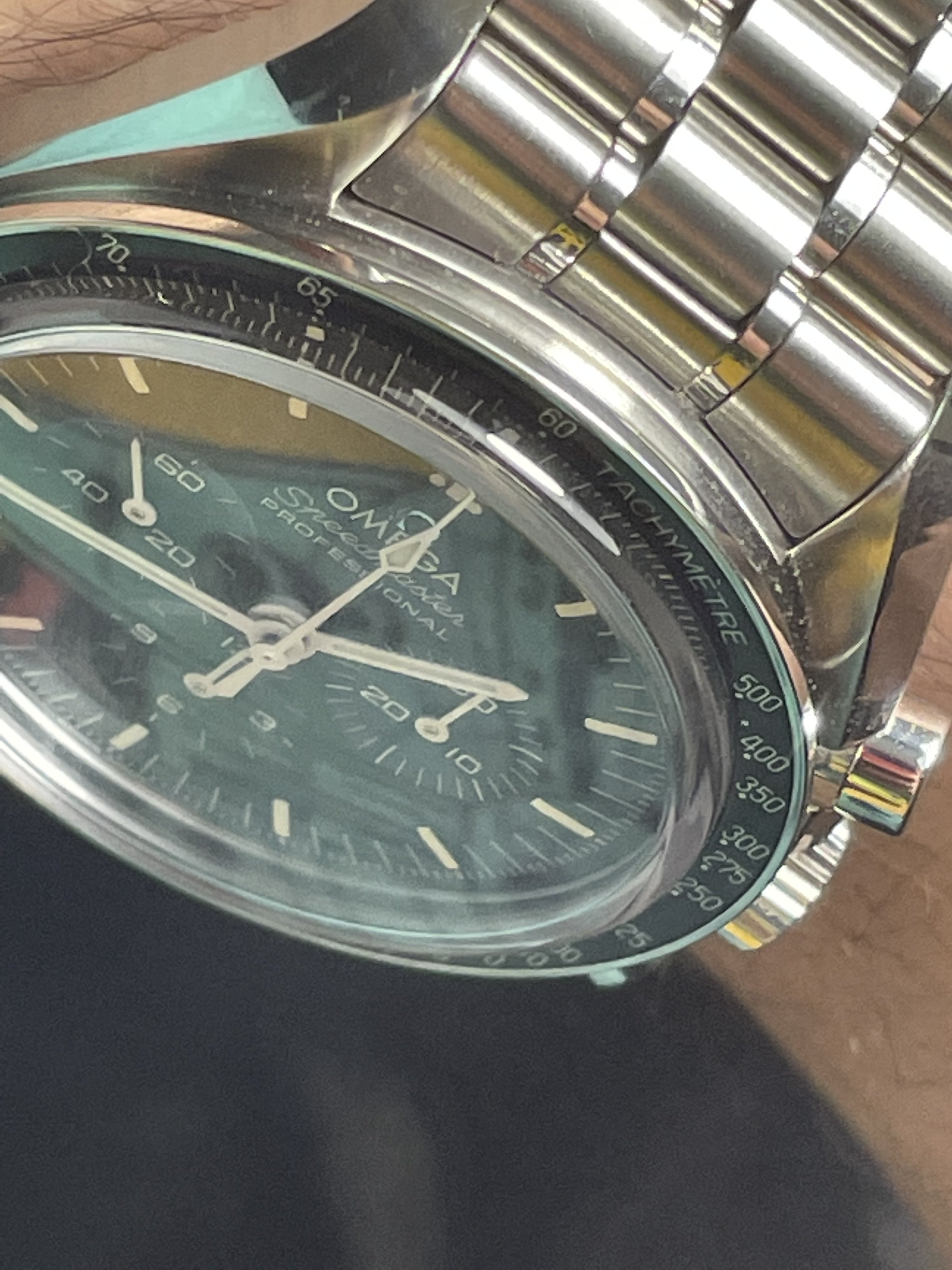

The spring bars are definitely in the holes. Here’s a few photos showing the spring bars and I tried to get a pic showing the max space in between the spring bar and the hole it fits on the end link. In this picture the full weight of the bracelet is hanging downward to pull the end link as low as possibly.
Would love to know what people think. This is bugging the hell out of me but at the same time it’s a first world problem and I definitely have bigger fish to fry.

All manufactured items have tolerances (+/-) which usually give acceptable results when the parts are mated together, in your case the tolerances of the location of the spring bar holes (or the case tolerances where the end links butt against) are in the opposite direction as the end link tolerances resulting in that poor mating. Hopefully a new set of end links will solve the problem, but the issue may be the spring bar holes in which case you may have to get a new watch to solve the problem. Less likely is the case tolerances where the end links butt up against are off.

Even if the spring bars are present, the AD might have accidentally used the wrong set. If I remember correctly, Omega's spring bars aren't all the same diameter. The bars for straps are different from those used for bracelets, although I'm not sure if that's what is going on here.

At this rate I don’t know what to do. I guess I’ll wait for the AD to get the new end links and see what happens, I’ll try to forget about it in the mean time. I kinda want to ask them to order me new spring bars as well but then not sure I’m they’re going to ask me to pay for them after they felt that wasn’t the issue. If I bought from an AD can I go into an omega boutique and ask them to check if my spring bars are incorrect? Would they have them in stock? Anyone know if something like this would be covered under warranty if I’d need a whole new watch? Ugh

Try not to stress. It should be fairly straightforward to diagnose and fix the problem:
1. Try new end links. If that doesn't work..
2. Check spring bars and ensure it's the correct ones. Any AD or OB should be able to do it in 2 seconds. And spring bars should not be expensive to replace. If that doesn't work, then...
3. Check for manufacturing defects in the watch itself. If present, watch should be replaced under warranty.
Hopefully you won't need to get to step 3 but it should all be covered under warranty, anywhere you go. That's what international warranties are for and why you pay for a new watch. For the peace of mind.
Good luck with resolving your issues.

Quite definitely an issue with the spring bars I’d say.
Get them to give you a replacement watch. I’d wouldn’t be accepting any issues like that with a brand new watch.
The spring bars used on a Speedmaster should be 1.8mm in thickness both for bracelets and straps and that's very important.
The ones used on straps are slightly longer.

Not sure if you’re looks worse than mine or not but here has been my experience:
omega boutique replaced spring bars - no change
Ad replaced end links - no change
I also viewed other 3861 speedmaster and noticed the same issue to varying degrees.
the issue (in my case) was not the spring bars as many here alluded to but either the holes for the spring bars are drilled too far from the case or the case is not shaped right aka their quality and tolerance standards are just low. Regardless I fixed it pretty simply.
I added a thin small strip of clear tape on the inside of the end links (not visible once installed), and that’s solved the problem 100%.
I may attempt to send it to omega to see what they can do to remedy the problem at some point during the 5 year warranty but for now, any movement of the end links is gone, and the rattling sound is gone. I’m satisfied.
