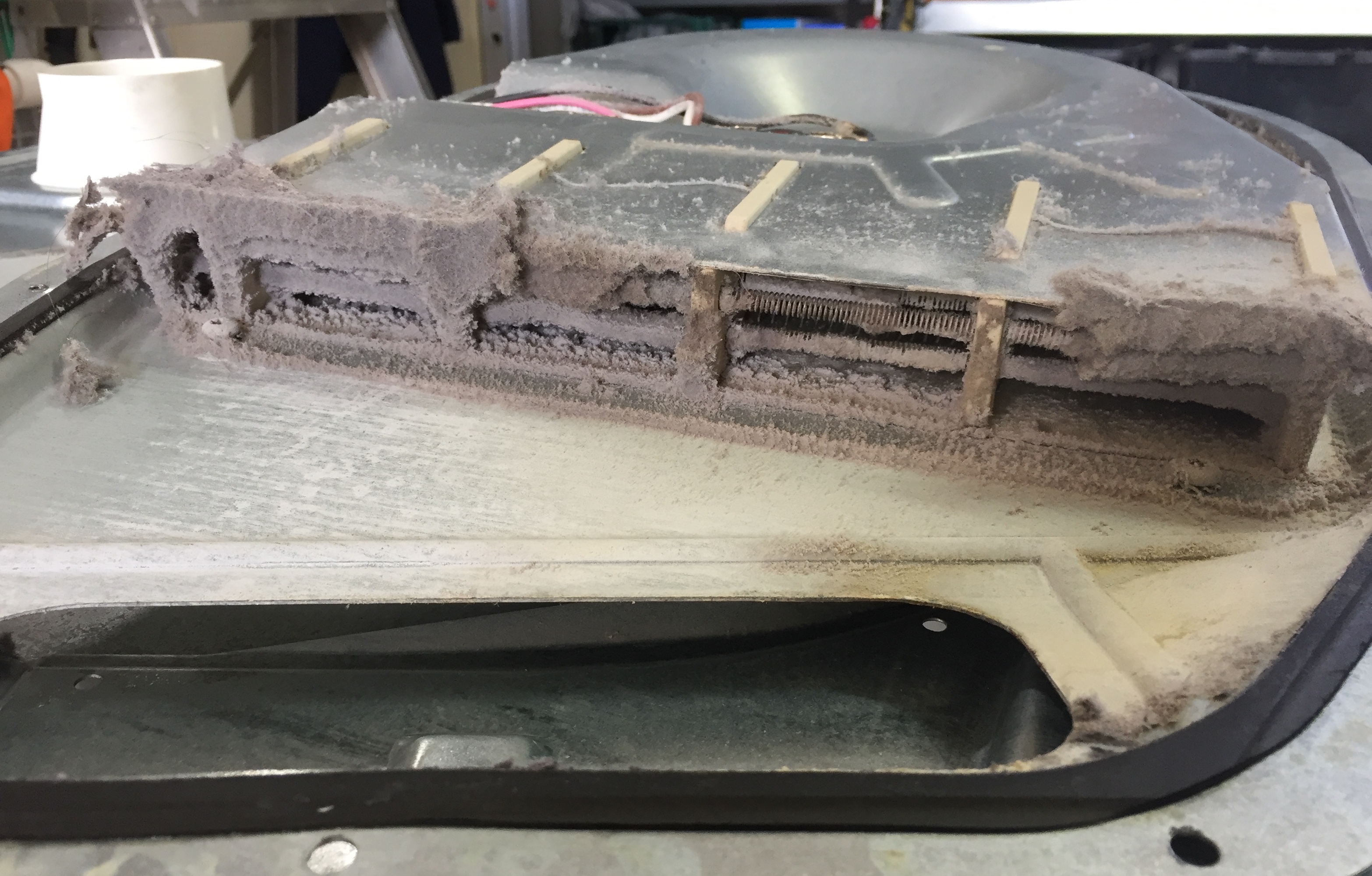

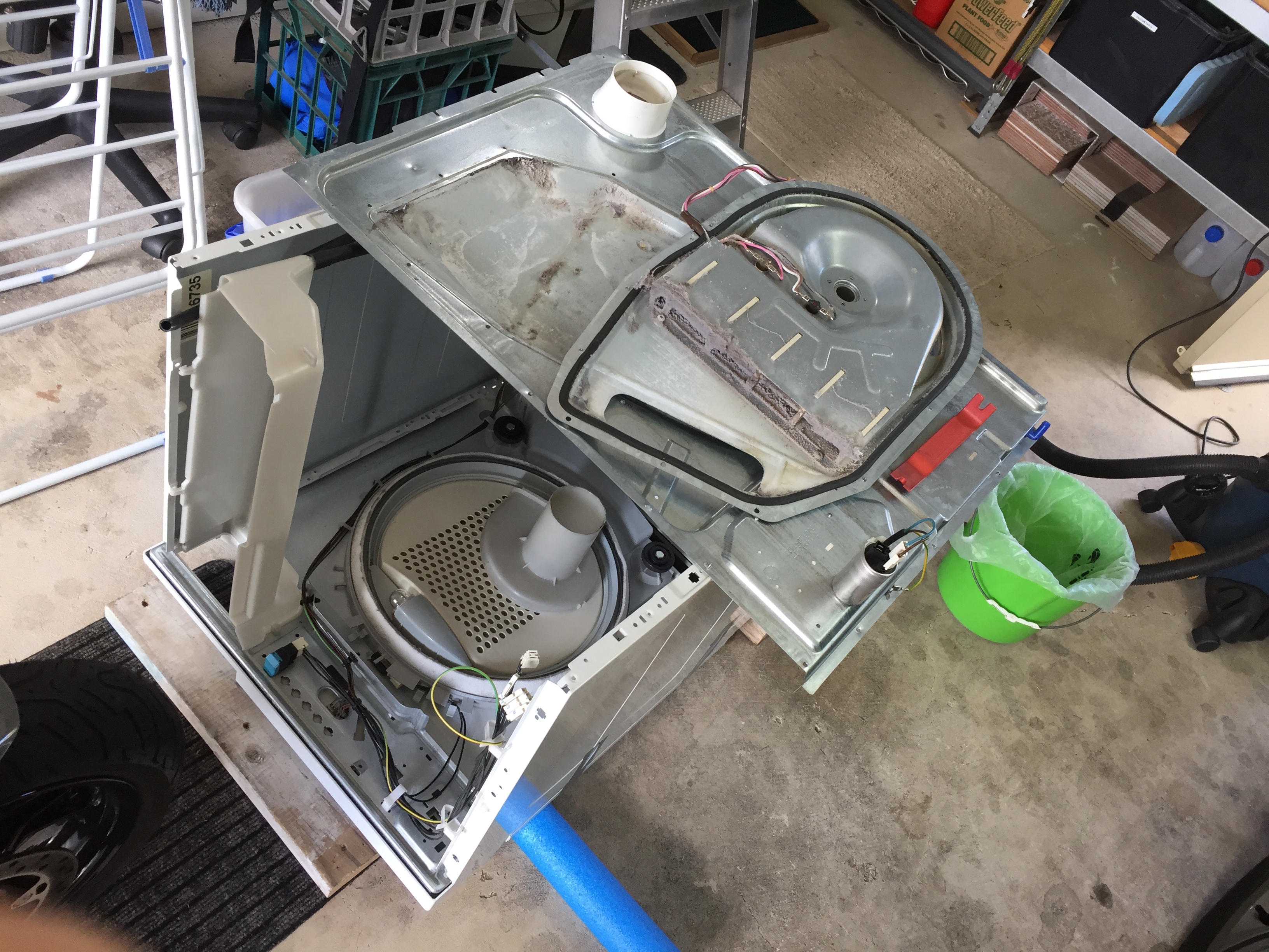

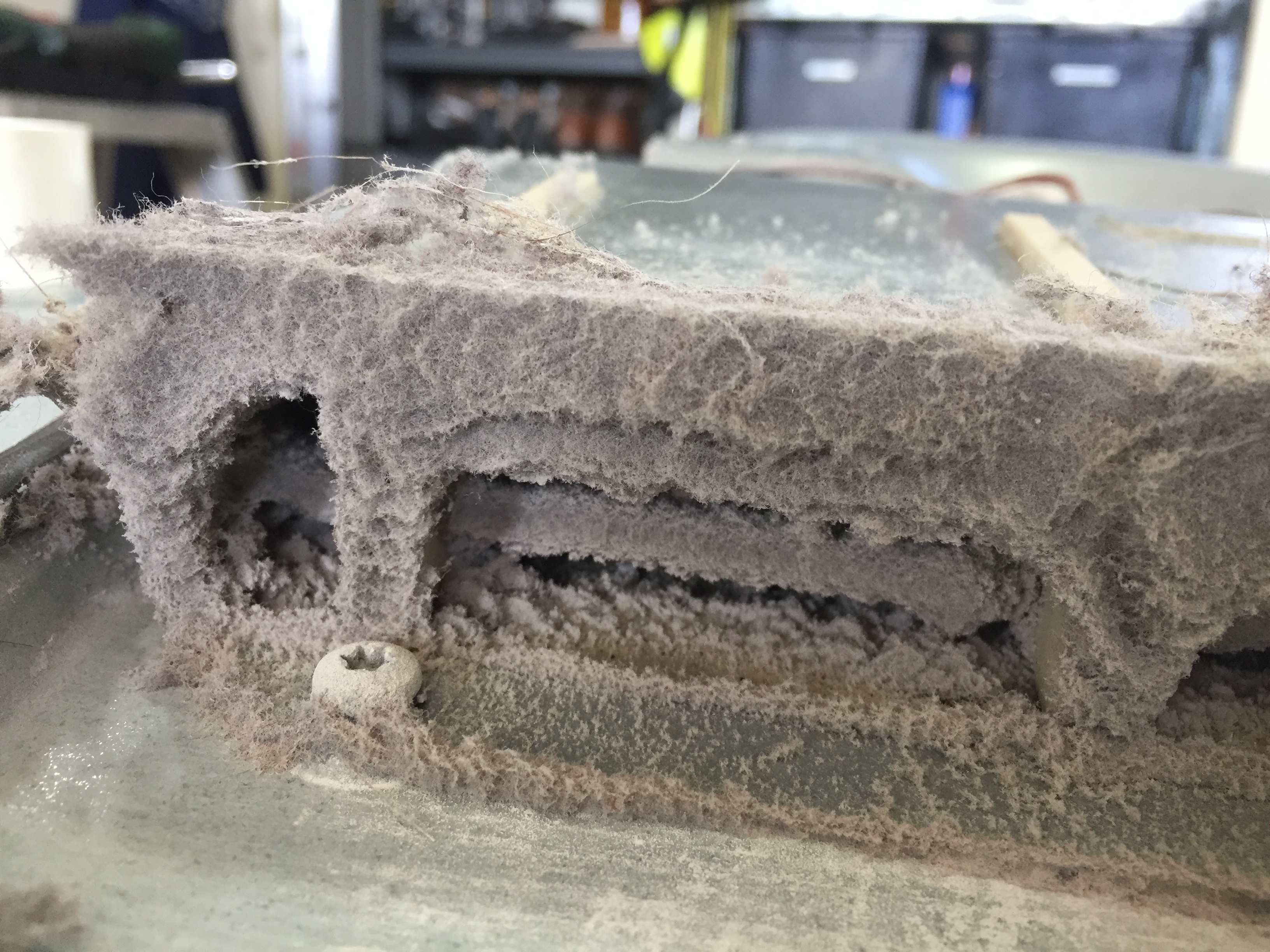

Ever wonder why..................
18,496
38,438
clothes dryers catch fire?

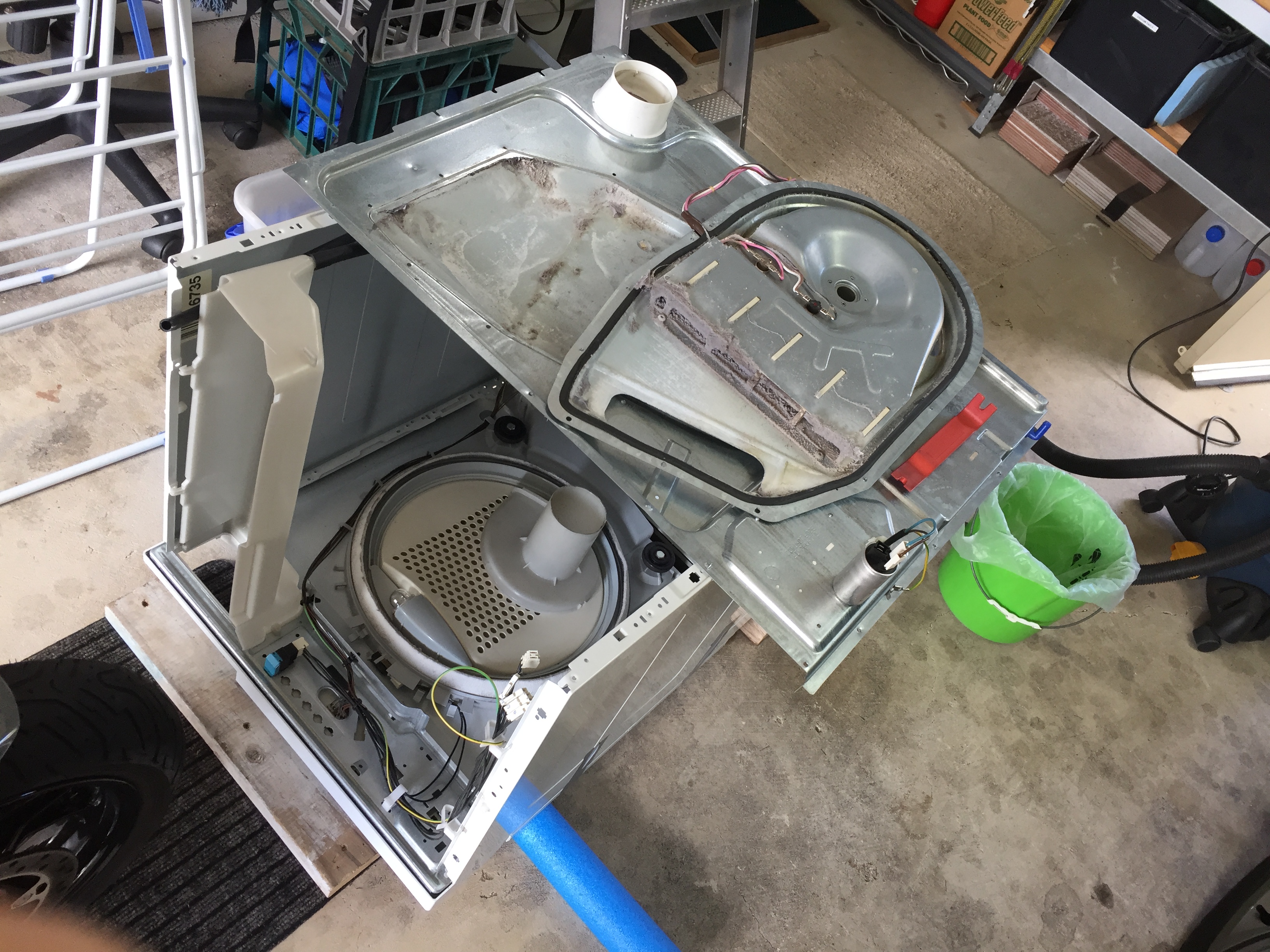

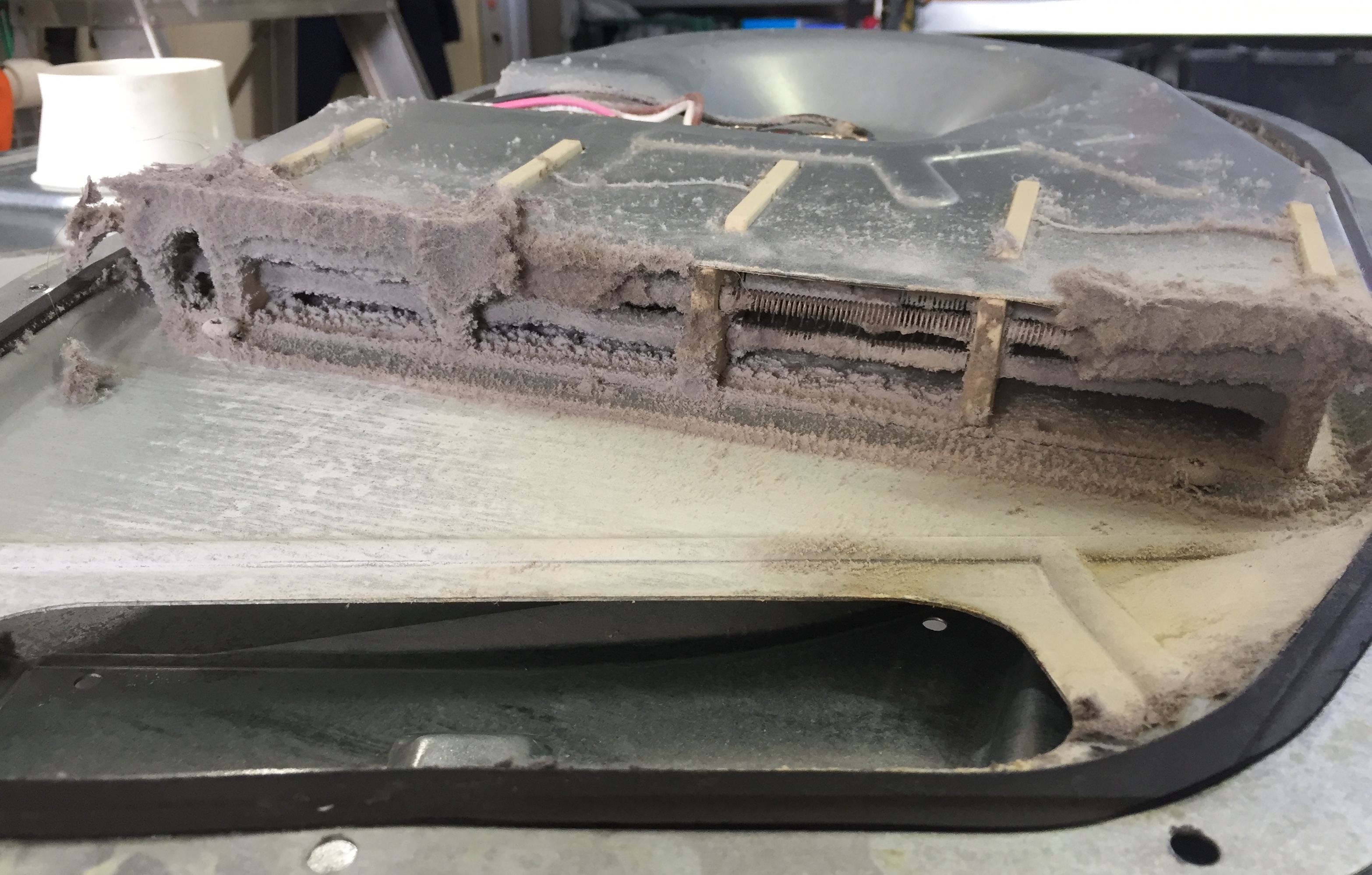

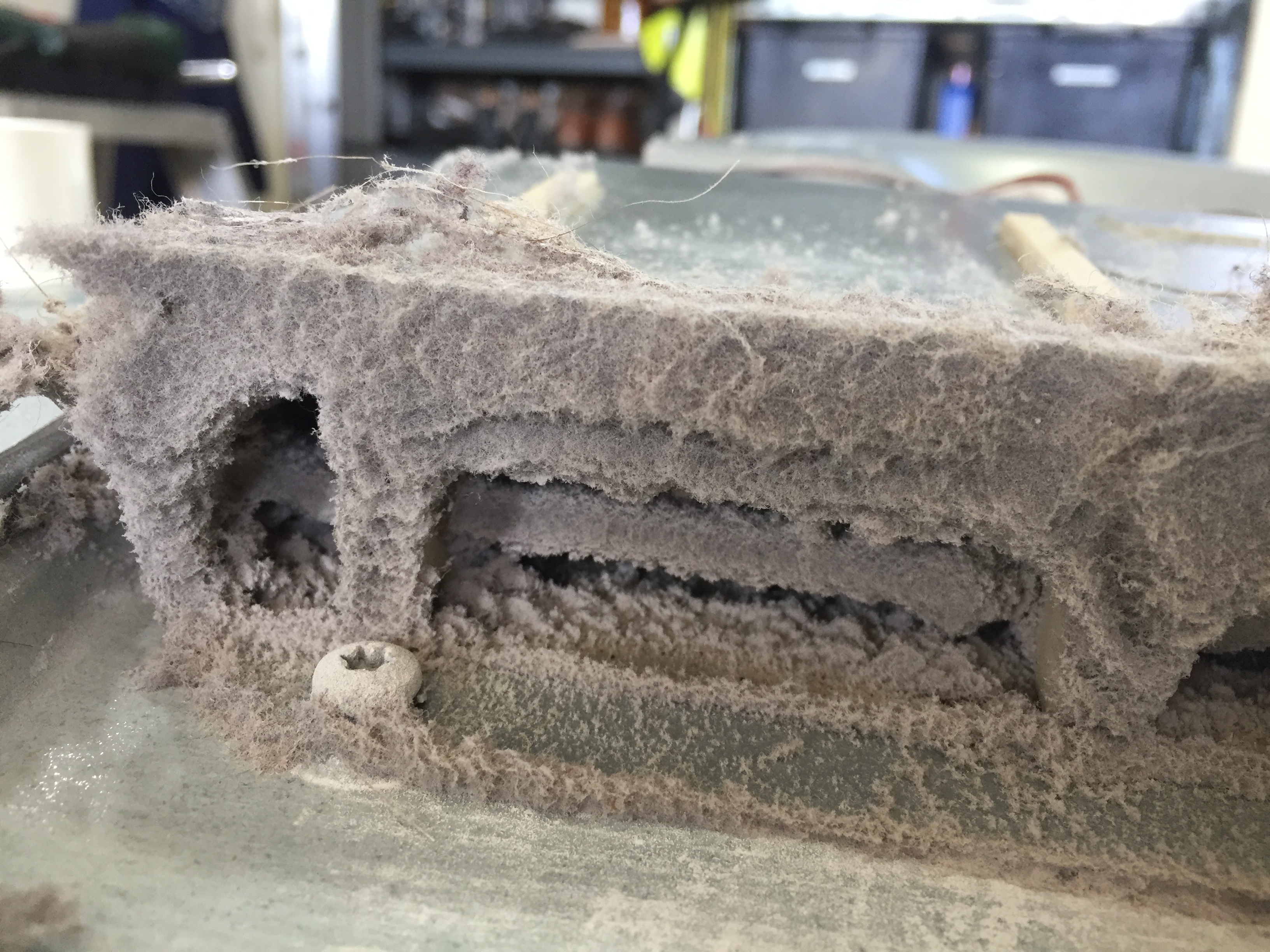

Pull it apart and check it out.
The inlet to the heater elements.
Eeeewe!
I know, I should be working on watches, but the belt snapped in the dryer so I thought I'd give it a deep clean after five years of operation.

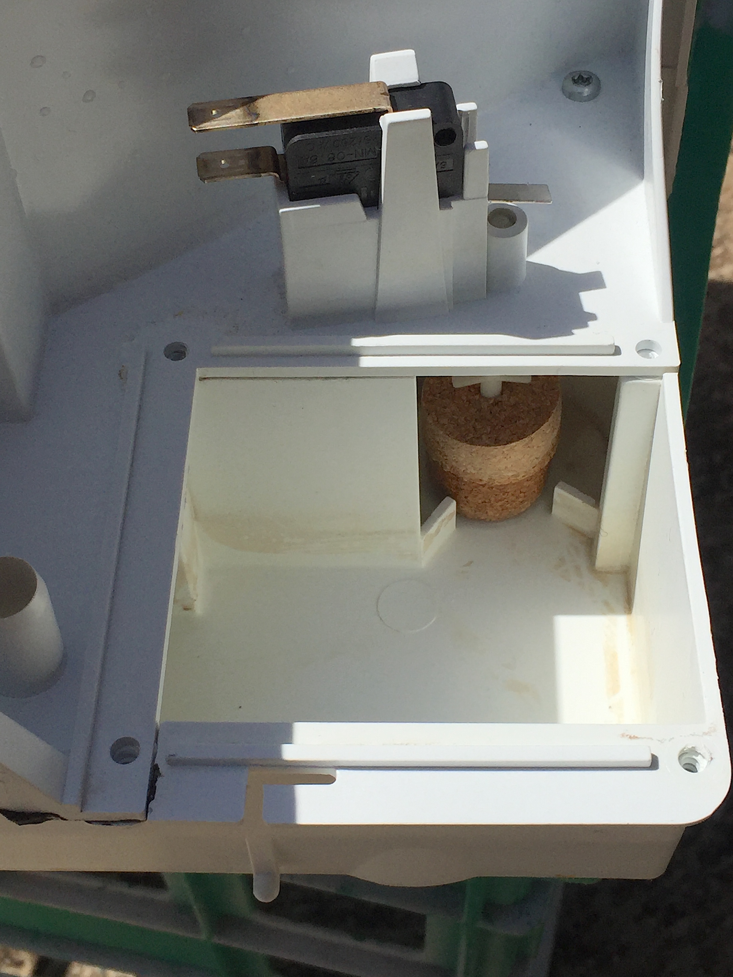

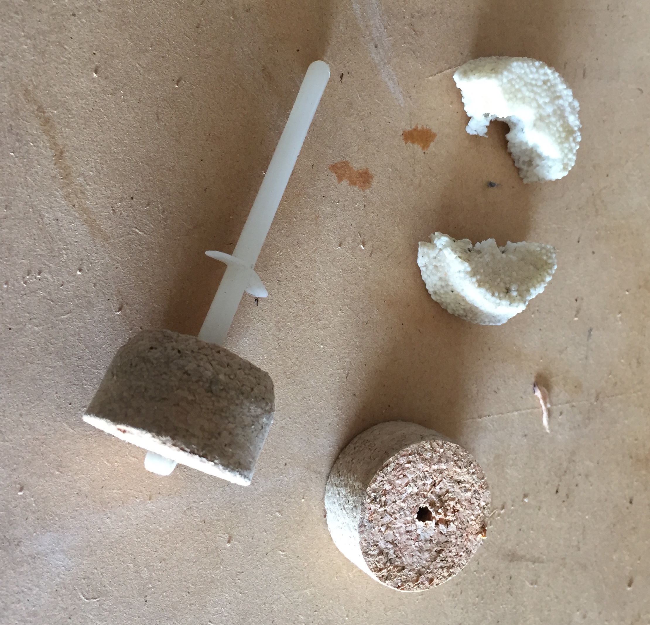

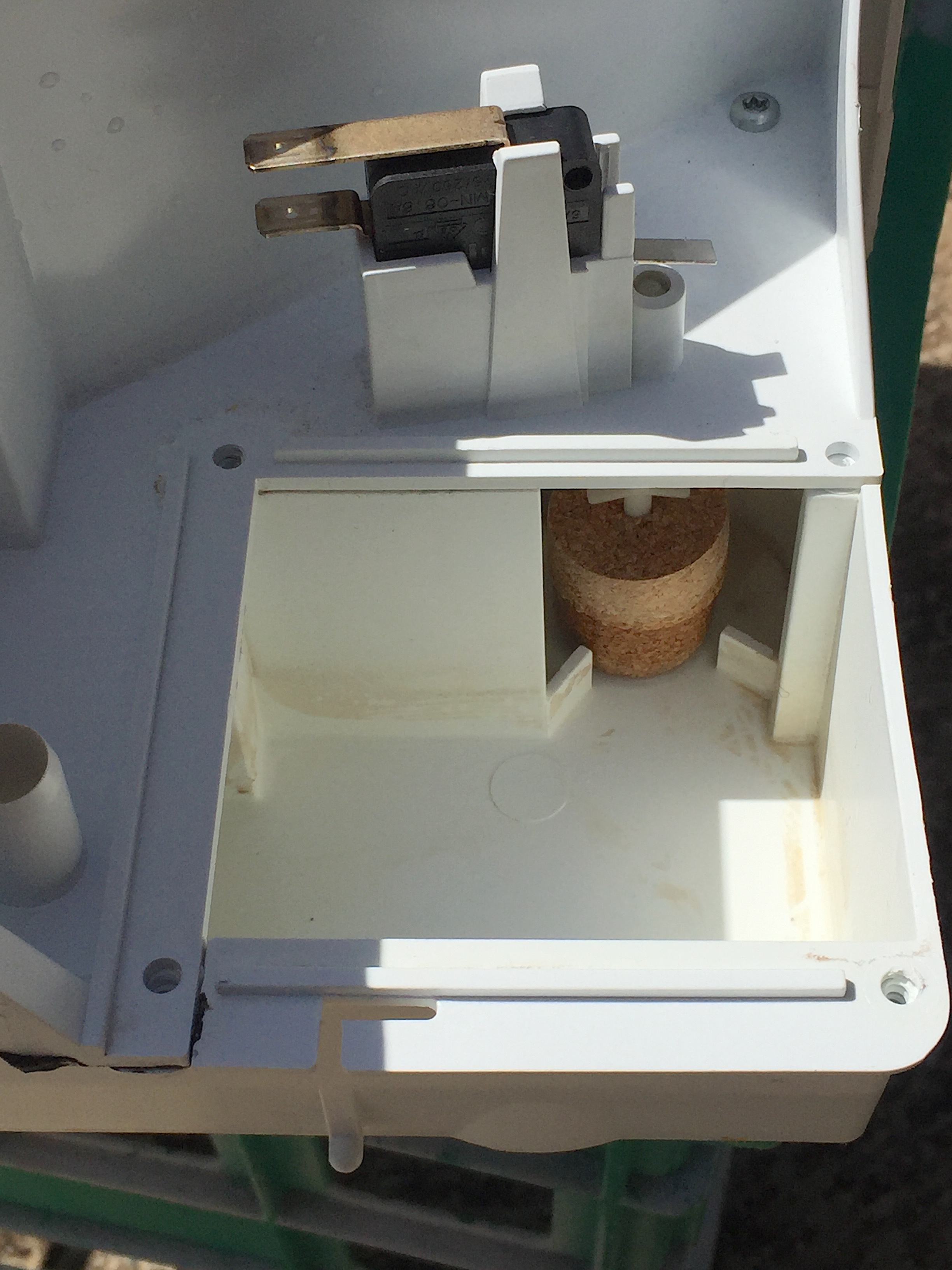

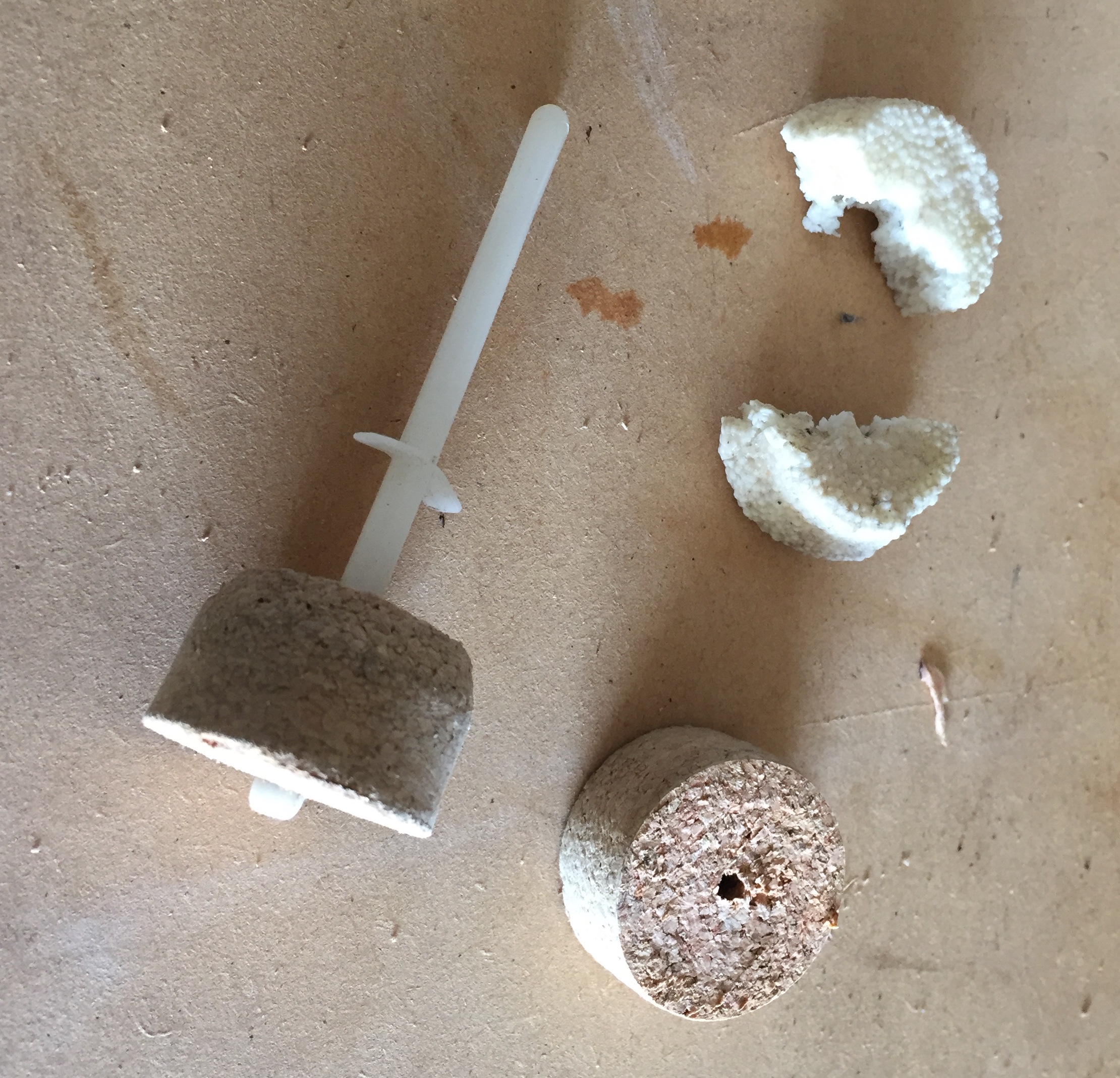

Couldn't figure out why the dryer would leak sometimes.
Seems that the float that triggers the pump switch wasn't a float any more, more like a sinker.
So I made a new one (pays to save the corks from your single malts doesn't it! 馃榿).
All fixed and tested, now just waiting for a new belt.

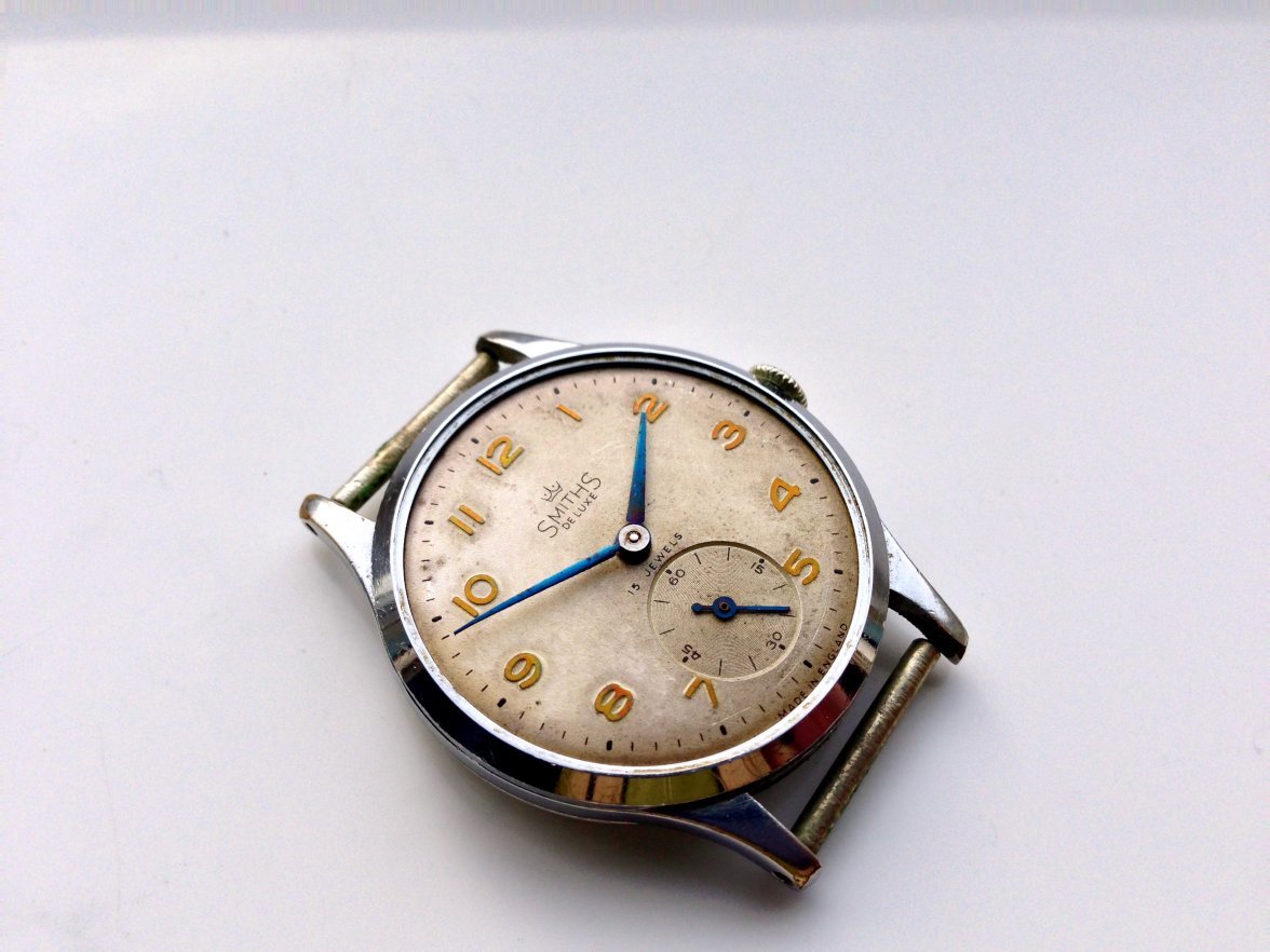

My cloths dryer is energy efficient @JimInOz 100% solar
I think you need me to send you another watch

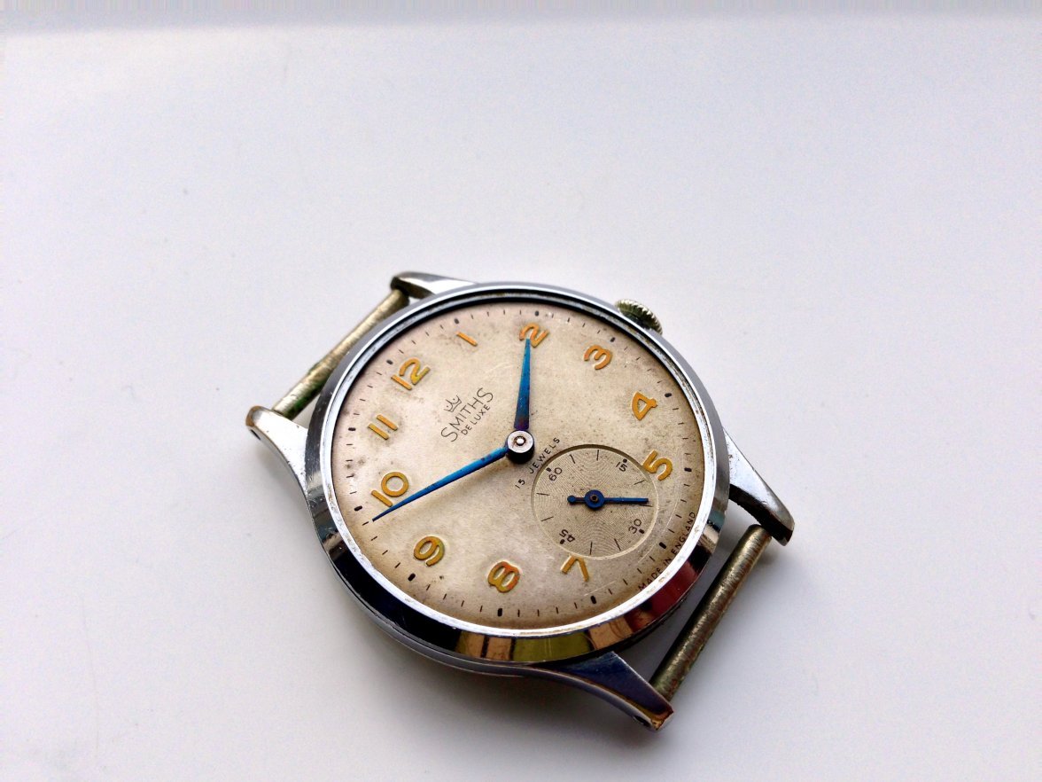

He could do the beautiful Smiths I sent him as a gift 馃槜馃槜

Oh man, you need new winding stem to fix that dryer, not the belt
It's in the queue Andy. I'd like to get a bit more confident with smaller movements before I do it though. But don't worry, you'll be the first to see it when I finish.

You鈥檝e inspired me to take mine apart - maybe it鈥檚 all gunked up also and that鈥檚 the reason it trips the safety switch 馃槻

I had an idler pully assembly disintegrate on my dryer last year, upon tearing down I didn't find all that much lint on the parts. If you have a buildup of that much lint you might check your exhaust for clogs or impediments to free flow of air.
