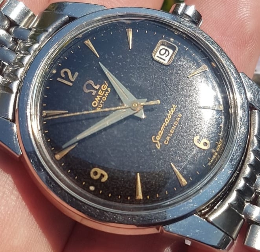

Good evening gentlewomen and -men,

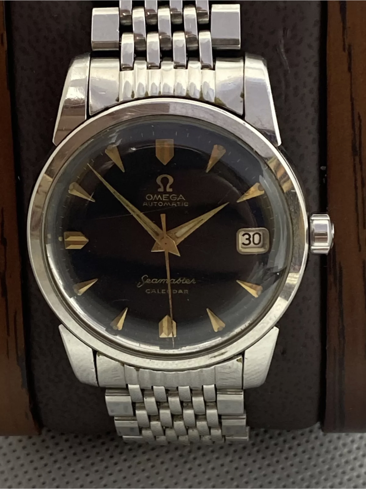

I’m considering taking a step into the minefield that is black dialed vintage Omegas and was hoping for your feedback - I have my doubts, so I’d rather be safe than sorry. And there’s nothing safer than “OF-approved”. 😀

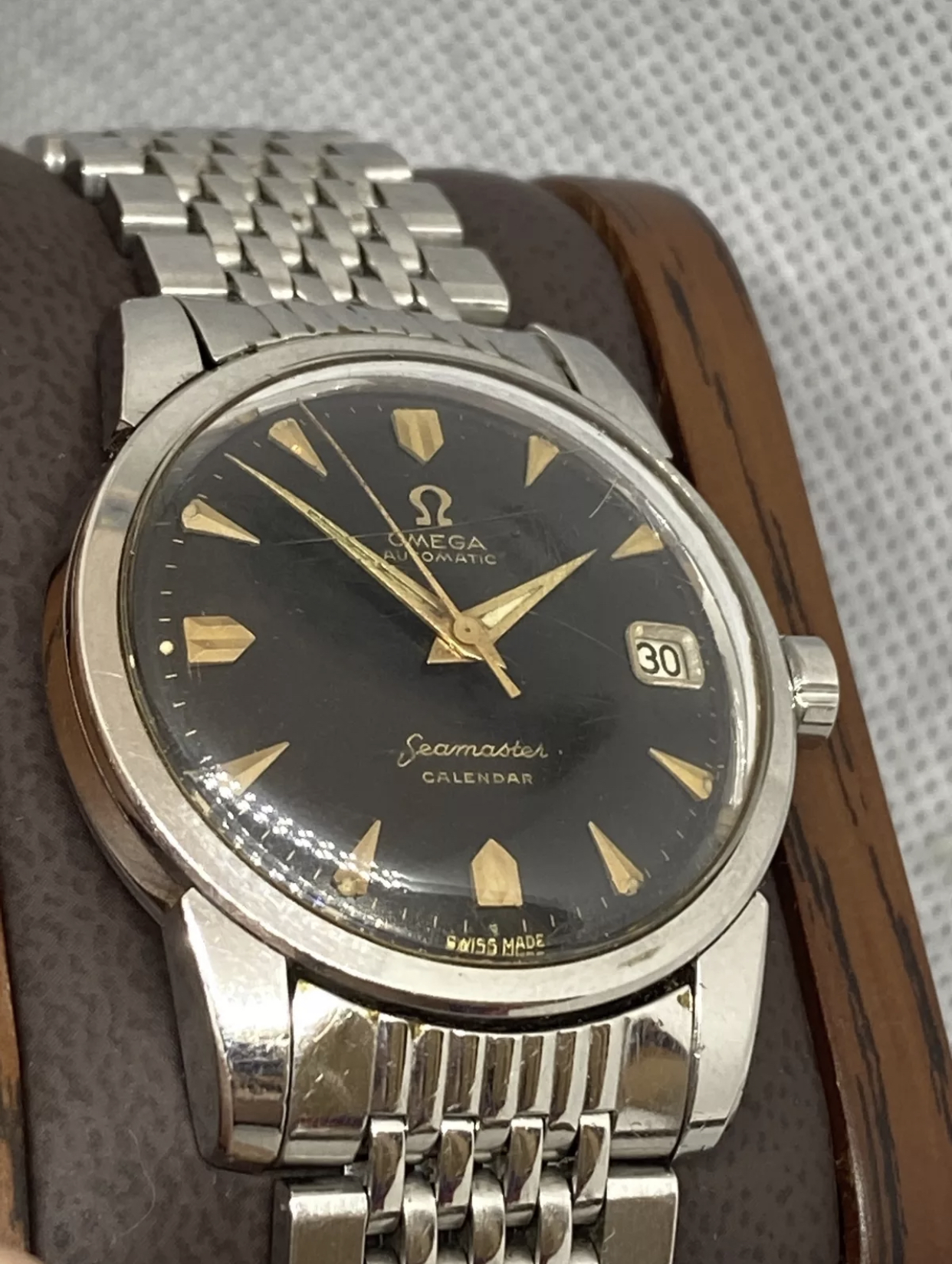

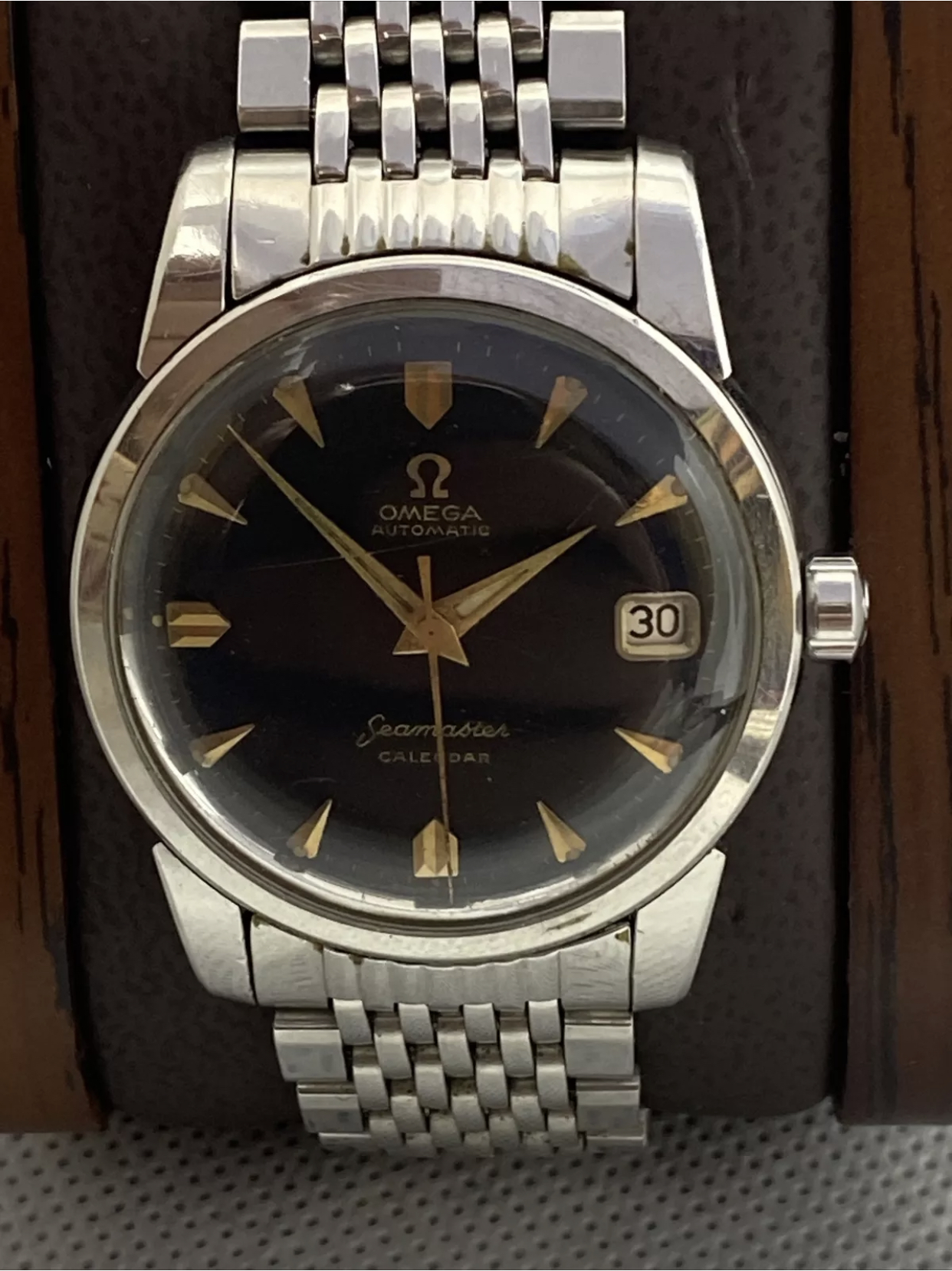

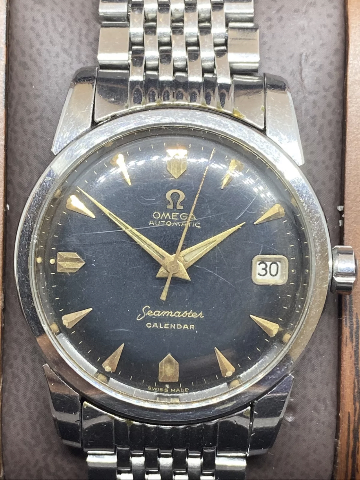

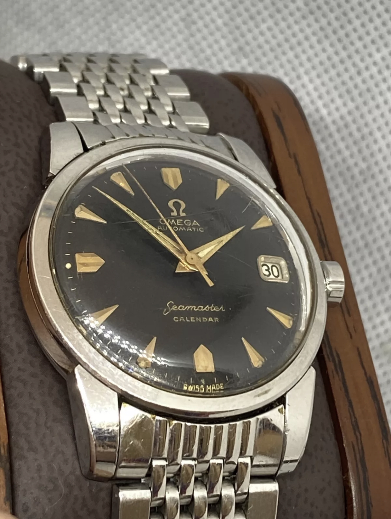

This is what lured me: A 1950s Seamaster Calendar, likely ref. 2849. Here’s what I’m thinking:

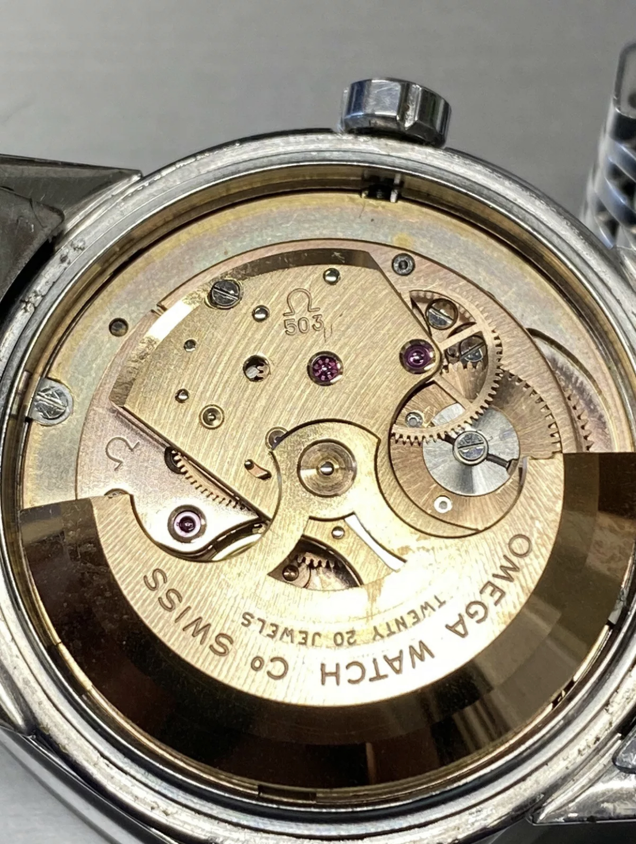

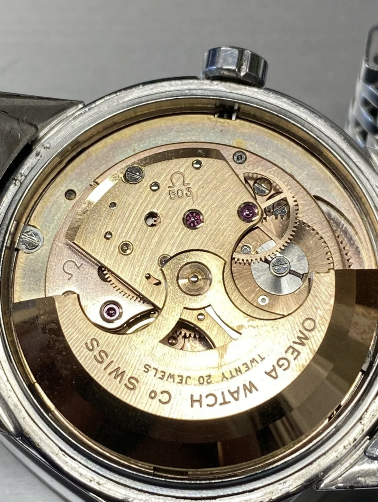

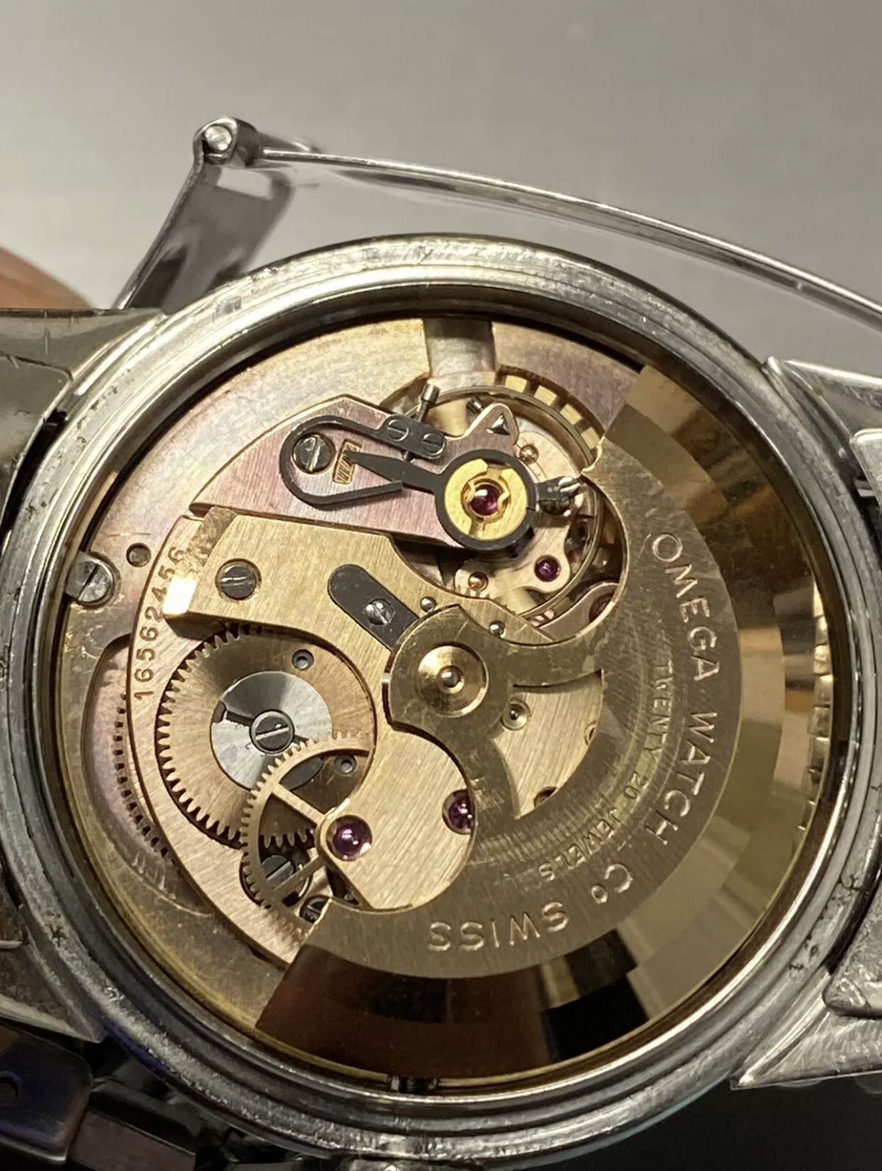

Case looks a little dirty, but fine otherwise. Cal 503 and the serial match the time frame the 2849 was produced. The crown is different to the one that Omega shows in their archive picture, but about every other 2849 I can find has the same one, so that should be fine. Font is hard to judge as it seems to be slightly washed out and the plexi obviously needs some love, but it seems correct to me. What bothers me (next to not knowing the condition of the dial itself due to the bad plexi) is mostly the minute ticks. Shouldn’t they also be gold instead of white print?

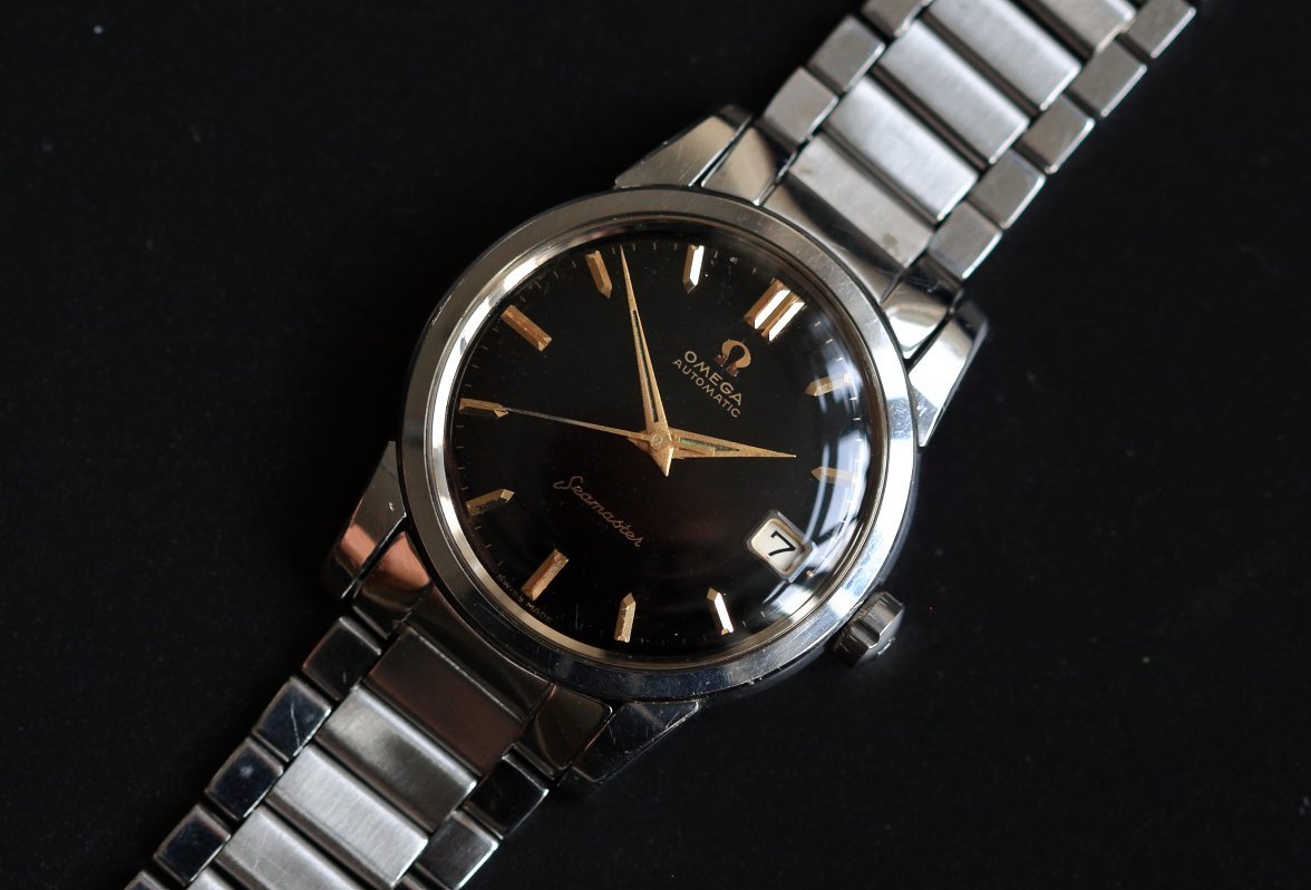

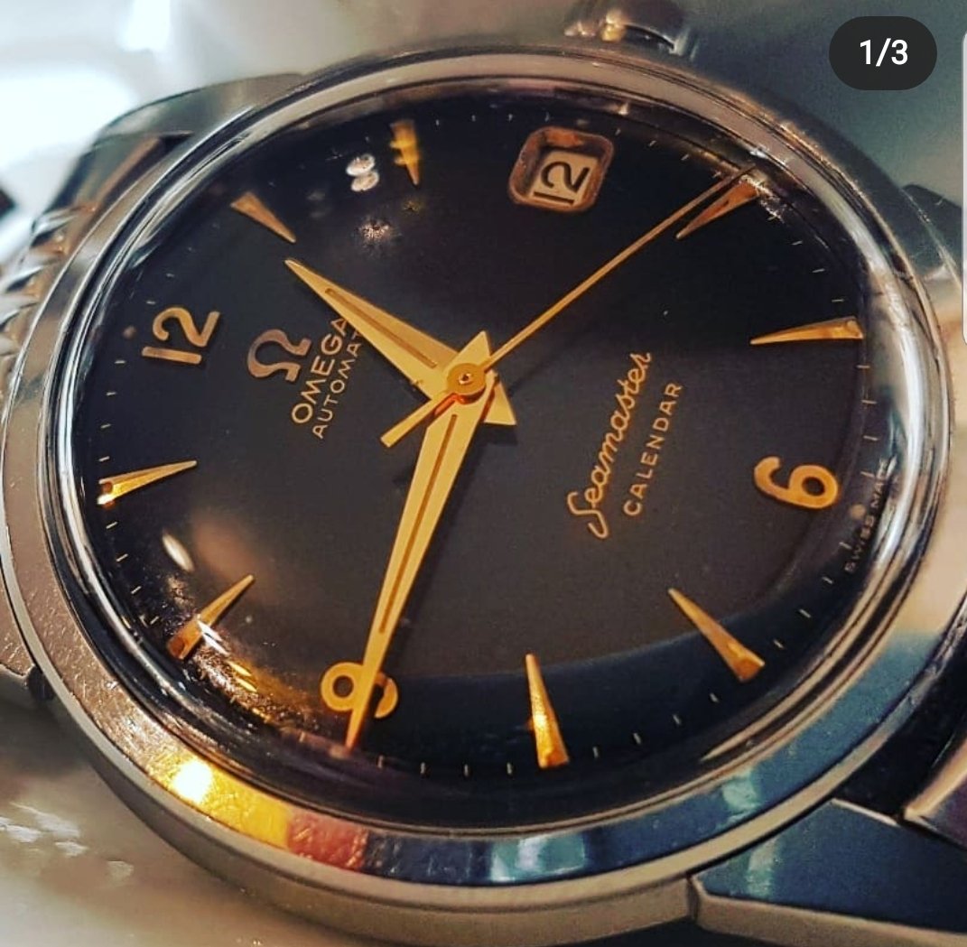

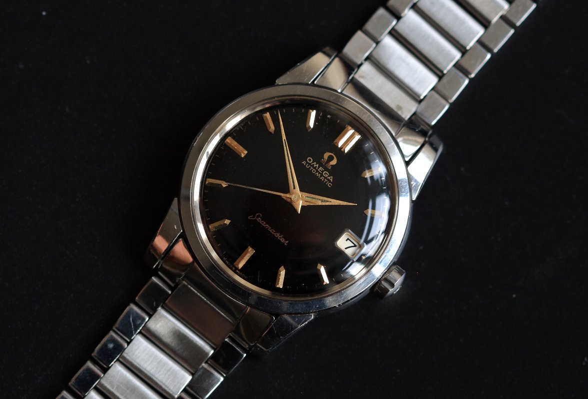

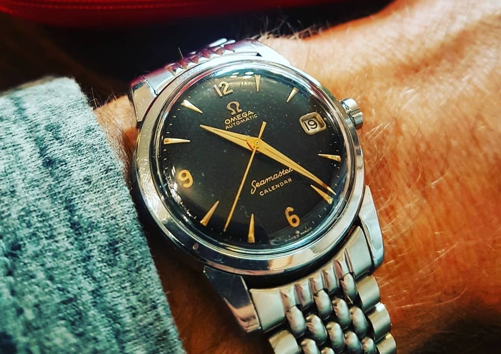

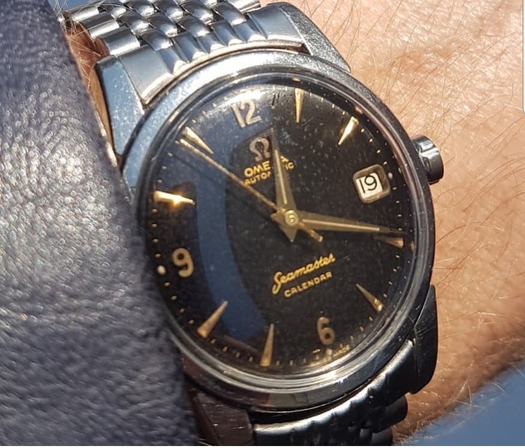

Here’s a picture of an outstanding example by our own @cristos71 (hope it’s ok to use that here):
Taken from here:
https://omegaforums.net/threads/vintage-black-dials-only-lets-see-them.1361/page-49#post-1634839

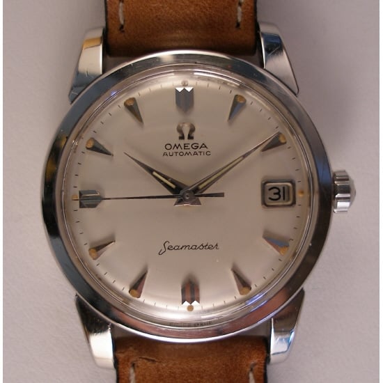

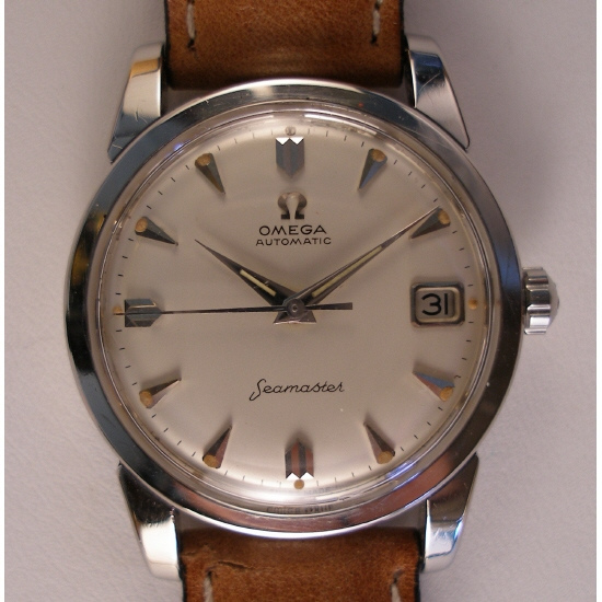

Here’s the picture from the Omega archives:

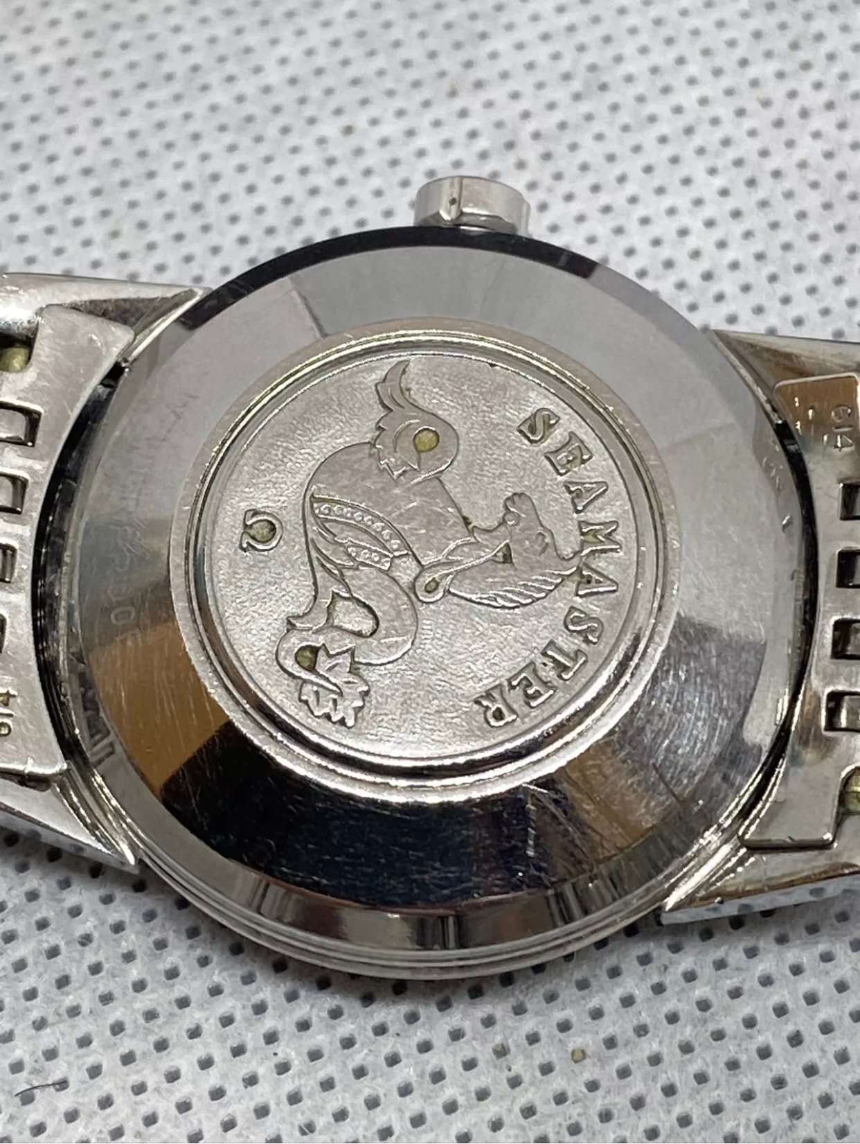

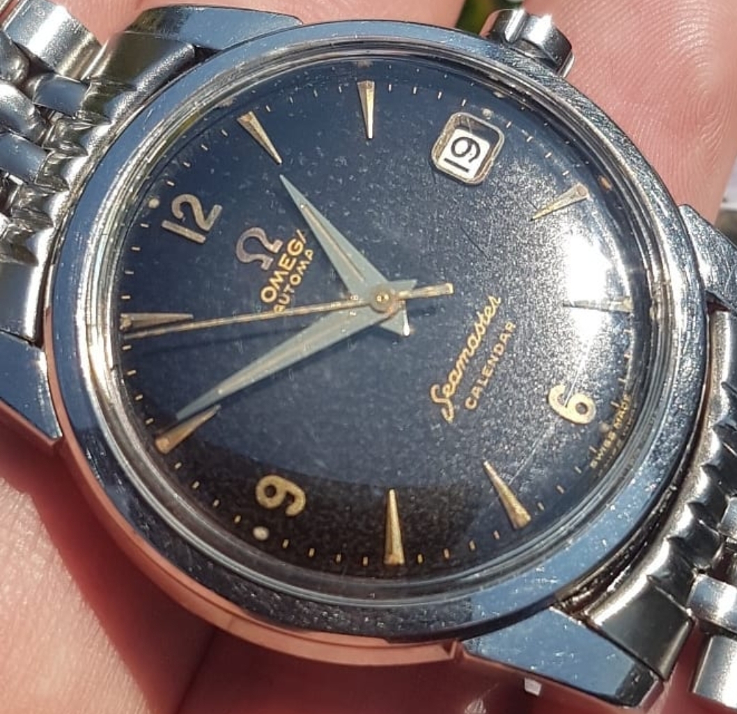

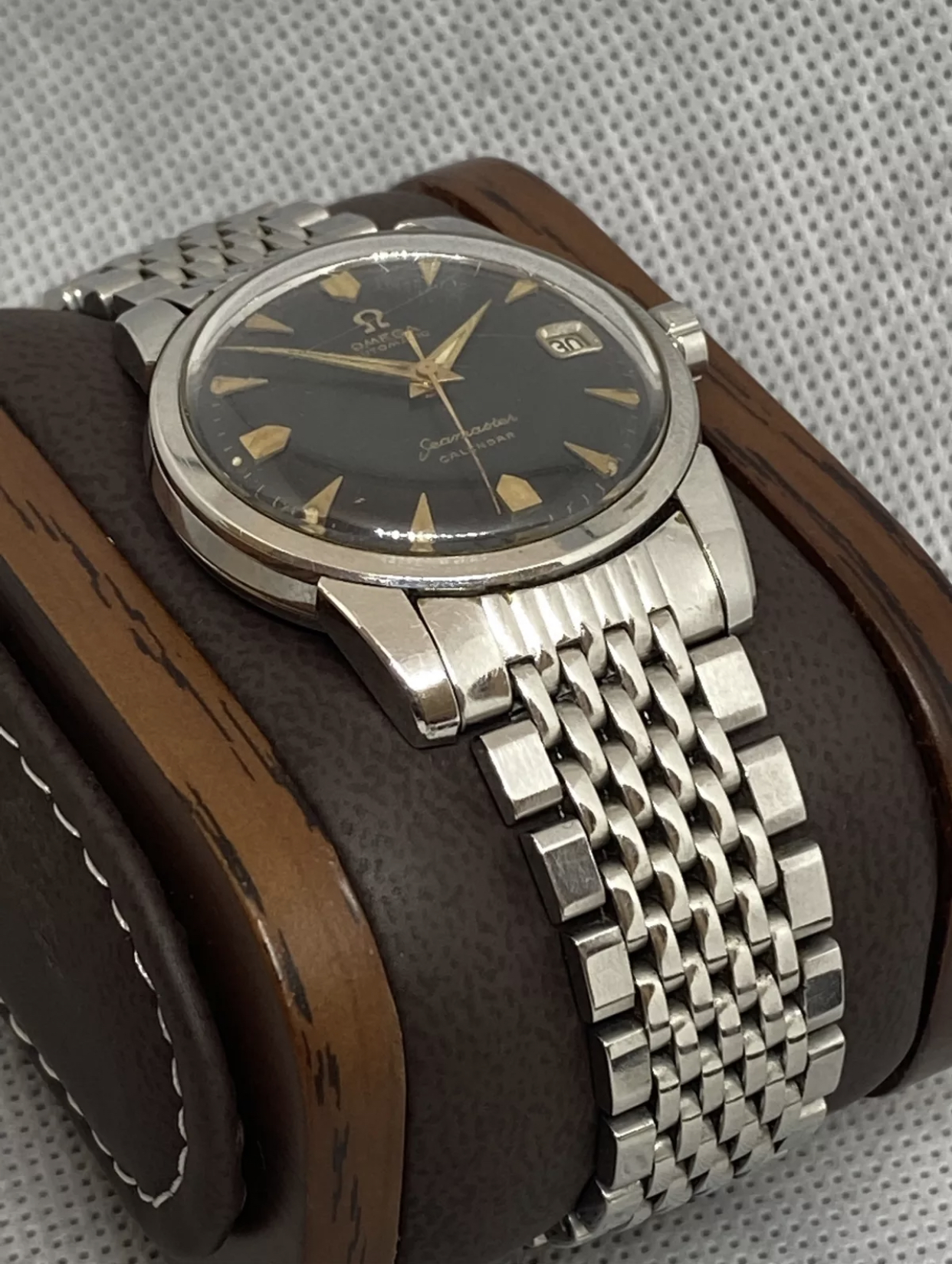

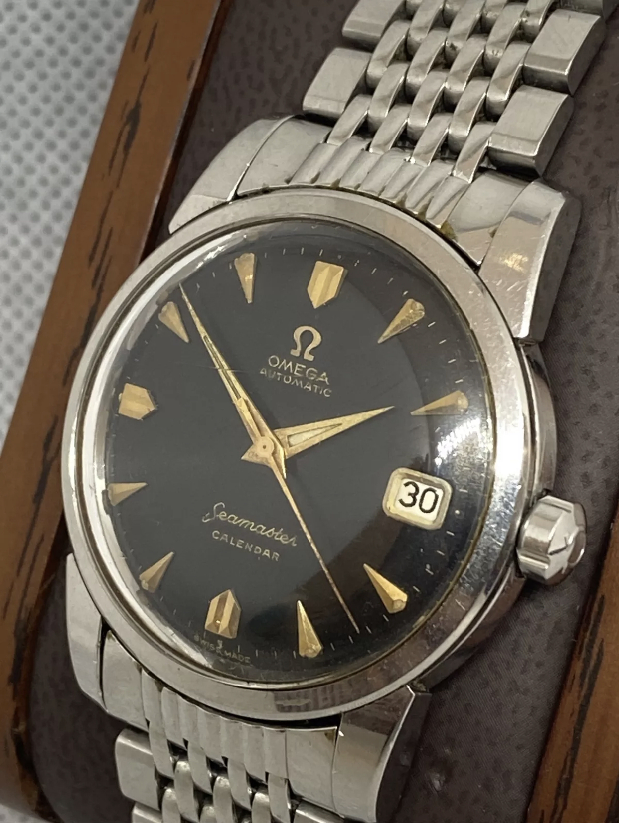

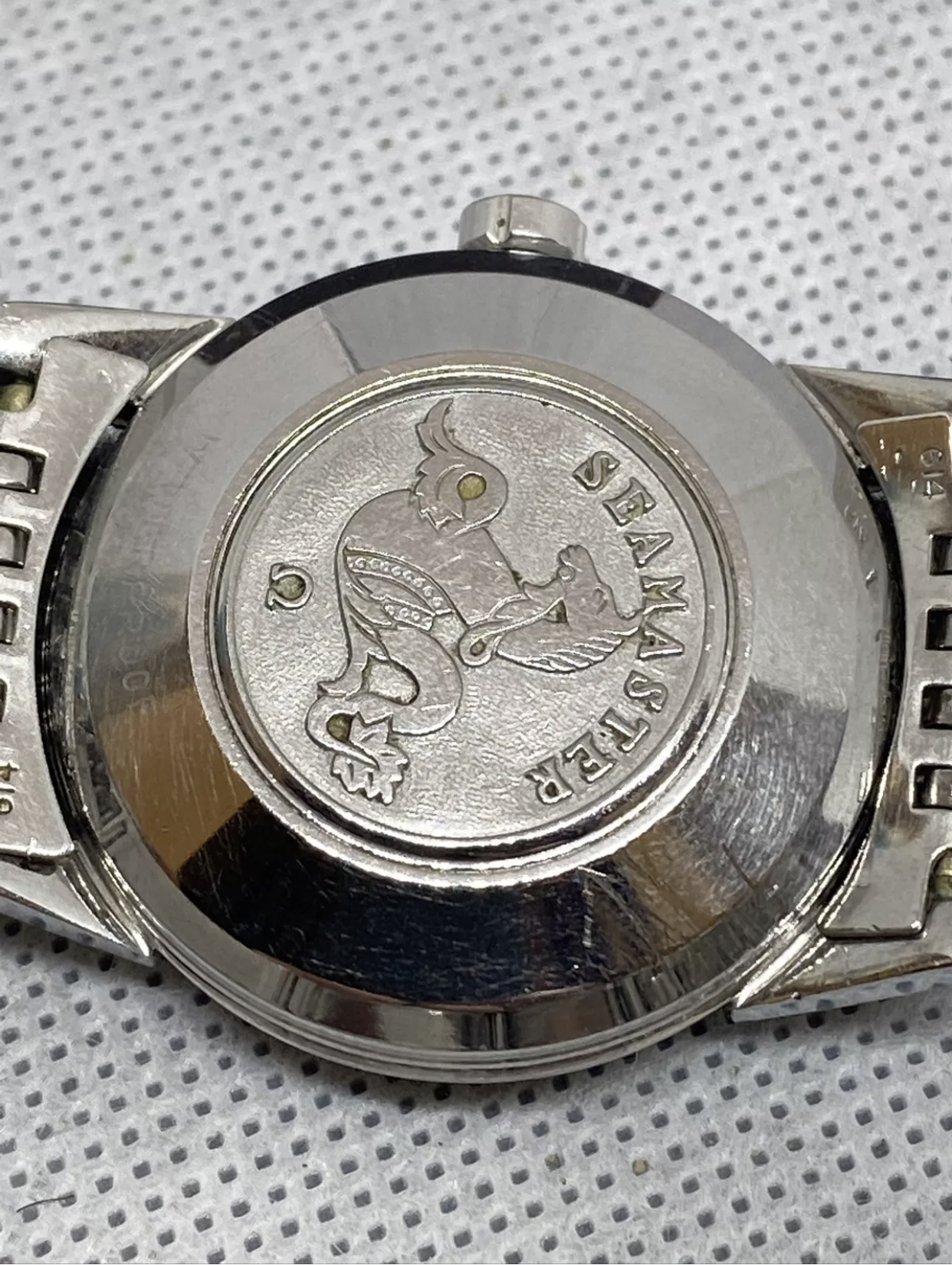

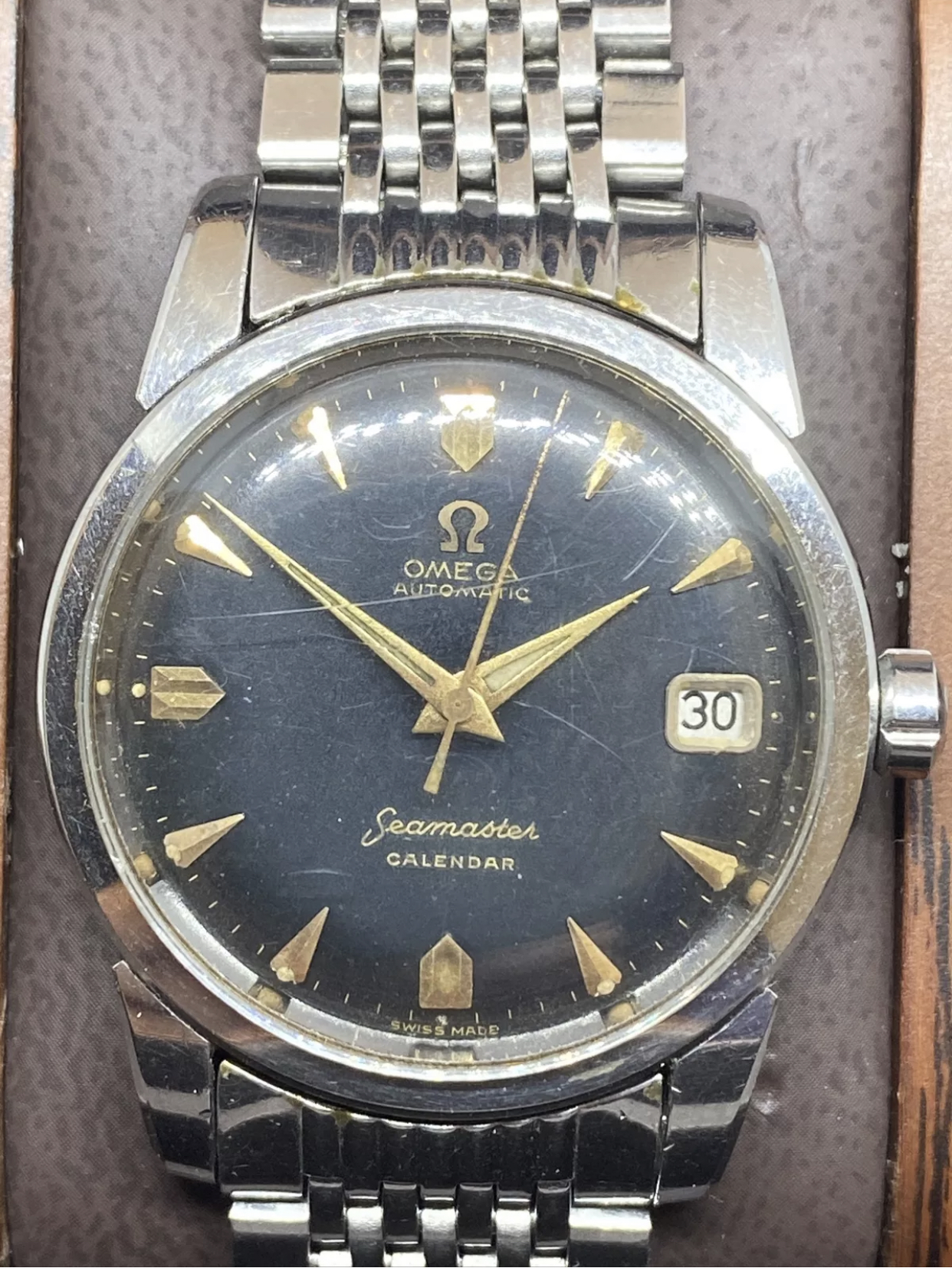

Last but not least, the pictures of the watch in question. There’s no picture available of the inside of the case back, unfortunately, seller hasn’t been the most responsive:
As always, appreciate your help greatly!

Hi, I think, it is a nice, honest example.

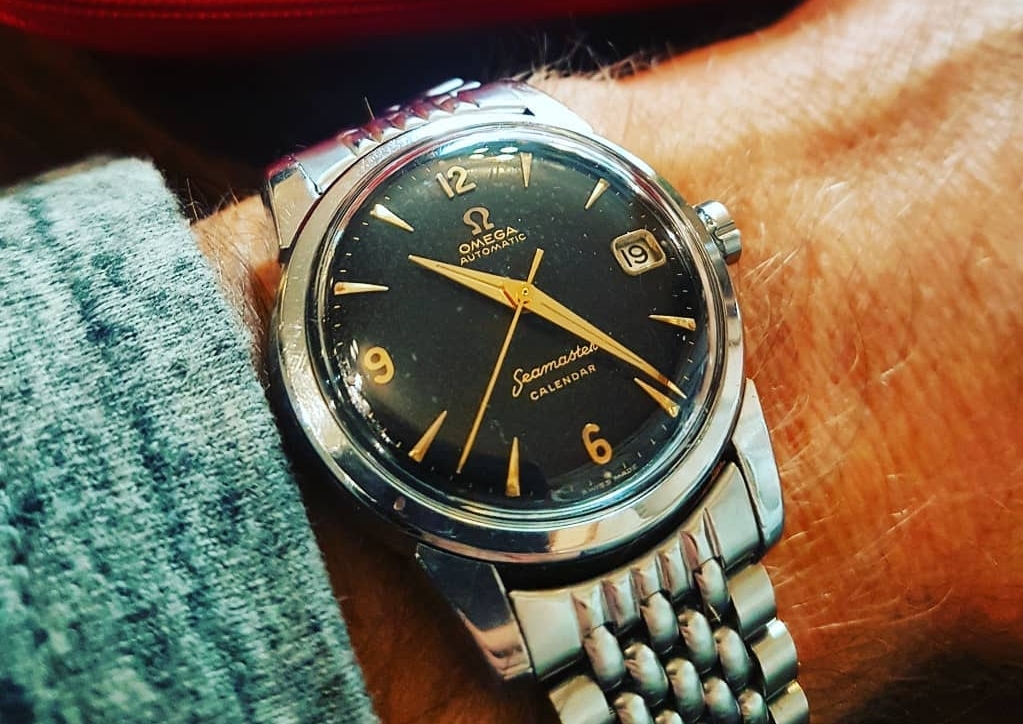

My Ref. 2849 has another dial version, but is in the same serial number.
Think, yours look good.
Think, the white minute ticks should be correct.

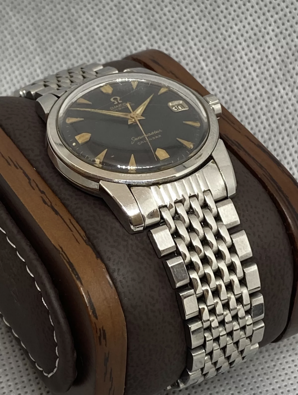

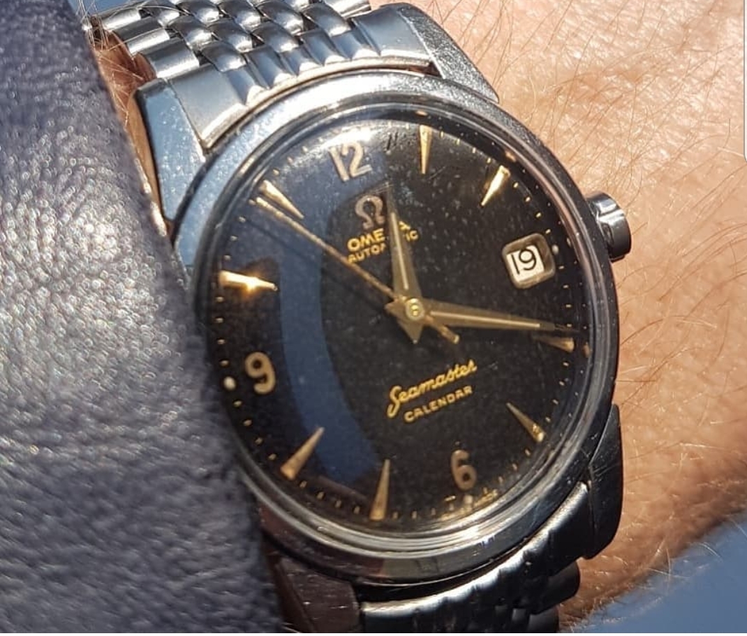

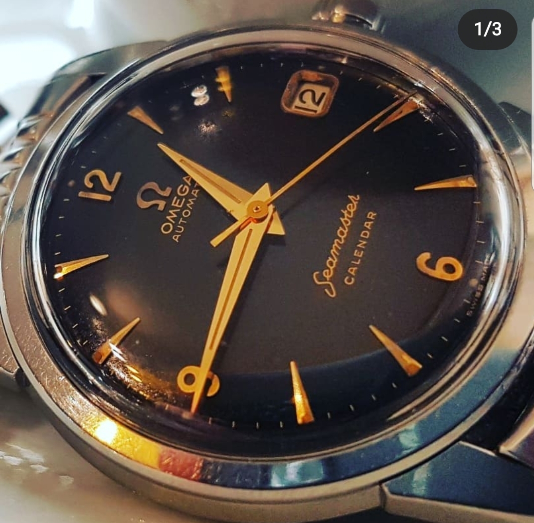

Some pics of my 2849:
Think, you should go for it!
Best,
Peter

I’ll speak only to the dial, which is what you seem most concerned about: Totally legit.

It looks nice and with a plexi polish should clean up well.
My only concern would be the size of audience this watch has, it won’t go cheap!

Agree this will reach a decent price. I'm not even really in the market for one and it's in my watch list.

@KP-99 That’s a beauty - love that dial design, too!
@mrbreen Any other issues you’re noticing? I’m always grateful for the input - two pair of eyes see more than one. BOR has some stretch and I’m expecting the movement to be in need of a service.
@Noddyman Yup, well aware of that. I know it’s not hard to find. I’m still curious to see this being sold on the open market, as on C24 the price would likely be even more absurd.
@Davidt No worries. Again, it’s out there, I’m not expecting to be the only person interested in it. 😀
