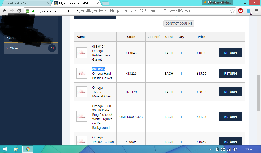

Thank you Rogart,
I am not sure about the glass gasket. Neither Boley nor CousinUK list a glass gasket for Omega case number 196.005.
With the ref. nb. of the glass (TN5179) I found that omega case number 196.016 and 196.019 share the same glass.
In those cases, there are 2 references for the glass gasket: 098EW0032 and 098.0032G. (they look alike but the price is quite different)
Did you order one of those reference nb. ?
Regards
This is a print screen of the parts i order . From Cousinsuk.
That is the hard part to find the right part. Cousinsuk doesn't always list the part when you search on the case number. That is why you should find the right number on Boley and then search with that number on cousinsuk.

Thank you Rogart,
Regards
For case ref. 1960005, the crystal gasket is part 098EW0012.
1,011
419
The same as i bought. Have no idea now how i found that out? I see that boley.de doesn't have that in their databank? Neither does cousinsuk? I think i found it somewhere on the net? It worked nevertheless?

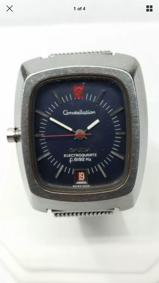

Old thread. But i am thinking of selling this watch. I haven't followed the market very much So i don't now how much they usually sell for. What is the value today. It looks about this today. Not polished but a few marks on top of the case.
162
134
