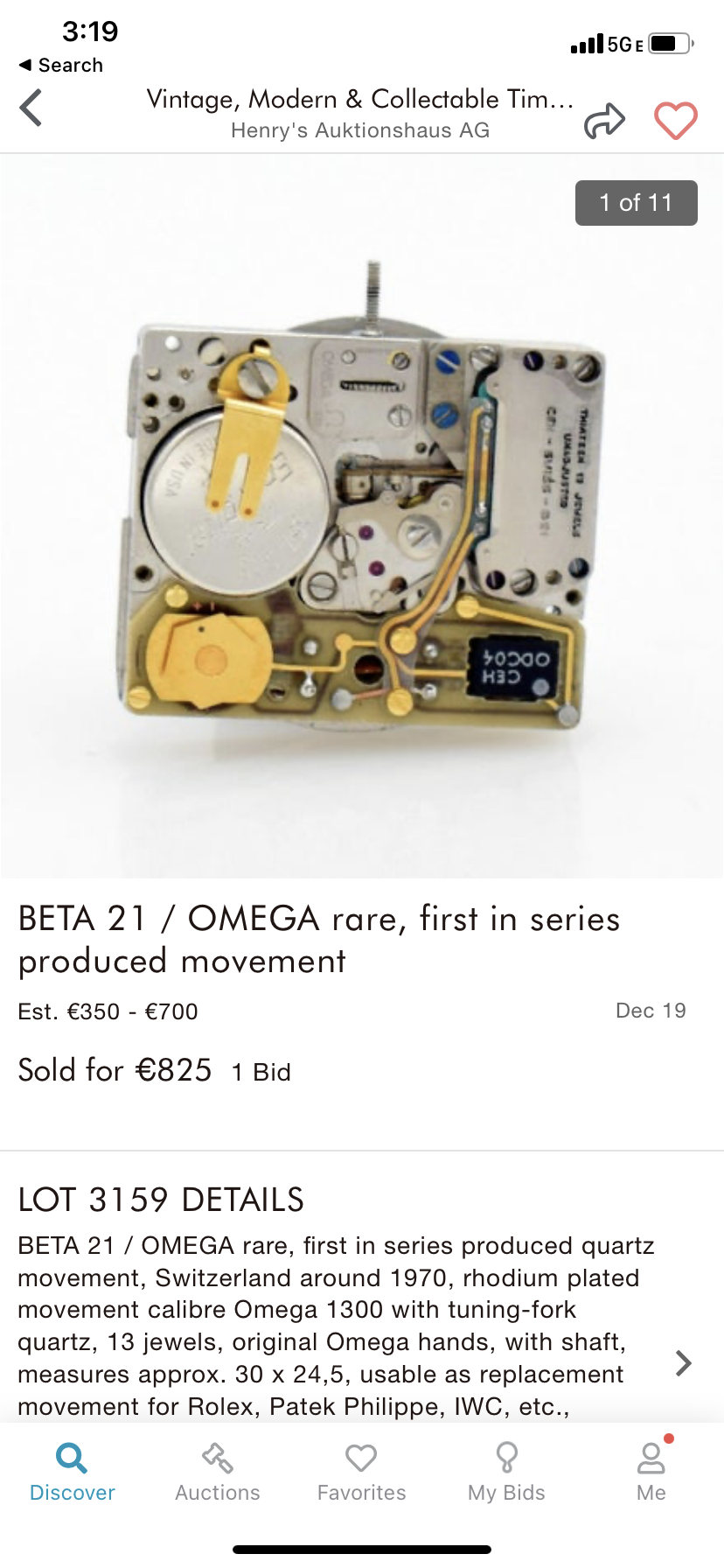

Saw this sell yesterday at auction .....
I think might have a spare movement .....

And only 169€ for the Omega f8192 ! Only the module though, there could be other problems like the pawl/indexing mechanism, I had that on one of mine.

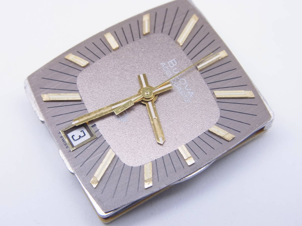

Hi there. I have my watch with a USA watchmaker that knows these watches. It is more of a parts issue with beta 21s. I am reviving a bulova accuquartz beta 21 movement and recasing it, so it isn't a project that all watchmakers would entertain.

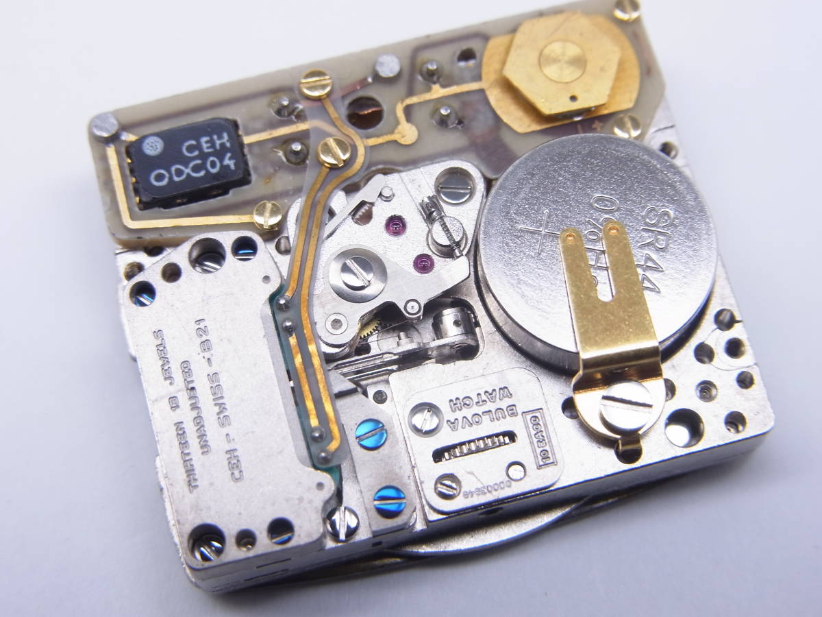

A Bulova B21, wow ! There weren't too many of these, actually I can only remember seeing the 18k "monster", is that the one ? Pics would be great in any case ;-)

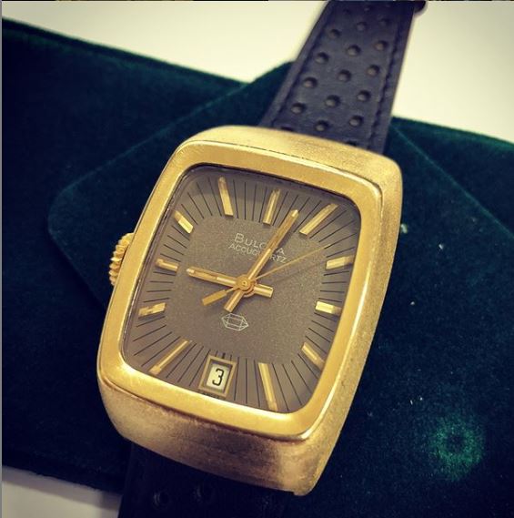

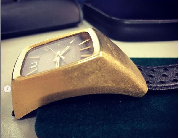

I am using an omega beta 21 case as the donor for this accuquartz movement. It's wedge shape is close to the accuquartz minus a whopping hunk of gold that the original had. These accuquartz had so much gold that they were irresistible to melters.
And the original for those who haven't seen it before (not my watch):
642
338
Ah yes that's the one, I wonder if any have survived...in 10+ years I've only see one pop up on eBay.
