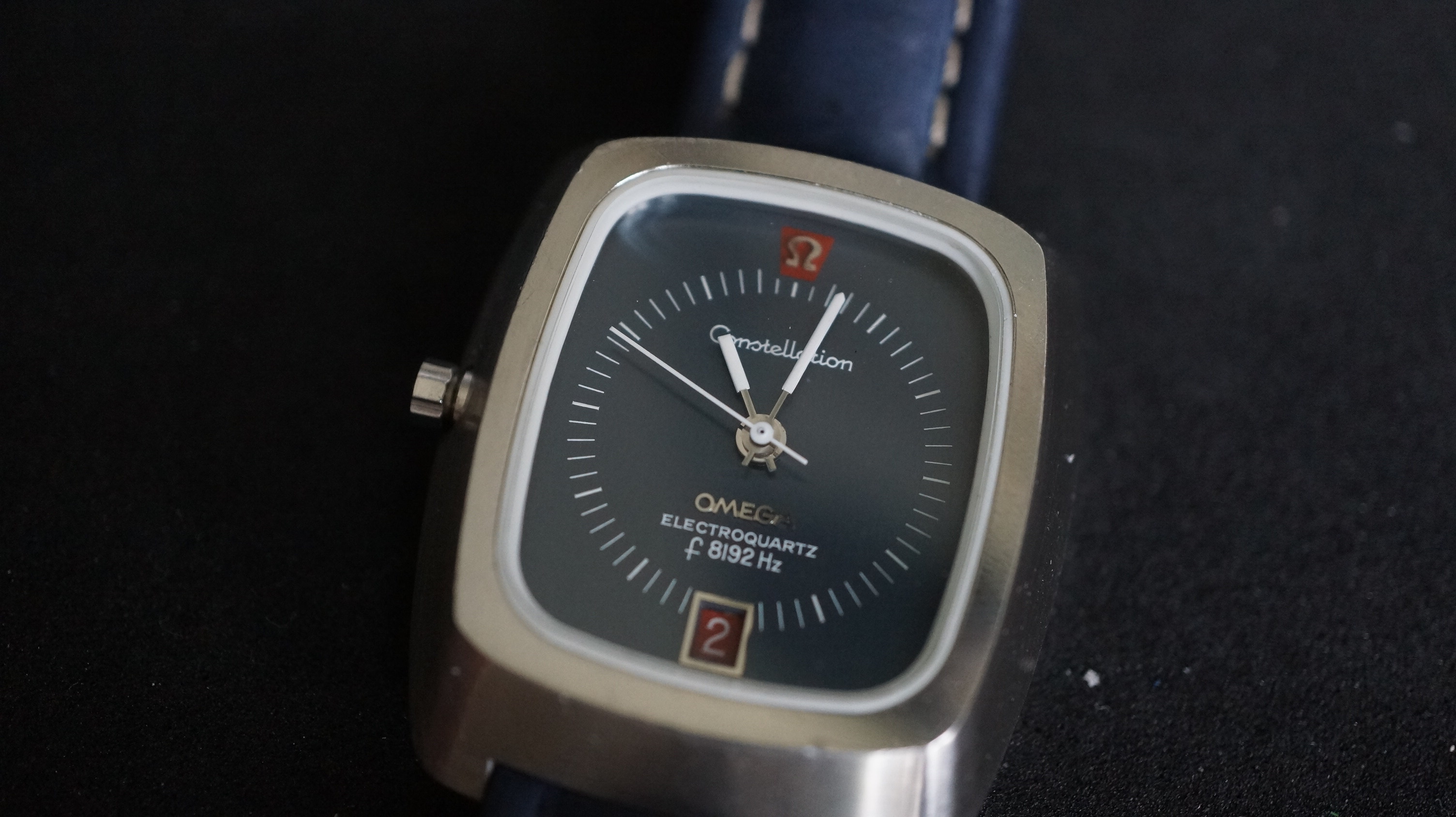

That looking good . But i think i will wait with buying a Electroquartz . Sometimes the fun is to repair the old watches?

There are lots of nice watches out there. Have some of my own that need to be looked after. Need to see if i can change the o-rings in my Speedy lcd? .

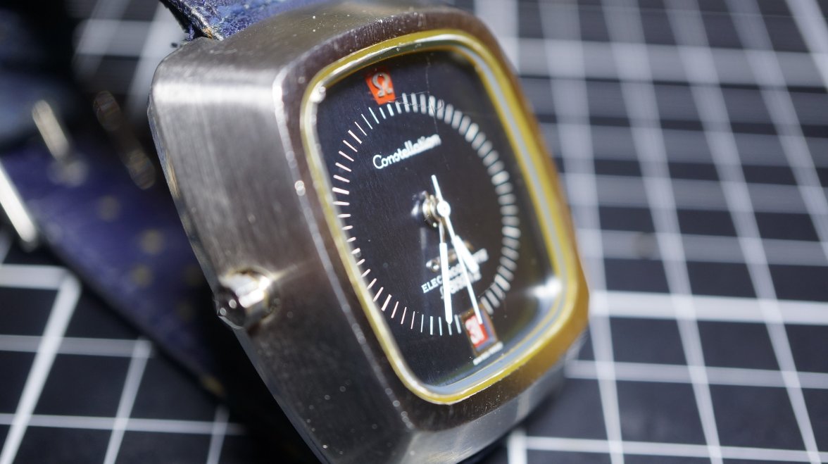

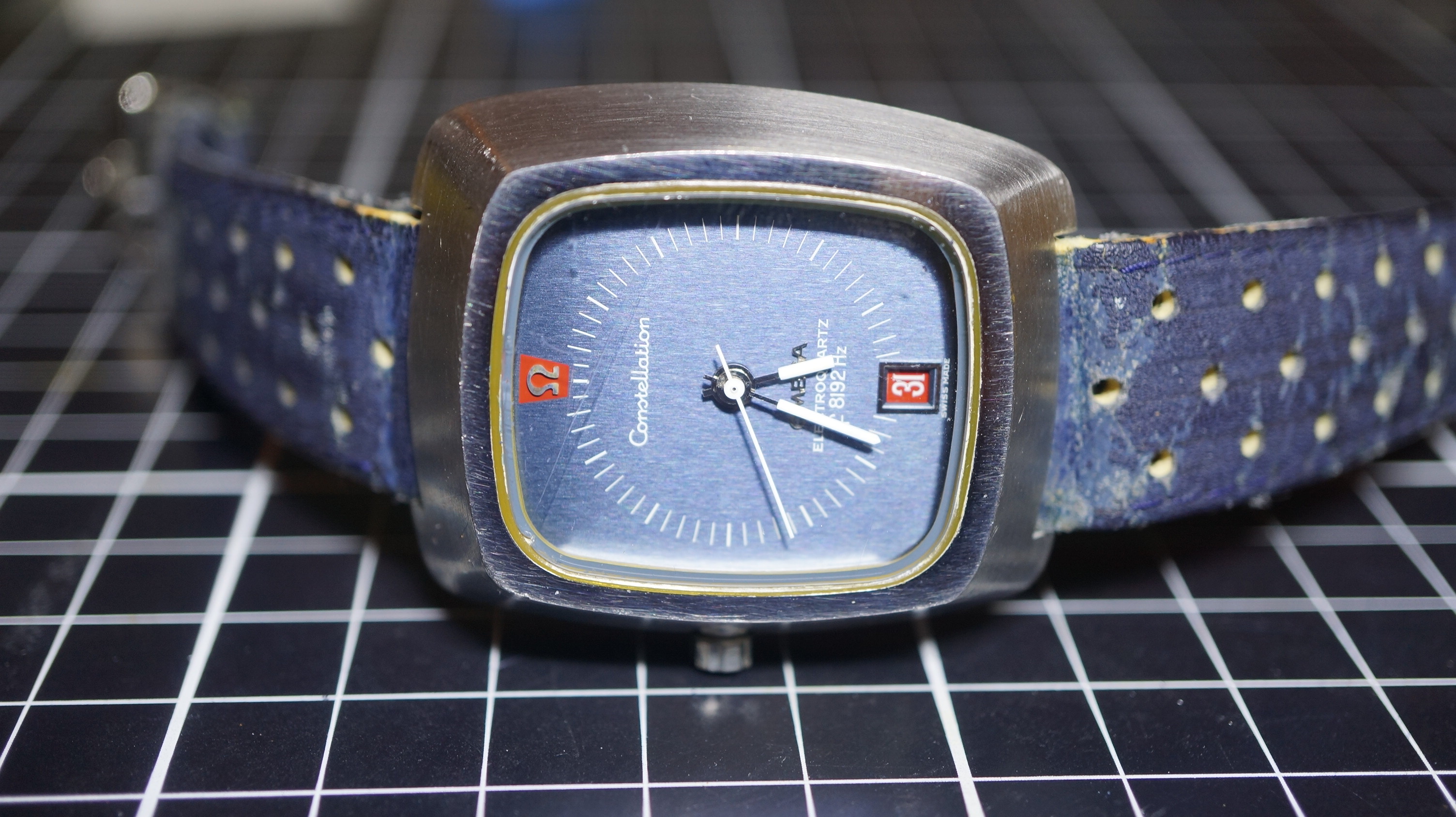

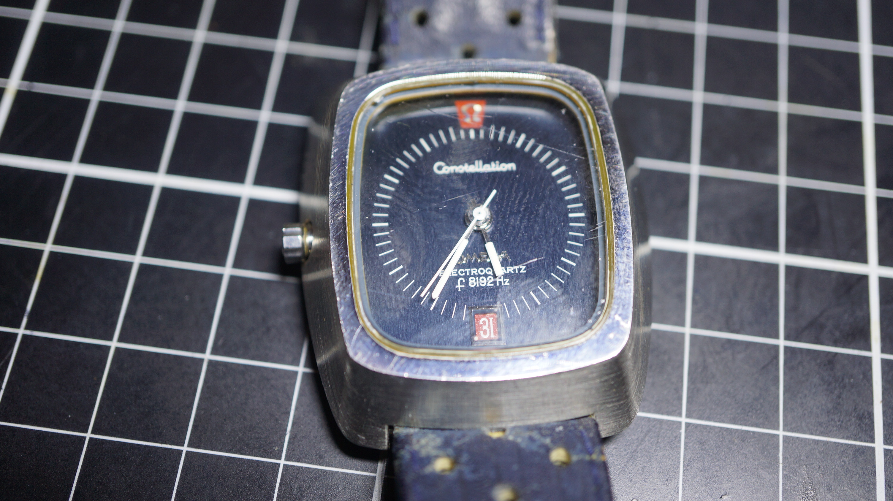

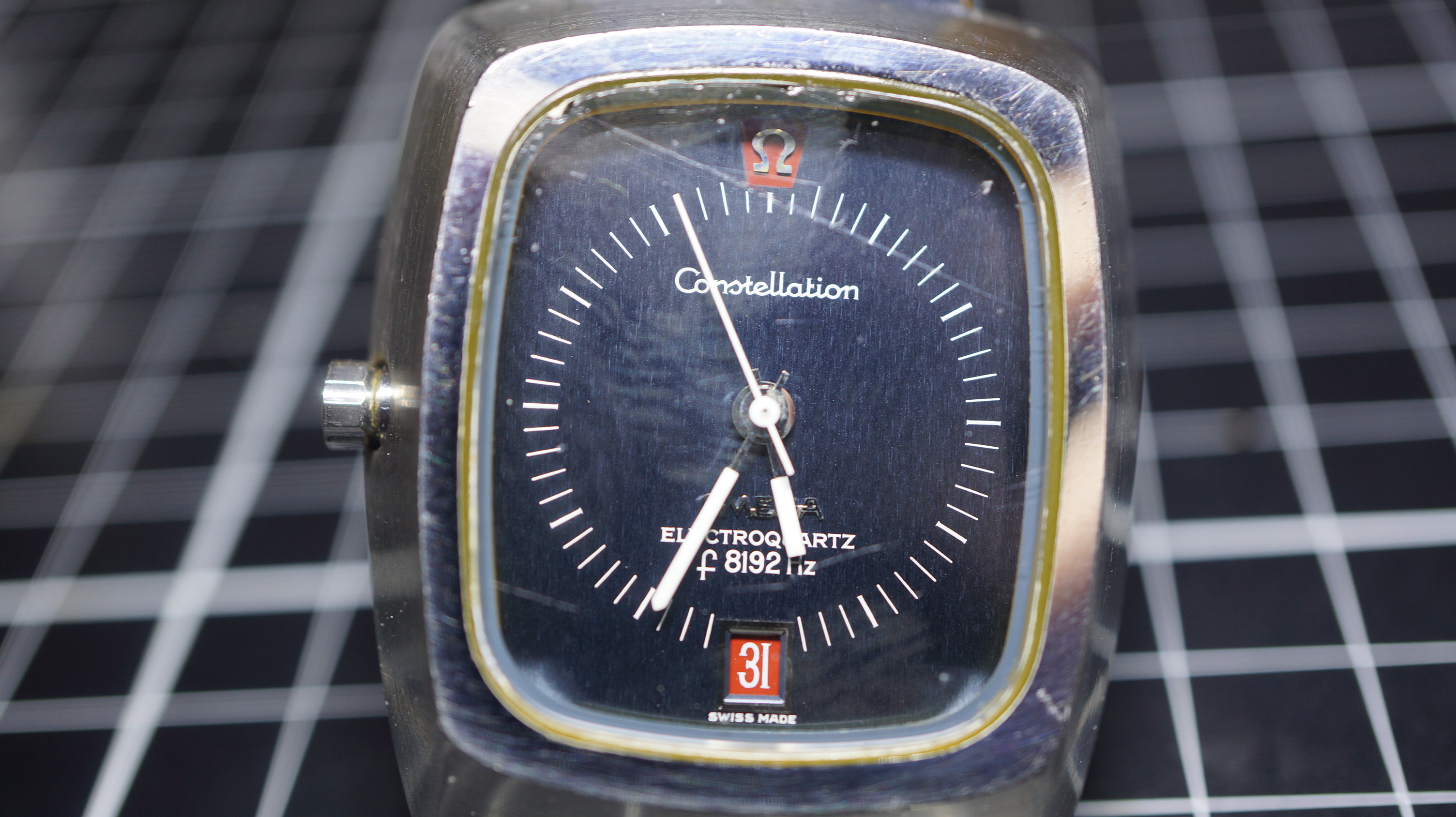

I couldn't but buy it when i got it for a good price? 😀. So some pictures of it will come soon . The case is in very good condition .The watch is running and the dial and hands are very nice.
1,011
419

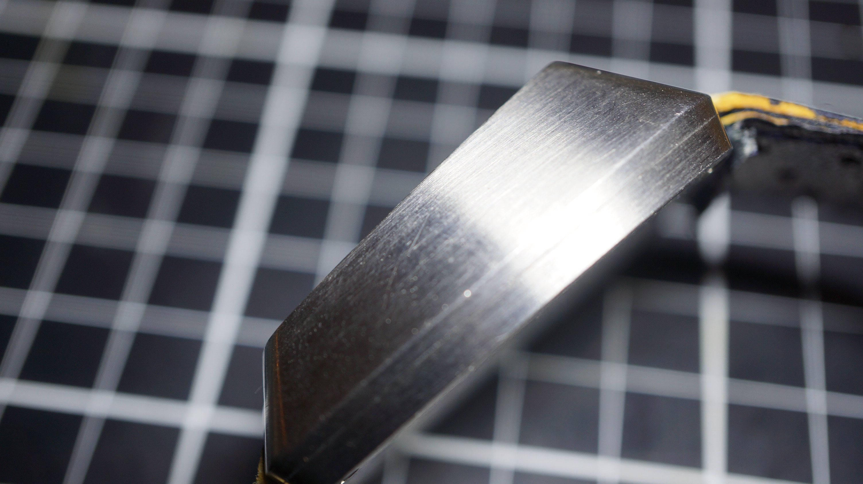

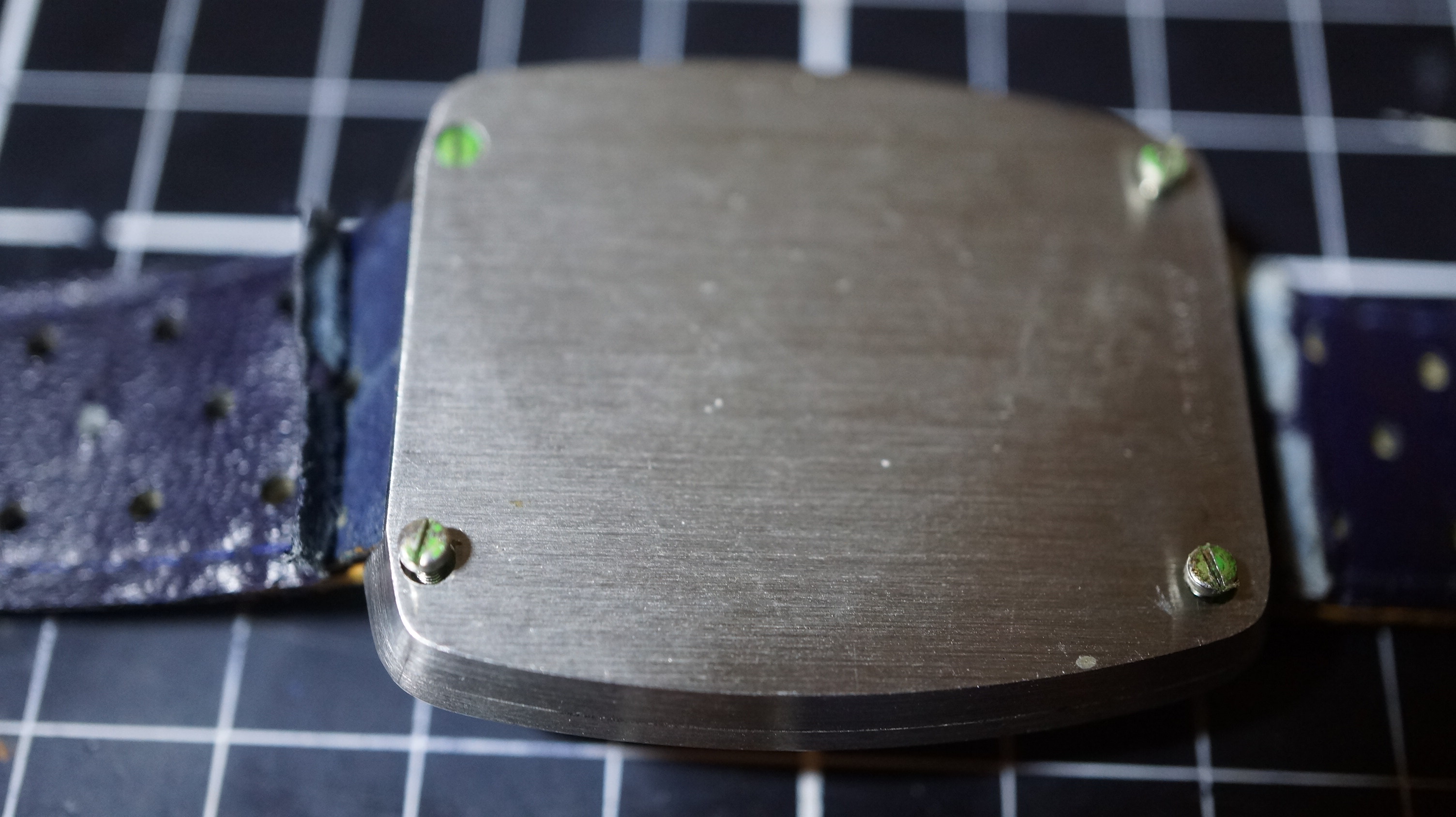

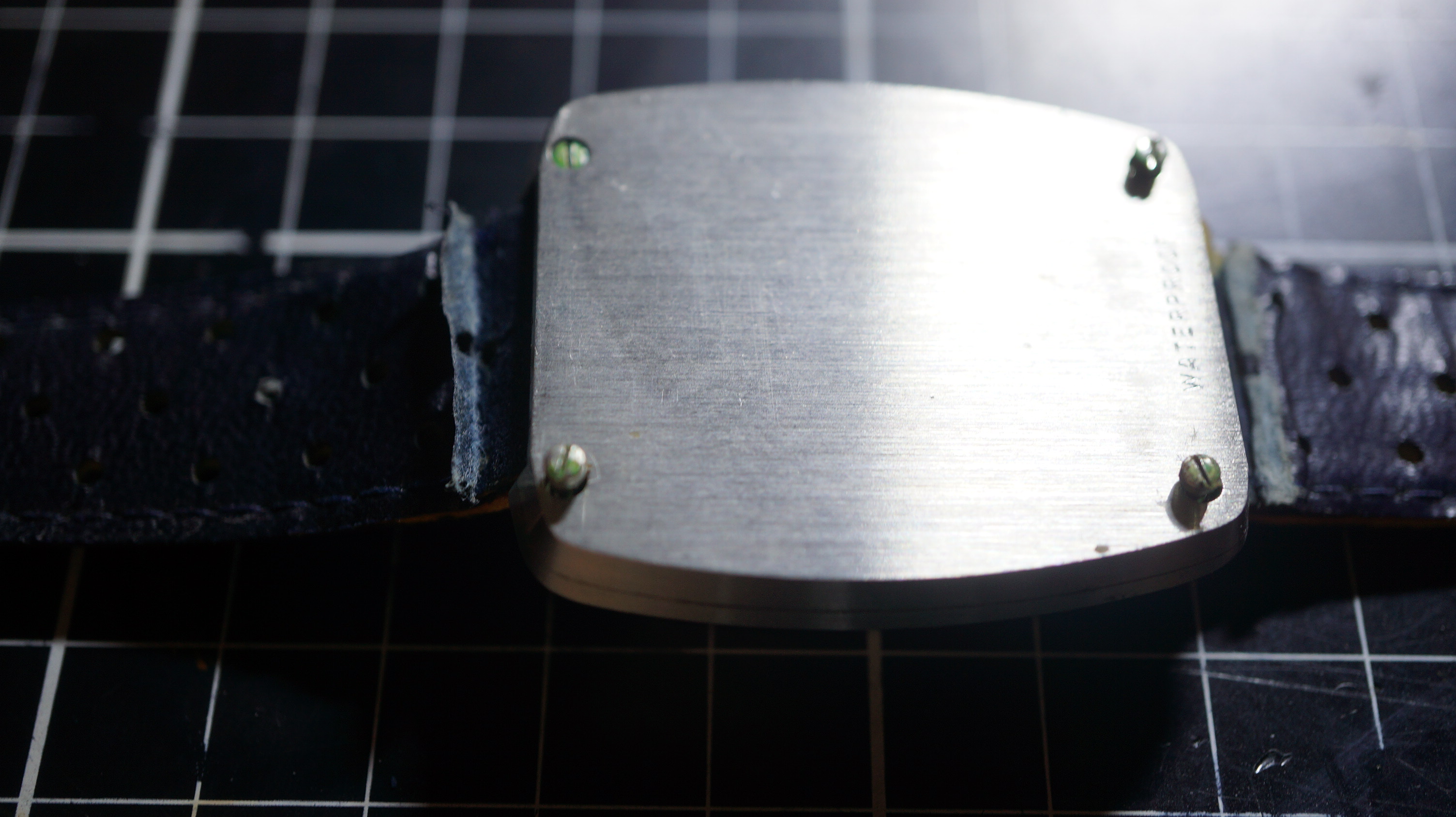

Some pictures of the watch . It's looking good . Sorry for the thumbprint on the crystal . There is some green stuff on the screws? Not sure what that is? And as usual the gasket was gooey like rubbergum .

Rare and under appreciated watches, calibre 1300 and the first swiss quartz production watch, the same movement used in the original IWC Da vinici, the first Rolex Oysterquartz, Patek Quartz, Rado Quartz, the first Jaeger master quartz etc etc.
Useful article here:
https://en.wikipedia.org/wiki/Omega_Electroquartz
The original screw all go that green over age, its a tell tale sign of an unmolested watch. Colin is right, no where near the value of a stardust but a good NOS example is £1000 - £1500 now, a good non serviced/ non NOS example up to £1000. Plenty of people such as keithT on TZ who can service them inexpensively so long as they are working
If it is running fast it is simply double stepping, it just needs a service, I have spare circuits for these if thats the issue so snag it if you can.
Hope this helps
Cheers Tom
Hope this helps
Cheers Tom

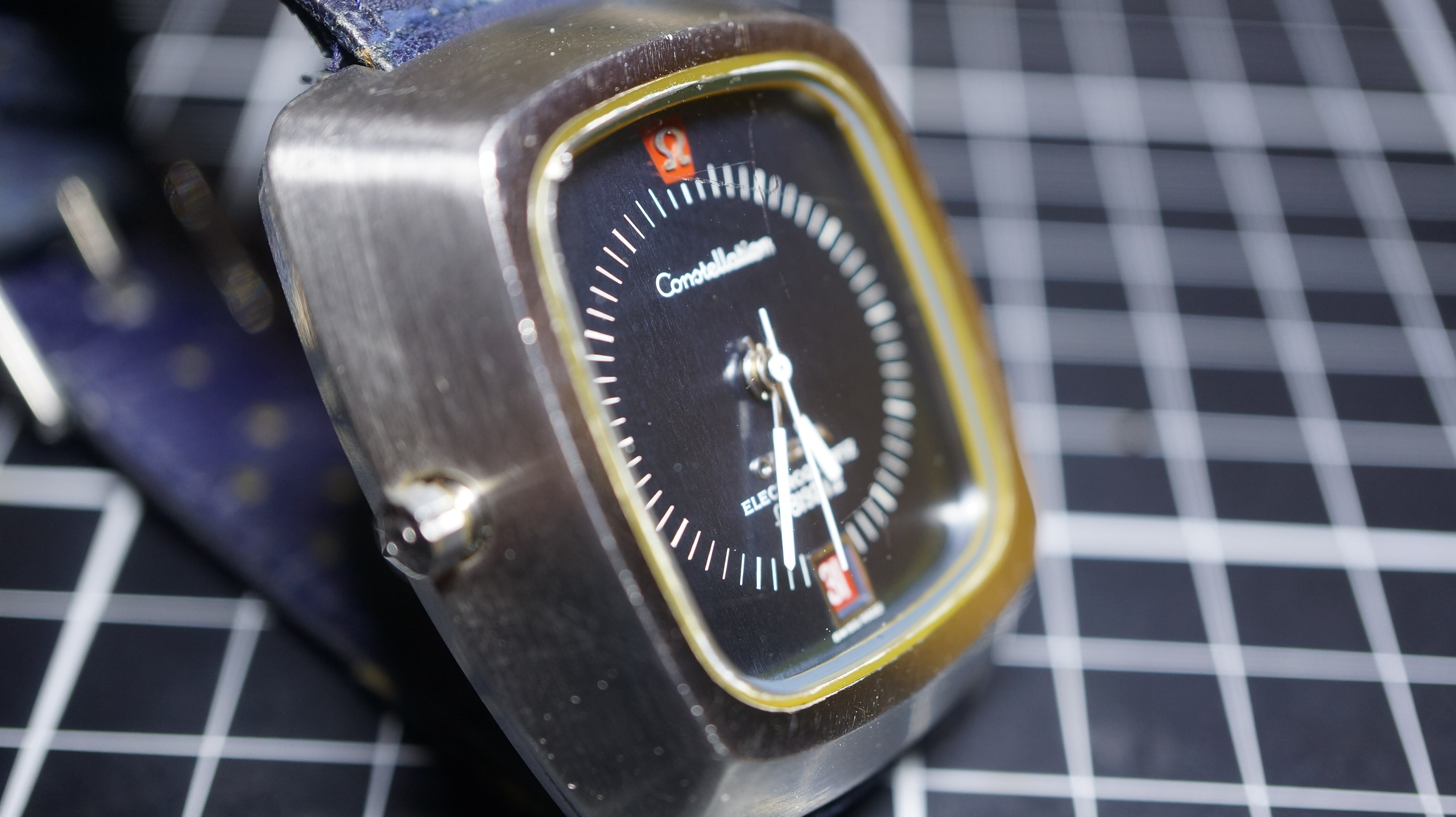

This is how the watch turned out after a new date disc and new crystal and gasket . Became a really nice watch. The date disc didn't need to be changed but when i was in there i did it anyway. I cleaned up all the parts that drives the date. In the near future i will send it for a service.

Well done !

Beautiful watch, rogart. I'd like one of those someday.
