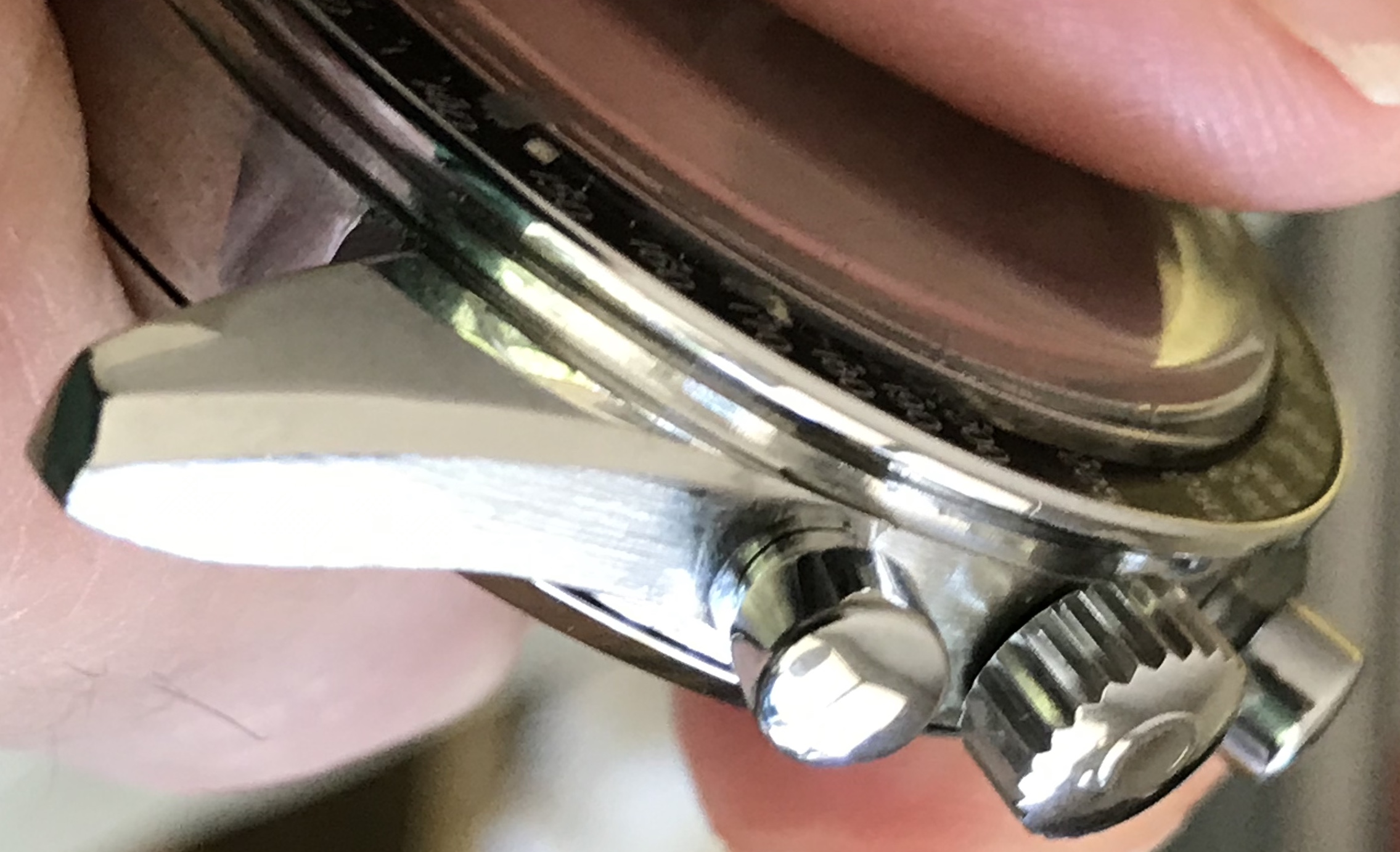

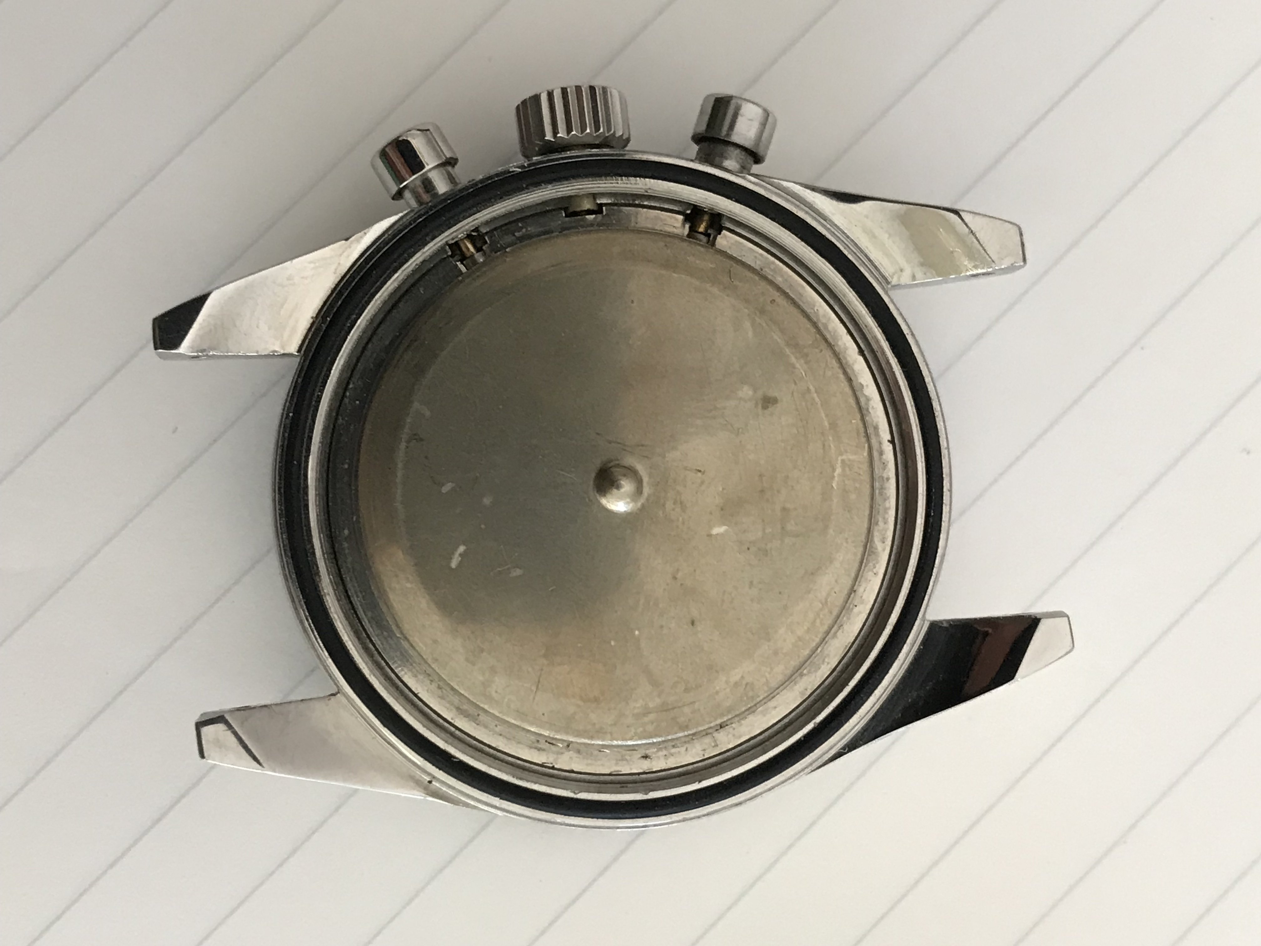

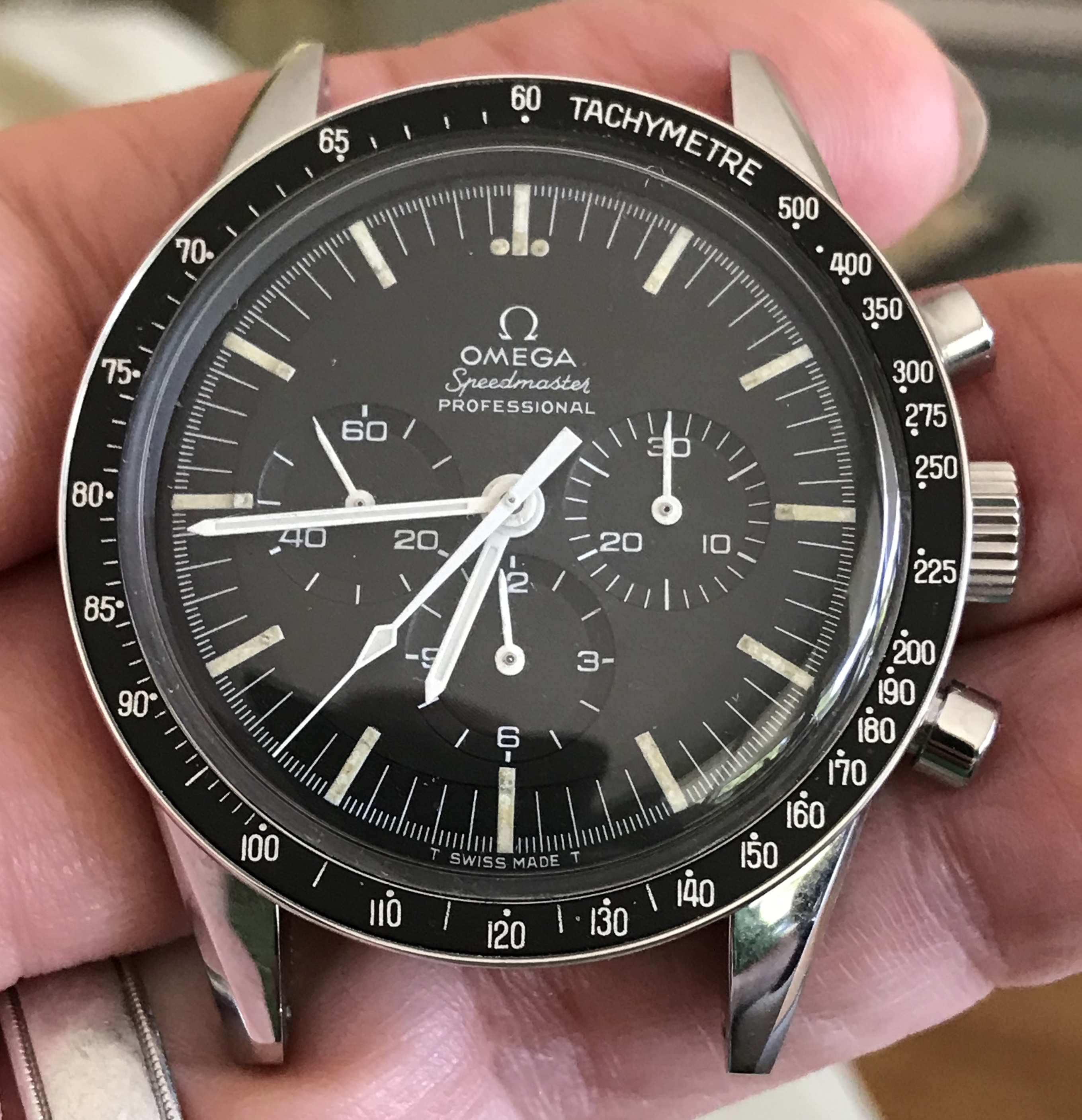

This Ed White put everyone off, I assume, because the dial, hands, crown and bezel are clearly wrong. But, look at the case! 😲
It’s a really nice B2 bezel, which suggests a service before the early 90’s. Note that the dial has long hour markers, which makes it unusual and interesting, even tho it doesn’t belong on the watch. The hands are luminova but the dial is tritium.

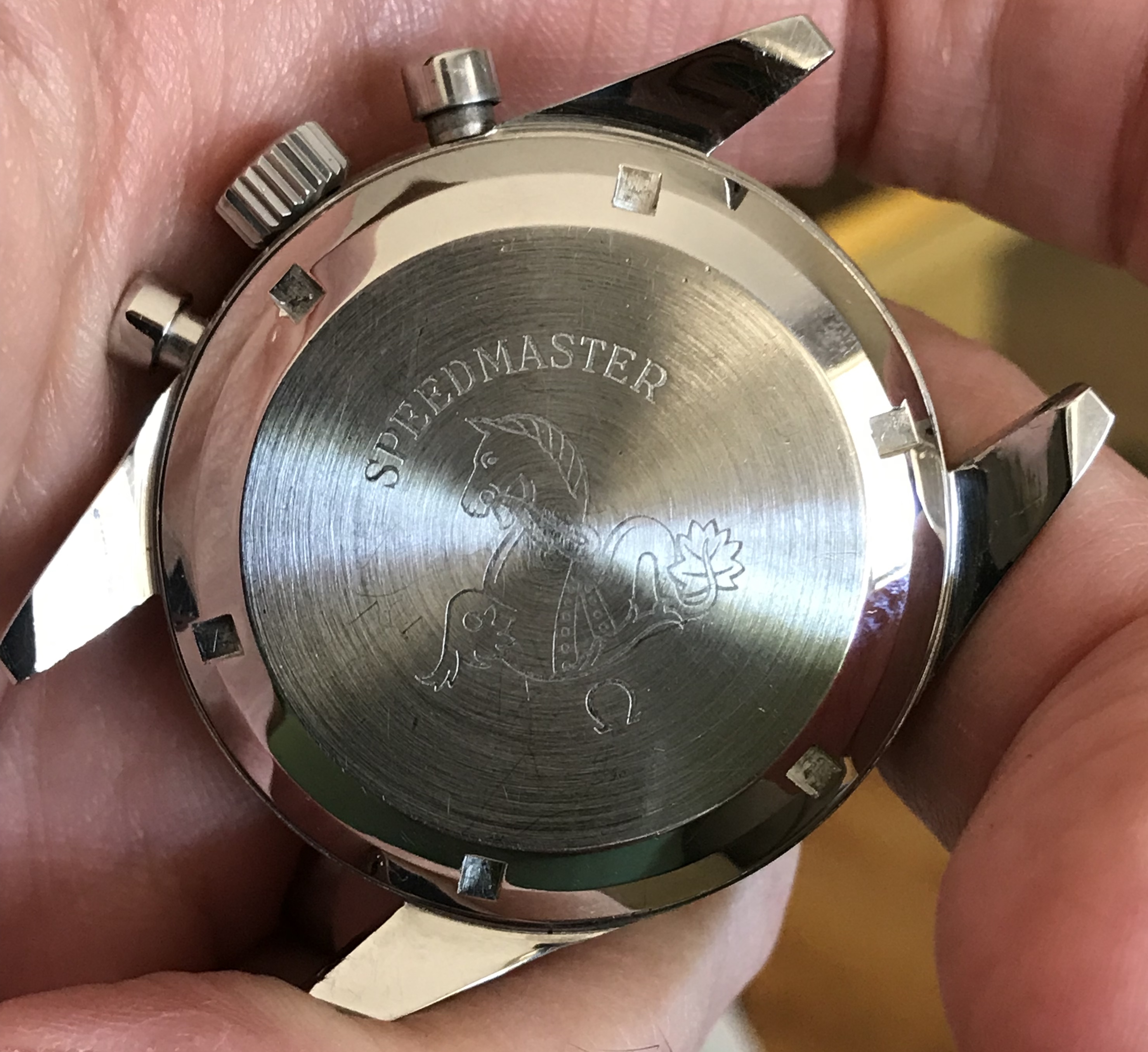

Those pushers are correct, even tho other stuff has been replaced. Note how free of damage the pushers are. It is interesting that the inner cover is a little mottled and not as nice as the rest of the watch.

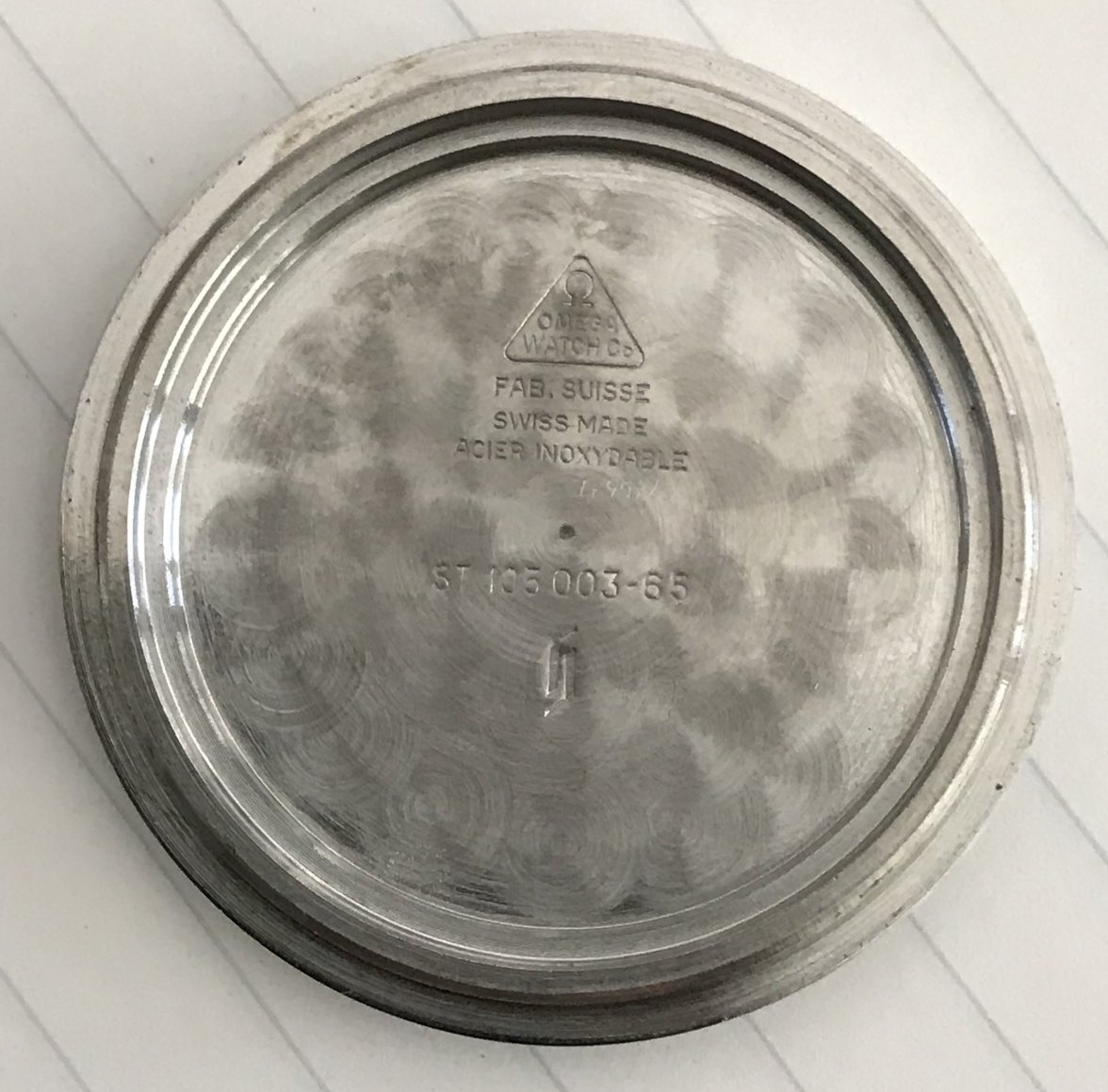

Almost no marks on the backs of the lugs. Yes, I saw the loose screw after I looked at this picture and replaced it. The serial number is in the correct range, with production estimated in April ‘66.

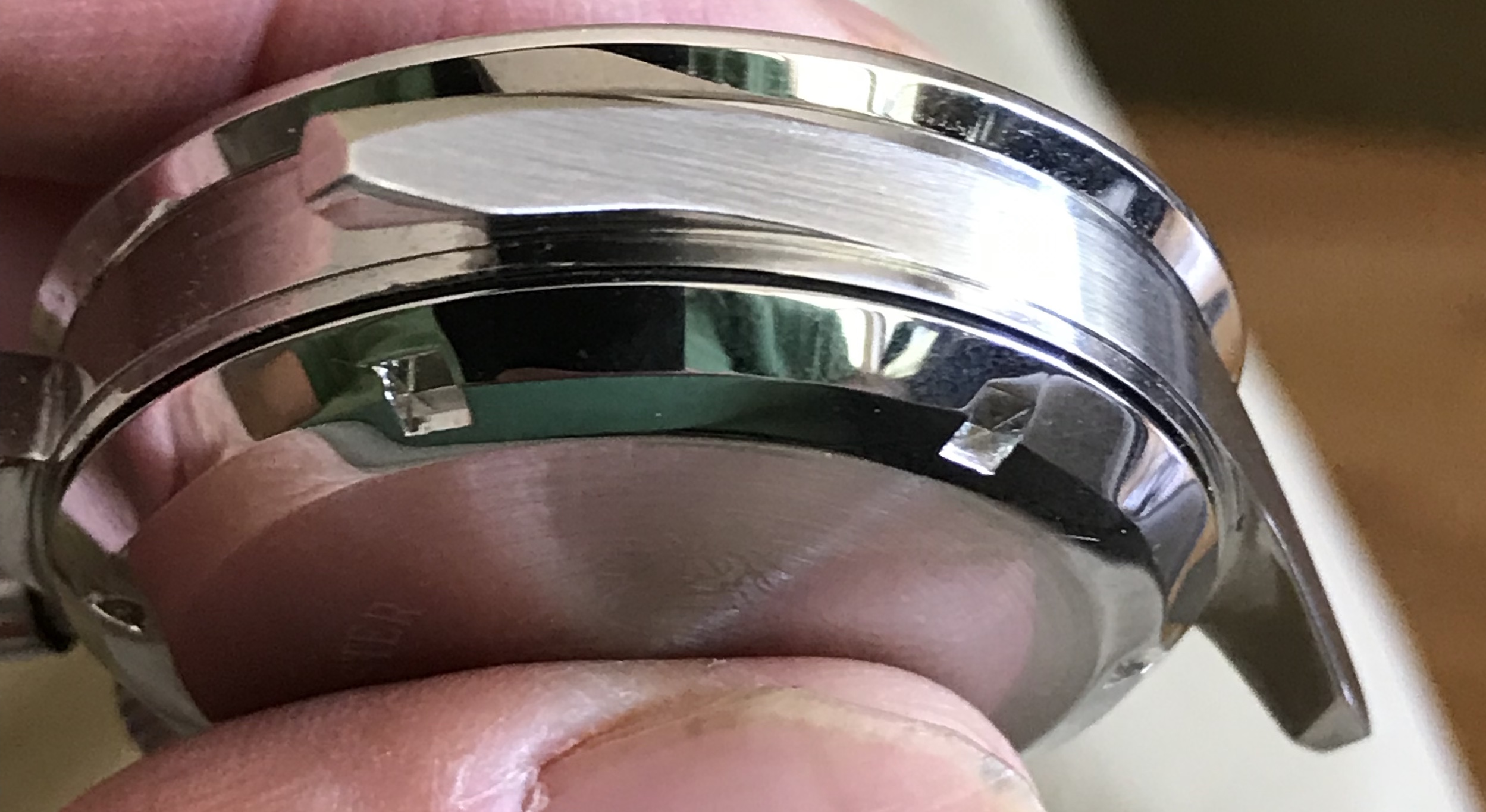

Comparing pushers from another Ed.

Serial sounds valid, mine is 22825xxx with production date on extract of 6/4/66 so I would put and example 4K serials later at May or maybe June '66. Just my 2p worth.

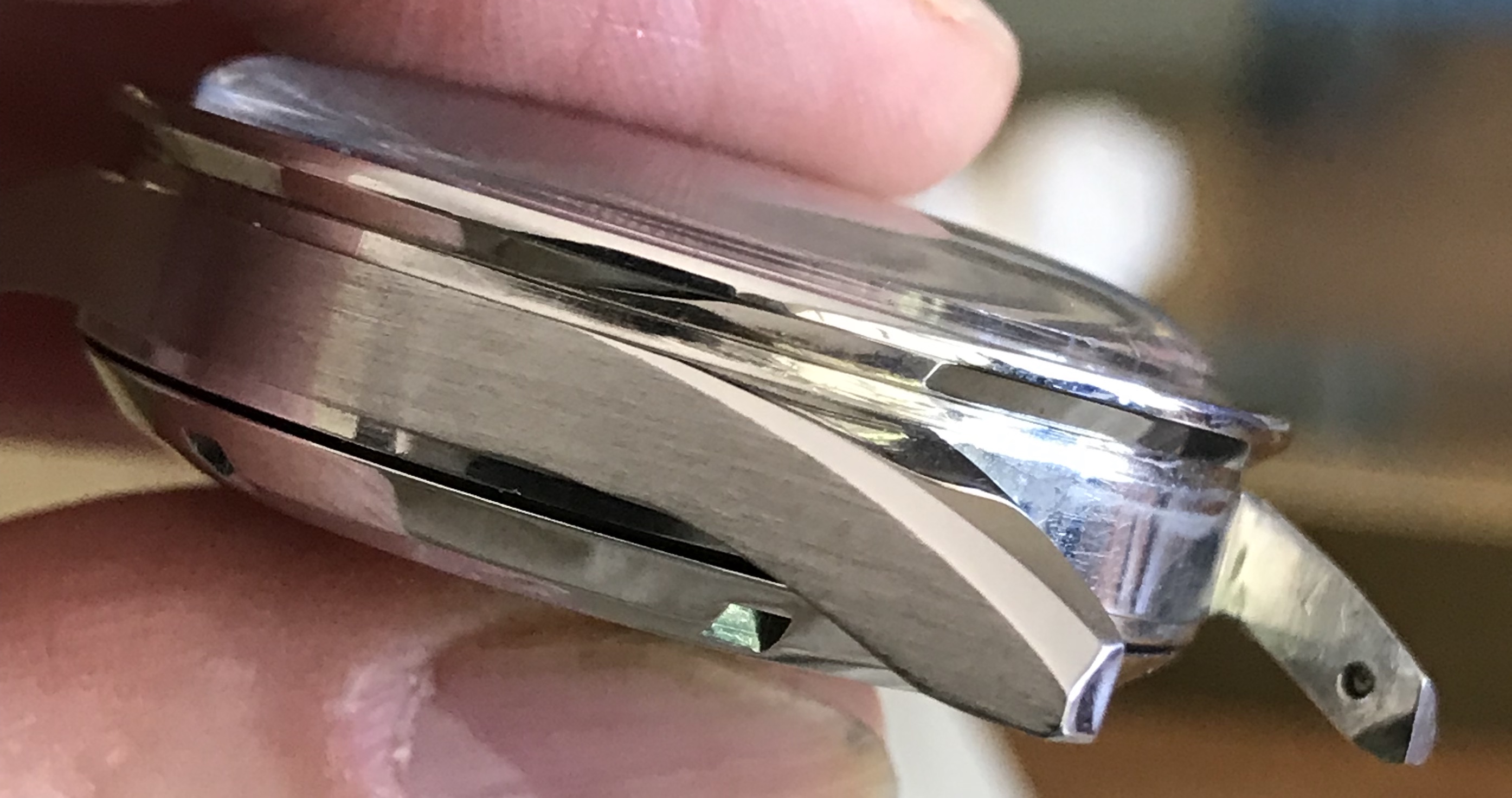

Its a nice catch but at the risk of sounding a little like a party pooper, I dont like the bevel on those lugs, it may be right for one straight lug iteration, but not for a -65 EW in my experience. It looks more like the FOIS interpretation so may be a heavy refinish or indeed a replaced mid case. I have never seen a -65 with bevels that extreme.

@padders : Is it possible it’s a service case from the 70’s to 80’s?
Hmm. I hadn't considered that. Could be but I think the caseback is the original deal. perhaps a replaced mid case only. Do bear in mind it may actually be a modern FOIS replacement case, the bevels are awfully similar.

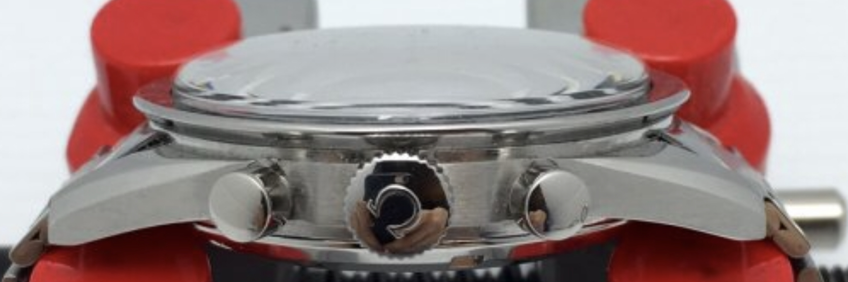

1,846
3,845

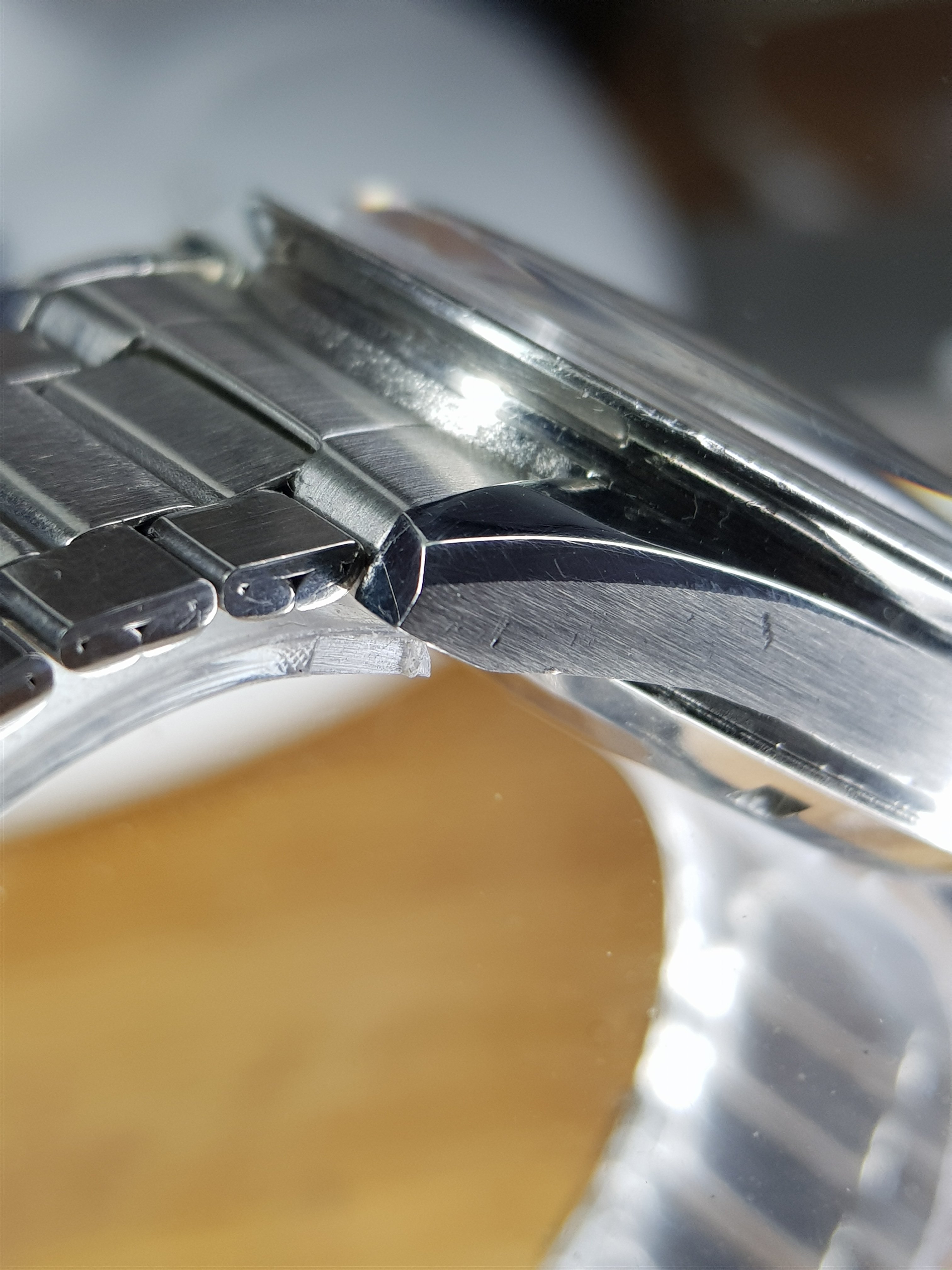

Looks like the case has been polished by omega I had one similar if you recall
I agree. bevels look too wide.
2,520
17,831
Yeah, this is part of the reason I posted this here, cause in my limited experience, I haven’t seen a -65 with these lugs either. But, these fluted lugs seem, to me, rare on any straight lug Speedmasters.
10,365
16,227
Yes. But not so not the modern interpretations. The FOIS, modern CK2998 and Trilogy watch have lugs like this, so it is either a refinish in the style of a very early watch or possibly, perhaps more likely a replaced mid case. EW facets are either small (63 and 65) or non existent (64).
1,846
3,845

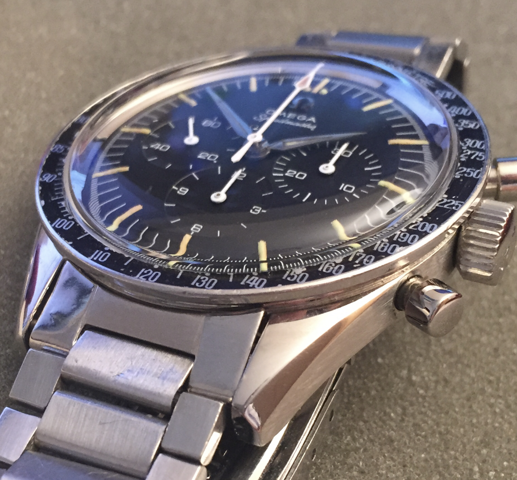

sorry forgot to add a pic done by omega when the previous owner sent it for a service

Hold the phone. I just realised you have a unicorn dial! That is a circa 1970 long index, stepped, non AML, 321 movement, wide T, Professional service dial described in MWO but not ever seen. Other than mine that is. Which I have fitted to a 145.012-68. We are now related! Rare but not necessarily valuable of course, but it is nice to see another

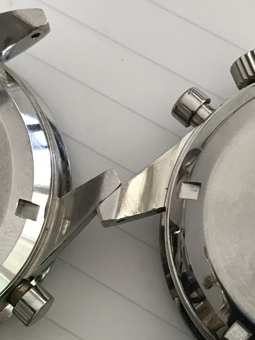

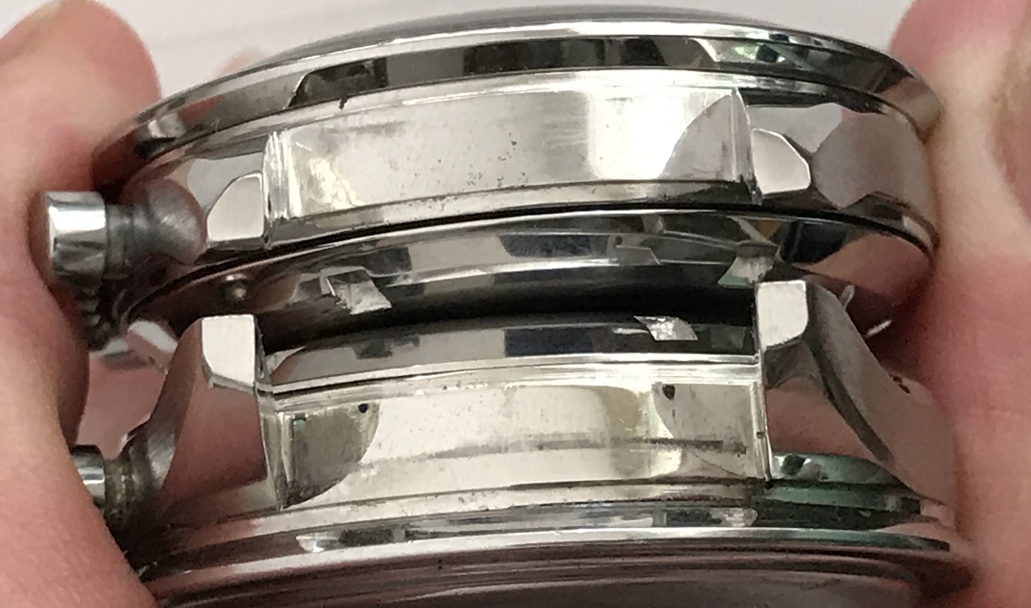

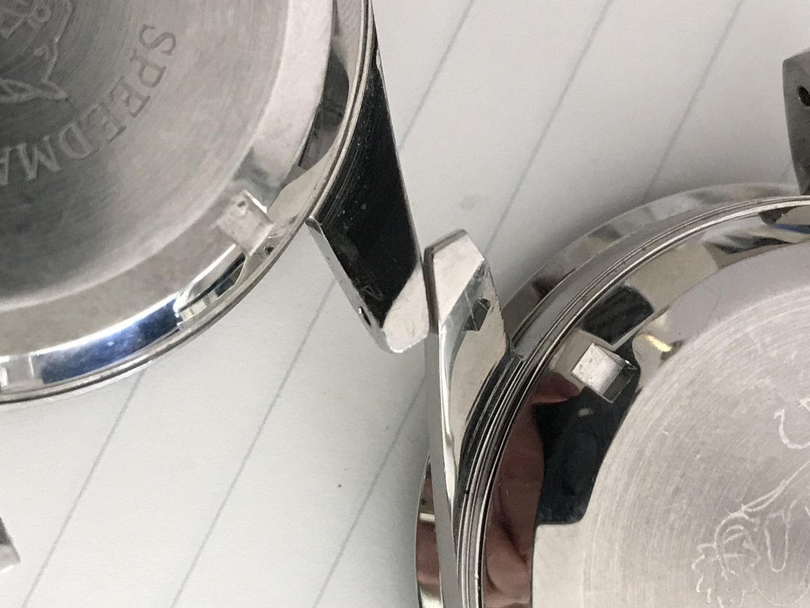

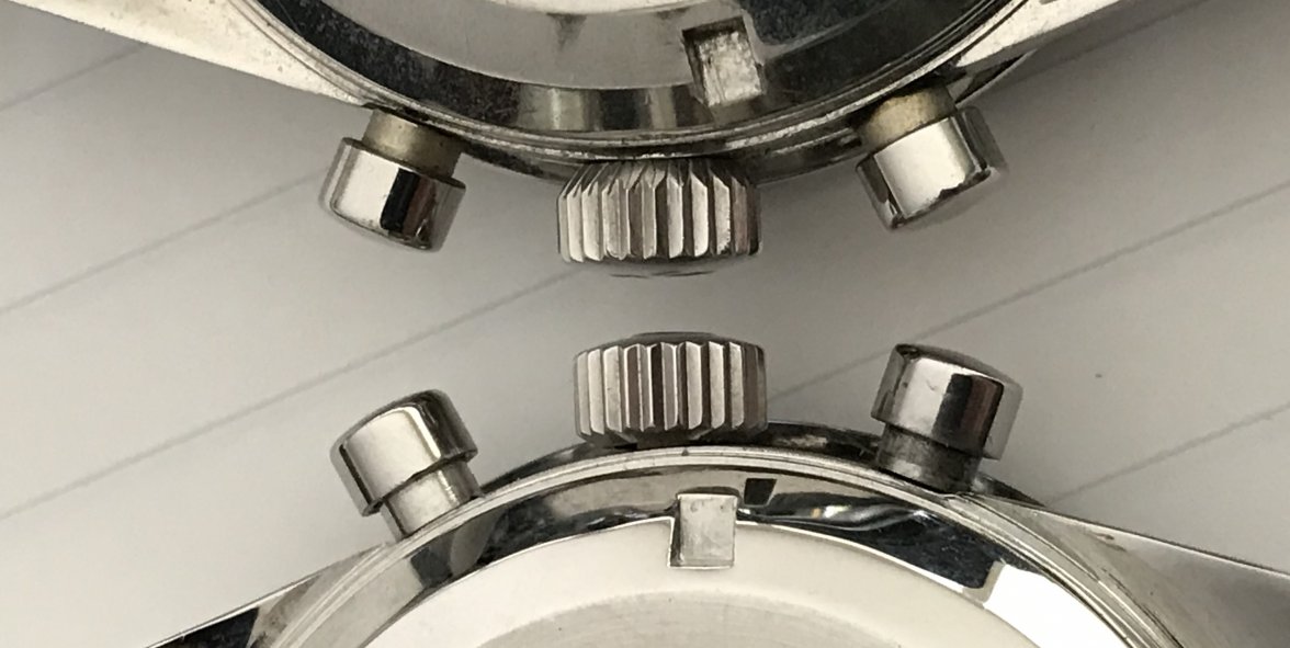

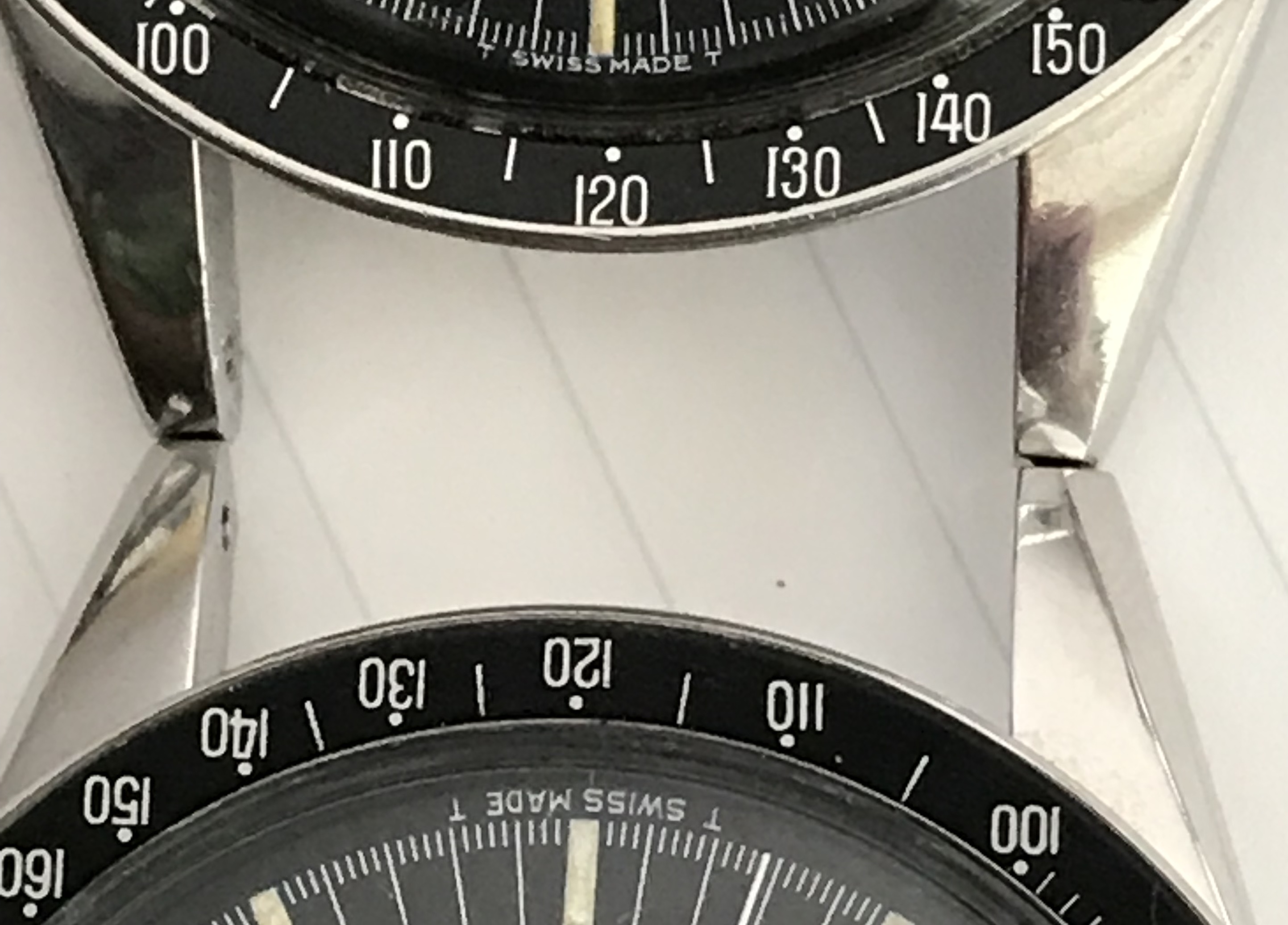

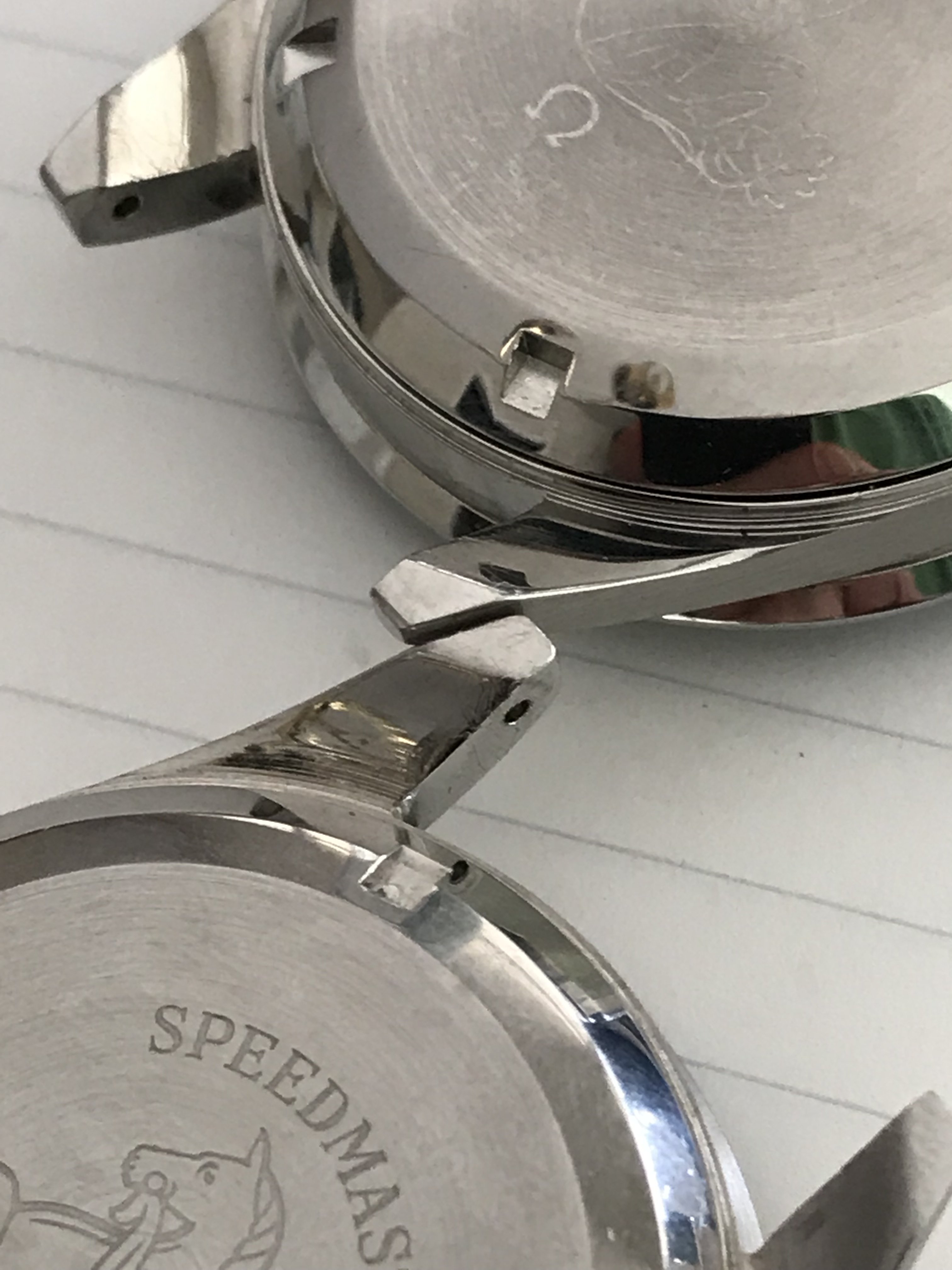

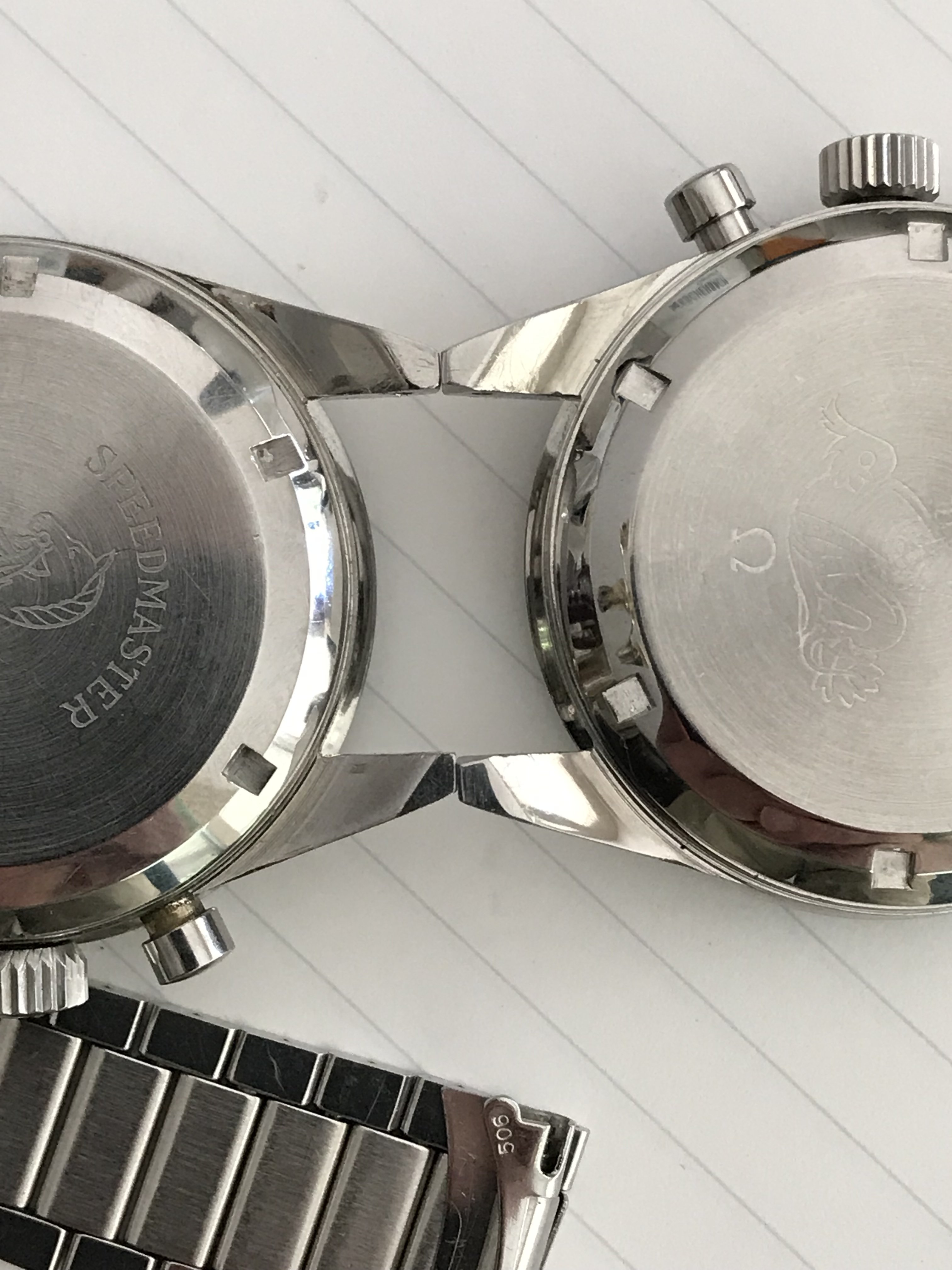

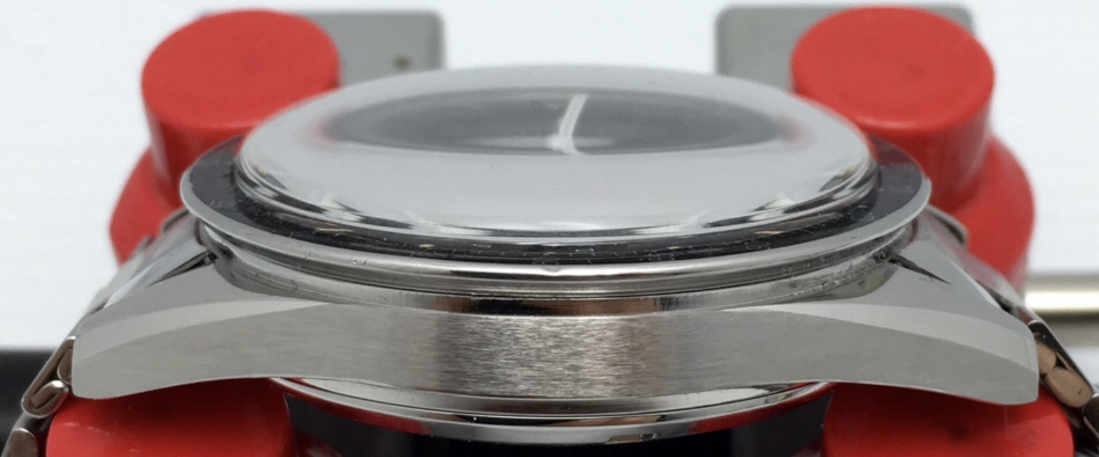

@airansun ... how do the following polygons compare to your other Ed-Whites?
If these were refinished/reshaped, I would expect your other watches to be 'fatter' as such.

@eugeneandresson :
Fun stuff actually
And, the money shot:
Totally fun stuff...thanks for the pics!
So, just for my own sake:
Pic 1: 'new' one on the left
Pic 2: 'new' one on the bottom
Pic 3: 'new' one left
Pic 4: 'new' one on the bottom
Pic 5: 'new' one on the left
Pic 6: 'new' one on the top
