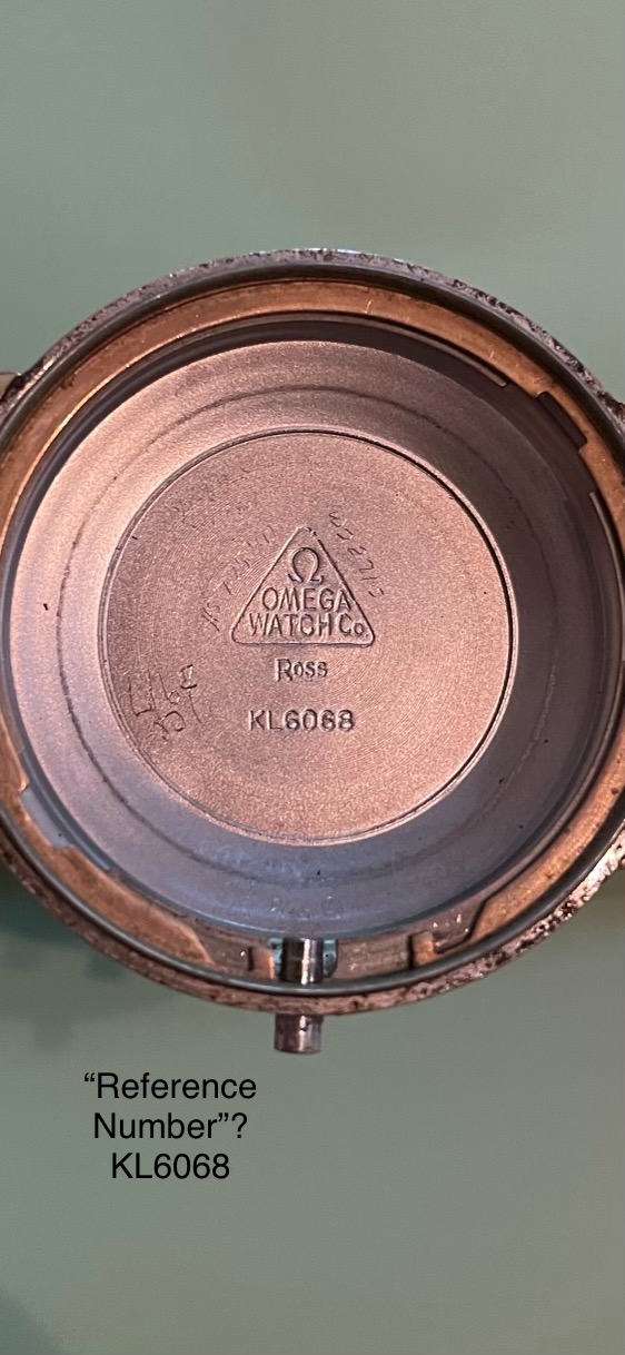

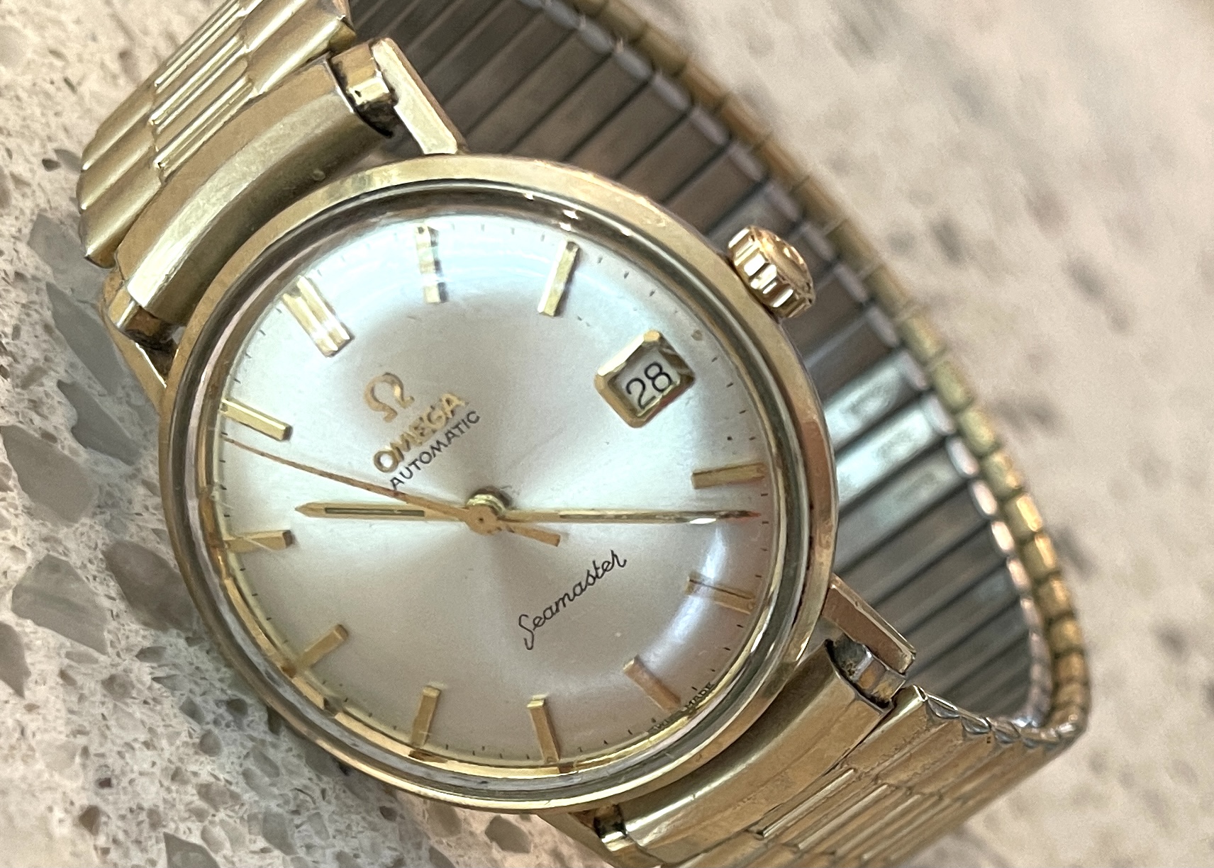

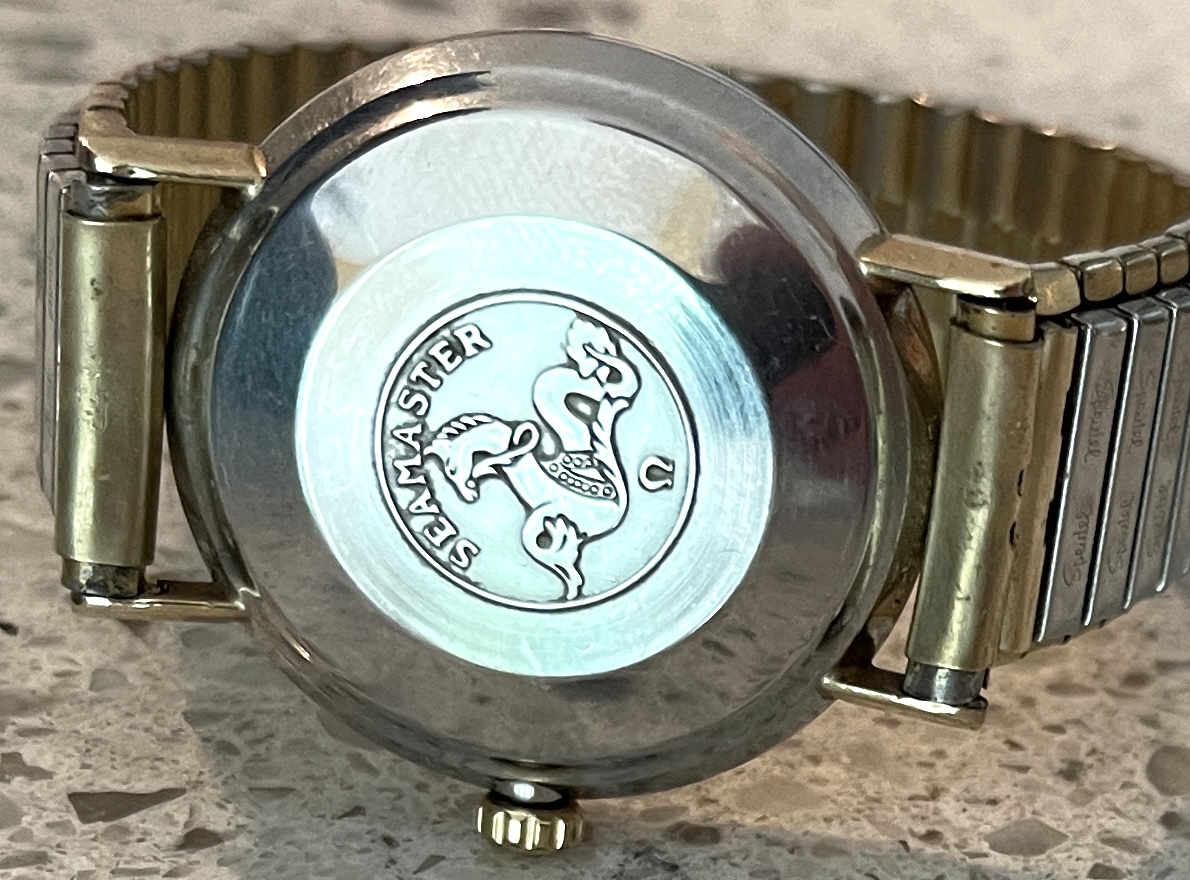

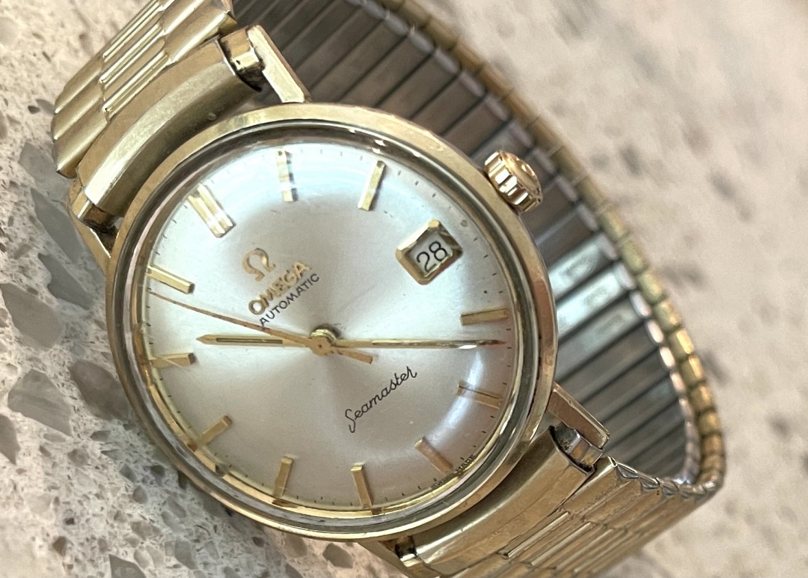

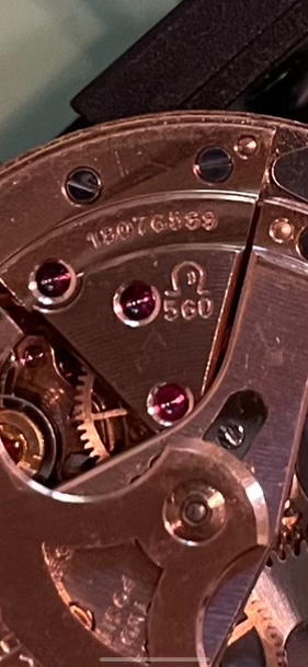

Hello All! I’m in the process of bringing back my vintage Seamaster to its original appearance (I inherited the watch from my father over ten years ago).
I was hoping someone might be able to confirm the correct Beads of Rice bracelet for it as I have a photograph from the 60’s which shows that’s what it originally had.
After scouring this fantastic site I believe I need a
1037 / 570 BOR Bracelet
however I’d appreciate some confirmation before I seek one out to purchase.
Up until the early eighties the watch never ran but with the help of an amazing local watch maker it apparently now keeps better time than a modern day timepiece! It is being returned to me this week!
Here is the information on the watch (as I understand it):
1966 Omega Seamaster (edit from 1961)
Case ref: KL6068
Movement: 560
gold filled
And here are some pictures:

1037 will likely not be the current number. An email to Omega Customer Service should help.
2,298
3,157
Nice watch, congrats!
1068 / 70 will do also as far as I know...
70 and 570 are interchangeable
You should get a nice one with endlinks below 200 $ on the bay

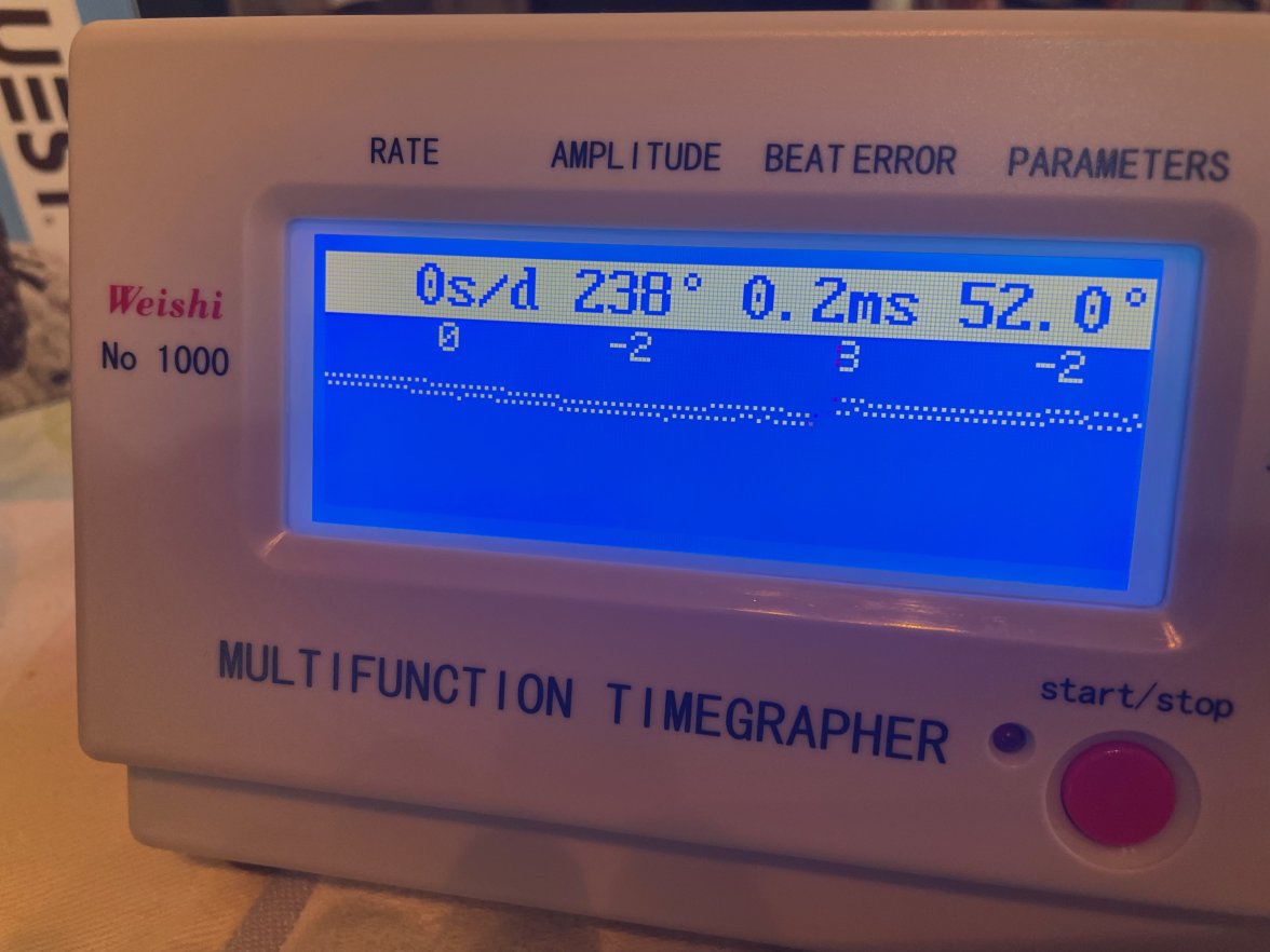

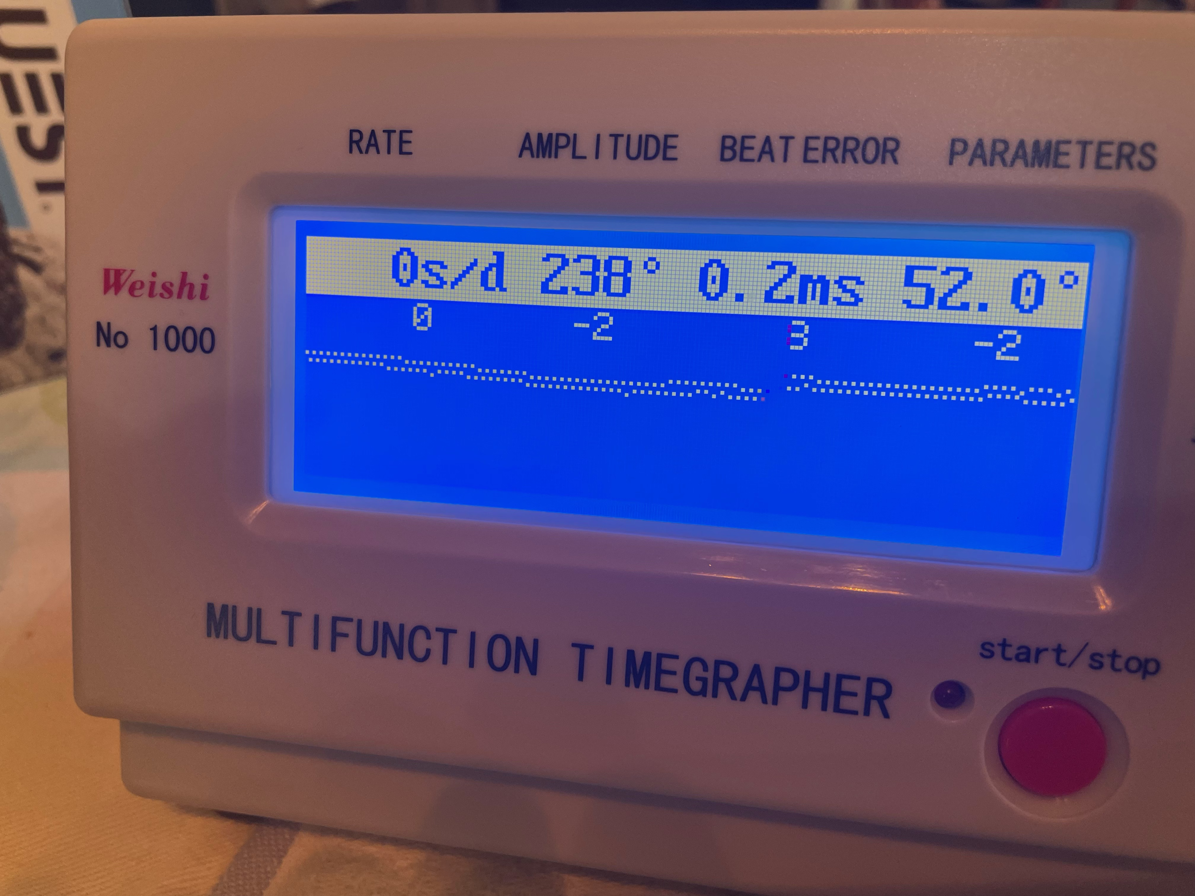

Is that timegrapher shot before or after the service? The correct lift angle for the 560 is 49º not the machine default 52º so in fact the amplitude shown there is over reading by maybe ~30º ie the true picture is that the amp is only around 200-210º which frankly isn't very good. It looks like it has been well regulated but maybe not very well serviced. If that £125 eBay machine is what your watchmaker uses, that is another indication he might not be as professional as some others. It may run just fine, but it has the potential to be healthier than that.

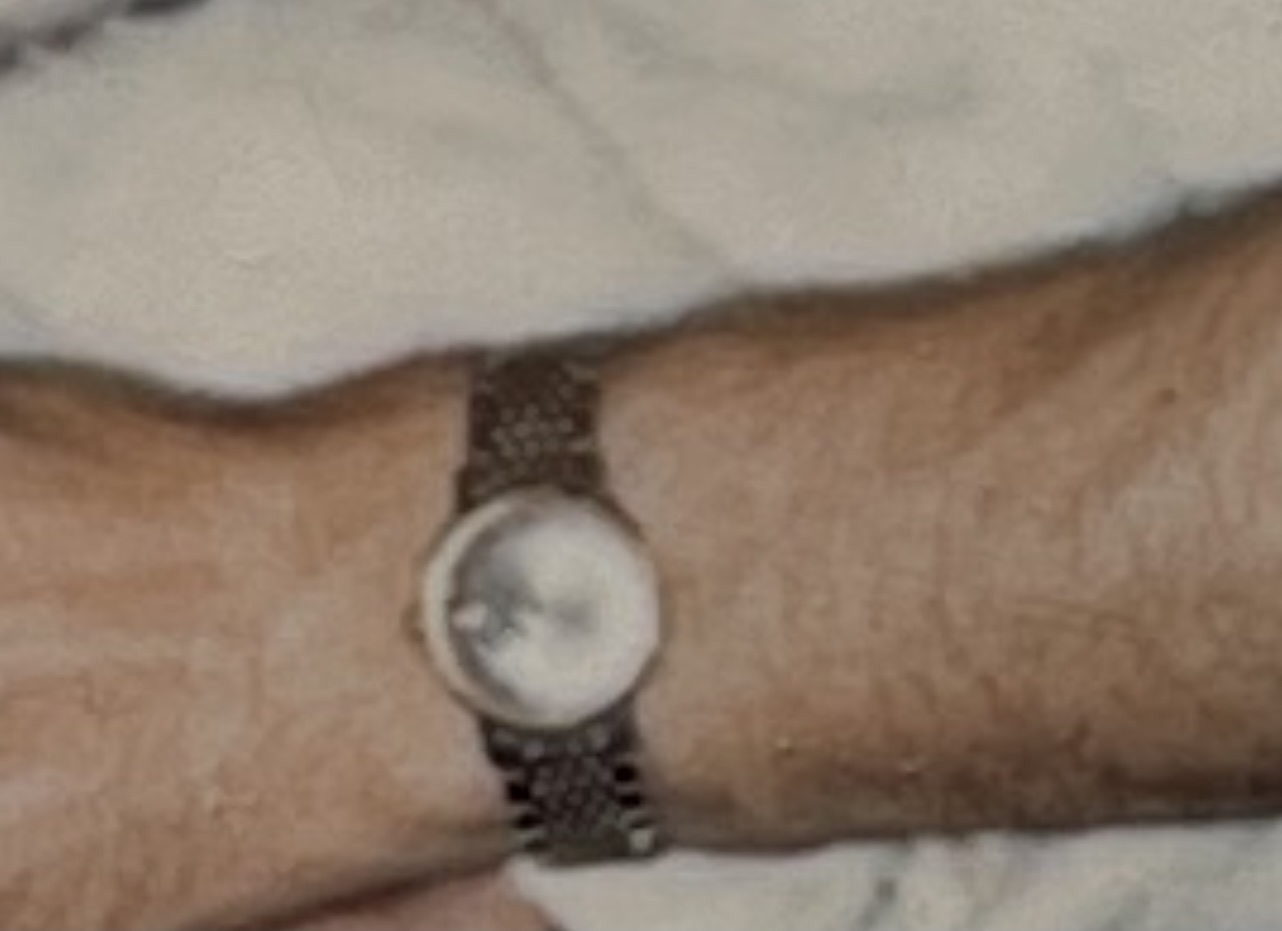

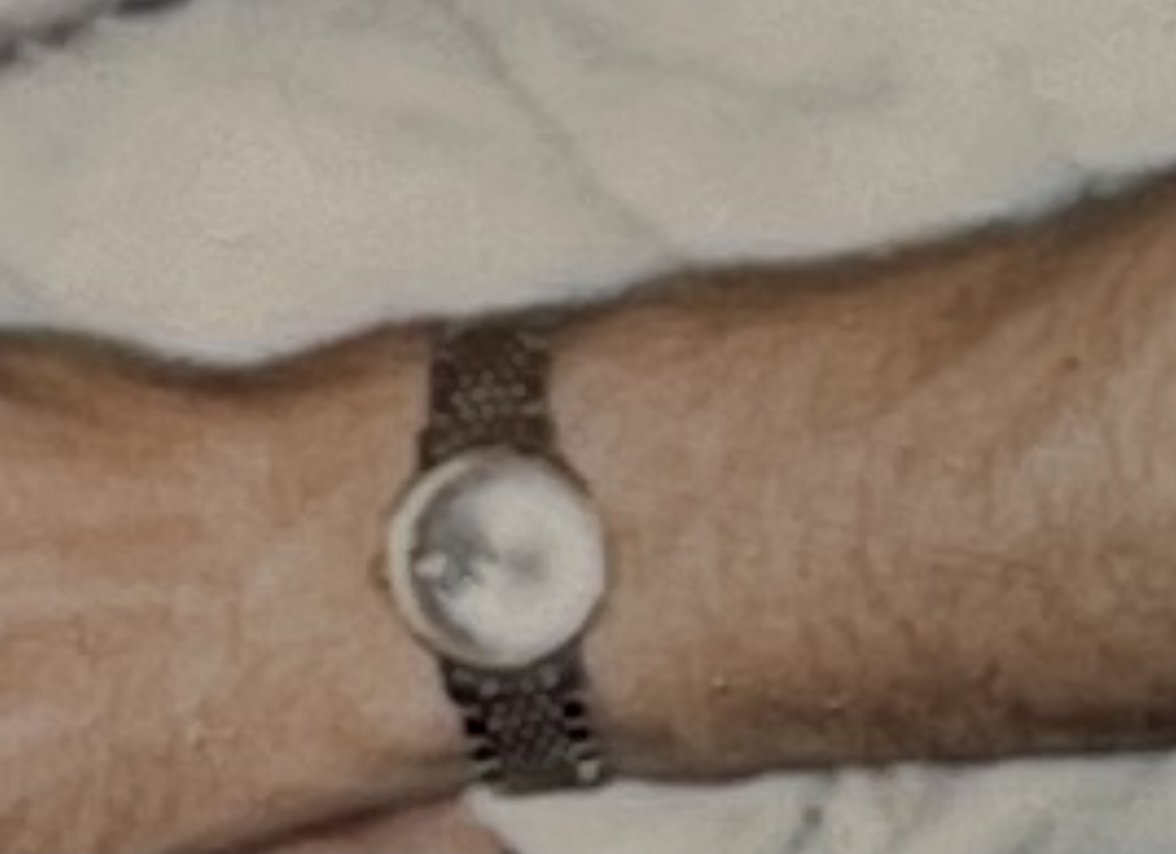

Here’s a magnified photo from 1966:
2,298
3,157
Looks very much like a "7 row bracelet" so 1068 or 1037 is most likely.
The shot is at some point AFTER service but I cannot say if it is the final reading. I really appreciate the input! I guess time will tell how well it runs / keeps time. Can you (anyone) recommend another watch maker in the U.S.? I live in Maryland, near the DC Metro area. I wanted the crystal replaced too but the one he ordered wouldn’t fit.
