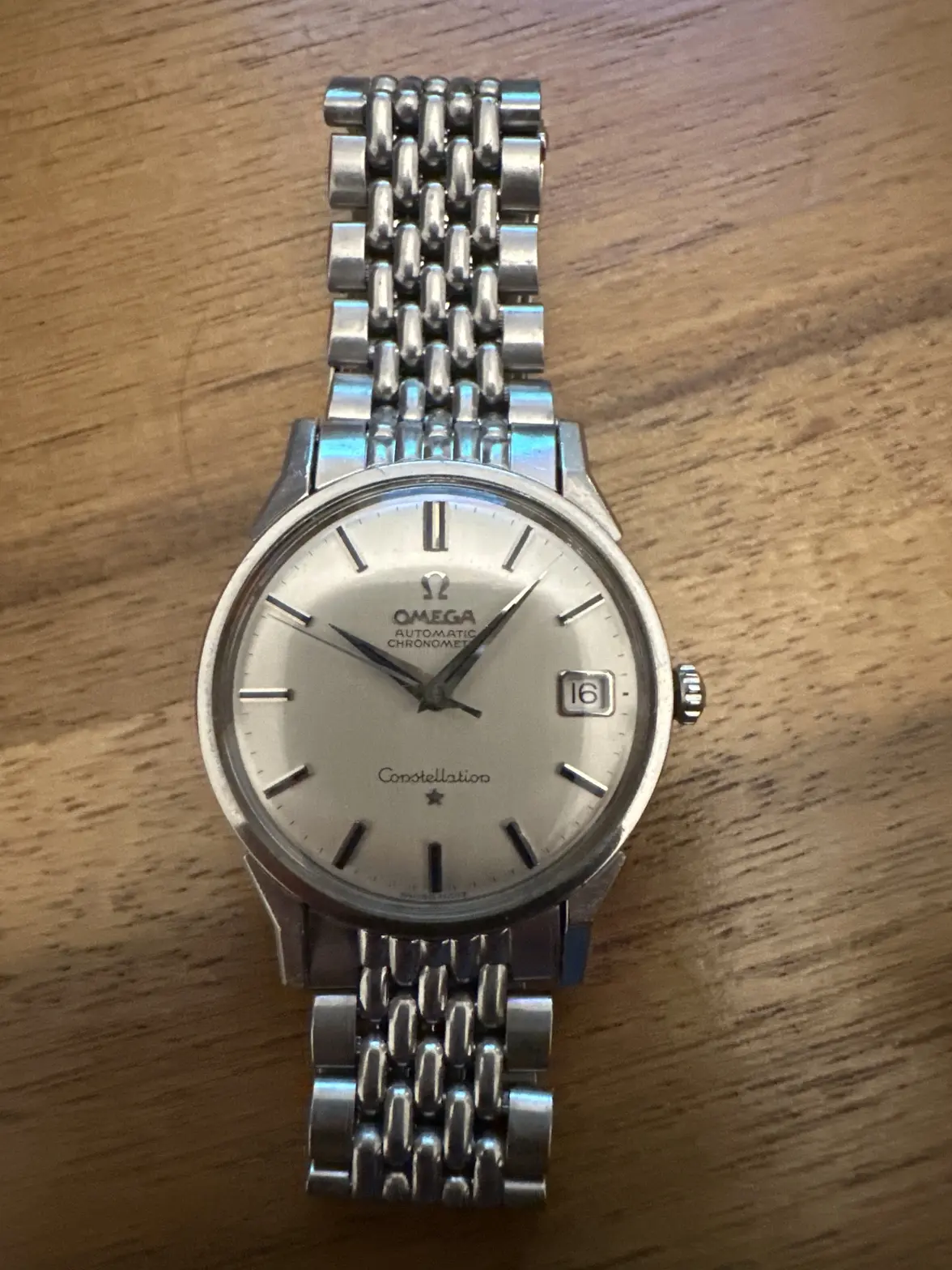

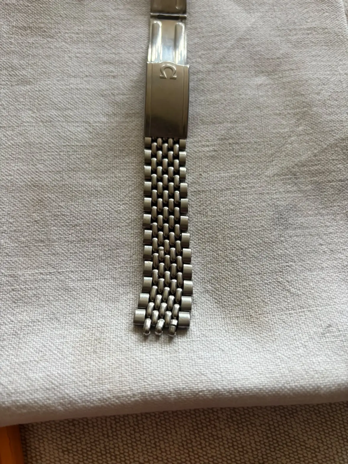

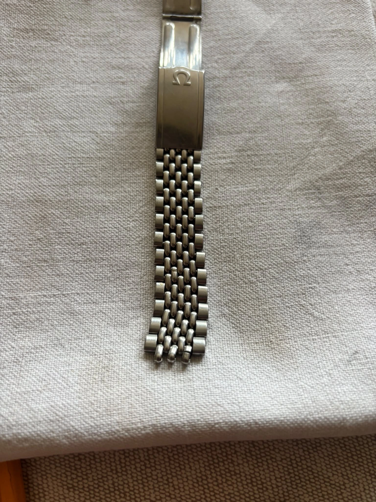

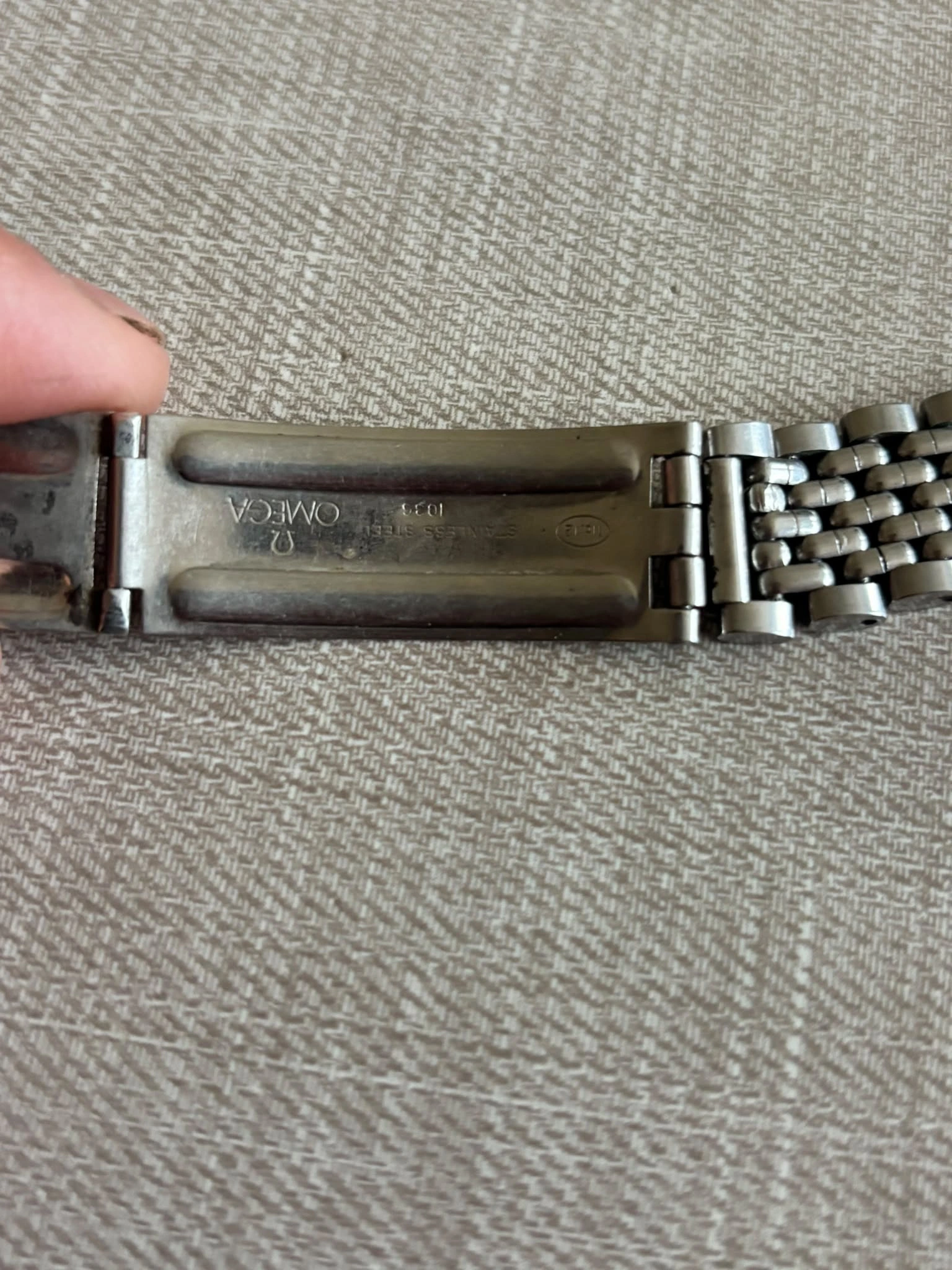

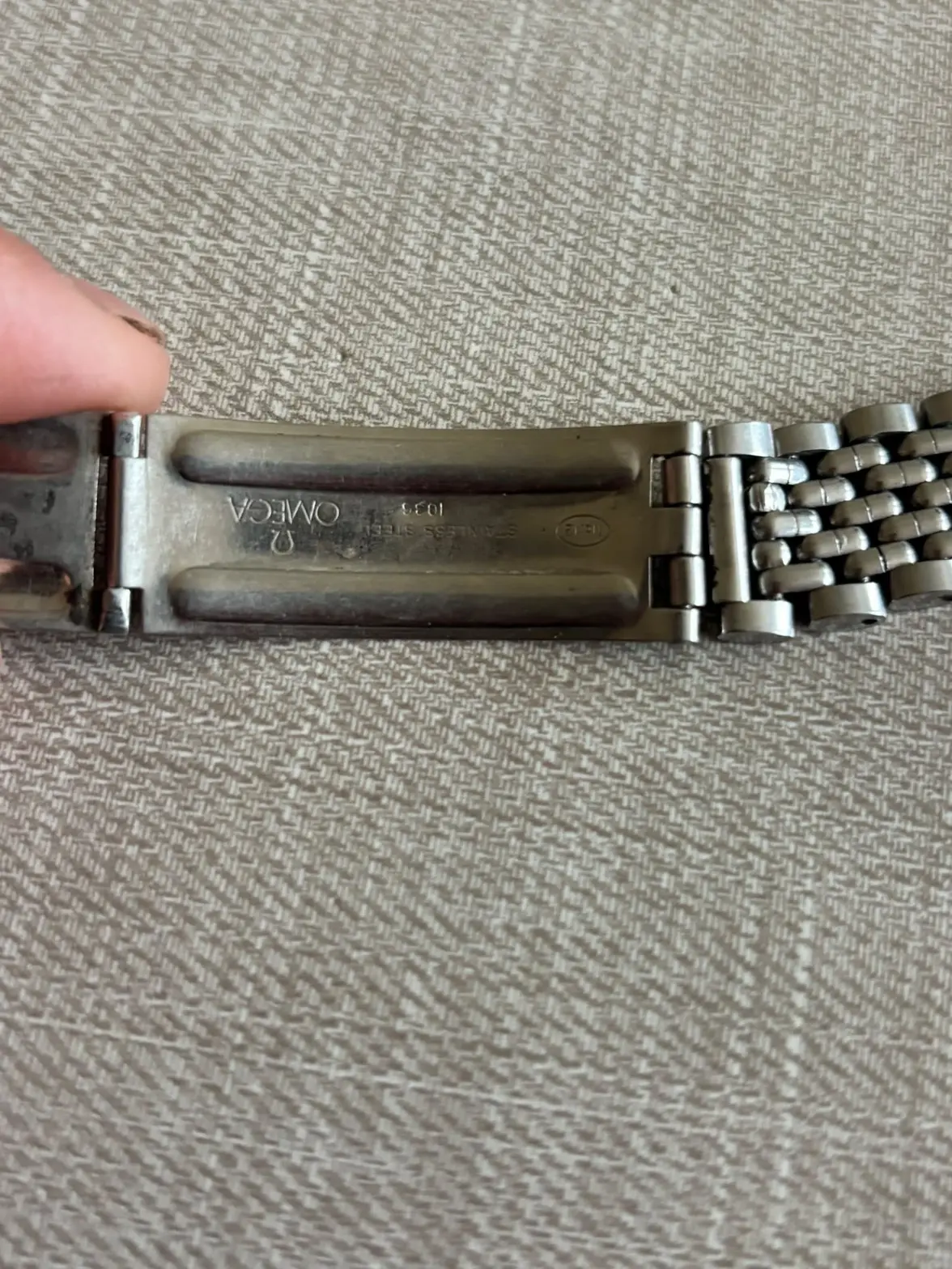

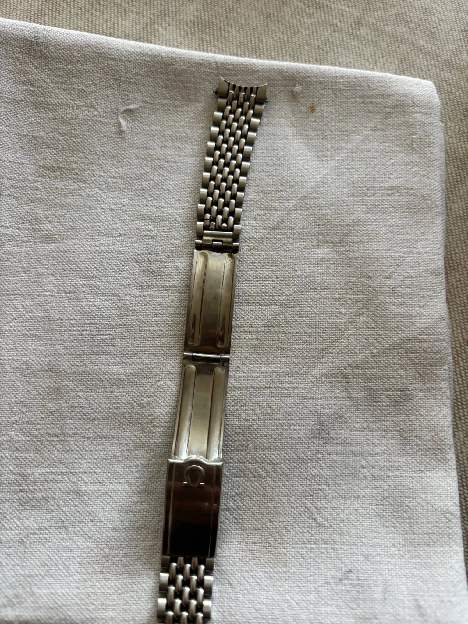

Hi Omega community,
I bought this Omega 1036 BoR watch bracelet, which came with only one 512 end link, to install on my 14902SC61. I think it's genuine, but your expert opinion could help.
I'd like your advice: would it be better to find another 512 link or replace both end links? Which would you recommend?
Thanks in advance for your help!
2,298
3,157
Endlinks for 60s BORs are not easy to find...
12/512 seem to be the successors of 11/511, check this threads
Unless your bracelet was cheap I wouldn't have bought it with only one endlink, sorry to say that...

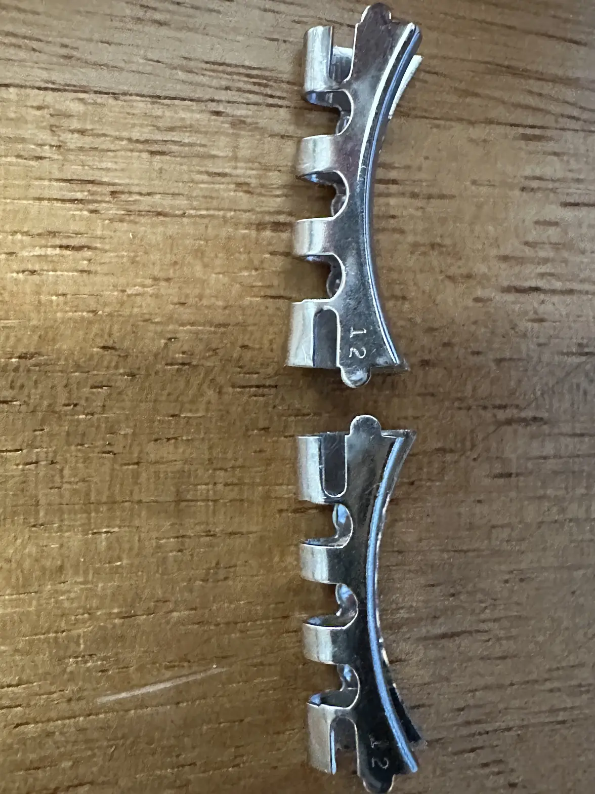

Thank you for the information. I paid 120 euros for it. Do you think I can replace the missing 512 with a 12?
2,298
3,157
They should be the same.
Most likely you can also use a 11/511 if you find one...

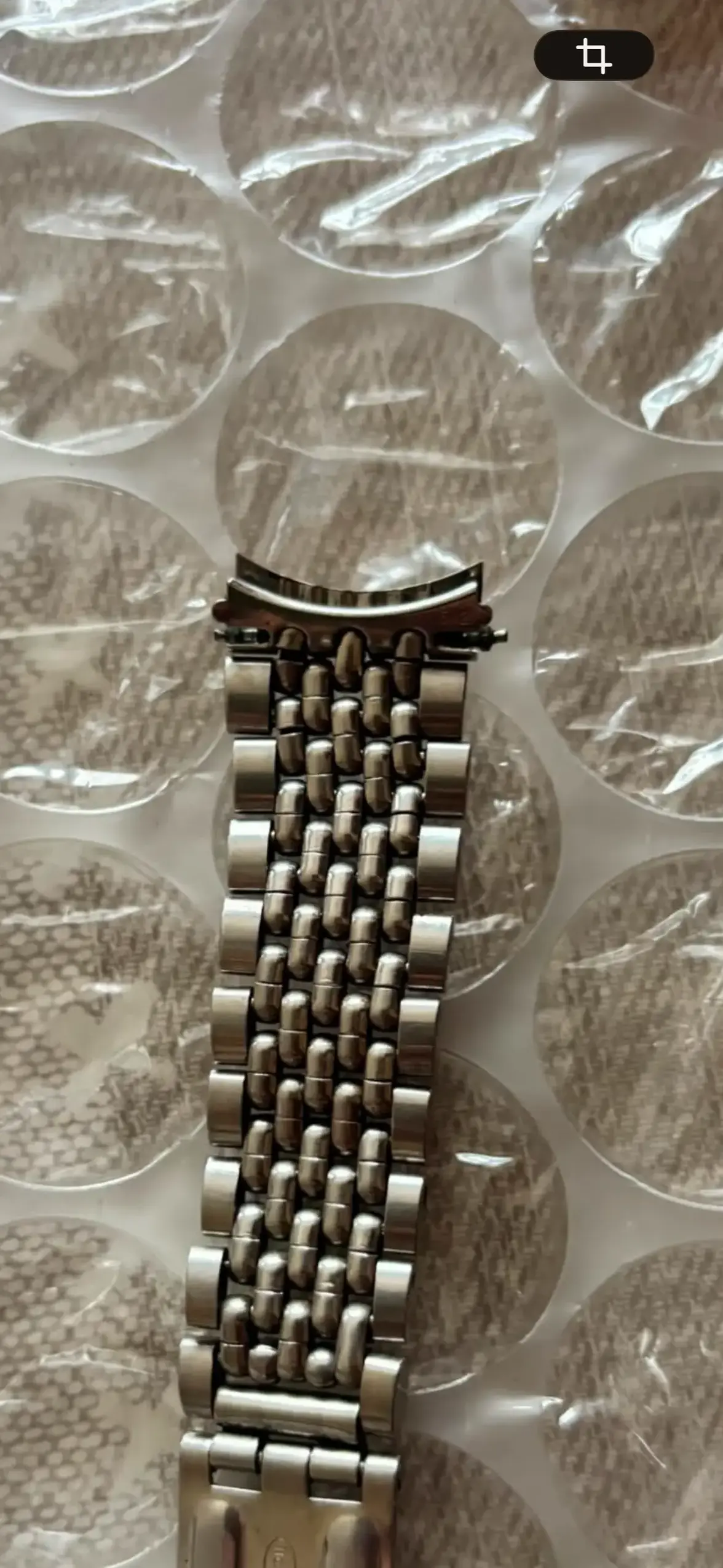

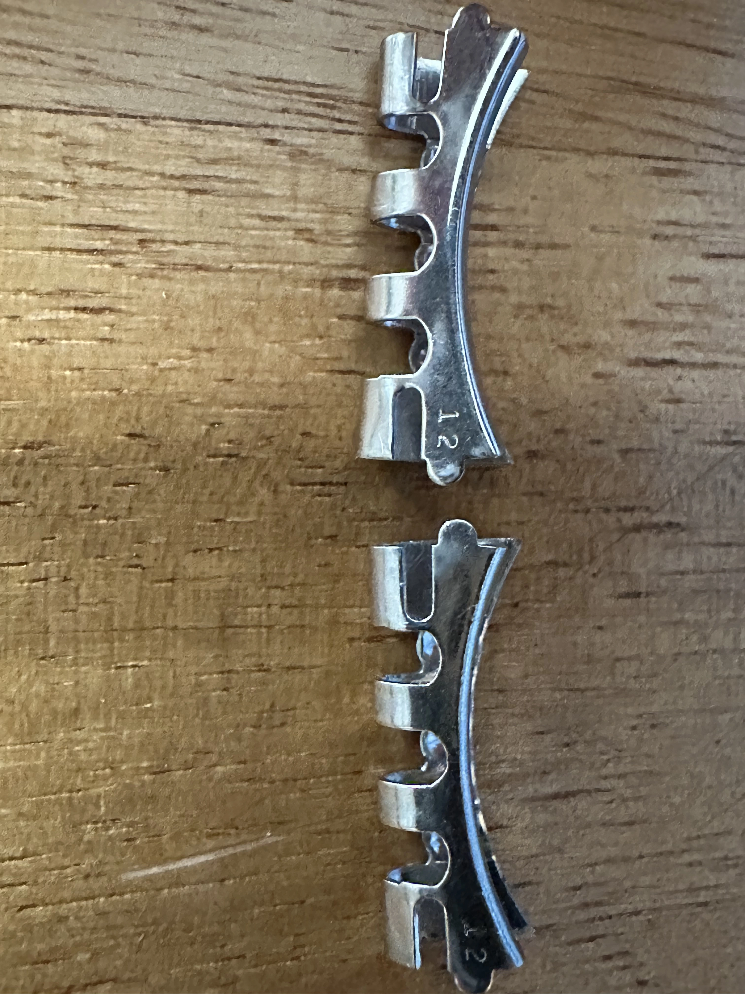

Hello everyone, I finally found the correct end link I was missing for 30 euros on eBay. So, if I calculate all the shipping costs for the 1036 and the two N12s, it comes to less than 200€
