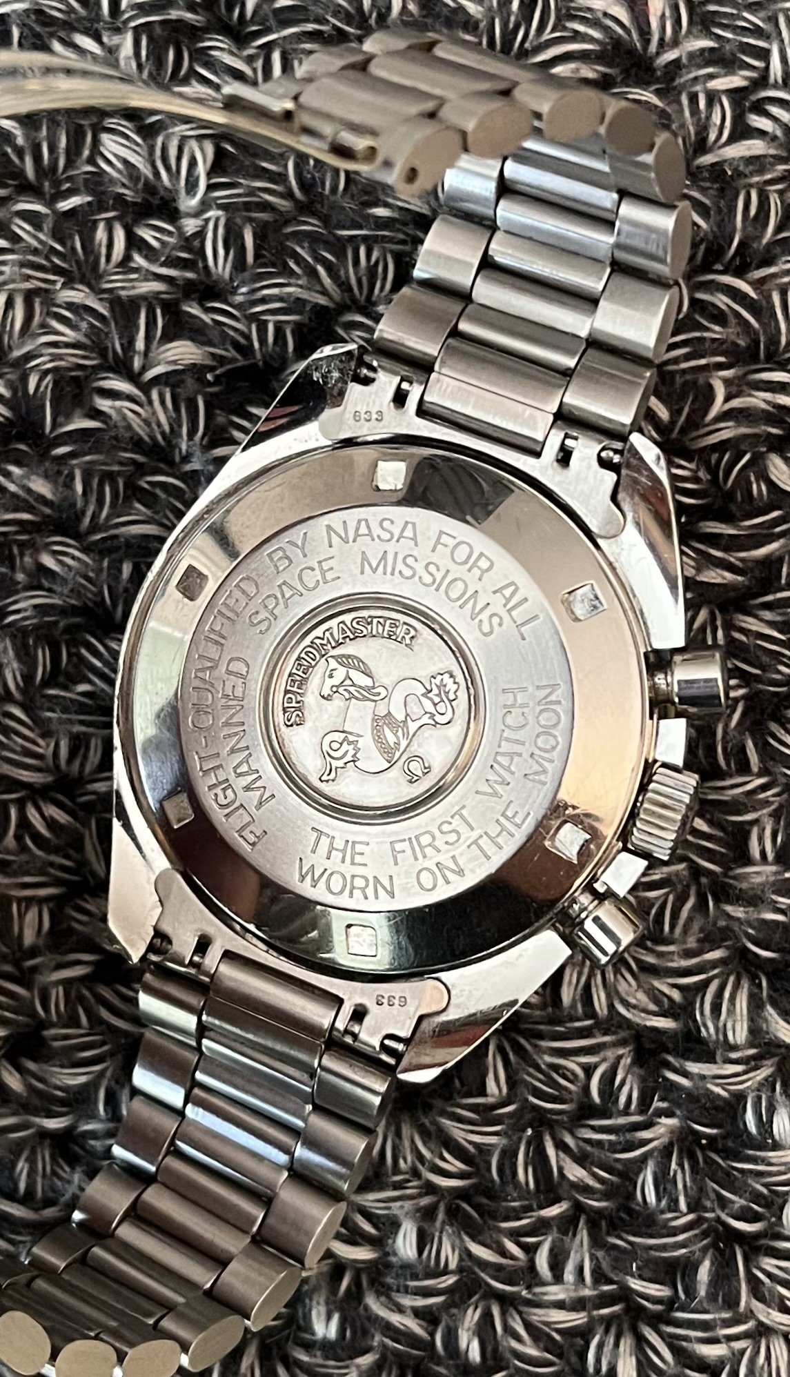

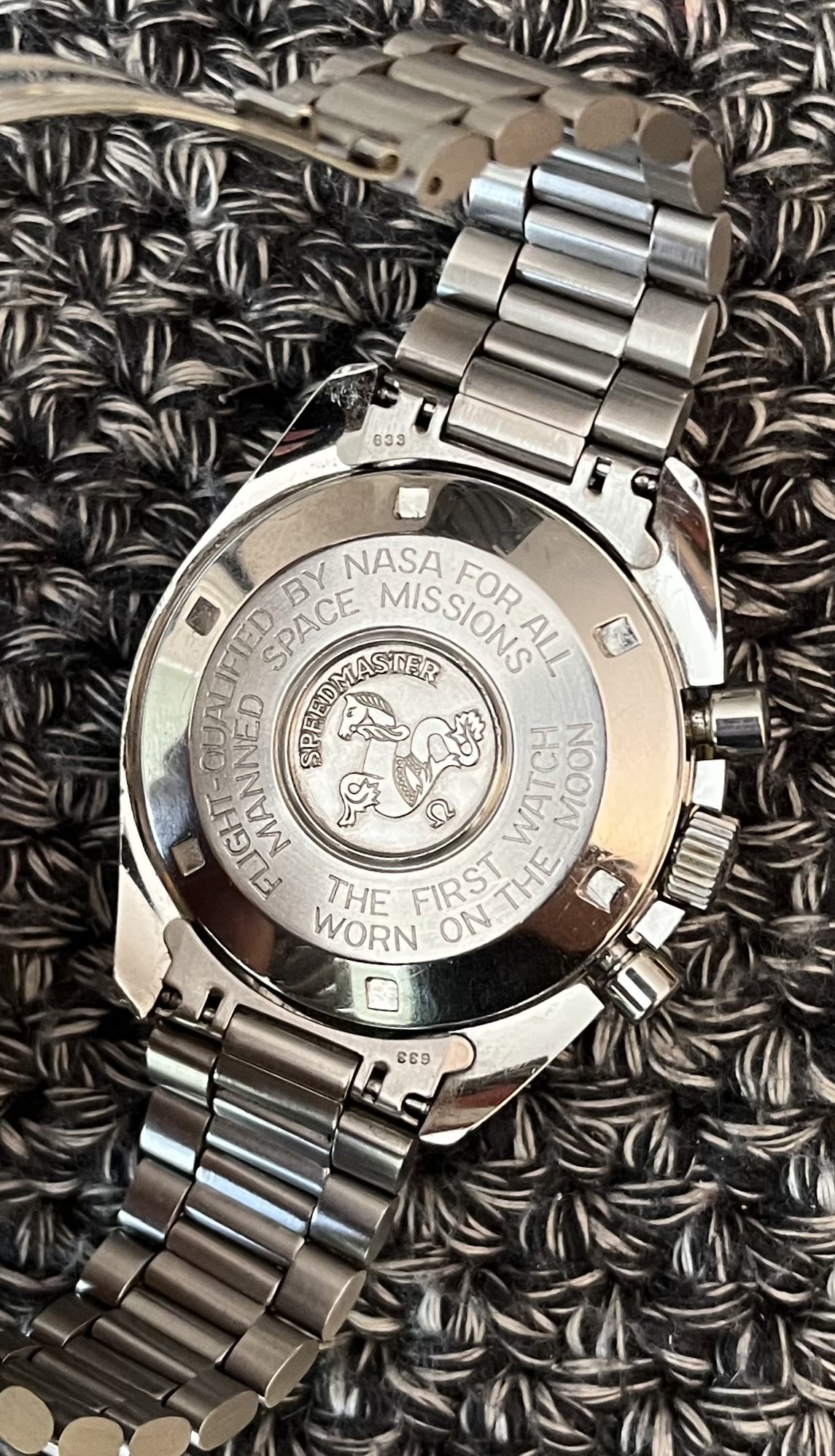

I would say its a later watch with an incorrect, (too early) case back.

4558**** usually indicates the 80s, around 1982. Especially those with a 45582*** serial. Certainly not 145.022-71, as @Spacefruit says, it’s likely something more recent. Probably a 145.022 CRS.

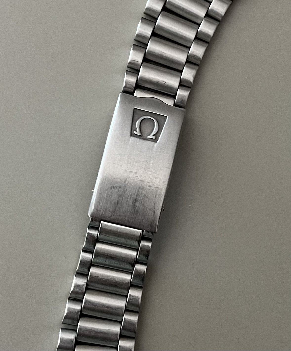

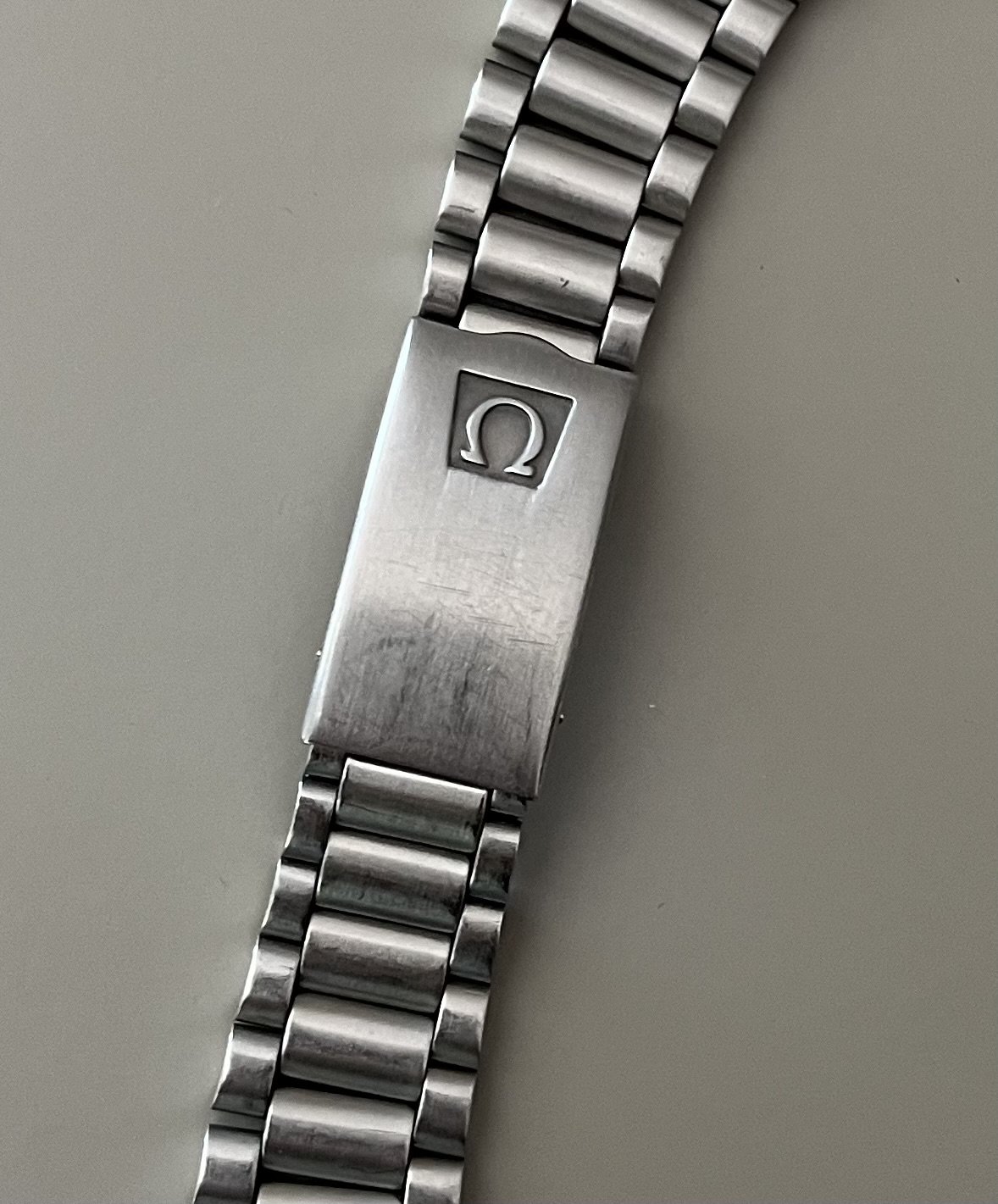

One more thing though is the watch came to me with what appeared to be an original 1971 bracelet. Clasp marked 1171 and endlinks marked 633.
Not sure if the entire case and bracelet is an authentic 145.022.71 and the newer (but authentic Omega) movement from the 80s was swapped in or just the caseback changed ?

They are not saying the movement and case don't match, they are saying the caseback and rest don't match. The 1771 bracelet used screw pins in the 1970s and had a different clasp, yours looks like the one seen from the 80s onwards that uses push pins. You can in fact still buy a push pin 1171 new right now.
You are overthinking it I reckon. It's a legit 80s watch with a caseback swap.
EDIT, I may have been hasty about the bracelet, the trapezoid logo on the clasp is that of an early one, but that one was seen until the early 1980s so might still be concurrent with the rest of the watch.

The bracelet pictured does indeed use screw pins. And does not the keystone shaped Omega emblem indicate a 1970s
1171 bracelet?

See above, was seen up until 1982 according to MWO (the Speedy bible).

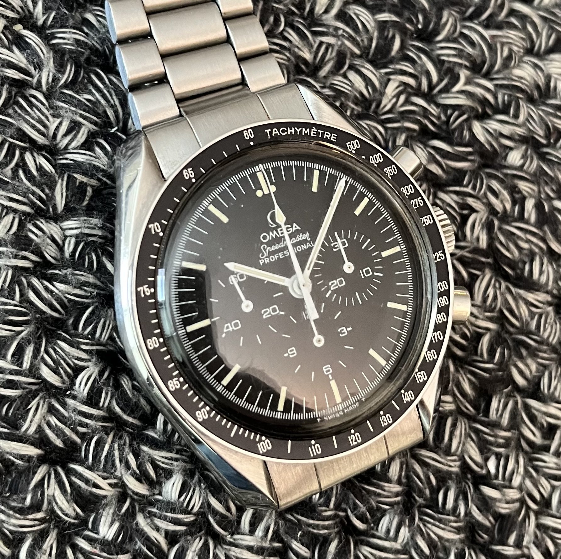

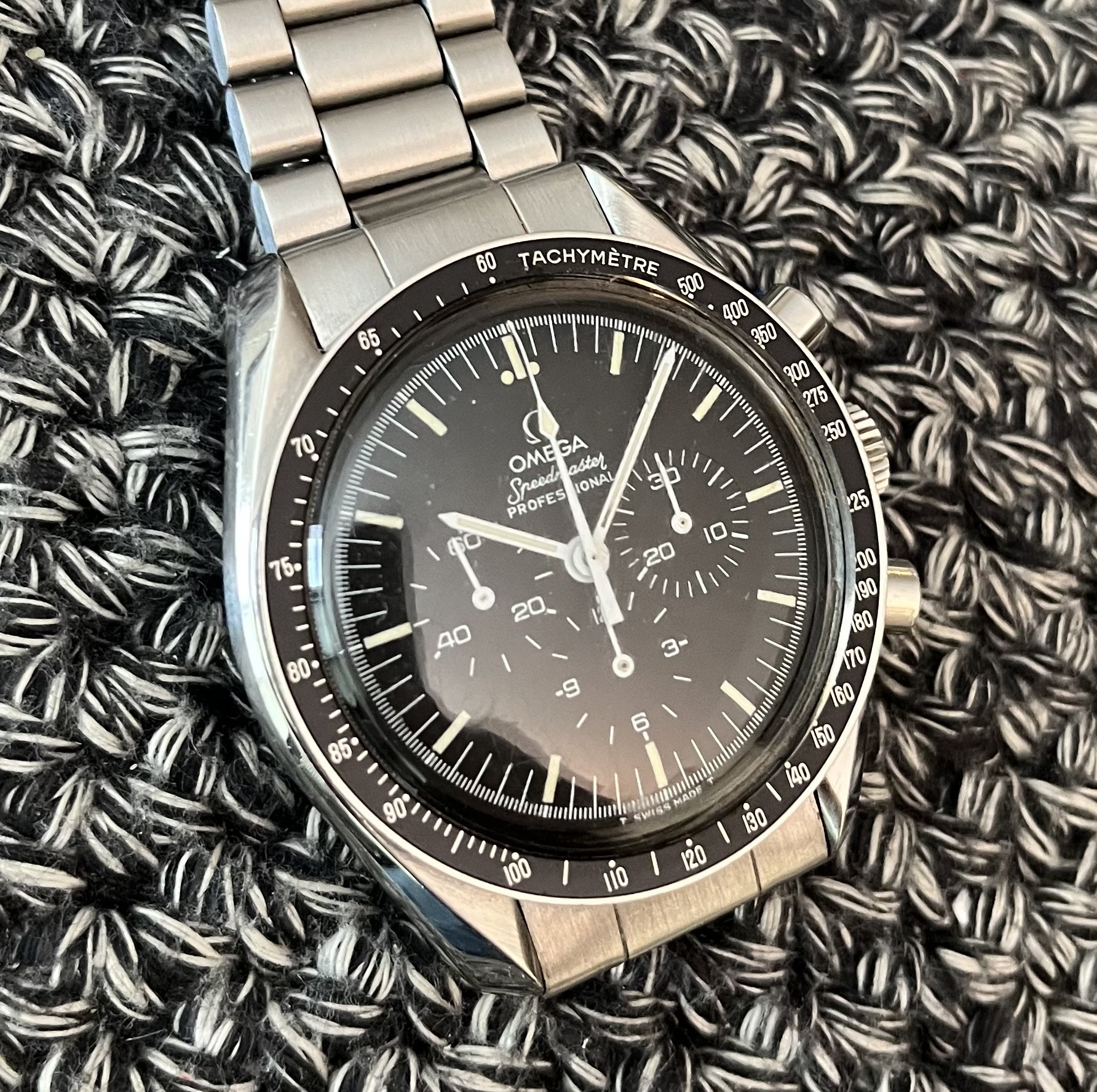

As some of the experts on these watches have noted it’s most likely a caseback swap.
the dial is clearly post late 1977 and ran through the mid 80’s. So the dial and movement seem to match which tends to mean the caseback got swapped at some point. I’ve not looked at the bezel but I’d expect a DNN style bezel. Which is correct for either.
