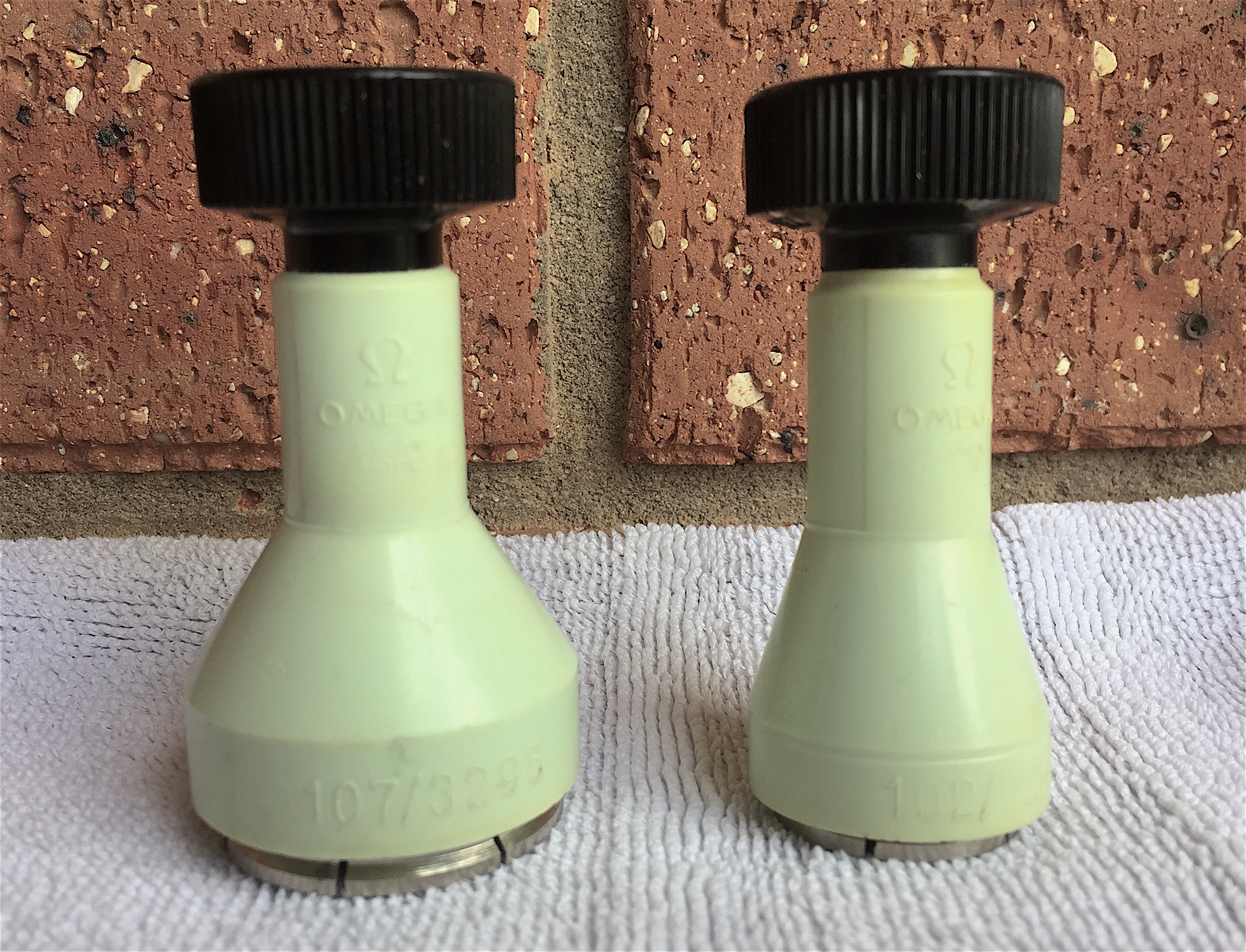

I thought the tool 107 is referring to The tool that takes the crystal off, as these are front loaders
There is no case back - the movement has to come out the front

Tool 107 refers to the tool you need to lift the crystal in order to remove the movement. The women's version requires Tool 102.
Dynamics tend to be less molested because the movement is harder to access. You have to remove the crystal, remove the stem, then rotate the dial about 30 degrees before the movement will drop out of the case. Omega helpfully notched the dials in the right spot, small enough for a toothpick to do the job.

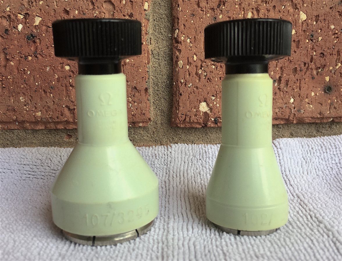

Tool 107 refers to the tool you need to lift the crystal in order to remove the movement. The men's version requires Tool 102.
Tool 107 is for the full sized mens watch, not the ladies, me thinks

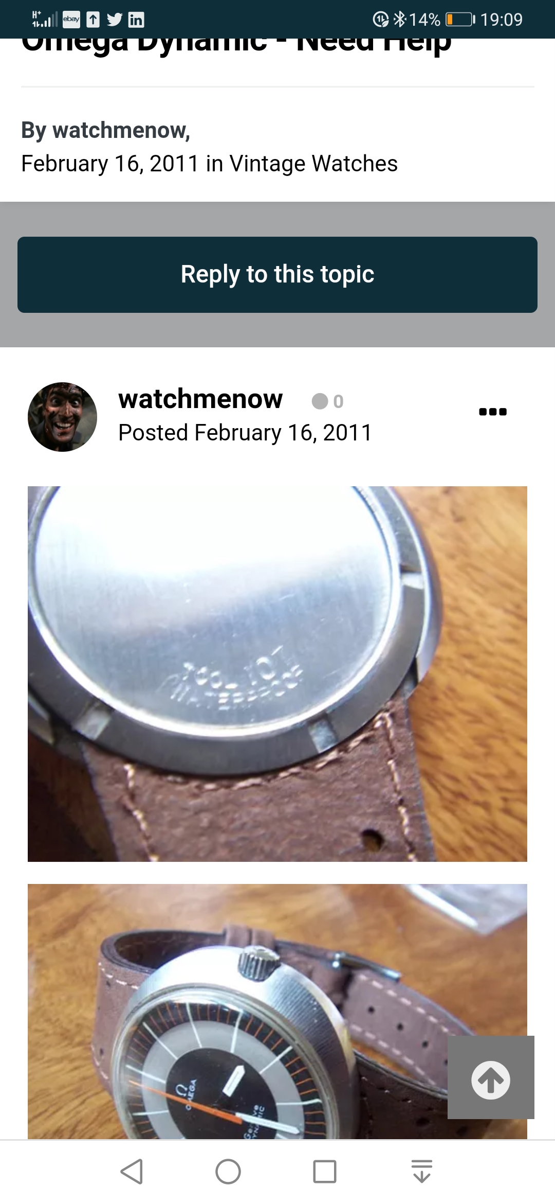

tool 107 waterproof
is etched / engraved/ stamped on back of watch in attached photo.
icant see it on ad. polished away? not on all dynamics?

The engraving is usually pretty light and hard to capture in pictures when you're trying to, let alone if you don't know it's there.
